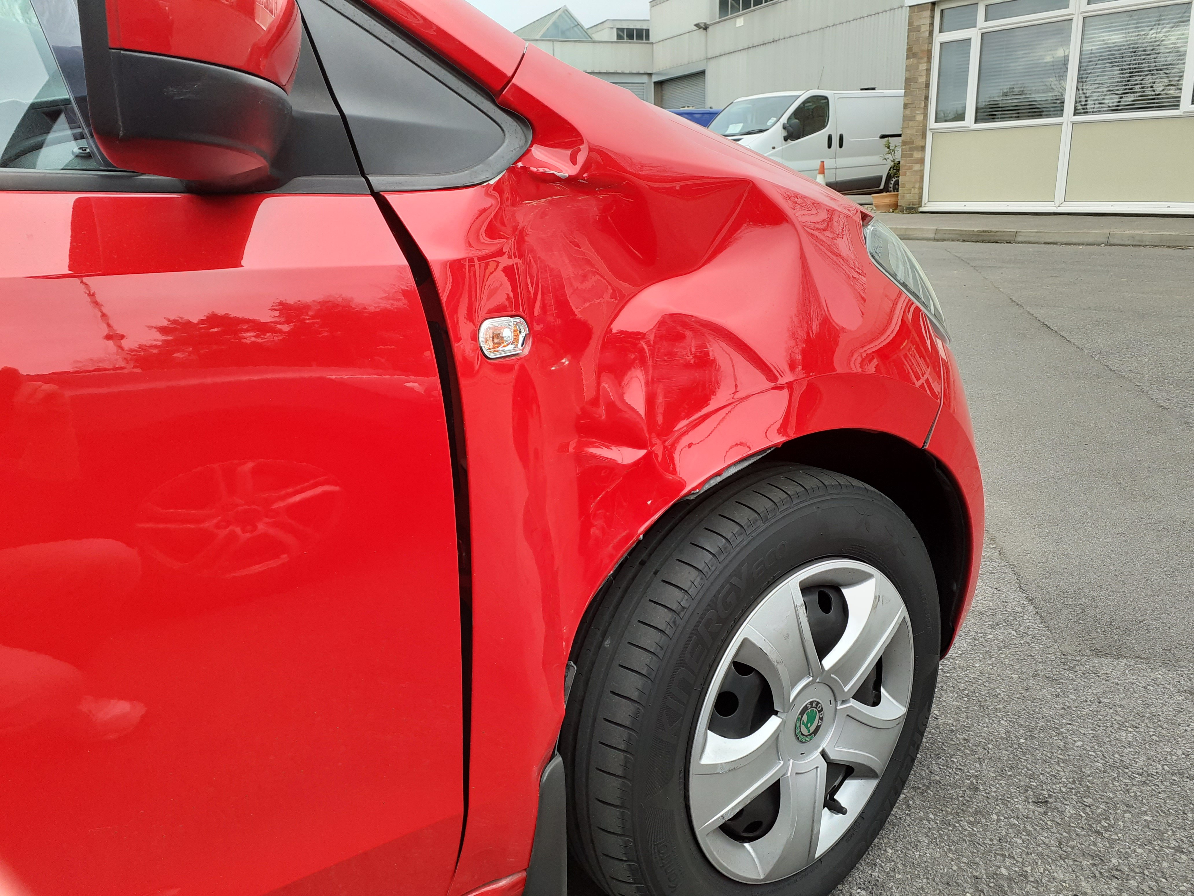

My day just got worse. Avoiding a kid on a bike I hit a post in the car park and badly bent my drivers side wing. OMG my smart little car damaged. I'm mortified. New wing and indicator will be needed. Any thoughts on the best way to him fixed? Do Skoda do body repairs, should I pay or call the insurance?
As it always is with a bit of damage.... Get a quote from a body shop or two. Then check with your insurer how a claim of this amount (roughly) will affect your premium over the next five years or so.
You may be surprised how often it turns out to be cheaper not to claim in the the long run, when it's clearly your own fault. For serious costs, you may not have the option, unless you have ample spare cash!

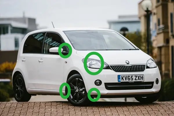

If you're mechanically minded, you can replace the wing yourself if you find one in the correct colour, they are actually very easy to replace as I've done it myself without any mechanical knowledge at all! (This was back in the day of not having a foggy, I even used the spare scissor jack to jack the car up 😂 (I always use a proper trolley jack these days before anyone says anything))
I've attached an image below with a very rough idea of where the locating screws are, we're going back 4 or 5 years when I removed the wing so I could be off, I know there's one at the bottom of the wing near the door, there's one behind the plastic trim in front of the mirror (which by the way I found a PITA to remove!)
You also need to remove the headlight as there's a screw or 2 underneath, again this is fairly easy to remove, there's a metal bracket above the headlight which is 3 screws from memory, there's a screw at the back of the headlight to remove as well, remove all the connectors to the headlight and then wiggle it out (can be a bit tight!)
As I said it should be relatively straight forward to remove the wing as I managed it with sheer luck, if it helps I even did a little repair post when I was doing all this which isn't by any means a guide, but might help if you choose to go down that path.

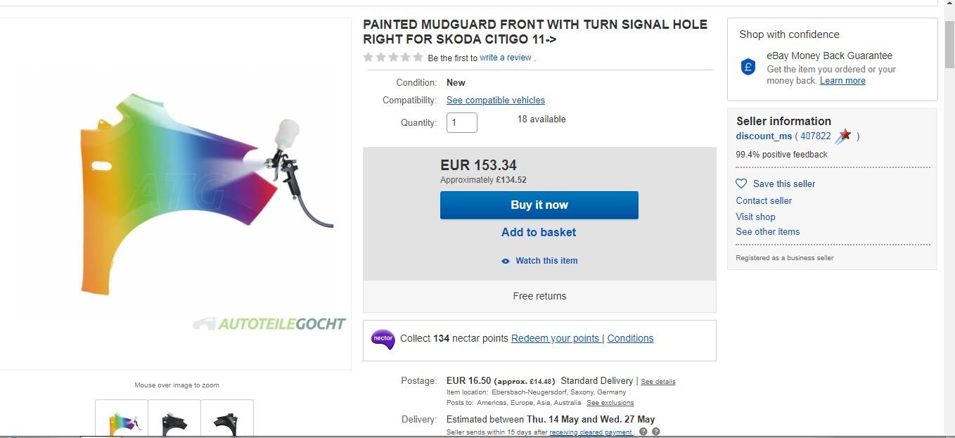

Advice from my sisters husband who used to be an insurance assessor is that a new wing and side indicator (+ paint ,time and labour ) at a body shop will push the insurance close to a 50% write off! NO WAY. So I'm going to have a go at replacing it myself.  New indicator £8, new wing Painted £156.52  £32.54 p+p from Germany. I'm not bad with the spanners and You Tube vids + print out from 7zap.com. So why not to try! No way am I letting my little mate go for couple of hundred quid repair.

that seems a lot damage for a car park incident?
but definitely self repairable
You'd have to be going sideways to do that damage by the look of it..................Definitely right hand down full lock imo.

Looking at the photo be prepared to replace the part circled, that looks like it's taken a bit of a hit too, given the damaged near the front bumper as well, you may also find you need a new bracket as these are very fragile, this would be the one you need:
https://www.ebay.co.uk/itm/164092786595
Is there any damage under the bonnet from the force of impact? I.E damaged to the headlight mounts.
You'll also probably need a new arch liner too as mine cracked when I hit a deer at 50!

Mickey, can you share the source of new painted body panels from Germany please?
Am pondering whether to repair minor damage to mine thats on a highly visible area of the wheelarch which could look worse for all my efforts, knowing the price of a plan B would give me the confidence to have a go because if I did screw it up I would not have to look at it forever after, I have the paint & materials, time is unlimited and free at present, I will enjoy the repair if I do a good job but would kick myself if I didnt.

Loosened and re-tightened all the bolts to ensure they can be removed, so back to ebay and messaged the company in Germany to check I order the right wing. Tornado Red paint code is LY3D a common VAG colour so hopefully no problems will let you know. In for penny!!!
This is the company in Germany.

Personally I'd avoid that as they've provided just a generic photo so you've no idea of the condition unless you ask for photos!
It's second hand, surely you'd always ask to see photos and they specifically say ask them if you've got any questions. Why just dismiss it? Obviously not your cup of tea but I was only making a suggestion as an alternative.......
