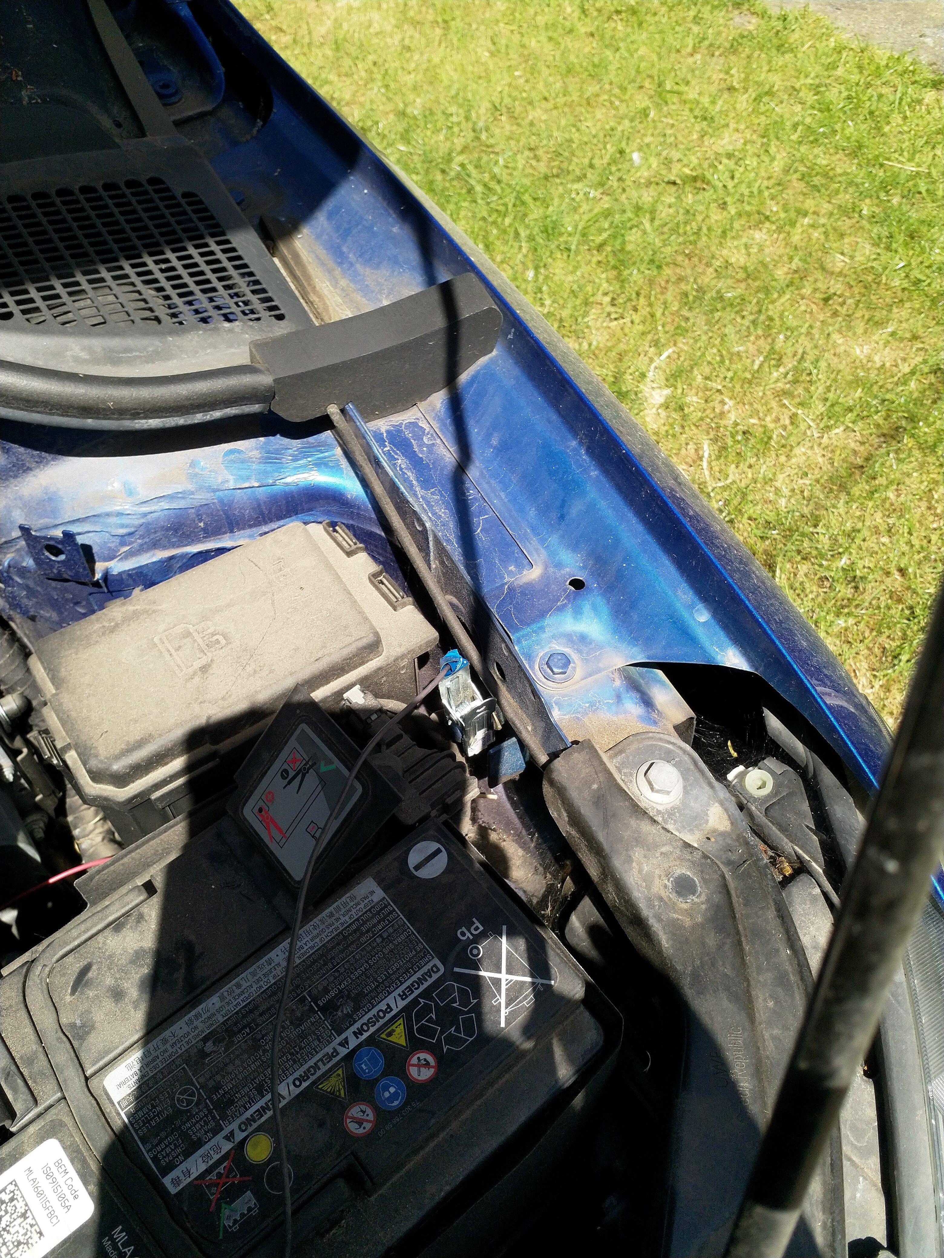

Bit late to this one after my car has gone flat for a second time. 😃 When charging the battery, am I meant to put the negative on the bolt like this? The manual isn't that helpful?
If it is "stop start" then connect to  a body earth point not the negative battery terminal. Trickle/smart charges are okay to charge the battery while it is still connectedbut if your charger gives a heavy charge disconnect the negative battery terminal and then connect charger to battery terminals.
I think it's a smart charger but I've borrowed it (again) so would have to check.
The nut that sticks out that you have the charger clip attached to, is painted.
You need to have the charger clip touch the end of the earth lead that the painted nut clamps on to the inner wing.
This lead goes down and towards the back of the engine bay.
If the charger clip just touches the painted nut it won't charge the battery. 😮
Thanks AG Falco
Thanks, that would explain why it started after I charged it, but wasn't very charged and stop start didn't come on even after twenty minutes of driving around. 😃 After I moved the clip I was just wasting my time! 😮

If you think that you will need to repeat this, just clean the paint off a couple of the flats/faces on the domed nut, ie the ones that are easiest to fit the crock clip jaws over, that is all I have been doing on my wife's 2015 VW Polo, maybe apply some Vaseline over these faces to prevent them from becoming corroded during winter weather.
Most if not all charger will give you adequate warning if the crock clips are not making contact with both a +VE and -VE point.
