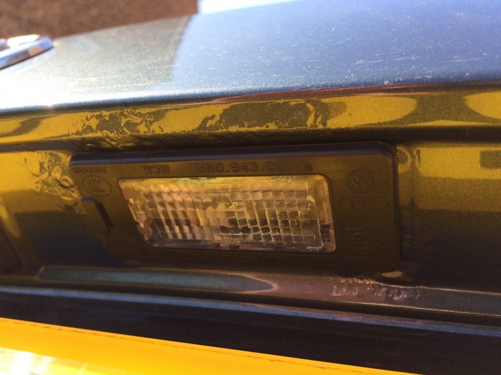

Anyone with a mk2 or 3 fabia check the boot by the lights for the playe and the button for the boot, I have found some on my 2016 fabia, some has been found on a 2015 fabia and some on a 2012, both are work colleagues of mine. Make sure to check it (or any of vw cars on the same platform for that matter) and mk3 owners (not sure about the mk 2) take advantage of the 12 year corrosion warranty, call them and tell them. They are doing mine because I'm a key worker but they will do it after lockdown is finished for non key workers.
mine is 2016 reg, bought it private sale a month ago and yes got the same corrosion!  thanks for pointing this out friend. I am hoping corrosion warranty is transferable ? I will ring Skoda dealer next week and hopefully get it booked in for after the lockdown then.

I'd be interested to know how water is getting there in the first place to cause this much rust.
It is the common location for the corrosion with the same reg plate lights on various Skoda models for over a decade.

I’m  thinking could it has something to do with the rear washer wipe if that was leaking internally ? I’ve not had tail gate door trim off to investigate, think I’ll leave that and just report it to dealership?
local one is Rainworth Skoda
When you move the inner trim of a rear hatch or a boot you might well see condensation.
This is the source of the H20 that is the cause of rust at the hole where the plastic light fitting is pressed through.

I changed my numberplate lights to LED in 2018 when I bought the car and there was a small amount of rust that is hidden with the lights. Shocking to see it's a common issue on such a modern car. I stuck some copper grease in it so might take them off again and re-grease.

I successfully claimed against Skoda back in 2018 for my MKII Fabia. The car is long gone now, but my advice is to persevere after lockdown. The main dealer body shop said at the time it was because they had used foam gaskets instead of rubber for the number plate lights which retained moisture. That doesn't explain the rust at the seam though? In the end they replaced the entire tailgate.
The car used to get filthy at the back during the winter, so even although I used to look after it, and washed it, it's an area that's particulately prone to rust.

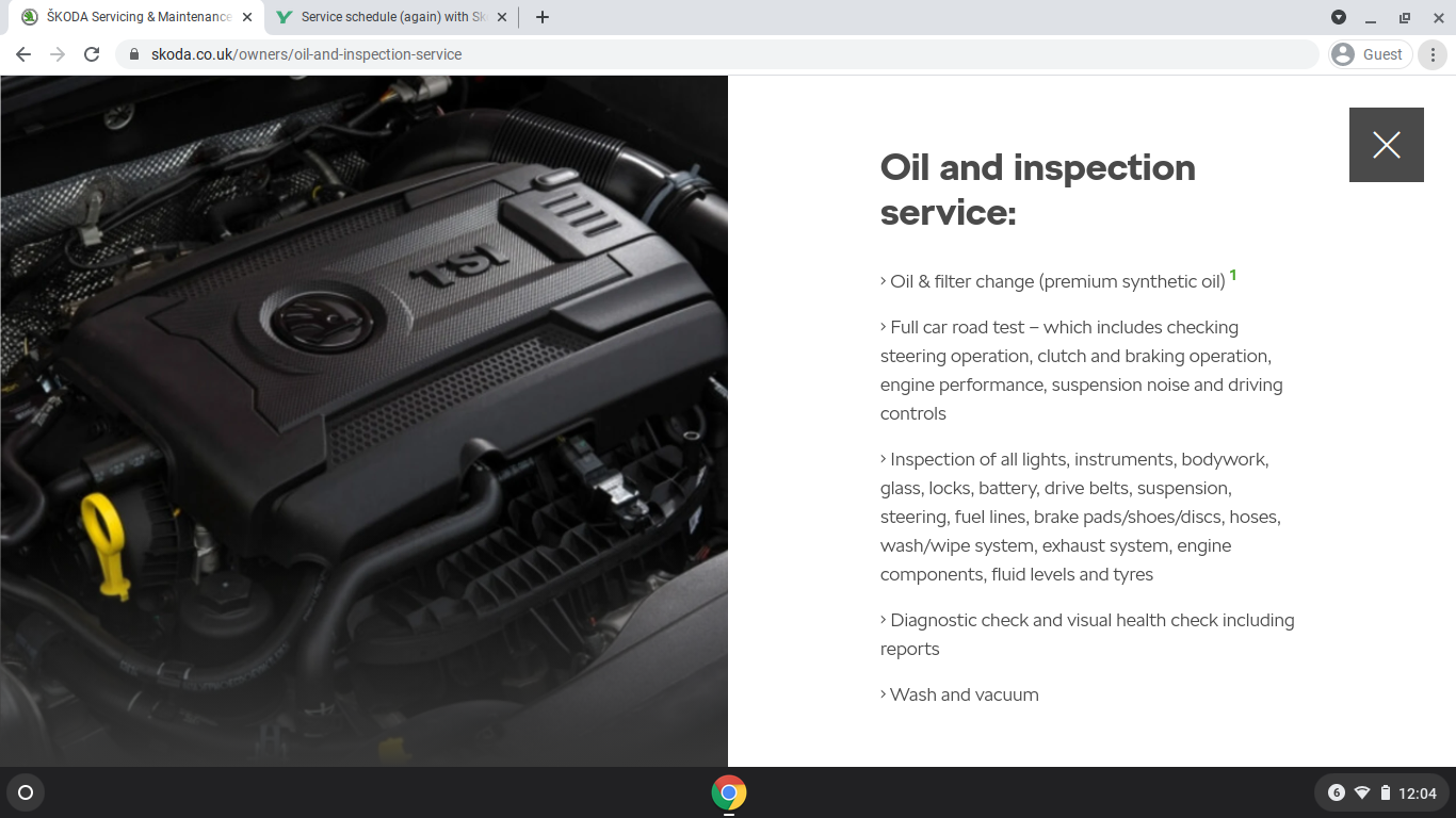

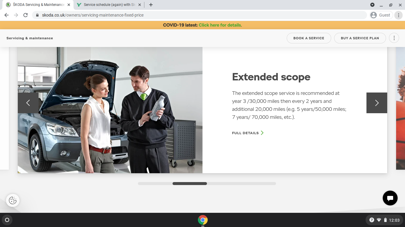

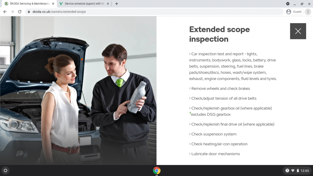

They know the Car Warranty, Paint & Corrosion Warranty does not have in the T&C's anything about a Body Inspection but their Websites for Minor & Major Services & them the Interim & Major Services say 'Body & Glass Inspection' as part of the 'Service Actions',  that Customers are Paying for.

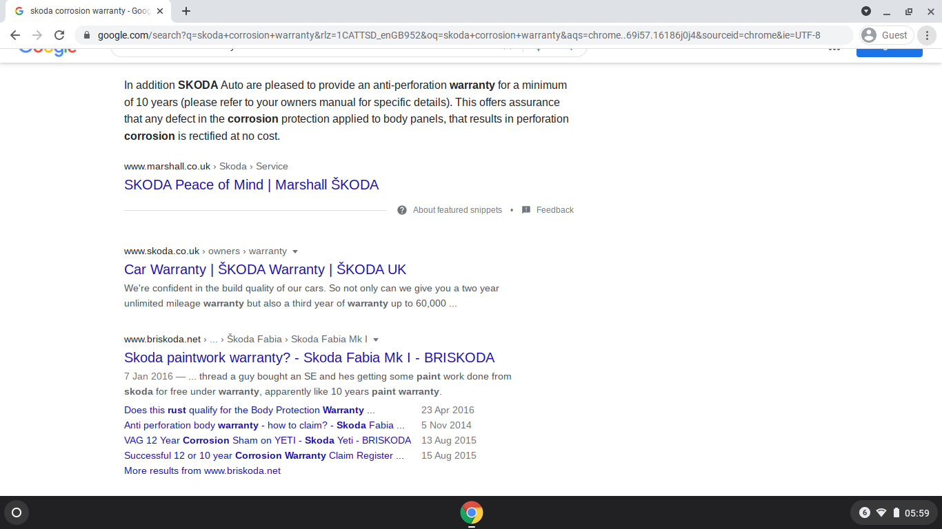

Skoda UK will try to hide behind the 'Perforation Warranty'.  Well before 10 years the rust people show at half that might well lead to a Perforation'.

I think it depends on the year and your luck, I've gone ahead and replaced my tailgate as Skoda wasn't budging and ombudsman is a 6 month turnaround.
Newer tailgate has LEDs which have a much tighter seal and an extra little rubber gasket, cost me £190 and a full day of disassembling and reassembling the rear of the car and coding in the new lights.
Also lost my Monte Carlo spoiler as they are non reusable (the adhesive is almost impossible to remove and I cracked the spoiler when trying)
Check the inside of your door, the trim comes off with one screw and a pry tool - you can then see the inside of the lights, there should be no dirt or water build-up inside the door
