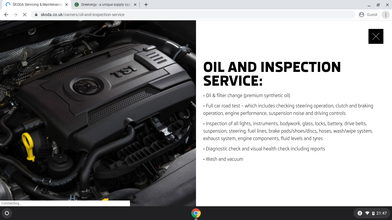

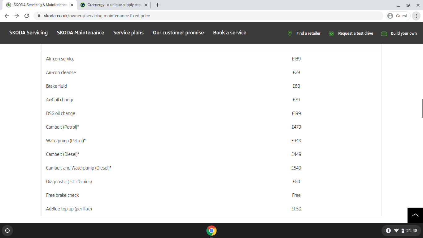

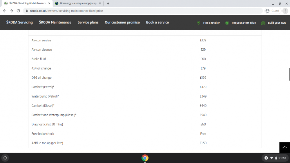

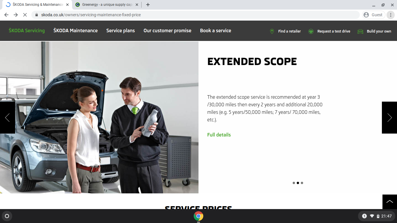

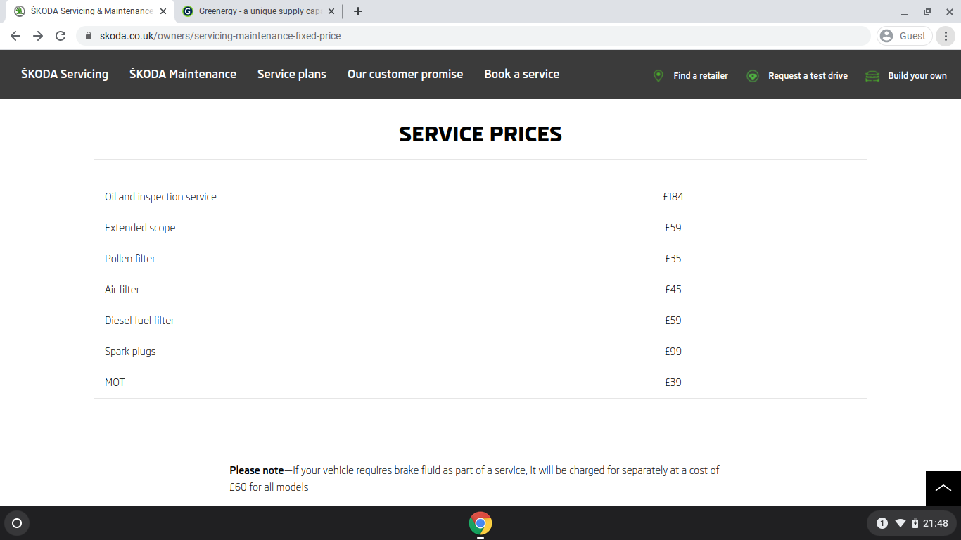

Thanks for the comment - Its got just under 110k. Yes the car is going in for full service - I mostly wanted an idea as to how much it might cost as to prevent the garage taking the mick.
The Haldex is a good shout but , and I might be wrong here, it sits centrally between the rear wheels but the sound is distinctly coming from the rear left and I guess the same point stands for the rear differential also although I guess it is still good to get checked out regardless.
@JakeByrd
The bearing needs checking, but you could lift the rear and do that.
I was not saying your issue at the rear is the Haldex, but the Haldex Oil change used to be said to be at 4 years, and then 3 and 30,000 miles and some need doing sooner depending on if actually used in mud etc.
Do you know if the Haldex is actually functioning?
3 minutes ago, Roottootemblowinootsoot said:
Okay thanks will definitely raise that at the garage.
Ah I see, honestly I don't know the car only has partial service history but I will have a look - I am not sure if this is something that would be covered by a full service?
Certainly not covered under a Skoda Main Dealer Service.
The Haldex and the Diff oil changes would be 'Extra Charges', as is Brake Fluid change and anything more than an Oil & Filter change and look see and report.
There is said to be some topping up done.....
Best use a trusted VW Independent.
