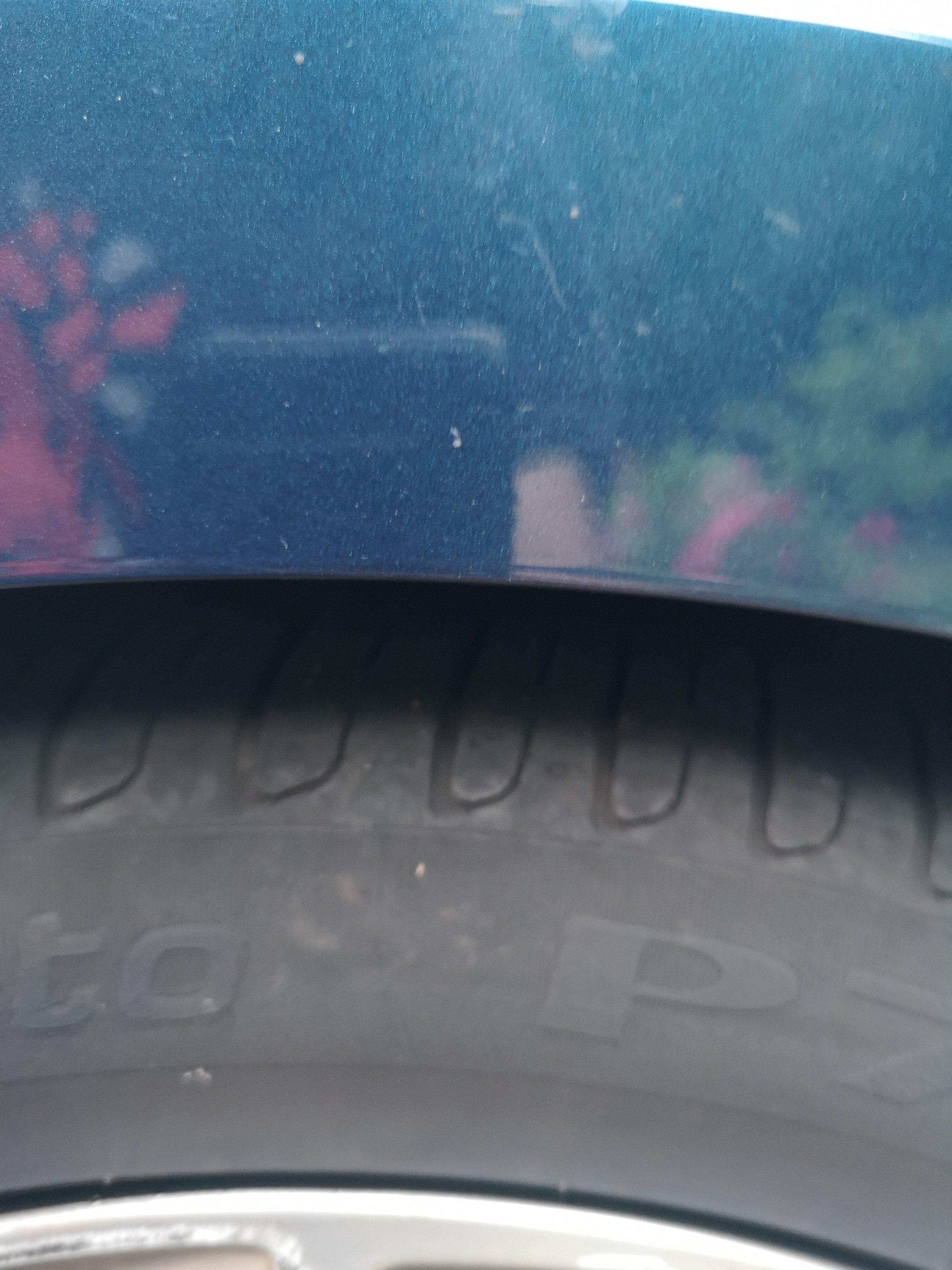

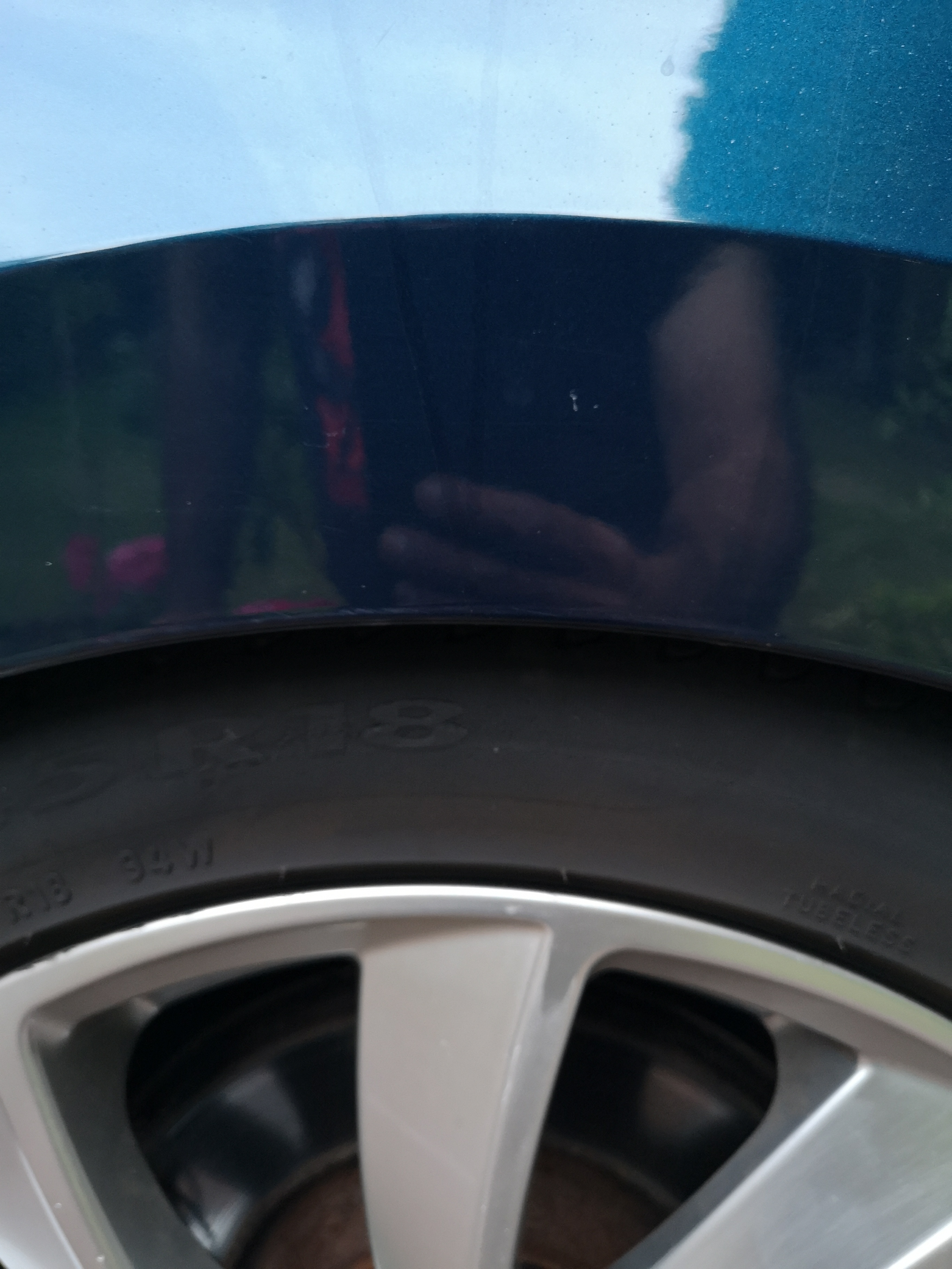

So I have about 20mm or slightly less in the front arch
Maximum about 5mm in the rear, the top of the tyre is literally in the wheel arch!

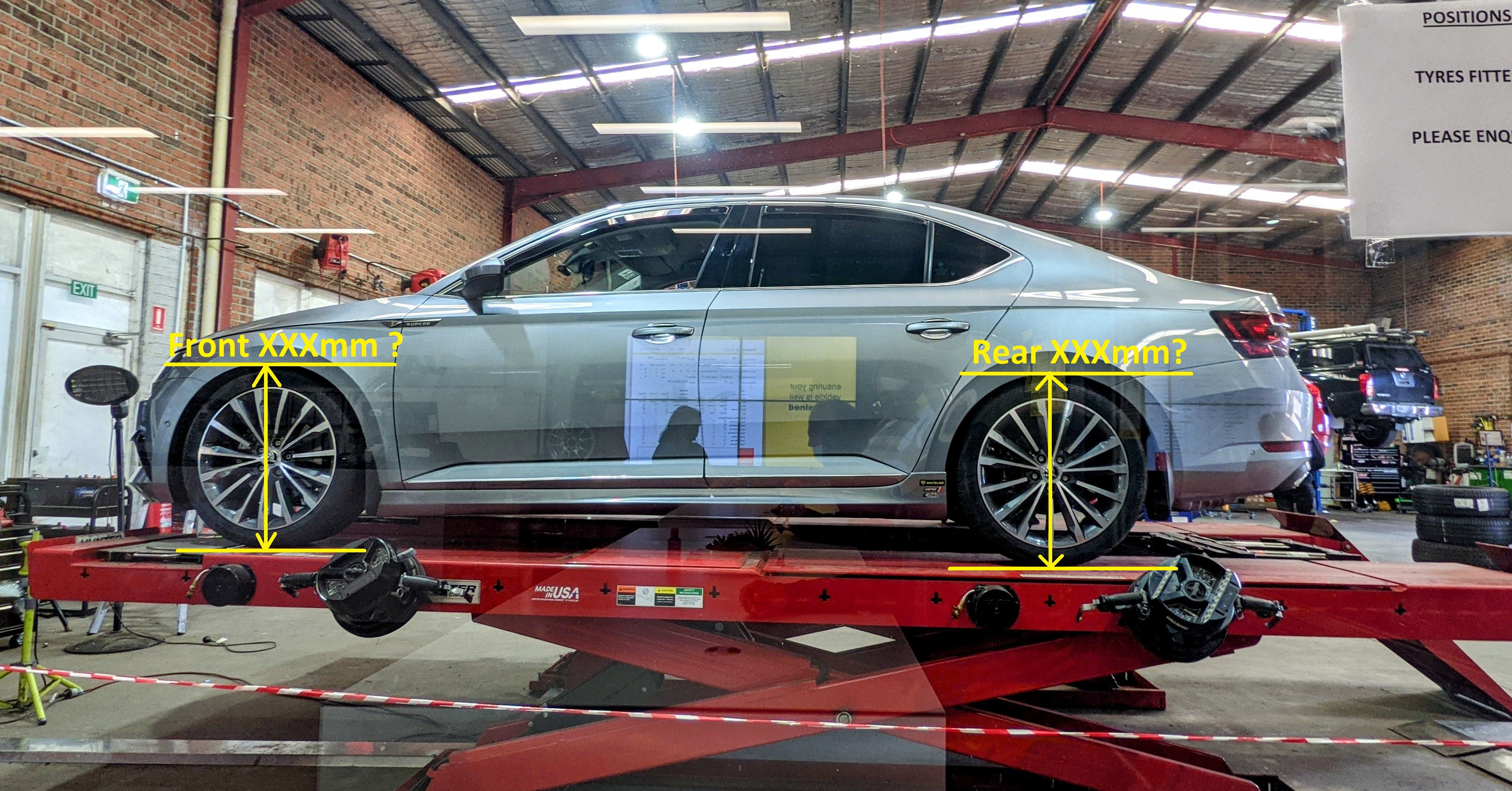

@Awesam - can u measure from the ground to the top of the wheel arch?
as per the yellow markings in the pic below.
So front is 65.7cm
Rear is 64.5cm
On 23/07/2021 at 09:01, pompom said:
is the rear in 45mm-75mm adjustable zone according to b16 installation manual?
Yes, there still plenty of adjustment if I need to adjust up or down!
