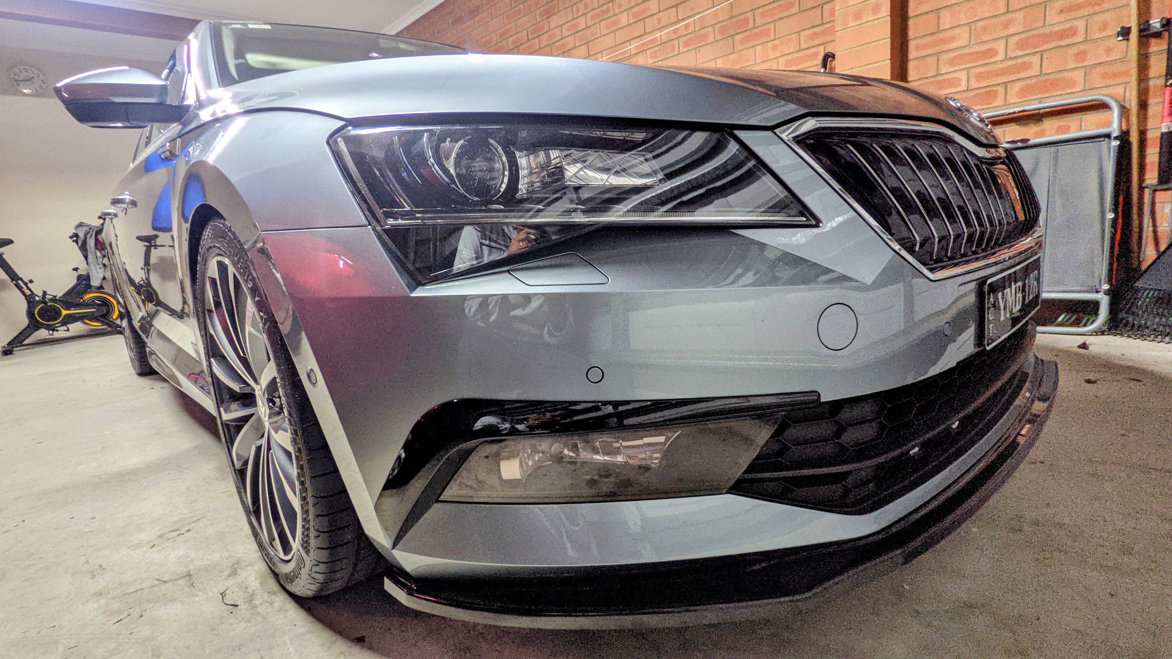

At the time of those photos I just had the Eibach springs on and the wheels were Ispiri FFP2 19x8.5 ET37, poking out a further 13.4mm compared to the stock ones.
However the tracks are so narrow  that even those wheels looked slightly hidden inside so I later added 10mm hubcentric Eibach spacers which brought it closer to a flush look (still 3-4mm from fully flush and definitely no rubbing whatsoever) which finally made it perfect for my like and discreetly more aggressive.
Here's a photo of the wider alloys + 10mm spacers on, which together equalled to 23.4mm further poking out compared to stock:
PS. Corrected the original poking out value
from 18mm to 13.4mm.
PS.2 Stock 235/40/19 tires
Edited by newbie69
So if you have 23.4 poke which is achieved with a spacer you must have an amount of extra space on the inside of the wheel.
Do you think you could get a 9" 255 tyre in there?

To be precise, the 23.4mm  is achieved by both the aftermarket alloys being wider & with different offset (the distance between the mating plane of the alloy to its outer edge ) pushing the width of the wheel out by 13.4mm, plus the spacers which push it further out by an amount equal to their thickness (10mm).
So, if the stock tires are pushed out by 23.4mm that means an equal amount of tire could fit yes so 235 > 255 should in theory fit.
I can't comment about the 9" alone because you don't specify the offset, and these go together.
If you mean  9J ET37 that would mean an increase of 6.4mm both ways comparing to my setup above (equally outside and closer to the strut) so that's not going to be the same.
With 9J you would need to drop to ET30 to ensure the 255 tire would not be any closer to the strut than stock (it would be even 1.3mm further away) and then it would poke out by 26.7mm which is 3.3mm more than I had in mine and I imagine it would be really at the limit.
