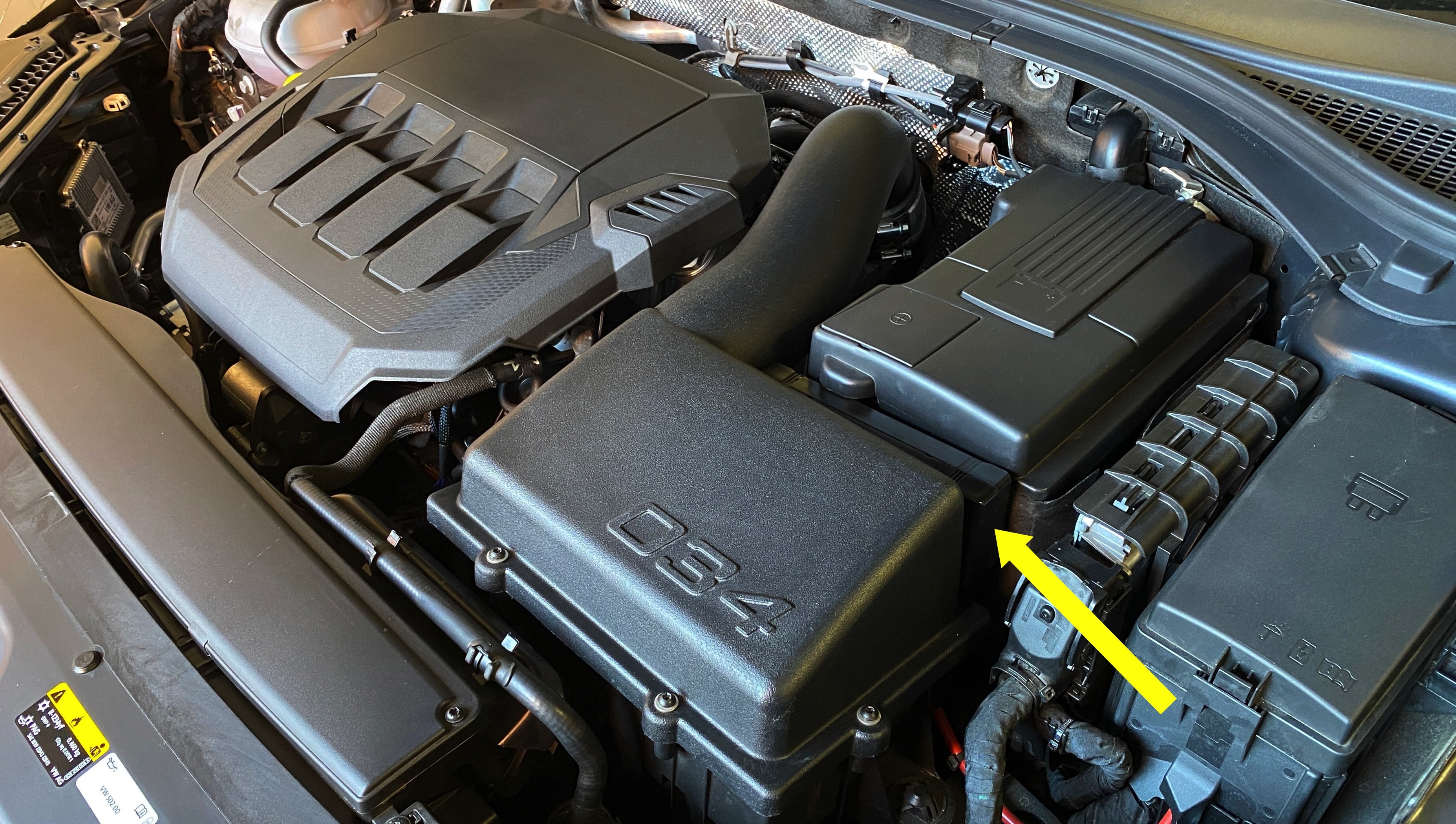

The JB1 (or JB4) also sits neatly in the engine bay, between the air intake and battery.
