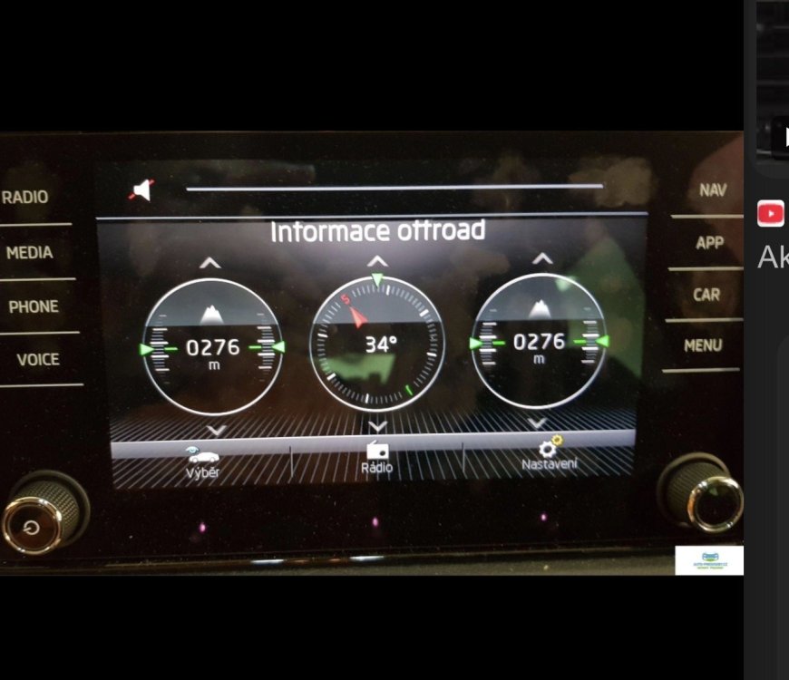

Which year is Your Karoq? May I code the off-road menu on my 22 FL?

Before making any changes, note down the original values.
Incorrect coding can adversely affect the function of the control unit; you are responsible for this. If the off-road menu does not appear on the radio after coding, restart the radio by holding down the power button until the radio restarts. It works for me:
5F - Electrical info »
[ Security access - 16 ] »
S12345 »
[ Adaptations - 10 ] »
ENG122229-ENG117732-Car_Function_List_BAP_Gen2-compass_0x15 » New value "Activated"
ENG122227-ENG117566-Car_Function_Adaptations_Gen2-menu_display_compass » New value "Activated"
ENG122227-ENG117568-Car_Function_Adaptations_Gen2-menu_display_compass_over_threshold_high » New value "Activated"

Do You suggest to write down original coding so I can return to it in case the new doesn’t work/restore it? You coded this menu via VCDS? Which voices can You visualize? Can You post an image of the Off-road Menu?
S12345 »
Can You visualize the OFF ROAD menu having the PERFORMANCE/SPORT menu activated? I mean can You visualize both of the options OR have You to choose one of them?
S12345 »
Hi! I tried but nothing; any other suggestions?
Mib3?
Yes
Dont Work anymore What i know
Can check with my 3 devices
