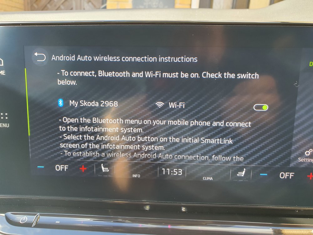

    and that both Bluetooth and WiFi are enabled on the phone.

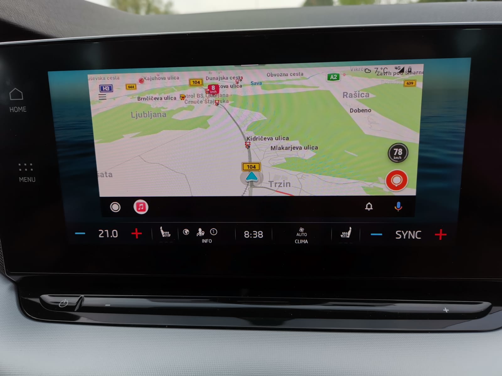

while my issue is not related to stricktly wireless thing i wonder is it possible to see the full screen when using android auto? There is always a frame around the android auto screen on display so i just cant utilize the whole screen
any suggestions?

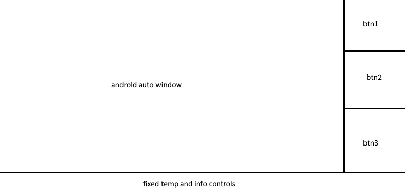

I've worked around that by adding android auto to my second window (when you swipe the main screen) it fits perfectly with x3 1x1 buttons beside it.
Here's what i mean:
I use the same solution, but if i want to use only nav on the screen there is a frame around it... Is it the same with apple car play?

my android auto is full screen, using waze + spotify

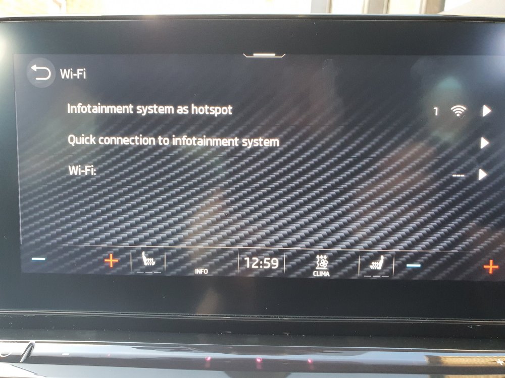

Hi @vfr I read the same for my car, but Android auto does work wirelessly! Just need to switch on the cars WiFi hotspot and boom. I think it would only be useful for short journeys however, as it'll probably burn through phone battery.
So you are buying another data package for the hotspot in car? I looked at that months ago and it was quite expensive.
I'm not buying another data package @Nissen82, just using the one that came with the car (as it's only a couple of weeks old). I'm not 100% sure on this, but if you do turn your cars WiFi hotspot on I don't think it uses much data, as all its doing is making a connection with your phone (and it's your phone that's then accessing Spotify/Google maps etc).

My AA looks like this also and it's really annoying. I have tried 4 different android phones all running android 11 and updated AA, opened Developer settings to set resolution to make widescreen and nothing has worked.
My guess is that this is a Skoda issue again with the older headunits, got my car last week but has a B hardware unit.
