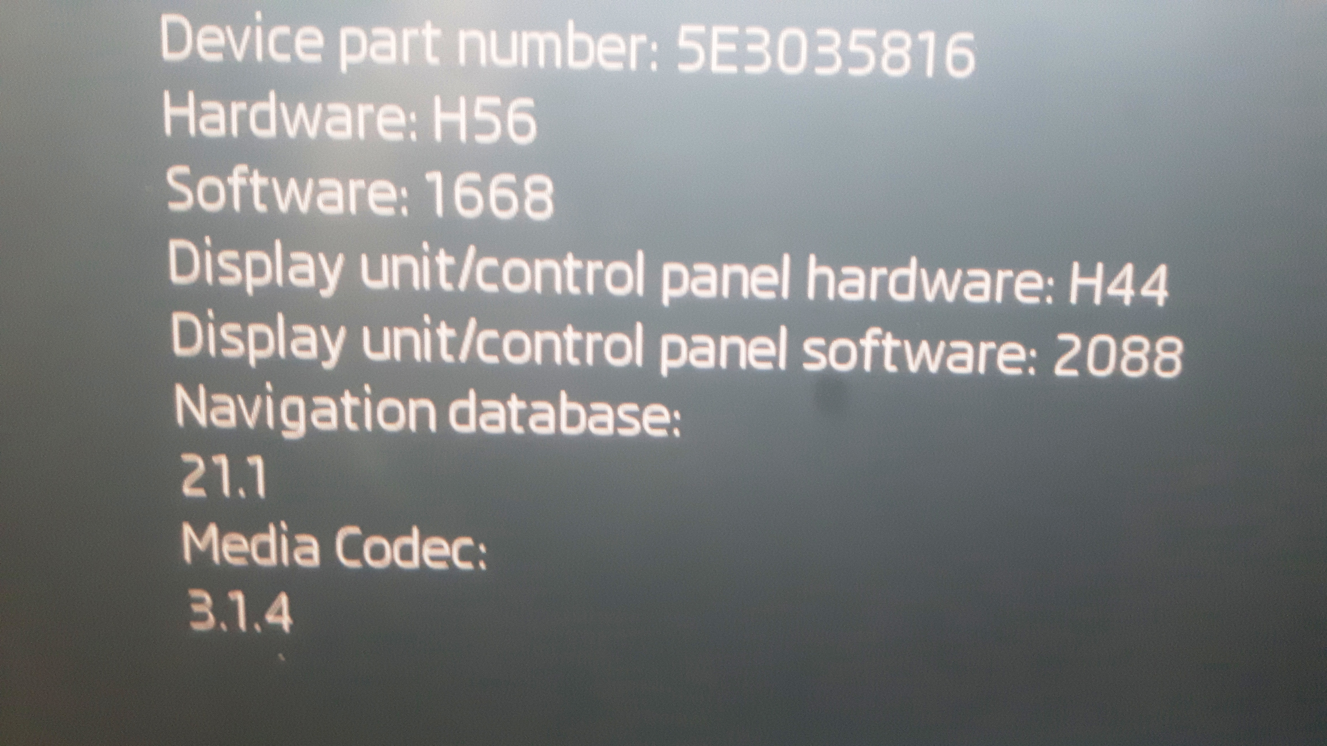

Early days with my car (1.5TSI SEL 1st Ed), today is day 7; it was registered in September 2020.
I too suffer with the inability to change the speedo to Km/h and the SatNav displays Km not miles - and I can’t change either in the settings. Additionally, the settings option to change the headlights for continental driving (Travel Mode) does not exist.
Looking at the system information I have...
Part Number 5E3035816
H/W H56
S/W 1668
... which is common with those others on hear with the same km/h-mph issue. Do you also have the Travel Mode headlights issue?

Out of interest what is your Device Part No?  Mine and the ones we have correlated, which have the issue is PN:- 5E3035816 which is now superseded by 3 later versions 5E3035816B, C & D.  All the later versions do not appear to suffer any of the issues we have been discussing however received this from our supplying dealership, who are most helpful and supportive, in response to them raising it with Skoda Tech' quote:
"Unfortunately I can't confirm that a later unit would be supplied from parts with software that would resolve the complaint. As the problem is under investigation I would suggest postponing any repair until more information is received".

Thanks.  Very interesting, totally different information to mine (see attached pic) This gets more and more interesting as within an exceptionally short time frame Skoda appear to have fitted several differing Head Units so no doubt whatsoever they are well aware of the issues.
