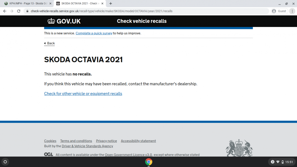

A Recall is forced on a manufacturer by the relevant country authorities for a serious road safety issue; but Skoda UK, dealers and owners often incorrectly call a Service Campaign a 'Recall'. What is happening at the moment are 'only' Service Campaigns not Recalls.
Just,
A Manufacturers 'Recall Action / Service Campaign' only if they are not 'Recalling the cars by contacting the Registered Keepers.
http://skoda-auto.com/services/recall-actions
If Skoda do an actual 'Recall' on Safety Critical stuff then it should be on the DVLA Recall Website.
Skoda certainly do not want that.  But maybe time that they actually have to have that.
If you buy a vehicle which really has safety issues, then VOSA is who you should contact just incase Skoda / VW disagree and think they can pan VOSA off with saying they are doing 'Voluntary Recalls' , yet owners have to come to them and complain before they even tell them of updates.
https://www.gov.uk/check-vehicle-recall

36 minutes ago, e-Roottoot said:
Just,
Would the kph/mph issue count as safety? Probably not I would guess
Very much not a safety critical fault if the car has a working speedo in MPH when in the UK and the speed done is controlled by the driver.
For 'Goods not fit for purpose issues',  first contact the seller, and if that goes no place, Contact CAB or a Solicitor.
If the car is owned by others because on finance / leased (rented), then contact them and have them deal with the getting onto the supplier.
Especially if that finance house is owned by the VW Group.
Edited by e-Roottoot
