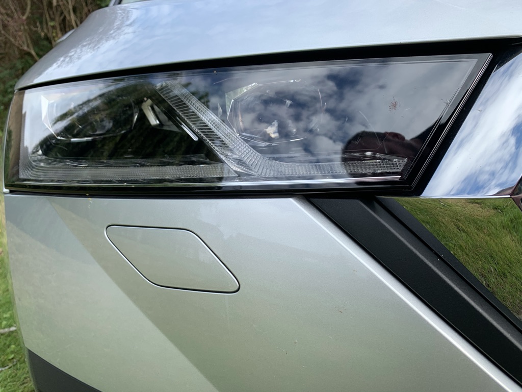

I believe I have full matrix LED headlights (according to the salesman) but haven't been out at night to test them yet.
I can confirm that I have 'Travel Mode' in the headlight settings & that it switches between left & right hand drive according to the display.
When it gets dark I will check if it alters the beam pattern.
No worries.
Mine has the standard LED lights and no Travel Mode - seems that might be a benefit of Matrix lights.
35 minutes ago, golfnut said:
Sorry for the typo.....S/W is 1668.
The matrix lights look like the photo below. Make sure you enable the dynamic asist and cornering lights before trying them out and see how they do at not blinding oncoming drivers. It sounds like you've got pretty much exactly the same car as I have but I've been having major problems with mine as seen in the video below:
