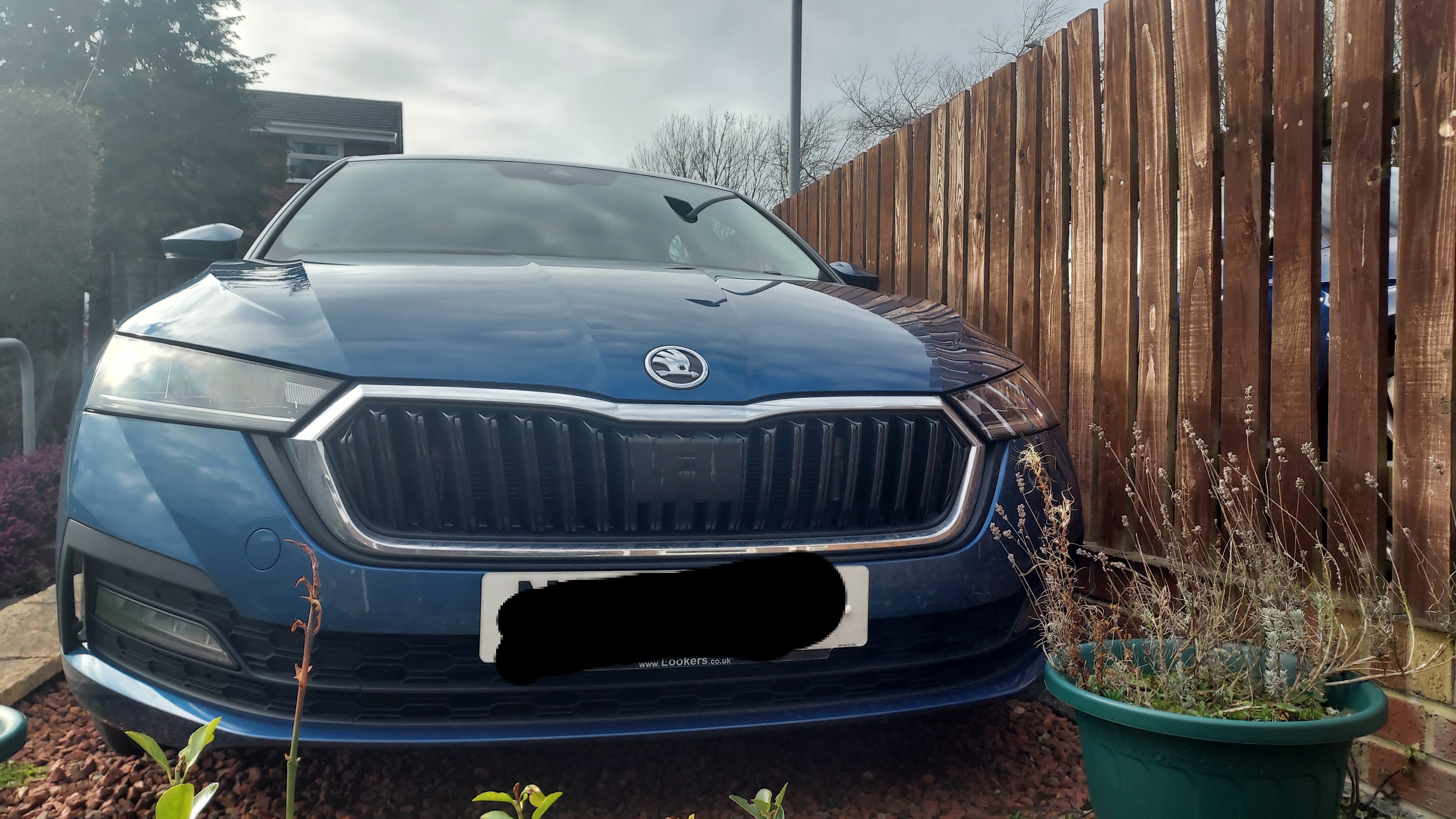

I have no idea what to think if this doesn't fit into being an MKIV, given my impression is that this is the all new vehicle. Like I say, sold as an SE First Edition, only had it since December.
Photo as requested.

Yep, that's definitely an Octavia IV
