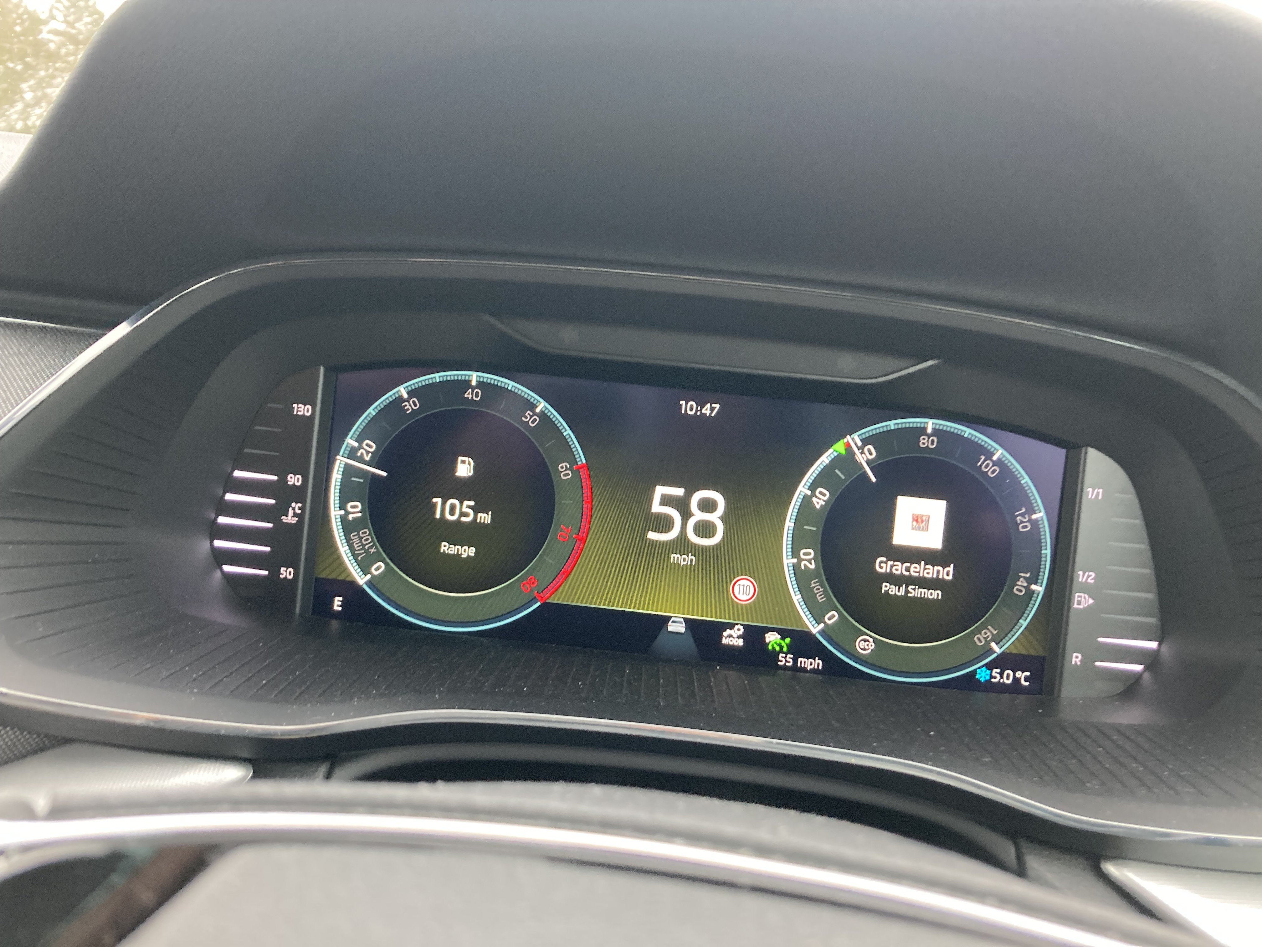

My car has only one problem - the random MPH/KPH bug.  This would be a minor annoyance if were not for its interaction with the ACC.  I've had recalls on cars in the past which were far less likely to be dangerous than a car which slows down because it thinks the 70mph limit is 70kph to the the confusion of the car behind.
I've been in touch with SUK and they have tried to be helpful but say that it needs to be taken into a dealer to get evidence about what's happening.  But I think the dealers are left holding someone else's baby.  What can the dealer actually do  to gather evidence for SUK?  They could drive my car around for days and weeks.  But what actual data at the system level can they gather at the instant when the system switches from an MPH value to an equivalent KPH value.  I've taken photos already and explained it only changes on stretches of road where there are no speed limit signs.
On balance, given that this is the only problem the car exhibits, I think it's best left alone - from what I've read there's a better than evens chance the attempted fix could introduce new problems.  I will speak to my Skoda dealer however.IMG_6331.thumb.jpeg.7a6385c58ec2a1a4d67f4c7698f48f67.jpeg

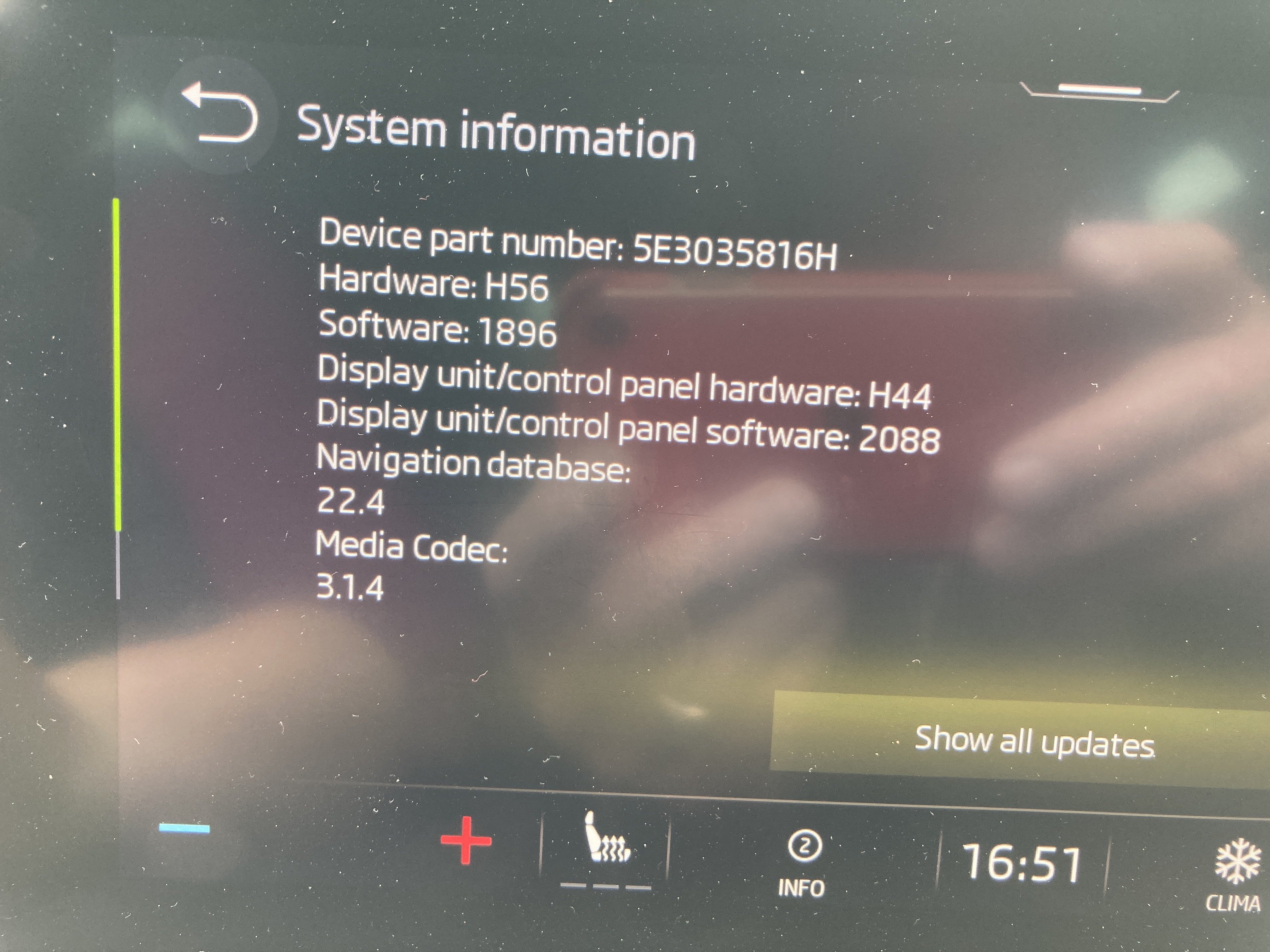

On 28/05/2022 at 07:20, Suffolk said:
I am pleased to report that my local friendly Skoda dealer have fixed both the emergency call button fault and updated the software to the latest revision -1896.  Also the Nav database is now 22.4.
Did a 70 mile journey yesterday and the ACC now works as it should.  The car is transformed.
Mine is now also 1896 - navigation is 21.7 (so perhaps more to come). I can also say that everything is now working as it should. 👍
