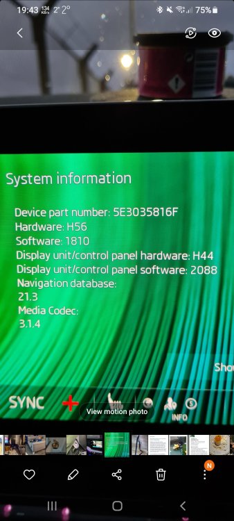

So this is a screenshot of what my hardware and software etc says now. Two new side effects since getting my car back. One good and one bad.
The bad - the built in sat Nav now doesn't work at all. I'm waiting on dealer getting back to me and told them that I thought it was poor they didn't bother to check everything before returning it.
The good - Android auto now works wirelessly. It didn't before.

Thanks Neonplanet44, You have the much sought after F suffix on top of version 1810. Mine is no suffix and around 1622. Mine is an Octavia and yours a Superb. Both lovely cars but both troubled by unready Head Units.
Thanks for this info. It all helps
Sorry Neonplanet40, we do both have Octavia 4s which makes different sw all the more confusing.

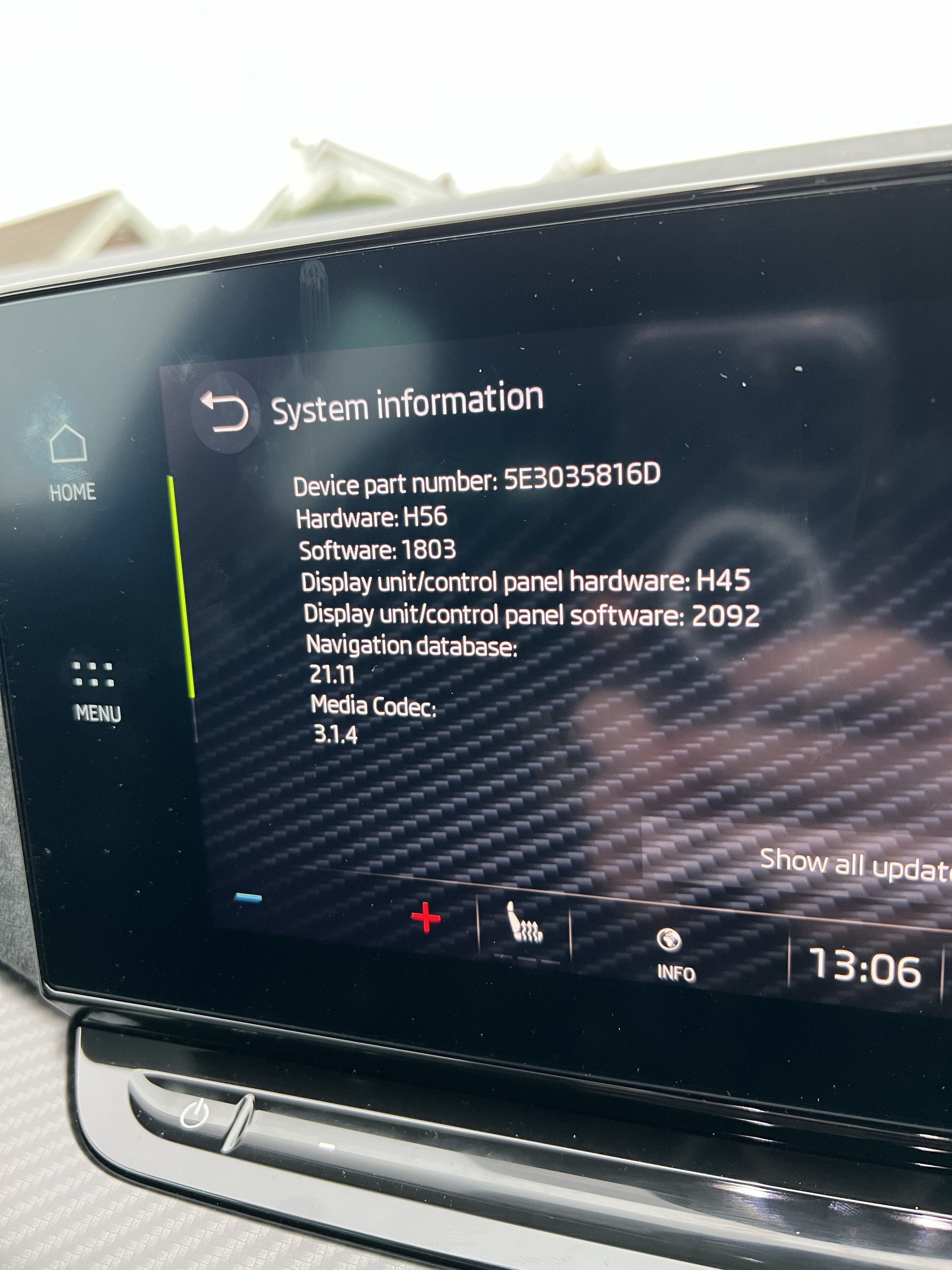

Mines back from the dealer. No difference at all lol. These are the system details. I assume they should have updated to a higher version?
