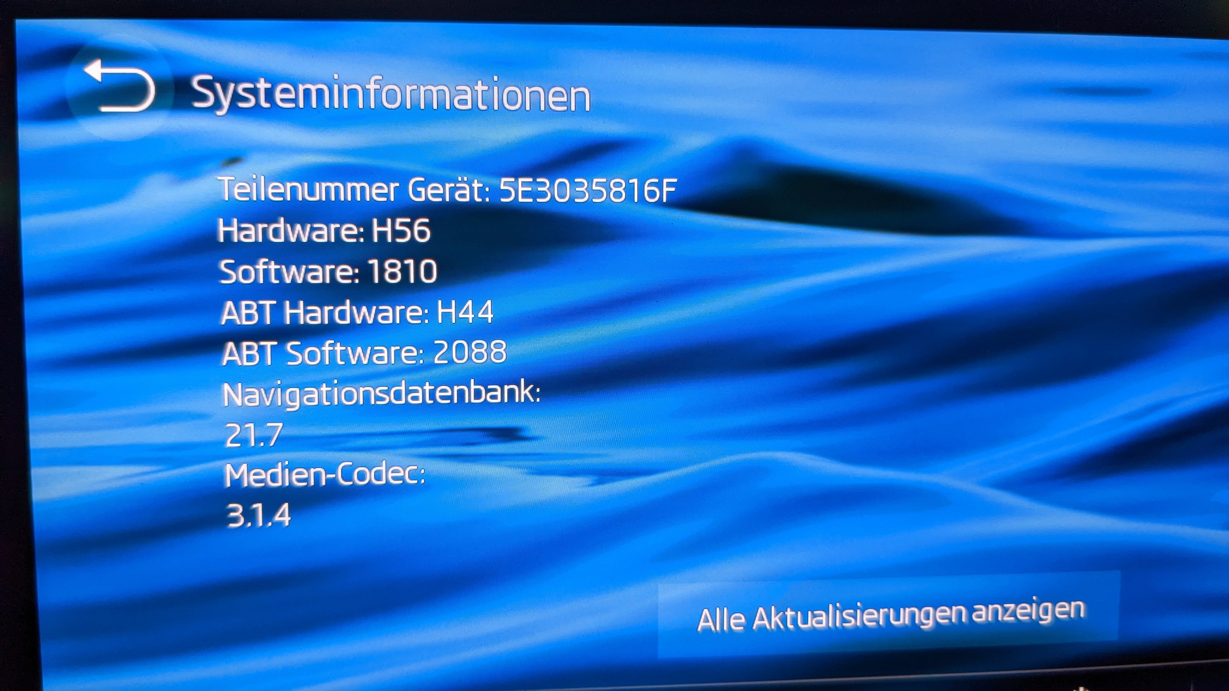

Hello,
I am actually quite happy with my Octavia MJ21. But the car has never had an update of the navigation database. The shop and apps have been updated online several times.
What can I do to update the database without a service partner?
The necessary settings are activated and the licences are active until 2023.
I have already tried an update via USB using various instructions. None of them worked.

After reading in the online ‘shop’ that after Year 1, in the U.K., further map updates continue to be automatic but only with a data plan - I read somewhere on this site that Map updates via USB C are possible for cars bought in EU states. Hope you have success, let us know.
I come from Germany and have not booked a data plan. The corresponding licence states that the online update of the navigation database is included.
The update via USB did not work either. According to Skoda, this is only possible online or via the service partner.

I am currently on Navigation 21.7 and my 1st year of ownership ended in Oct 21. I do not appear to be receiving further online updates. My car has recently gone in for a ‘major’ series of software updates but the Navigation does not appear to have been updated.
So it seems the same position applies in the U.K. as in Germany in that: USB C doesn’t work; you can get your Service Partner to do it - at an extra charge - following first year of ownership…..and that only if a data plan is purchased following year 1 does Navigation continue to receive further automatic online updates.
