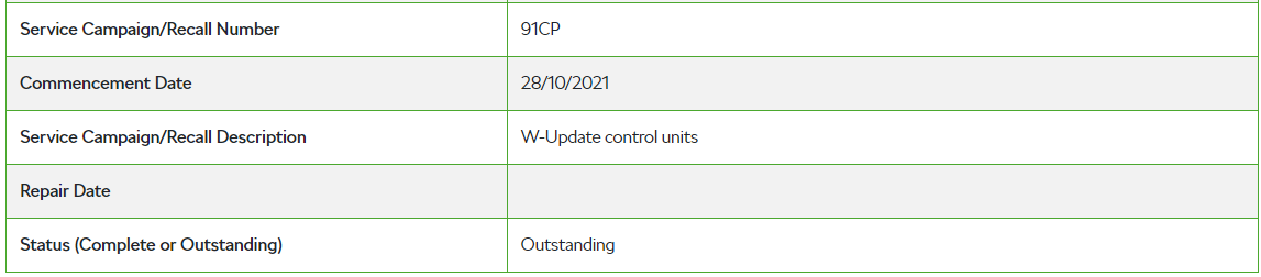

As 91CP does not refer to Software, I wonder if it could be the Virtual cockpit replacement that has been signed off.
If anyone has any details of 91CP, I would be interested to hear from you.

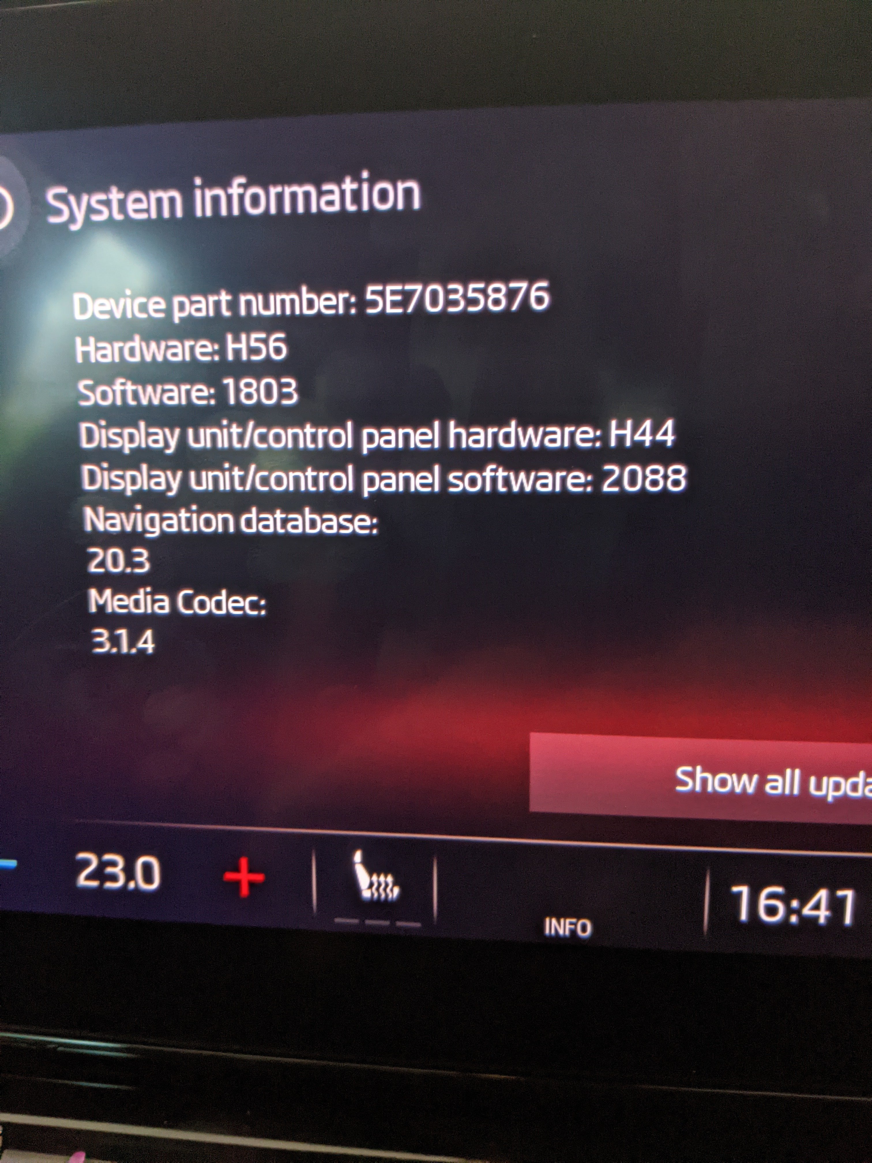

what I will be trying to find out is whether the system info without a suffix letter will remain on their early SW or will get upgraded to the latest one which all revision from B seems to be getting now…
Mine has no suffix but it is on 1803.
Edited by DaveFromSydney
Interesting - thats a different Device part number to mine. I have 5E3035816
Hardware: H56
Software: 1668
The rest the same apart from the Navigation Database.
Hardware: H56
Software: 1668
Well they did say they replaced "The infotainment control unit".
Spoke to Kate this morning and she confirms the Virtual cockpit is being replaced sometime next week so looks like the solution tested by @snealis the one going ahead.

Interesting. 91CP was released on Oct-28th so I wonder if it includes anything in addition to the digital instrument panel..
May I ask what is your current SW version? Are you like @snealwith 5E3035816 / Hardware: H56 / Software: 1668?

My system information is :-
p/n 5E3035816
H/W H56
S/W 1668
Display unit h/w H44
Display unit s/w 2088
