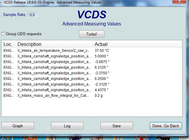

Oh and how can I tell if there is chain rattle that is abnormal? I can clearly hear the tappets and I can hear the chain if I listen very closely. There is no obvious chain rattle when cold starting as far as I can hear. I did notice that in VCDS timing chain stretch has increased from 3.4 degrees to 3.6 degrees in like a week but was sitting at 3.4 degrees a while.

Also did some logging with VCDS and knock sensor shows higher than usual amounts of vibrations coming from cylinder 3 when idling cold at first.

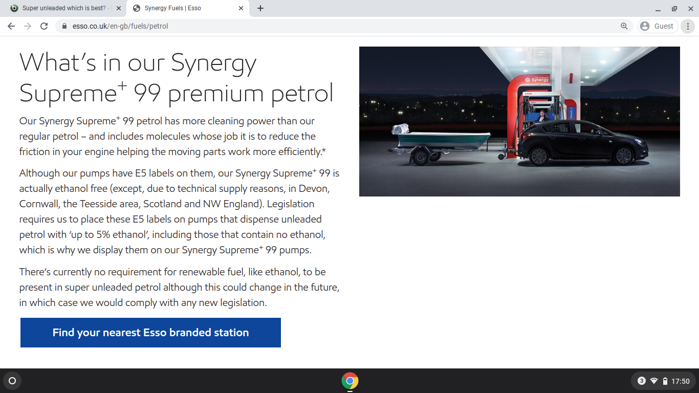

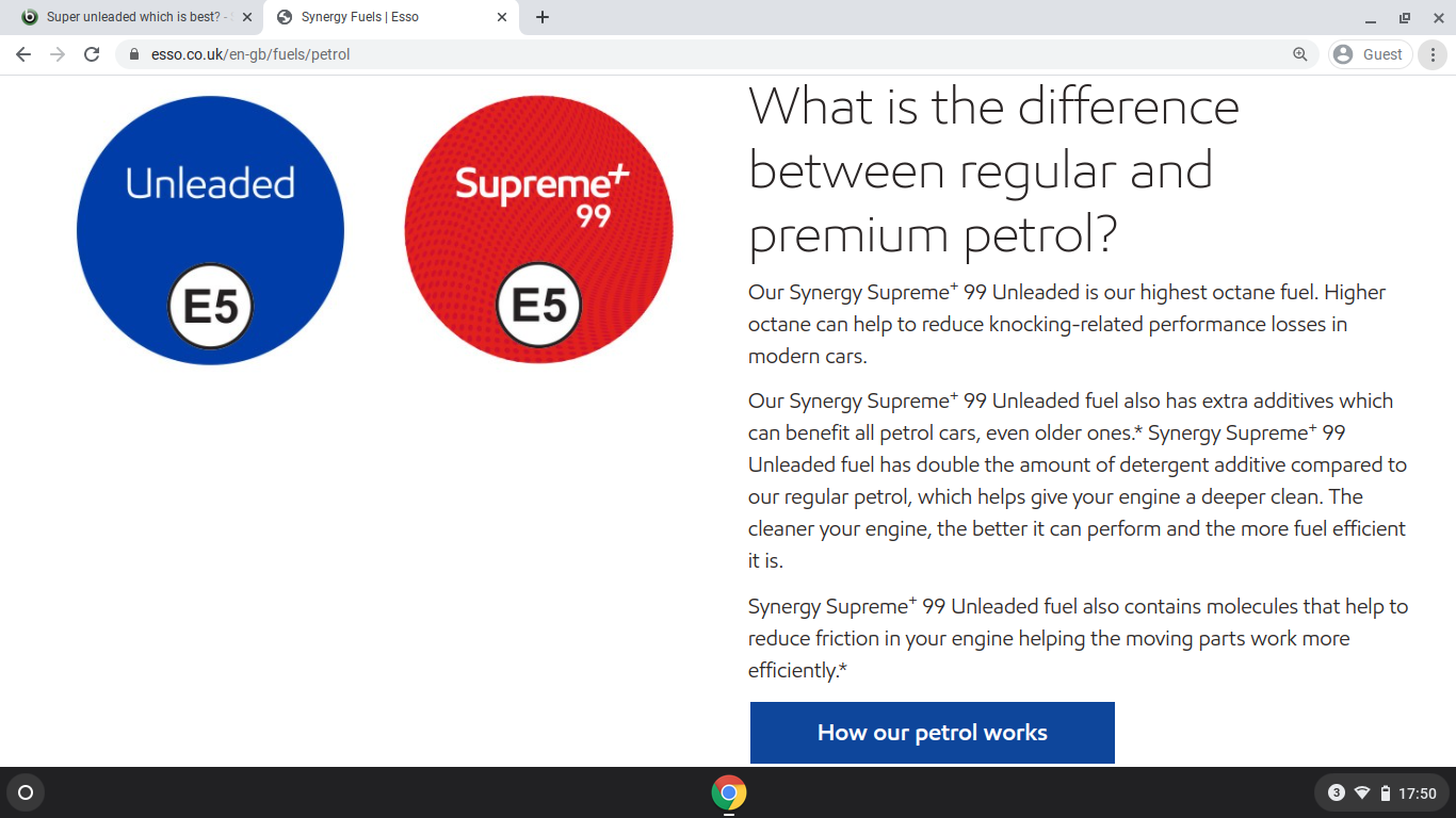

@KoreeniumLikely in your country the 98 ron (Min) Superunleaded in your country has now changed from Summer Formulation to Winter fuel and is still 98 ron min but could be more like 100+ ron.
I don't know about octane ratings and how much it changes between summer and winter formulas but let's assume that winter formula has 100+. Why would it matter this much? Originally this engine is rated to run on 95. Several of my friends use same fuel and they have literally no noticeable difference going from summer to winter etc. Though they do have different cars, engines and much lower milage etc.
Well I've read somewhere the engine is tested with 98 but given a lower rating so it's easier for must consumers worldwide, but our engines, at least mine, says 95 octane  minimum and not 95 required, also read the reason it starts 'badly' with 95 and not with 98, at least in my case, is because of ignition timing and with 98 the fuel burns with the correct timing on the first few strokes so the engine starts well, with 95 if it misfires in the first few strokes the engine bogs down or reduces timing and the rest of the cold start is screwed because of it
@Koreenium Higher octane or winter fuel might have made no difference but you are the one that mentioned fuel and the car behaving differently now and you might use fuel from somewhere else.
It is usefully IMO that you actually have some idea what you are actually buying and using when a car is having issues like starting and running.
PS
In the UK Super Unleaded has not been sold at 98 ron for a good few years.
There is 95 Unleaded,  then Super Unleaded,
but it is 97 ron minimum other than the 99 ron minimum sold by Tesco as Momentum 99.  Esso Synergy Supreme 99 or Shell V-Power Nitro+.
VW Group in the UK might well not be aware as they never changed their website.
Hi,
I also have an engine CBZB 1.2 tsi, and Im nervous about if the chain rattles to much, It only has the strong rattle at sartup for 1-2 seconds, and the it quiets down, but off course Im still able to ar thhe chain rotating.
Mine is from sptember 2010, ad the engine control is a simos 10.10, but i simply cant find the value for chain elongation you are writing about. Eg. your chain was 3.4 degrees out. Is it only in newer versions of engine control this is possibe ?
I have other values, relating to adaptation between crankshaft and camshaft, and therefore they say something (nut i dont know what) about the length of the chain. Anyone can explain whet these degrees means ?
