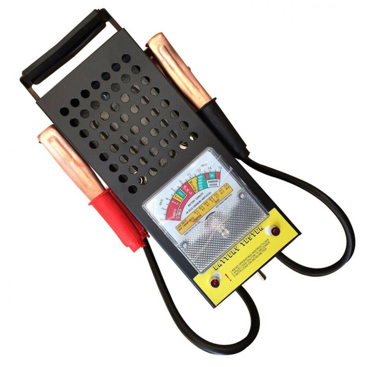

The direct approach to car battery testing (i.e. under real load) that I prefer:
