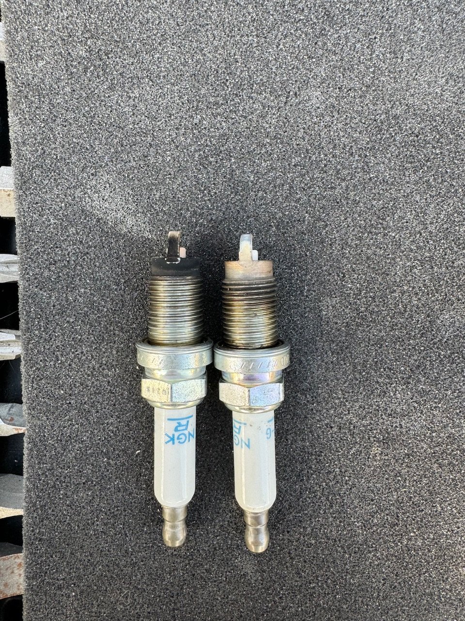

cylinder 1 and 2. something îs really different
It suggests cylinder 2 (the lighter) is running leaner than cylinder 1, not dramatically so.
