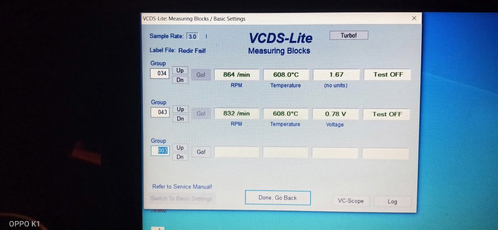

Thankyou so much for your response bro 👍🏻.... If there is any fuel mixing or fuel injection or any other issue on engine due to this atleast we can read it through VCDS... Right? But when i connect VCDS there were no fault code is there on it and no more misfiring or nothing shown in measuring blocks... And actually i re condition the engine last month due to cylinder one valve problem...😓 And at that time i regularly VCDS fault with misfiring and after i change the valve and re-condition the engine its all gone...💪🏼👍🏻... And i saw this red glowing manifold header inside the guard at night time and Let me check it thoroughly once again, about the red glowing issue on night time... And will take photo of that asap... Another thing please let me know, is that fabia 1.2 petrol engine vibrate slightly when idle... Or not???? The same engine of my friend vw polo has vibration 📳 on idle... Is that normal? If you have fabia the same engine kindly help me...🙏🏼 Thanks in advance....
Look (on your car) at the temperatures shown for the cat in the two measuring blocks that I logged, 034 and 043. Compare with my numbers.

Bro.. i checked the measuring blocks with vcds... And the result i attach herewith...
