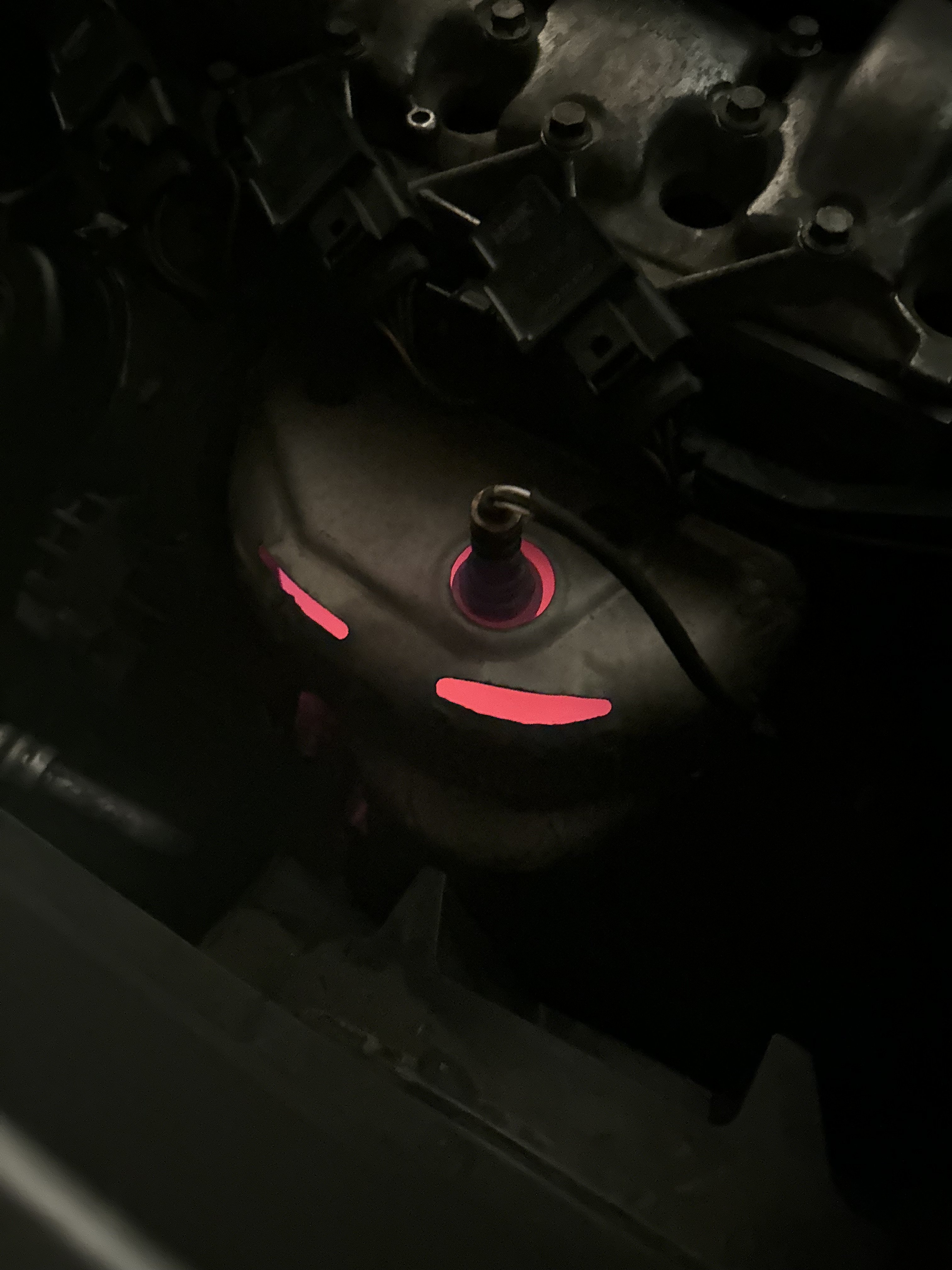

With engine idling, fully warmed up following a twenty minute drive, I looked under the bonnet and removed the engine cover so I could see around the area better.
There was no glowing of any colour, even when I looked from the sides to see under the heatshield.
I took this photo horizontally from just in front of the battery, looking across towards exhaust manifold/cat
20210207_181016.thumb.jpg.dd3f8b4b6cb7f4eef86c3db7958bd260.jpg:
Ambient temperature was a chilly 0.5°C though.
Edited by Wino

Sorry for bringing up this topic but i have the same problem. CHFA engine heat the catalytic converter like hell. Runs on idle at 600C degrees and in roll above 800C degrees at 2000-2500rpm.
The engine works and sound great. Managed to do some work, rebuild cylinder head, new head gasket, new valves, new timing chain, new coils and spark, new Lambda sensors, changed the catalytic converter and still does the same. i really don’t know what to do. car runs on aftermaket landi renzo LPG and petrol. both fuels heat up the catalytic converter. exhaust is not blocked.
I really left up of ideas, don’t know what to do next.
Very lean mixture? I.e. hot combustion.
Stop looking at it!
The cat will be working perfectly.
cat box is empty. no catalytic converter at this time, trying to solve the issue. i don’t think its normal to get up to 900 degrees.
that’s what im thinking about but i don’t know where to start
