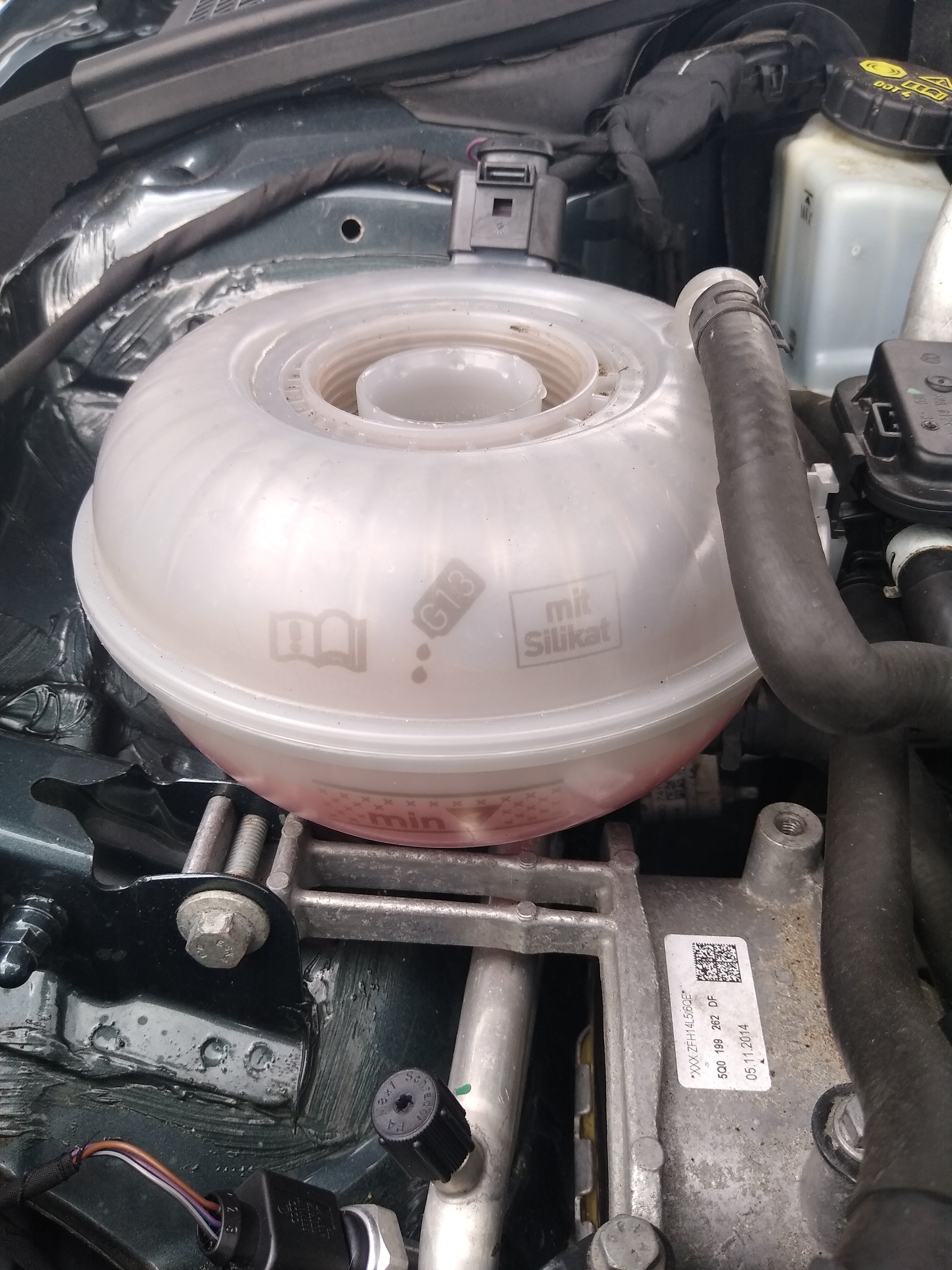

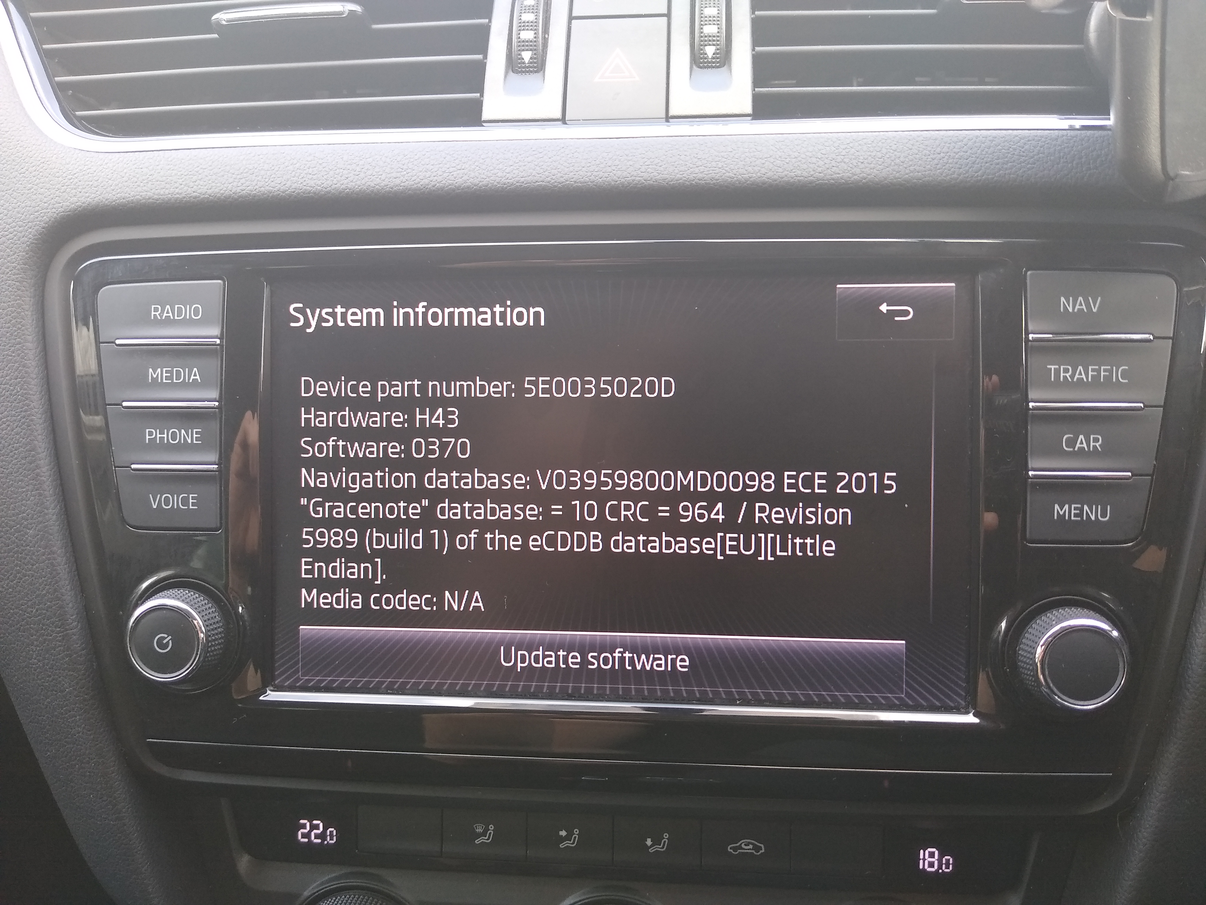

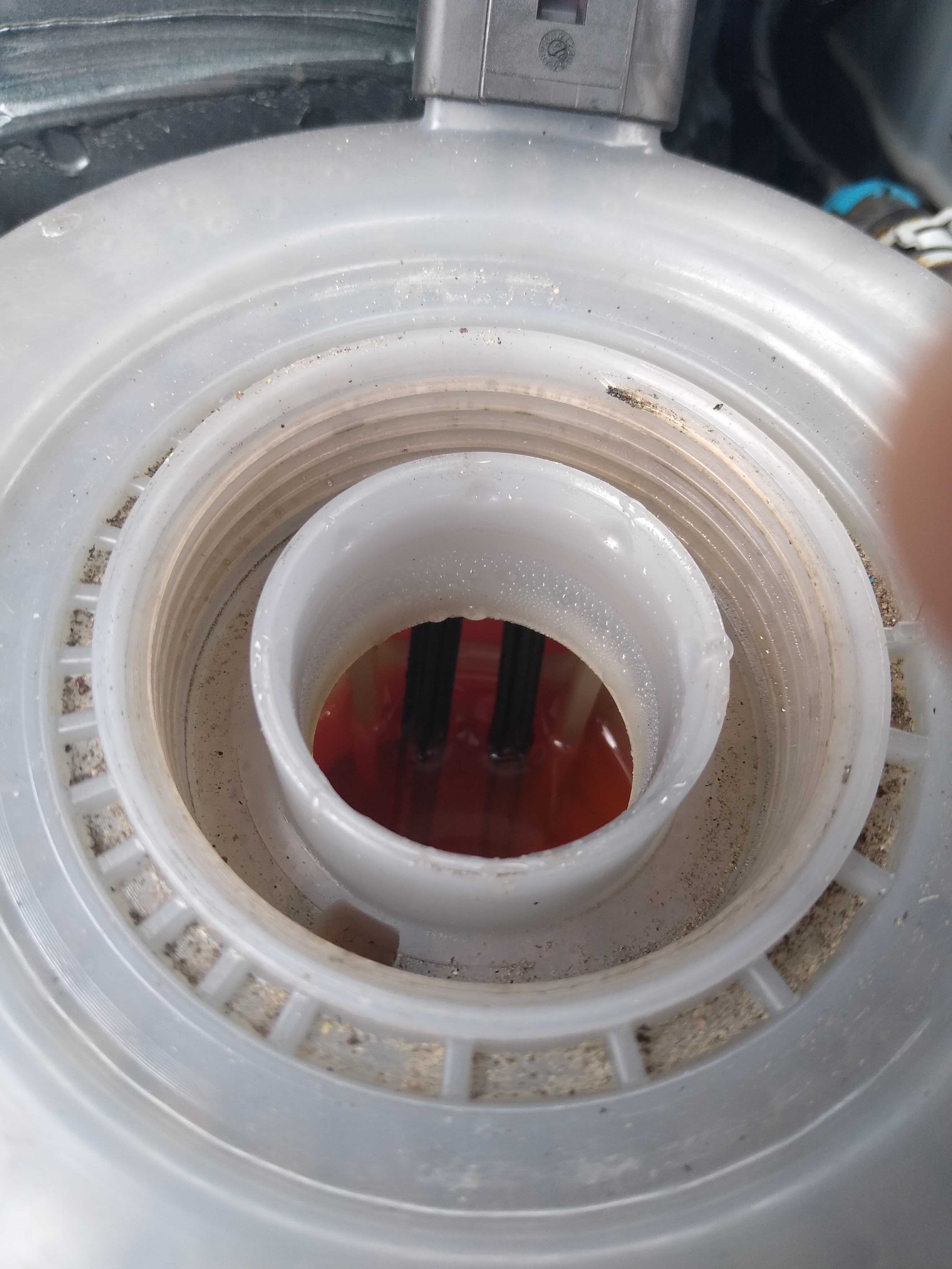

Cheers all, picked it up and it hasnt took long to get used to driving, it feels pretty solid, certainly an upgrade over the old focus. The infotainment appears to be the Columbus unit with the big screen?  The coolant looks good but looks like the dual chamber, no spare wheel (stupid foam and pump and I have the locking wheel nut in the car. Overall pretty happy so far.
Some pics of the bits mentioned.

Welcome @Sload that is a MIB1 Columbus so as mentioned no smartlink but maps are on the unit so no faffing with SDs in the Glovebox for maps. If you do a search on here or go to the Skoda update portal and pop in your vin you will be able to update the maps, just need to download the update (unzipped) to an SD or usb drive.
There is a newer software version as well but that's a bit more involved, to correctly update it and show no errors you need to update a coding parameter with VCDS or similar. Unless experiencing some issues probably better leaving that.
Missing phone holder I wouldn't worry about, the one that comes with a 2014 doesn't really fit many modern phones in it anyway, a newer one was released with the facelift that does.

Coolant looks fine from the pic but for peace of mind and if you're going to sell on in 12 months and don't want to attract an unnecessary bill it's worth changing. My heating went south 3 days after cambelt change. Garage flushed it twice and partially recovered it but it's not 100%.  Part number is 5Q0121407M was £24 Inc vat on the bill for the flush.
