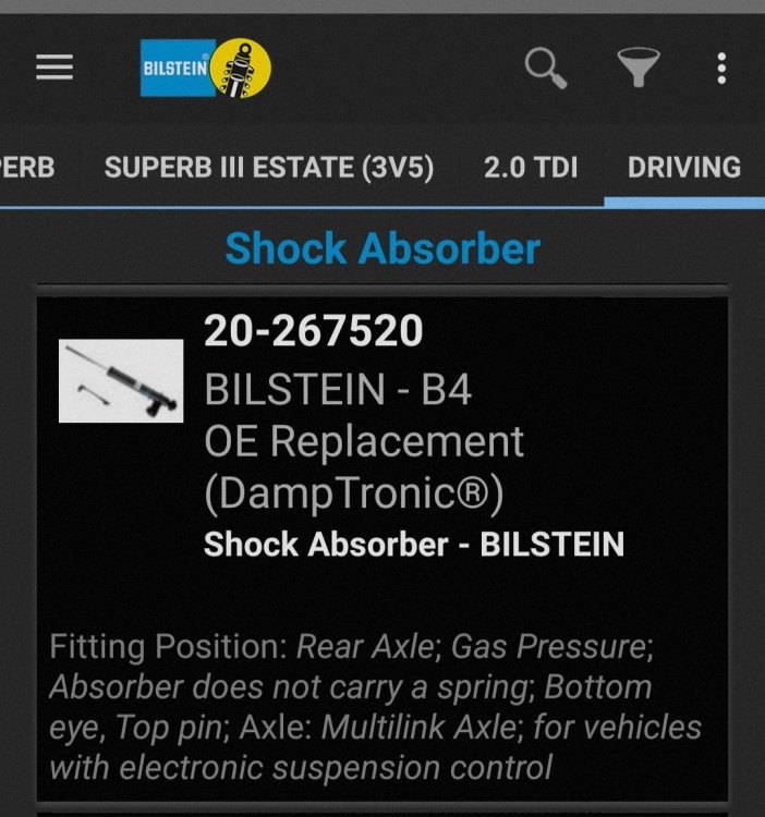

answer from German seller ->
here are the delivery times from all parts:
F11-79-008-01-HA  / available
F11-85-043-02-FA  / end-september
23-254343 / end-october
20-267537 / mid-november
but that are B6 DampTronics (DCC)

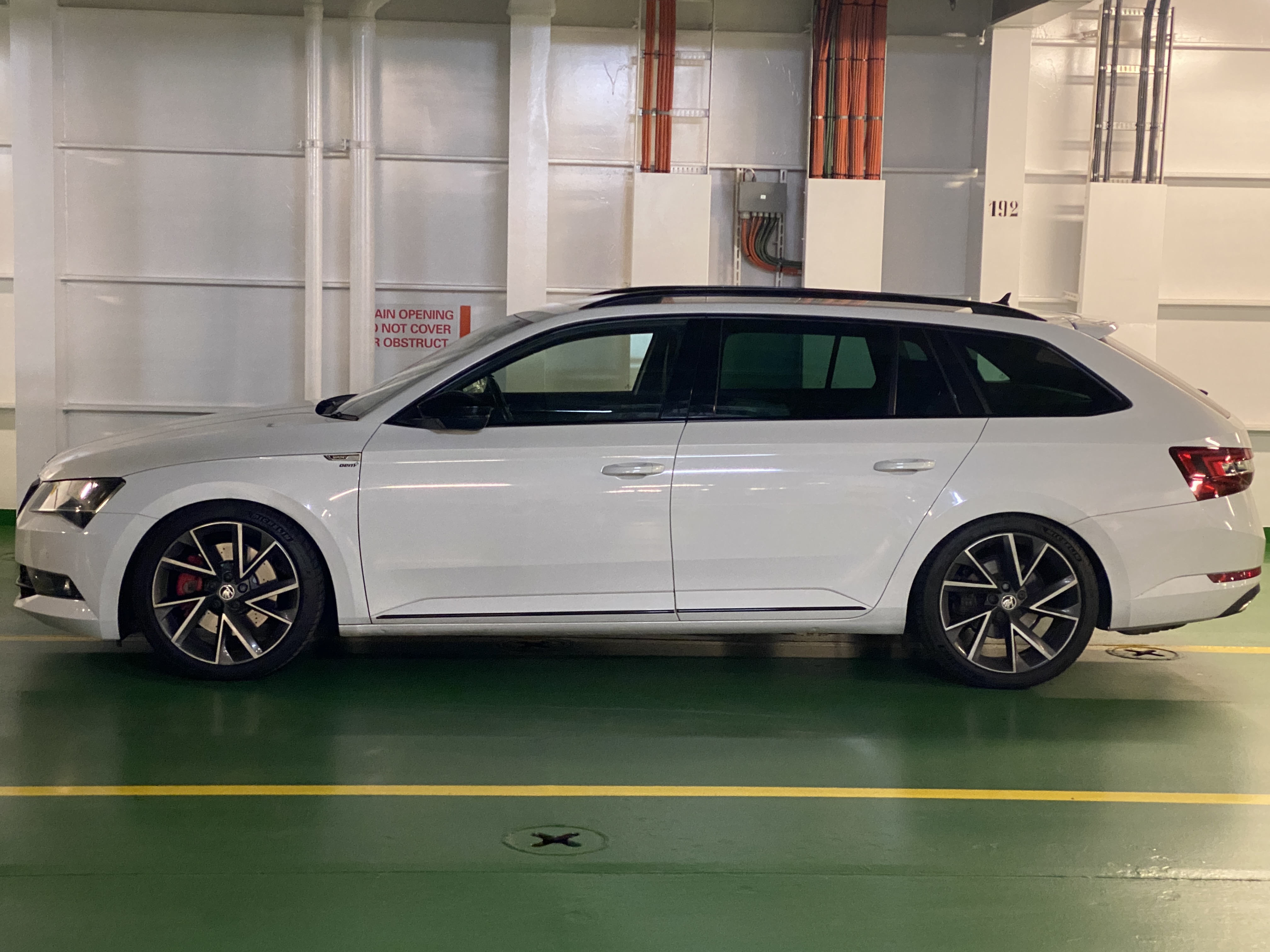

Hi from Madrid!  what springs do you carry?  has the body raised something?  can you upload some photos ??
 Hi from Barcelona! I haven't changed the springs thereby the comfort has been unchanged. Yesterday my wife drove the car and she didn't notice or complain. The body raised a little bit, but will settle over time, it's really hard to notice.

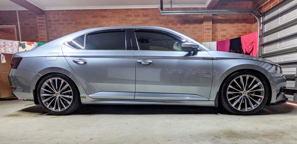

2 hours ago, Gabrielem said:
Too low for me, maybe with 18" wheels there will be more gap between the wheel and the wing.
It's not the 19" wheels causing the low ride height, but the low ride height H&R springs.
235/45R18 tyres and 235/40R19 tyres have similar outside diameters.
Outside diameter of 235/45R18 tyres is 668.7mm
Outside diameter of 235/40R19 tyres is 670.6mm
Edited by Carlston

and the H&R springs and the Eibach Pro Kit measure the same?
I doubt the Eibach Pro Kit springs would lower the car as much as the H&R springs. Eibach springs tend to be more sensible and give a better ride than the rather extreme H&R.

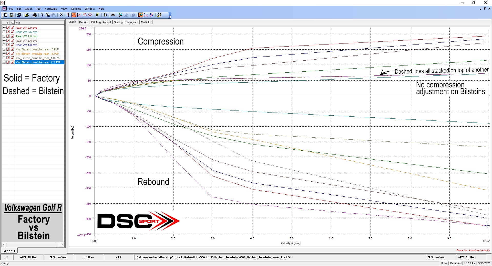

i don't mean to spoil the Bilstein party, but from a dyno test done by DSC Sport, they found the Bilsteins Damptronics are only able to control the rebound, while the factory DCC shocks are able to control both compression and rebound with their valving.
The test was done on the Bilstein Damptronic B16's (part number 49-255874).
This means the Bilstein Damptronics are a less capable setup when looking at compression adjustment, but still happen to have slightly greater rebound range.
Basically the only benefits to the Damptronics are adjustable spring perches to change ride height and stiffer springs.
They are not beneficial when looking at the "active" functionalities of the shock. This is due to the valve used in this specific shock, however in other Bilstein kits tested, like the Porsche Kit, the valve is different and was able to control both rebound and compression.
bad news for me 😞
recently ordered B6 DampTronic
