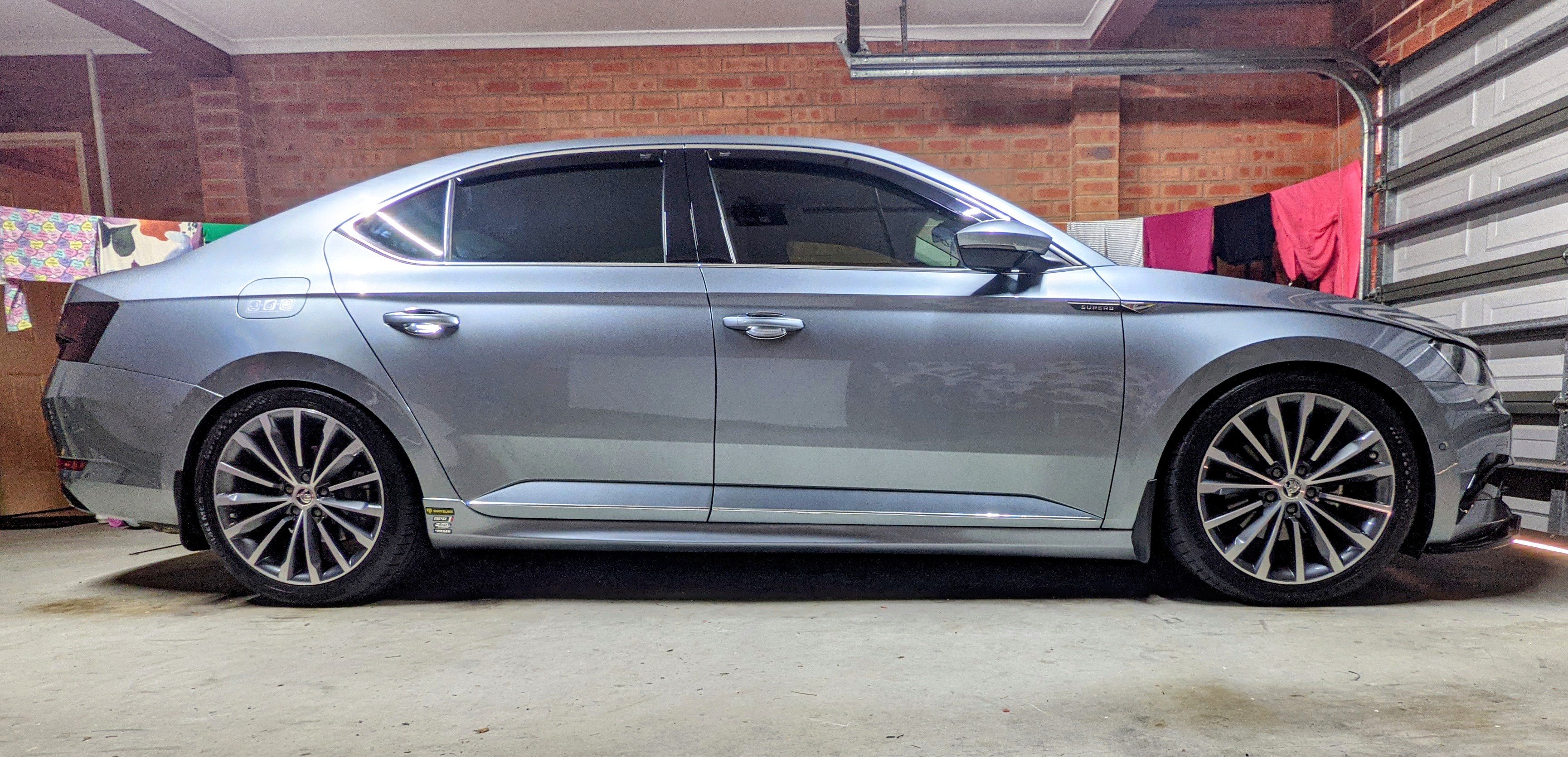

This is my 220 lowered on Eibach Prokit (FWD sedan version).
Mine dropped 20mm as I have DCC.
Too low for me...
30 minutes ago, Gabrielem said:
Too low for me...
Fair enough, but earlier u asked for springs "that go down 1.5-2 CMS".....
The Eibach Prokit drops the car 2cms.
Also, my car as Rieger side skirts and front splitter, making it look even more lower.
Edited by JR RS

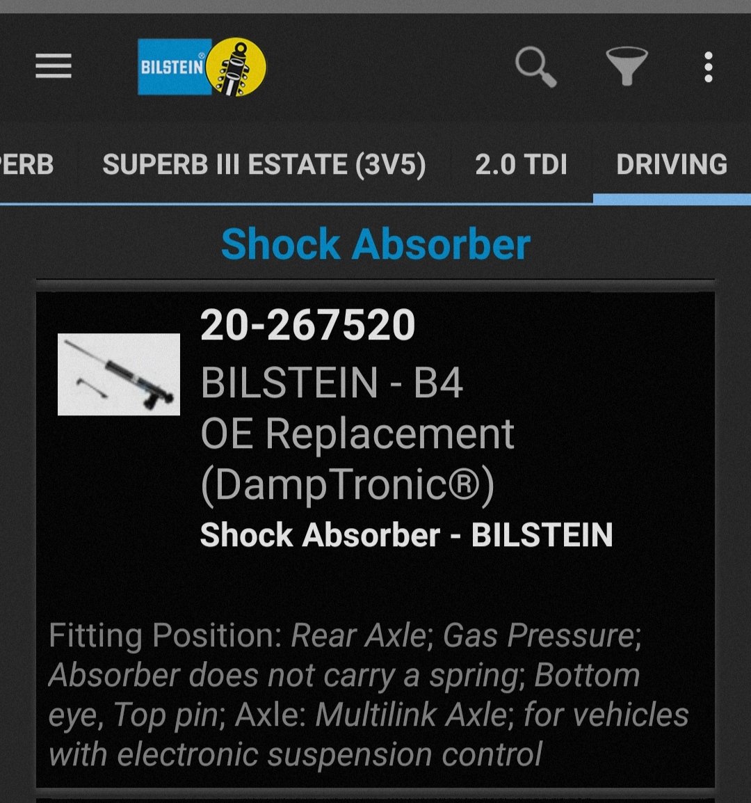

I have installed the Bilstein b4. There are no errors in in the damping on Obd 11. However there is no difference between the modes and it’s basically hard. I even pulled out the fuse for the electronic damping and the damping remained the same. I  called Bilstein UK who told me that if there are no errors I would have to take the damper off the car and send it to them for testing….they couldn’t tell otherwise. Highly impractical. They basically couldn't care less if there were no errors. I’m starting to feel like I’ve been scammed as I have no active suspension now. Are they just pedalling non active suspension as active?
Bugger, sorry to hear that.
That pretty **** poor for them to say that the only way to b sure is to remove the shocks and send it to them to test!!
Either the Bilstein's valve electrics r not understanding the car's DCC signals....
Or
......the Bilstein's valve electrics r just a gimmick.
There is a massive effect (not placebo) between Comfort and Sport modes with the DCC shocks, even with lowered springs.
I'd expect the same with the Bilstein Damptronics - it's the whole reason why u buy the more expensive Damptronics version so u can still retain that comfort control.
What else do you consider that they could or should do?
Ask me to take the car to them and they could test drive it and see it is obviously not working.
Agreed, have you proposed that to them?
The guy at Bilstein was very clear. He said he'd been doing it for years. If there were no errors appearing I would have to take the dampers off the car and send them in to be tested. He said that was the "only way" they could be tested. I guess I would warn people that they are very much on their own buying these dampers as Bilstein practically speaking don't want to know. I am wondering whether there is a plug and play issue with these dampers and it needs new software or what. It's all very frustrating.
On 19/09/2021 at 00:25, MikeM46 said:
i just had a closer look on the Bilstein B4 - these r NOT damptronic shocks, hence why ur feeling no difference when u switch modes!!
the B4 r standard OEM replacement shocks.
"Bilstein B4 - These are classed as a replacement damper. A few B4 variations exist depending on the vehicle application but these are all intended to replace the standard shocks fitted when the car was new."
u can read about the different types here.
if u had DCC shocks, then u should've got the B16 DampTronic version.
if u had standard shocks, then the B4 is the right replacement.
Thanks for looking. The shocks I bought are b4 damptronic shocks. They are the like for like replacement shocks for DCC suspension whereas the b16 are much firmer. See photoIMG_20210921_060511.thumb.jpg.c597fabdbb06ccf40f000e5426aa33f7.jpg
ah, that's good.
i didn't realise they had damptronic versions of the B4.
i'll just go sit in the corner now.
fingers crossed ur shocks get sorted.
