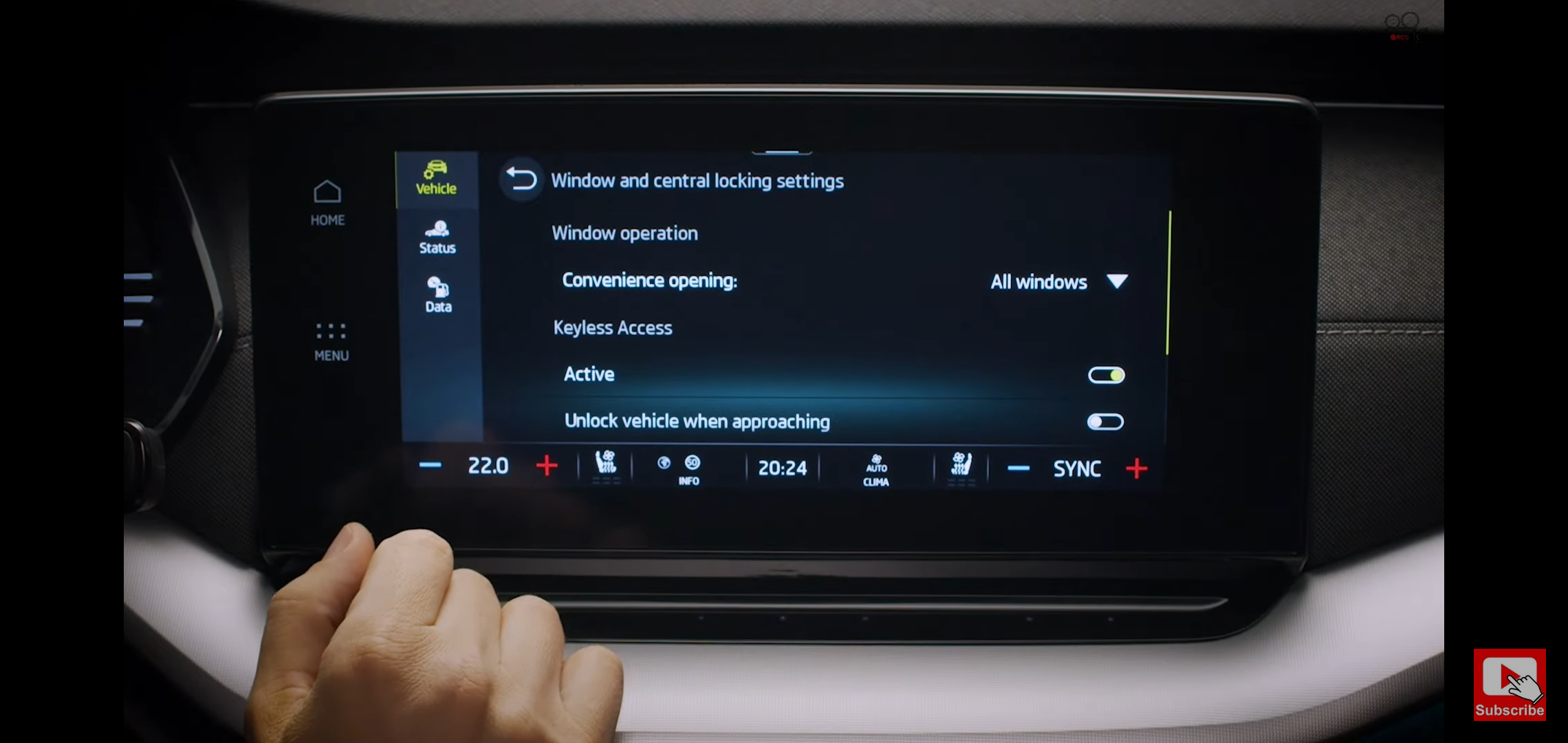

You can also turn kessy off in the window & central locking menu.

Thanks :) Bought the car today and this worked perfectly.
