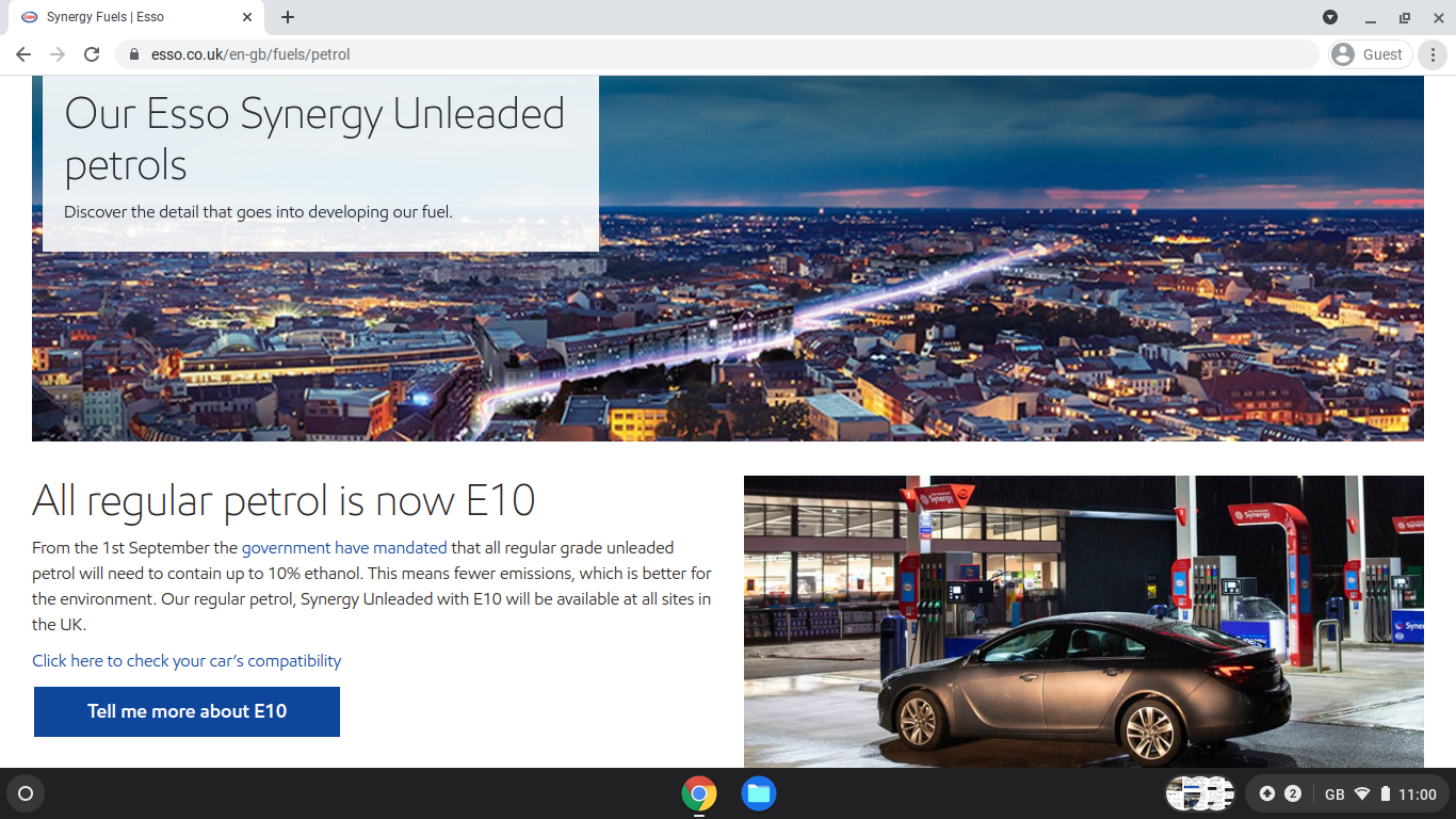

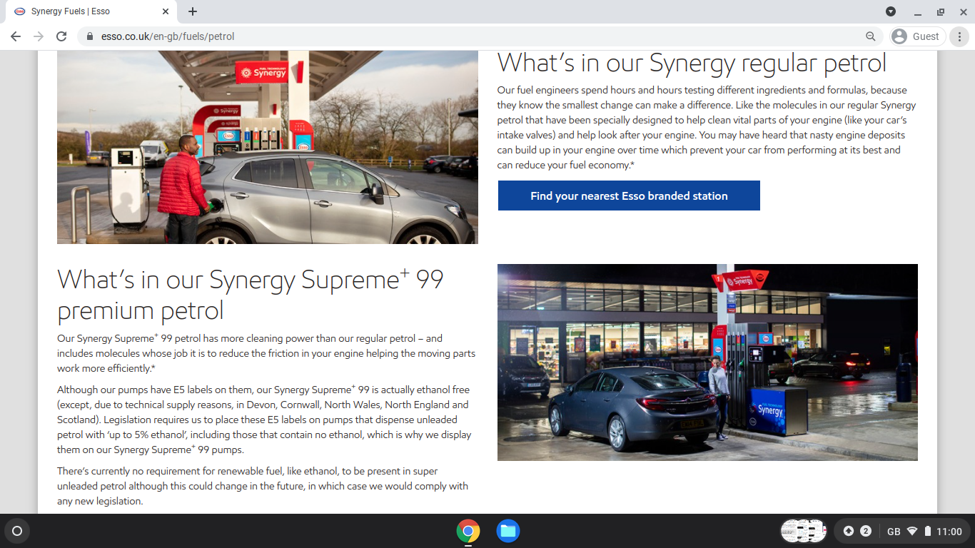

Fuel buyers in the UK are often so unaware of what they are buying.  Which depots or ports or refineries it come from. If it is base fuel arriving in the UK or from UK refineries with Cracking Plants.
They might not know when the Spring / Summer formulation is delivered to filling stations in their area or if they have Winter grade which is less hygroscopic and might be higher than the minimum Octane.
The winter grade petrol can sometimes be in the UK filling station tanks later in the spring than in parts of Continental Europe.
ESSO Super Unleaded delivered in the UK is not the same formula all over the UK.
Edited by e-Roottoot
All this fuel chat is genuinely interesting and all, but is it just me or do ESSO love ❤ a Vauxhall in their marketing / promos?
Like who in their right minds makes the decision that putting a Mokka in the promotion of anything positive in the automotive industry is a good idea...
^^^ They probably know their UK customer base and Mokka were one of the highest sellers or first registration cars, leased to lots of people and owned by Motability and leased out for 3 years.  As are many Vauxhall models.  Millions must drive them and many might go to Esso but do not think BP, Shell, Gulf etc are for them and they would never buy supermarket fuel that is produced by the same supplier as ESSO fuel.

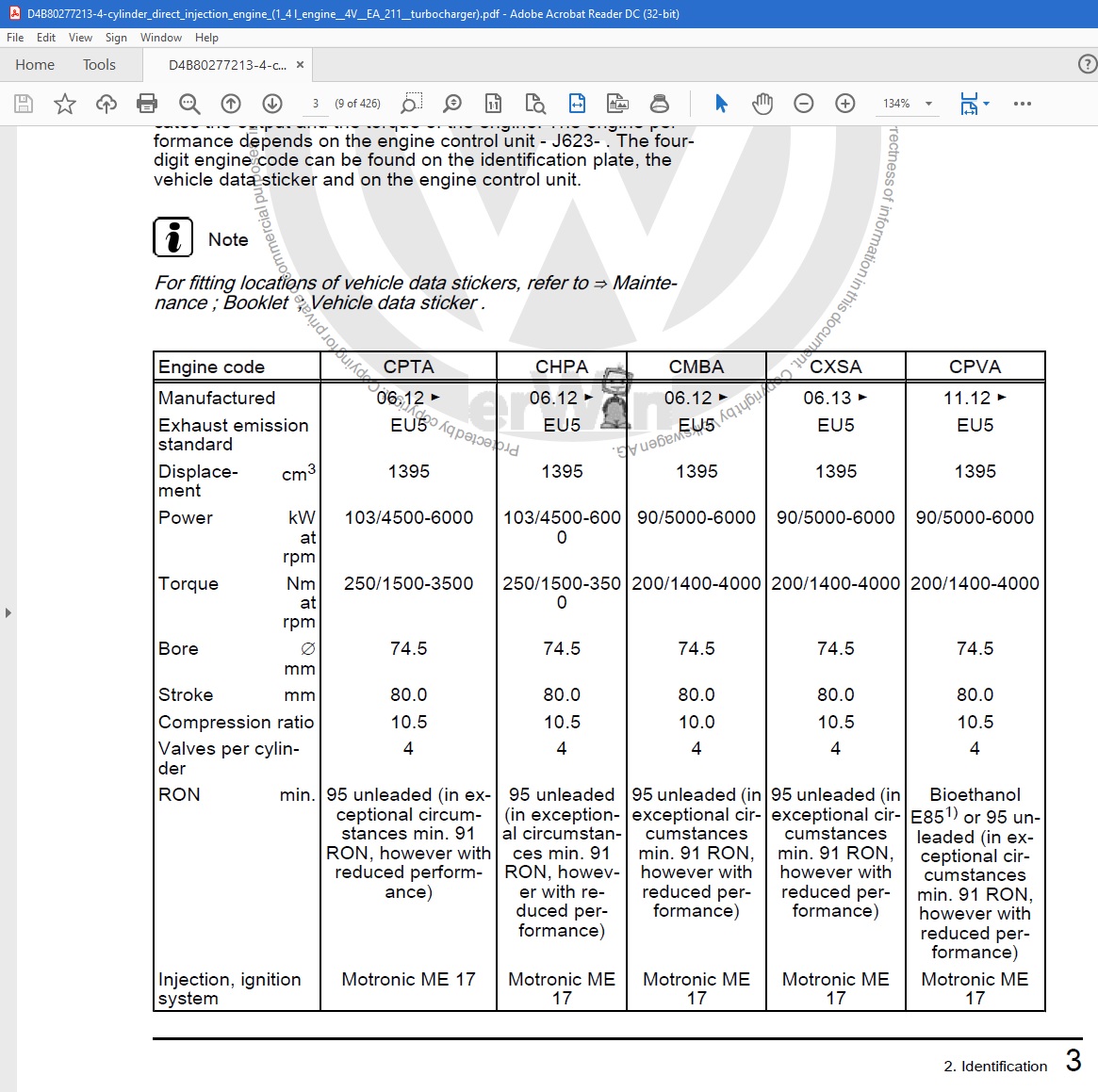

That is the first time I have seen anyone confirm in this forum the 1.4tsi 140bhp fuel standards as 95 RON and 91 RON emergency.

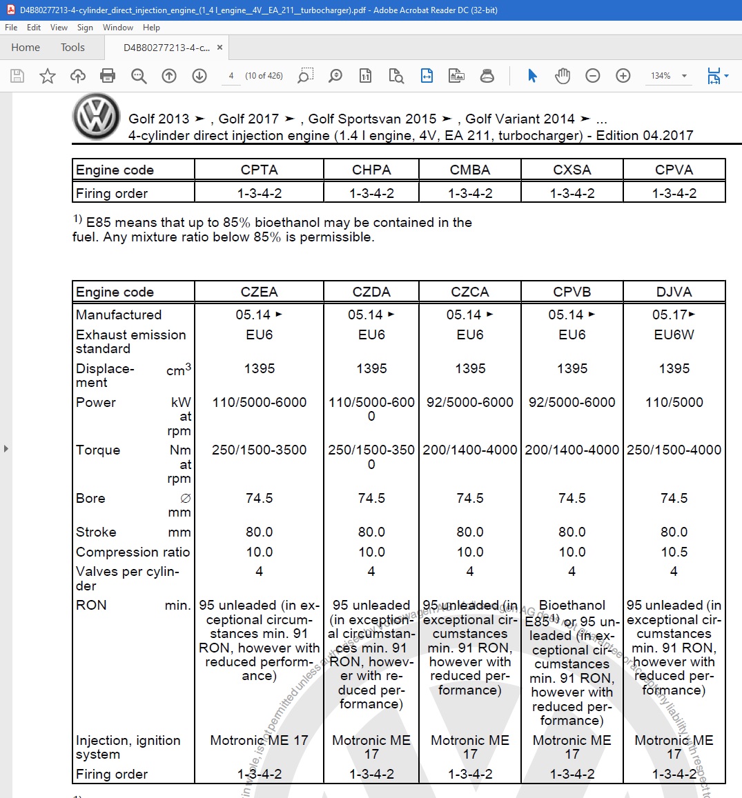

The VAG ERWIN repair manuals for the EA211 engines state it.
It may also explain why the base "95RON" stage 1 remap offered by tuners gets a nice hike without increasing the turbo boost by much as the timing gets altered correctly to remove the capability (reduced) of running on 91RON.
