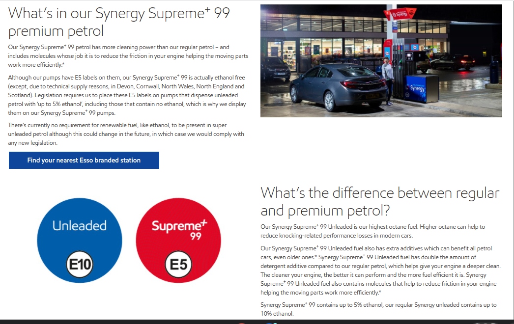

Costco was doing 99 ron before going to 97 ron.  Maybe because it was Greenergy that had been supplying them then that changed.
Sainsbury's Superunleaded 97 Ron min as well.
ESSO,
Ethanol or not in the E5 99 Octane?,
location location location dependent, or what might be brought in from Continental Europe or Globally.
Edited by e-Roottoot
@Wino  We’ll spotted – the perils of rephrasing a sentence after typing it!  Now corrected.

I may have to give the Esso Supreme+ a try.
It'll certainly be a step up from the bargain basement Sainsbury's 97 E5 that I "treat" my car to in favour of the Sainsbury's 95 E10 stuff. :D
