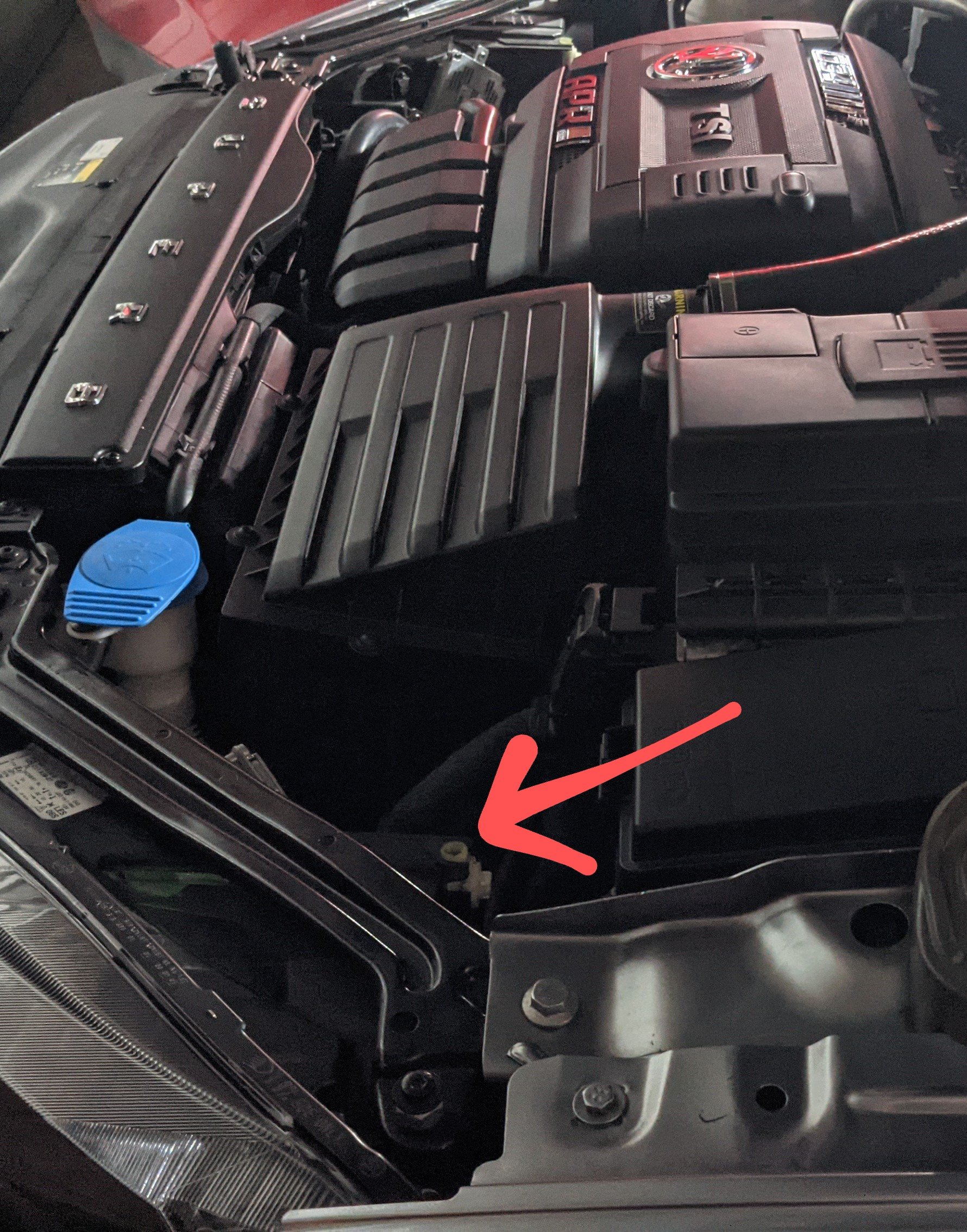

As it's been said before - park approx. 7m from a wall, pop the bonnet, using an Allen key, make slight adjustments to the adjuster on the top of the headlight.
There r two adjusters - one for vertical throw and another for horizontal.  Adjust the vertical one. See image below.
If u need to make major adjustments - then u need VCDS or OBDEleven to put the headlights into Learning mode before u can make adjustments.

From what I’ve read on here in the past, you only need to adjust the screws ever so slightly to get the correct distance.
You’d use the software if it was way out.
This is what I’ll be doing at some point, buying new osram d3s laser bulbs.
If it still seems like it’s a little low, get a thin marker pen and on the screw draw a straight line making sure to draw a line onto the plastics as well.
That way when you adjust the screw you have a reference point to turn it back to if not happy and want it to go back where it started, as you just have to get the lines straight again

Tried a full anticlockwise turn of the headlight adjusters, couldn't see too much movement when watching the light beam on my garage door, so I need a dark country lane where I can measure the beam length.

I had to make at least three full turns on my car, to get them to the right height. If you are close to the garage door, the changes will be hardly visible.
