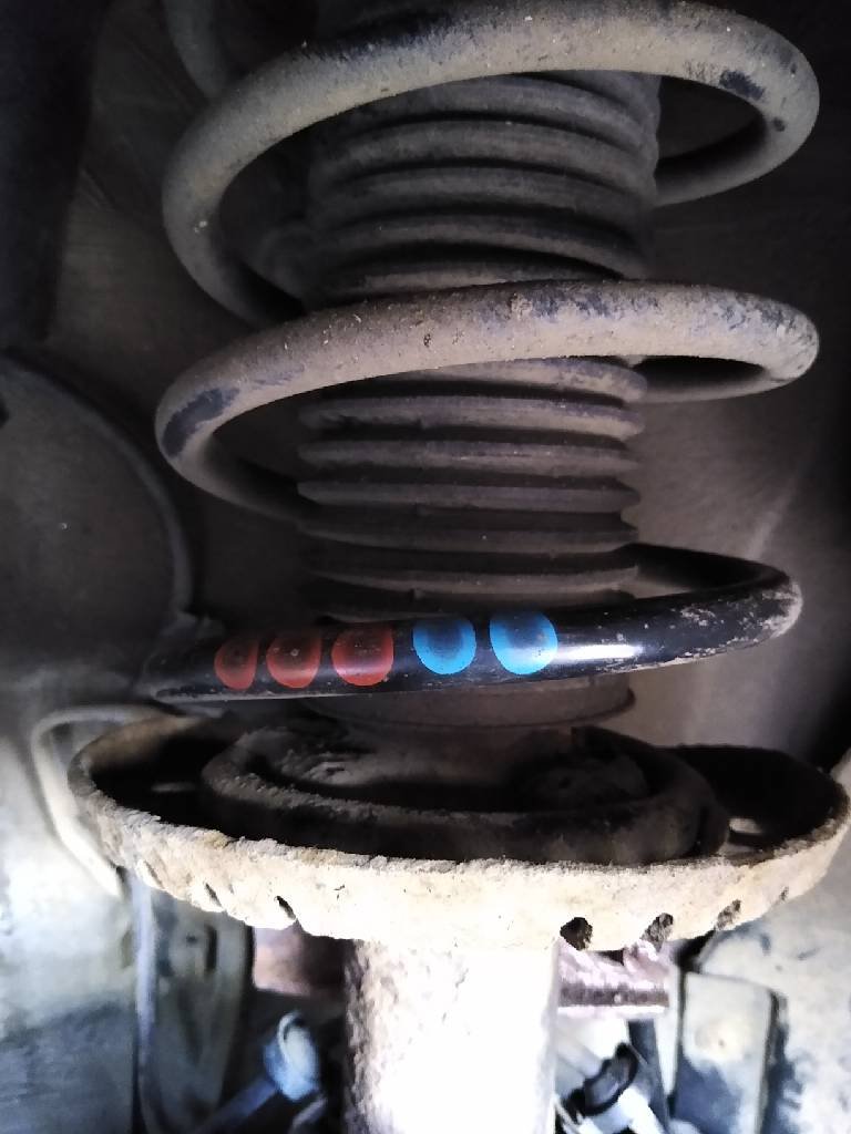

If the springs on the car now are the originals, or correct genuine replacements, they'll have a sequence of coloured paint marks on them. This is the key to finding the part number.
3 red marks then 2 blue would corrrespond to the part number you mention.

I have just checked and after rubbing away the dirt there's 3 red dots followed by 2 blue, so looks like 6Q0 411 105 AE is indeed correct.

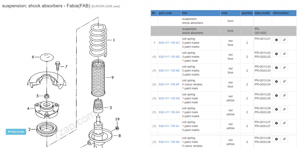

That's not enough of the part number to say; the letter suffixes are all that differs between every variant of shock, standard, heavy duty, sports etc. There's probably a sticker on your old ones if original,
Probably -BH as shown on this page (view on computer, not phone to see all info). Part numbers for the other bits are all there too. Ebay seller 'vagbolts' is usually competitive on genuine fasteners and often next day delivery.
suspension; shock absorbers - Fabia(FAB) [EUROPA 2006 year] (7zap.com)

Again, very helpful Wino, especially the other part numbers too.
I think 6Q0413031BH is correct as my vehicle's PR code is G01.  The struts are so badly rusted I think I would be lucky to find any markings or stickers.
