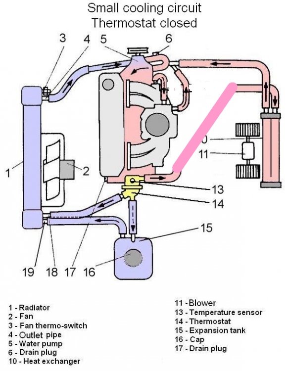

Take a look the below picture, it is from another member but it was Wrong and i made a rough correction.
The problem of my Trusty was in the ''red" section where the coolant was restricted by the thermostat, at cold starts the coolant circles inside the ''red'' sector and the thermostat sensor reads and send signals.
My old coolant was too thick, the whole temperature on the ''red" sector was a little bit low and took too much time than it should be to get warmed, the temperature gauge was showing that the needle took long time to get rise so the first kilometres the coolant temperature was less than it must and this cause me a raise on fuel consumption.
Who needs a thick coolant in cities in Greece where the temperatures at winter are not below zero?
The illustration was made by me and it was nothing wrong with it. It is for Felicia with carburetor.

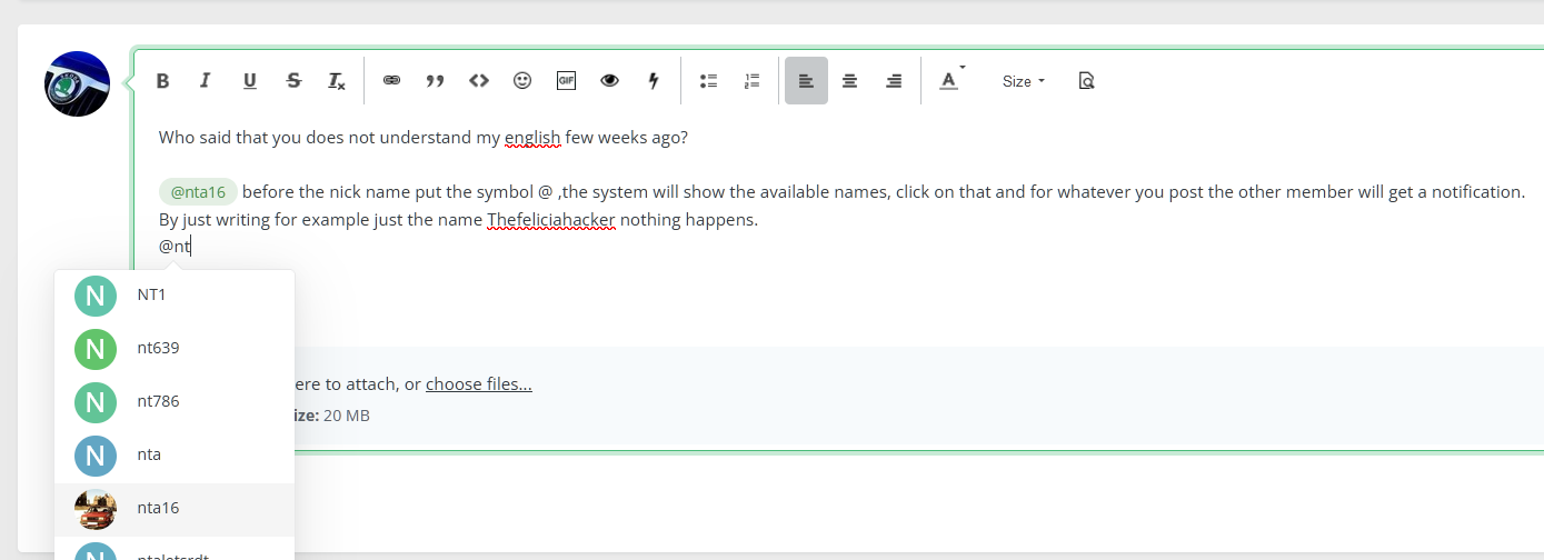

@nta16 before the nick name put the symbol @ ,the system will show you the available names, click on that nickname that you want and for whatever you post the other member will get a notification.
By just writing for example just the name Thefeliciahacker nothing happens.
Below is an example, i write the symbol @ and when i write the initial n then the available list show up, i clicked on your nick name and when i write the above post get a notification that someone mention you.
