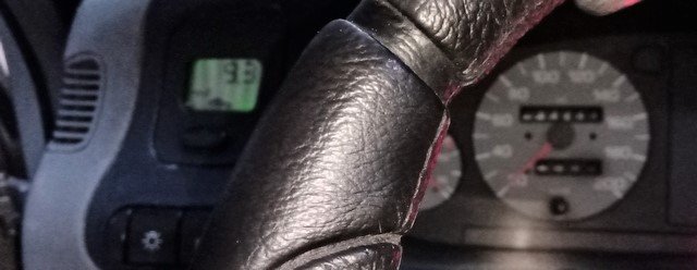

My Felicia had an average fuel consumption at city traffic of 9,5 lt/ 100 Km which is not only good news but leaving me optimistic for better results because now everything is as should be (i have the proper coolant, Ecu-chip updates, Amsoil additive, TC-6 better adjustment plus a recently Ecu reset) so i am in agony for the next refuelling.
This is a photo few minutes ago, yes i know it's a crappy but i was in a hurry.
Fuel consumption 9,3 lt for 100,7 Km in the odometer.
Note:  The above fuel consumption was in City traffic (mainly 1st-2nd gear and only for few seconds the 3rd) including the recently snow days with low temperatures.
The "new" coolant plus the Amsoil additive helped me the most plus the ECU-chip update, the cold starts now have nothing to do with the previous ones.
Many times other people criticise me for keeping detailed service notes but deep inside me i know that i am right.
Those notes helped me to understand the nature of the problem and surprisingly no mechanic tested the coolant, everyone was watching the blue colour on the expanding reservoir and they were saying
''Hey, you are Ok, you have enough fluid" but no one spend 1 minute make a simple test.
Another photo from that trip, it was very difficult to take good snapshots of fuel consumption with the right hand but you can see the needle which barely touches the 100 Km.
The road was straight, even on slightly downhills the result can change dramatically but there is no meaning from me for such photos.
