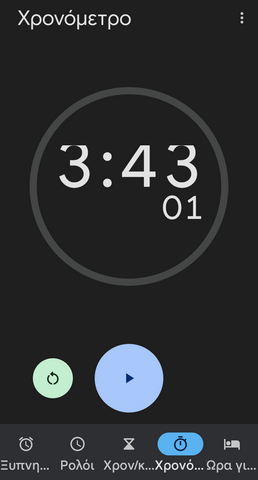

So last night i have made a test, nothing else On (radio, heater etc), start the car with no revving and counting the time till the needle drops to 800 rpm which is the idle level and the temperature will rise.
Here are the results, the engine went at 1100 rpm and when dropped to the idle the timer wrote:
I don't think this is normal.
