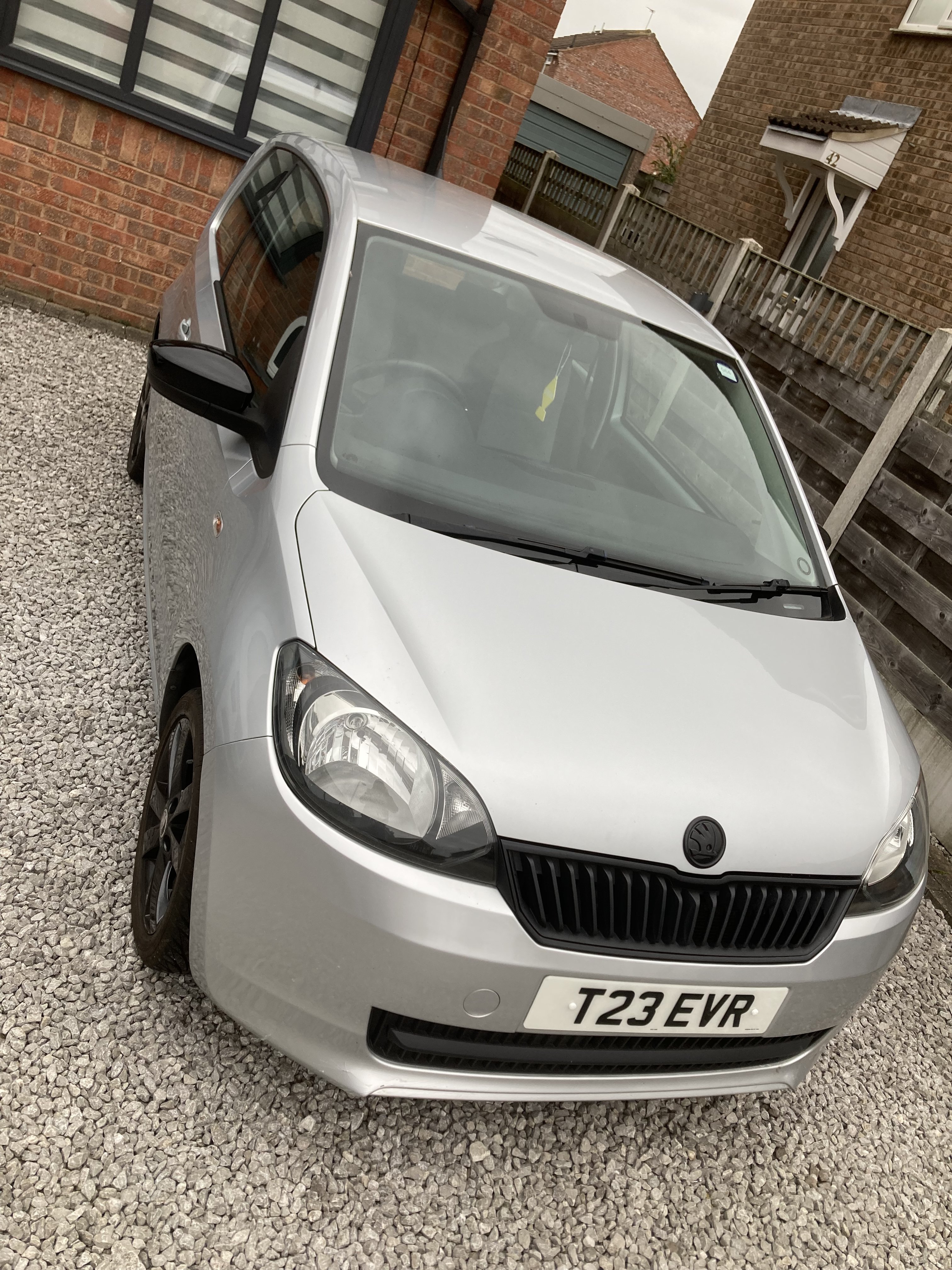

some pics of the citigo when I brought her a couple of months back
62plate se spec
with 72k on clock,
lovely eBay wheel trims 😂AC99278B-C14C-4428-92E7-6DE913ED01D3.thumb.jpeg.f9b65965f058dc90a69f57683f57afc7.jpeg5D66D540-AB3C-4565-9ACC-2A1EAAFAED82.thumb.jpeg.0912a0fea1a99dd75eb7e36d715c0f37.jpeg

Updated the exterior with Monte Carlo 15” alloys which will hopefully clear gti brakes,
Black mirrors
Monte Carlo grill
black superskoda Skoda badges front and rearA4E5E59C-7467-4FBC-92DF-38DA39F94B9D.thumb.jpeg.38ccef84c60fc59e11e26458a17f7c17.jpeg

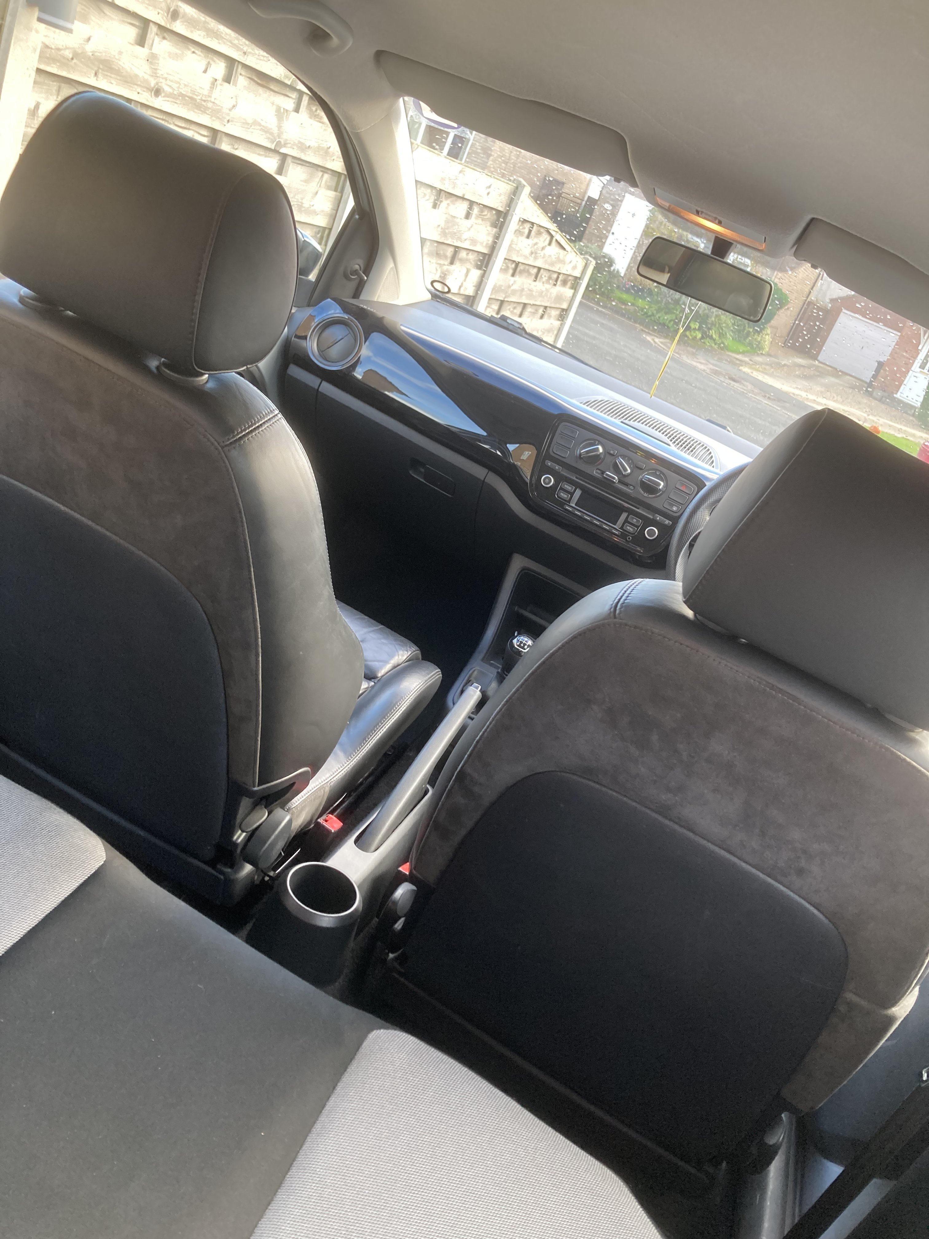

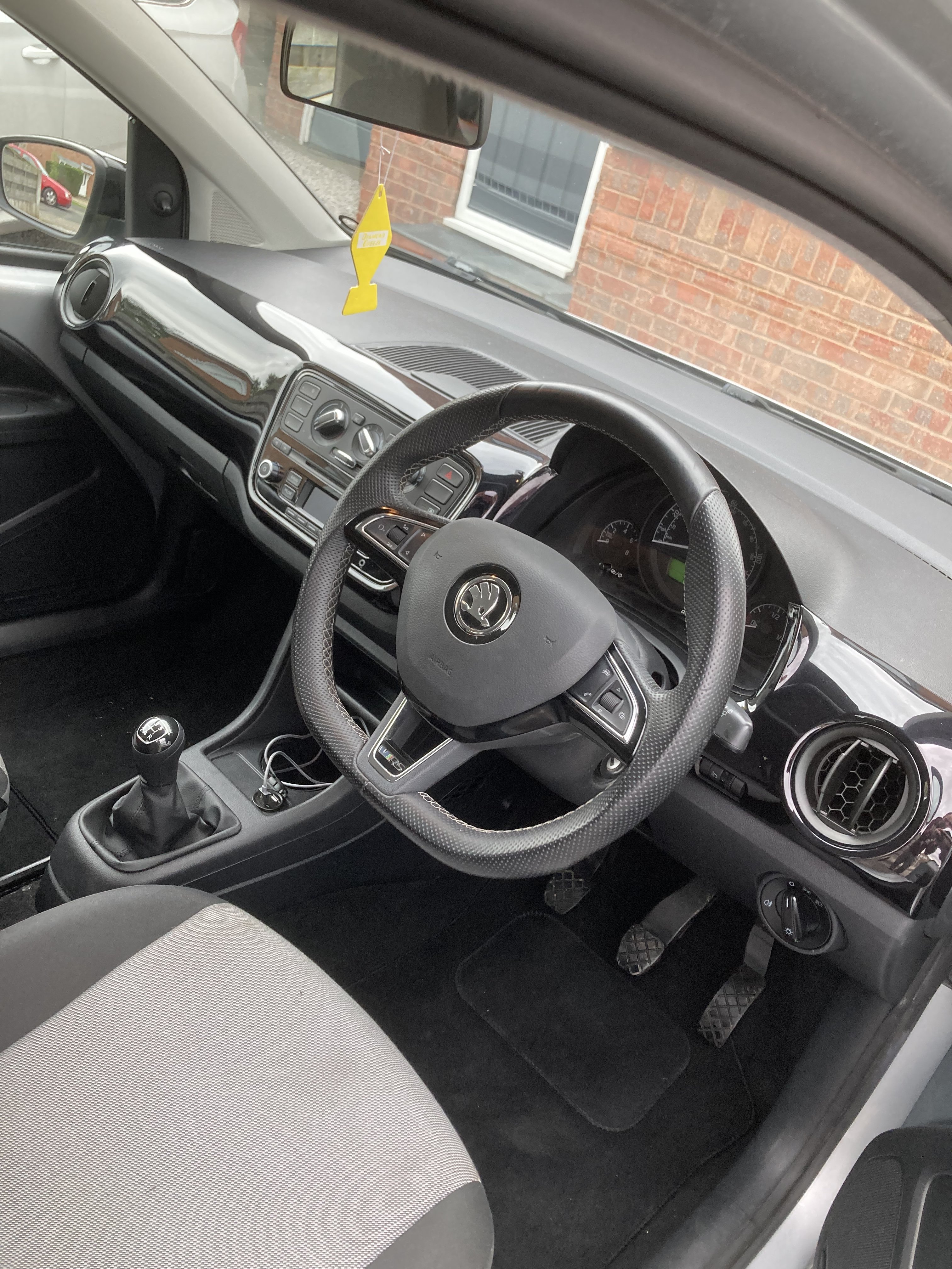

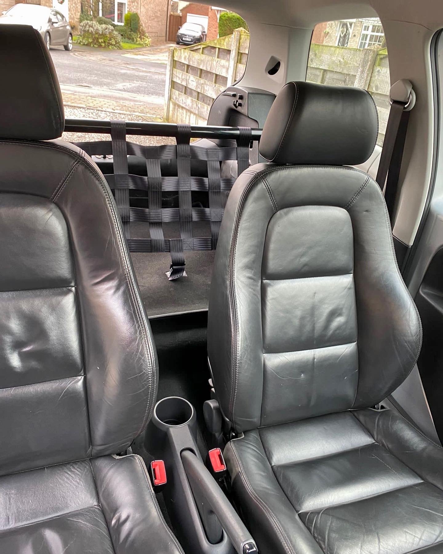

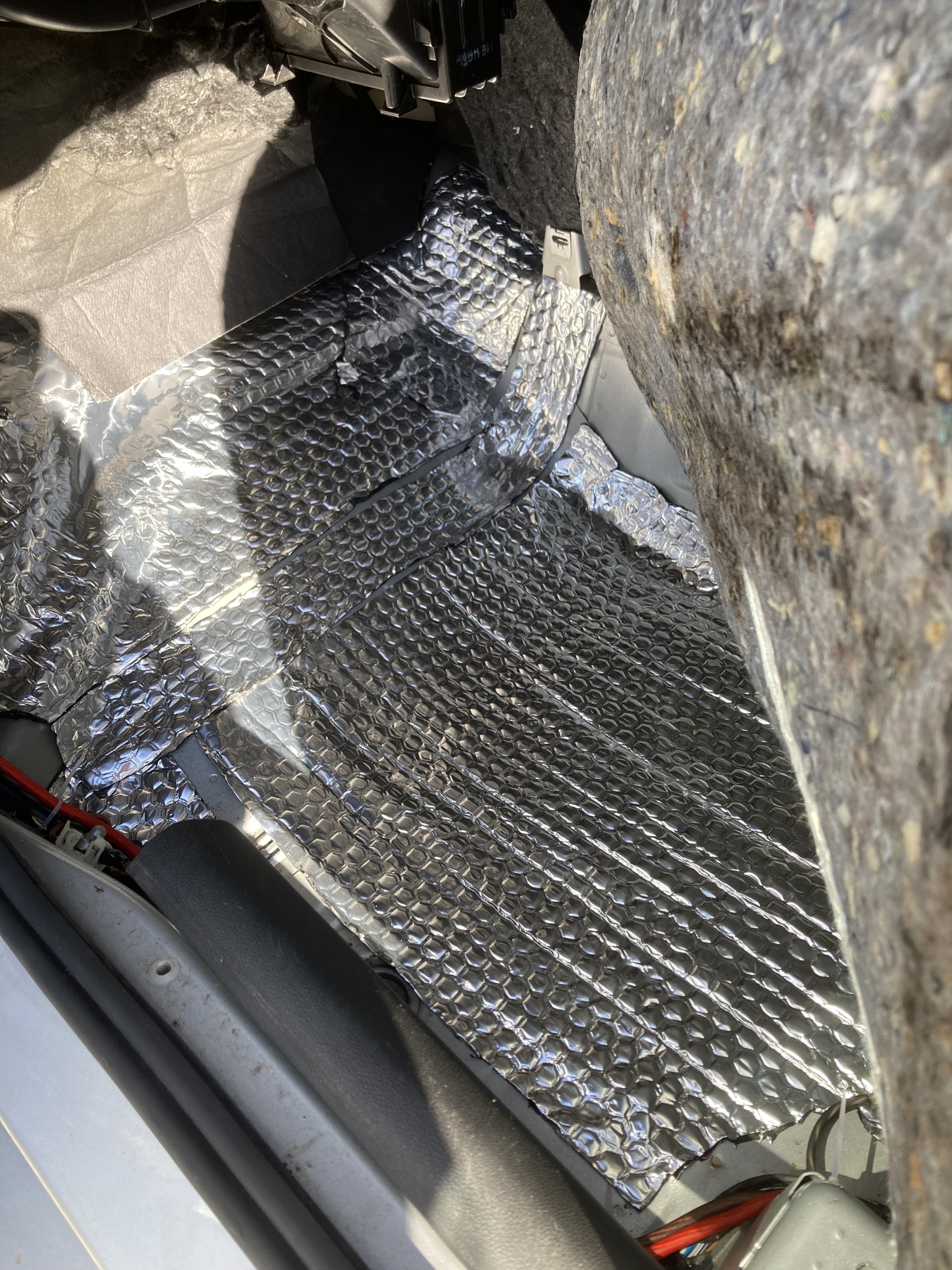

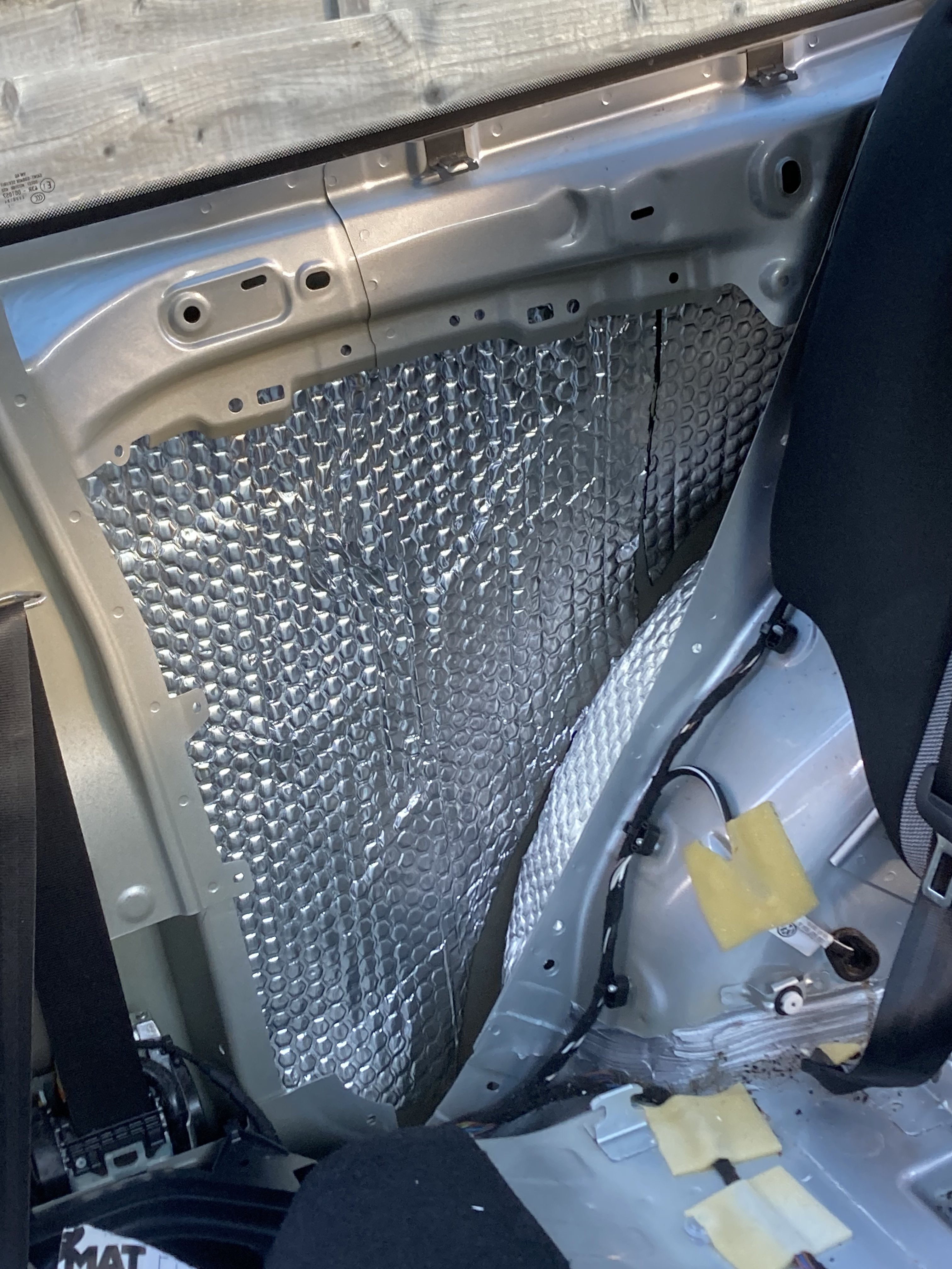

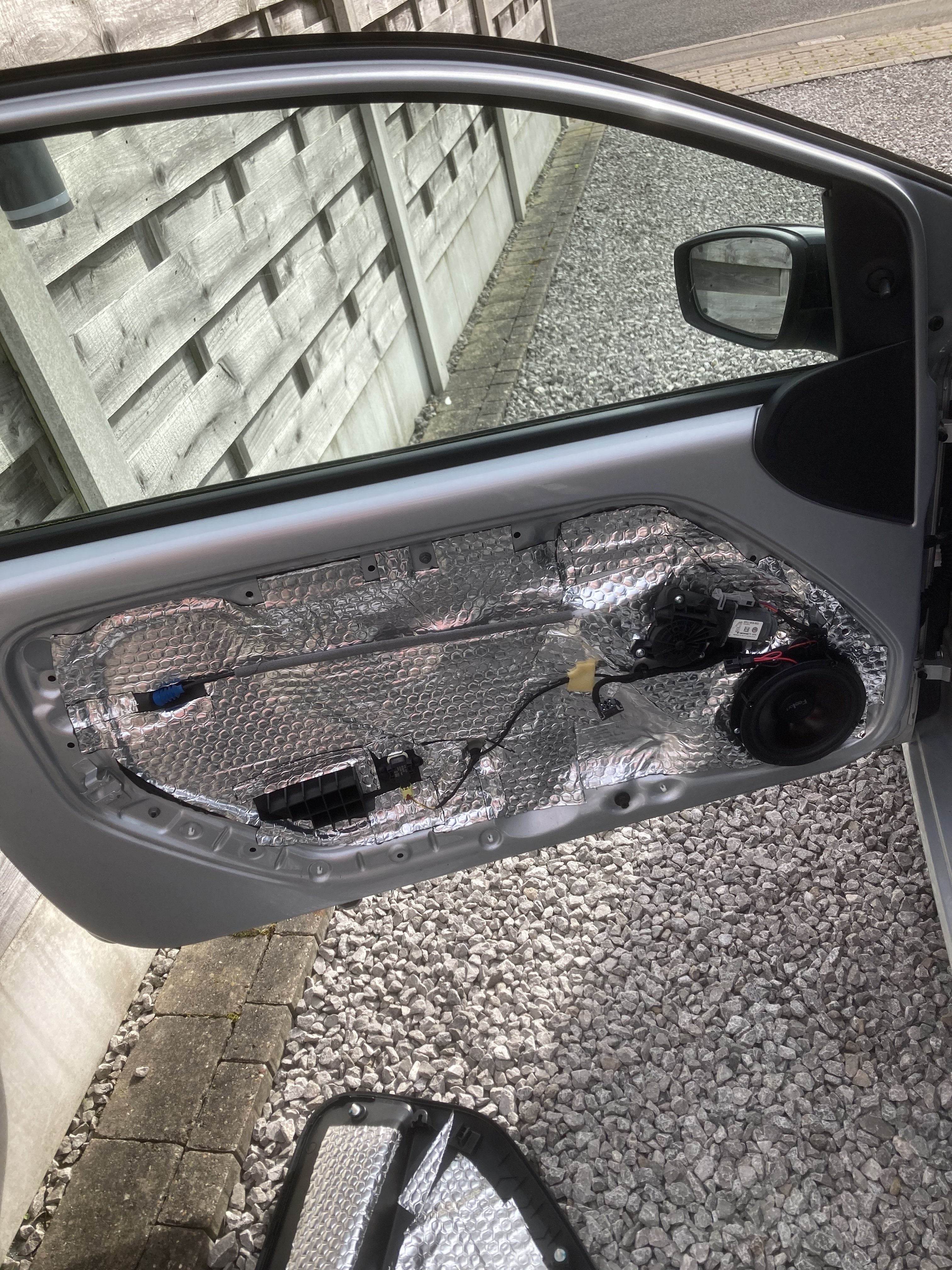

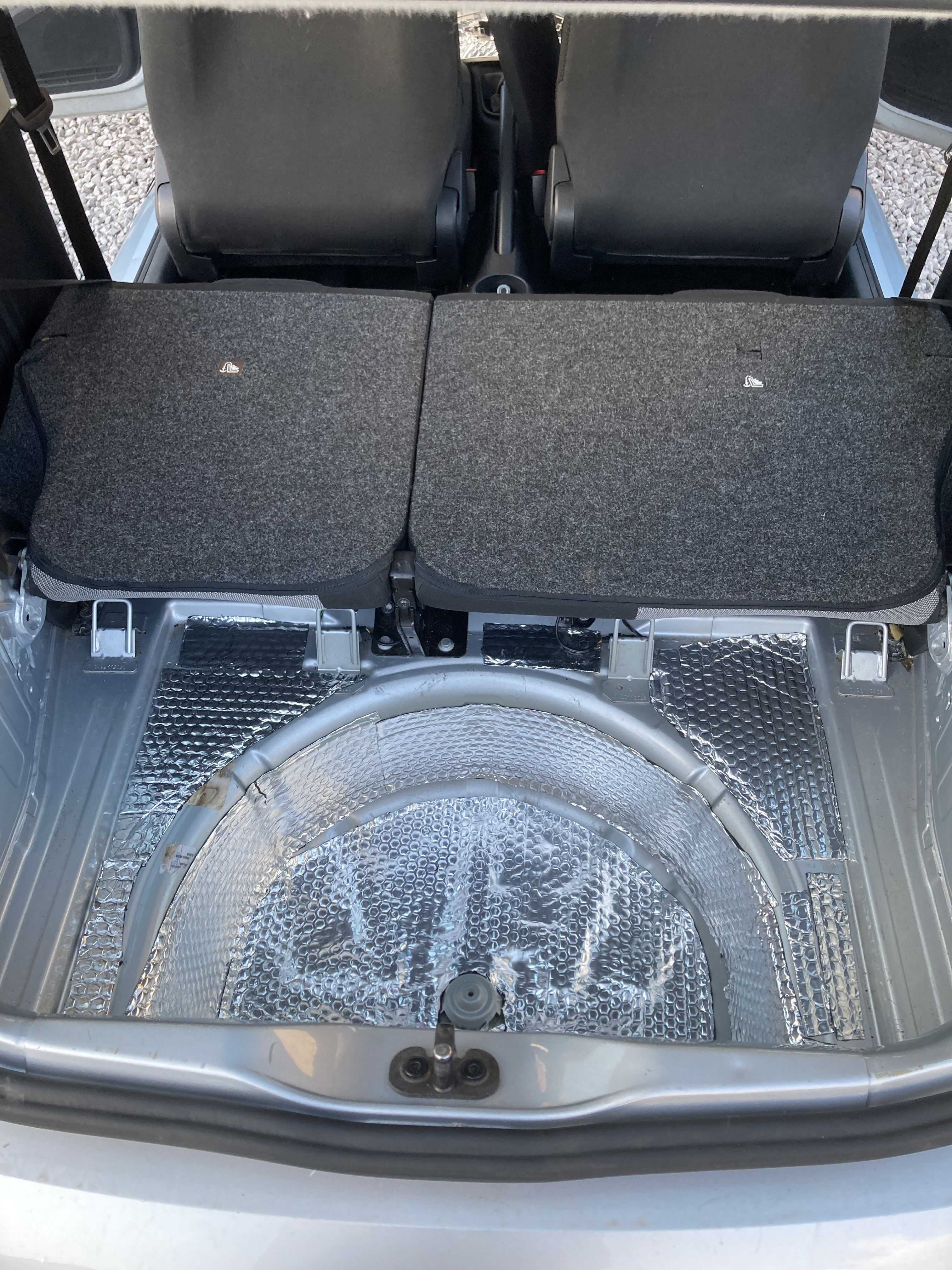

Inside I’ve insulated pretty much everywhere although will add some more foam under carpet when all interior comes out again, added a rcd 215dab retrofit, front feelart speakers and a pillar tweeters added with gloss black up trims and Octavia mk3 vrs steering wheel and Audi TT front leathers.

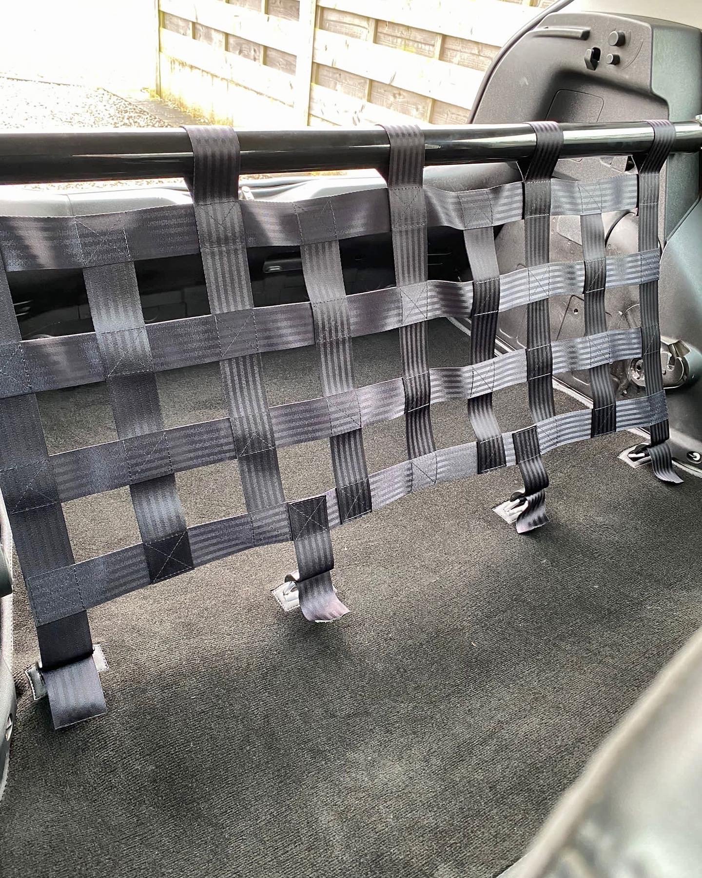

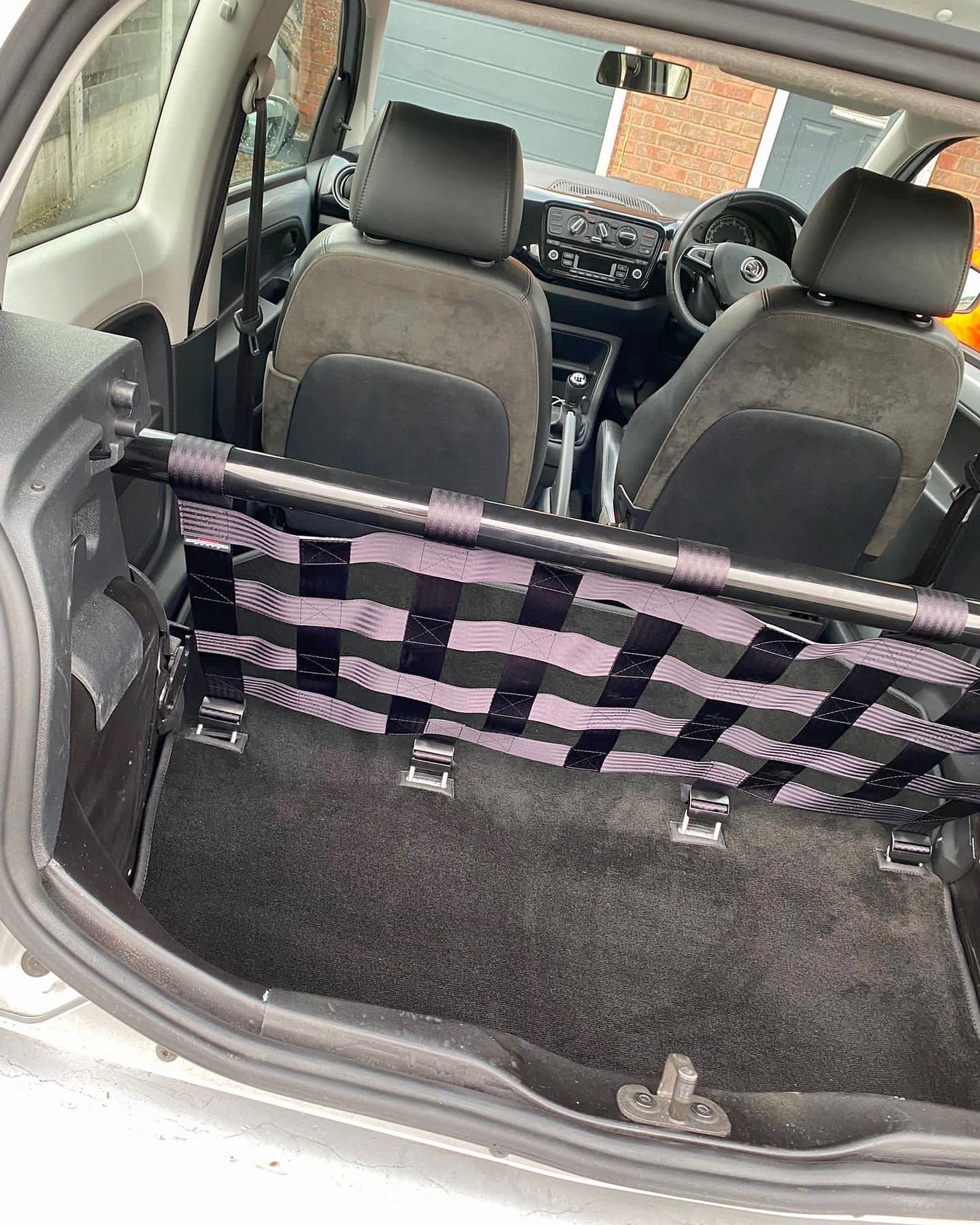

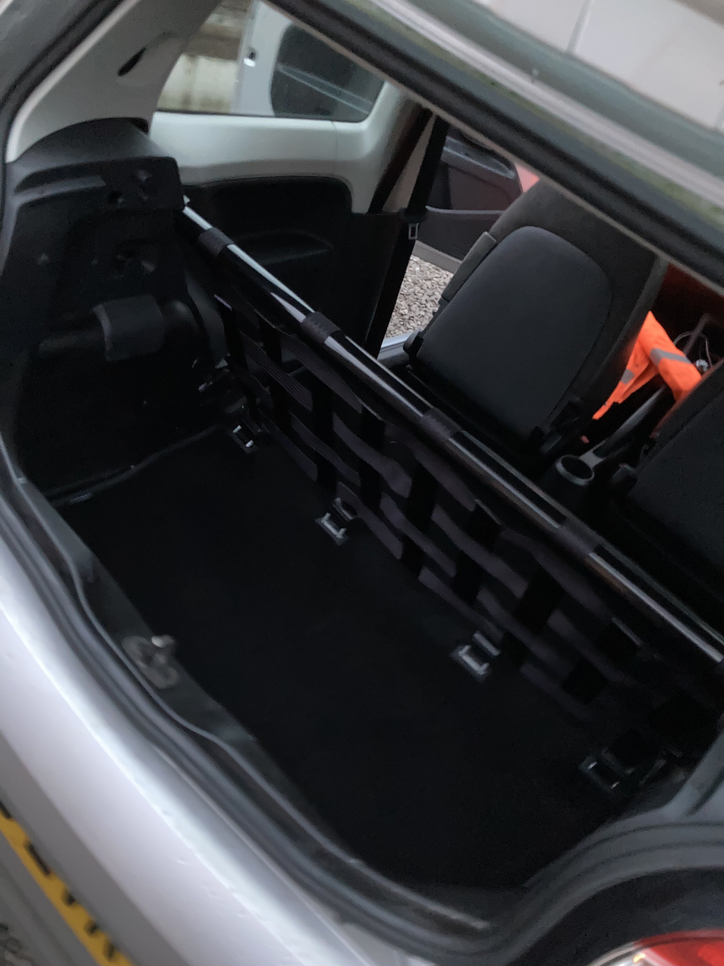

Rear will have a stern performance rear seat delete with brace and netting it’s on order :)
3B503BF2-FB54-42EC-B563-E25542836456.thumb.jpeg.74f243f6fd4cb923966a64f2fa052356.jpeg05F4D5BB-2CCF-41F5-B3BB-0A9BE8AEE389.thumb.jpeg.2ac4b6faf2b61759f306b6e0c38de753.jpeg286D7EBF-D1ED-4BB3-A839-67ED0769095F.thumb.jpeg.329ff63cb0f6d42af93b943535cc727e.jpeg183907EE-90AB-42C9-8CF0-D695A8A15A13.thumb.jpeg.85d03d0153724ec4ae793172fd4592ca.jpeg
DC06BA10-77C9-4899-BBCF-2DD1F8EA8D94.thumb.jpeg.ed2e4b191ae57479cfc6a942ee727bb2.jpegA137CE07-8C6B-4394-9053-BEDD6C987B74.thumb.jpeg.a00b89ccc7be9d7ba99a24b518afac49.jpeg

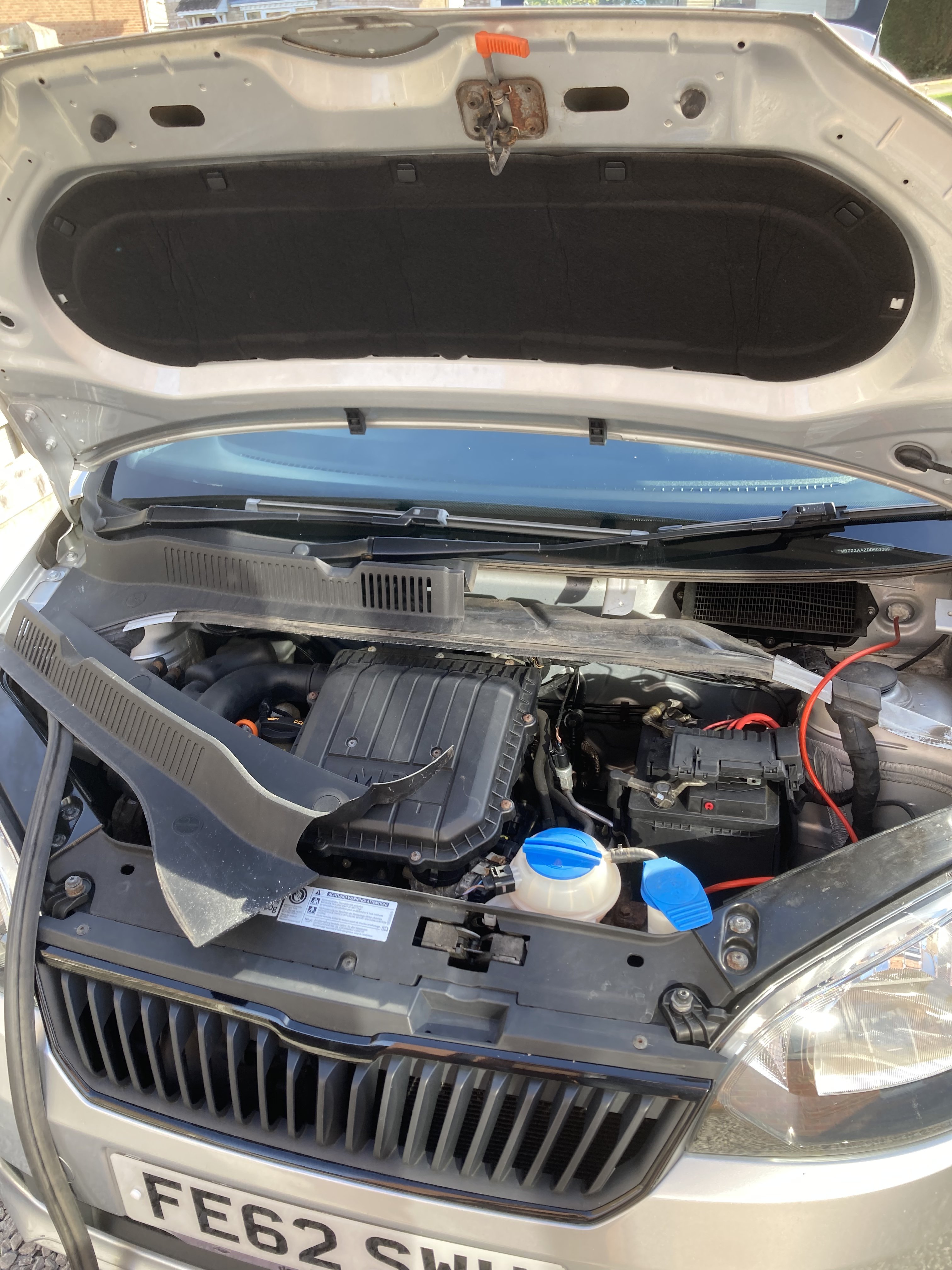

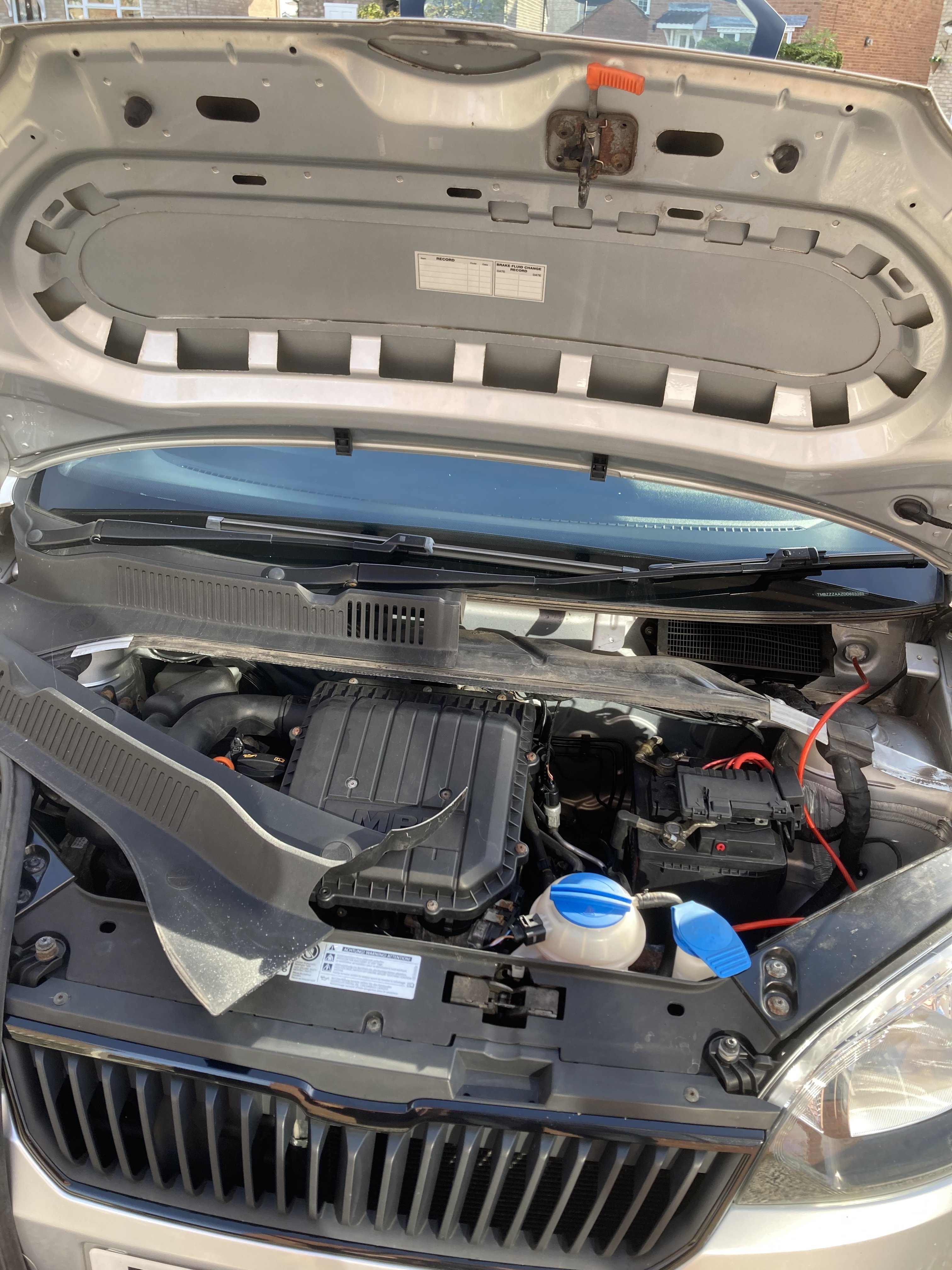

Also added under bonnet insulation that comes on the e-up, I love also since drilled the other two holes that the citigo bonnet doesn’t have and fitted the other two clipsF38A4087-7591-4C5E-8713-0DDE0FFA7D5B.thumb.jpeg.5f5ad3b57b1b84780183b35b1f77d6b8.jpeg5DE80387-BB7A-4A7F-BA89-0A7721F23E3B.thumb.jpeg.faebac56227b1cc20f41909d5d739c0c.jpeg

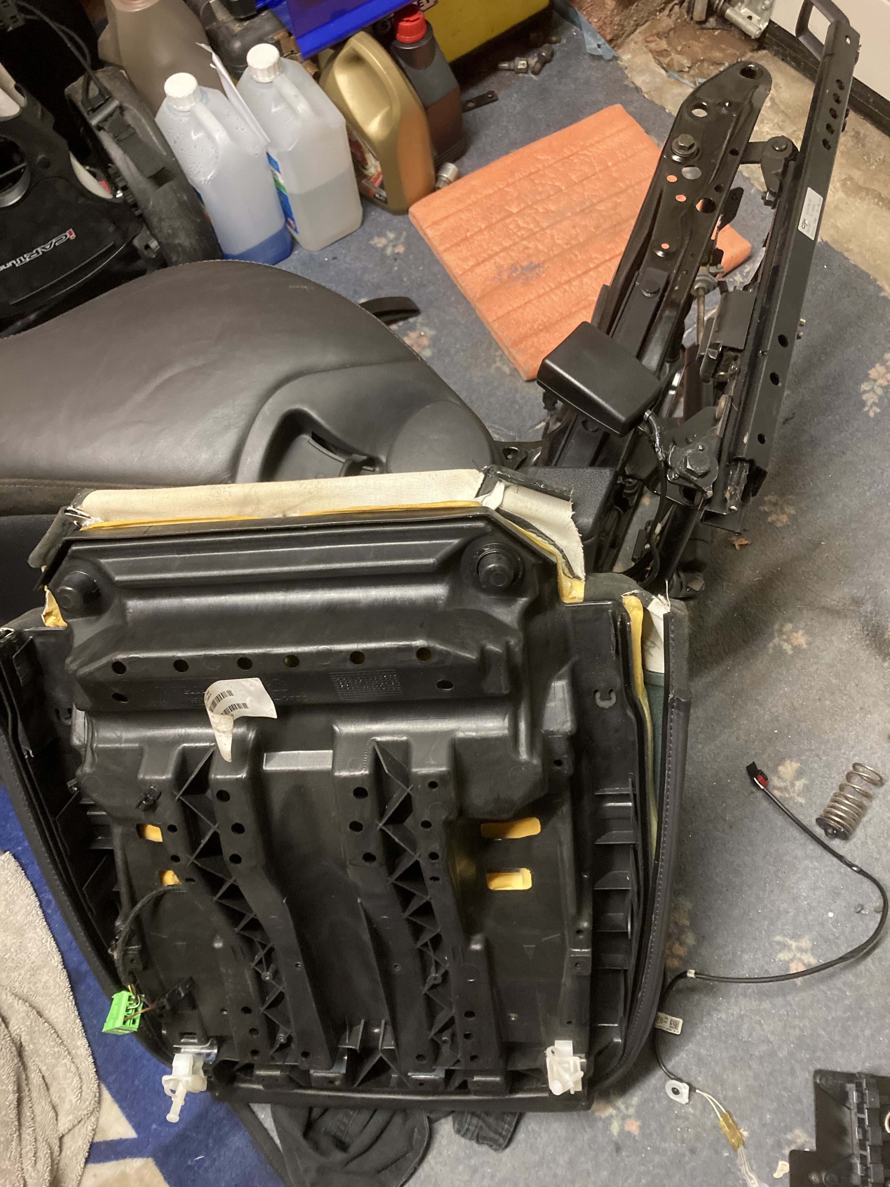

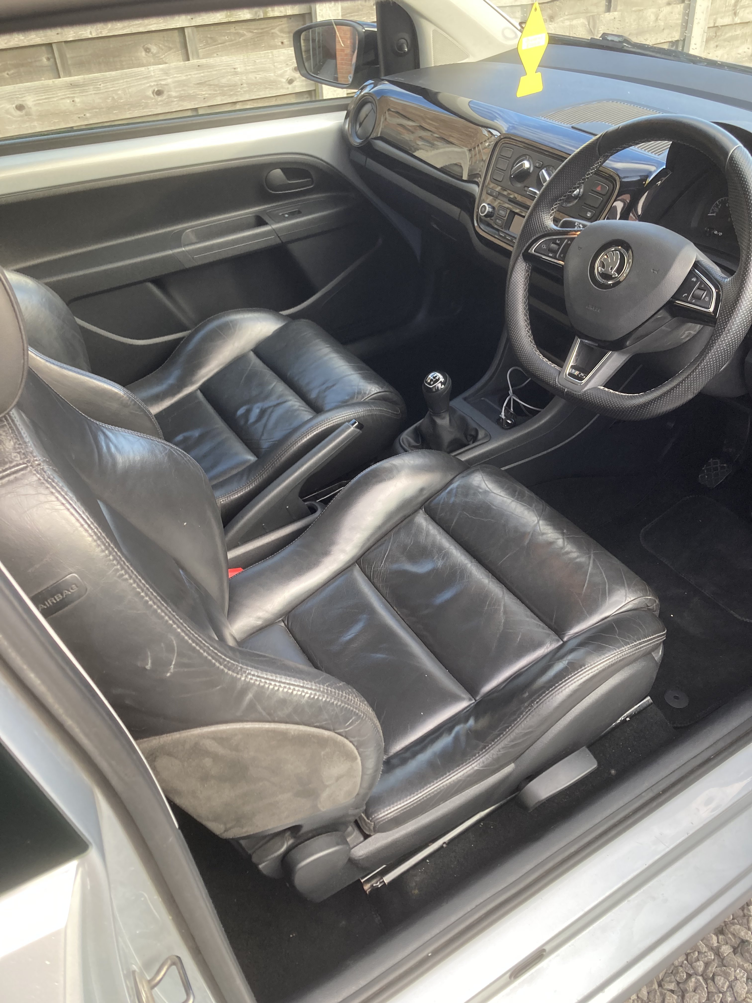

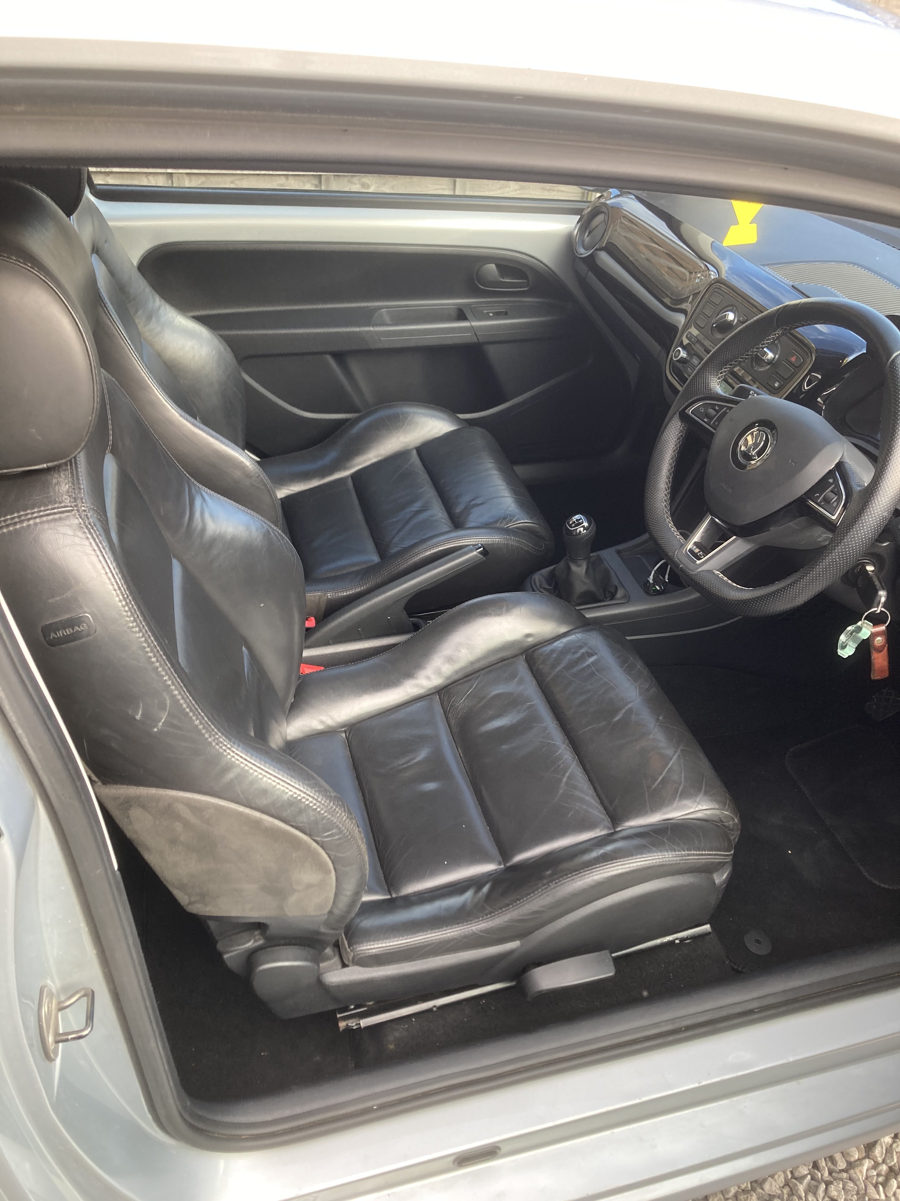

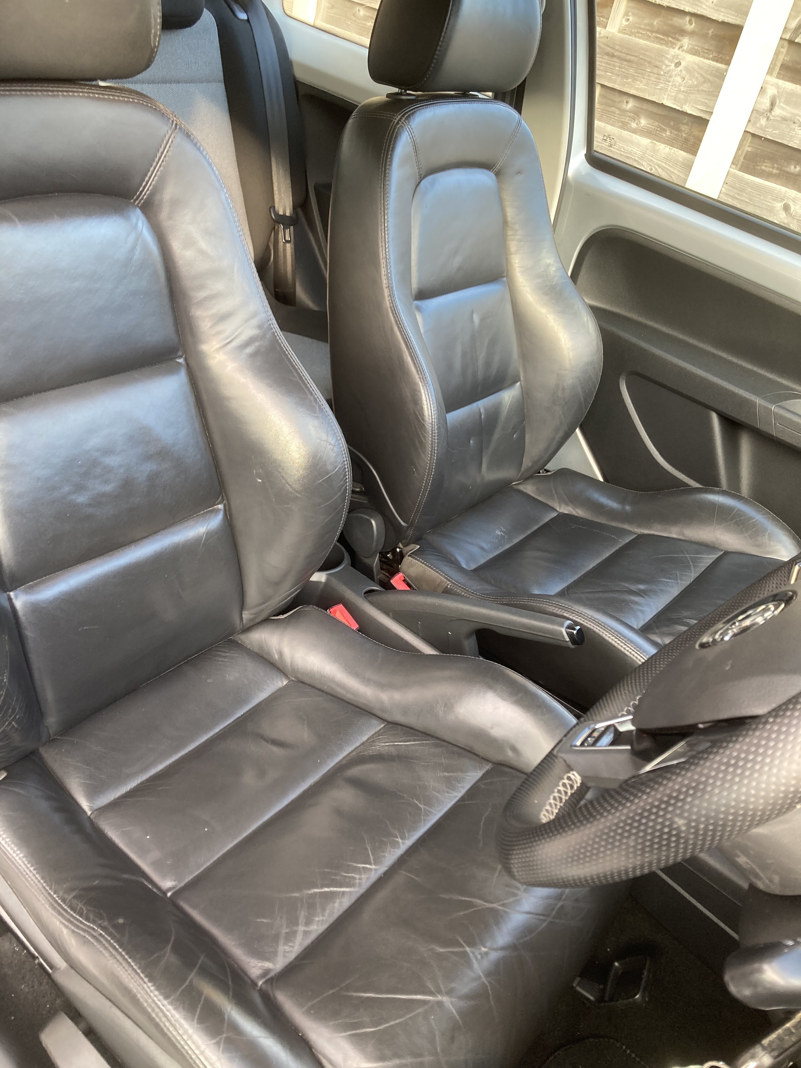

Some more pictures of the seats, I’ve made them plug and play with airbag connectors, the passenger occupancy sensor was swapped over to inside the TT base, and seat belt buckles also fitted from the citigo seats.
the TT mk1 seats i have fit before into a mk1 Fabia so remembered they were thinner then the usual late vag fitment.
I will get them retrimmed at some point but we’re a bargain for £80

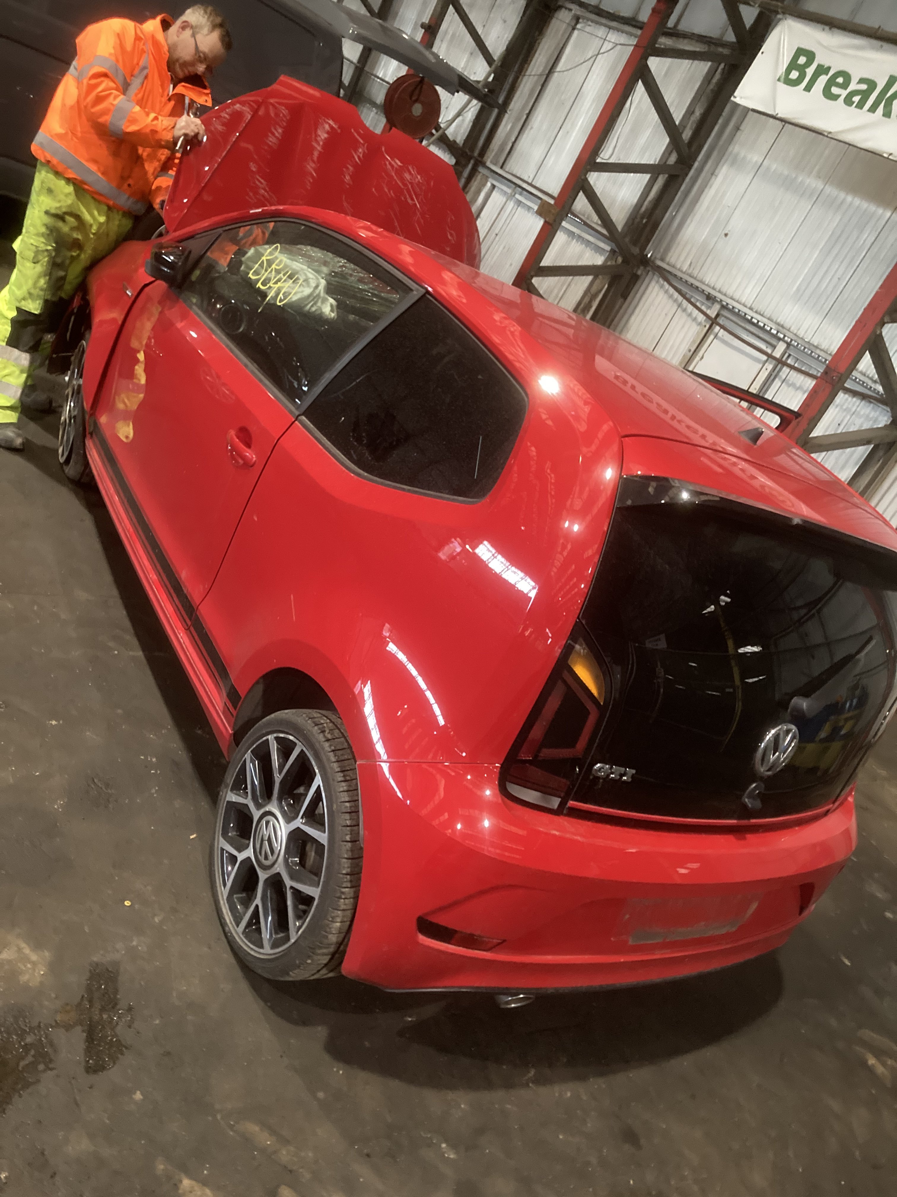

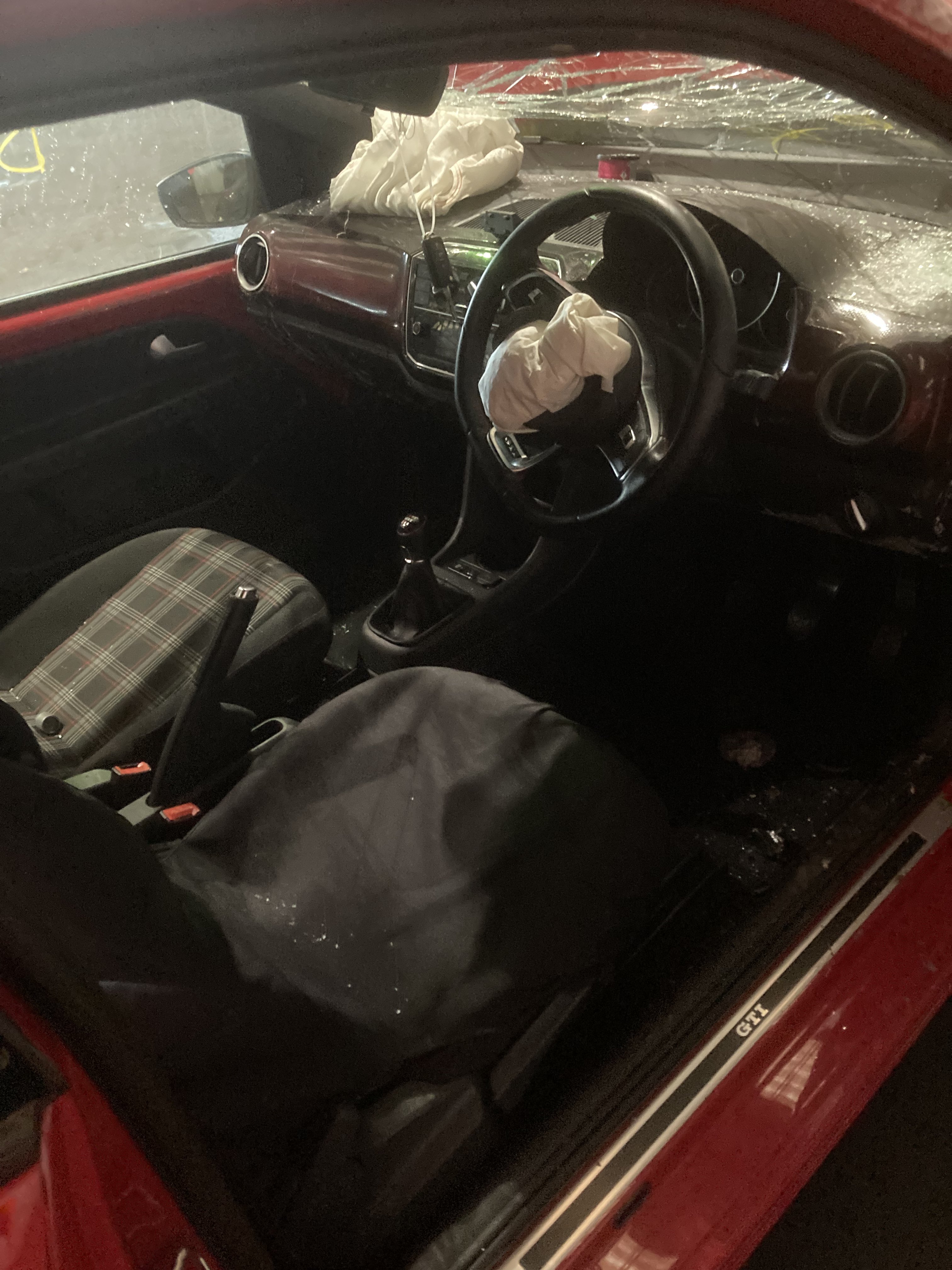

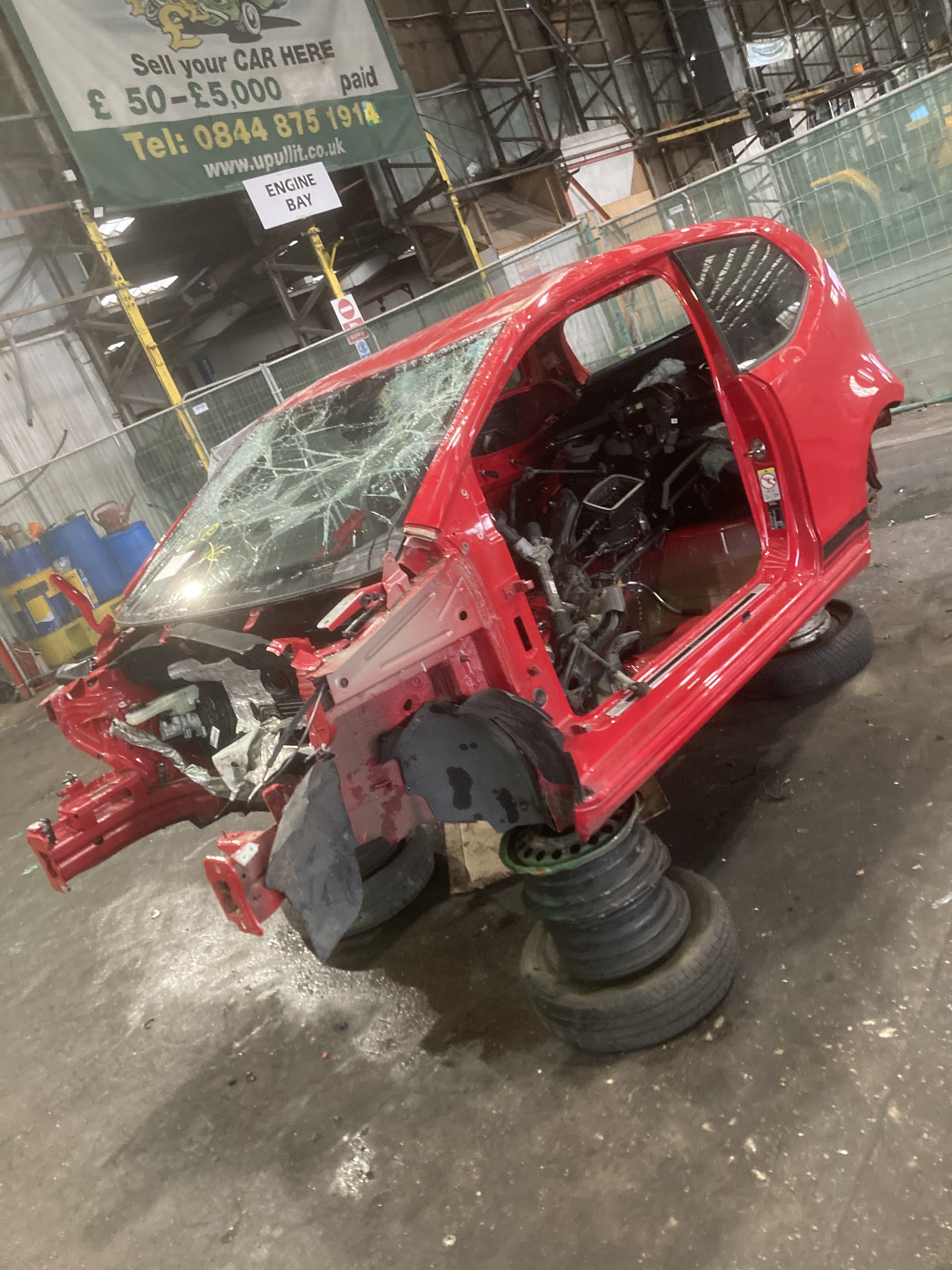

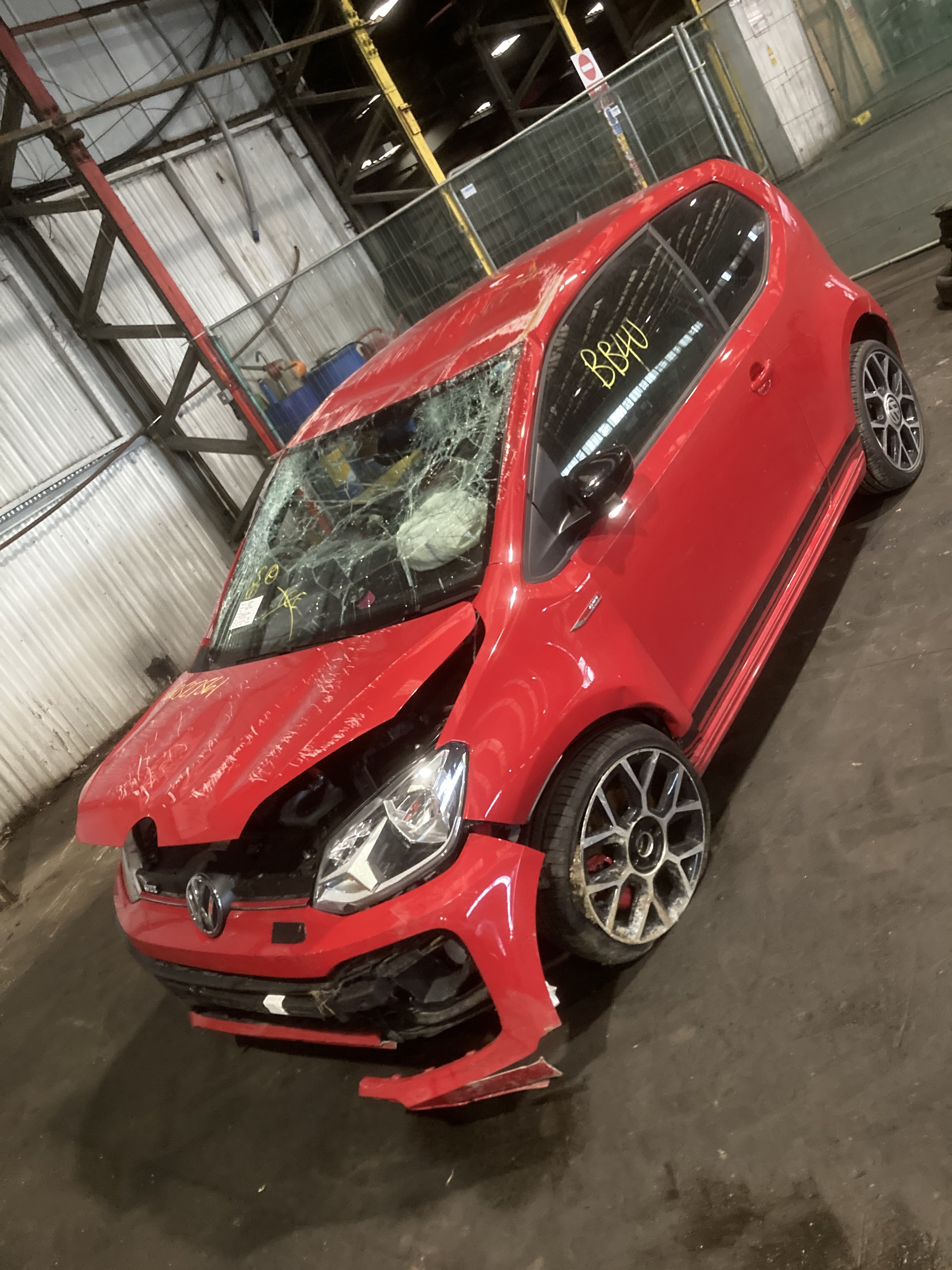

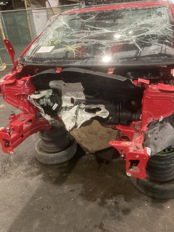

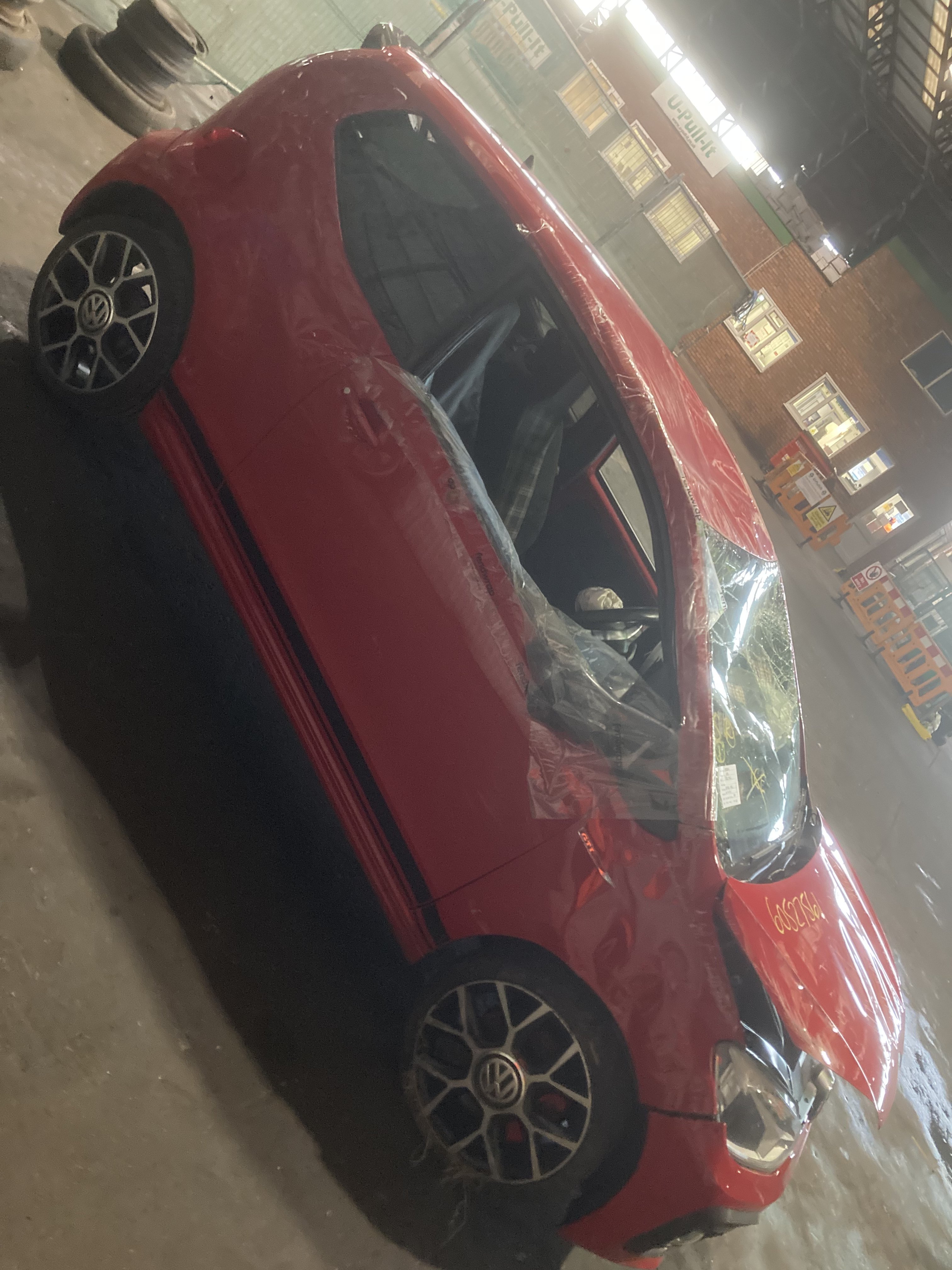

Today was the day for stripping the doner cat b I purchased
All in all very pleased the rad pack was unfortunately bent and beyond saving but engine and box look good, I just need one driveshaft at some point
To this

Couldn’t keep the shell as it’s a cat b had to be scrapped.
I’ve got the complete wiring loom front to back :)

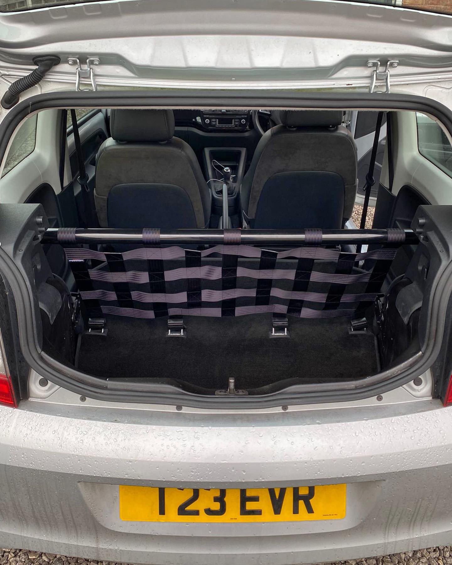

Sneak peek at stern performance rear seat delete kit
Stern performance rear seat delete kit fitted 32989652-06F6-49EF-9716-D0E6943F89CE.thumb.jpeg.5fe1d62d58d0ed5f226b4b474b5c468e.jpegA7CD178E-D7B0-468D-8767-BD9D4C2DCACF.thumb.jpeg.55cb3d0d7b433fff5a7ee9dfd2b092a2.jpegA10AF2CB-2AAF-4828-AEE1-E7295AB7EA20.thumb.jpeg.e6565739375b591dc0e292e1eea08144.jpeg21FADA8C-948C-4E38-BAD8-6C7F5C5B46D5.thumb.jpeg.39f80294981e1f53e5e23410ecae2f8e.jpeg

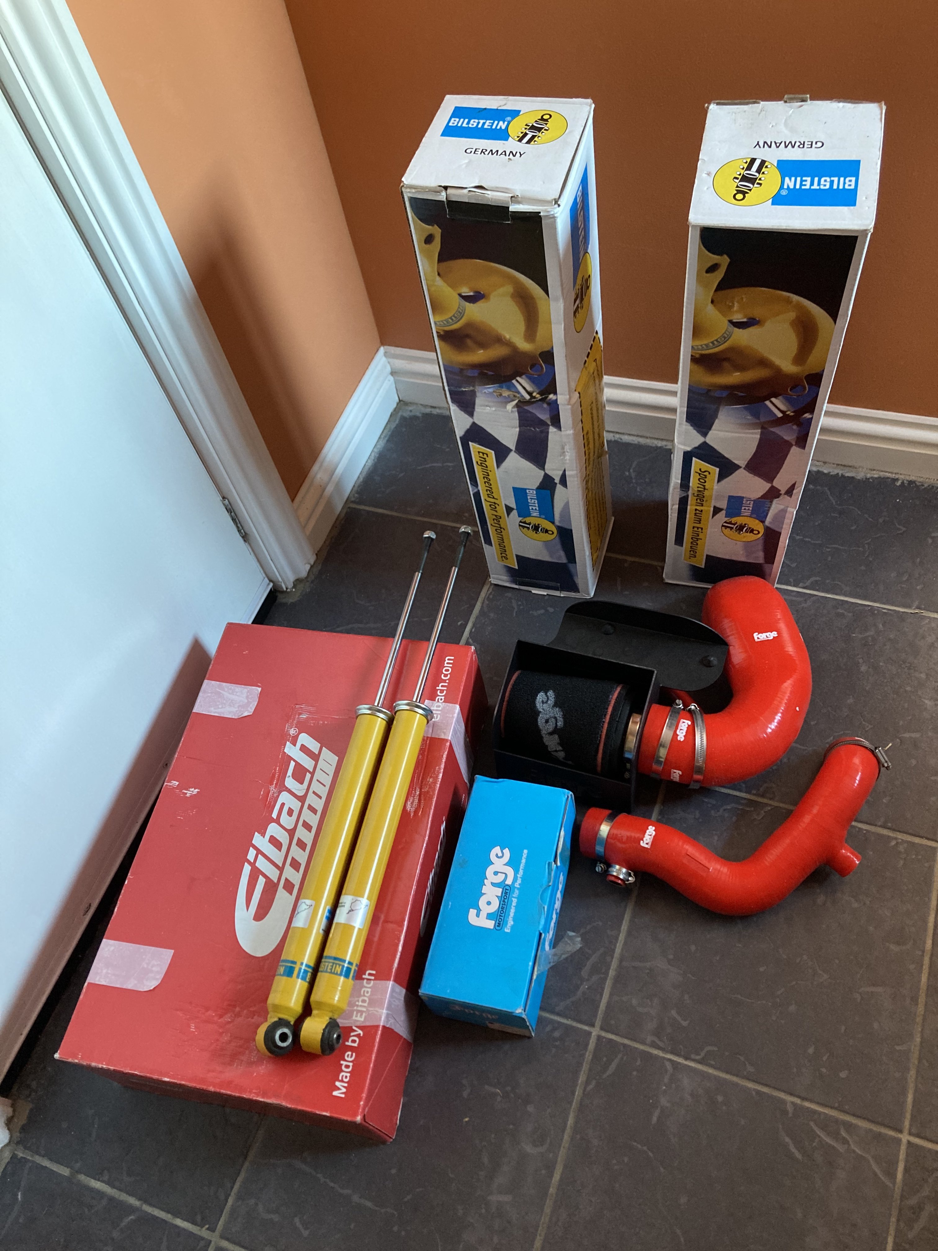

Brought myself some Christmas pressies,
some bilstein b12 shocks and Eibach springs combo, and some forge goodies for the engine,
going to see if I get a chance to do the suspension soon if the weather stays mild, and if the gti brakes clear the alloys

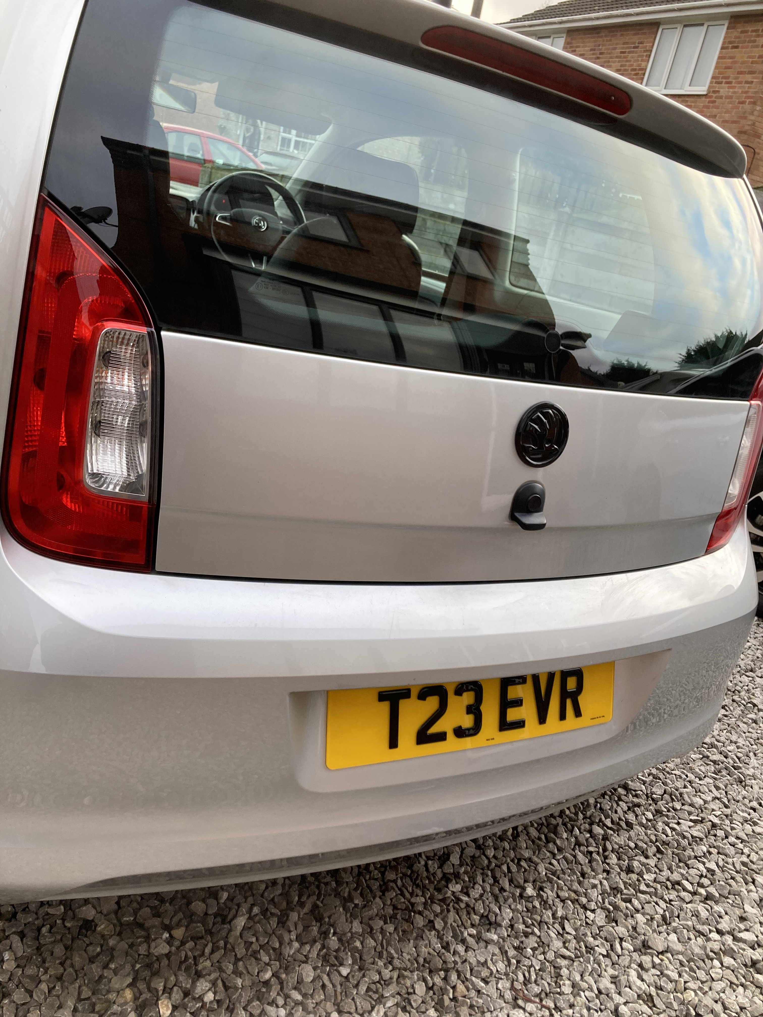

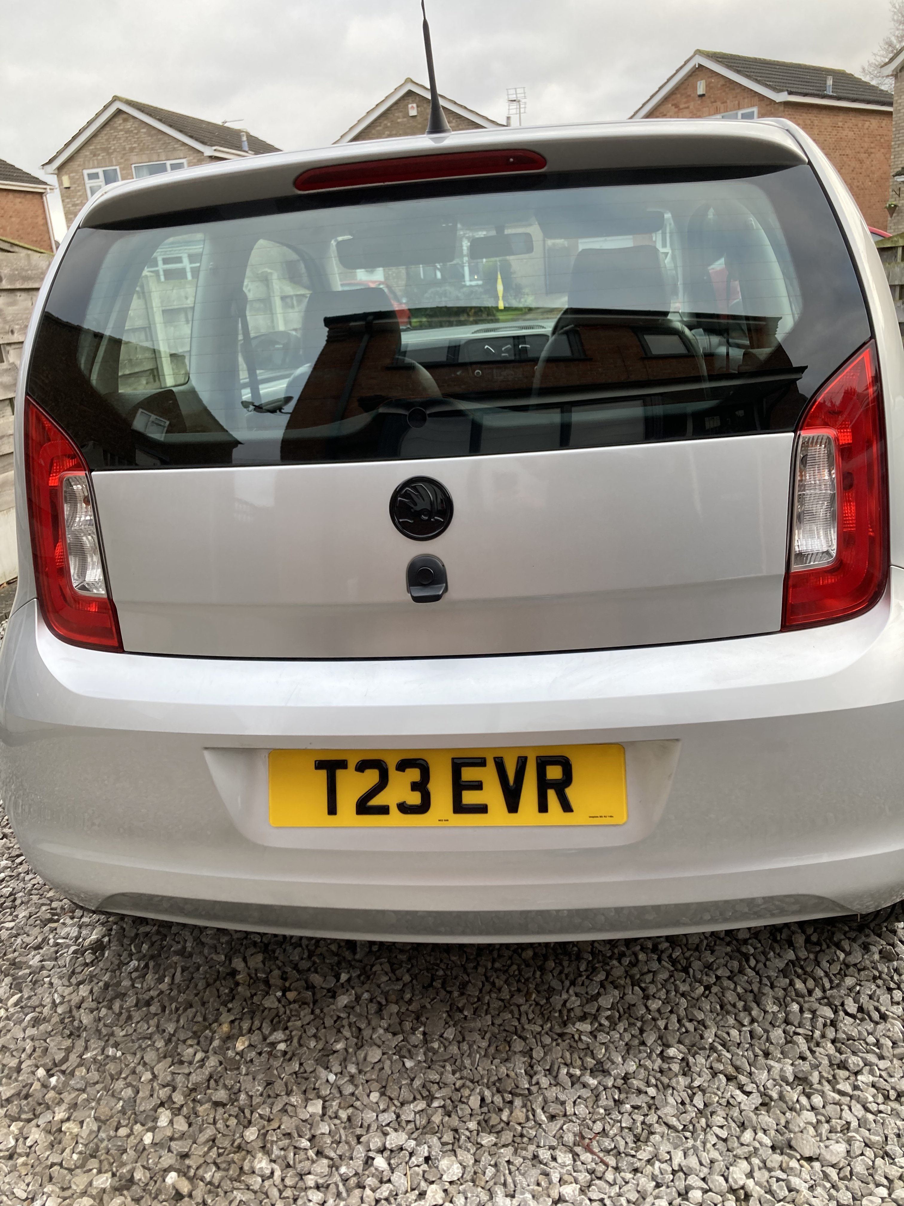

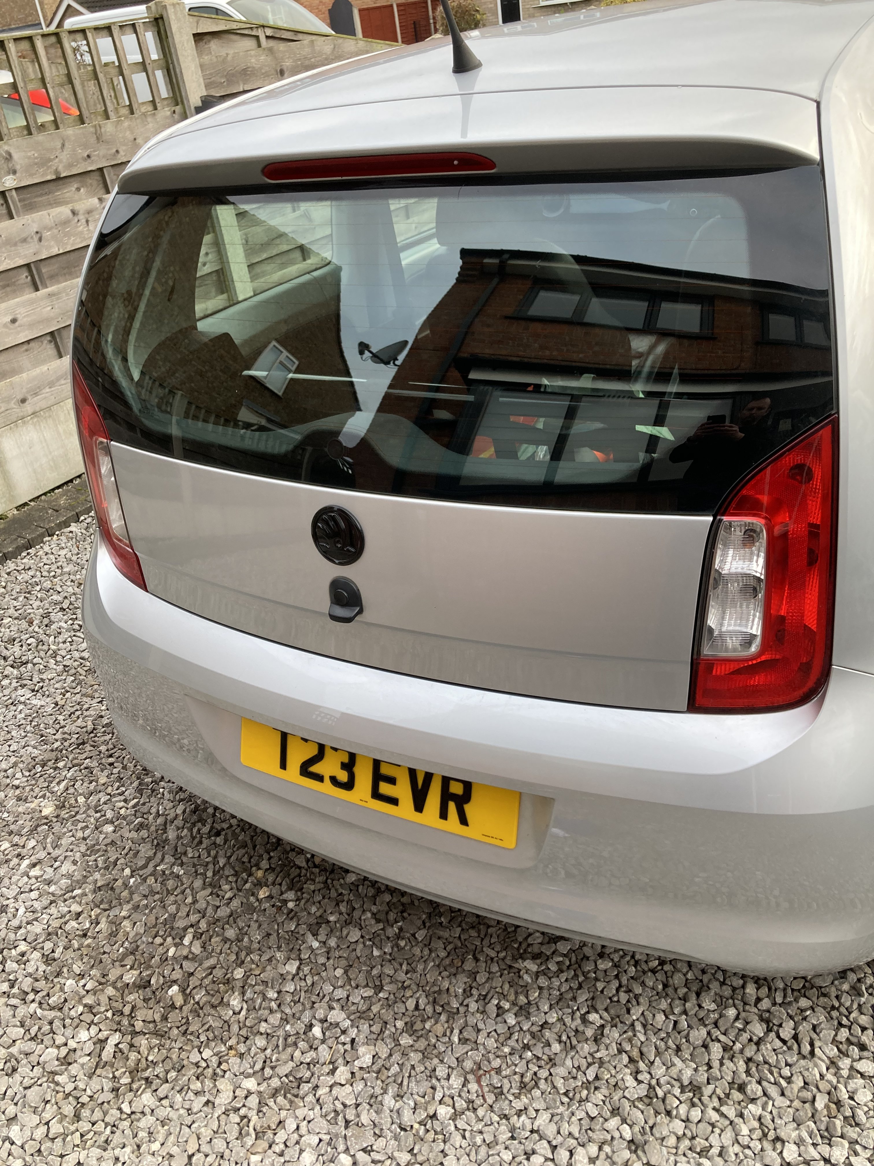

I finally got my rear wiper delete on after not having it on there since I’ve had the car,
the rears going to change abit more eventually with a gti rear bumper and then facelift citigo rear lights. I debadged the rear a while back with the gloss black Skoda badges added
