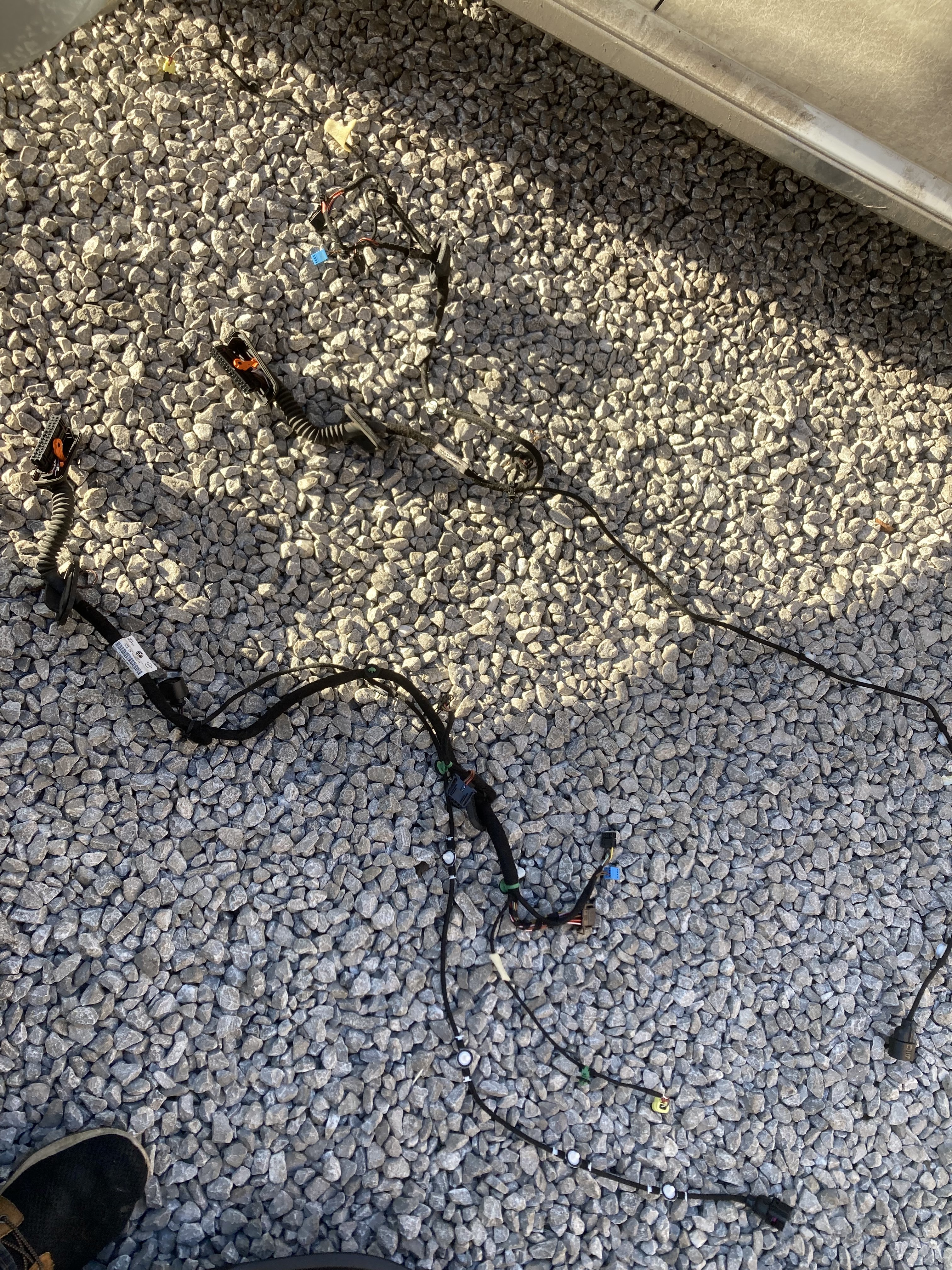

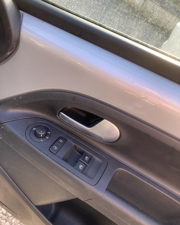

Made a start on sorting the door wiring looms.
the standard citigo only comes with single electric window switch and manual mirrors.
the up has the facelift mirrors with integrated indicators, electric and heated.
and the double window switch
with a nice brushed ally handle on the trim.

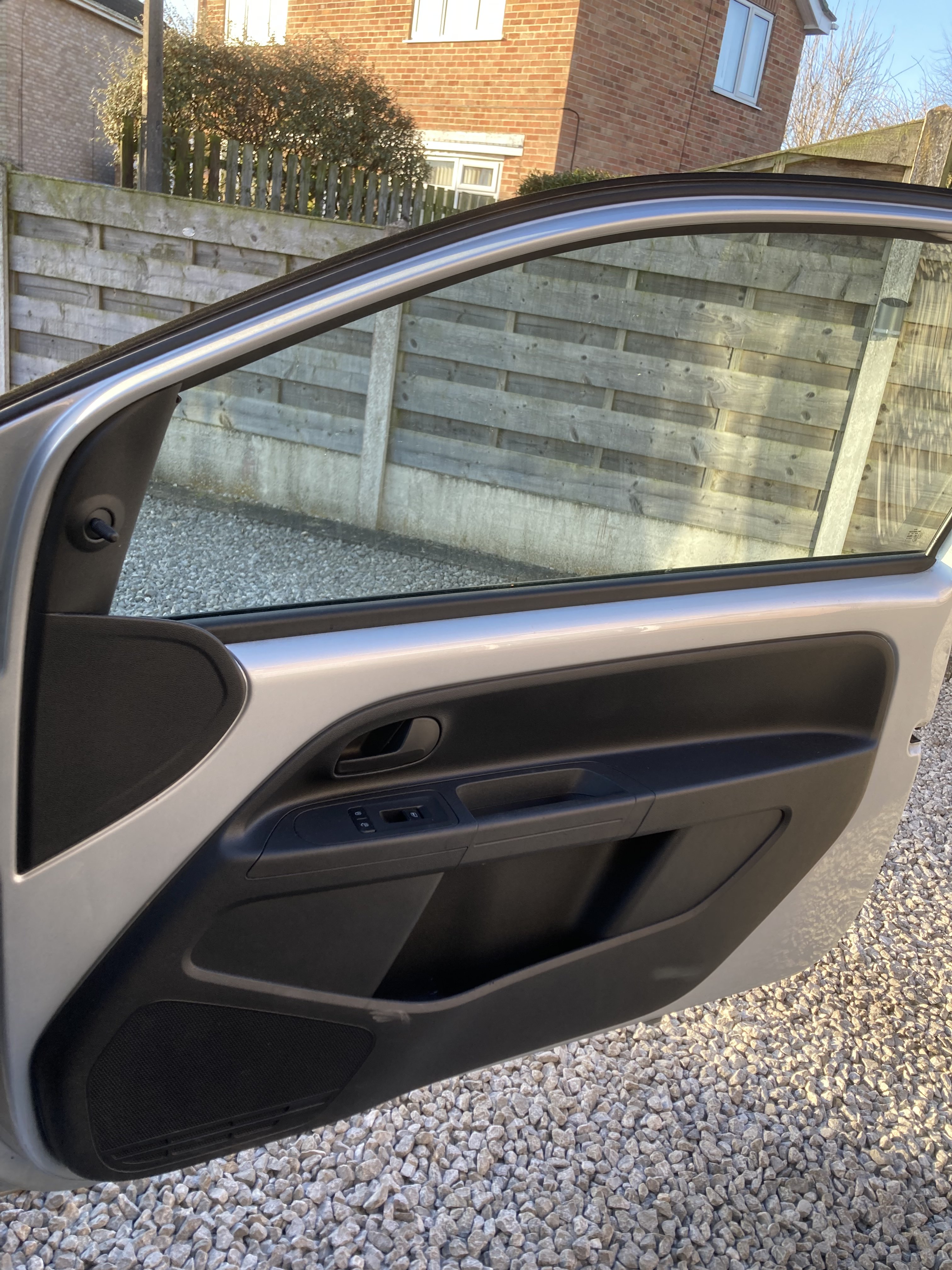

Standard door
so stripped the door open to remove old loom and refit the gti looms
5030A3E7-87FA-48A5-8A7A-2C6895B81F9A.thumb.jpeg.f45668c85a8205f14d71fa23f1c935a2.jpegA606F894-D7A2-4F0A-95CD-8474E5272D55.thumb.jpeg.efdc746eaeb7d069950c54a7b2bc68da.jpeg
as you can see a much more substantial loom with loads more wires
Finished product just needs a good clean
E3116874-D7AF-4CEA-AED9-495F6B3CC50C.thumb.jpeg.17fec7f98865fe5d7015ec86b21dae97.jpeg1ADD3195-0213-43D0-A5BC-A1EDBBF87113.thumb.jpeg.0769b2a32e586b1b4d72ab4472aa3e3b.jpegEAE1F64E-A06F-48FC-B2ED-1C7AD2F843D2.thumb.jpeg.d4df9f1bd6976aee6c35d4bf5a5fb4ec.jpeg

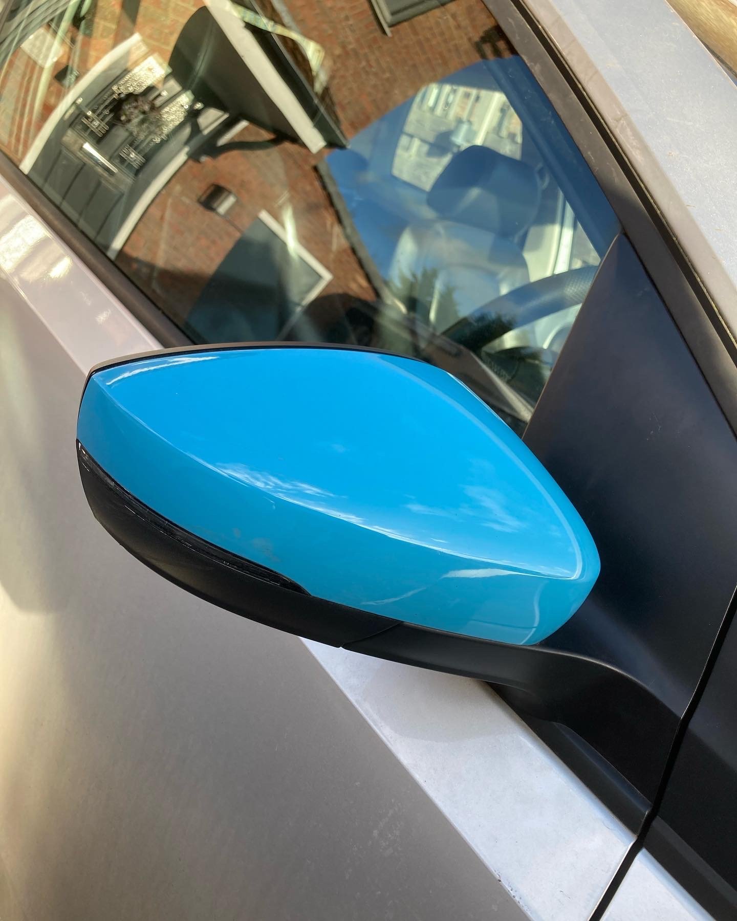

only had one good mirror from doner hence the blue other side. Was surprisingly hard to find an electric and heated one. I’ll change caps shortly when I find one
You could try Jas at CitigoParts, I'm sure he'd have a black cap in stock

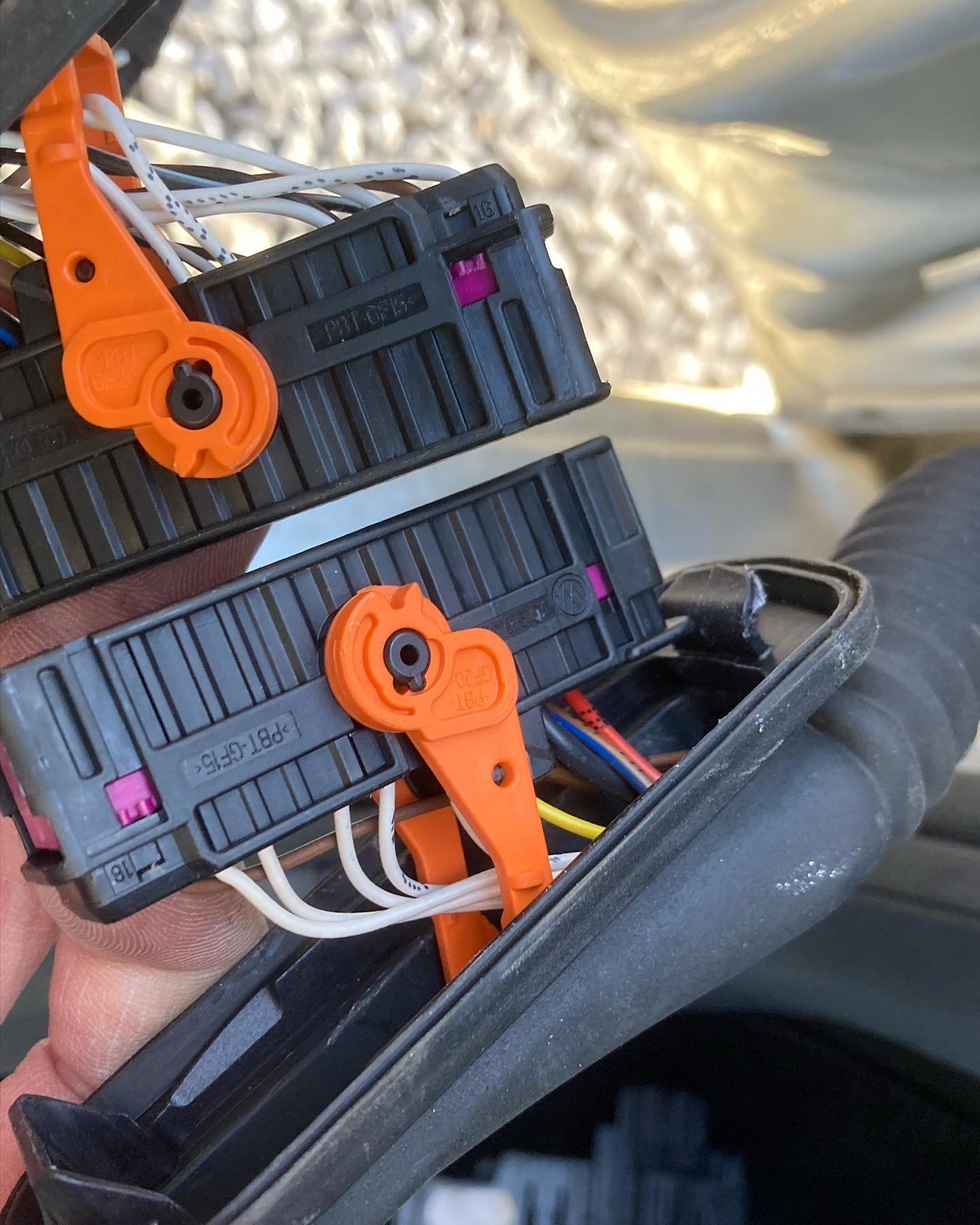

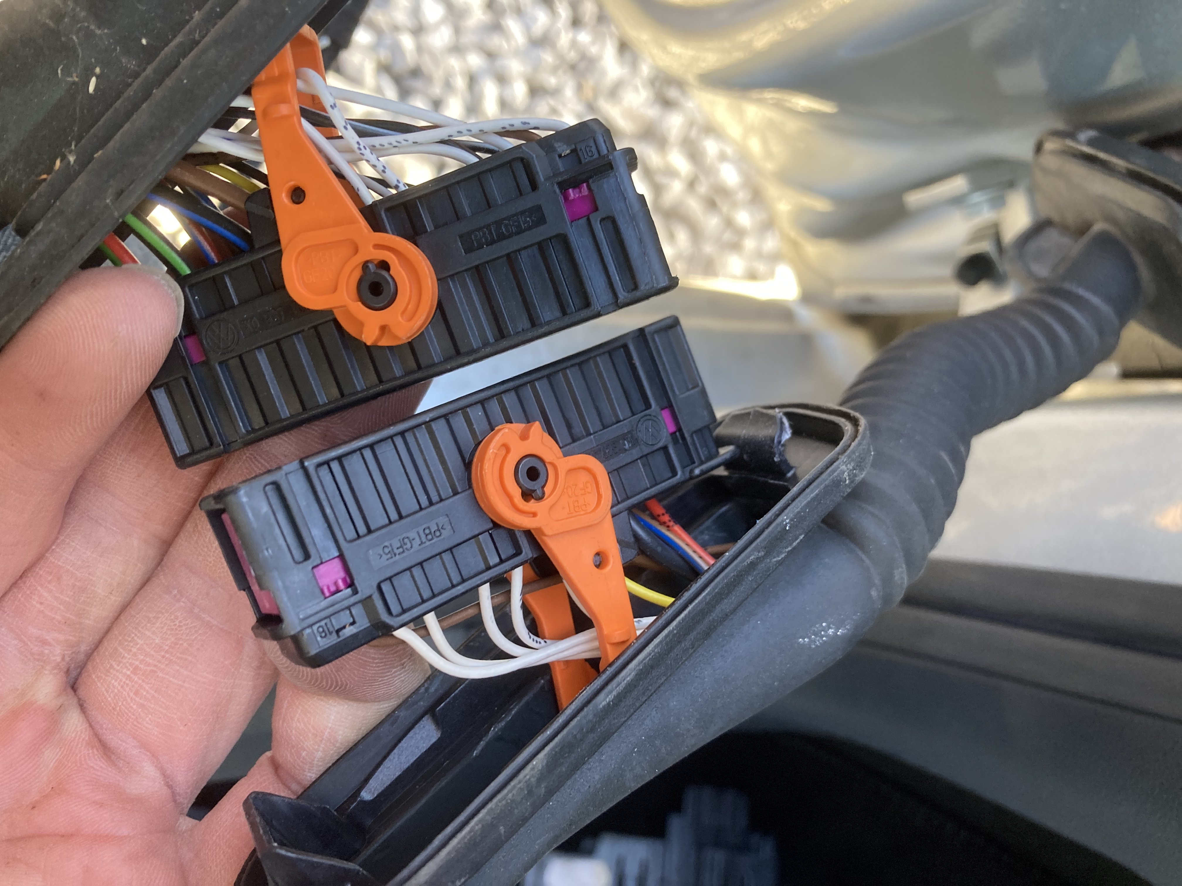

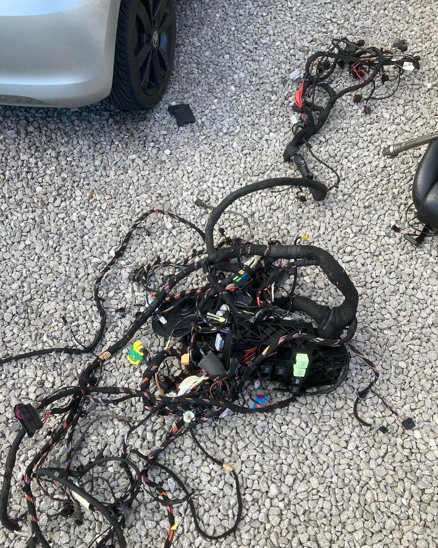

After you had installed the new loom did the electric window and central locking in the drivers door still work?  Reason I ask is that I have a door loom from a twin window switch Citigo that I want to swap into my drivers door. I know the passenger window switch will not function without some additional wiring across to the other door.
The central locking still works but windows do not, must be a few wires in different places coming out the door. Obviously not a major issue for me as I’ll be changing the rest of loom to match in a month or so
Will have a closer look at the plug and compare with the original one and hopefully it'll just be a case of repositioning some wires and running some extra wires for the second window switch.
bottoms original obviously a lot more wires in new one as it gains electric heated mirrors with built in indicators too, and the double switch.
Im sure it could be worked out with wiring diagram

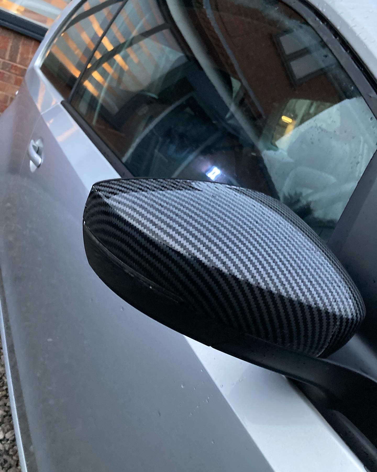

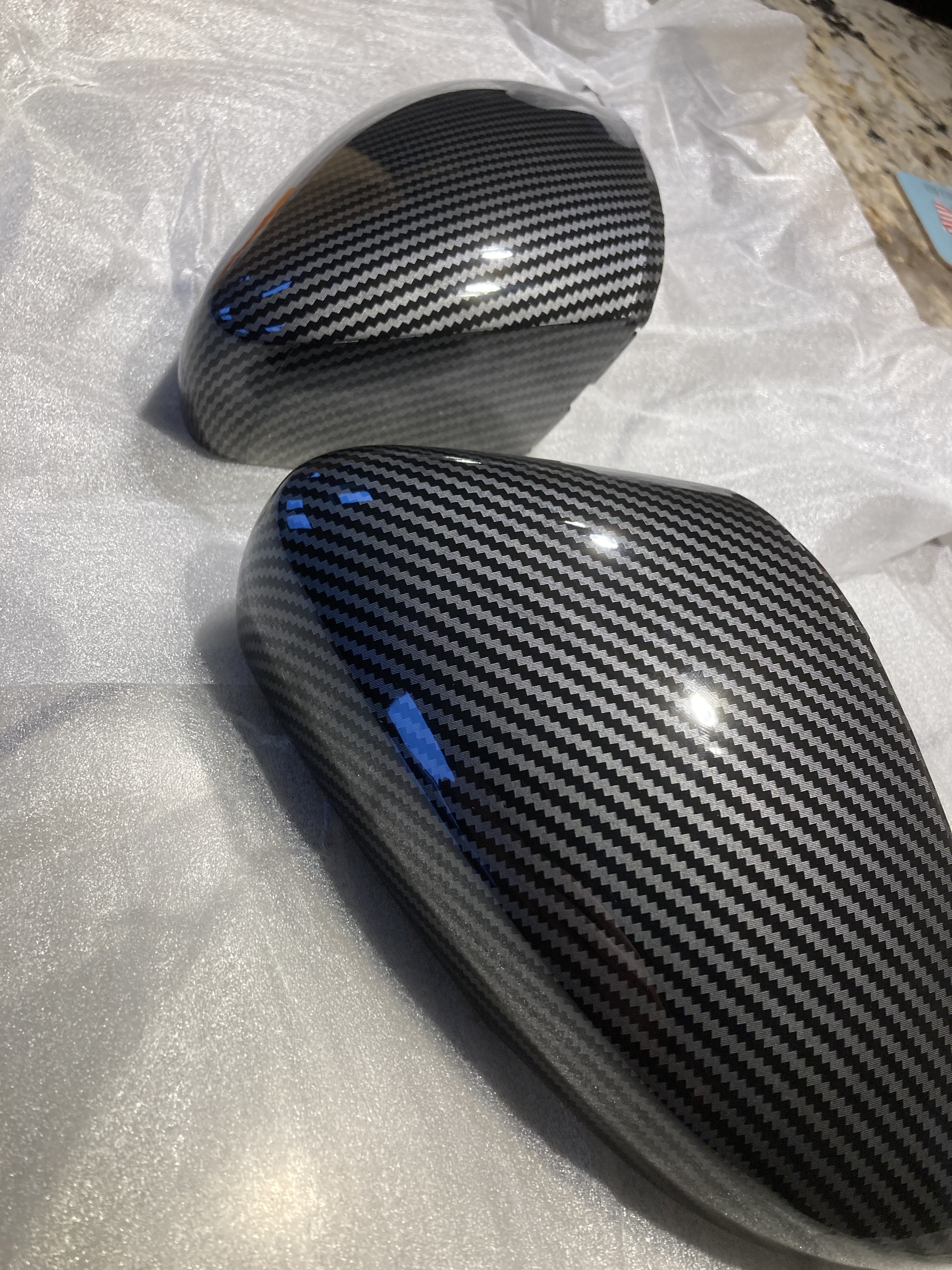

some fake carbon mirror caps only as they were cheaper then buying one black one lol

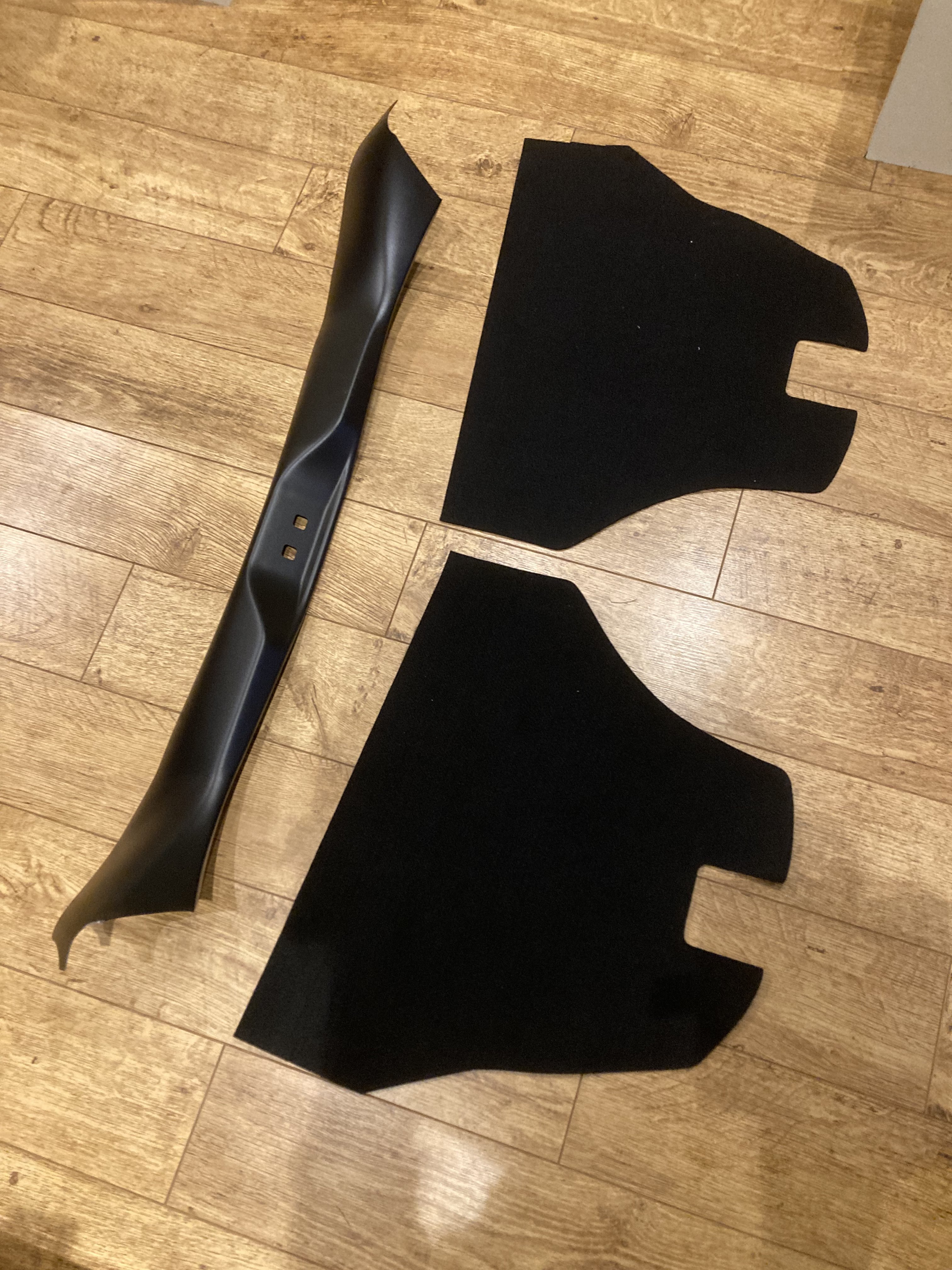

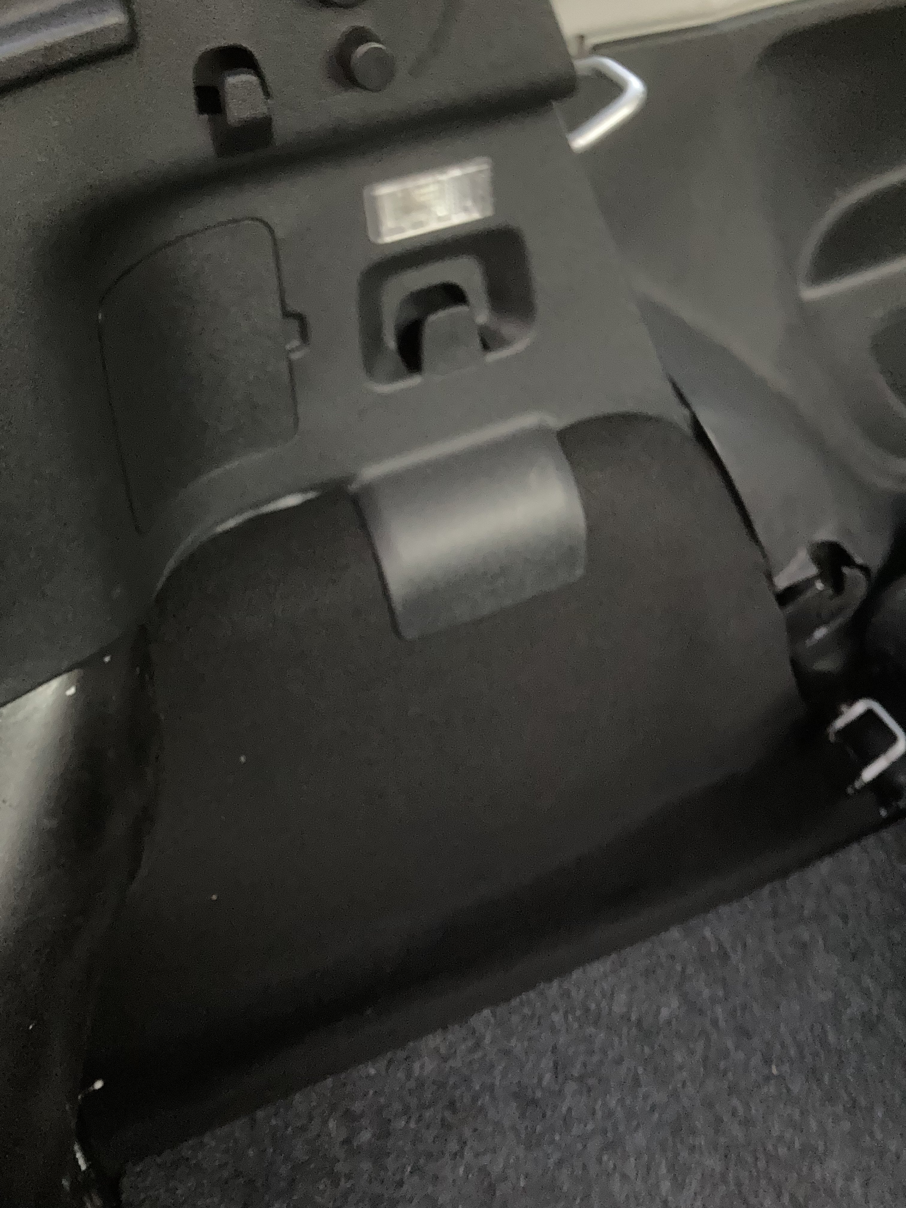

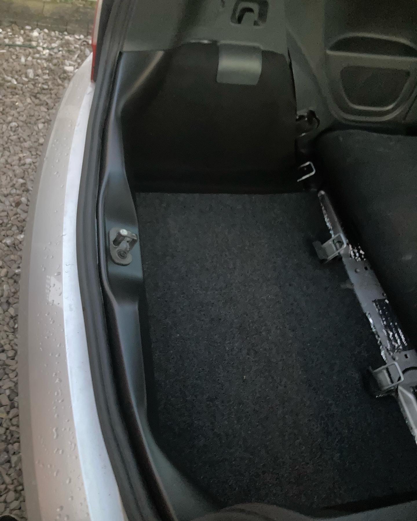

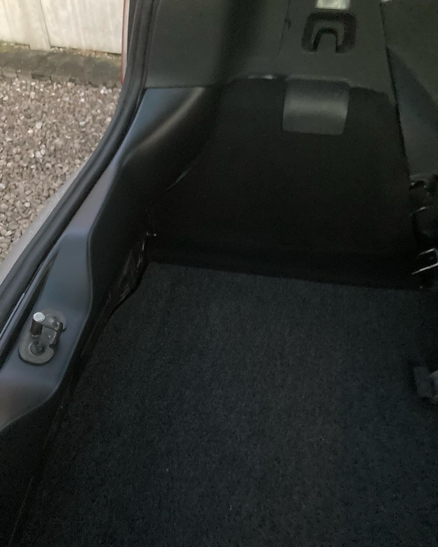

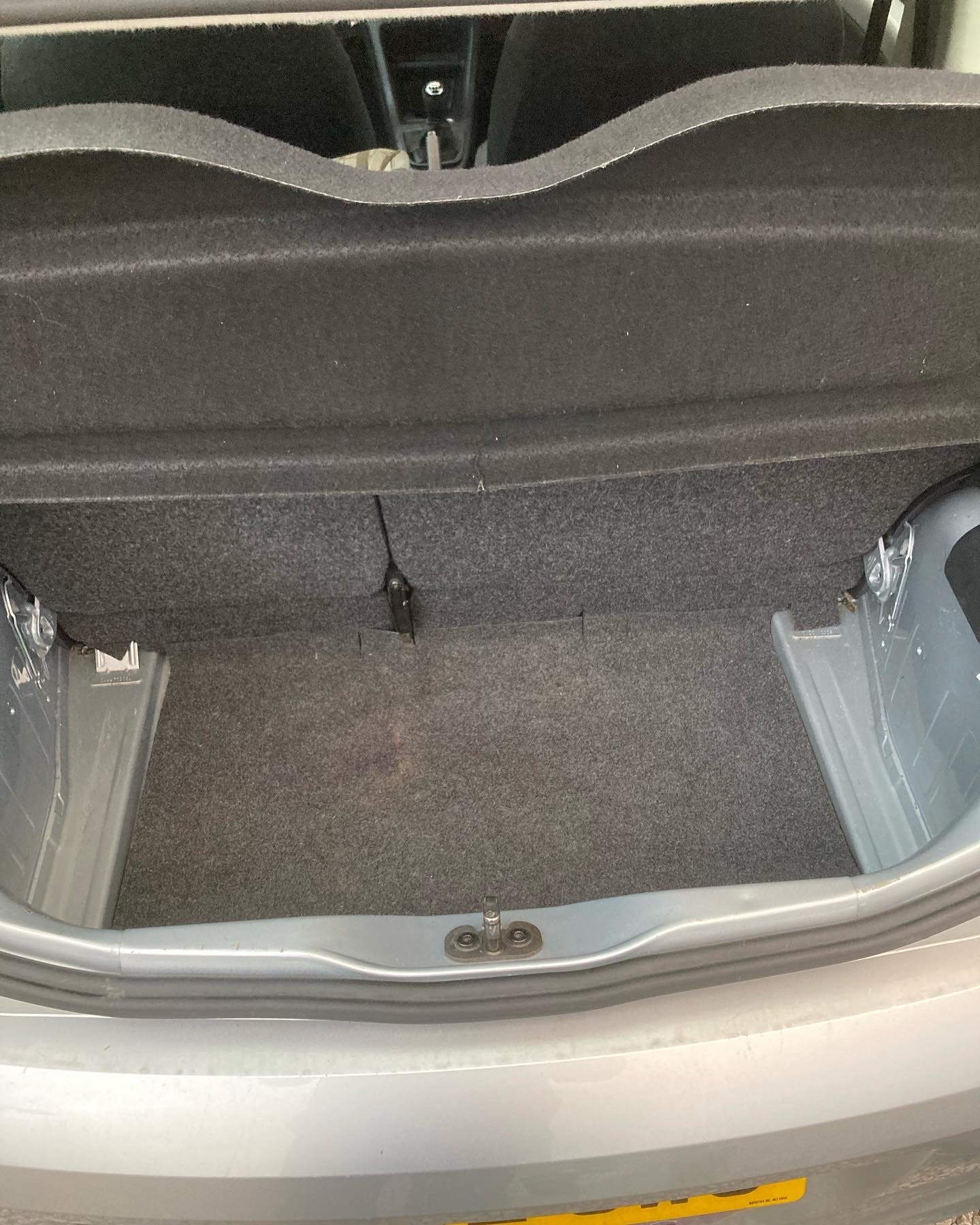

and also some boot trims to get rid of the bare metal back there, something it should have had from factory :)

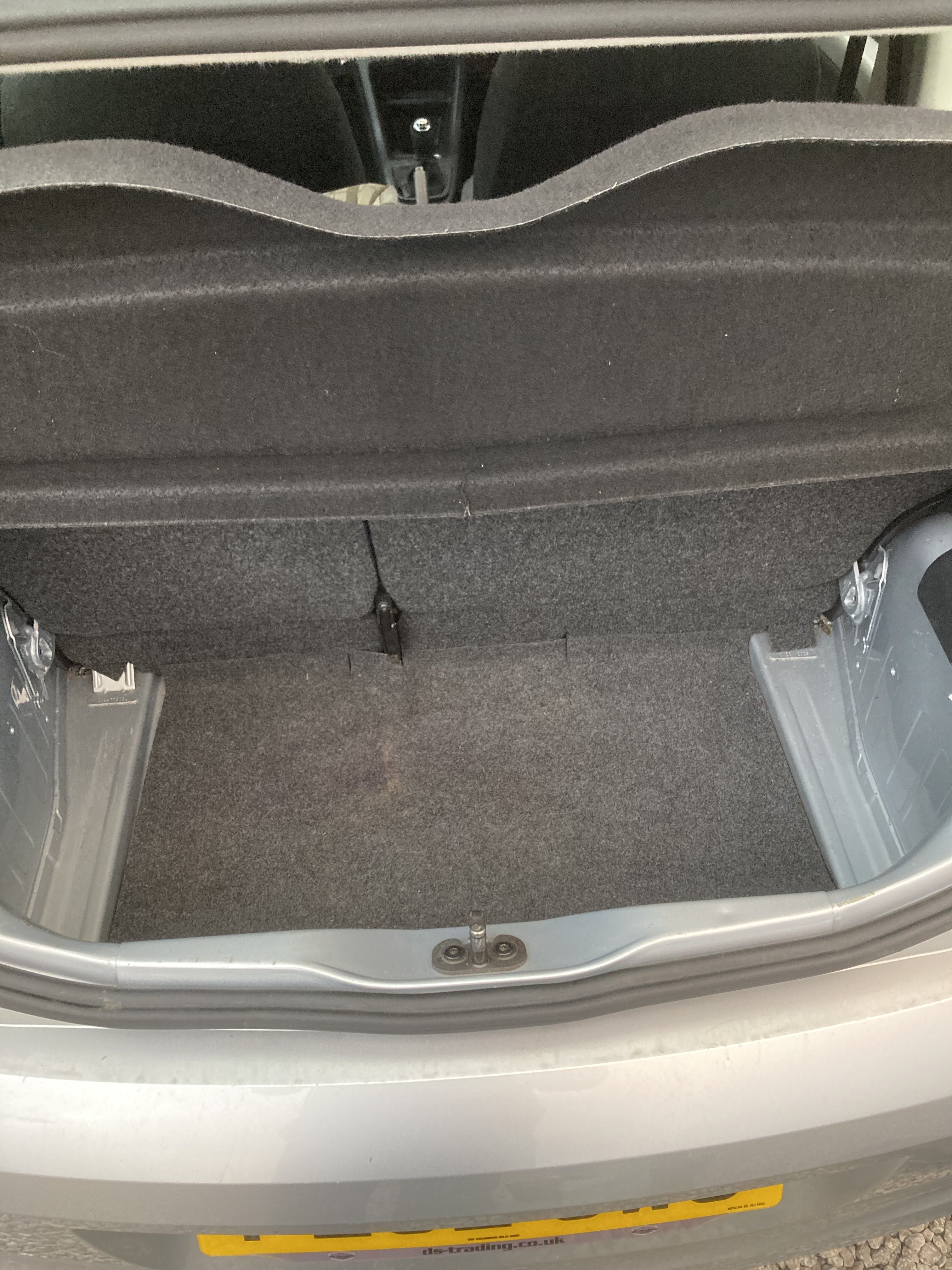

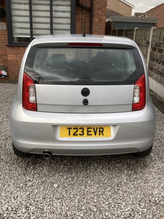

How a normal citigo boot looks

Fitted the trims was getting a little dark, fit is pretty good but could probably do with some spray adhesive too, I added extra double sided tape to the stuff that was on it already I’ll see how well it holds.
before
after
966284F7-1DC2-47A4-A275-DD5449991FFA.thumb.jpeg.bf9752c667345becfd1ec33b919fb86b.jpeg5C1580AA-6D99-4166-9FA7-67DCDC1C9FCA.thumb.jpeg.257e8c1a38fa42b55d207277f83eb67f.jpeg53582FD7-1DAA-4280-8481-437C8BBBB058.thumb.jpeg.3b955ebe8e5a065630081b3c4c2476d0.jpeg

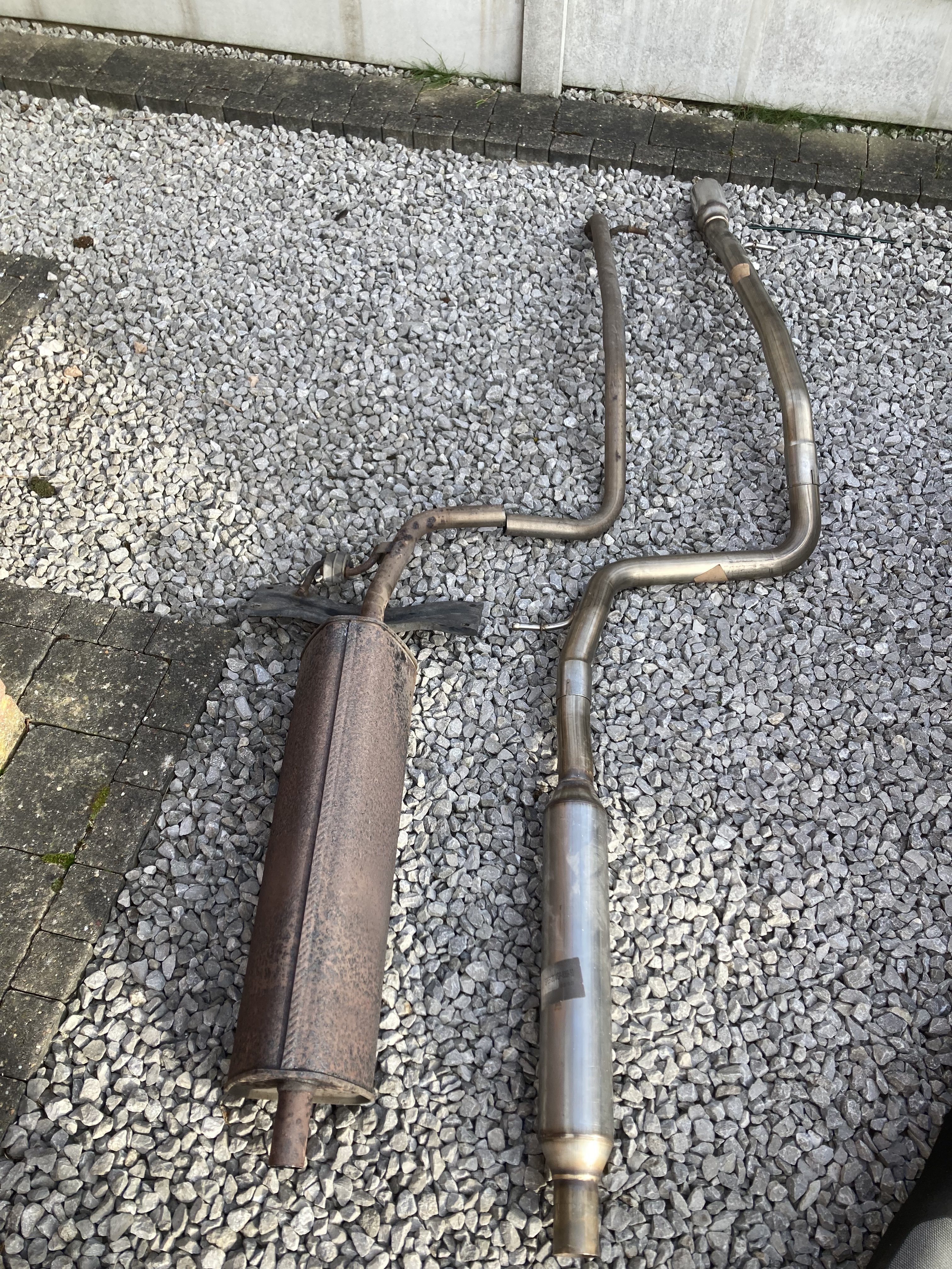

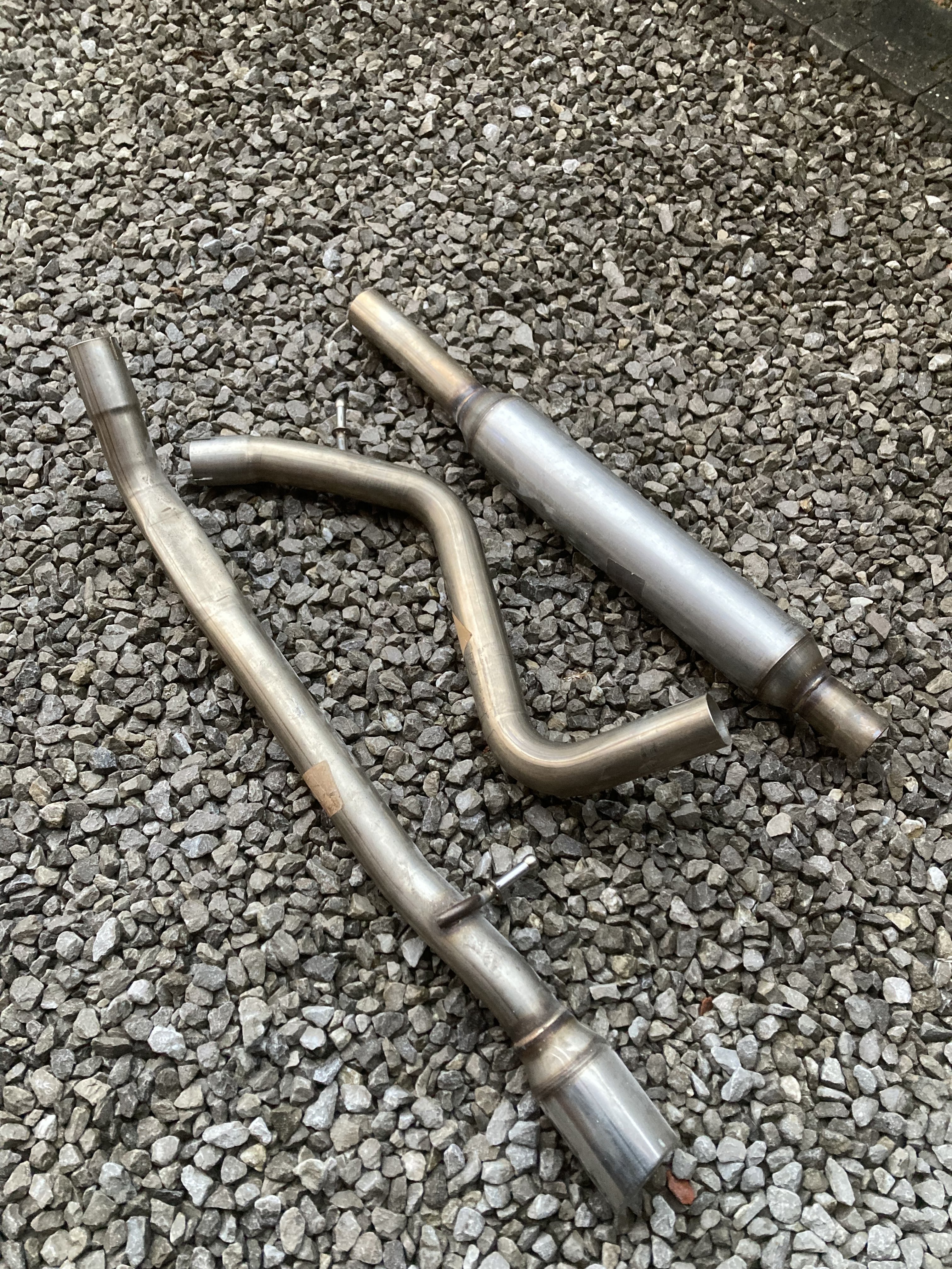

Also picked up an exhaust for when I stick the engine in, was a prototype from direnza and only used for a few hundred miles, was too quiet for its previous owner. Which is good for me as I don’t want stupid loud7951F4DD-58CB-4177-BE8E-58AE9823FC7C.thumb.jpeg.ad88ca54f3b0d291f8cea80269280c32.jpeg

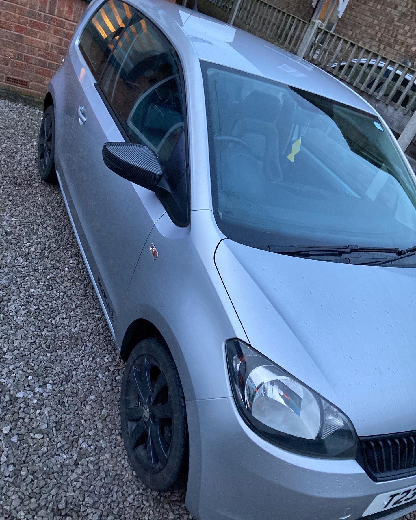

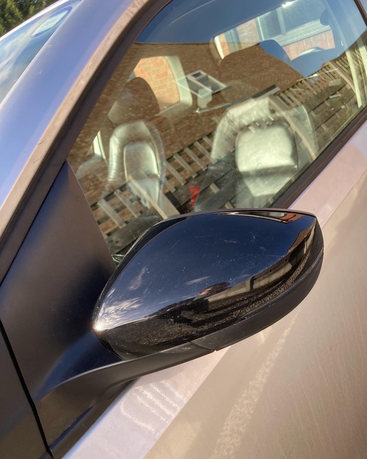

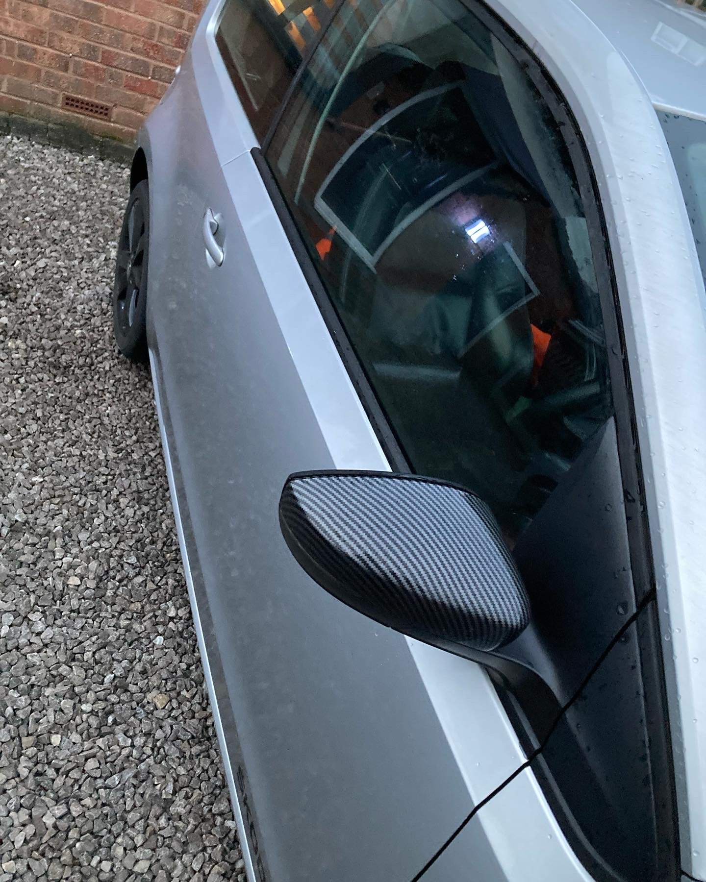

Fitted the mirror caps yesterday was too dark for pics so have a couple today, they don’t look too bad

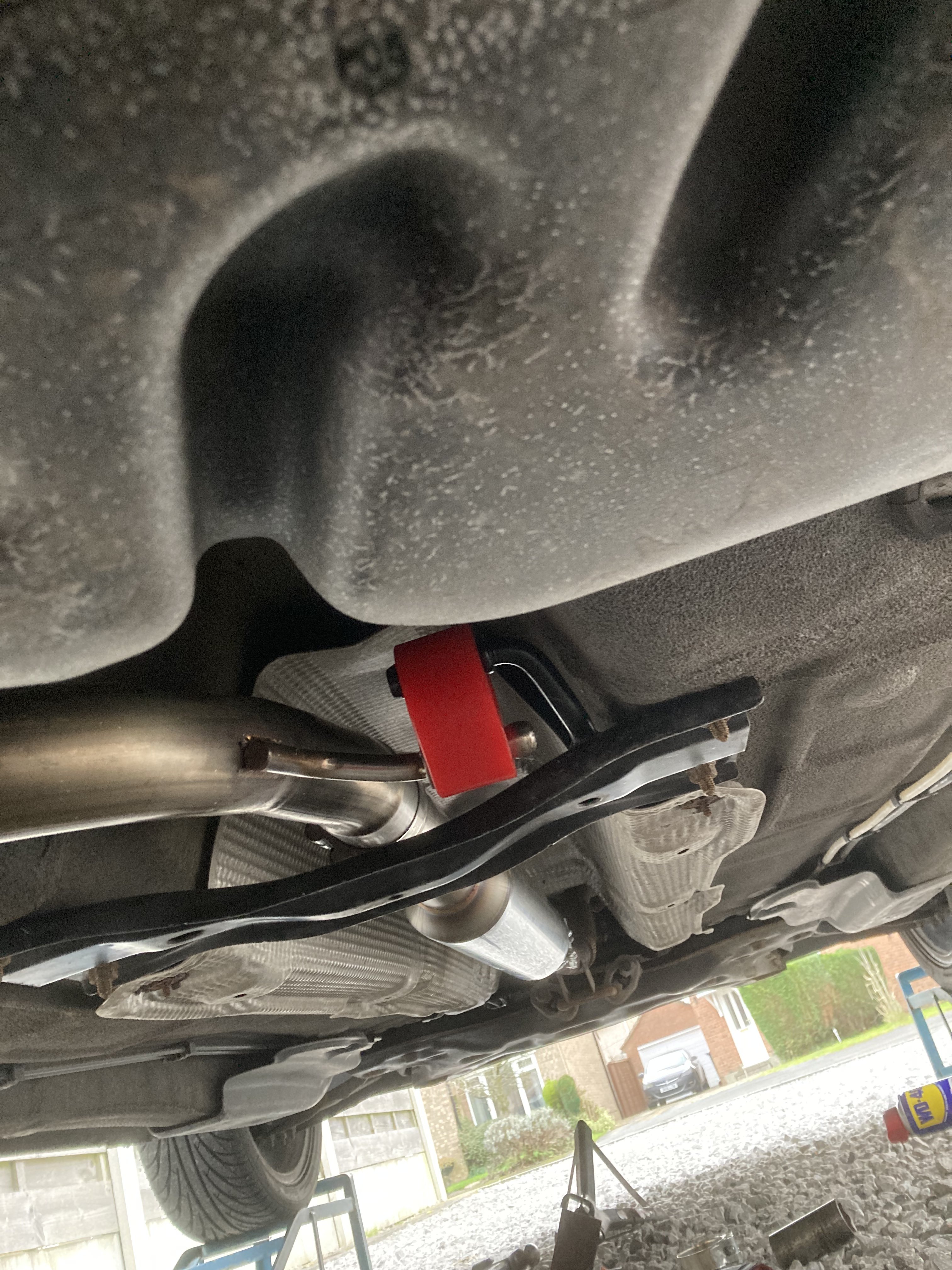

Fitted the exhaust today as I’m still trying to clear down what bits I can get rid off before the strip down, it’s ridiculously loud on an n/a engine as I was kinda expecting. Only need to put up with it for a few weeks before I start though so that good.
Hopefully going to get the gti bumper sprayed soon that’s next priority.

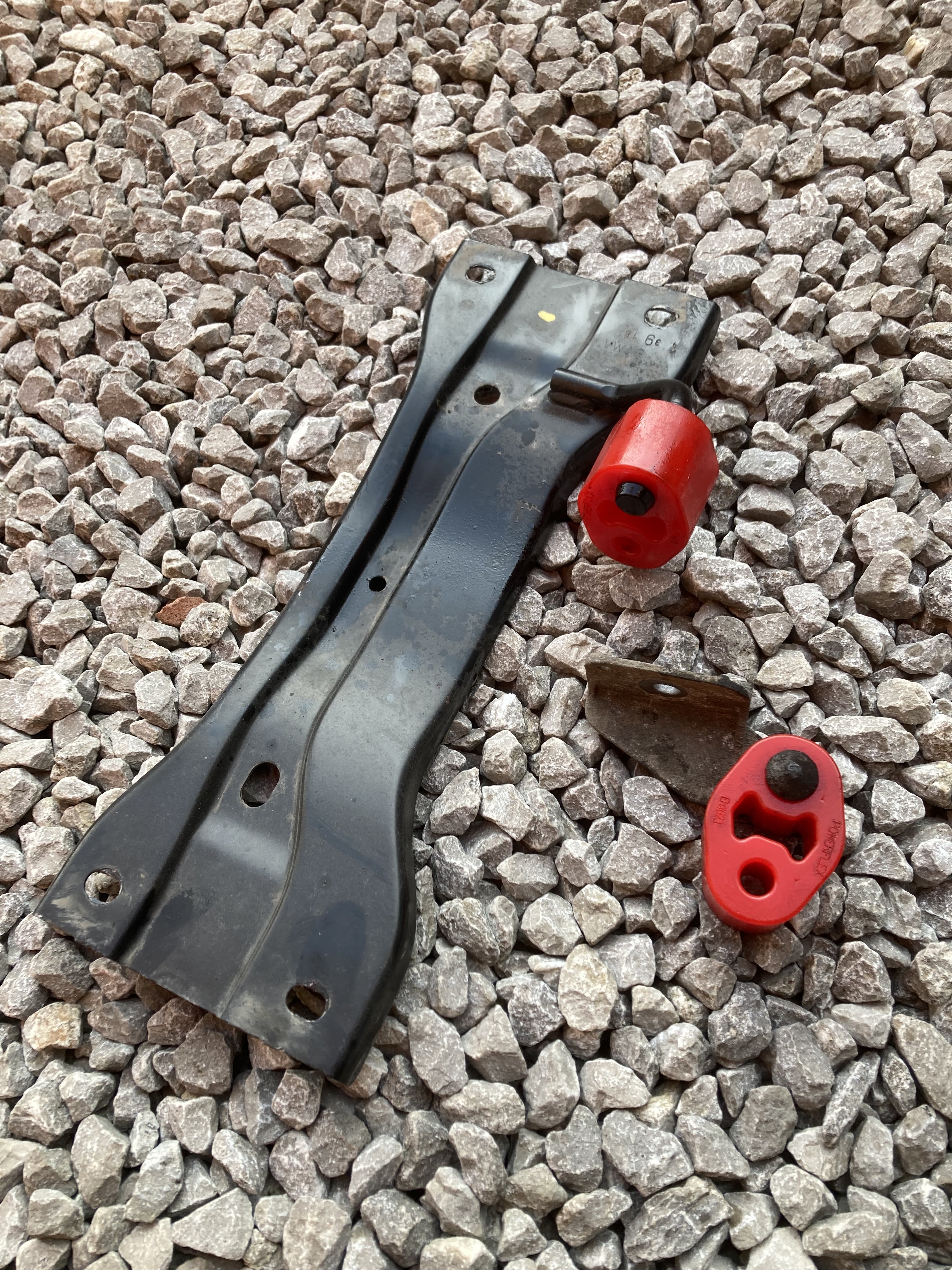

Fitted some powerflex exhaust hangers, and the crossmember from the gti too as mine was rusted.

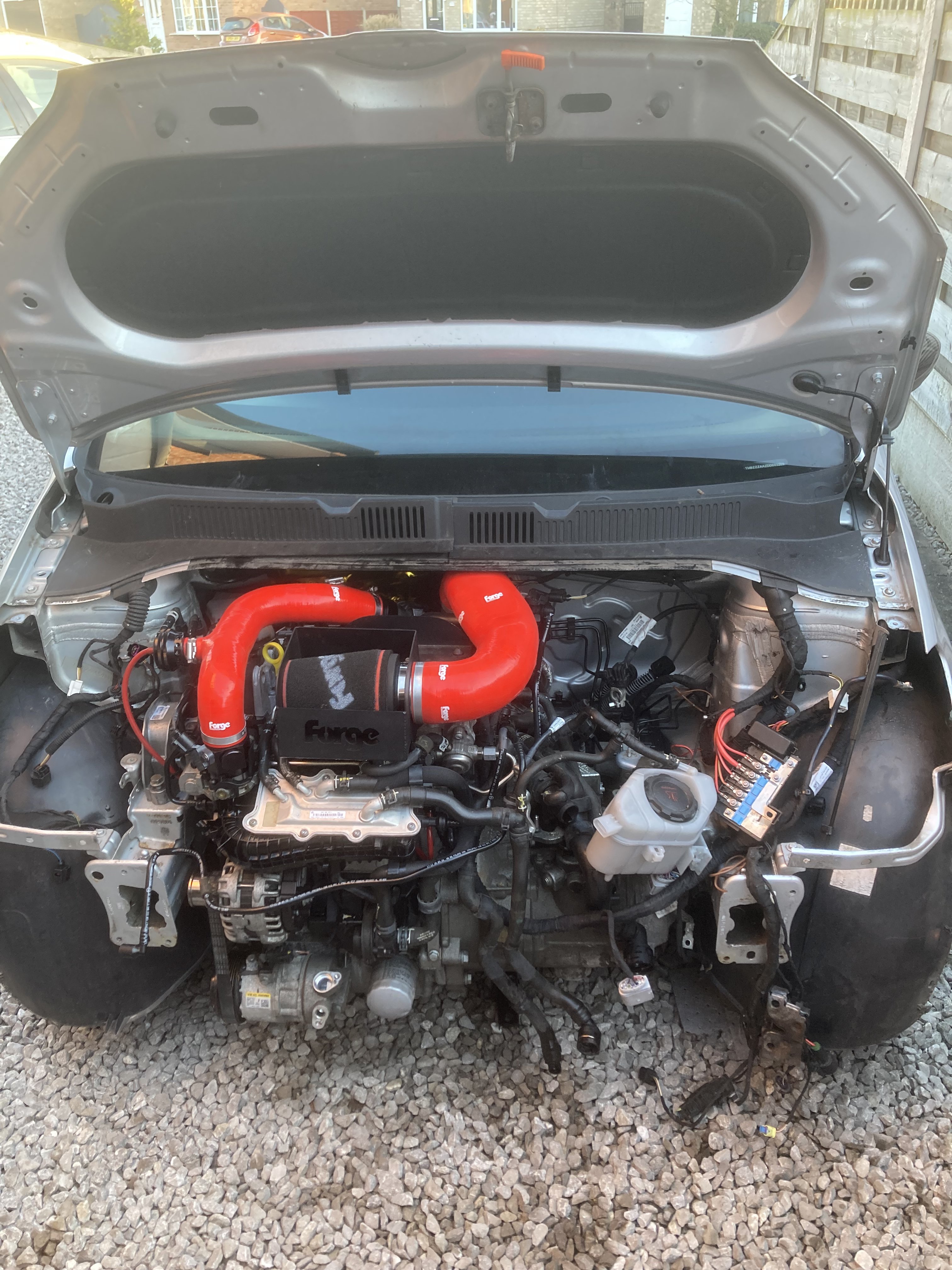

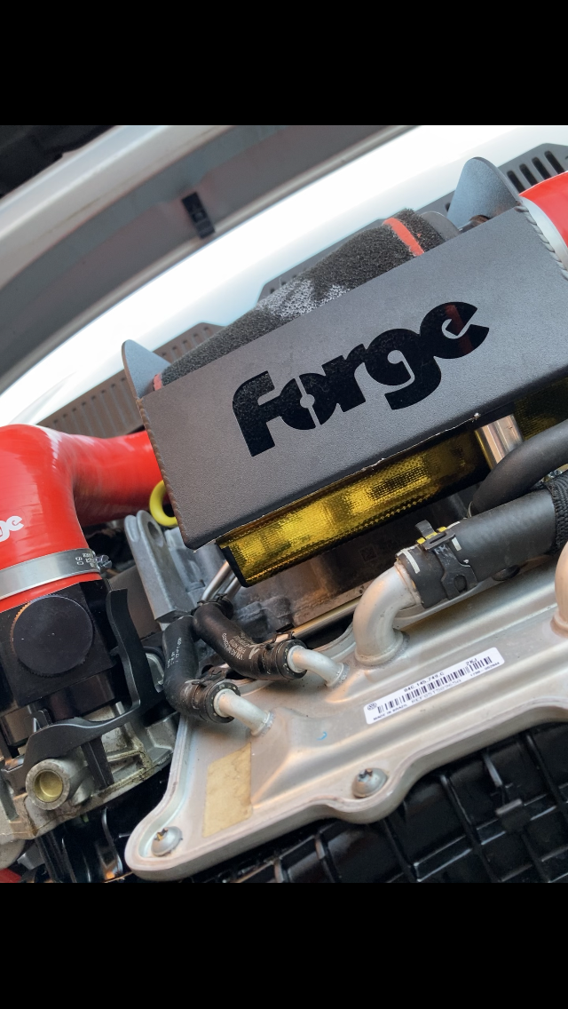

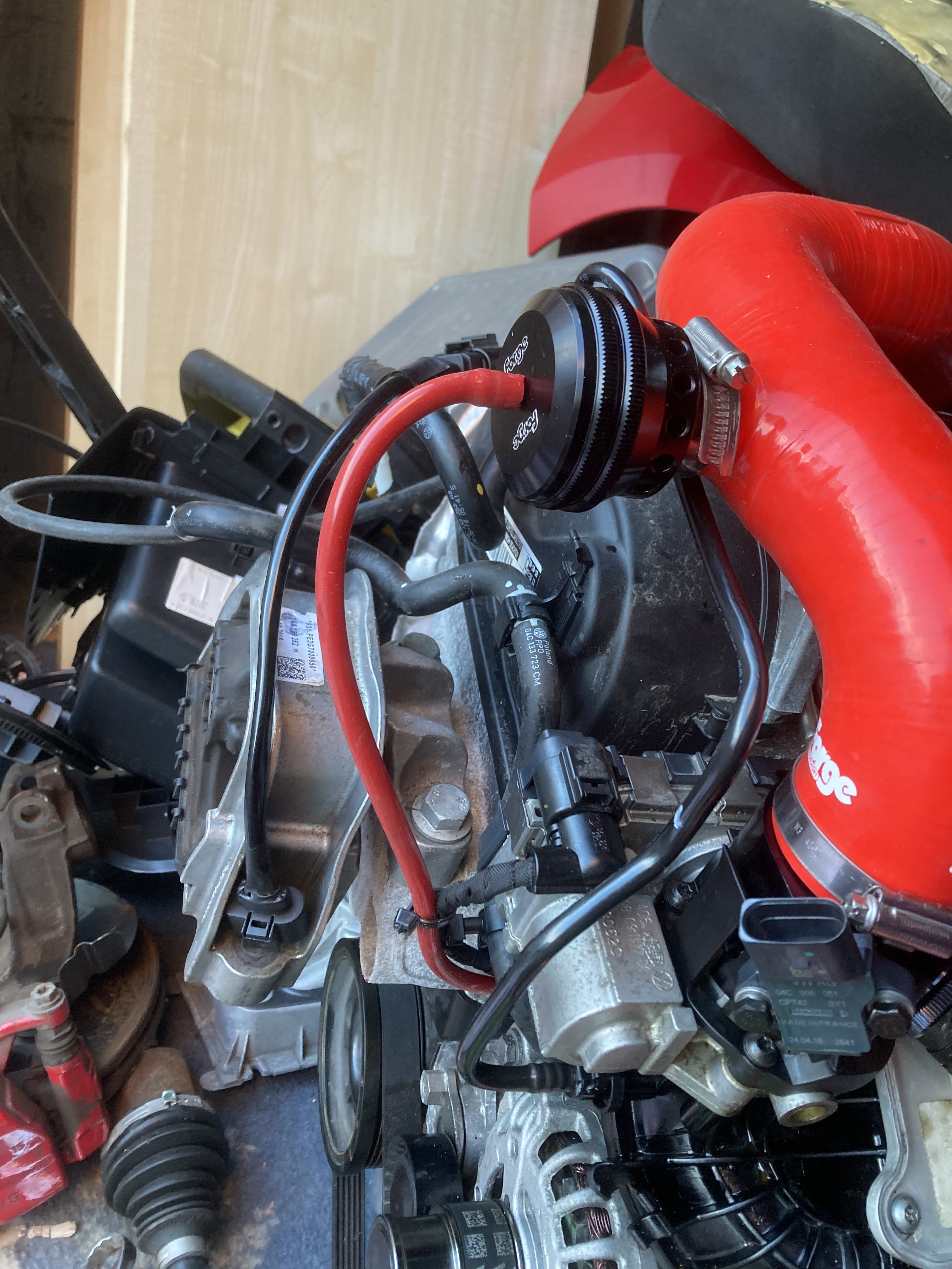

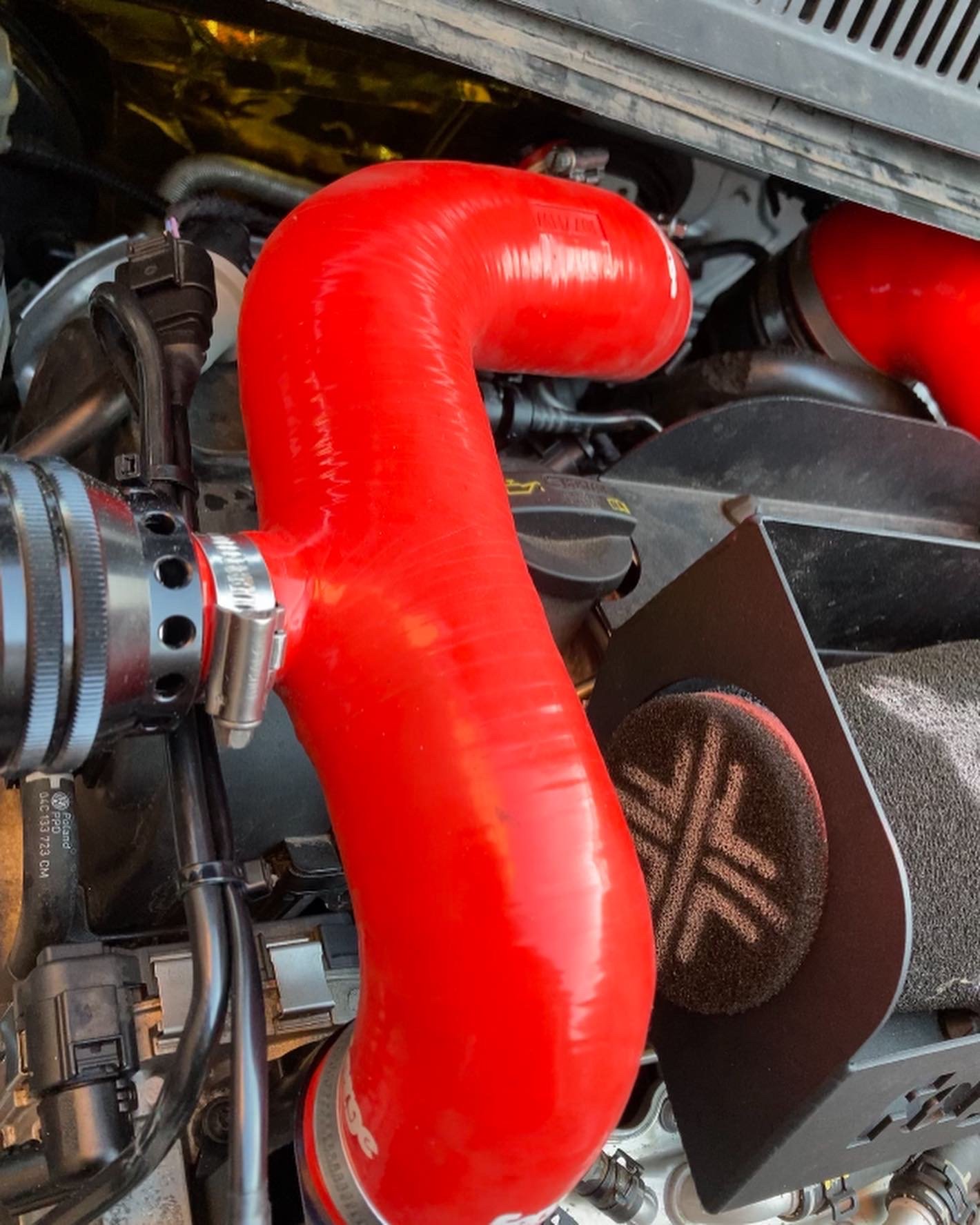

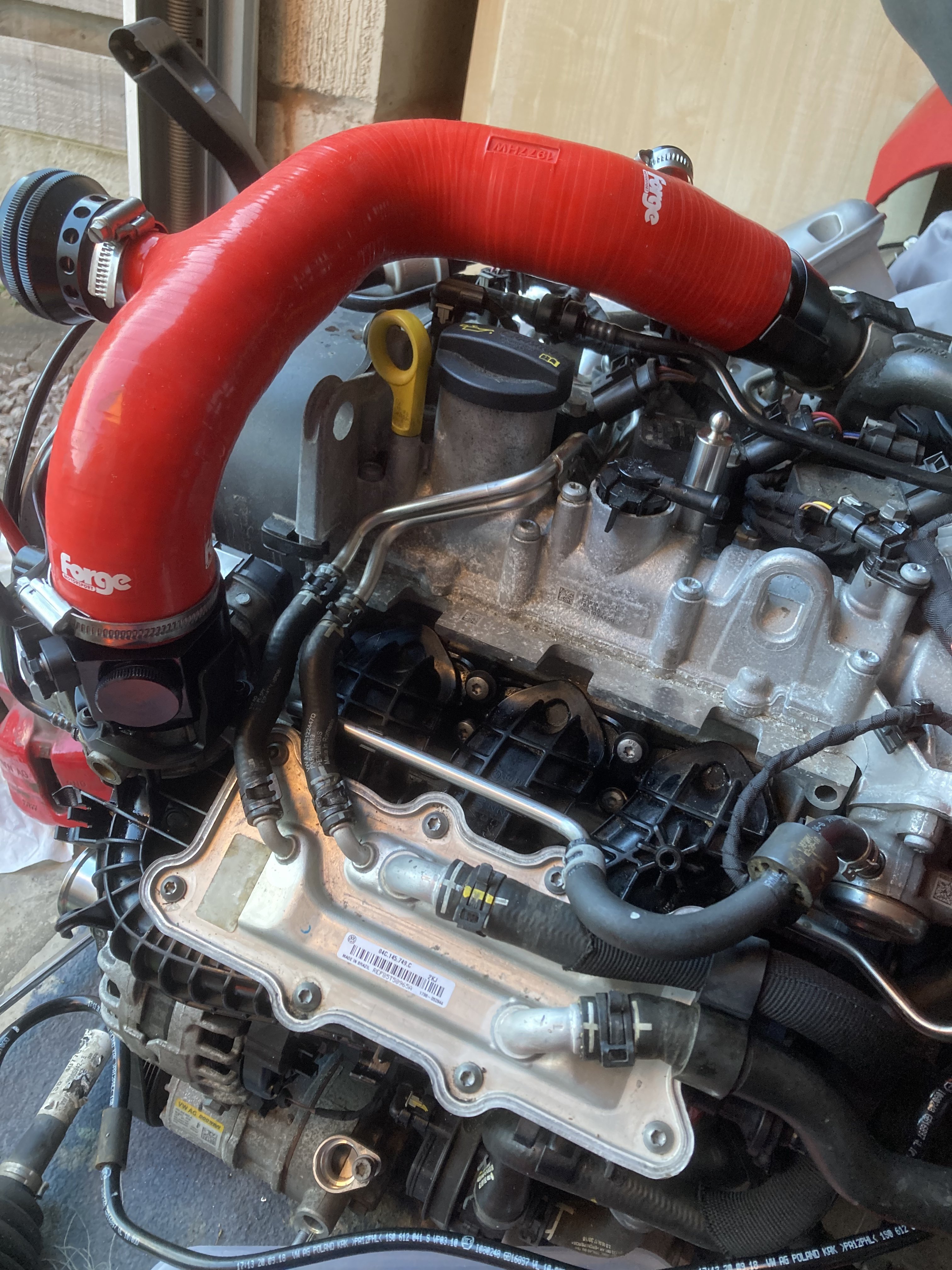

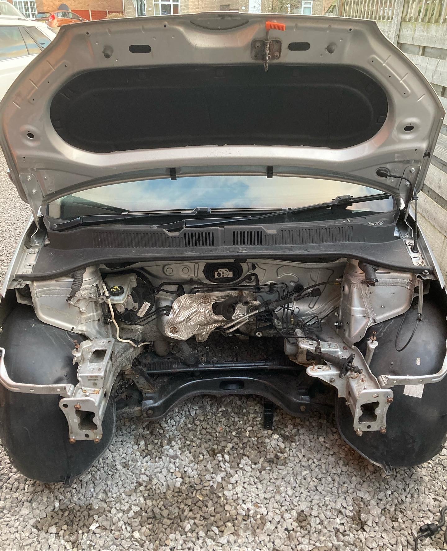

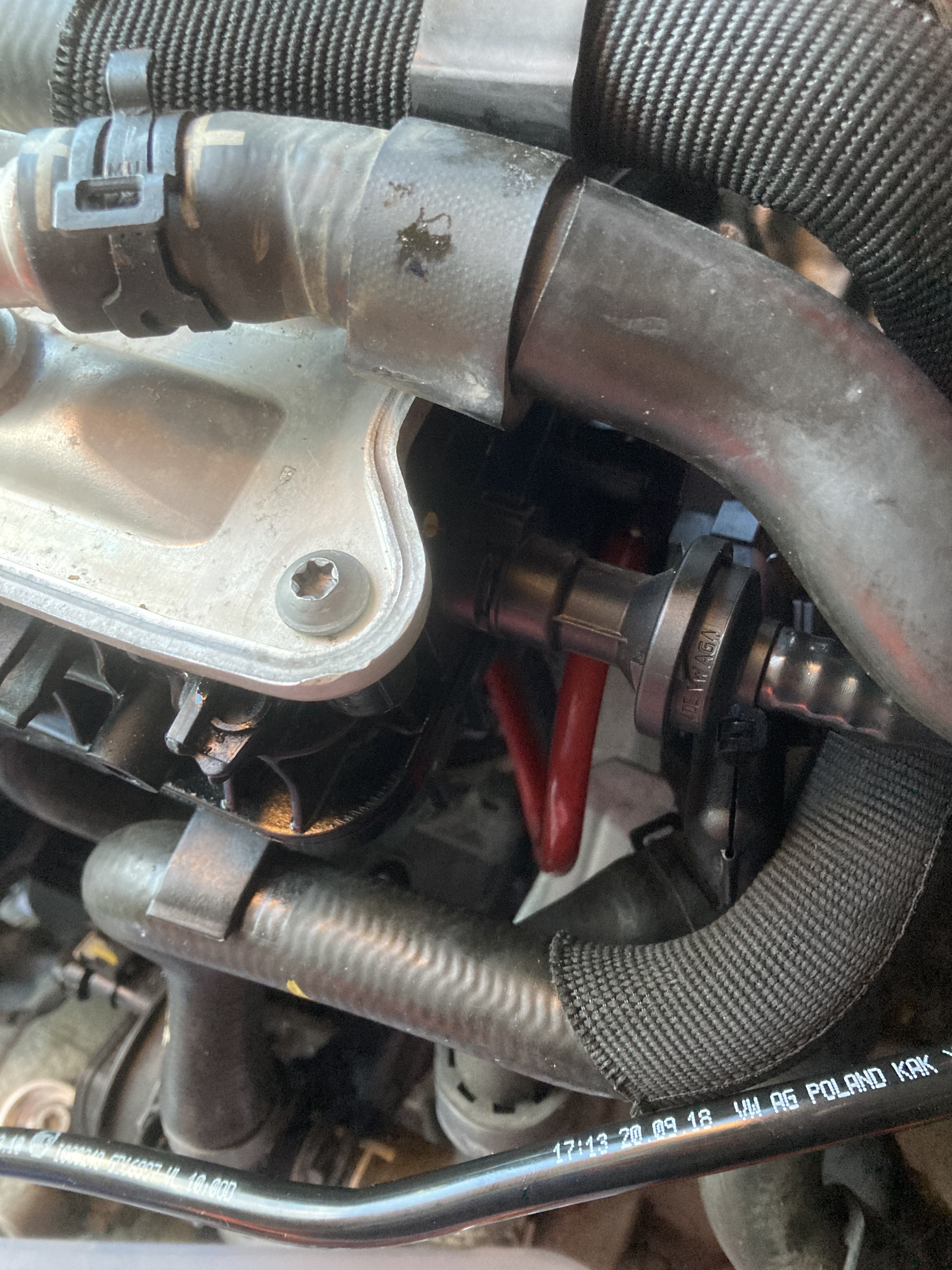

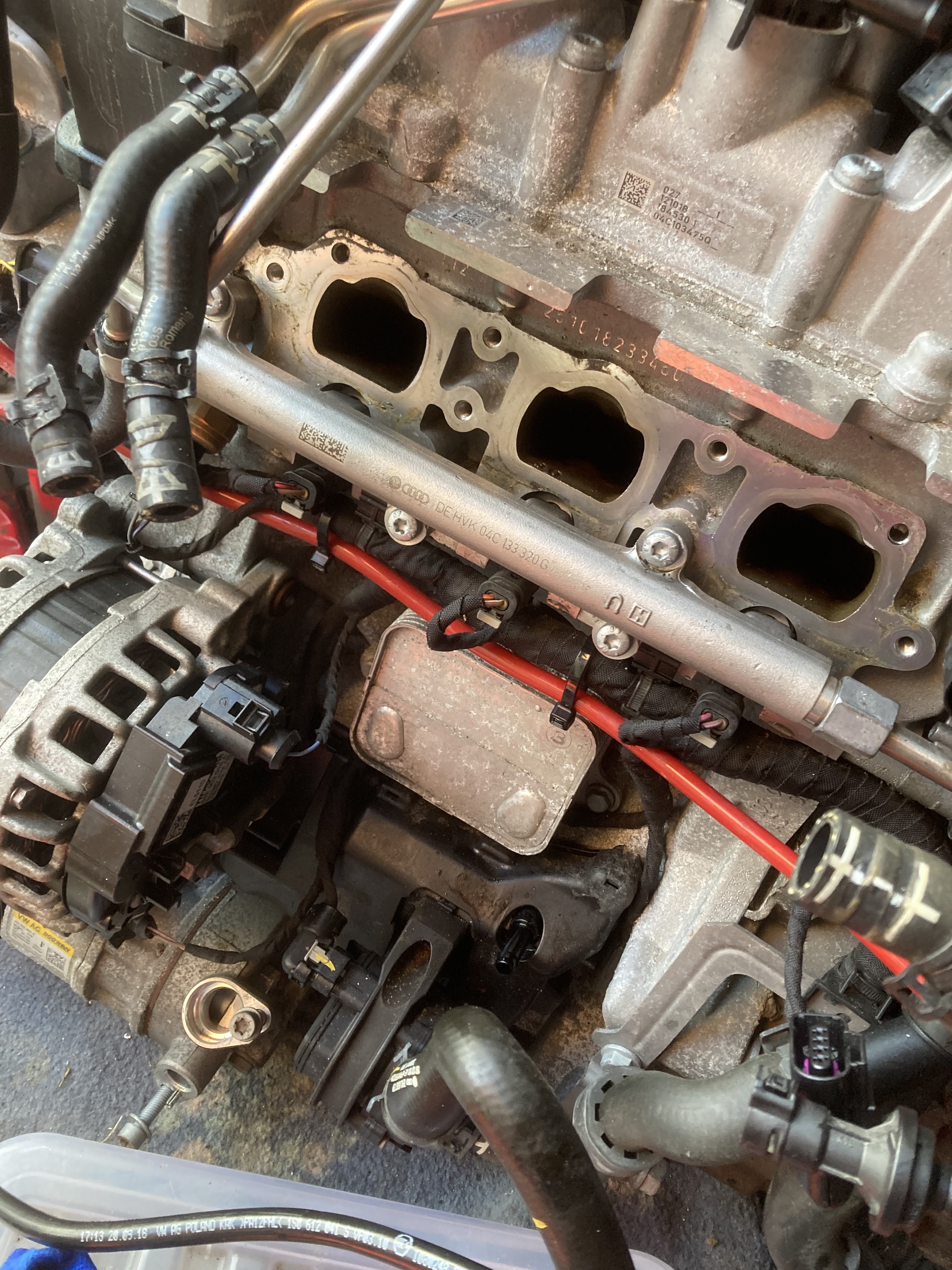

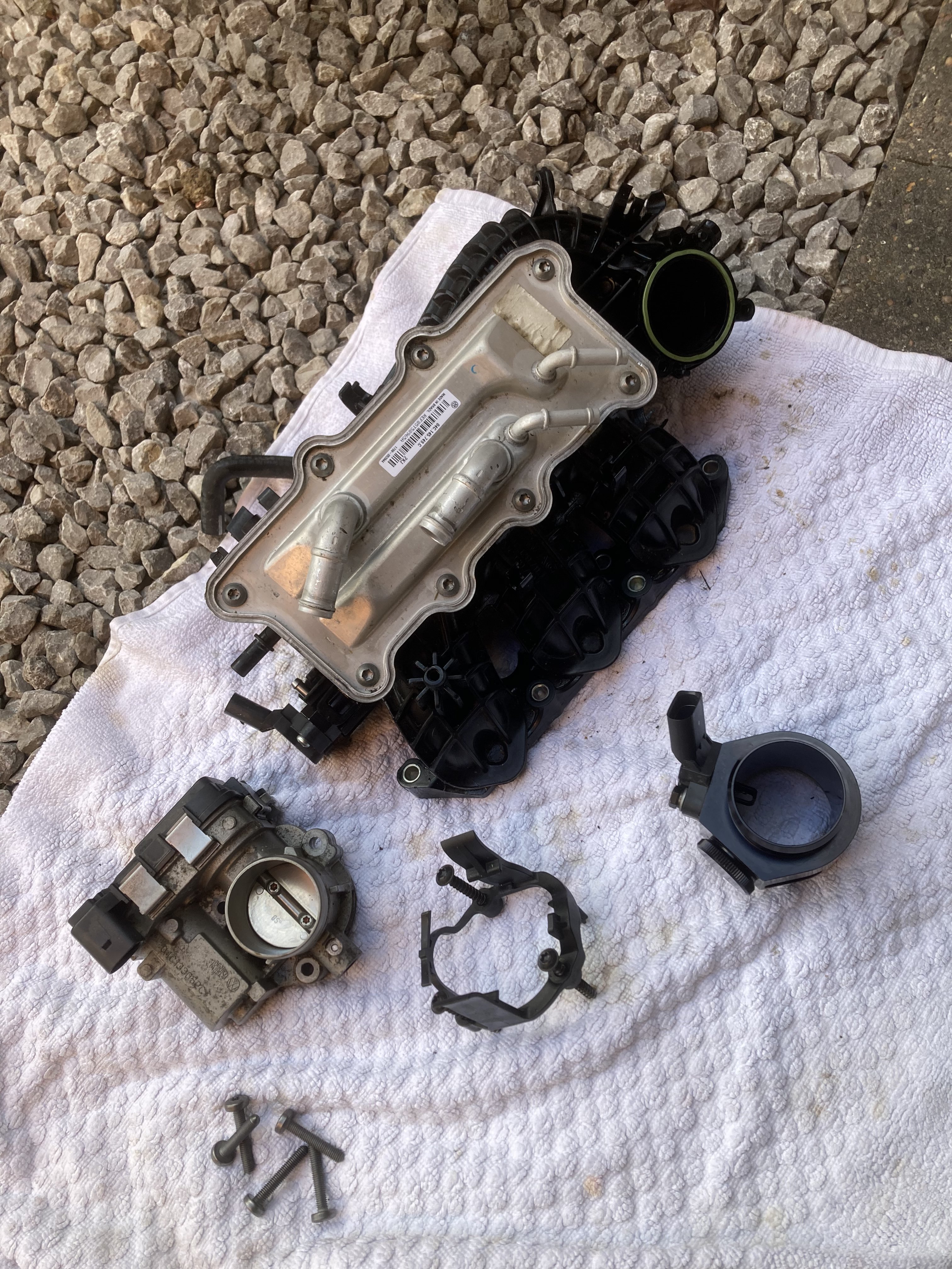

Thought I’d whip the inlet manifold for a little clean as some oil had got into throttle body when it was upside down, just to check. Turns out it was minimal which was good so just a little clean and back together. Also allowed me to run the vac pipe for dump valve nice and hidden underneath.

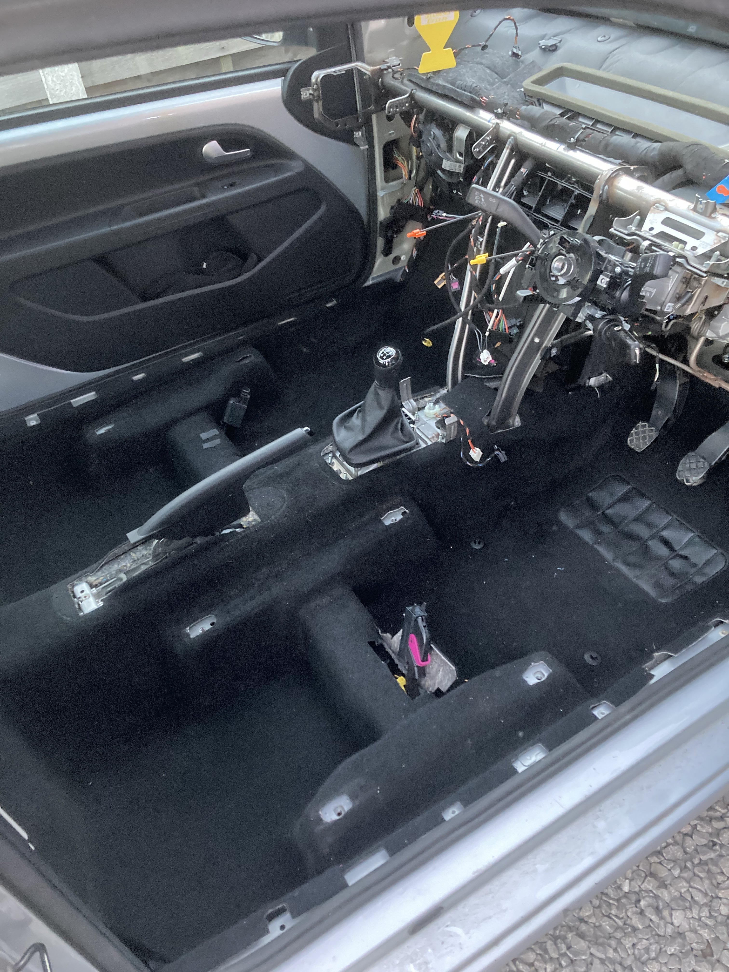

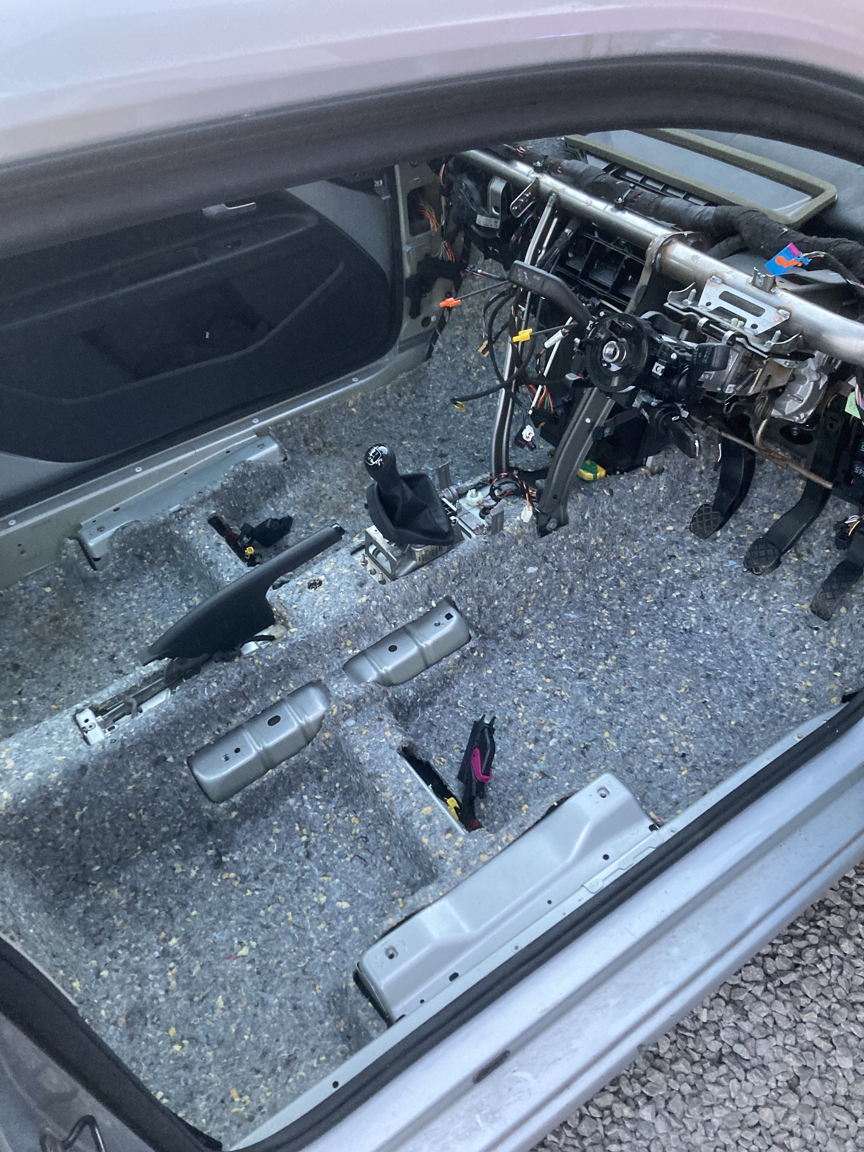

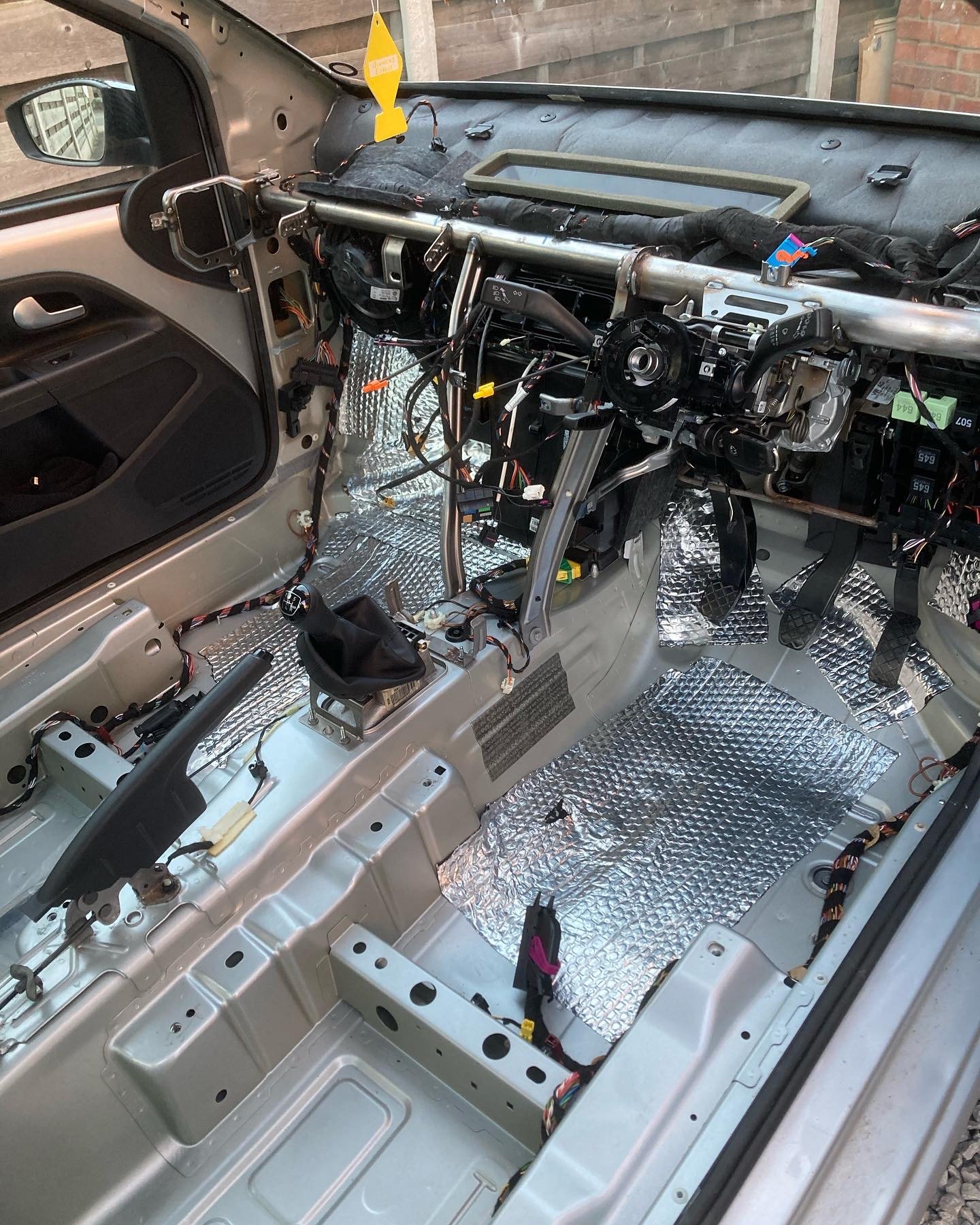

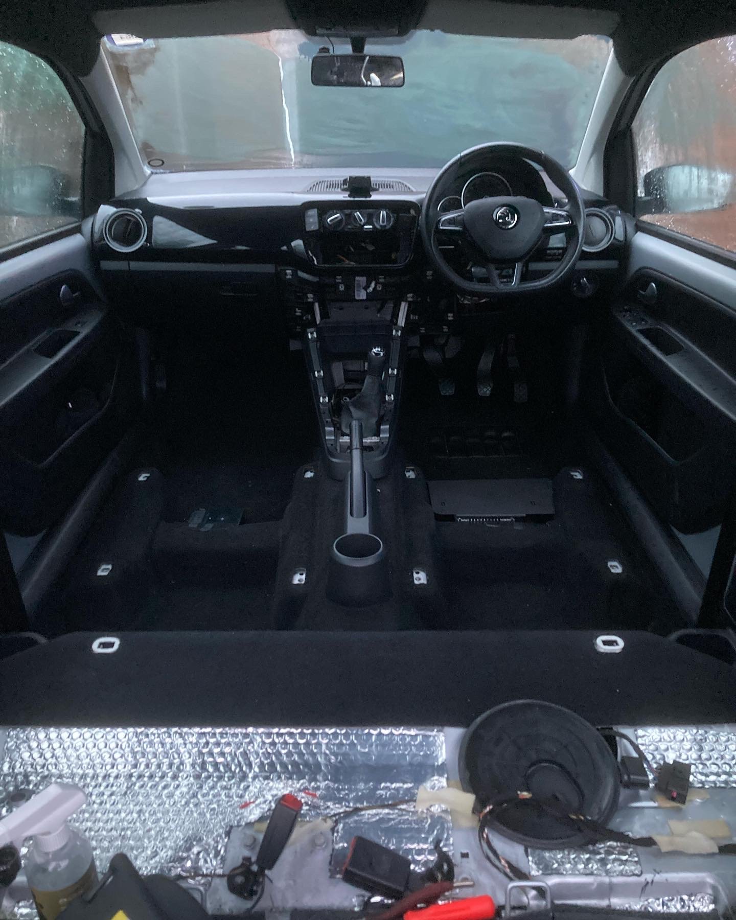

Interior stuff left is,
All dashboard stuff back in,

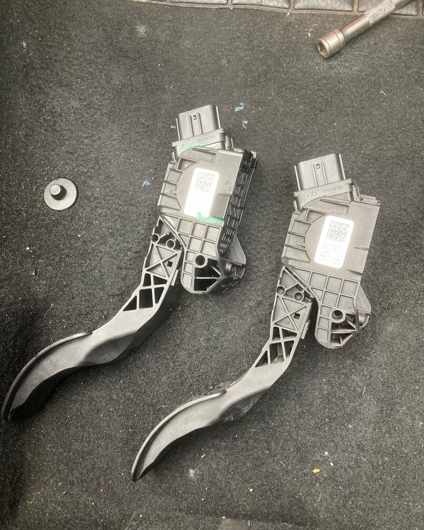

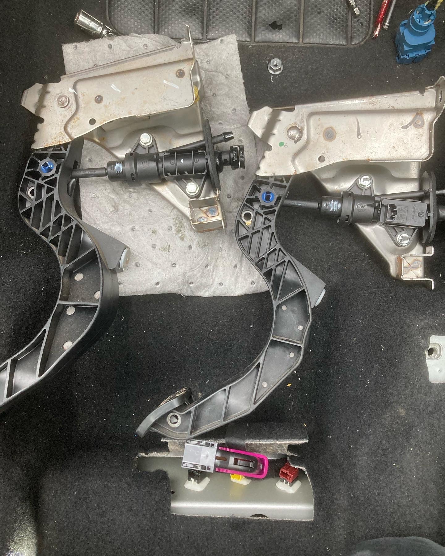

Swap throttle pedal
Swap clutch pedal (can’t use original as different for stop start, the connector is built into master cylinder)
Fit Fuel Pump and Fuel Pump Ecu (new gasket on order for pump)
Stop start module under pass seat to fit
Beats amplifier under drivers seat to mount

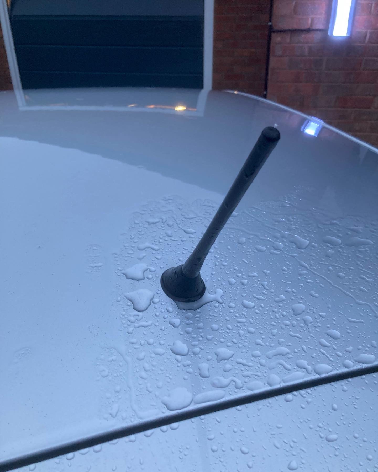

Aerial base to fit (oem dab from donor)
Black headlining from donor.
Then engine bay wise
Abs module to change, donors a much later revision number on pump then original so going to change to save any coding issues)
Clutch slave cylinder swap and bleed

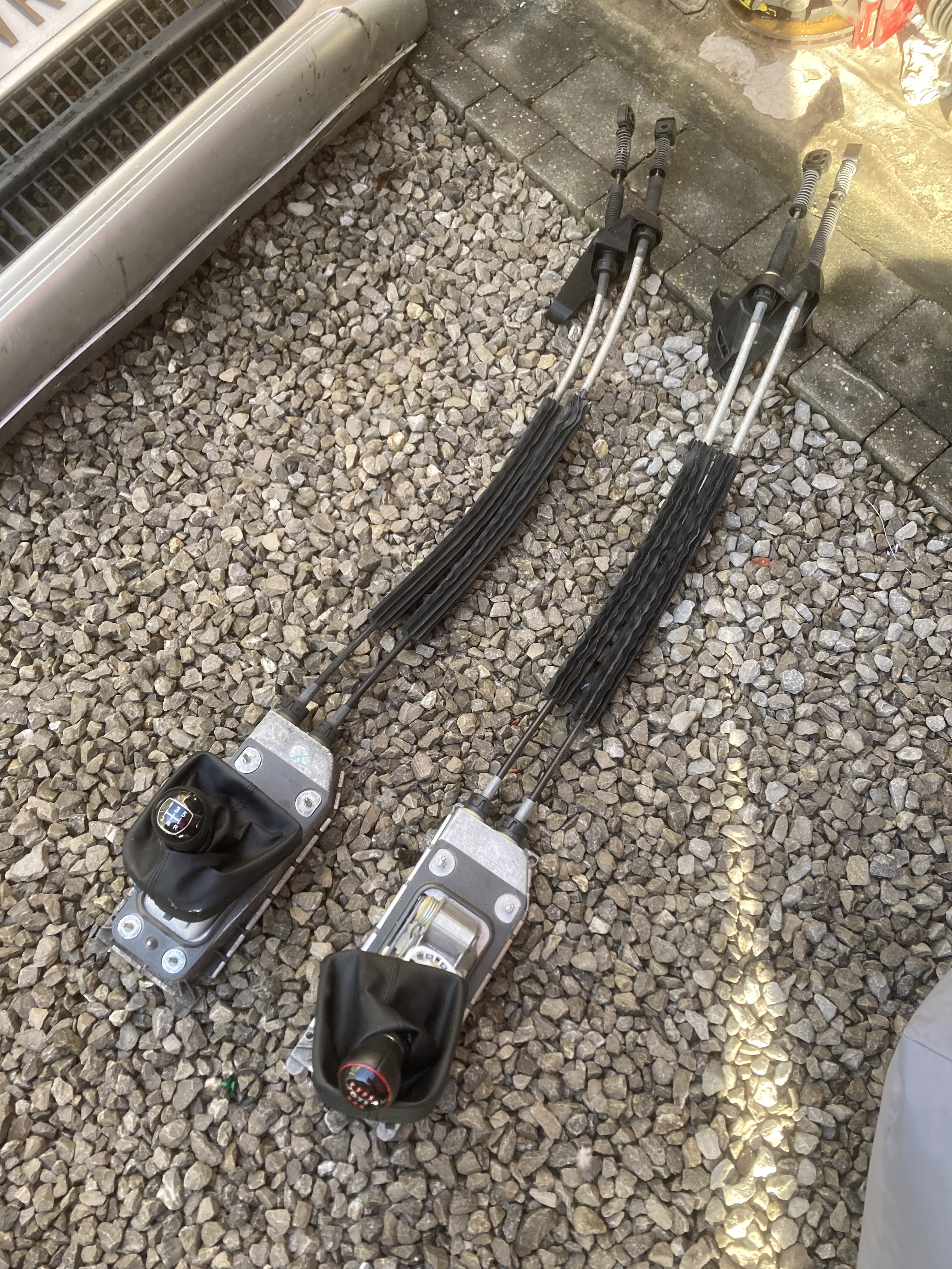

Gear-selector linkage to swap, so heat shield needs dropping over exhaust.
Going to heat proof the back of engine bay as obviously that’s where the turbo/exhaust is and there’s no shielding there on mine. I’ve got some fancy gold forge motorsport heat tape coming.
New radiator on order as it’s got the extra connector for cooler on inlet manifold. From research it’s the same size as normal up so hopefully my rad fan will fit nicely

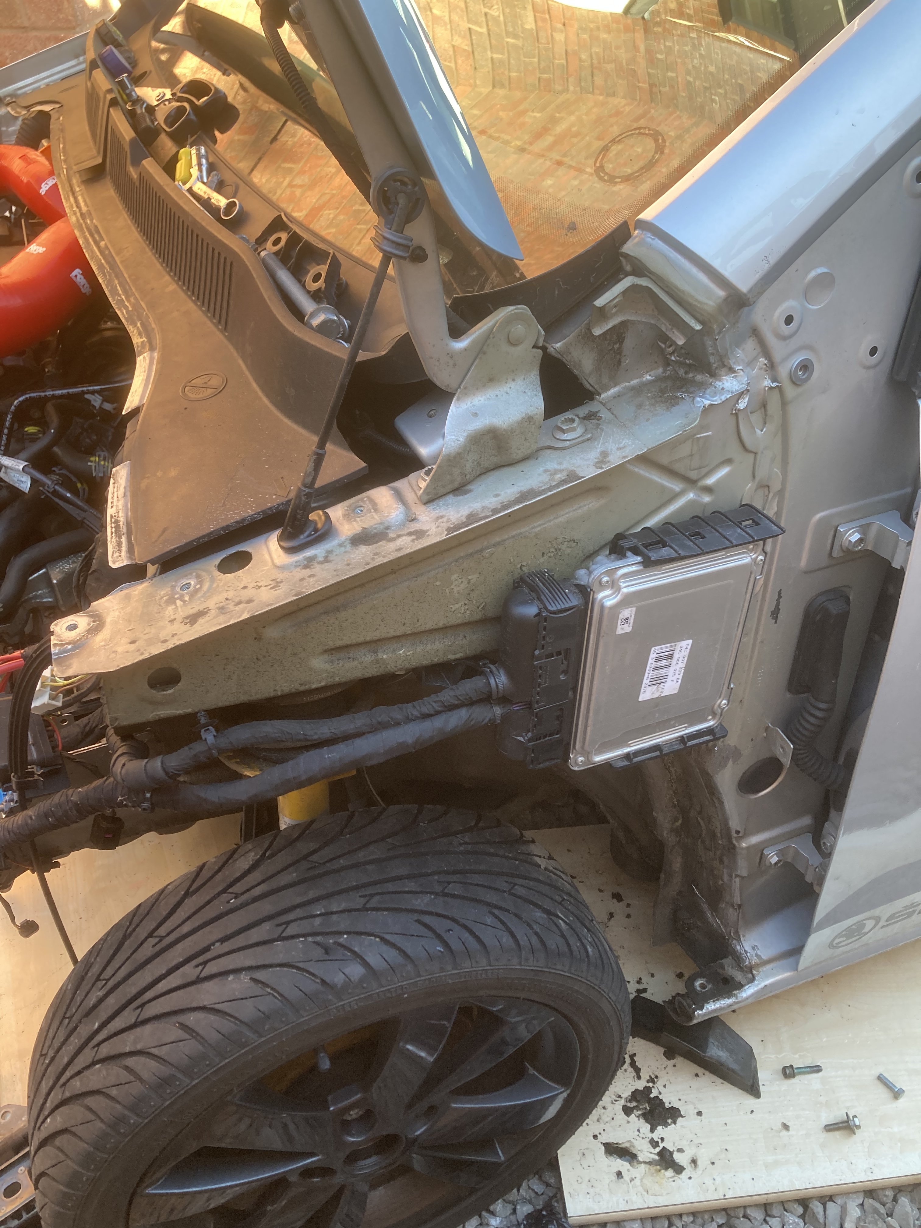

Then engine Ecu to mount in wing as oem
Fit engine
New Engine oil/filter and gearbox oil
Fit driveshafts
And door lock and locking fuel cap to swap over at some point too to fit donor key
Jobs a gooden lol

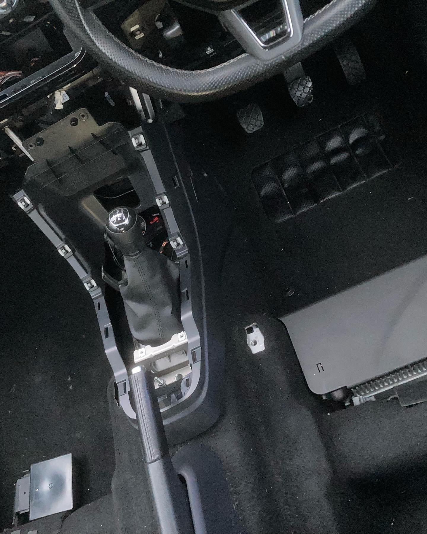

Not much this morning,
*Drivers door barrel swapped to match new key along with locking fuel cap.
*Gear linkage bolted to gearbox
*wiper linkage fit and wipers on

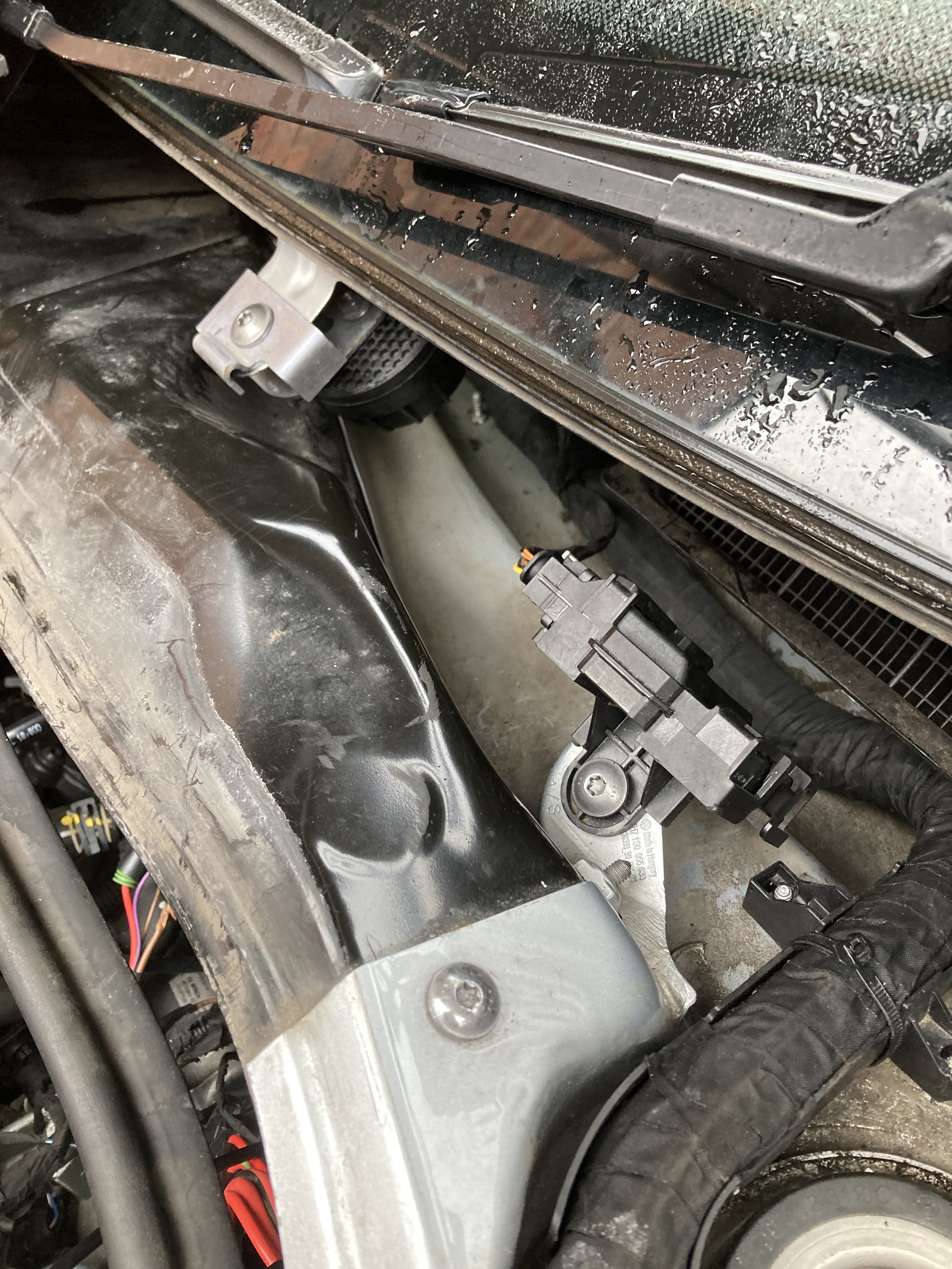

*soundakator and control unit fitted under scuttle
*front washer hose connected to jets
Pic of soundakator and control unit, amazing how it has the holes already there to bolt too :)
