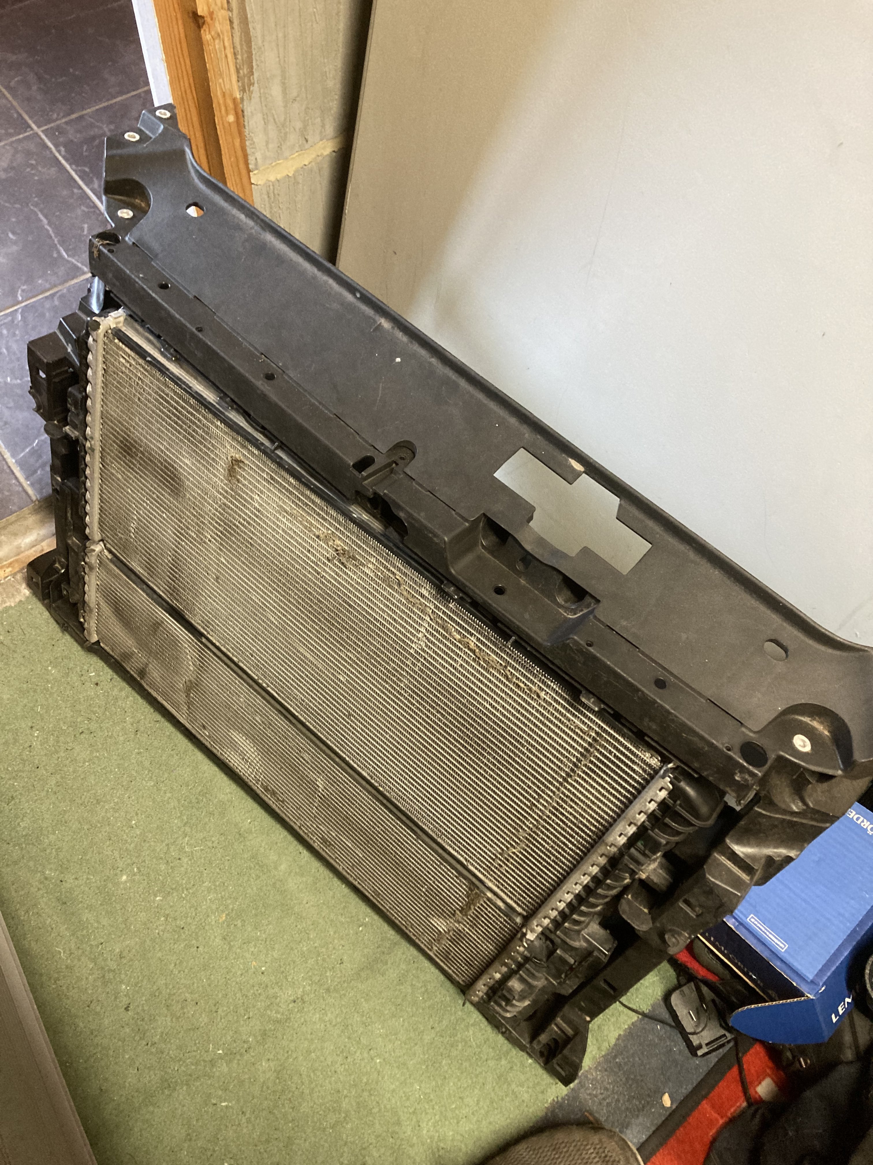

Waiting for radiator (two week wait)

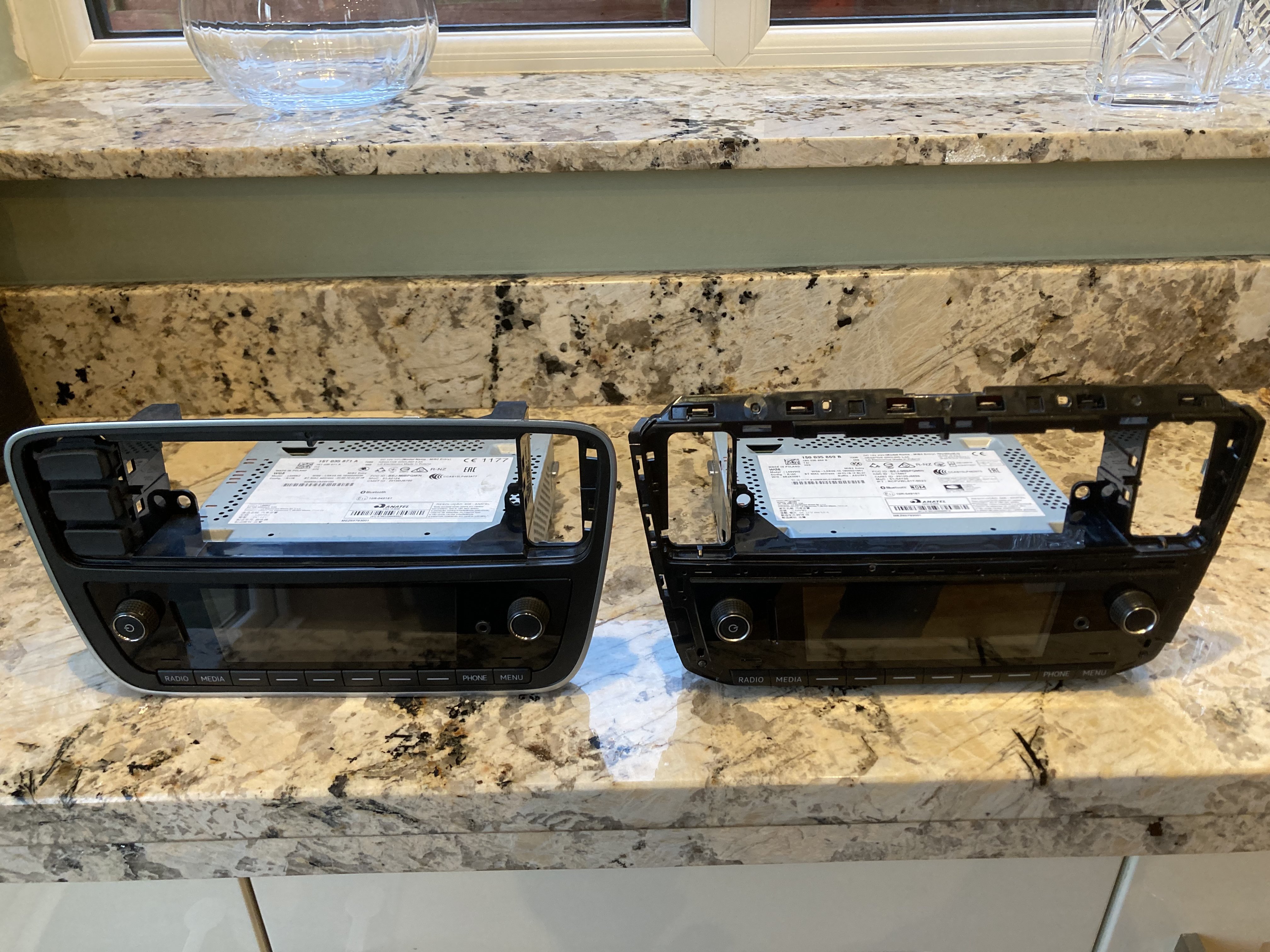

ordered a citigo facelift stereo so I can hopefully swap the displays over so it keeps its component protection and will work as the up stereo won’t fit the dash.

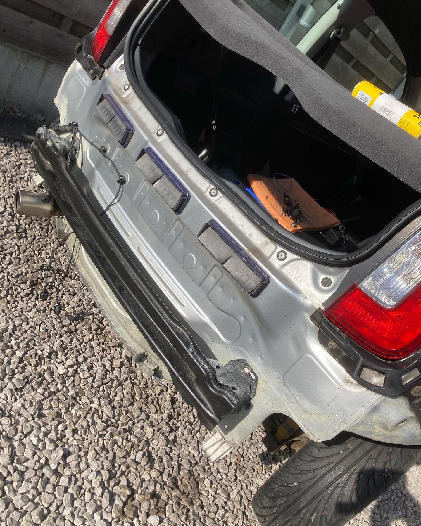

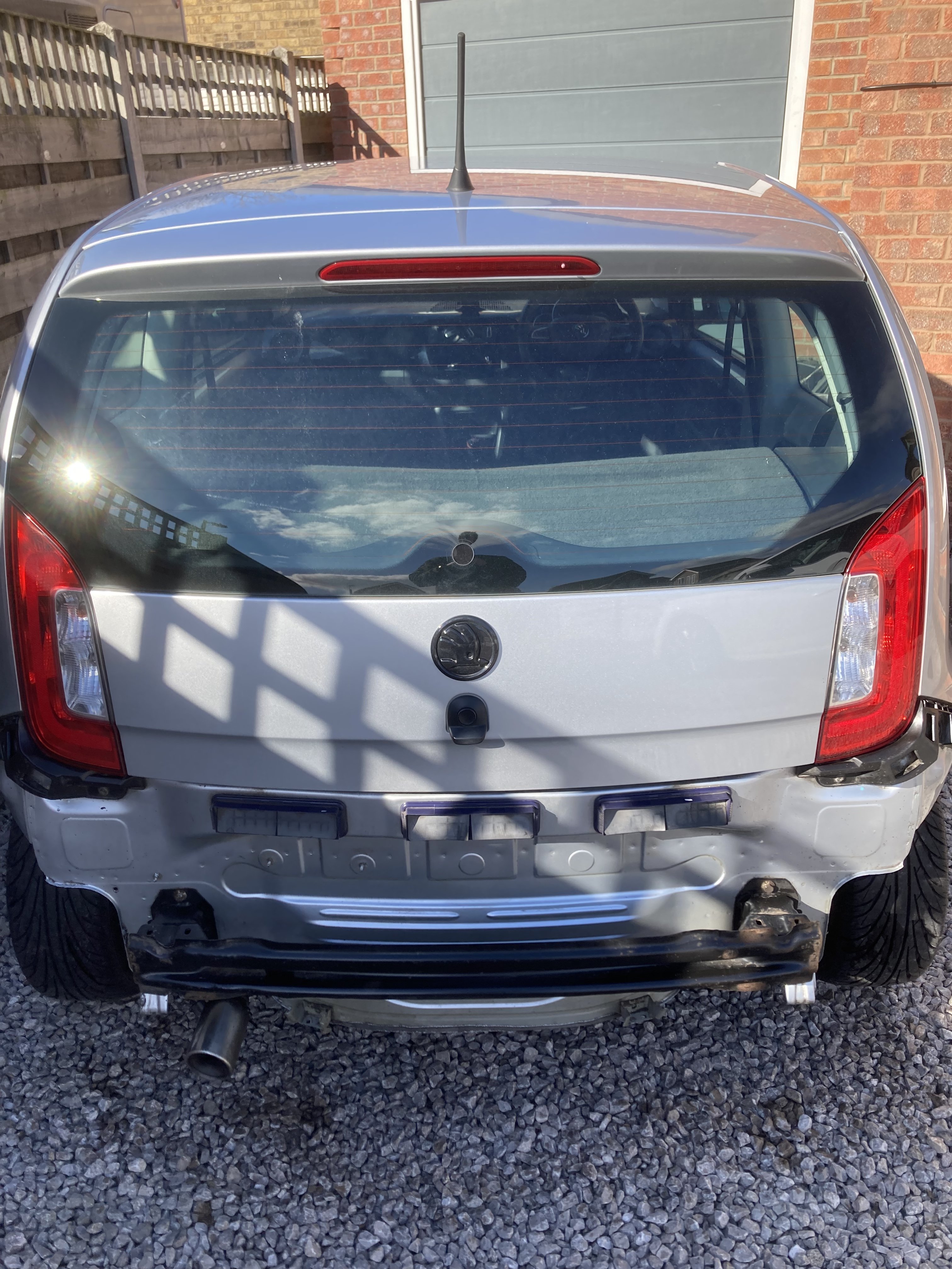

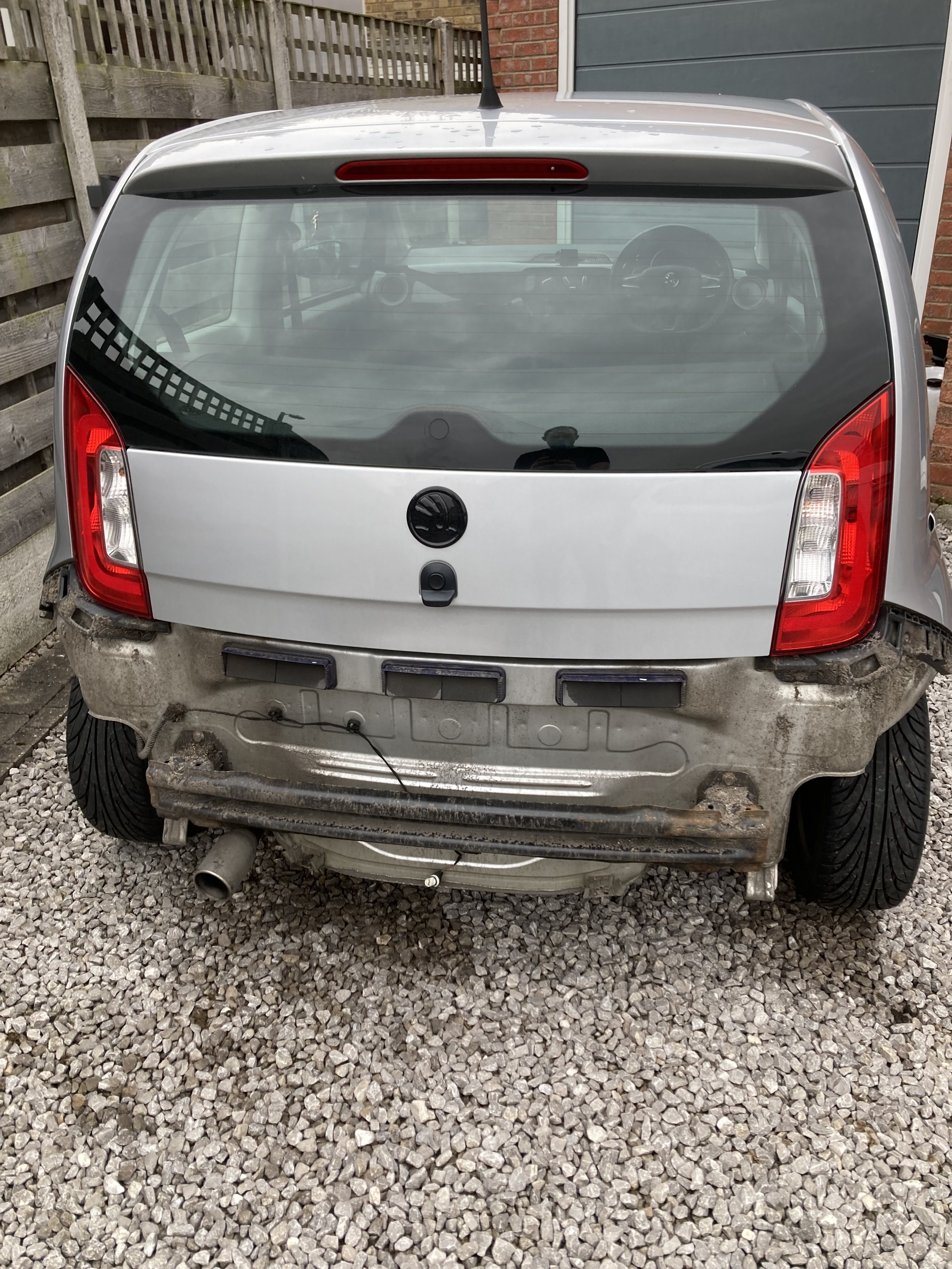

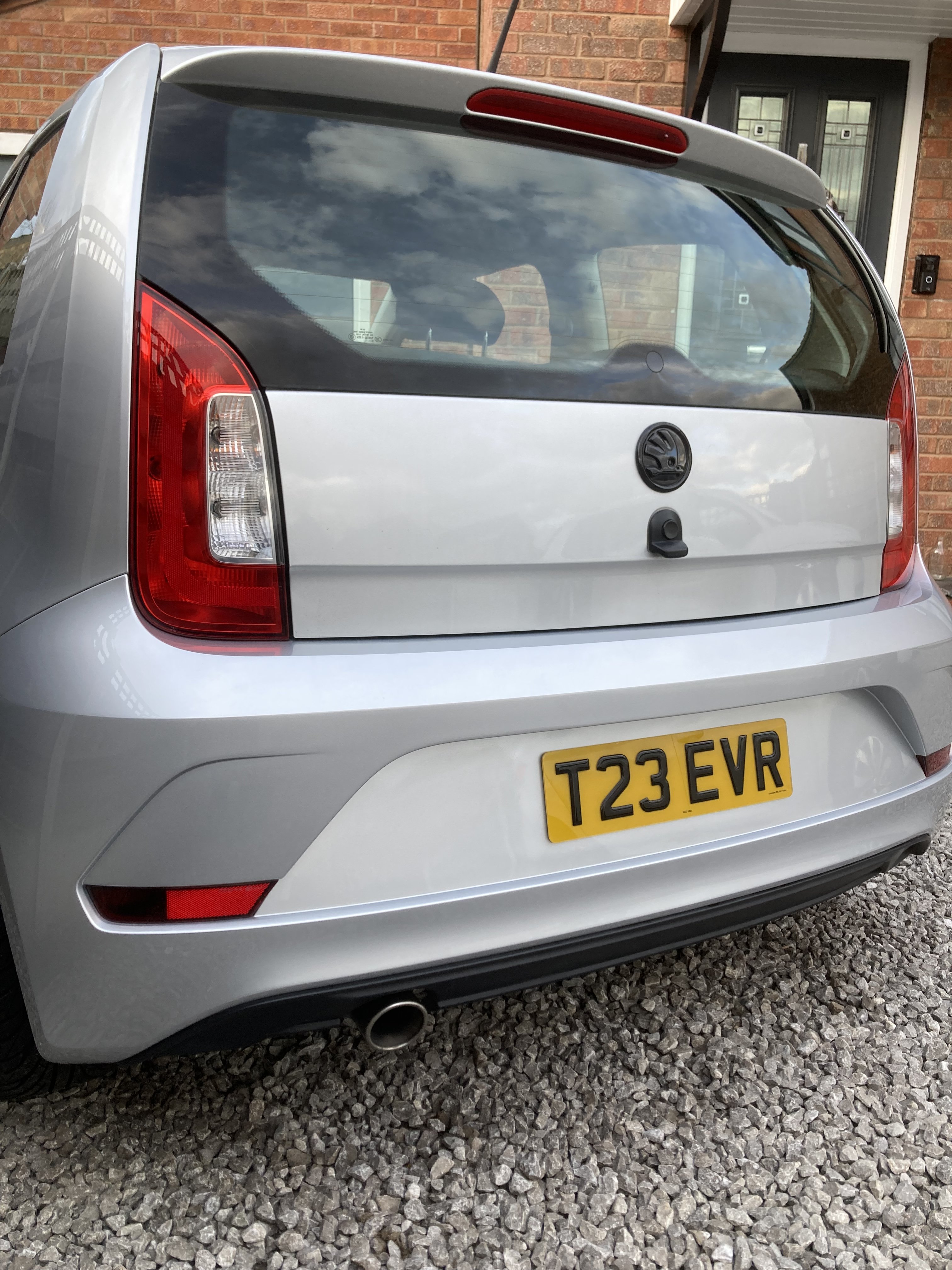

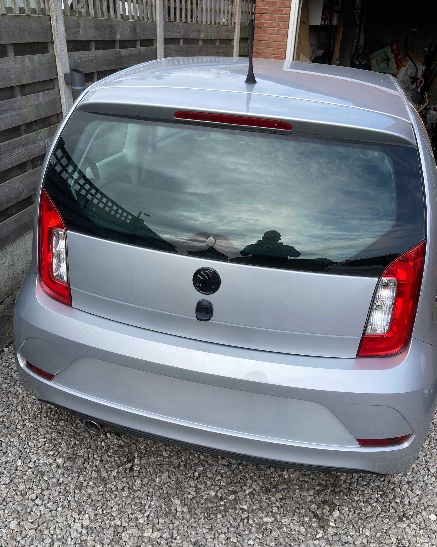

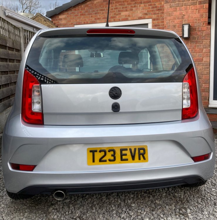

Cleaned the back end up before my bumper comes back from paint, I’m fitting a gti one so it all works rear fog, twin number plate lights and the oem exhaust cutout

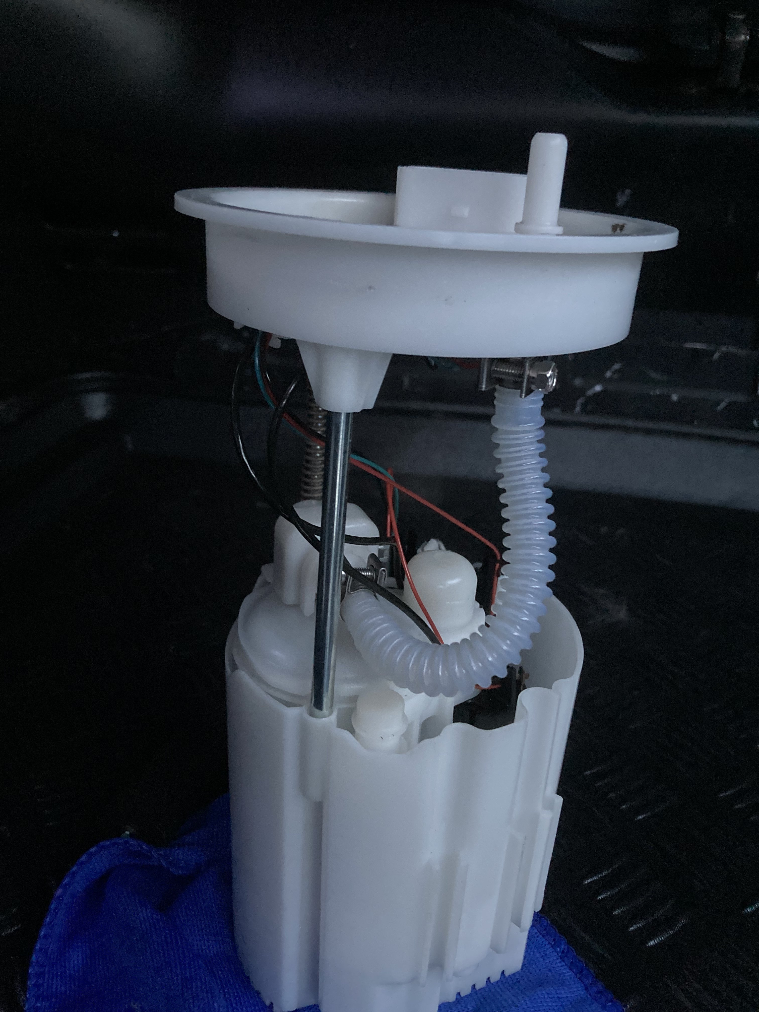

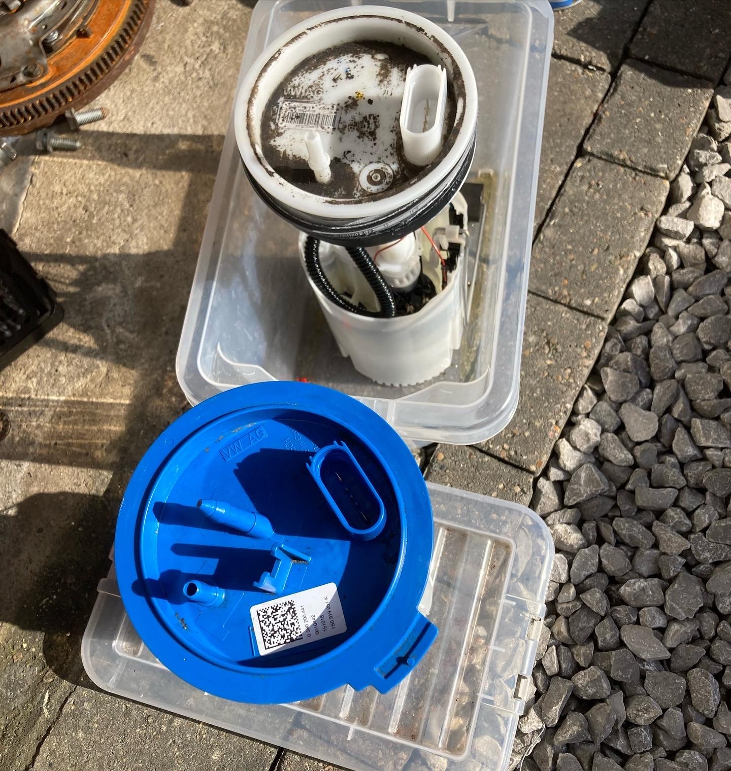

ran into a little problem with fuel pumps as I now know the tanks are different and the pumps are held down differently screw type vrs a locking ring.
As I could find any info on the pumps flow rate I’ve swapped the internals over anyway to save any future issues when it’s mapped. Just waiting on a bit off fuel pipe and I can fit it back in.
you can see the difference in the head in this pic

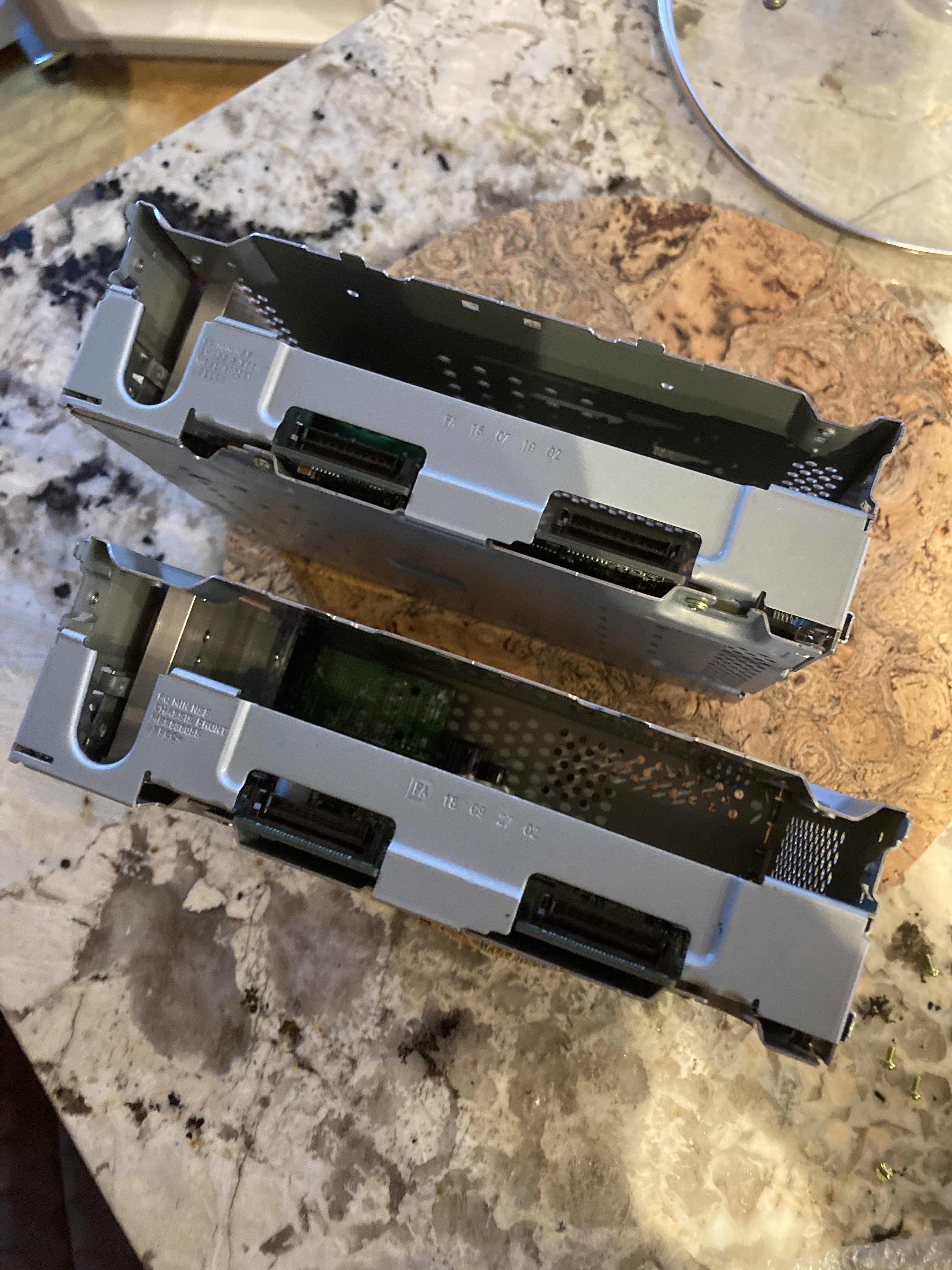

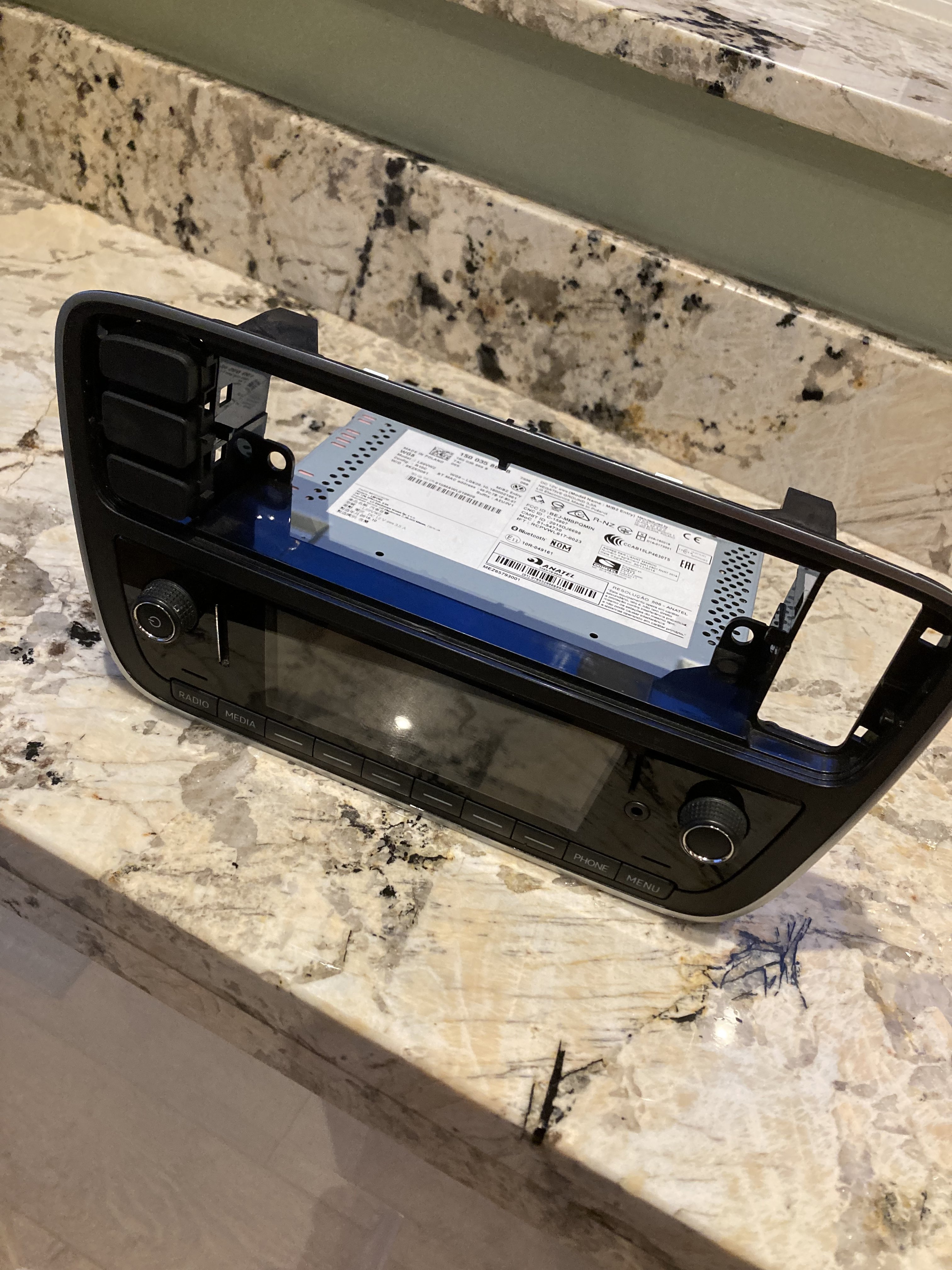

One of the last few pieces of the inside.

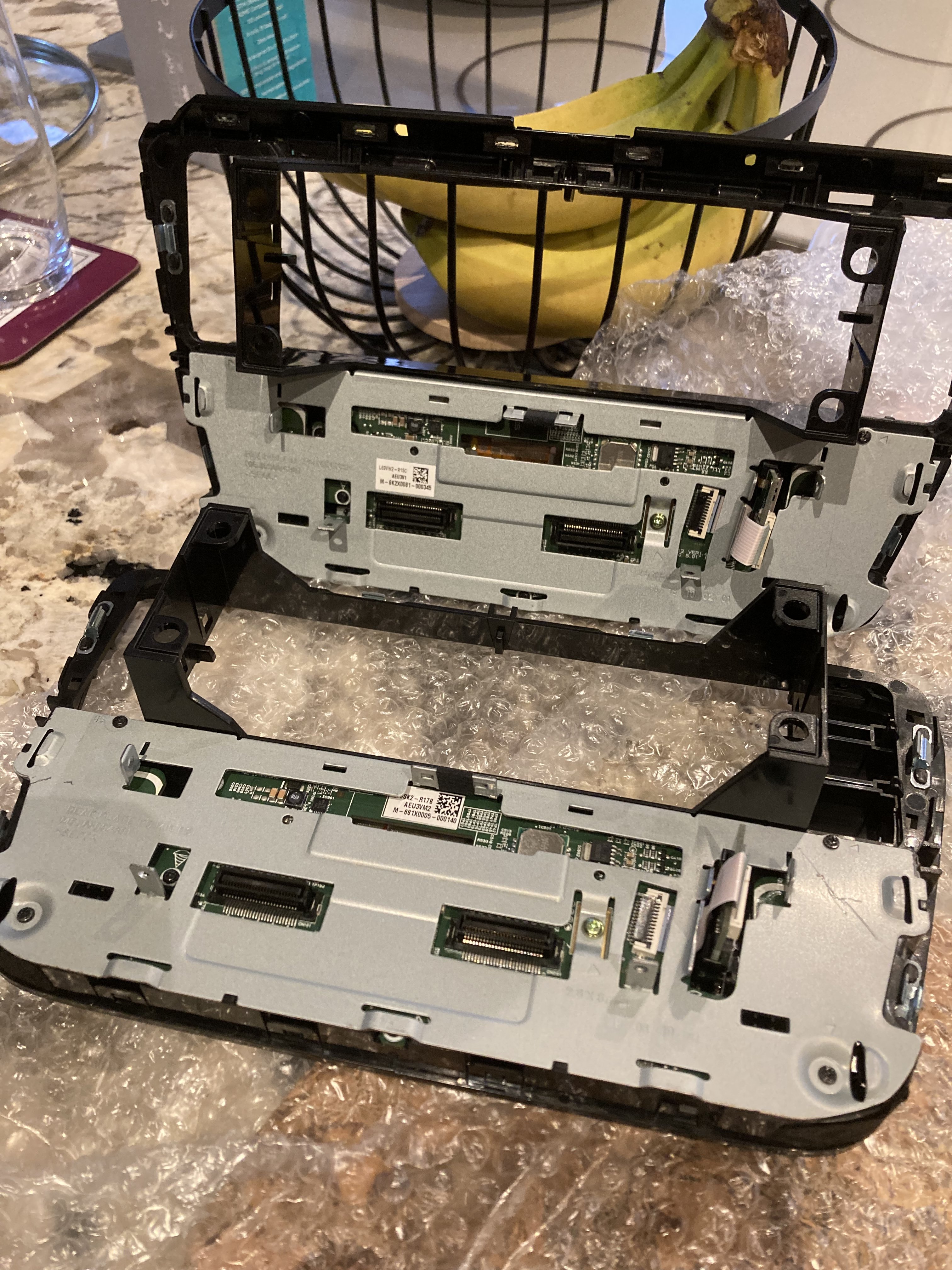

I Swapped the facias of a facelift citigo so the stereo out the gti will now fit straight in.
Dashes are a different shape in facelift up’s whereas citigo kept same dash throughtout.
Now it will work with no component protection worries.
Also received a steering column  cowling today that’s from a facelift as they are different to original.
So just need the switches next to heater out of a facelift with the stop start and heated seat buttons to finish off

Recieved my fancy in tank fuel hose from demon tweeks, got that fitted up and the pump back sitting in the car. Rest of interior can go back in now.
so the pumps got the original head but all the gti internals now :)
Gti bumper on,
swapped crash bar as old one  was a little rusty, and added some waxoil to the bottom of body and corners while I was there, got the body guy to fill in the old screw holes so I can run my 3/4 length plate

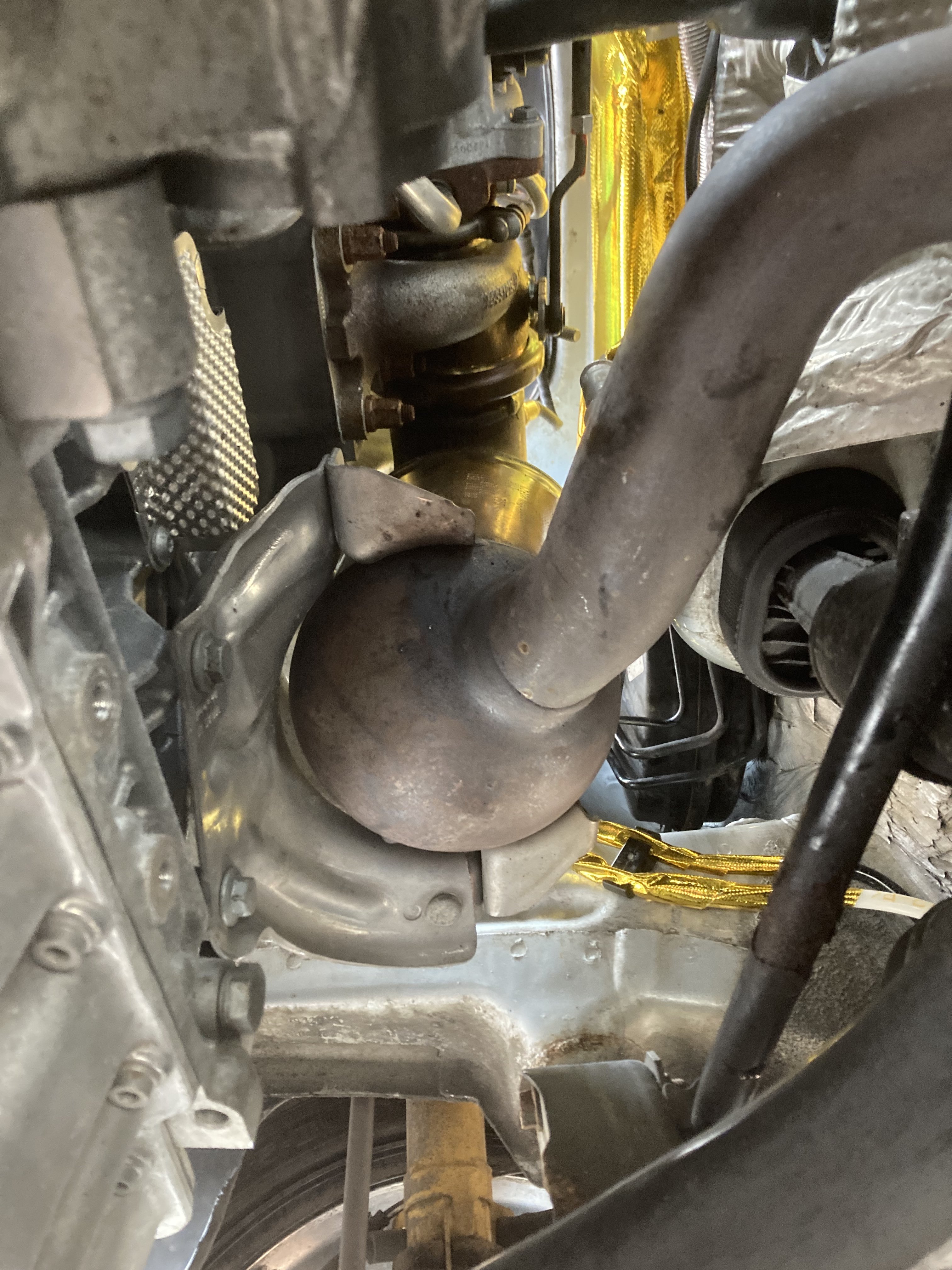

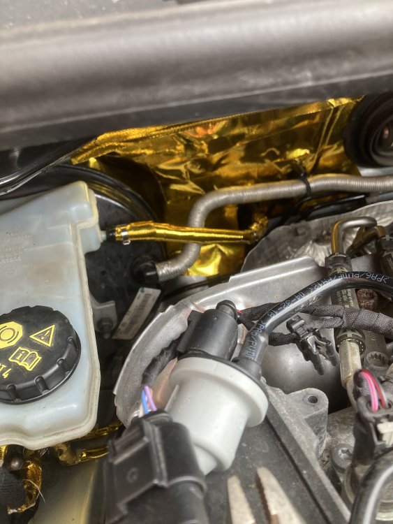

Added abit more heat protection for the clutch feed pipe as it’s abit close to the downpipe.
Also
*Downpipe on
*Rest of exhaust mated and aligned

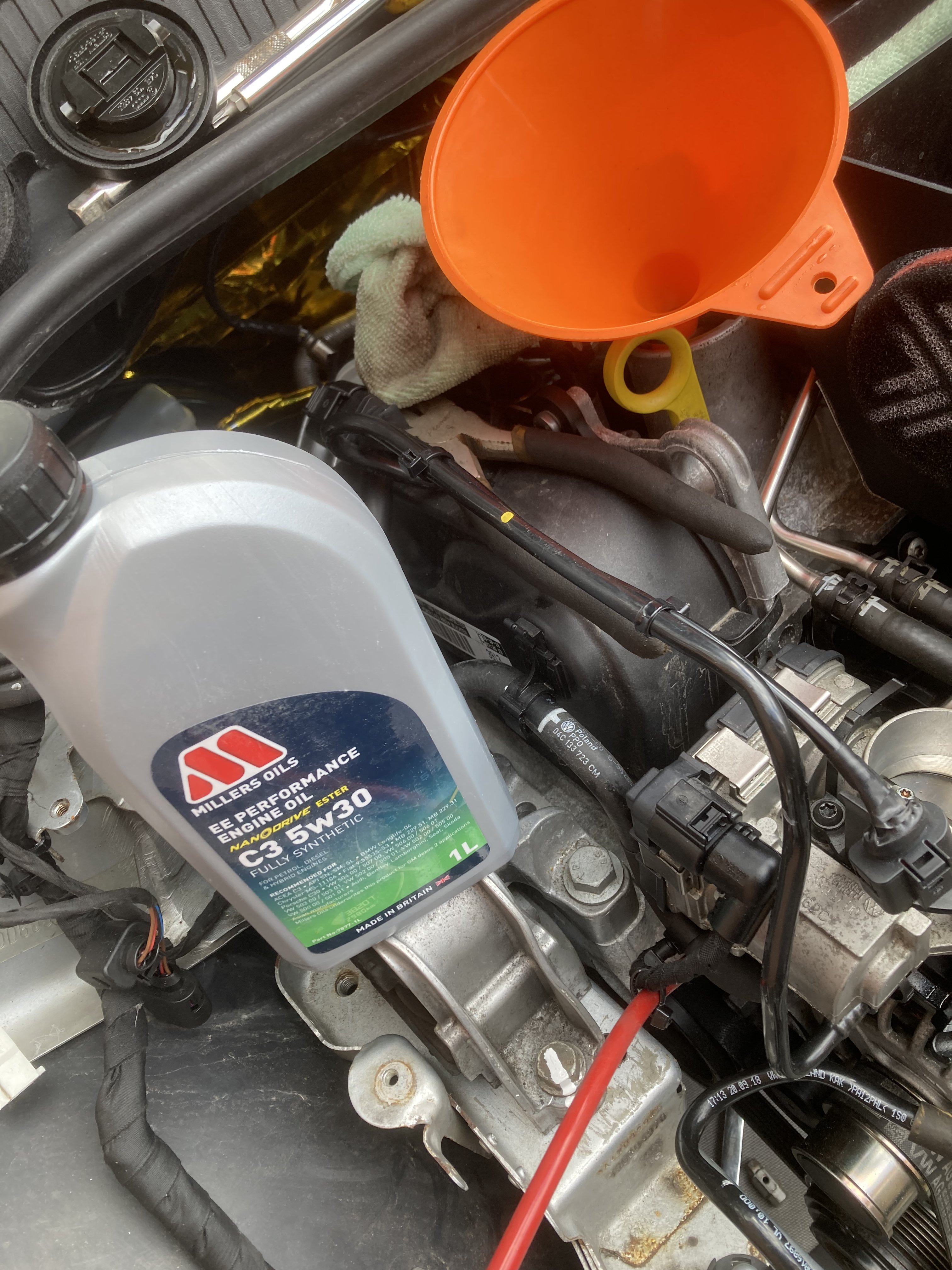

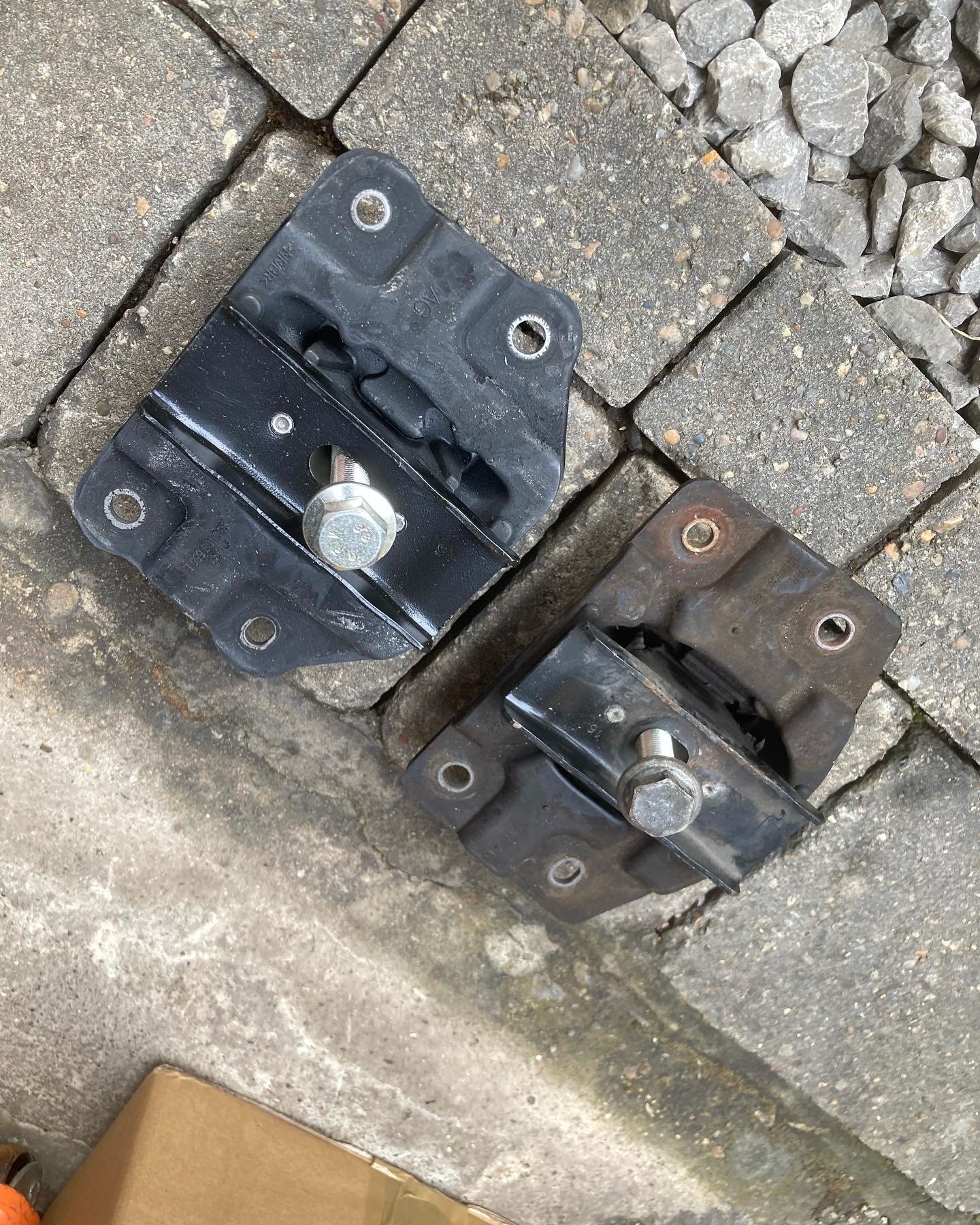

*New gearbox Mount
*Oil and Filter changed
*Mounts torqued up
She’s alive
Also got the exhaust all aligned she sits beautifully, it has a nice subtle note not too loud which is good.

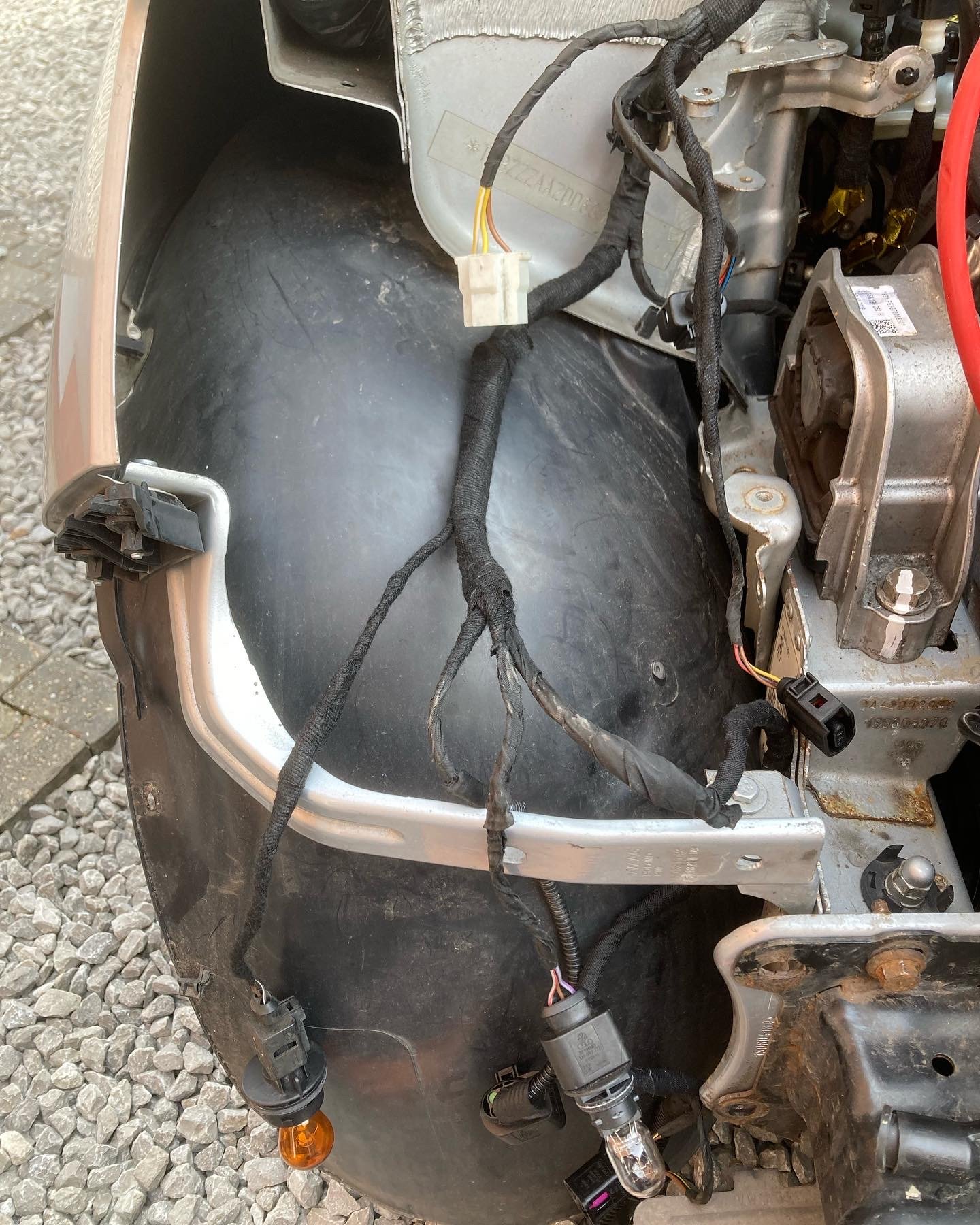

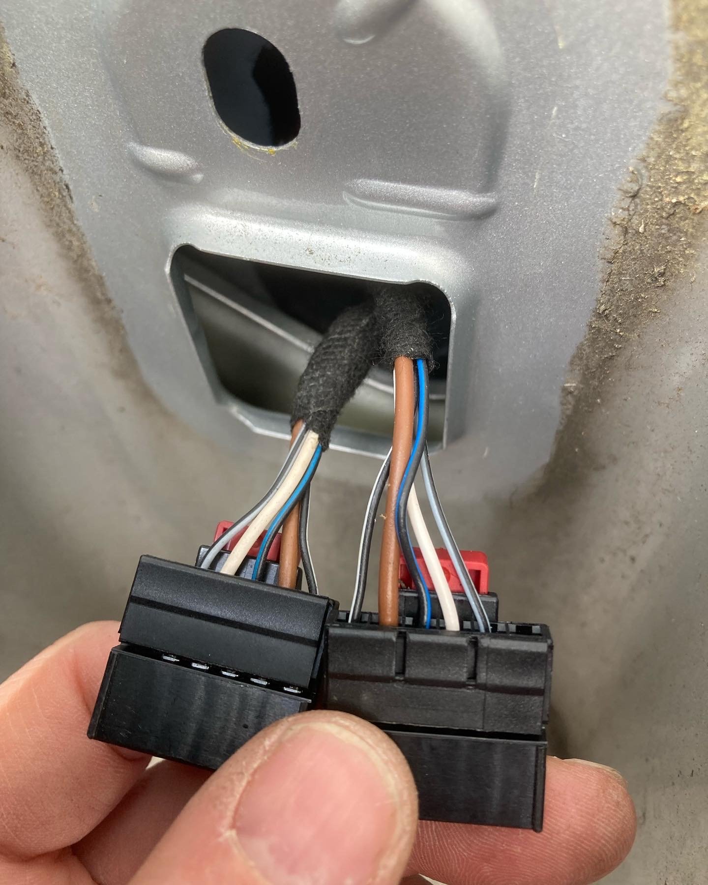

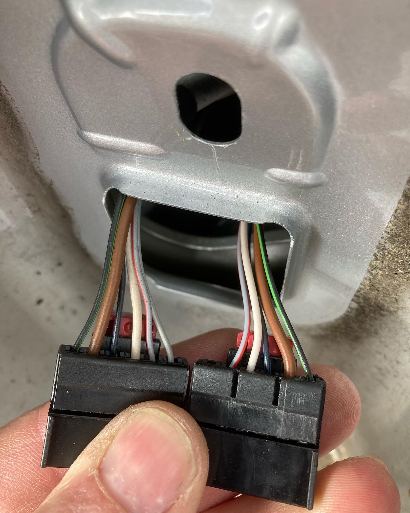

Wired in all the lights
*Rear lights repinned to fit citigo in different places on Up
*Front light wiring extended as the bulbs are in different places

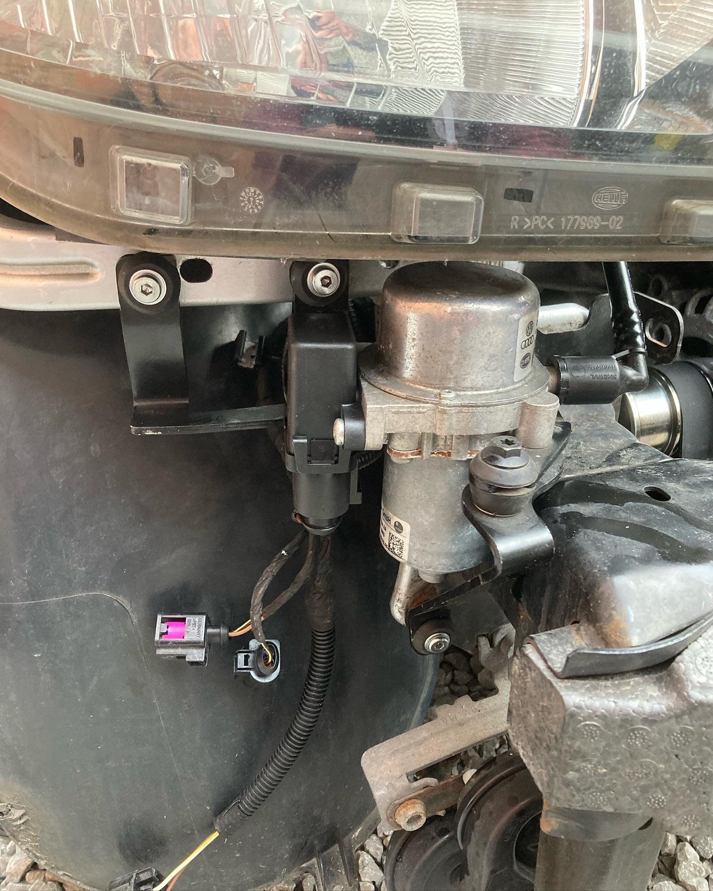

*Brake vacuum booster mounted
Little vid of the rear, so nice with the twin number plate bulbs

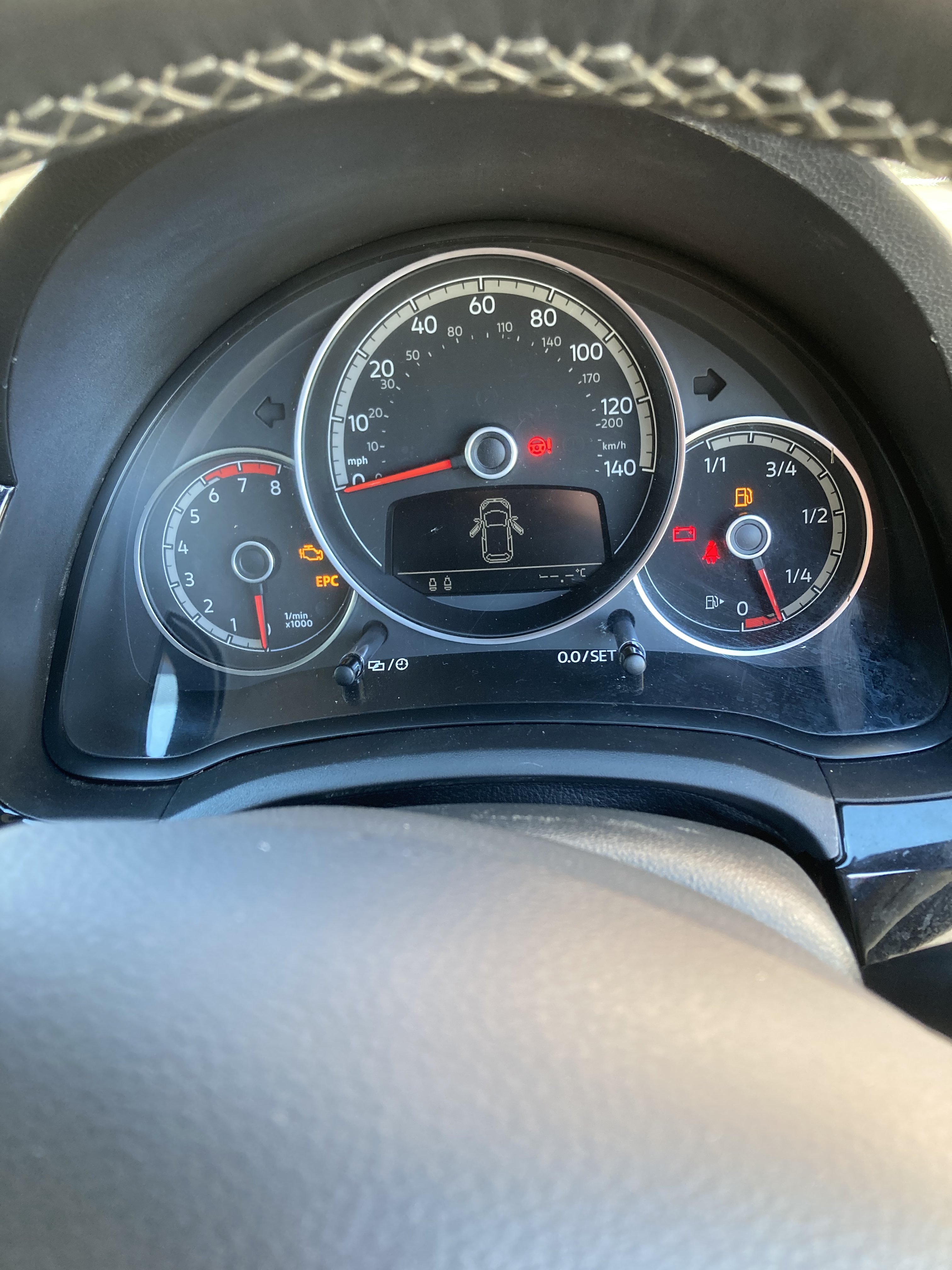

just one warning light to get rid of now steering!

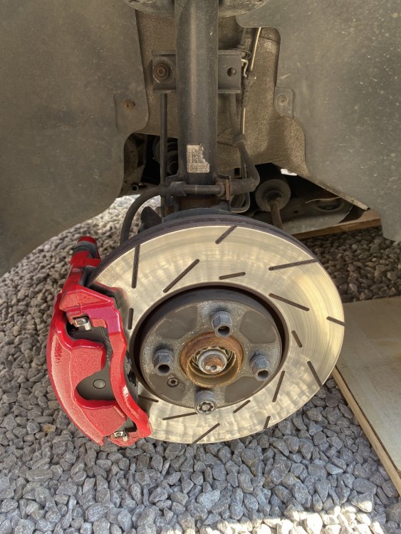

Fit the o/s driveshaft today and heat shield over it.

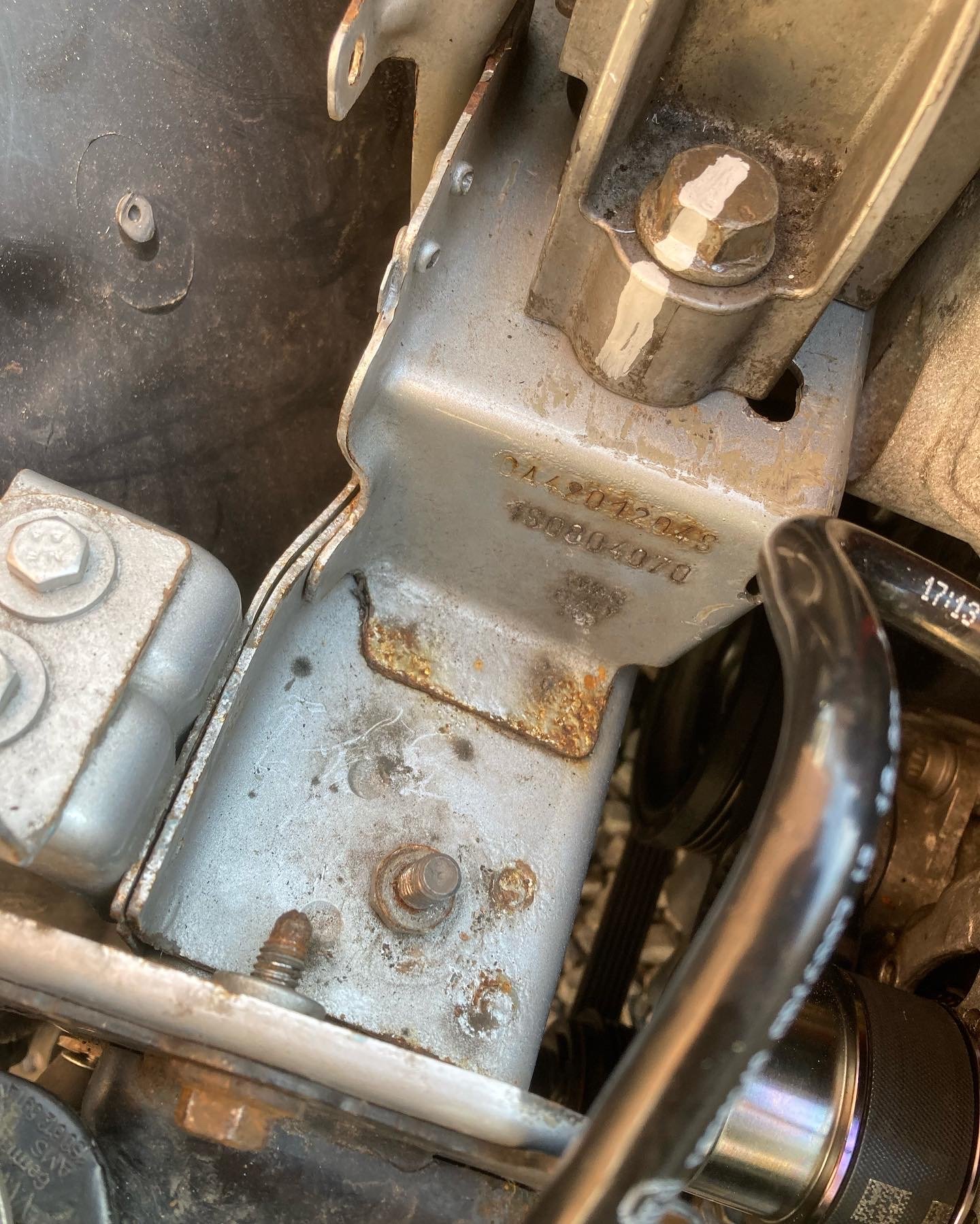

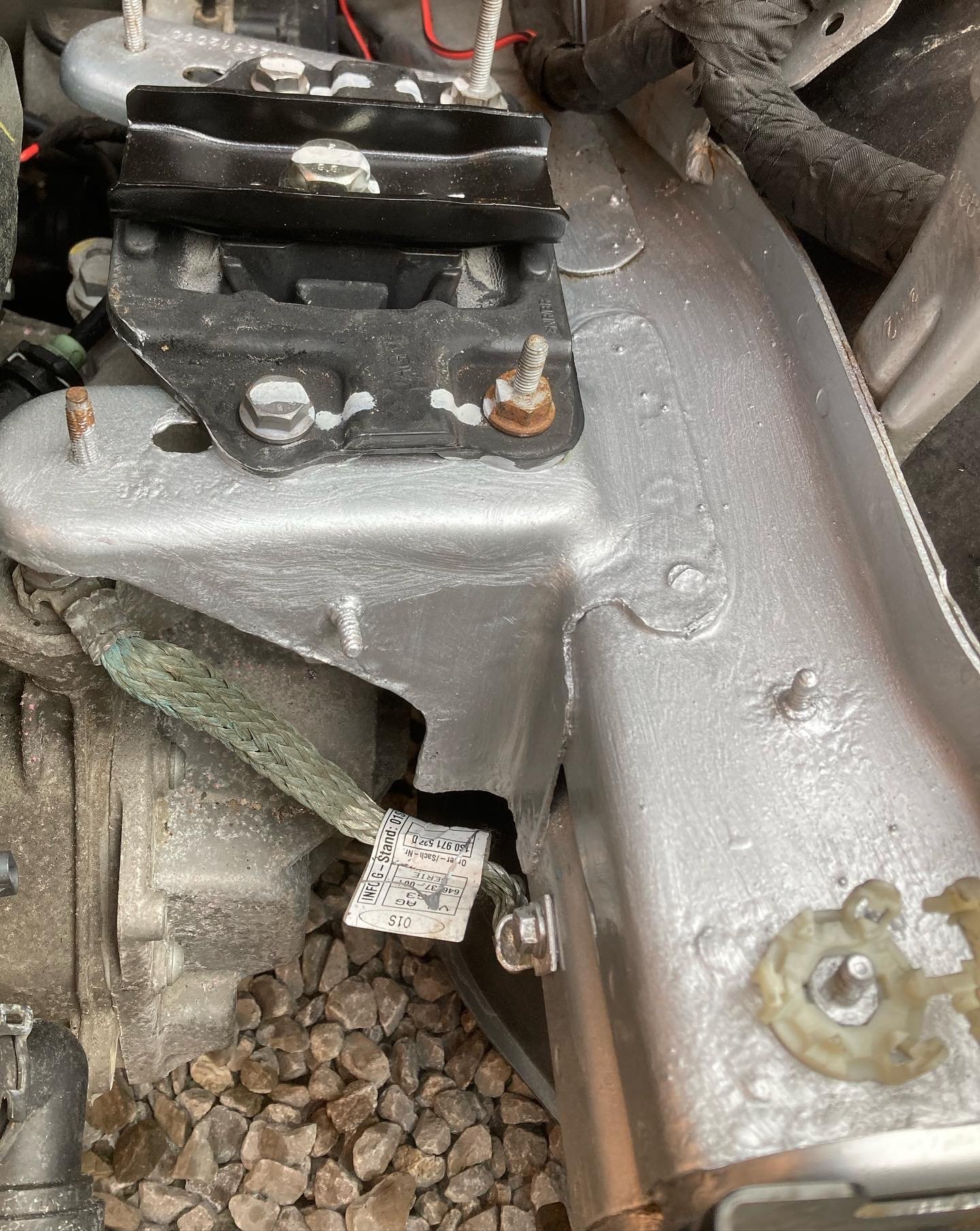

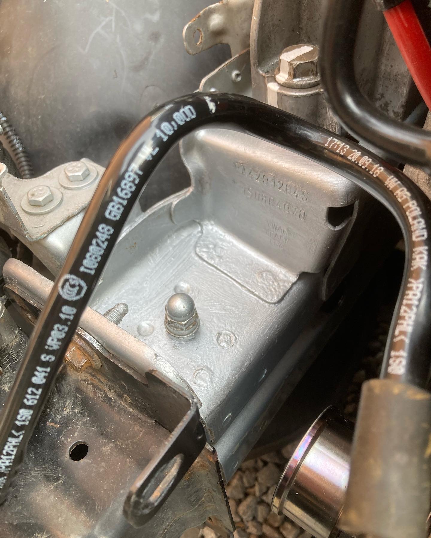

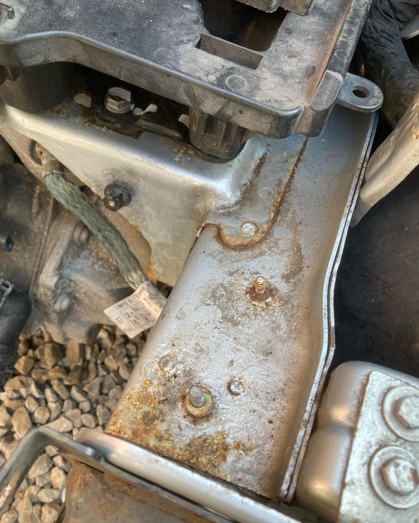

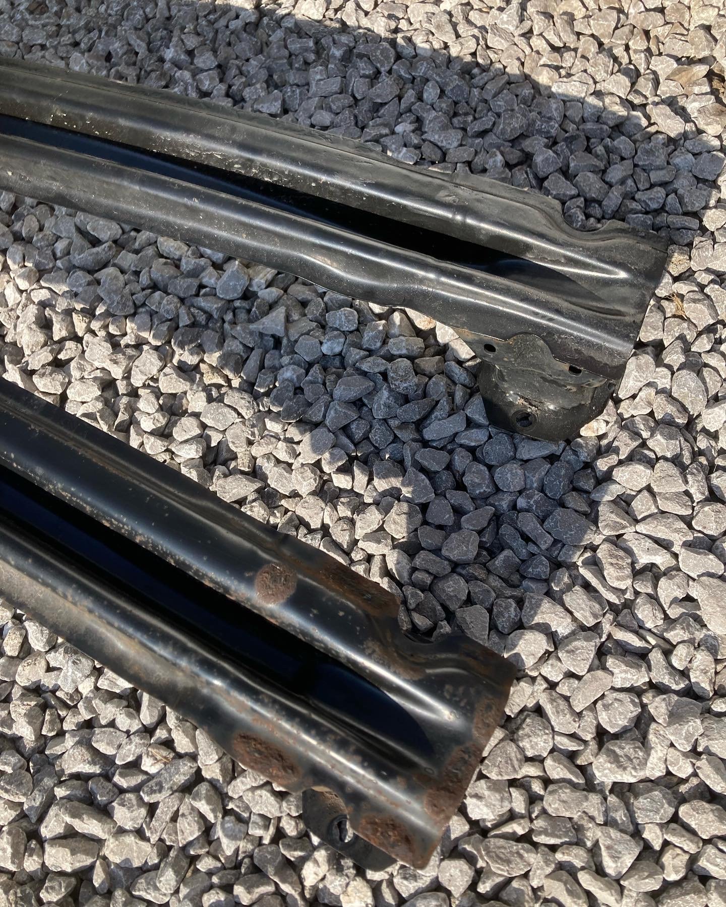

While the front was off I decided to treat the rust dots starting to appear as it was getting abit crusty. I’ve Treated it with some kurust and then a couple of coats of hammerite silver and they have come up not bad at all.

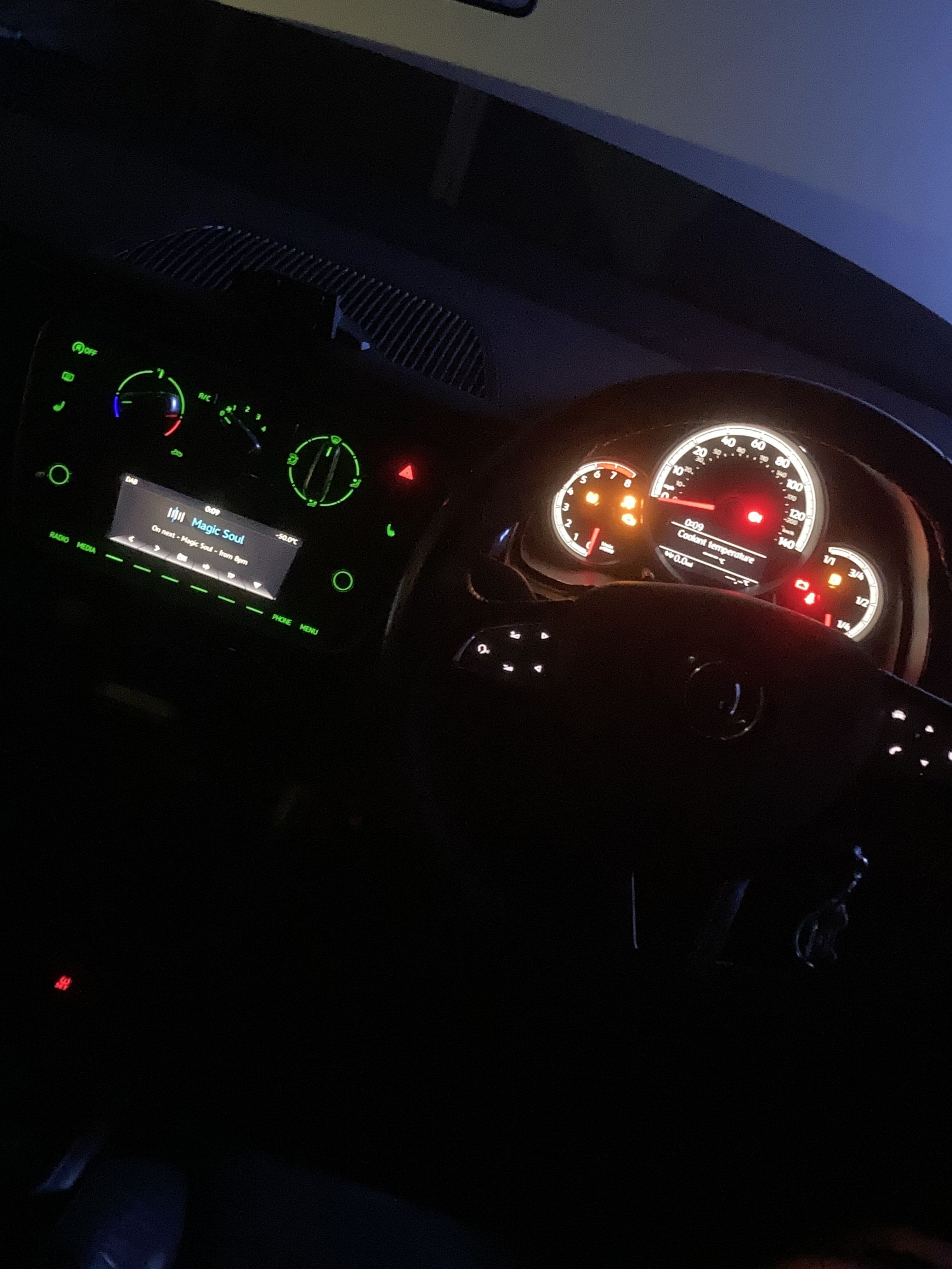

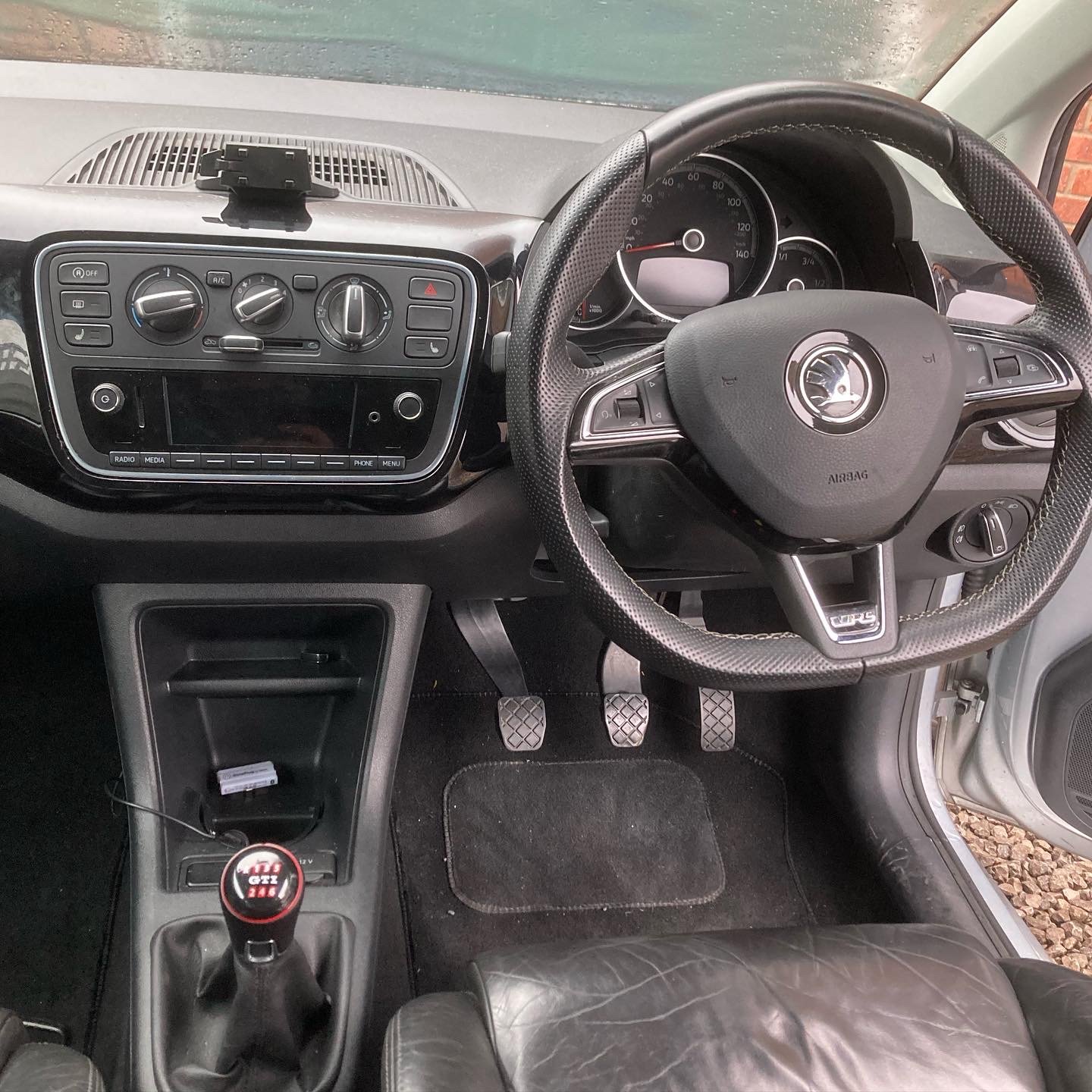

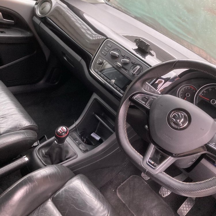

Got the dash all back together finally, I accidentally fitted the up gti heater controls and when  I was out in the dark, everything else is green except the heater that’s red 🤦‍♂️, so got the Skoda one back in and all looks lovely.

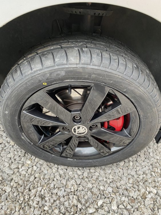

My driveshafts been dispatched, I’ve got a stop start battery coming tomorrow.
I’m just waiting on rad mounts, fingers crossed will be moving under its own steam on Saturday.

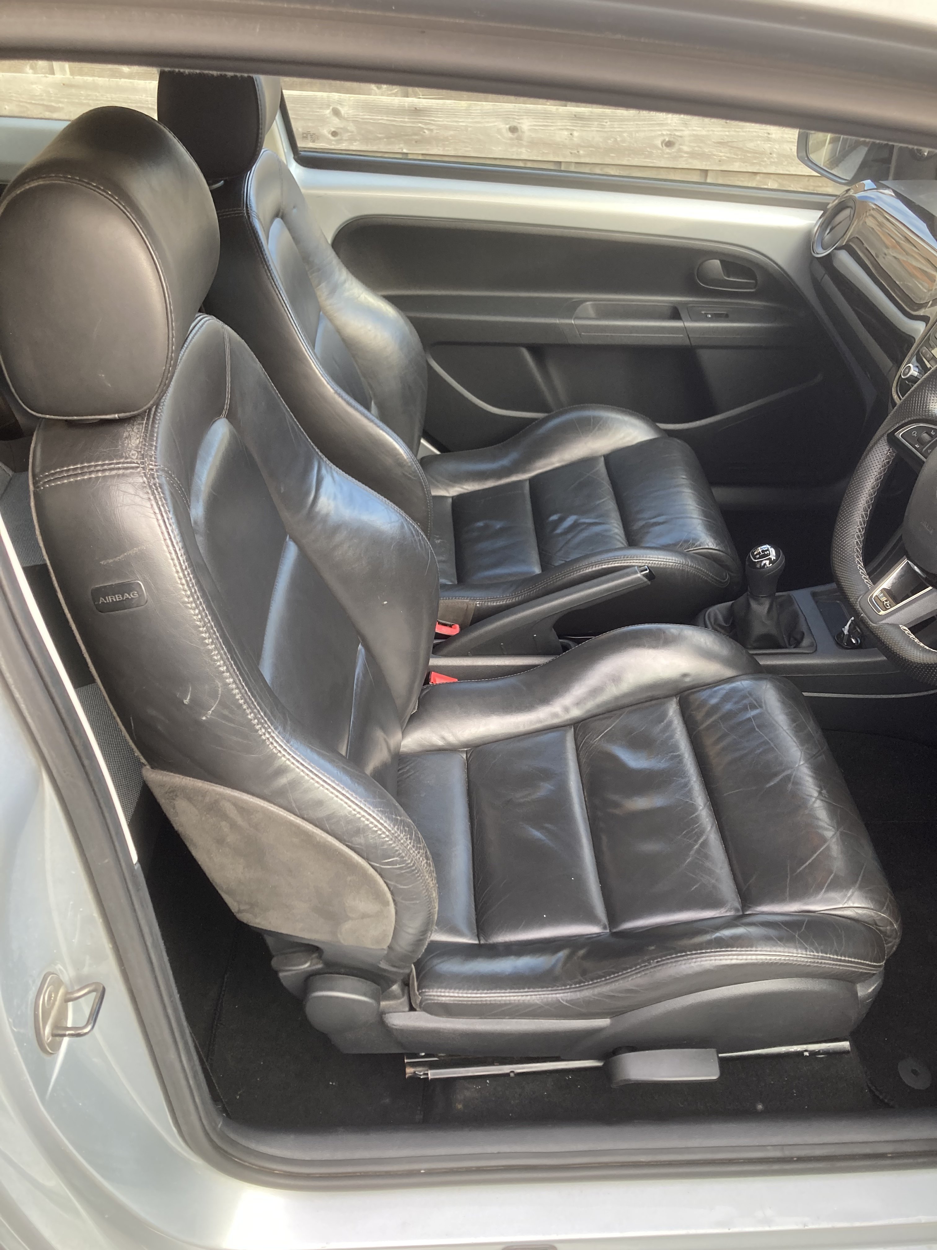

Those seats fit nicely in there, and they're chuffing gorgeous! :inlove:
Yes indeed a great £100 mod, I had TT seats in my mk1 Fabia for 1000’s of miles and there great
Little night shot, the steering wheel controls work the stereo but unfortunately doesn’t toggle the dash functions so I’ll need to experiment with that see if I can get some different buttons to work as I really don’t want to change the wheel,
at least it looks good
