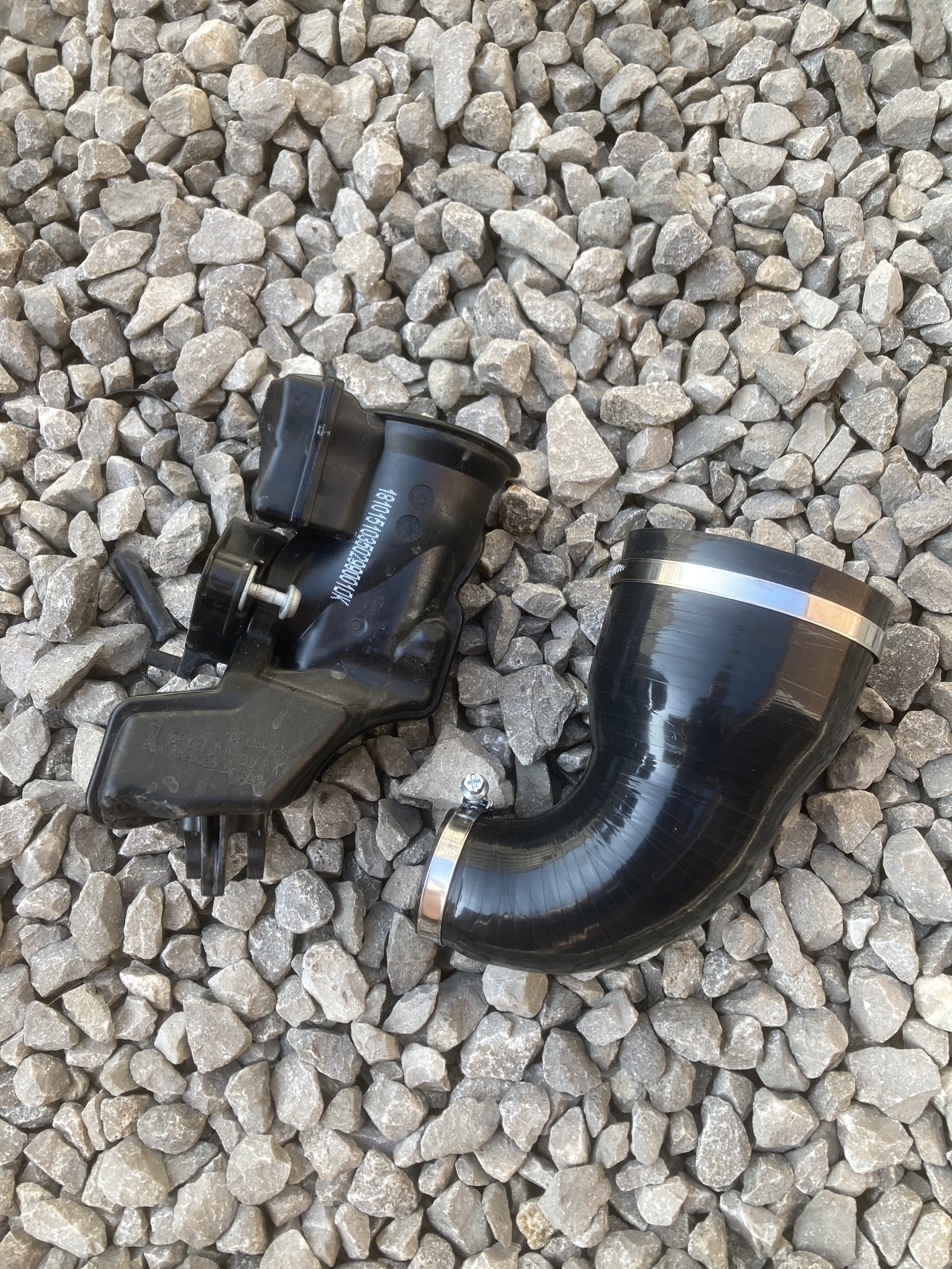

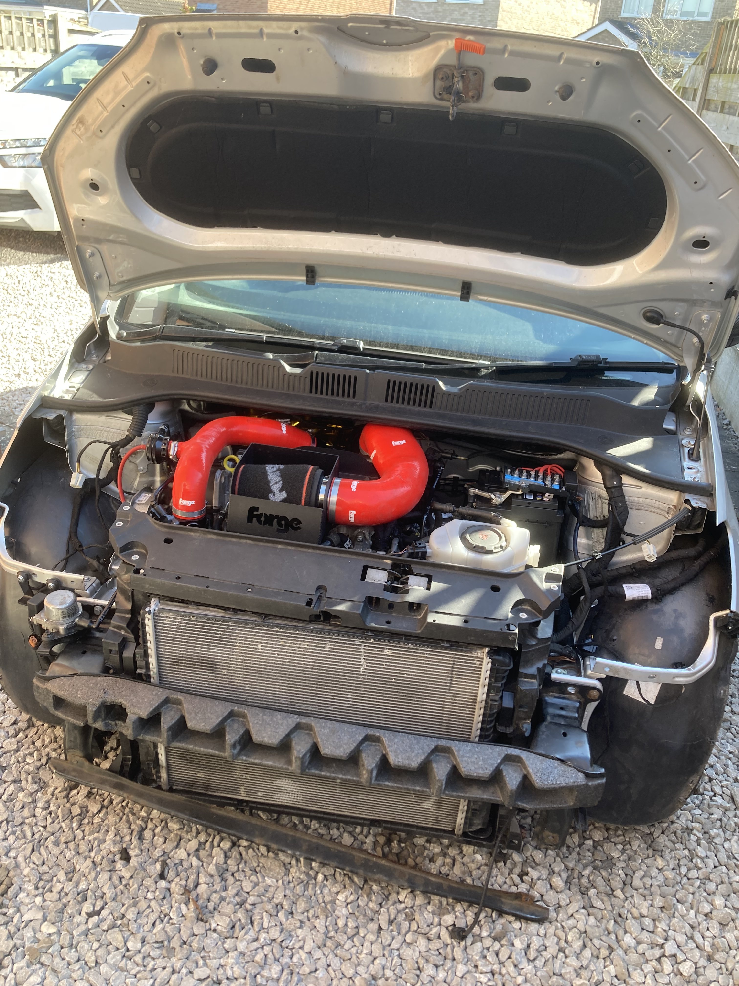

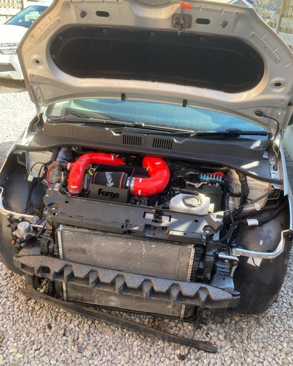

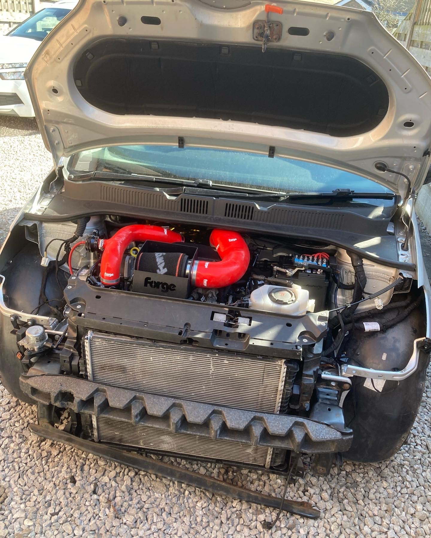

Picked up my last couple of bits this morning, fitted the rad pack up and ran the wiring to where it needs to go.
Unfortunately my driveshaft has gone awol with parcelforce so waiting to see what happens hopefully it will arrive next week.
anyway pics of the rad

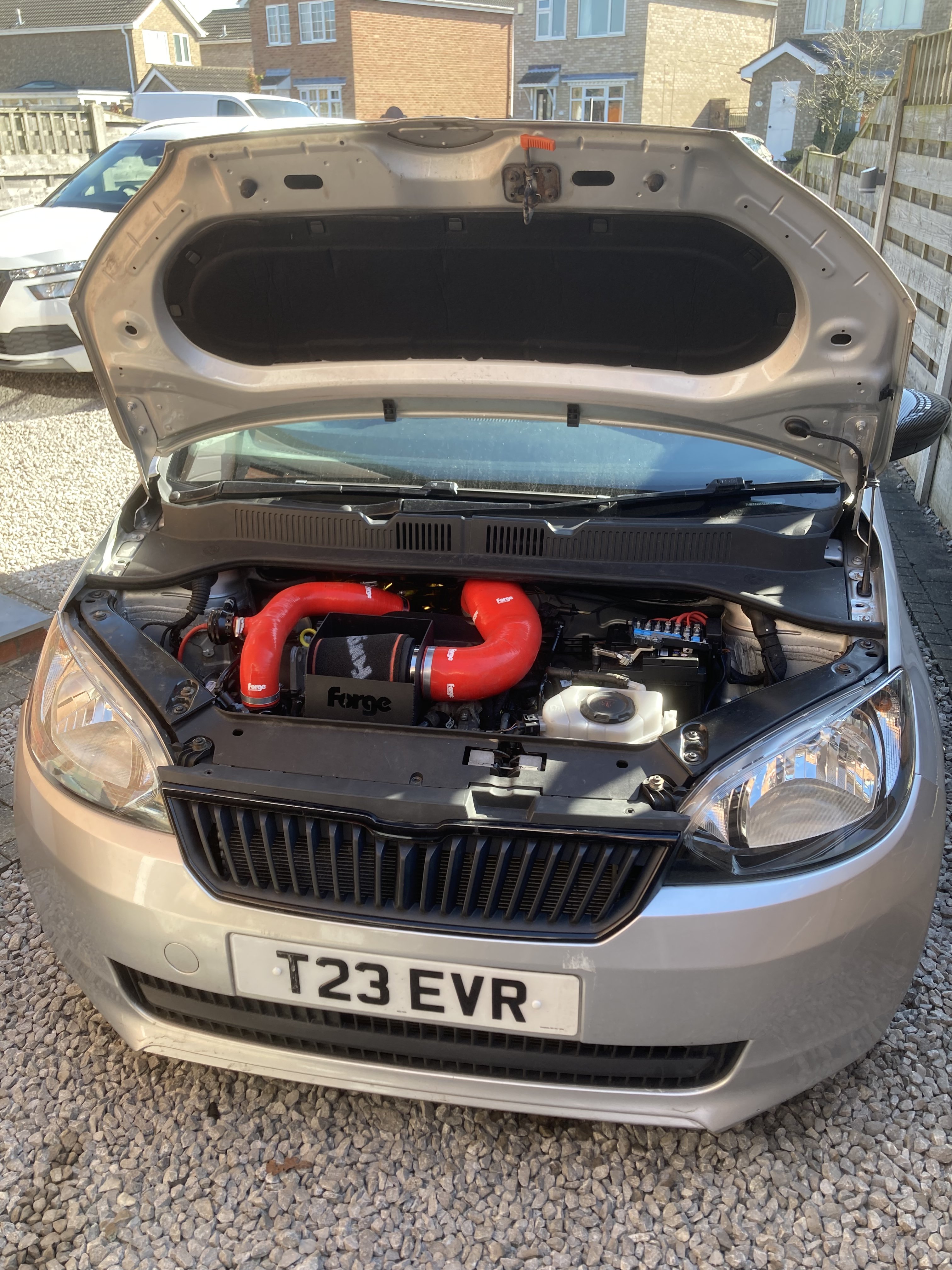

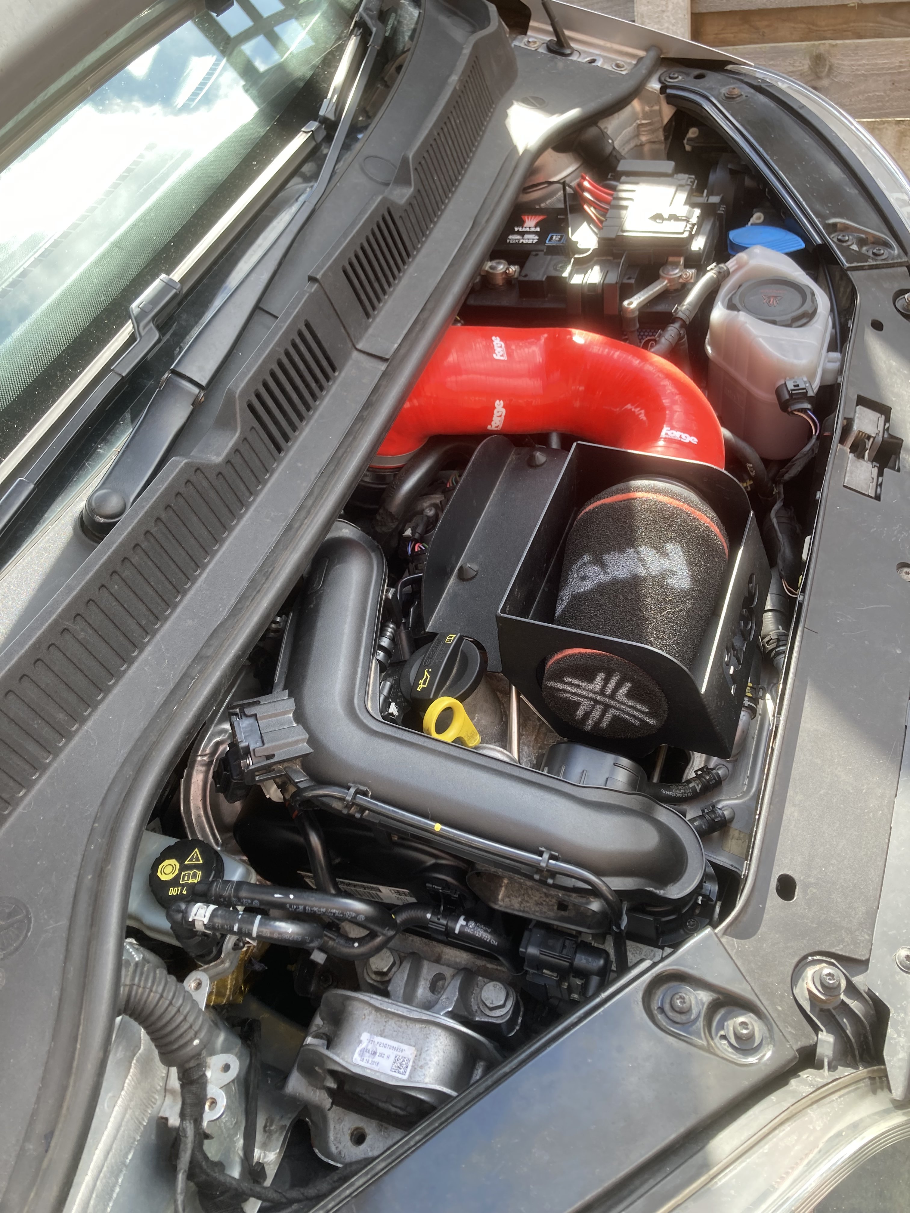

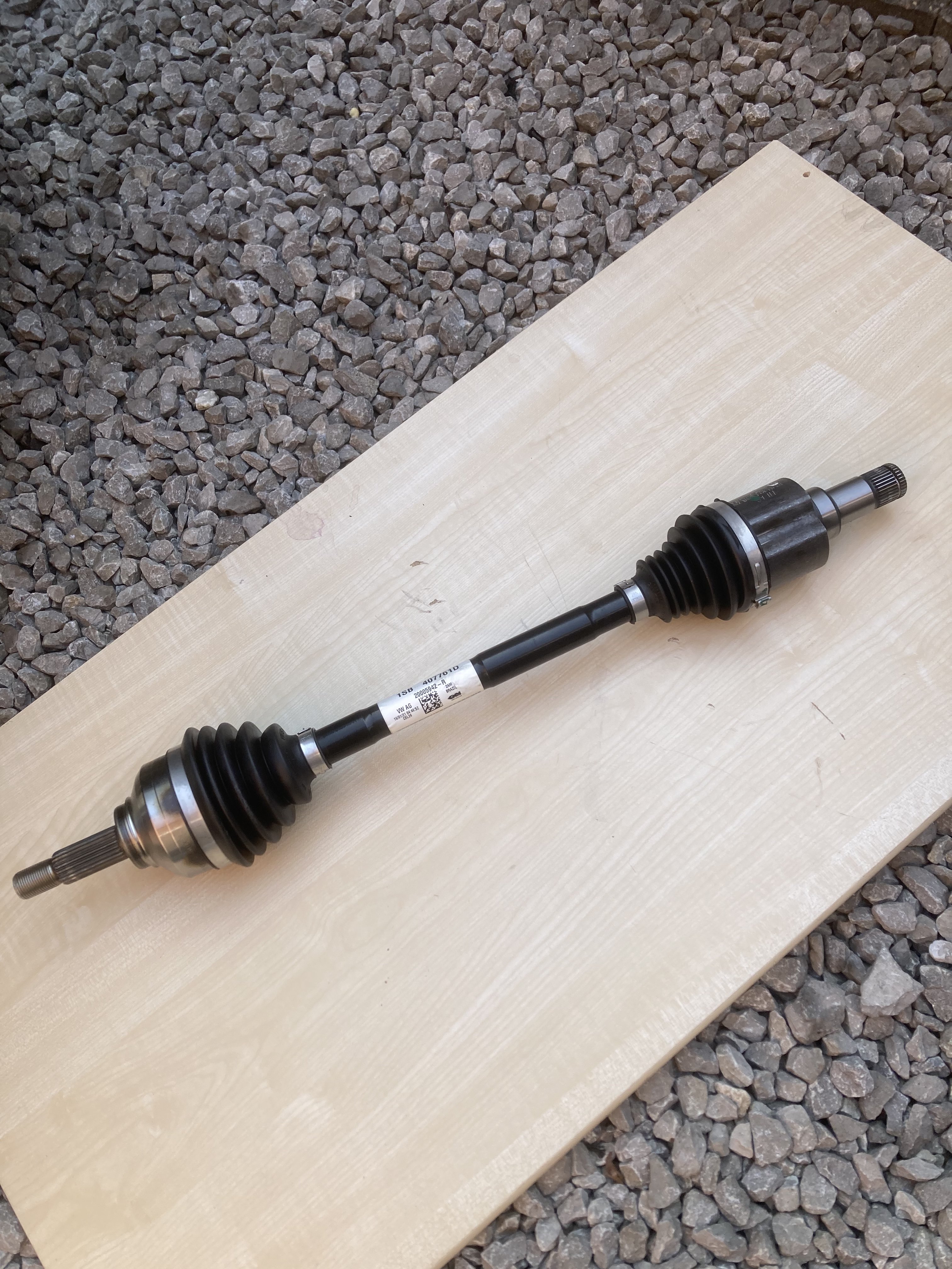

  • Done Driveshaft arrived yesterday,  so got that fitted, gearbox oil filled, lovely traditional fill to spill box in these no set figure like the 5 speeds,   Coolant in and r
  • Got a little build tag made, came out great
  • Some pics from the past few days

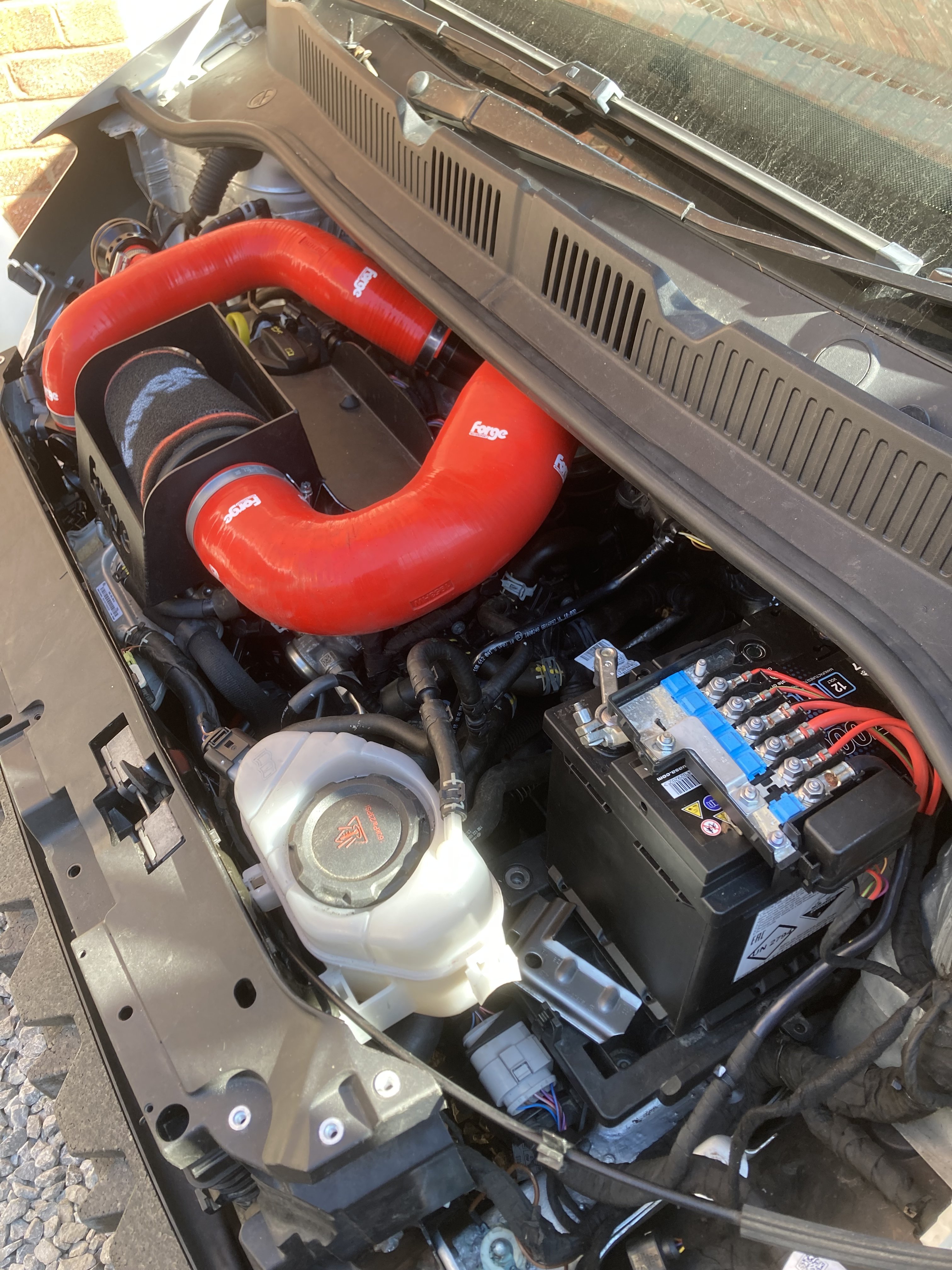

Shown up a couple of little things

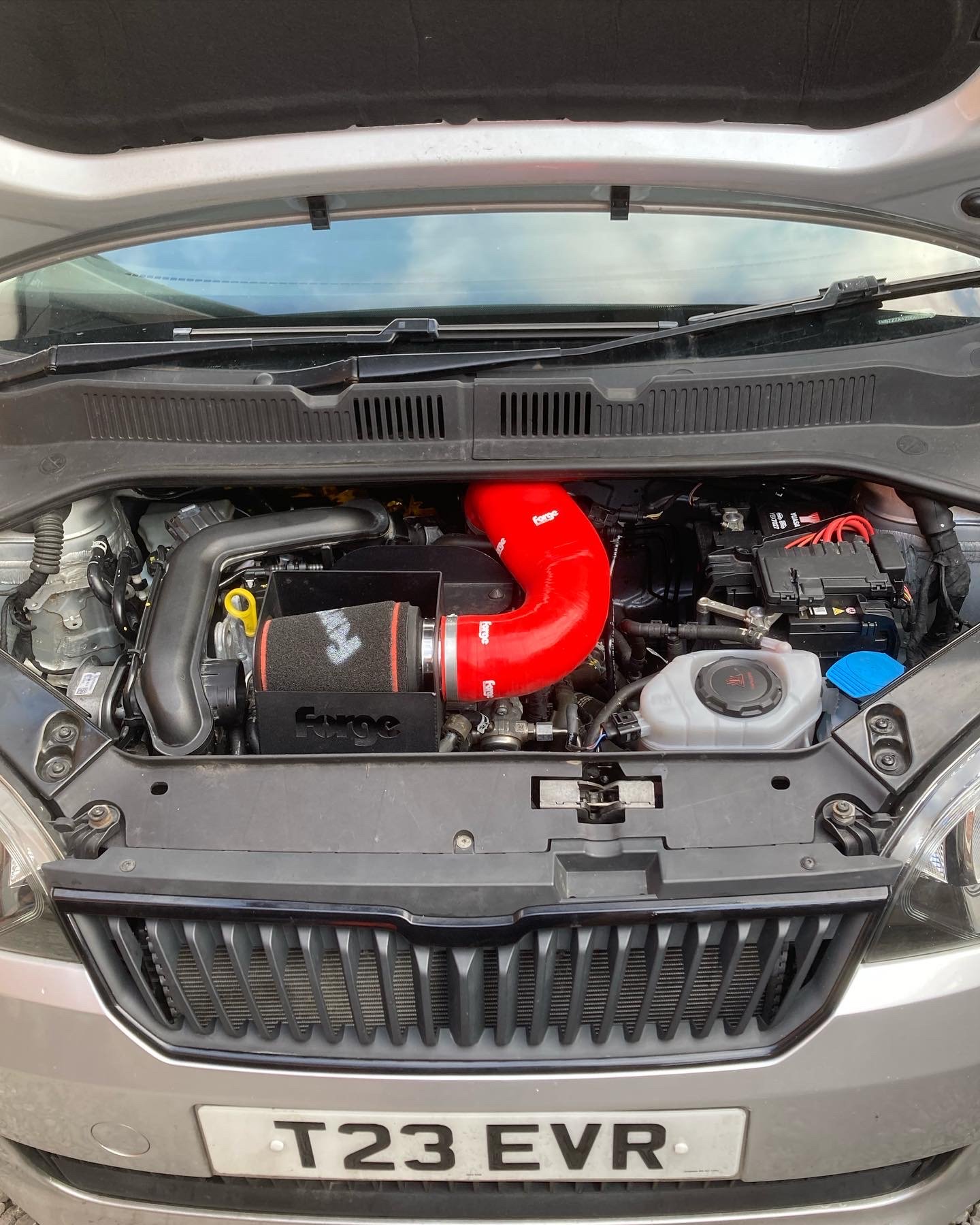

1: how I wasn’t happy with the forge bov, maybe abit old for that now 😂, so standard pipes back on
2: My inner driveshaft gaitor appears to have a small hole causing grease to be thrown about, lucky I had a spare so swapped that today,
Other then that all seems well

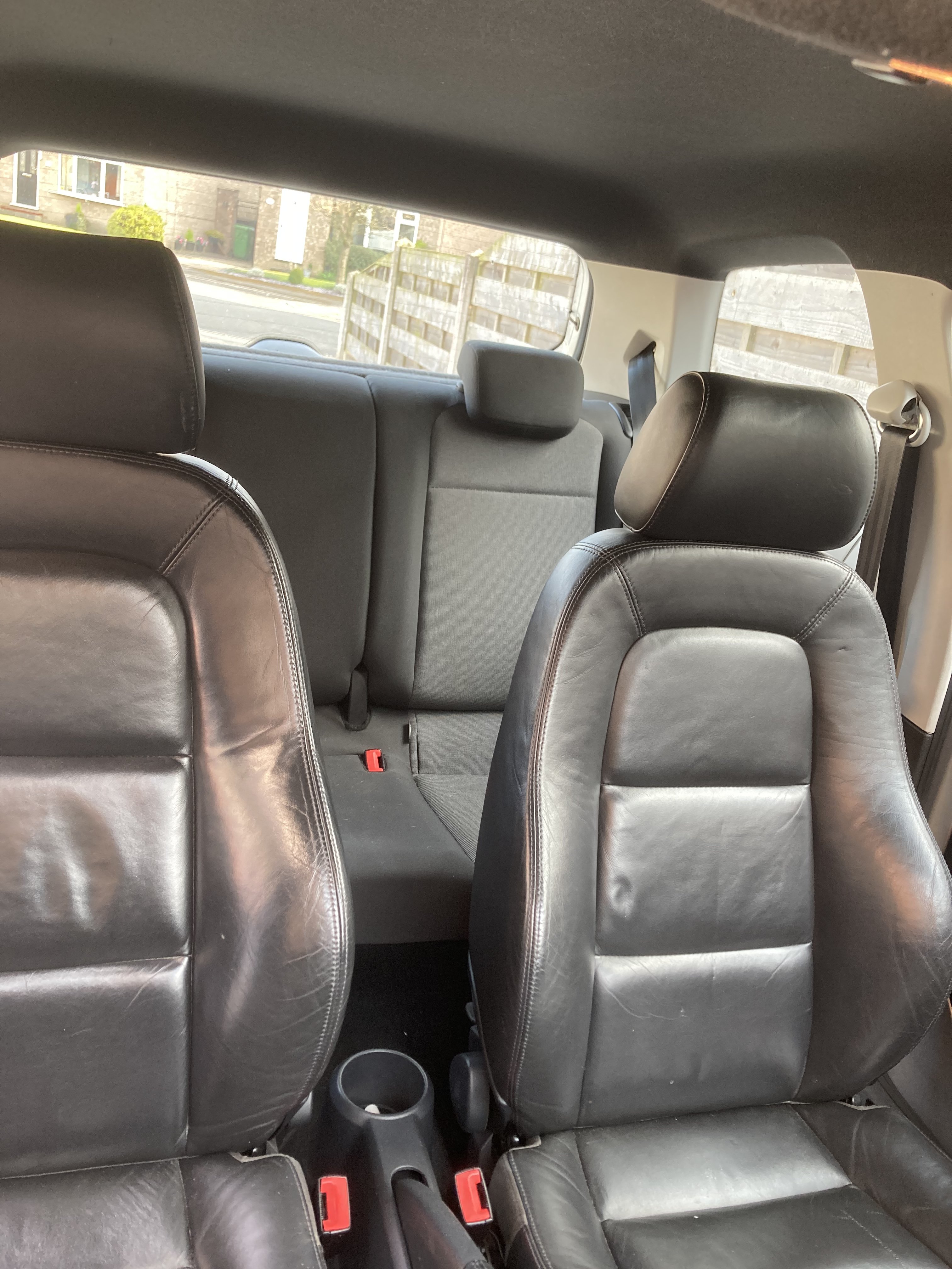

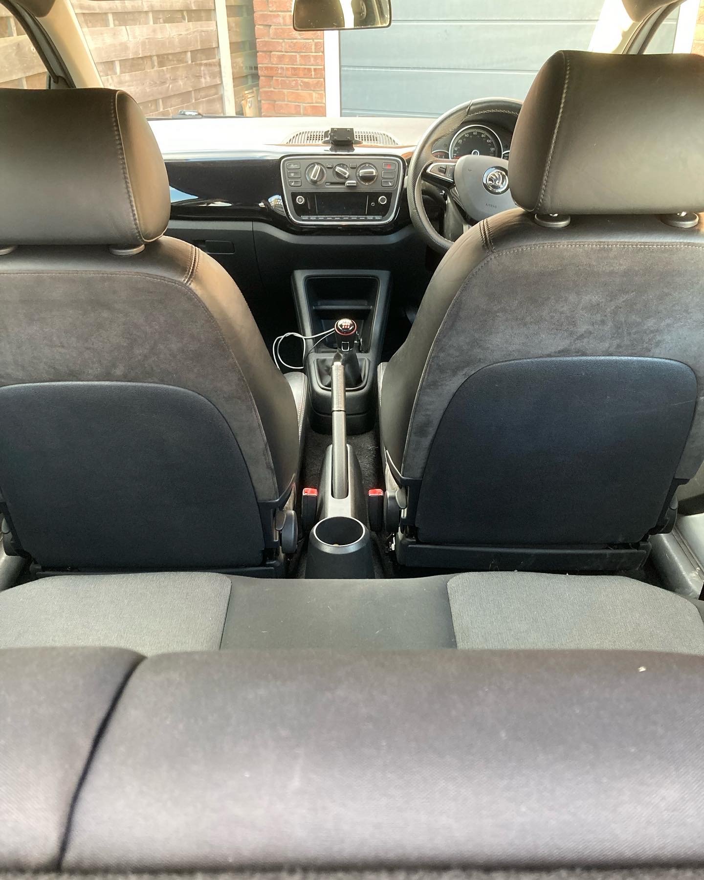

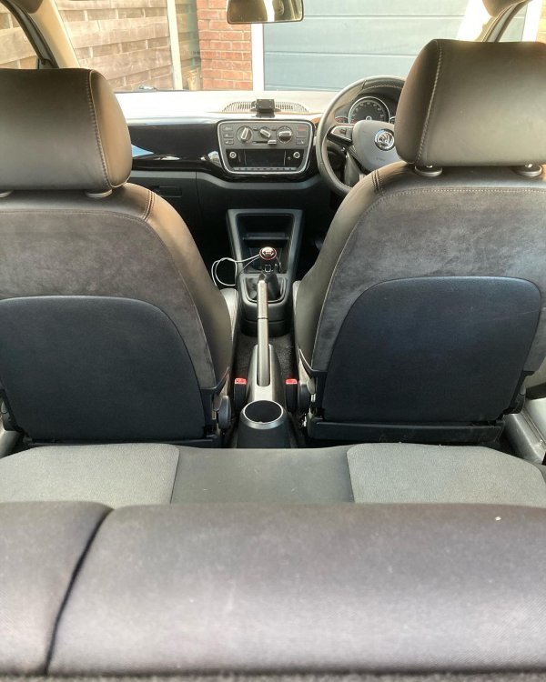

Picked up some back seats so full interior in now,
Just need some leather rear seats now... ;)
not too bothered there only for the dogs 😂

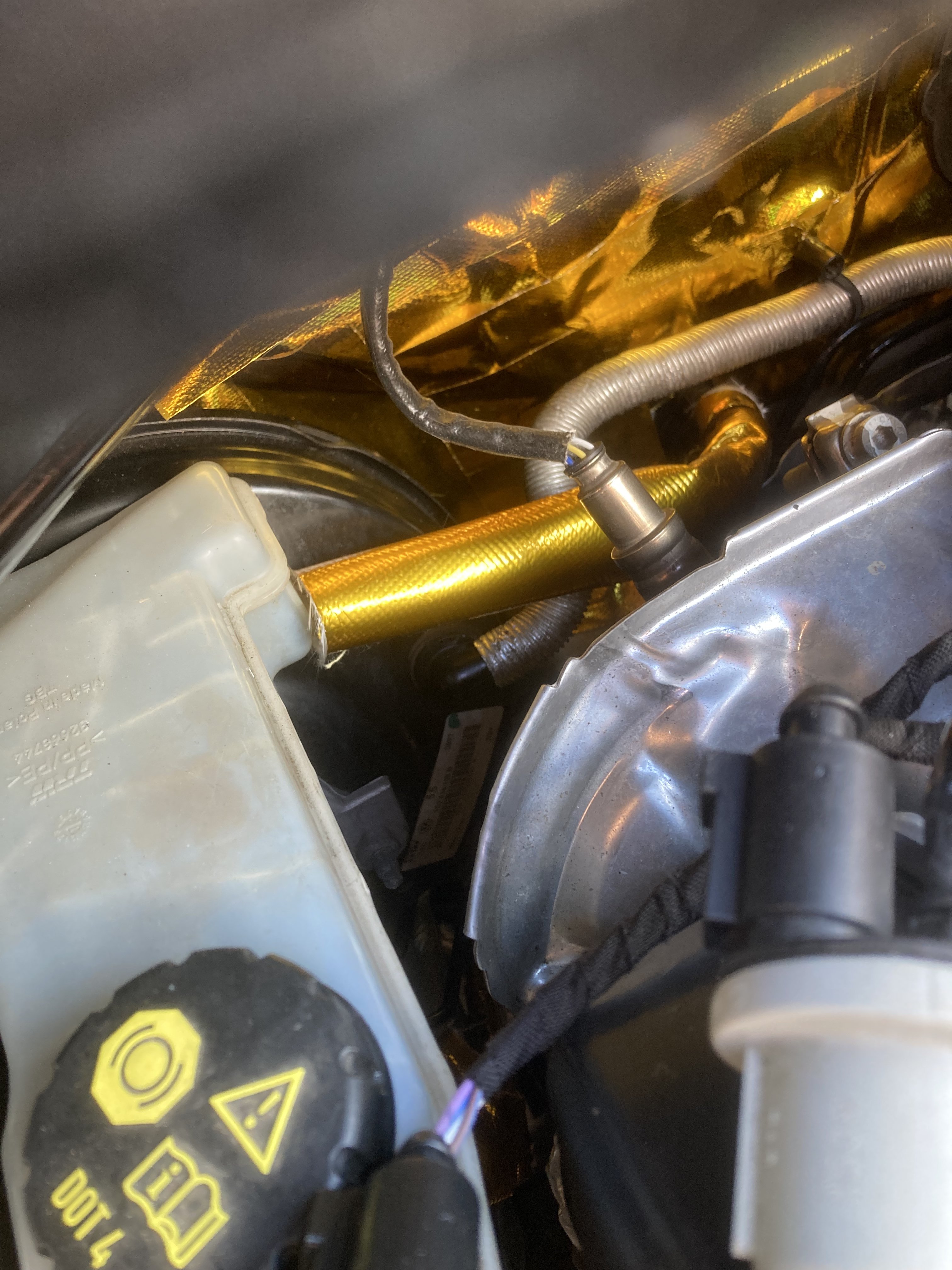

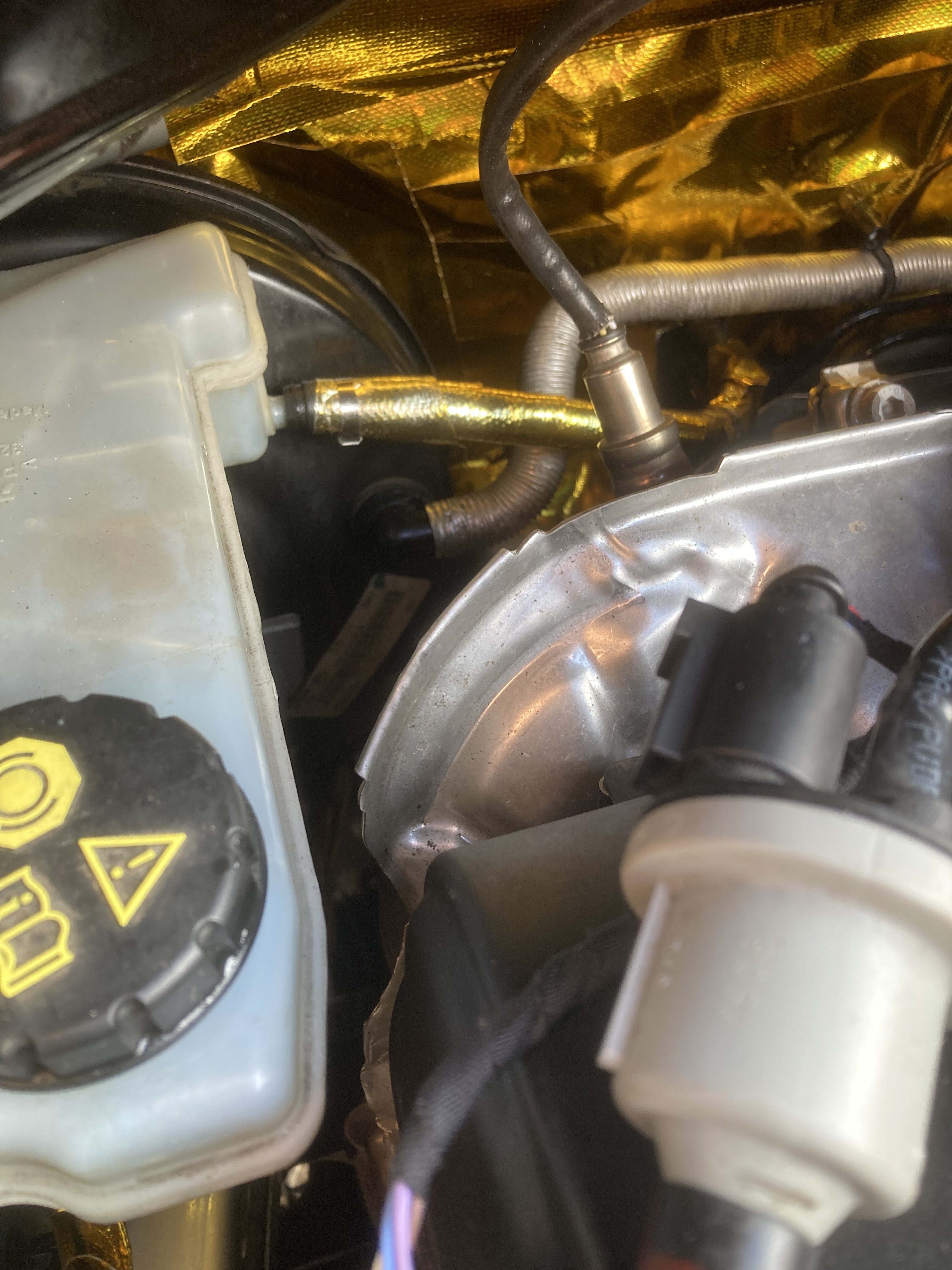

Noticed my forge heat tape around clutch feed was struggling with the heat, and already started to discolour after only 500 miles. So upgraded to some gold heat sleeving from funk motorsport to hopefully keep the heat in check

Most competition cars I've seen IRL use a white woven heat shield, which does discolour, but not enough to bother the drivers.
I didn’t want to risk it being a plastic pipe with brake fluid in it , better safe then sorry :)
Ah, I was thinking mostly of exhaust manifolds, primary downpipes and turbos.

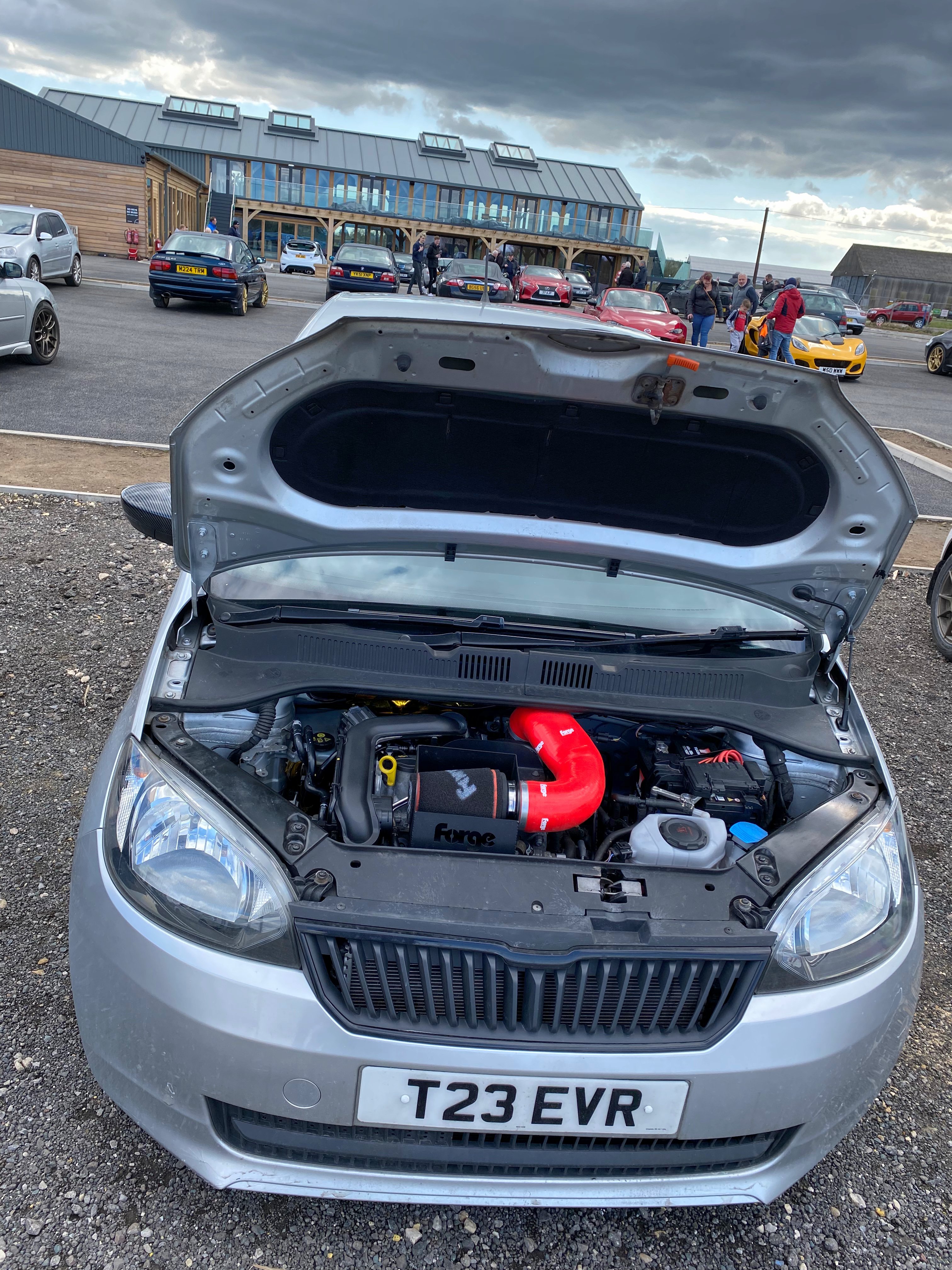

Little pic from an outing to motorist hub at the weekend

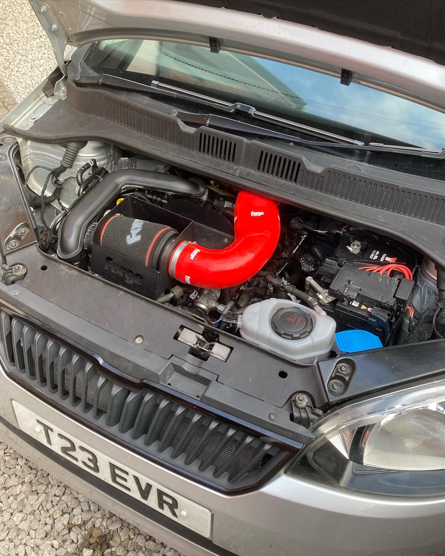

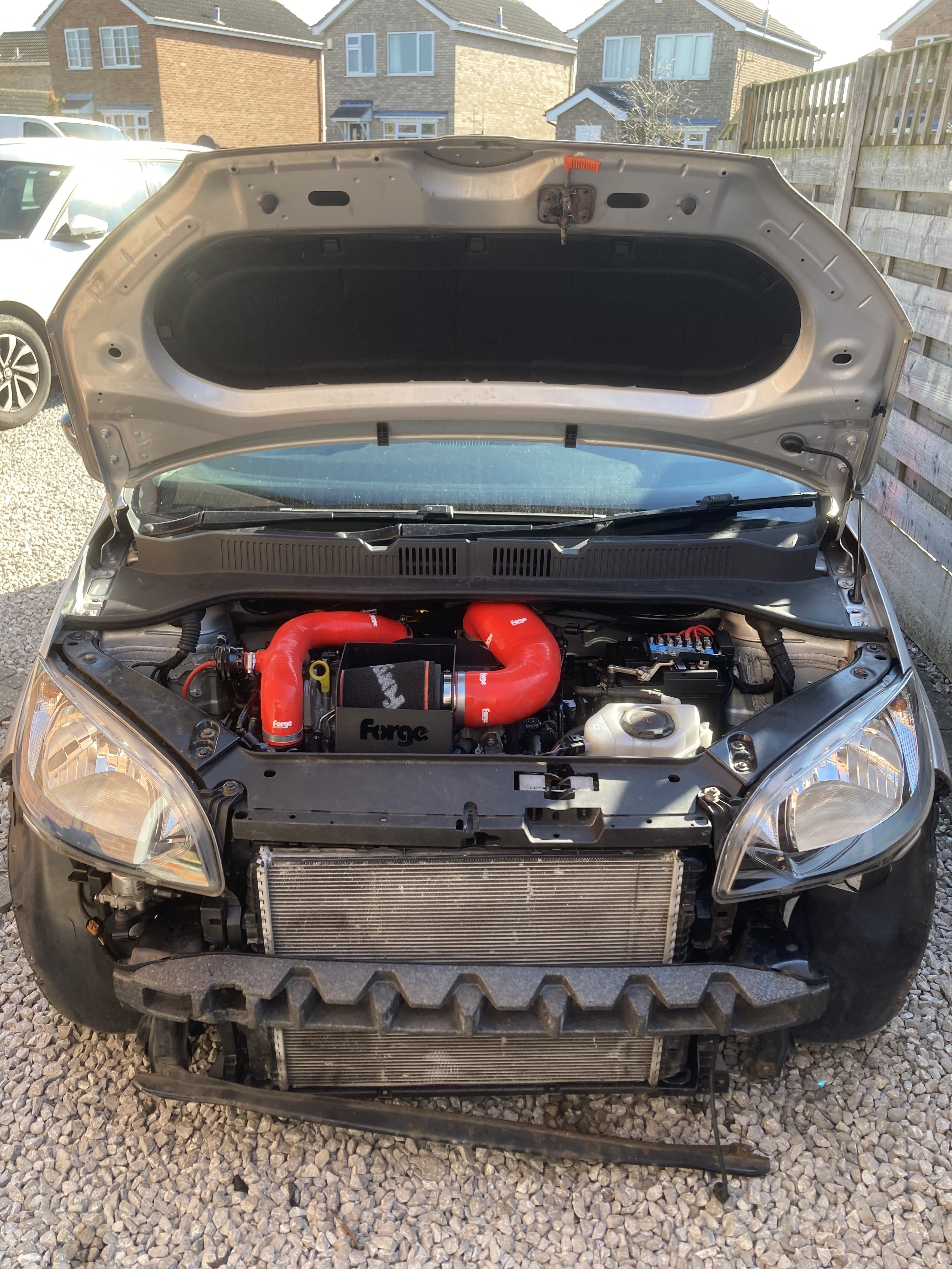

I liked the forge gear but got tired of it pretty quick so going back to looking oem under the bonnet :)
Still got some mods planned sports cat/panel filter/turbo elbow and will eventually go stage 2 map and anything north of 150bhp will be very happy with, not for a while yet though, they see around 155-165 normally stage 2

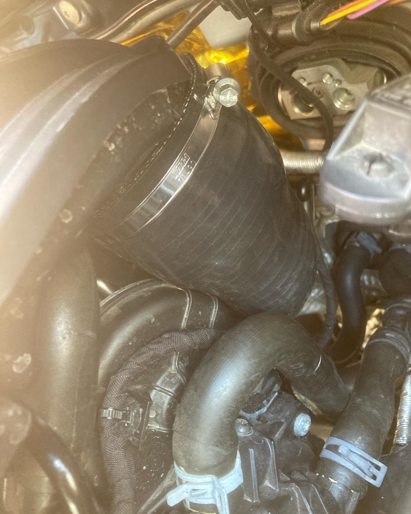

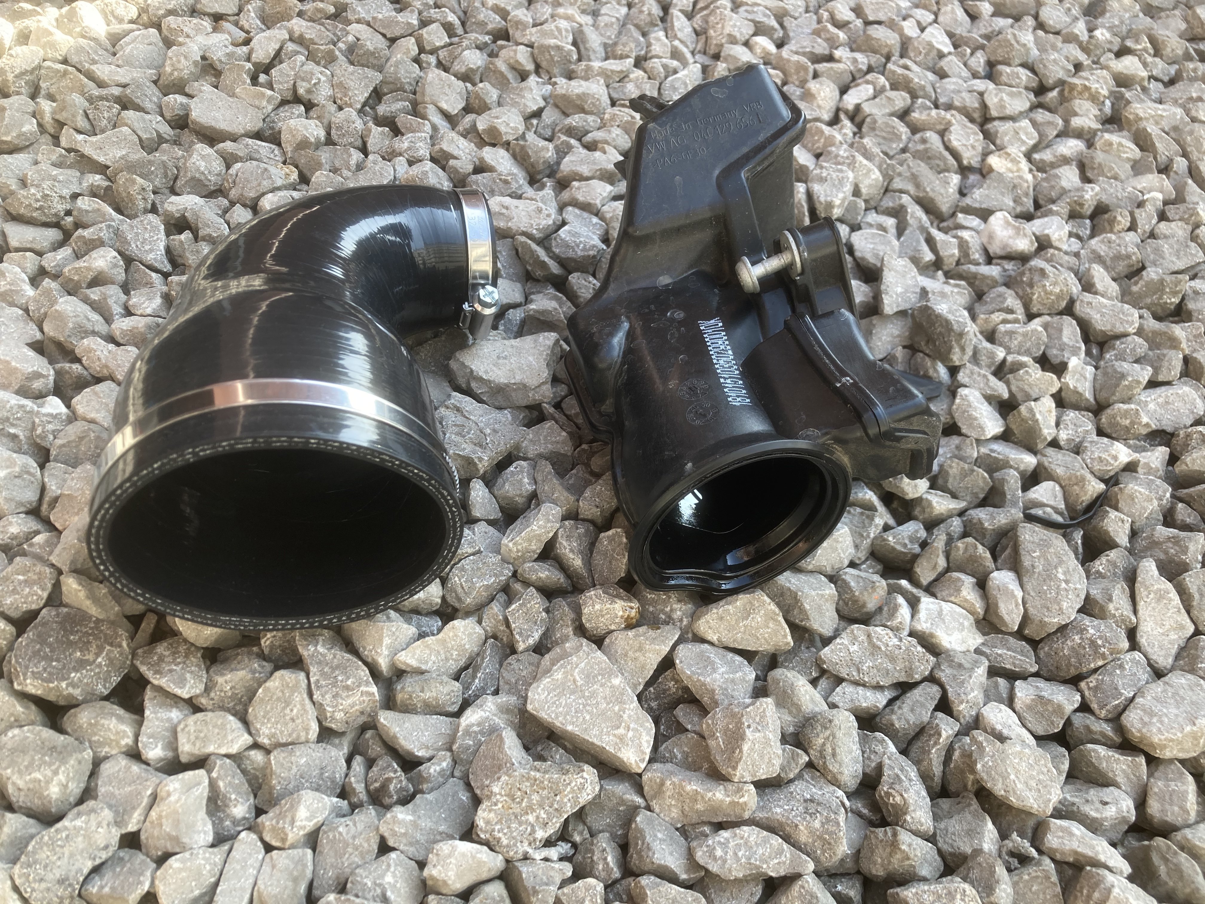

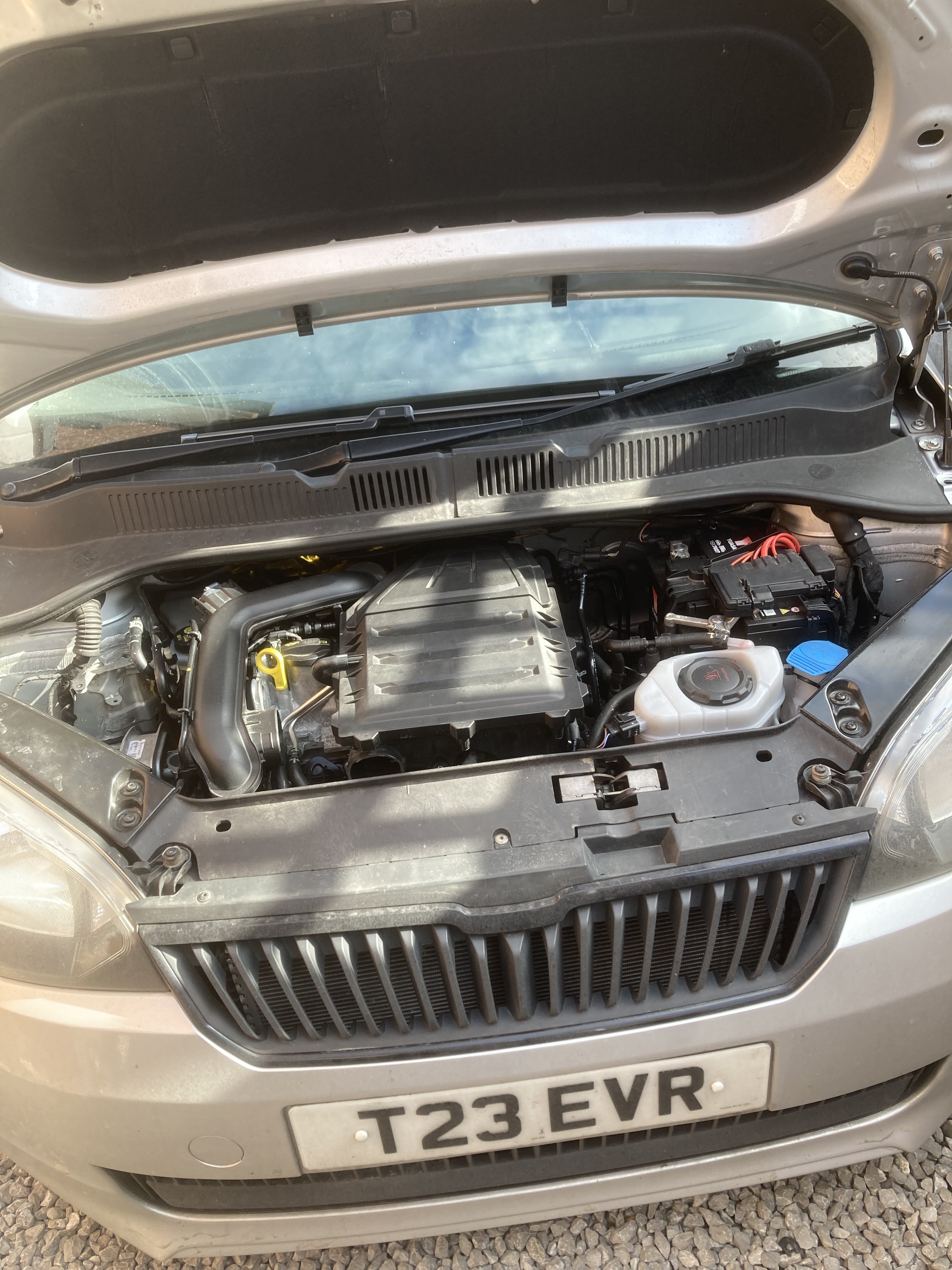

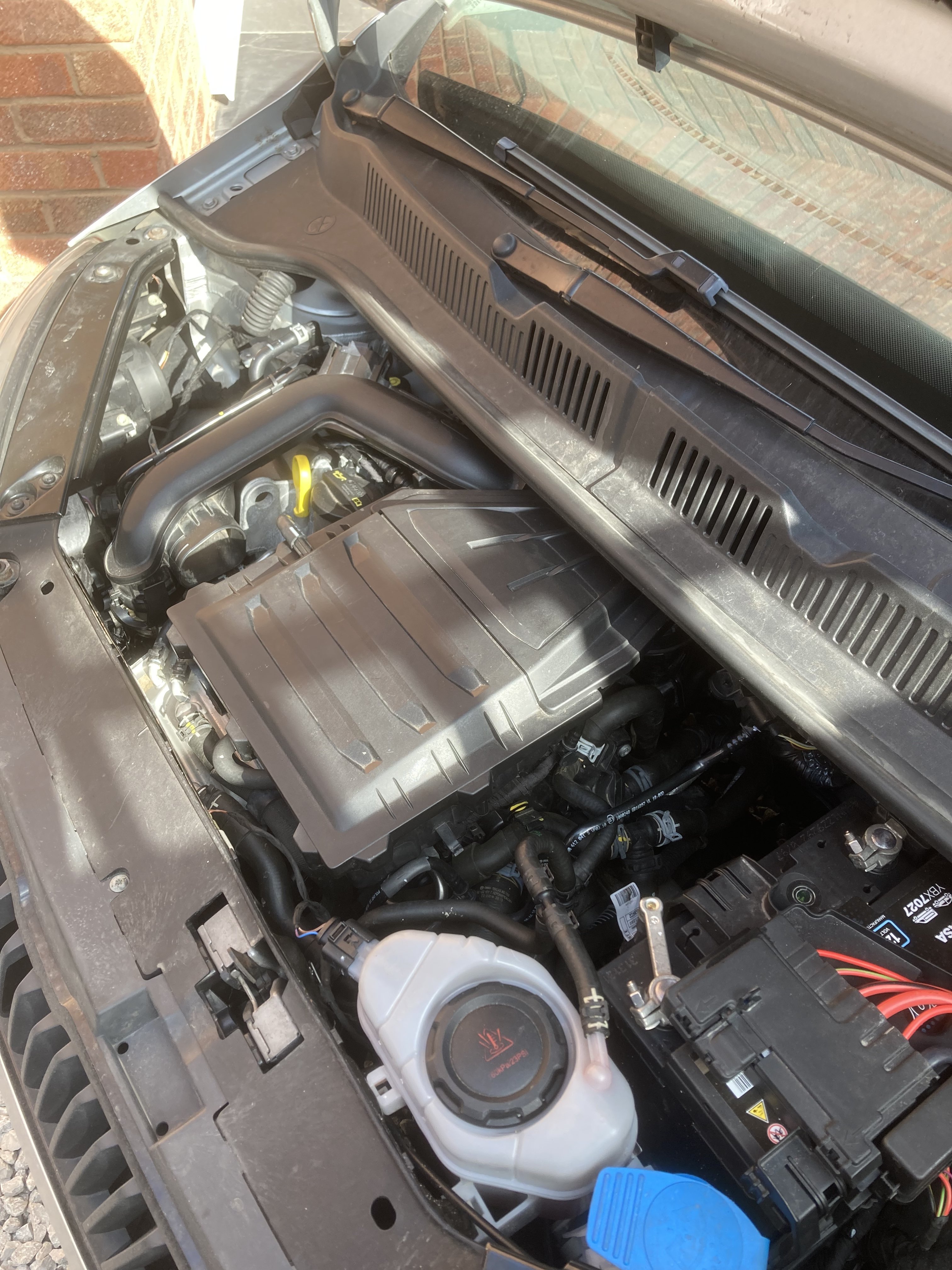

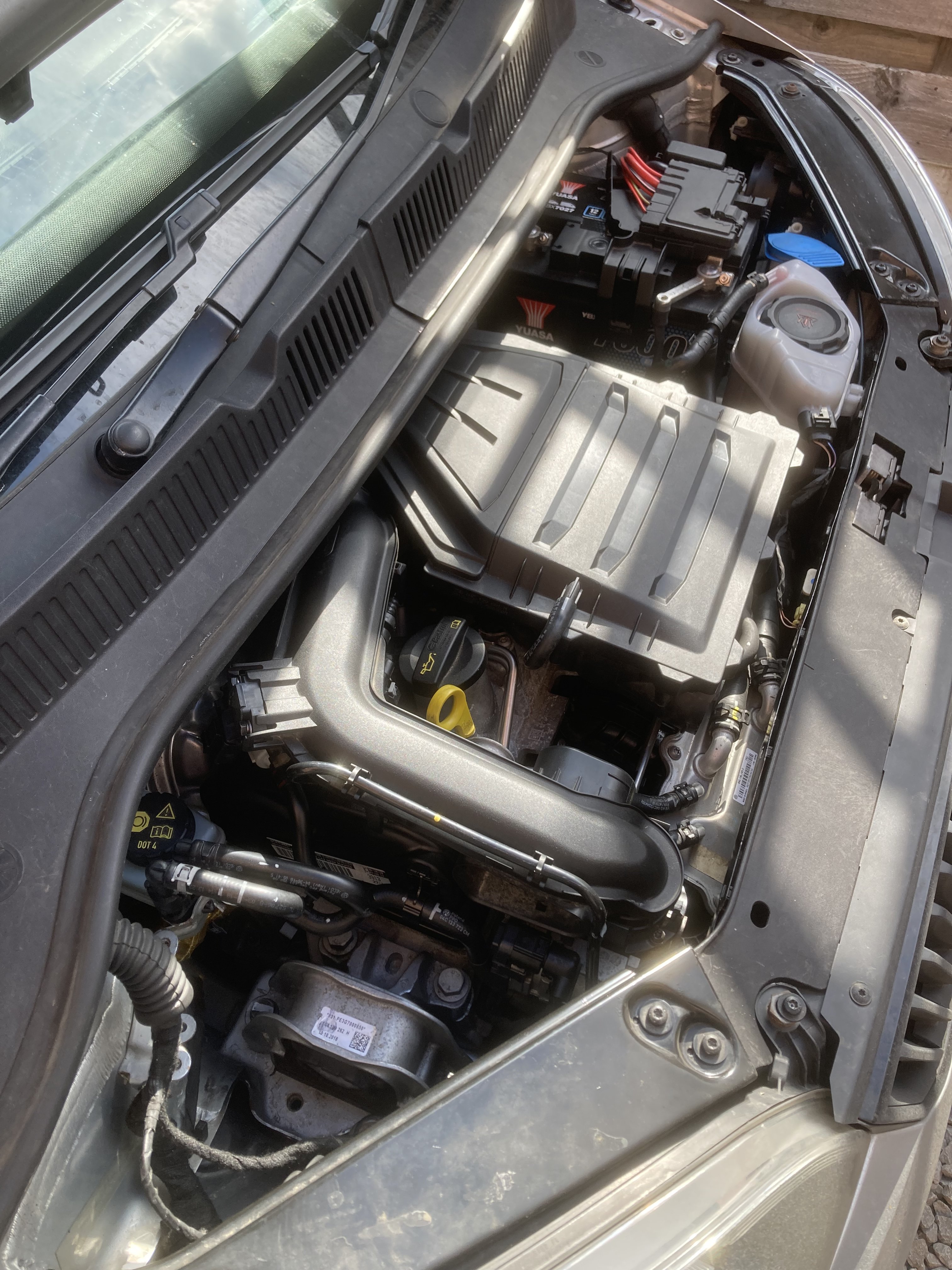

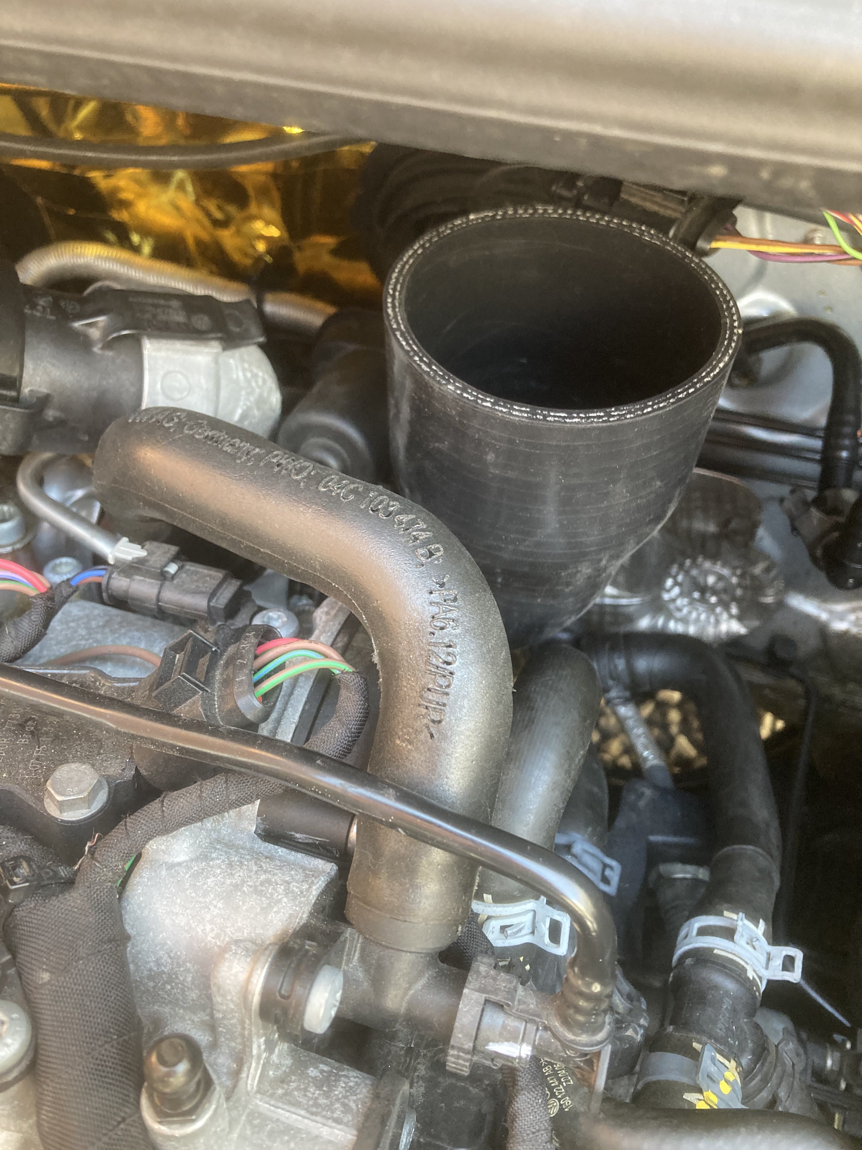

Jbs turbo inlet pipe on today,
pretty good fit, went on quite easy

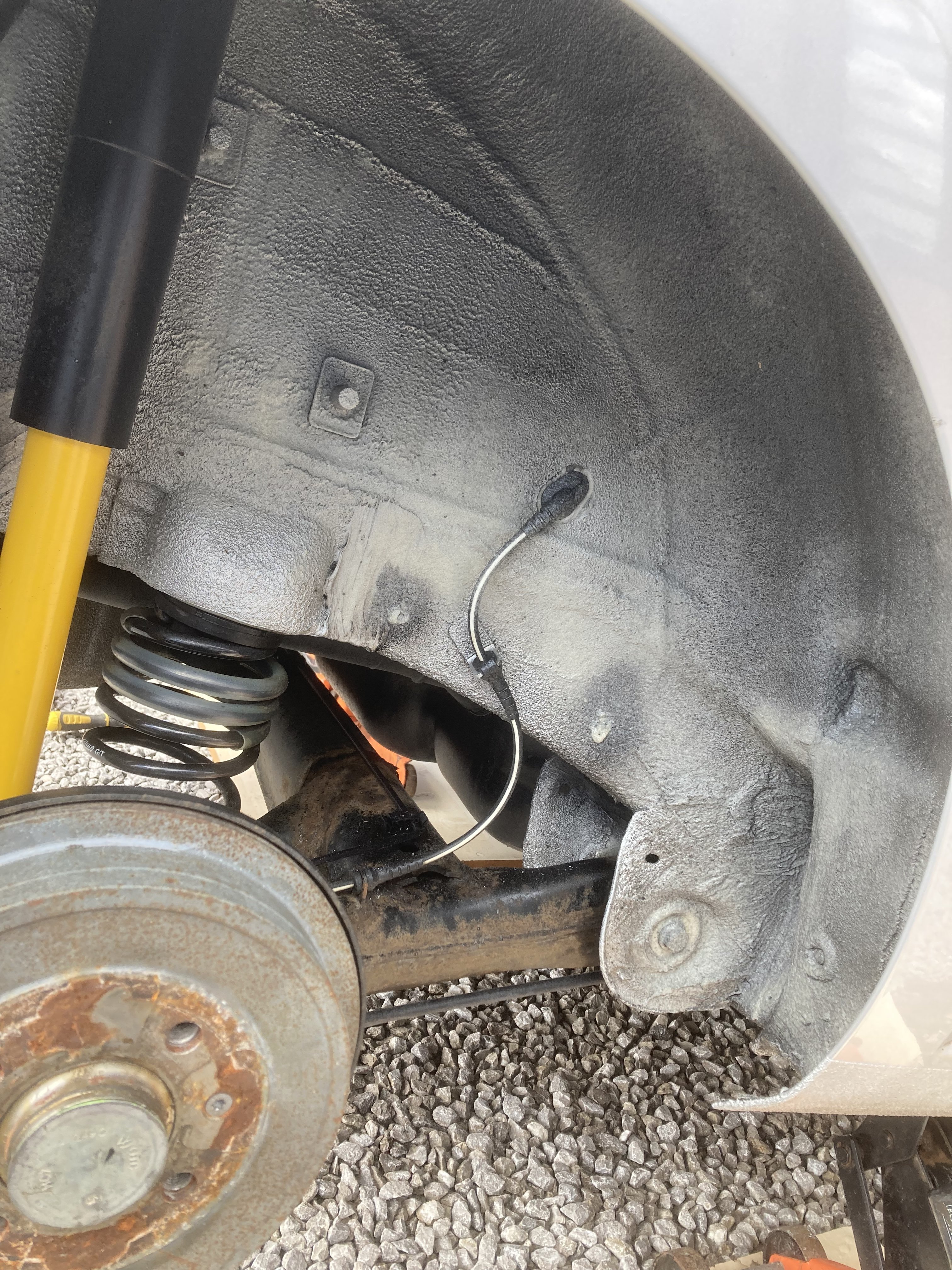

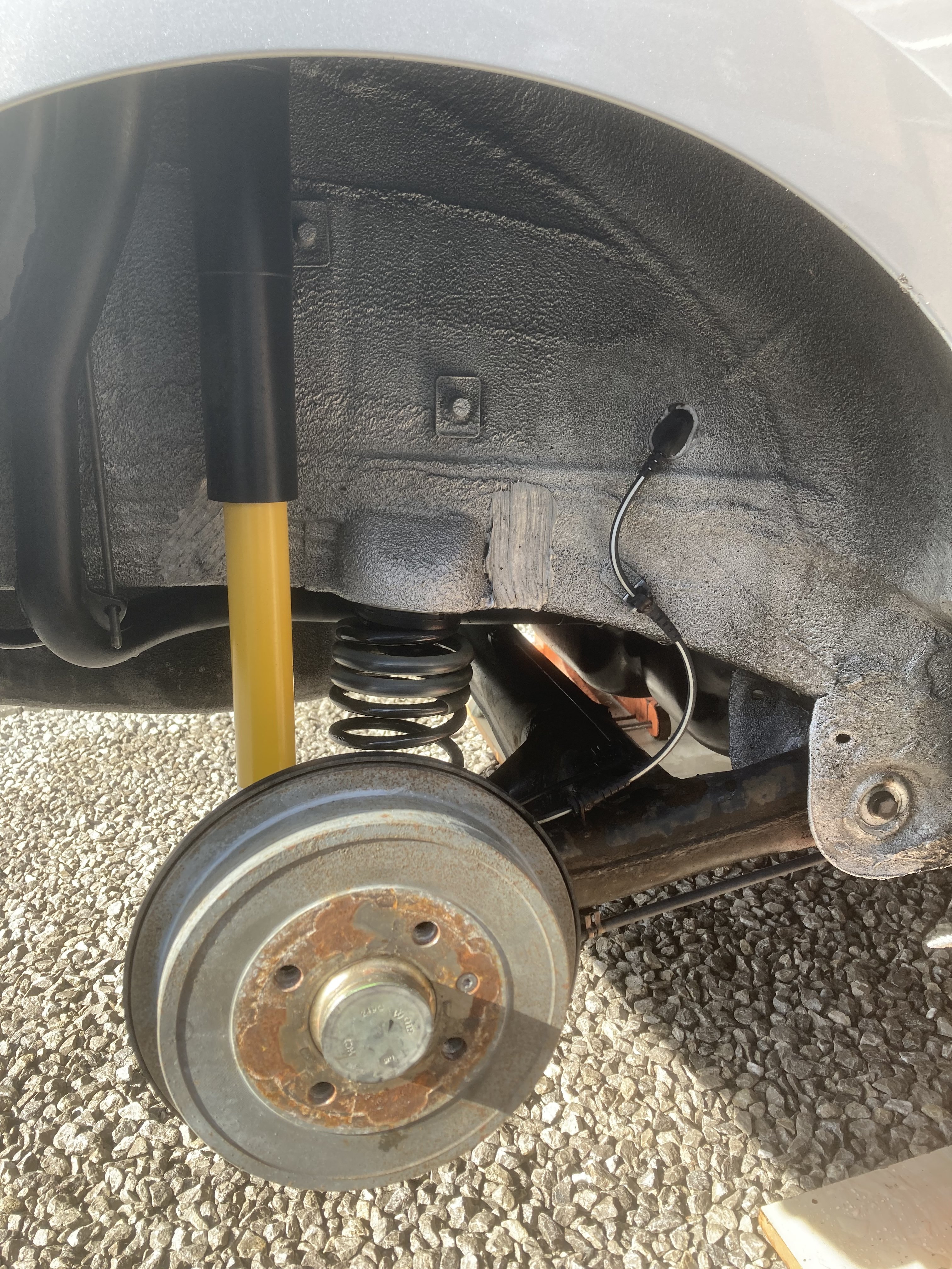

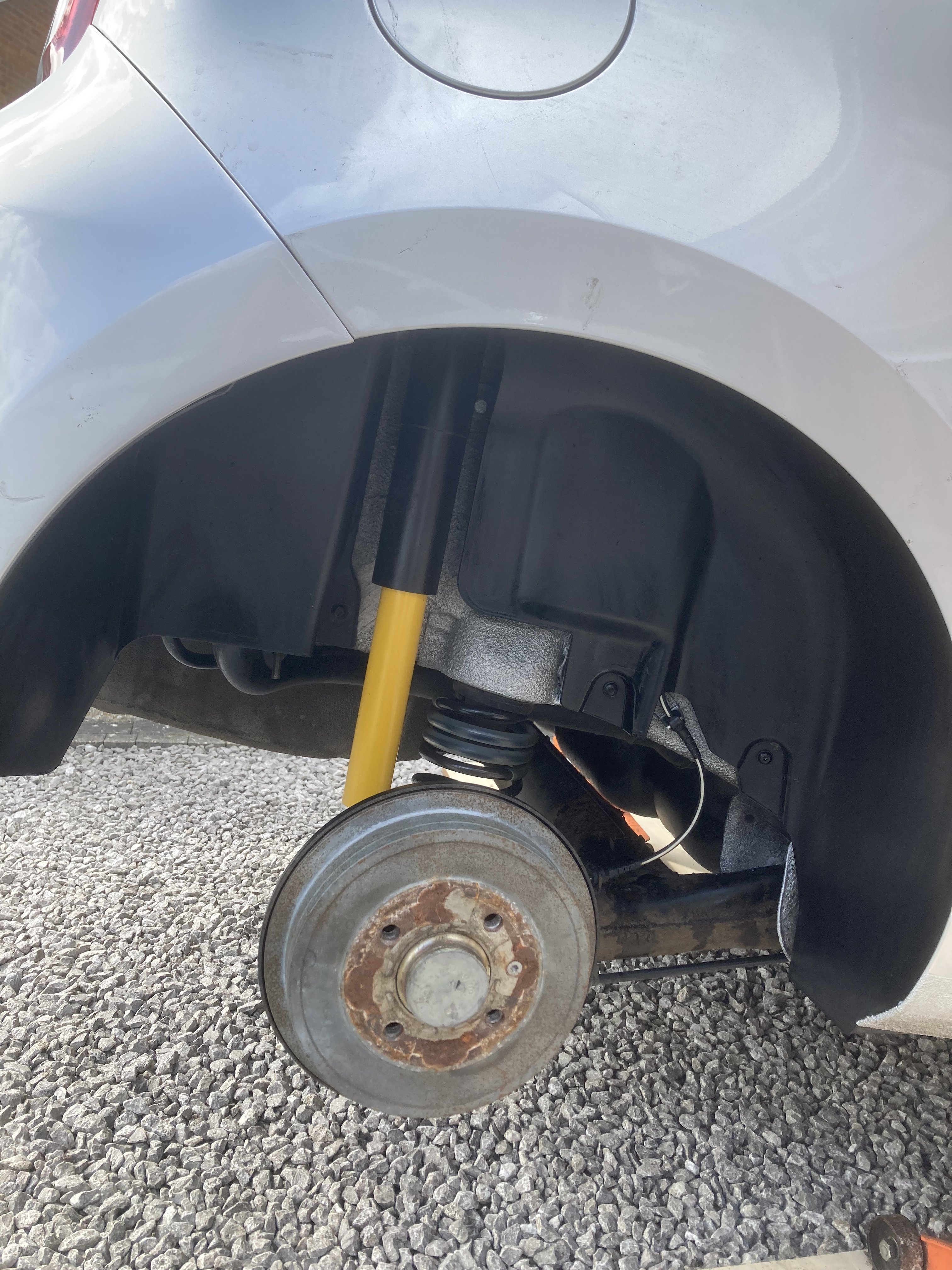

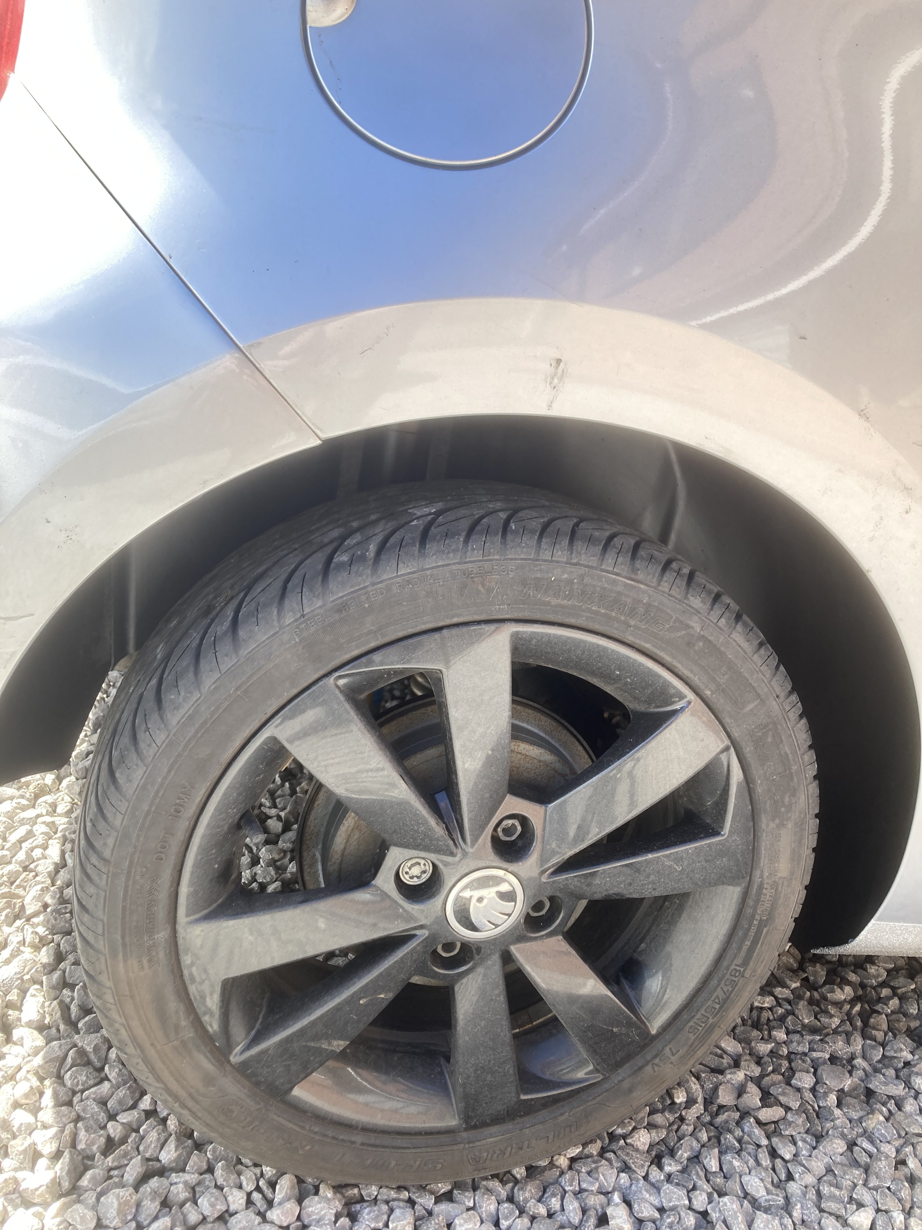

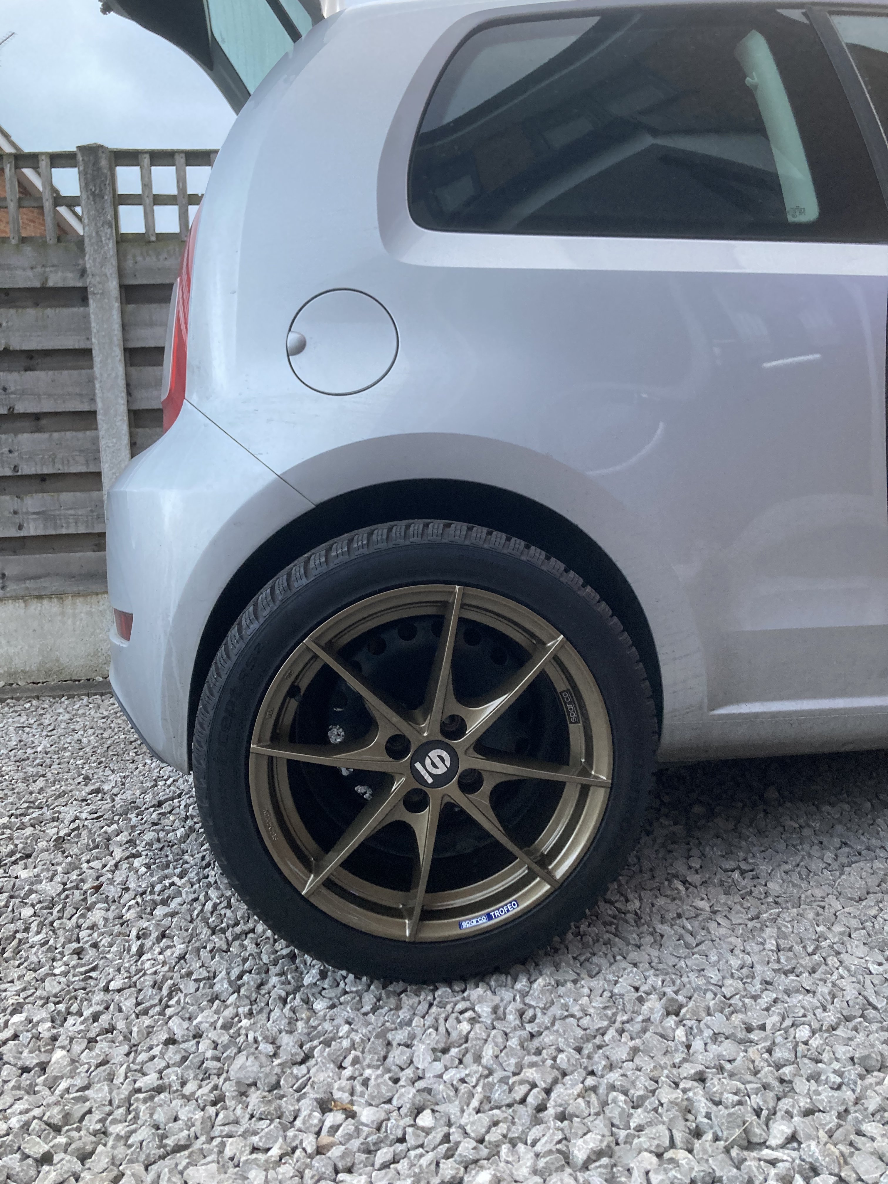

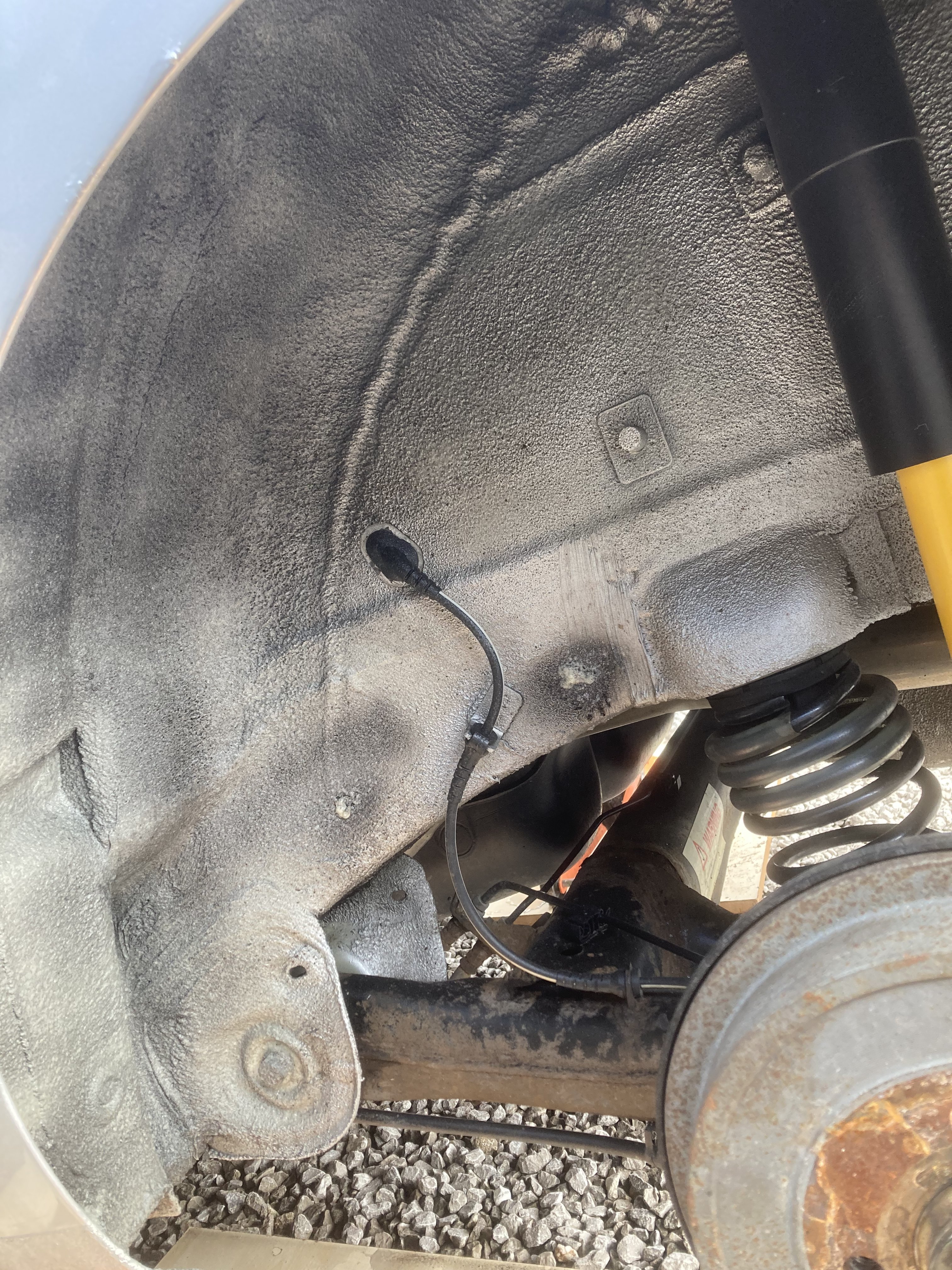

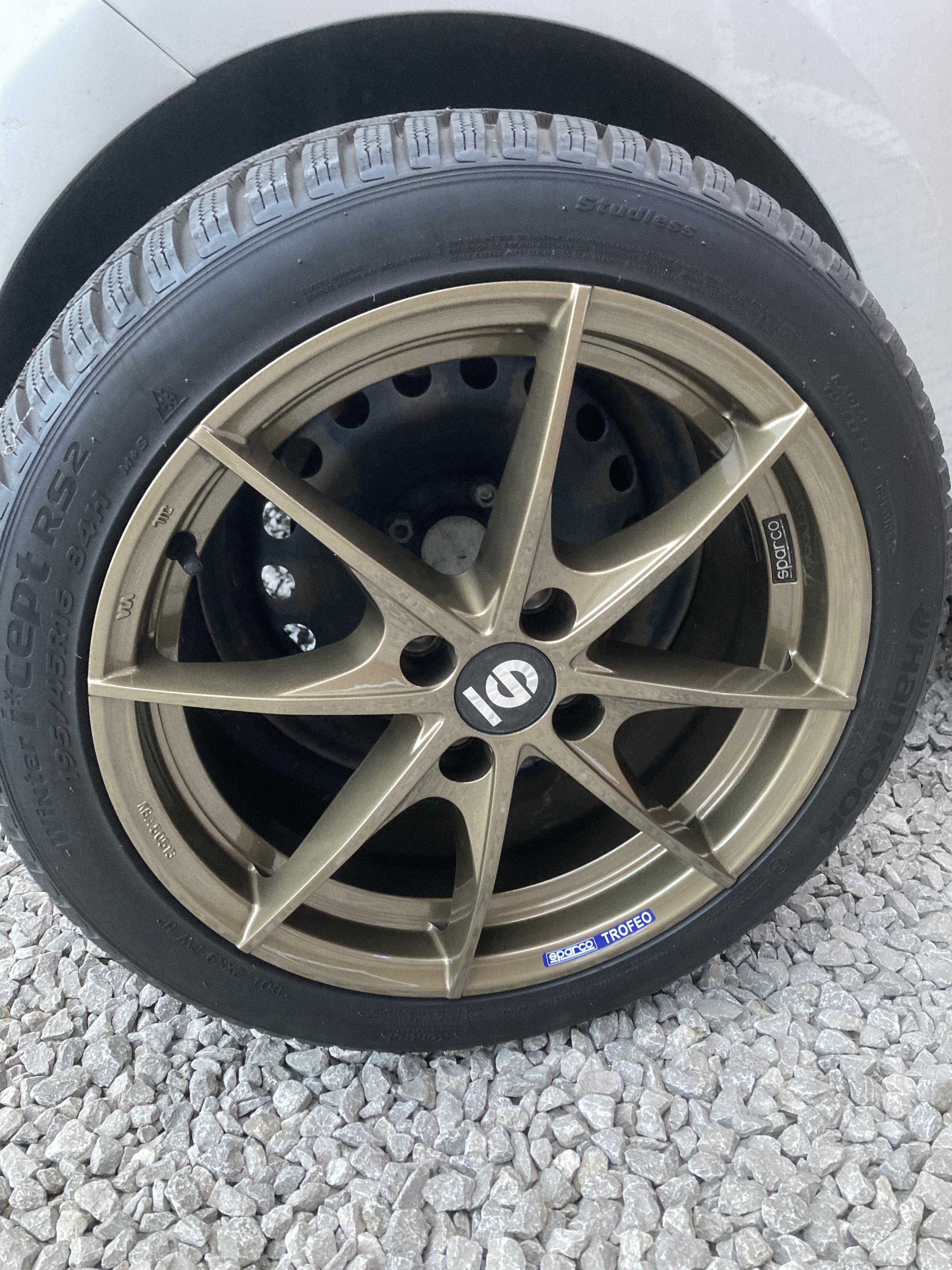

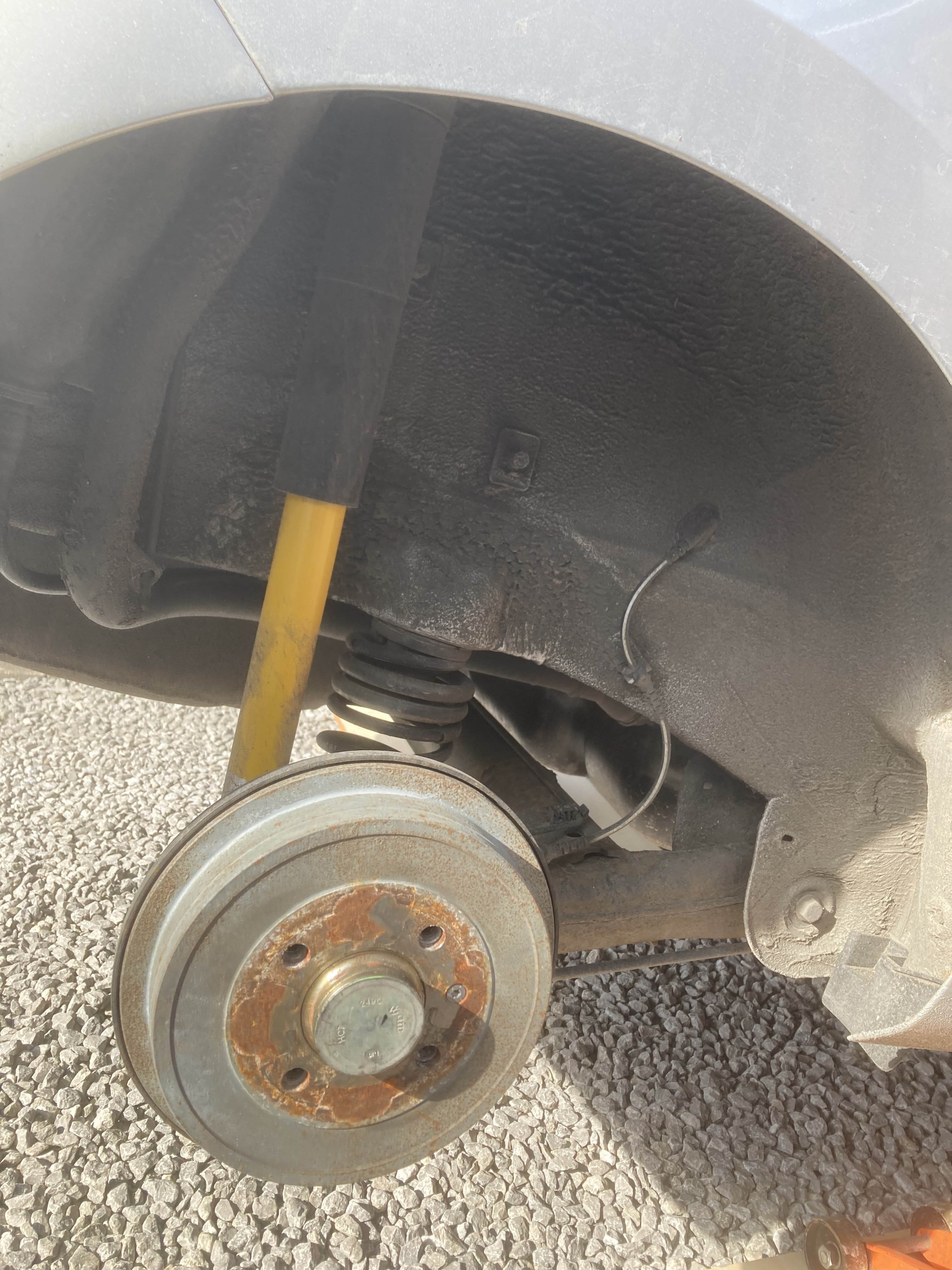

Picked up some new wheels the other day, got a plan for Saturday to paint rear drums black and going to ceramic coat the alloys and got a little mod to lower the rear a small 7-8mm with some different rear spring mounts, should sit abit more level front back then
Might I suggest Finnegan's Smoothrite; all the toughness, heat resistance and anti-corrosives of Hammerite, but in a smooth finish.
New wheels look very nice. What are you doing with the old Skoda alloys?
They sold a few weeks back sorry
