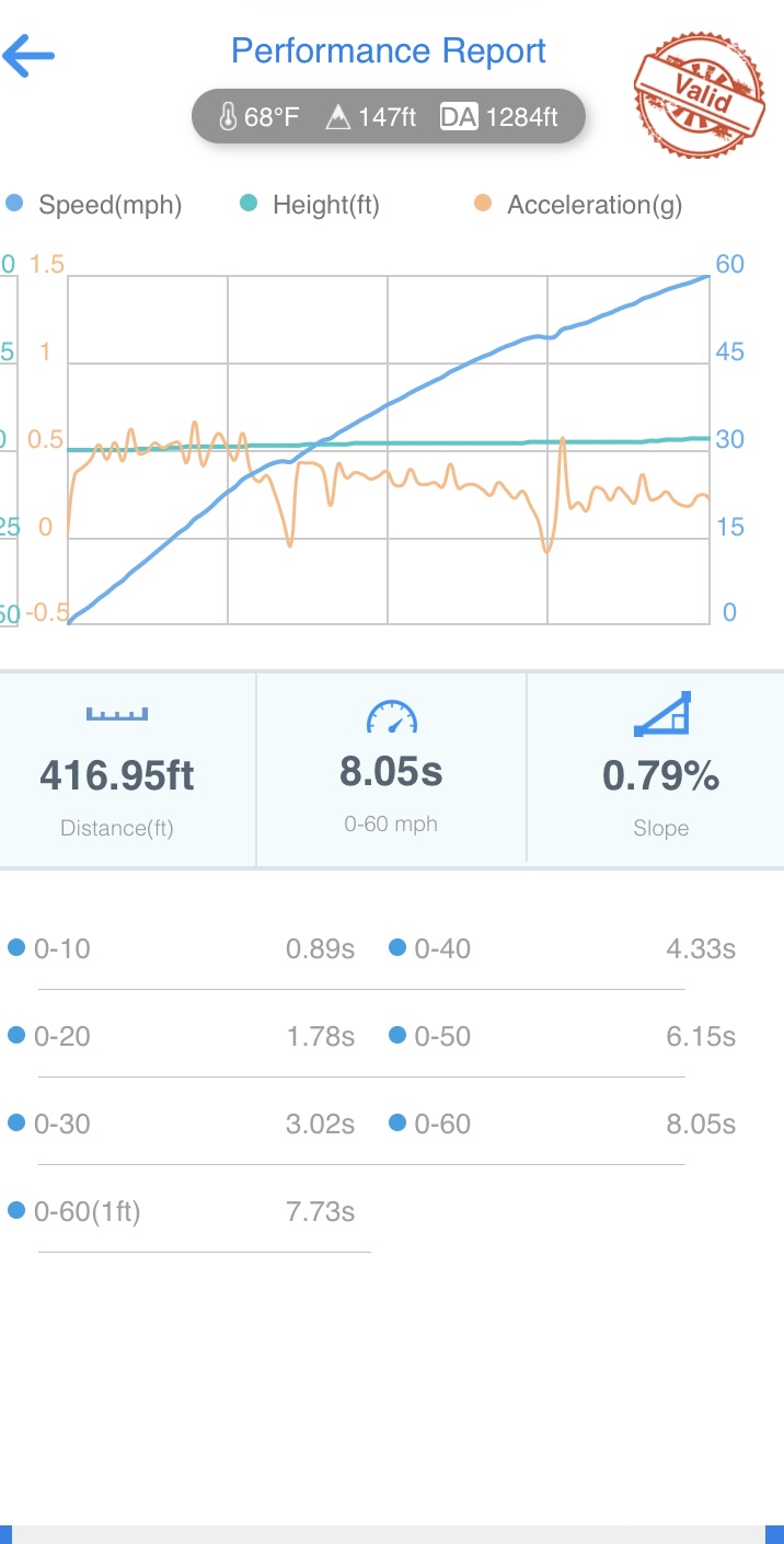

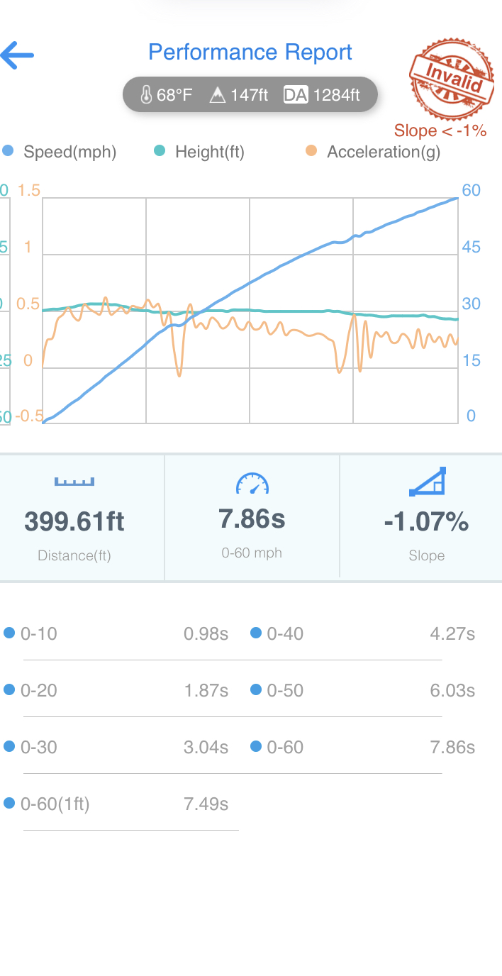

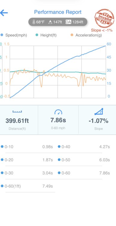

Been playing with the new gadget, a dragy gps timer.
Done about 30 0-60 runs,
best was sub 8 but slightly over the downhill allowanace of 1%, other best run was 8.05 secs slightly uphill, and just over 16secs 1/4 mile best.

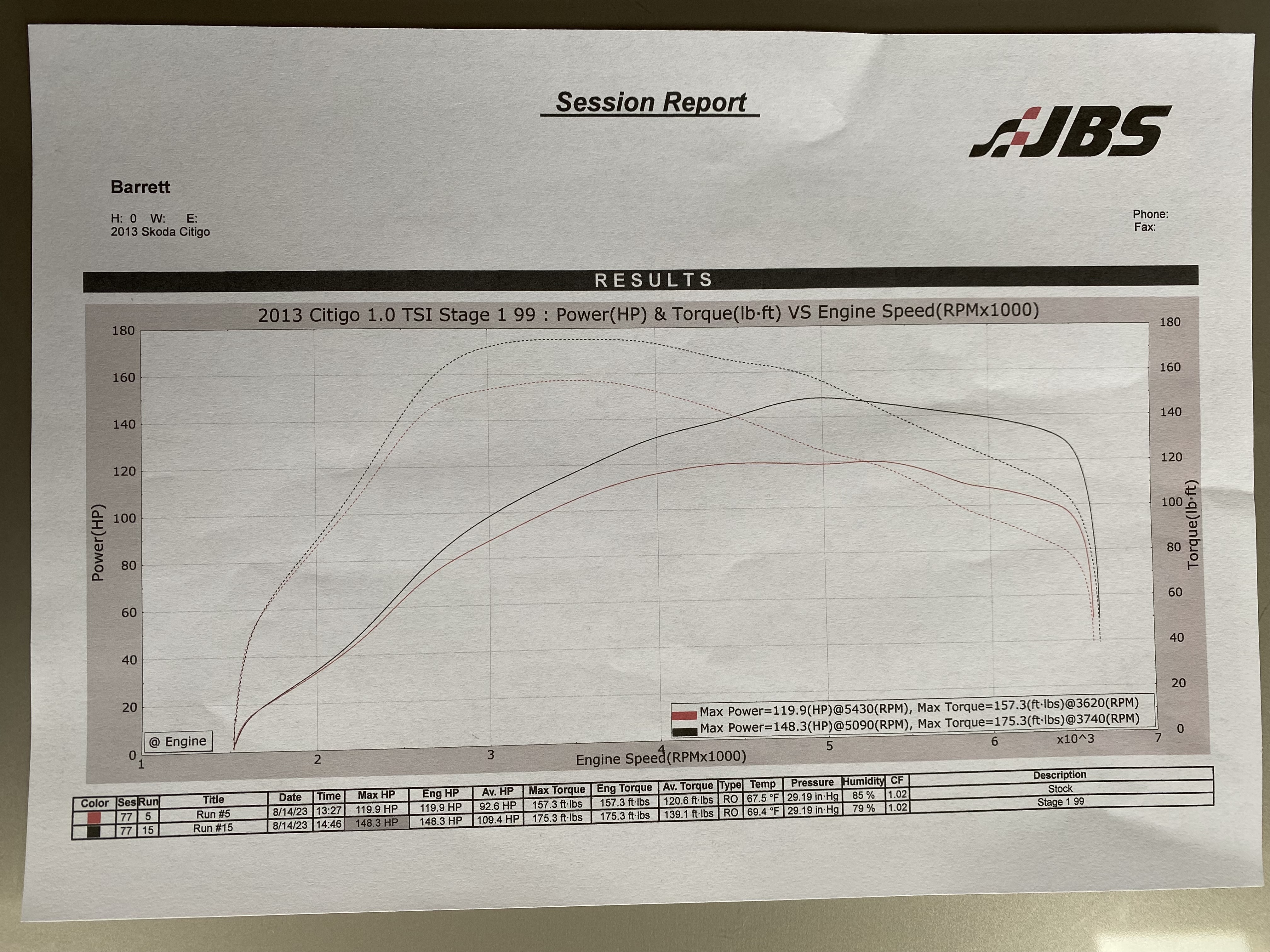

Remap on Monday to see how it improves

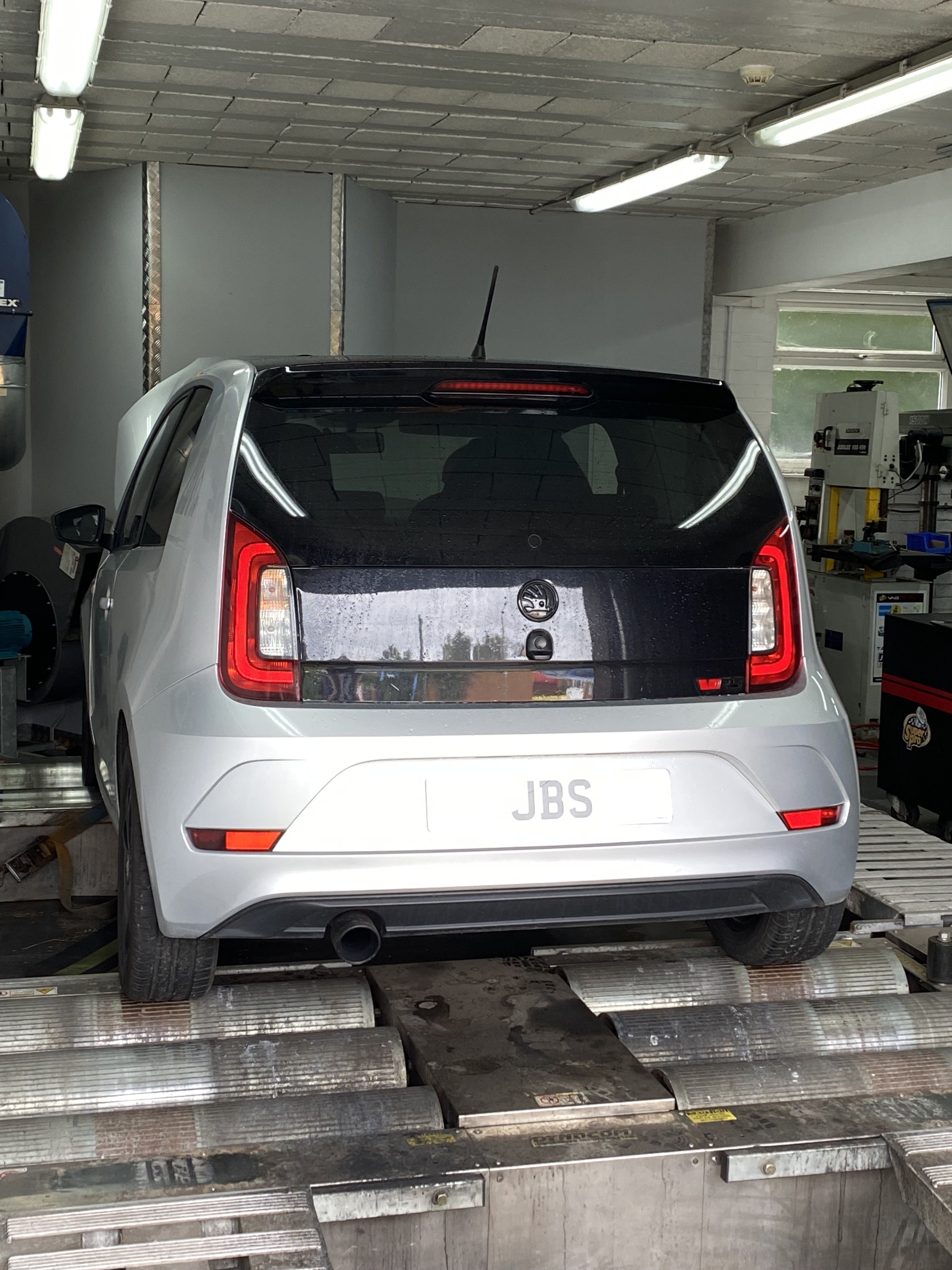

  • Some pics from the past few days
Been playing with the dragy again and
with better tyres I reckon sub 7 is doable 0-60. I have some old Contis on at the min that are just getting under 3mm so not the best. I have done many low 7’s, it’s a surprisingly quick little thing

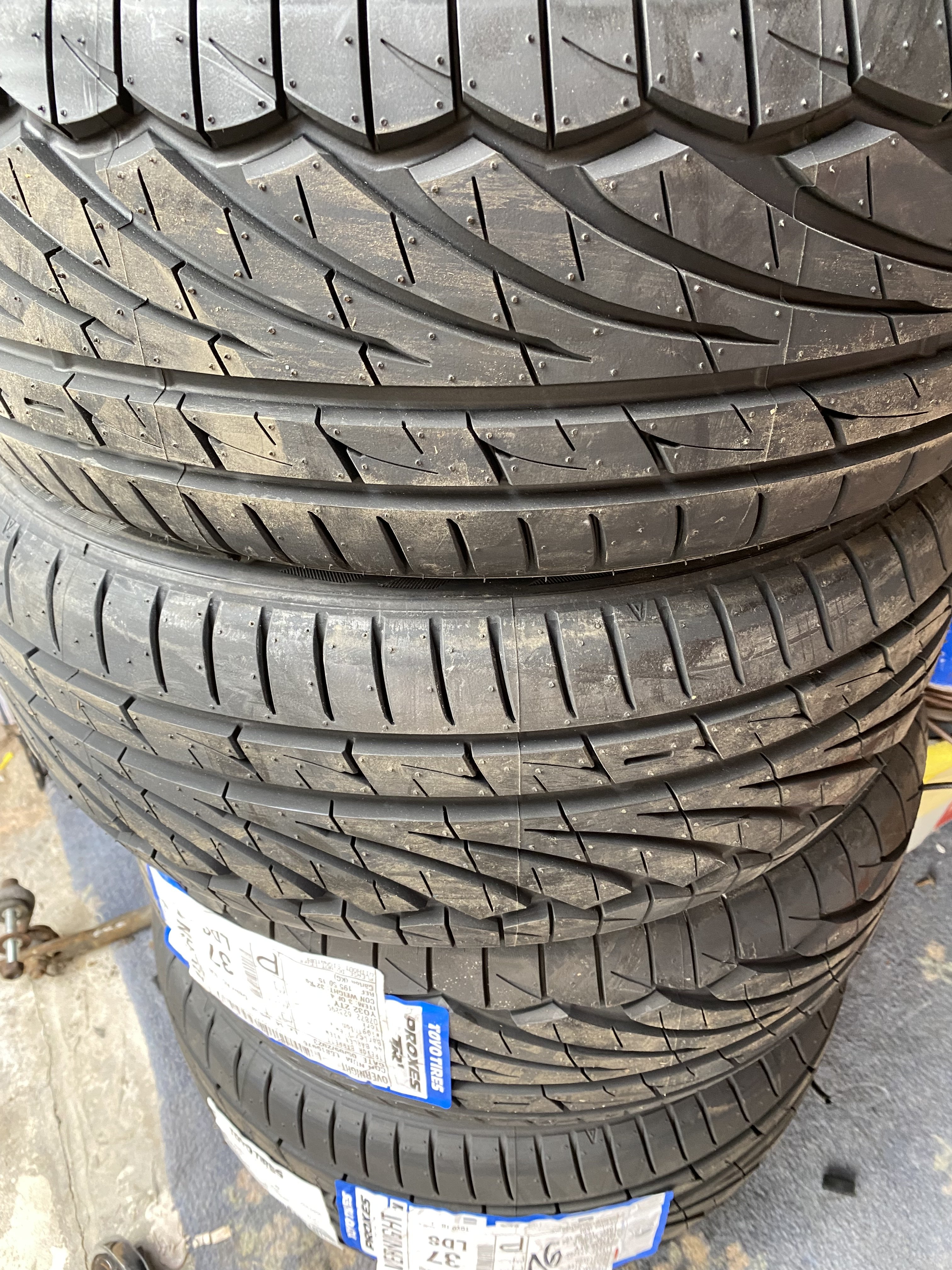

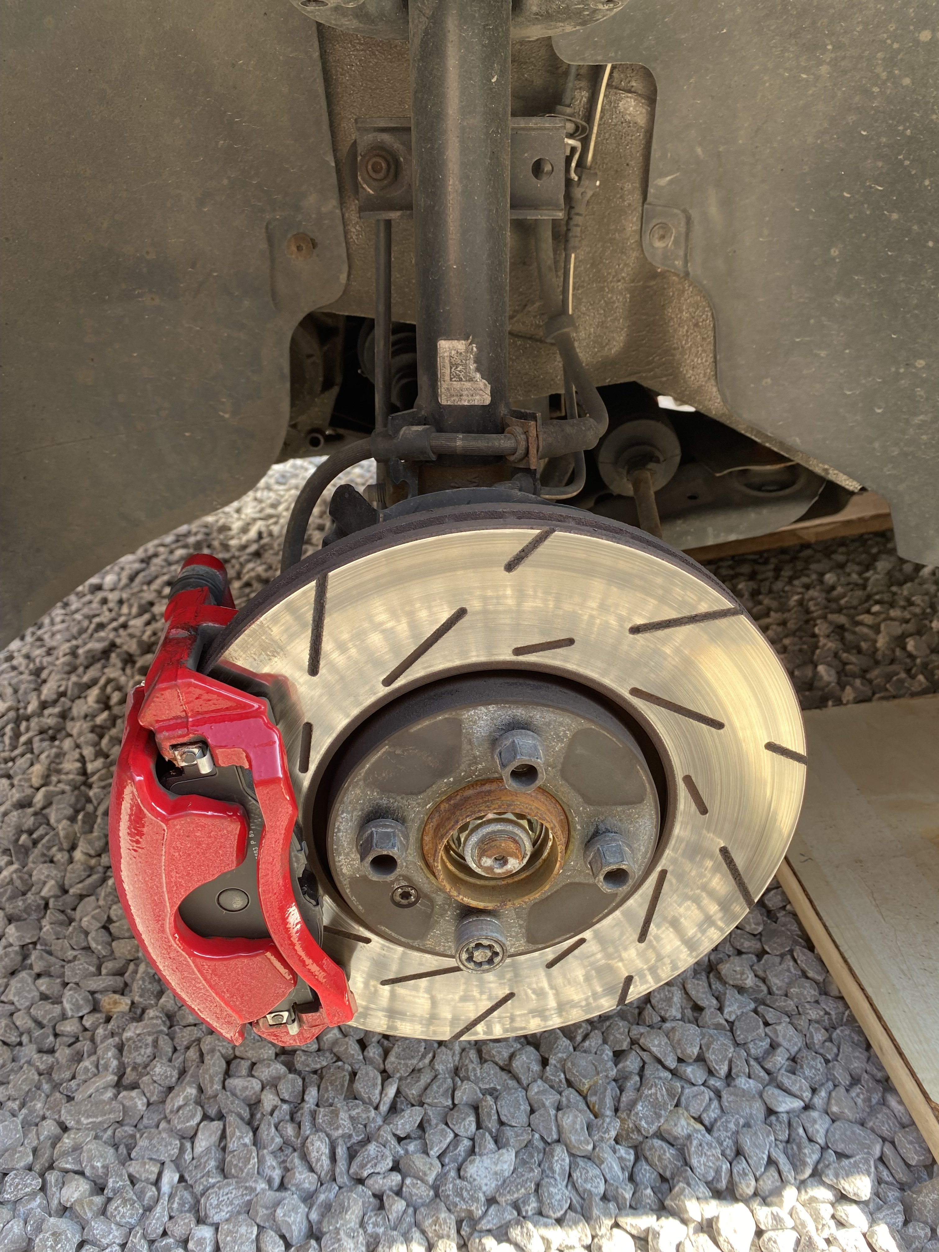

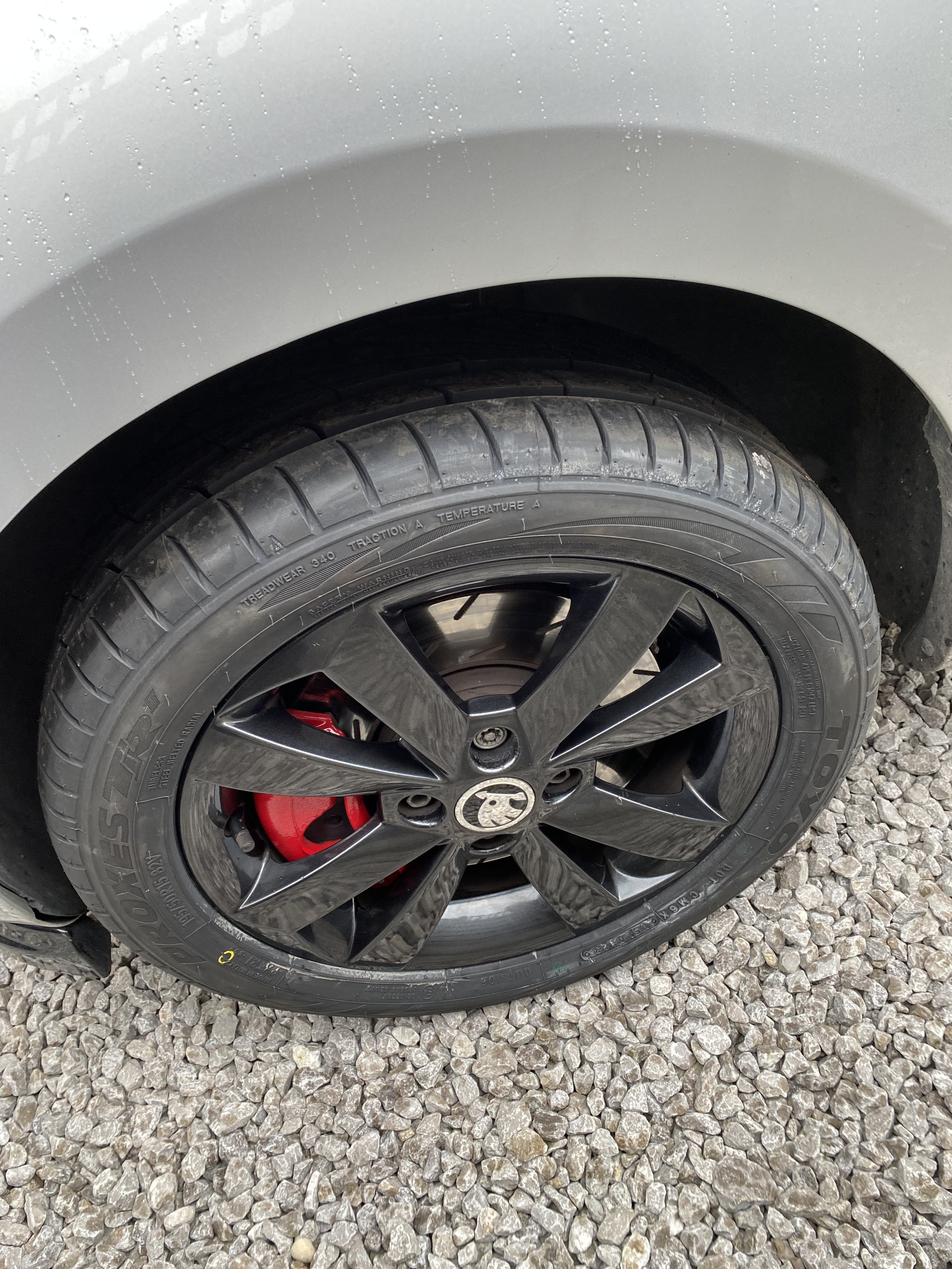

If anyone follows me on Instagram the car is up for sale although not done a proper advert yet, just getting the finishing touches done and a full one will follow.
just getting new tyres all round and changed front pads for some Brembos, going to be a great steal for someone up at 6.5k
