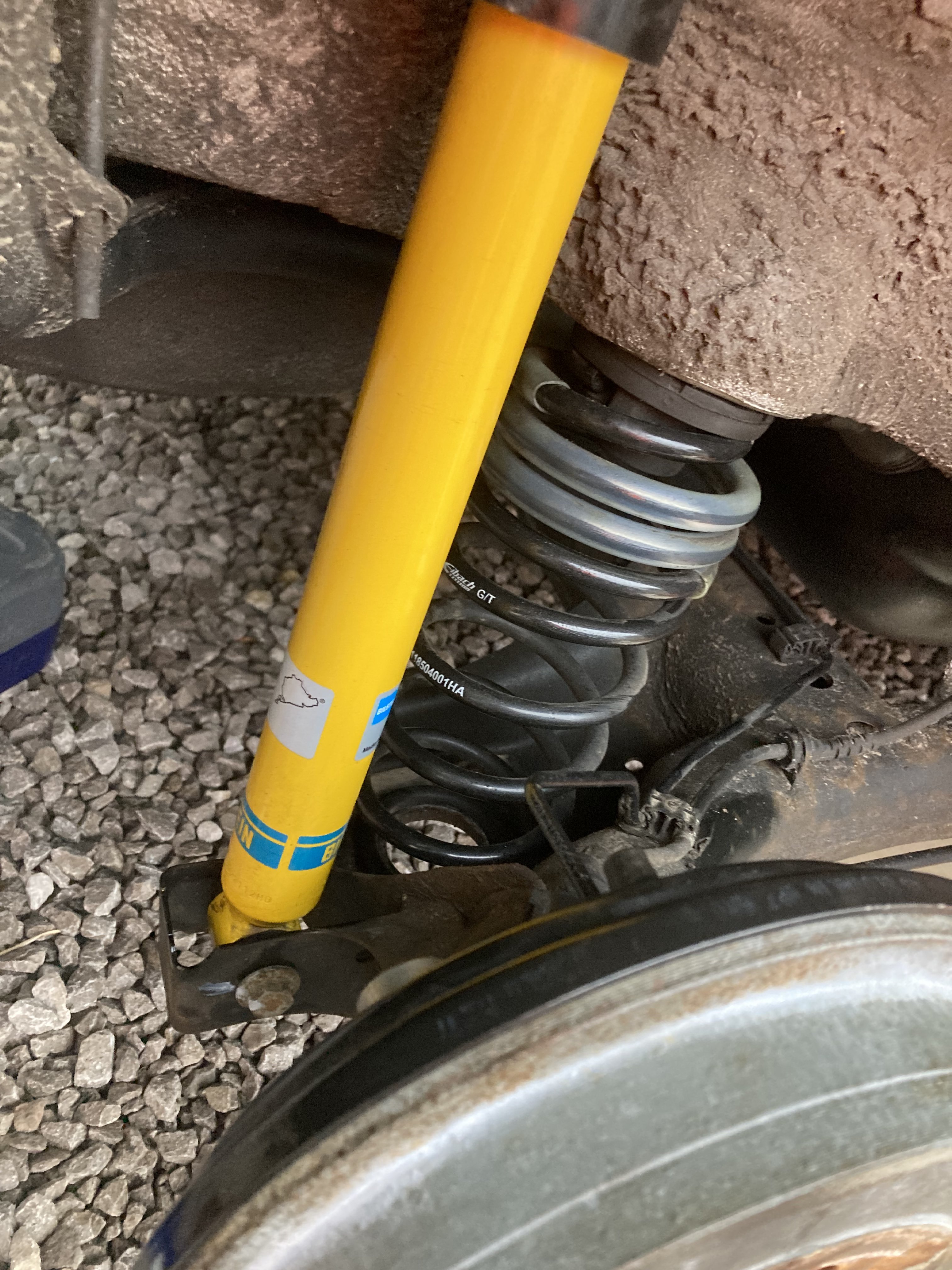

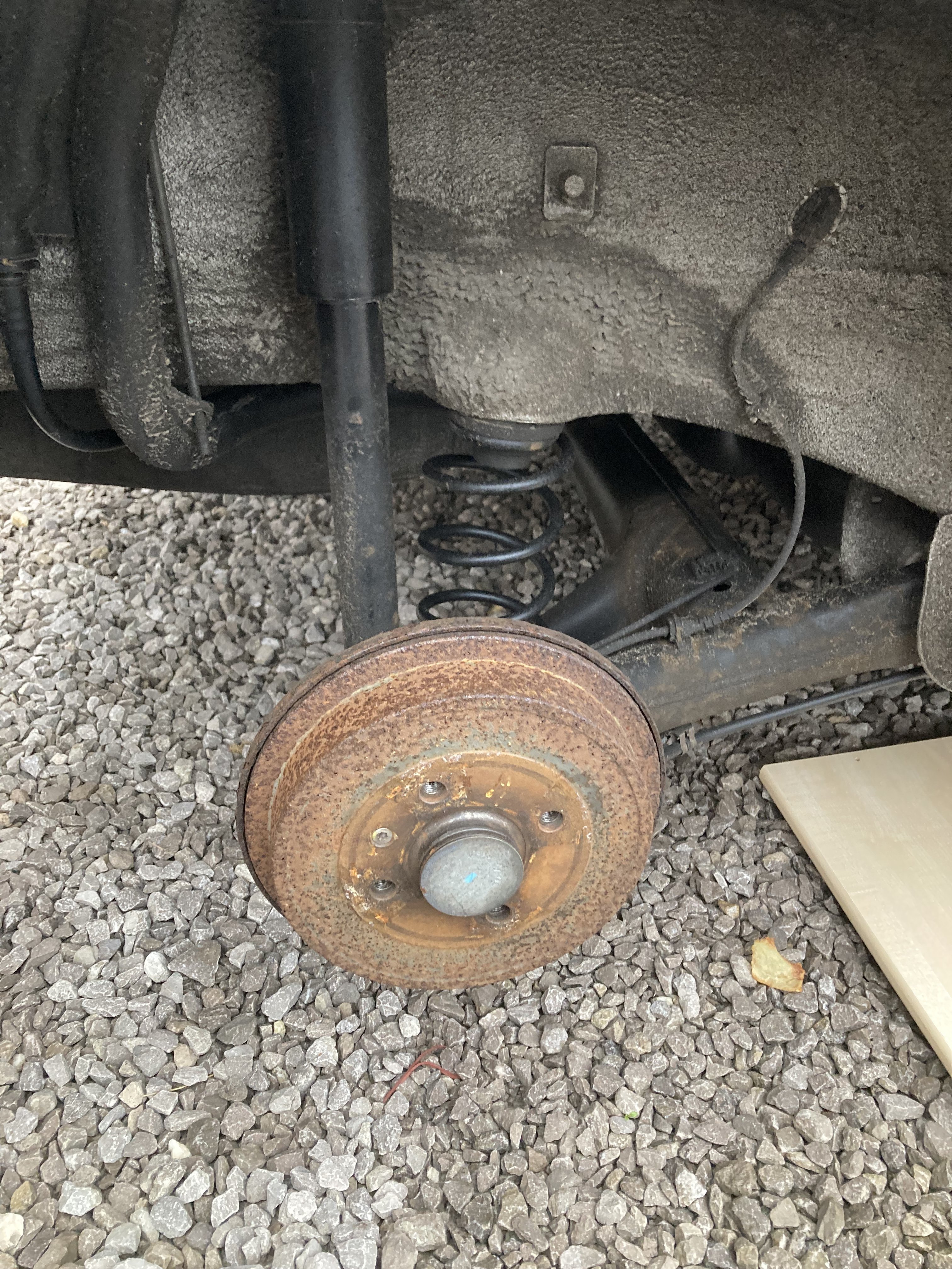

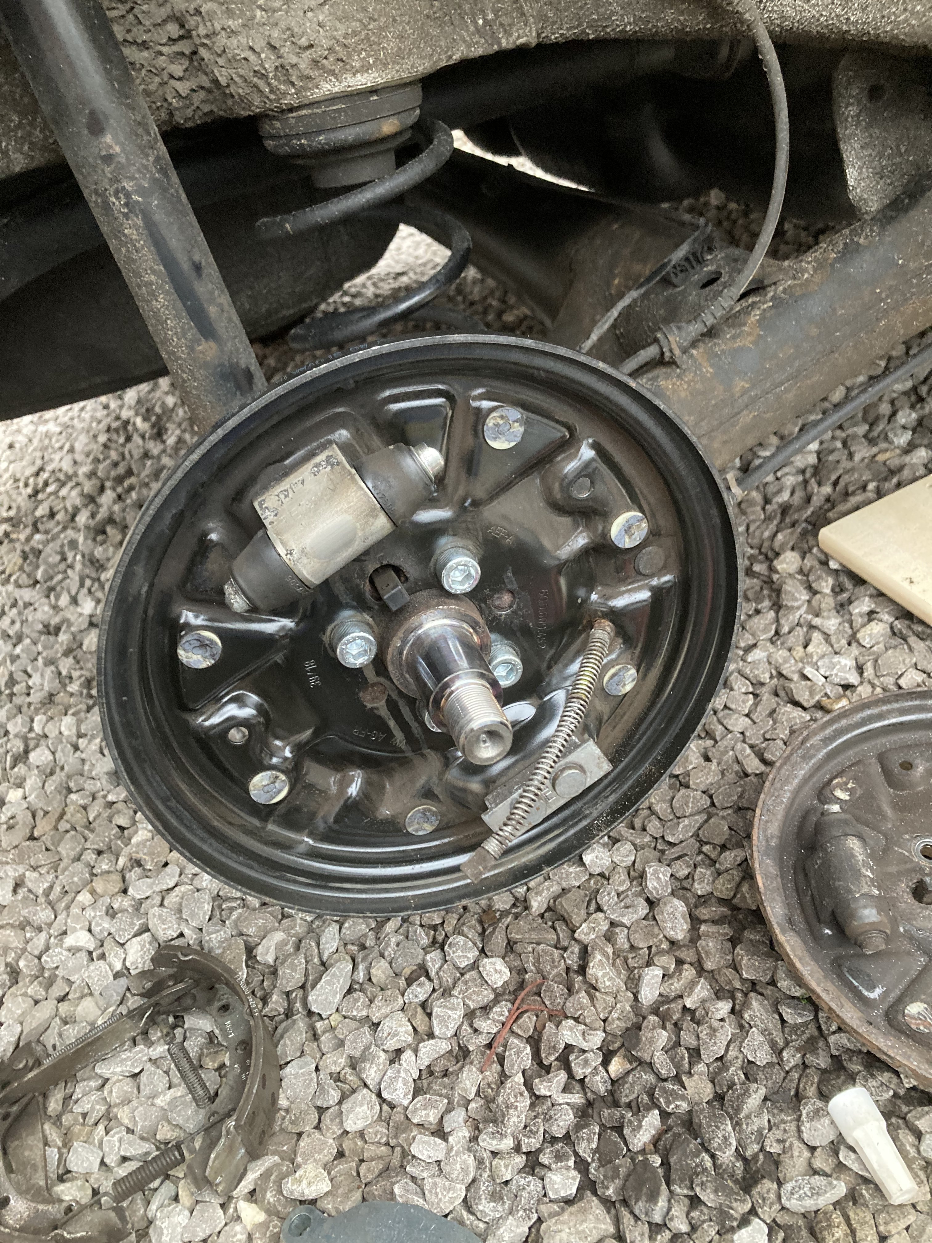

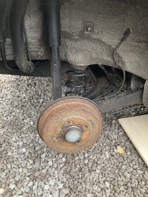

Made a start on rear brakes/suspension
swapped it all over as it’s nearly seven years newer.

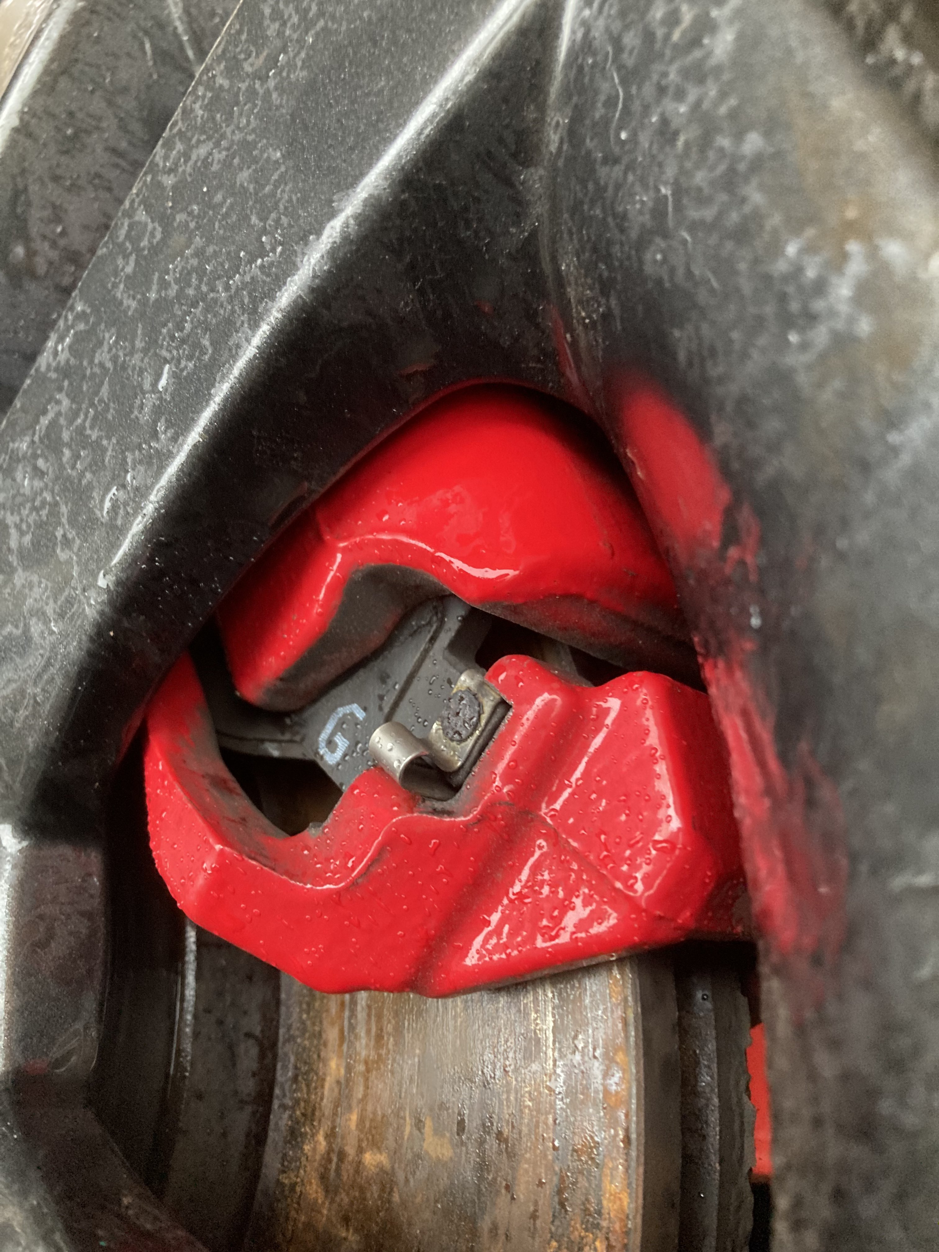

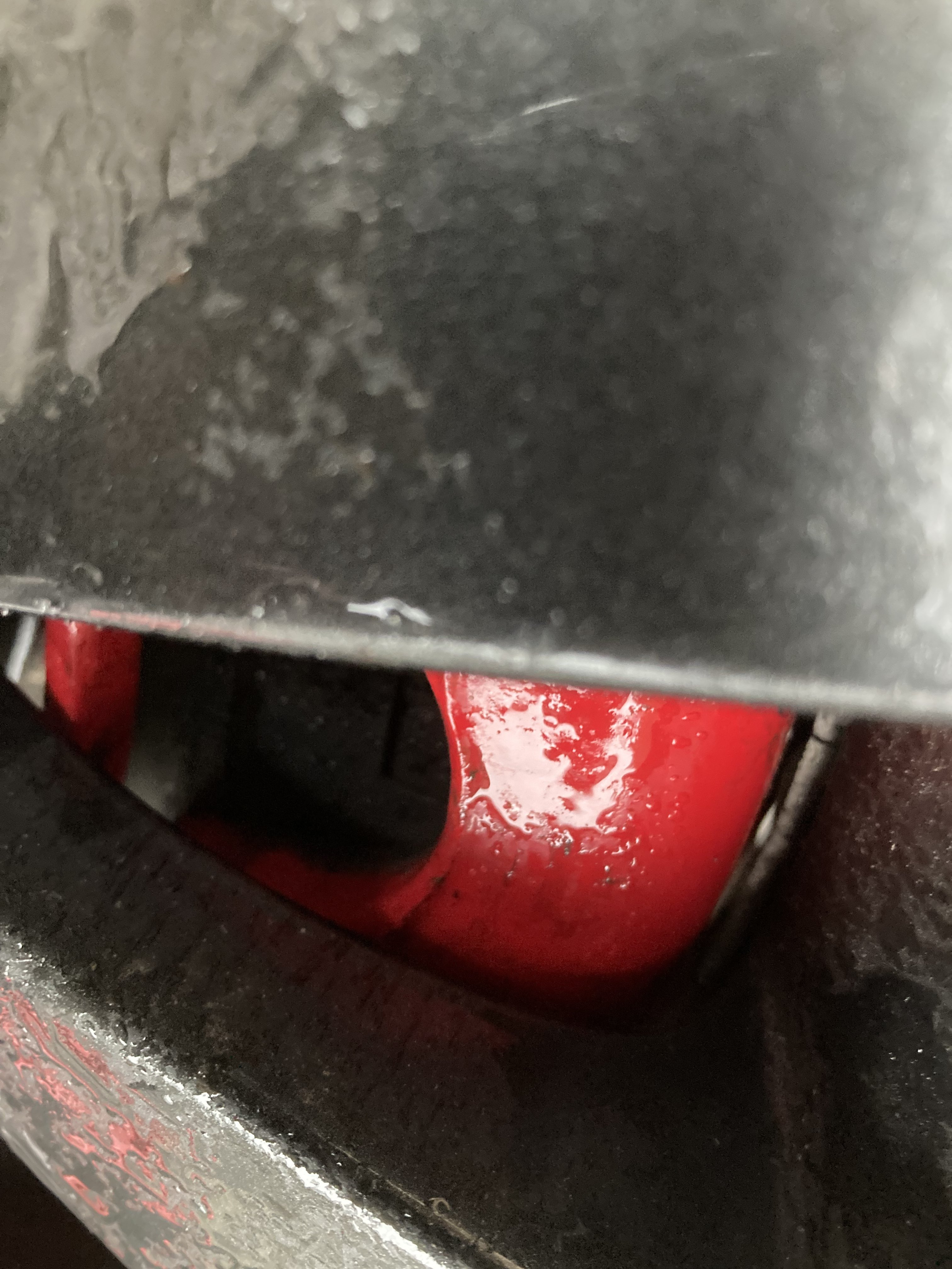

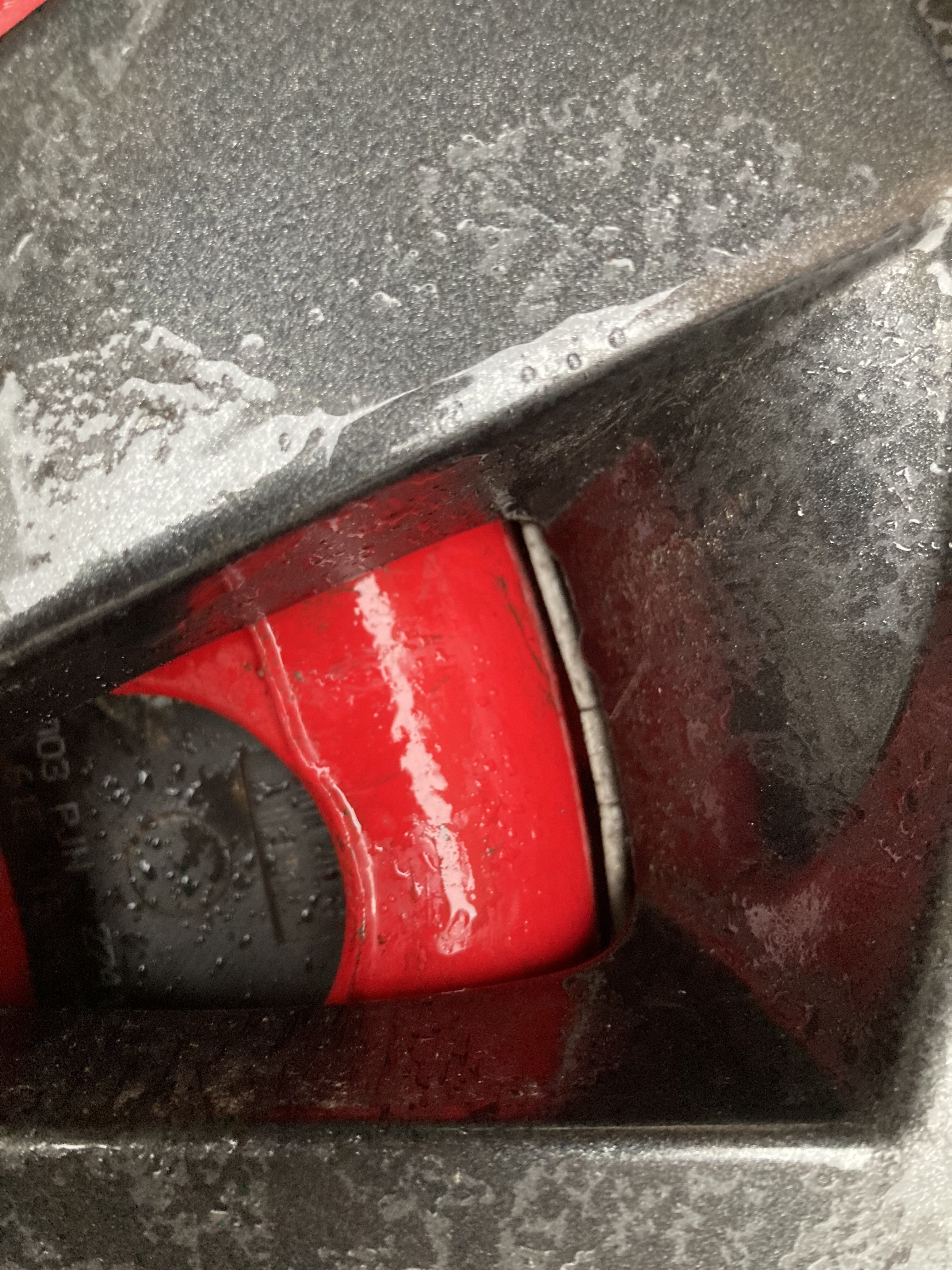

hub/bearing, backing plate shoes etc. fitted some darkside 12mm axle spacers I brought a while back, and fitted up one side with the bilsteins and Eibach springs, test fit the wheel over the brakes it is tight but a few mm clearance from the wheel weights to caliper. I wonder if they do slimline wheel weights. It does turn without catching anywhere which is good

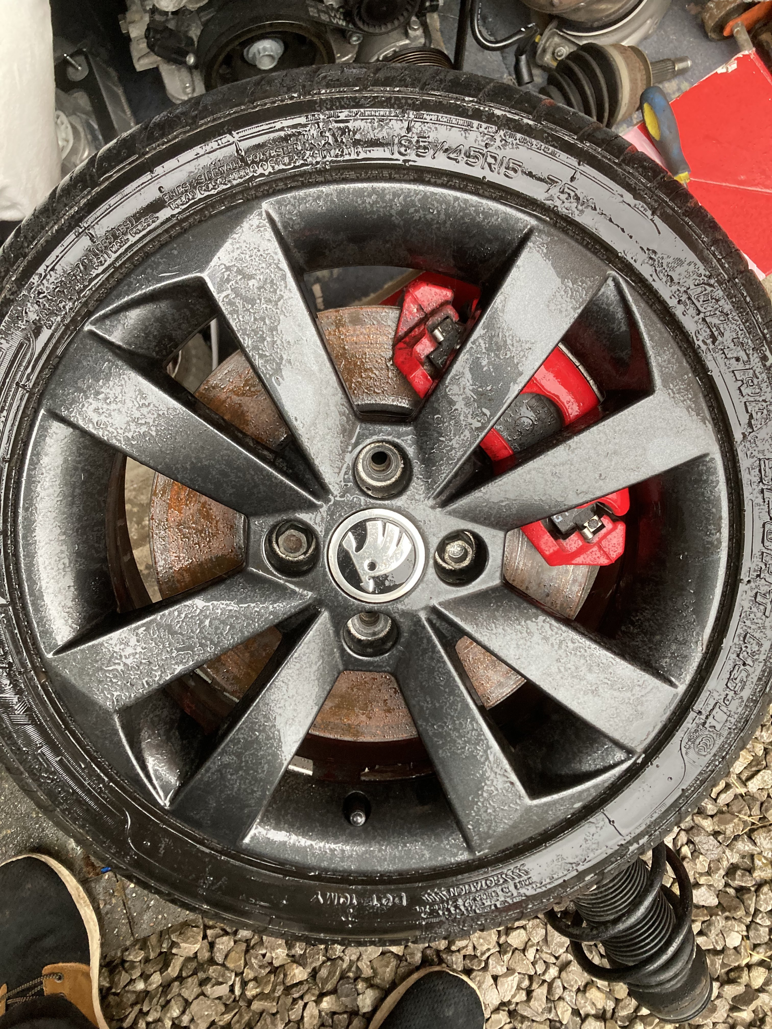

Looks like the front brakes will be OK with 15" alloys.  I'll start sourcing brakes for my Elegance I think.
Are there any differences with the rear brakes or axle beam?  I'm sure I've seen somewhere a rear disc conversion using Lupo GTi parts.
there’s a company that does rear disc conversions
https://theupgrade.haus/products/rear-disc-brake-conversion-kit
beams are the same all drums
the only place I’ve seen you can get the fronts from are a kit on eBay. But if your not upping power plenty of decent pad/disc combos for the standard 256’s

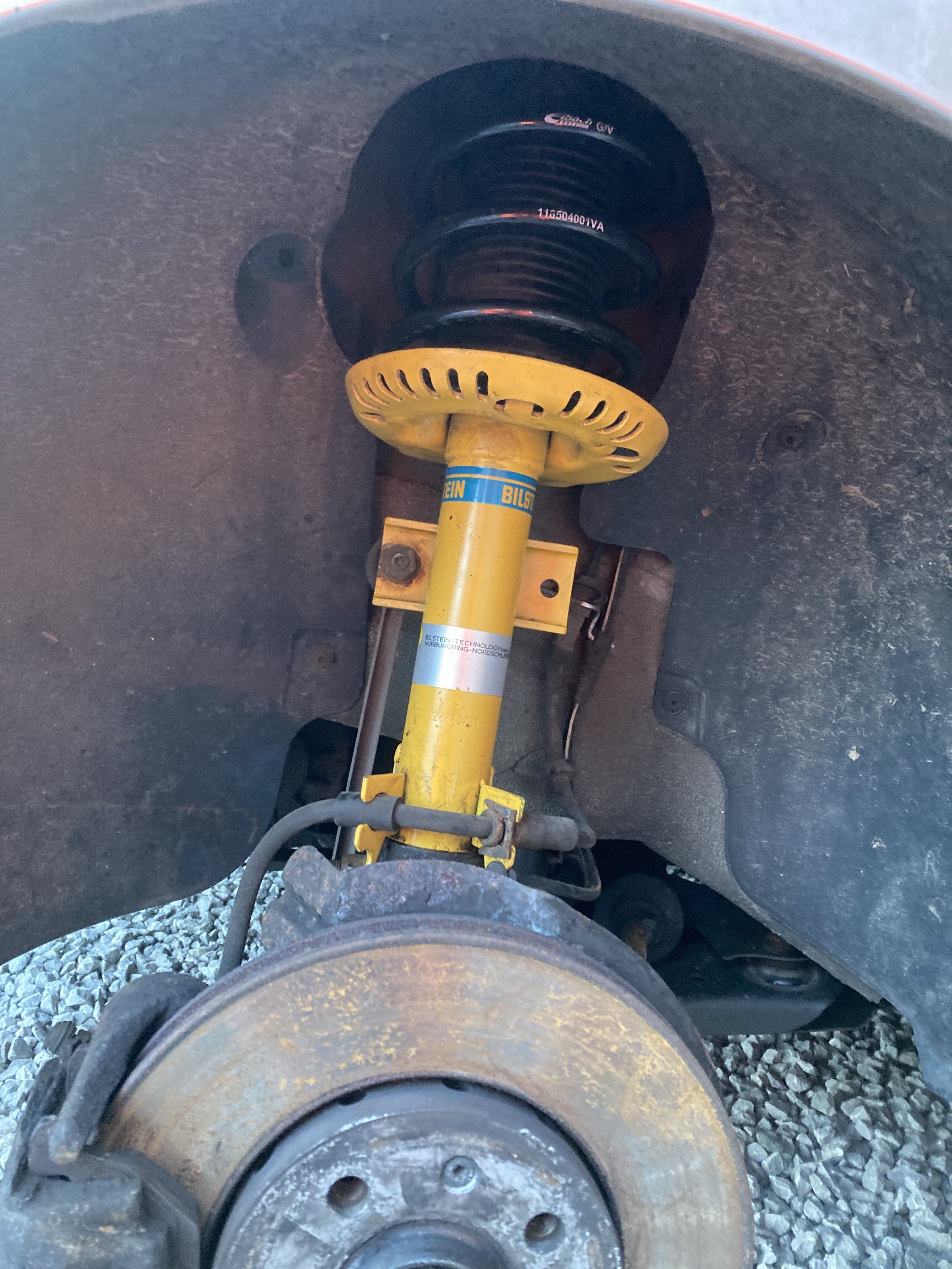

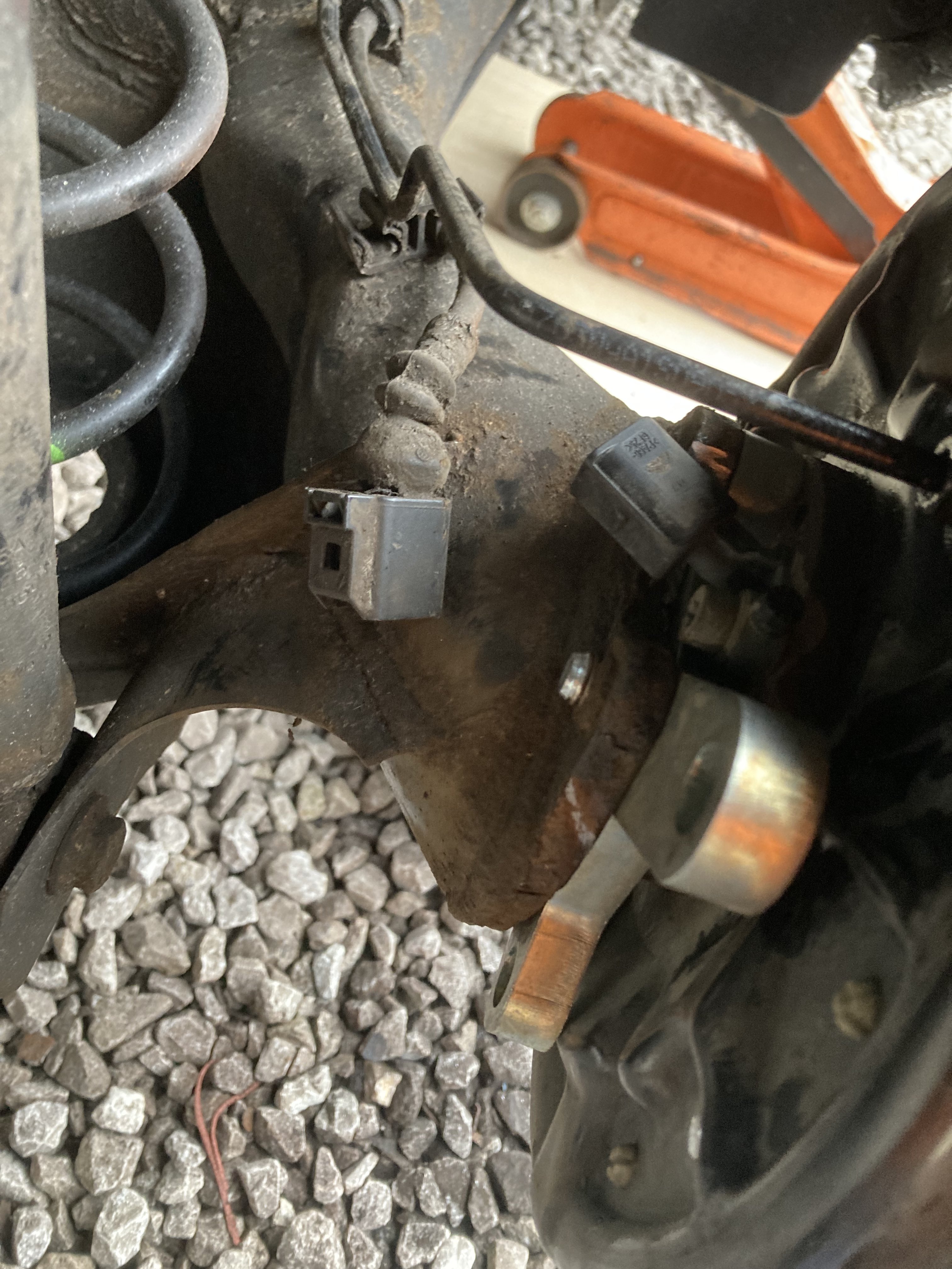

Made a start on front suspension, got both sides stripped an n/s refitted just run out of daylight again as weathers not been great, hopefully finish it at weekend 5D412A58-31E5-438E-86B6-786629CFBD5E.thumb.jpeg.606a41dc60bf285b5888ec77bae1b625.jpeg

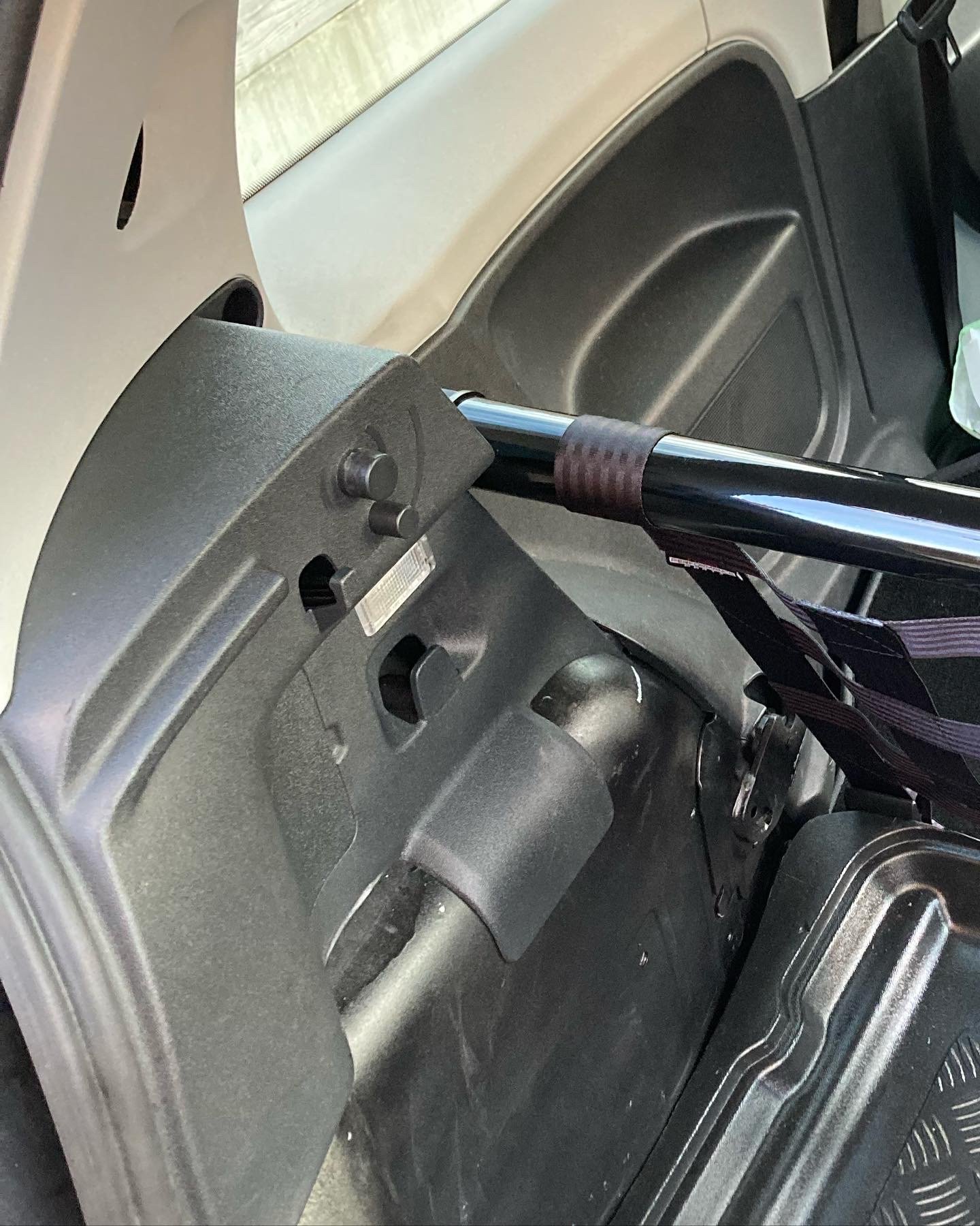

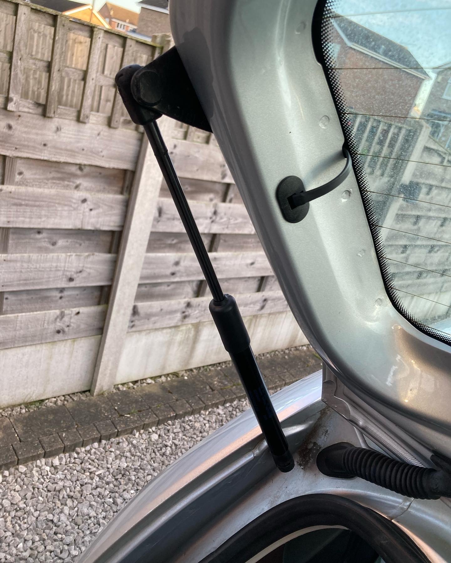

boot struts swapped
boot seal swapped

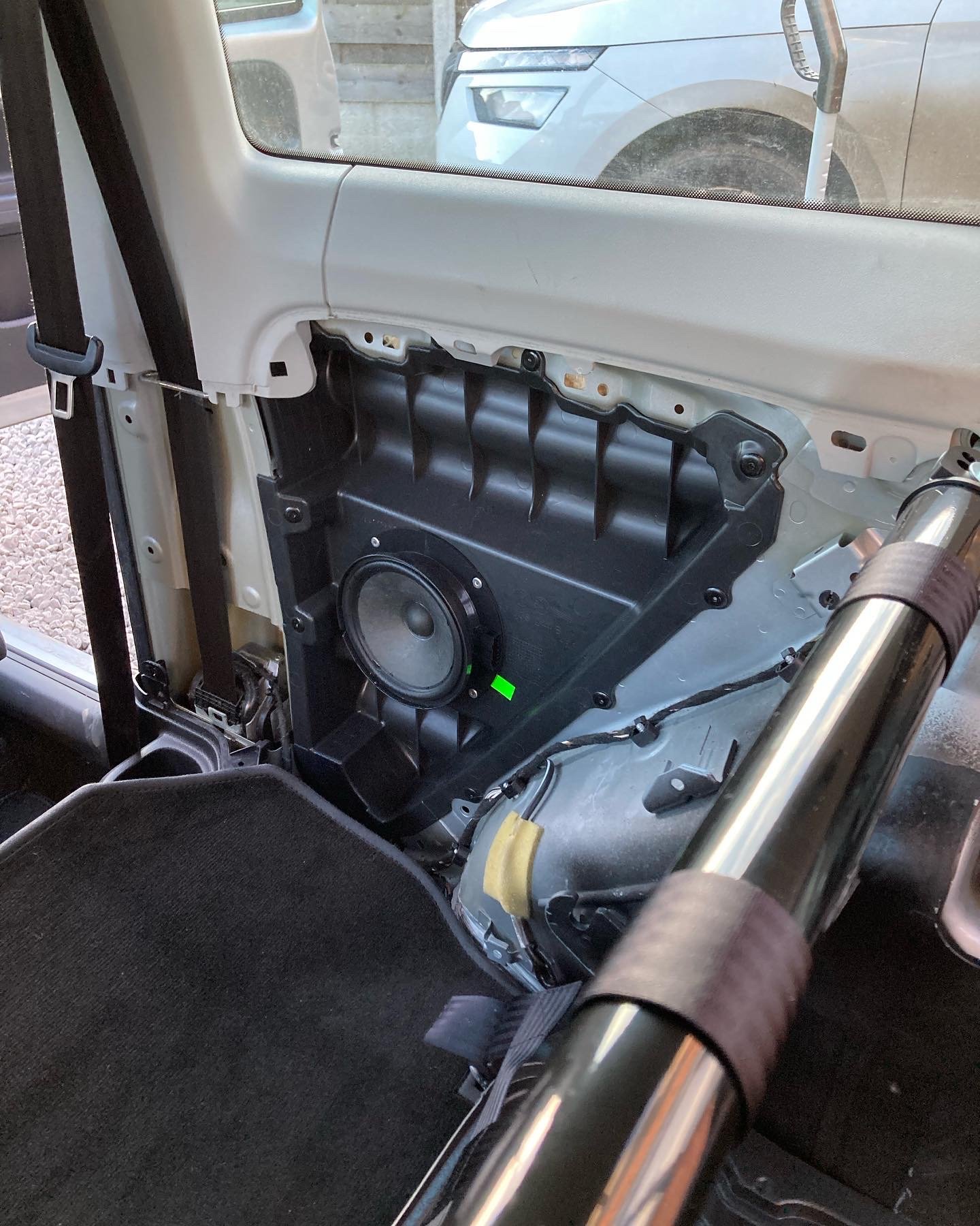

rear speakers fitted

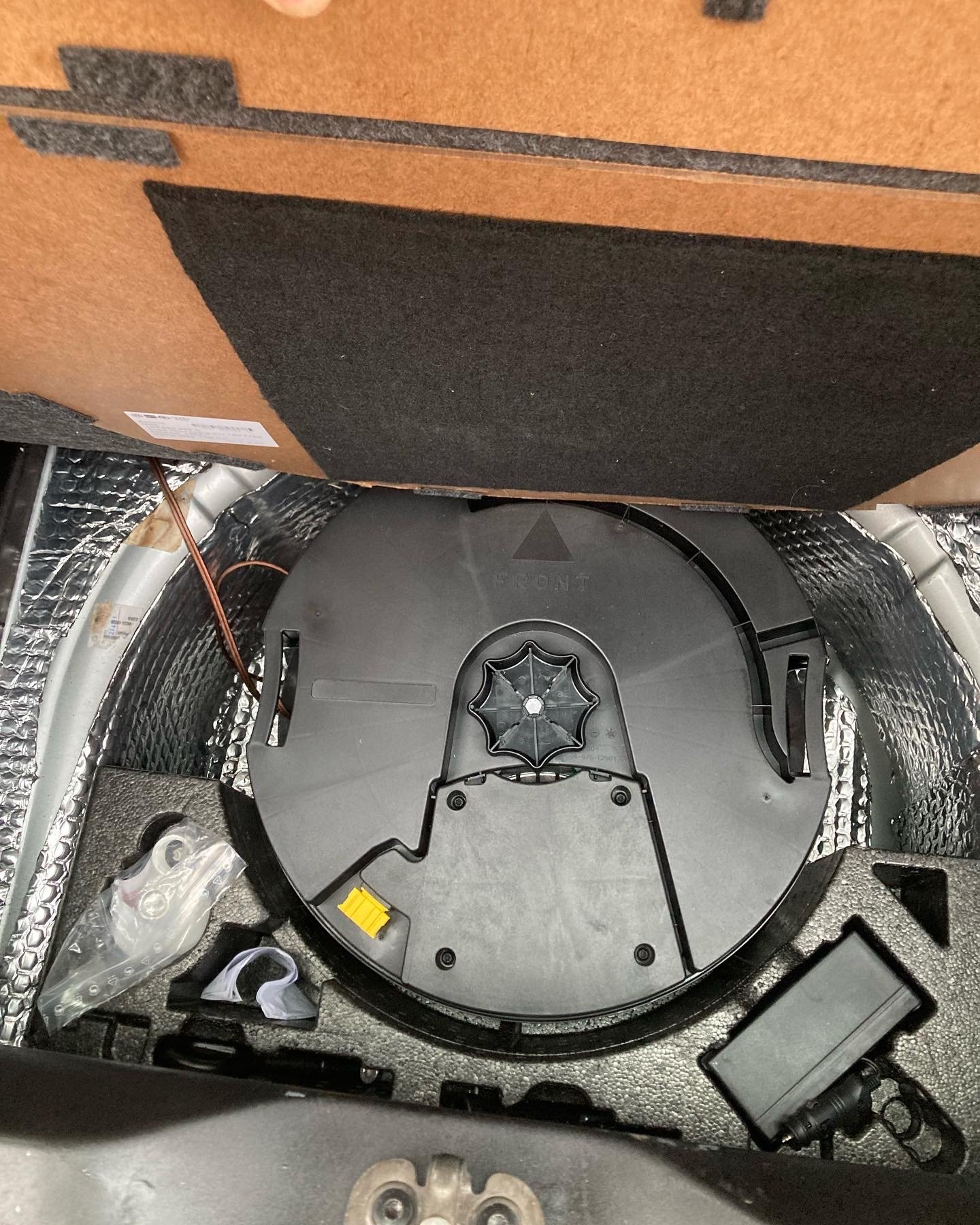

beats spare wheel sub and tool kit put in,
And the boot trim with light
obviously not wired in but when I run the new loom will all be plug and play

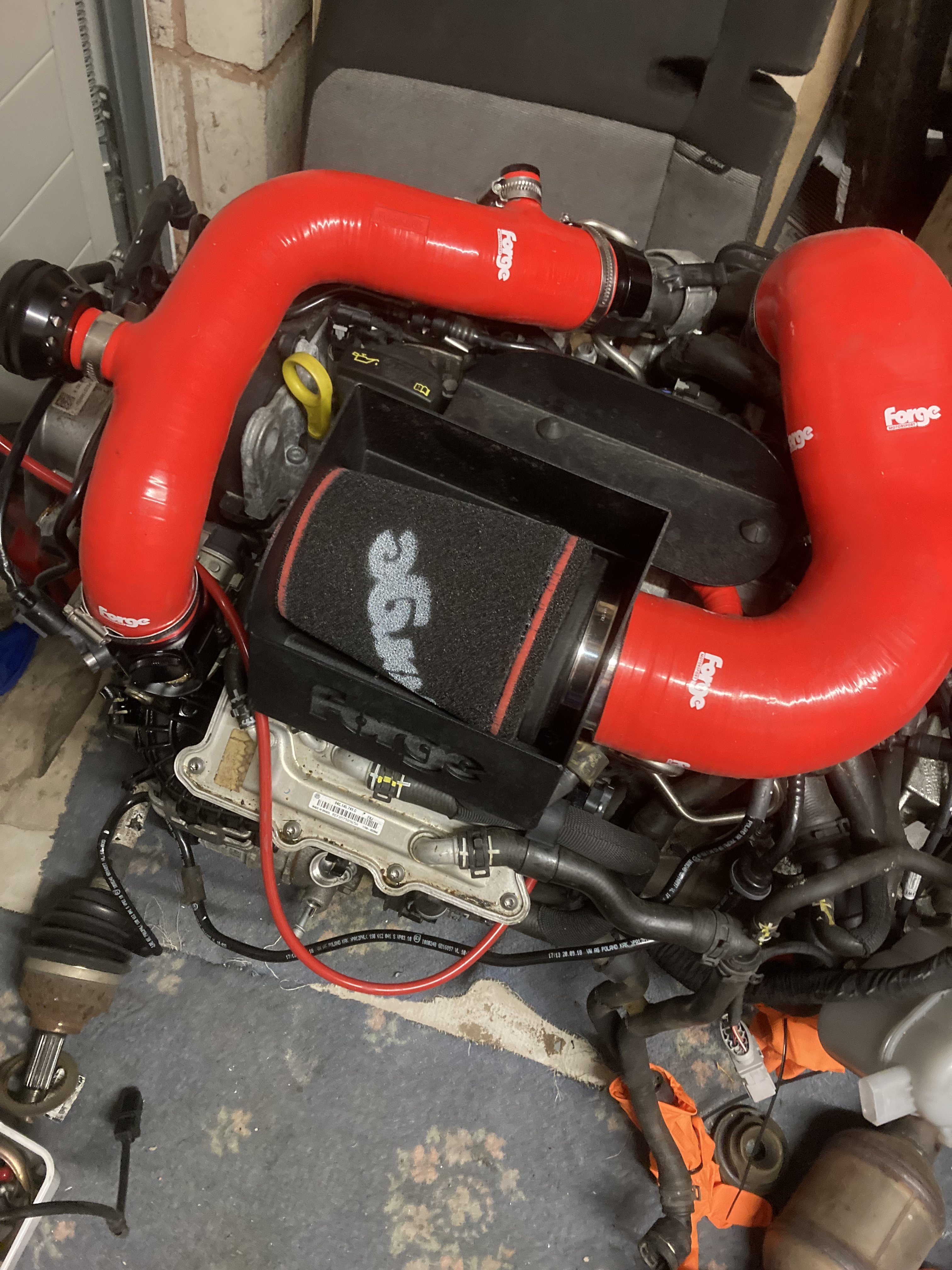

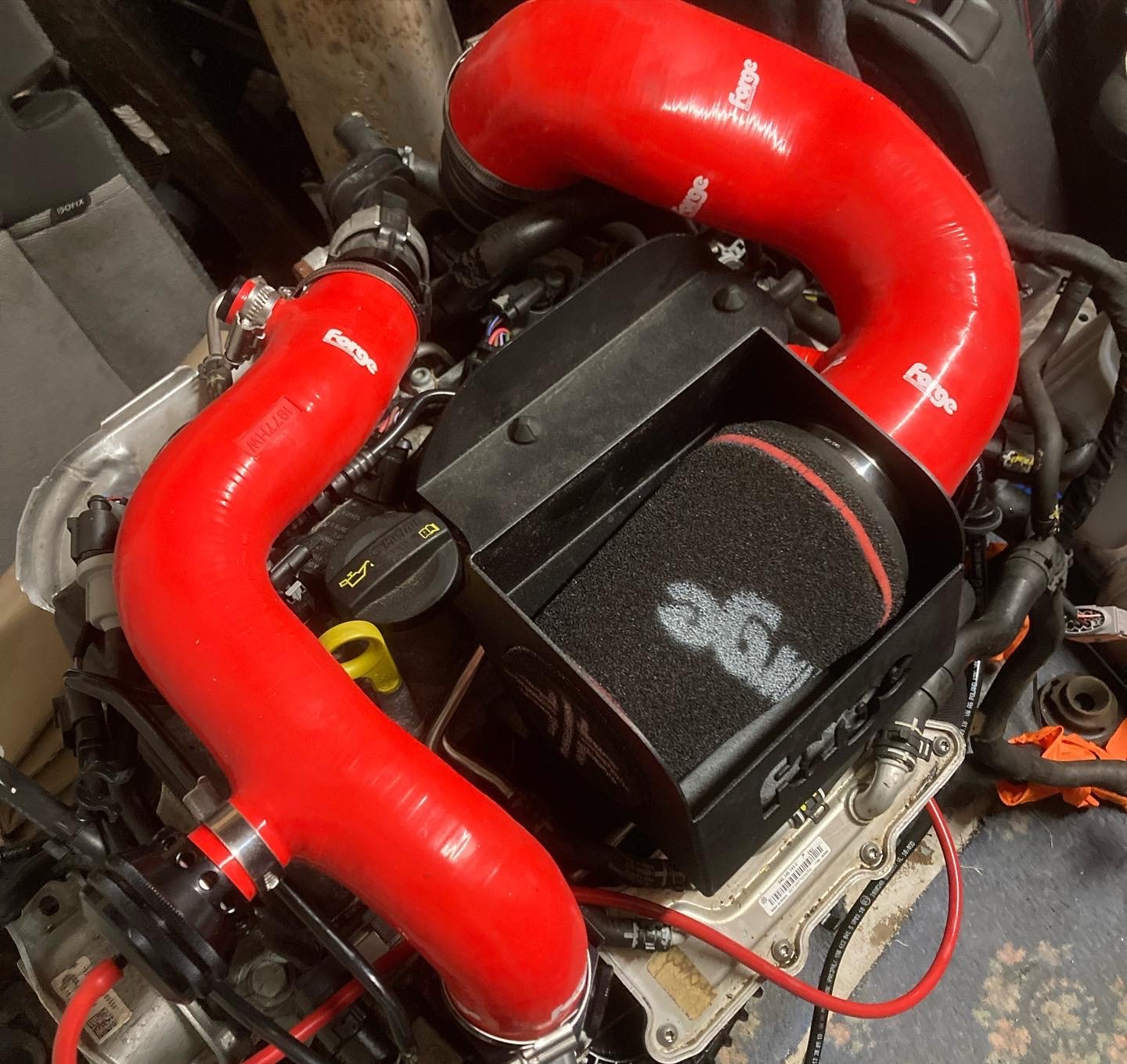

Been having a test fit of the forge goodies I brought
Really cool 😍😏

Loving the build so far!! I am curious about the beat subwoofer. I am guessing the Up! GTI had the beats amp under the seat which is how youre going to run it to the radio?
Only reason for asking is I would be interested to know if the sub can be run without an amp via the standard radio... do you think this is possible?
Anything’s possible yes I’ve got the under seat oem amp to power it once I change interior loom, but to get it running in another car I imagine would be a knightmare, there are plenty of powered spare wheel subs that will do a better job and be easier to fit. I’m only fitting this as it’s going to be plug and play and the small size of the citigo should be more then enough
