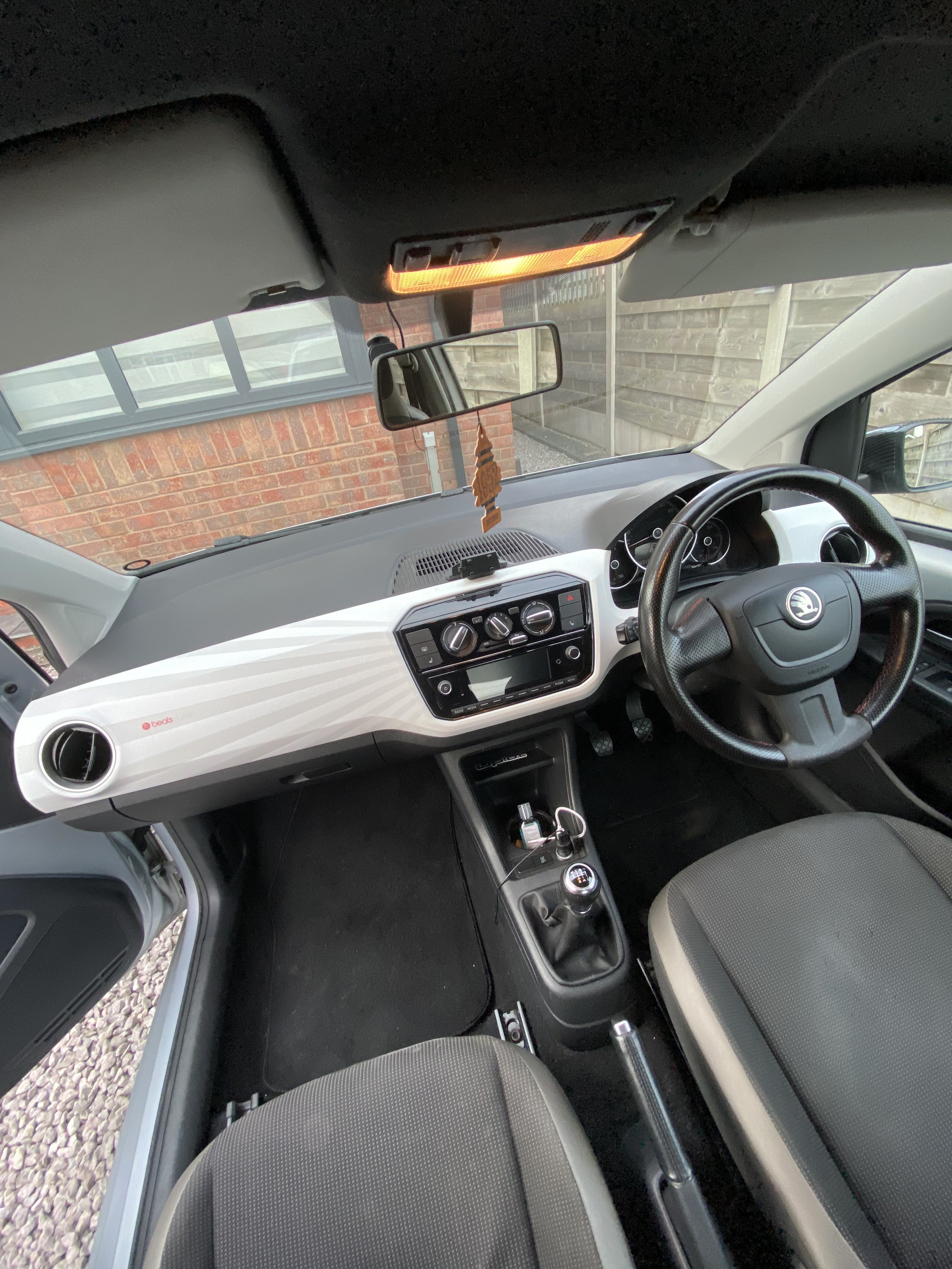

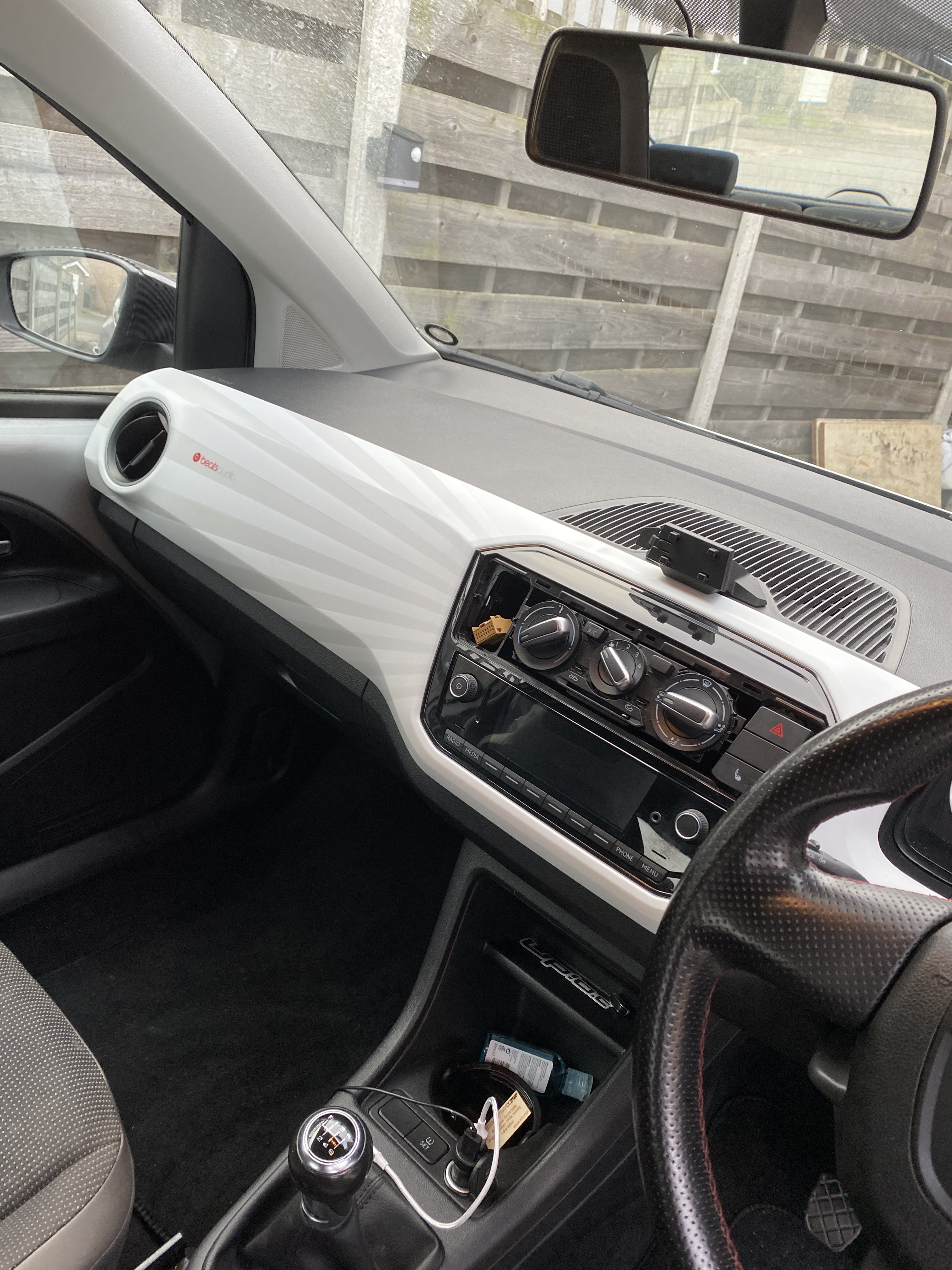

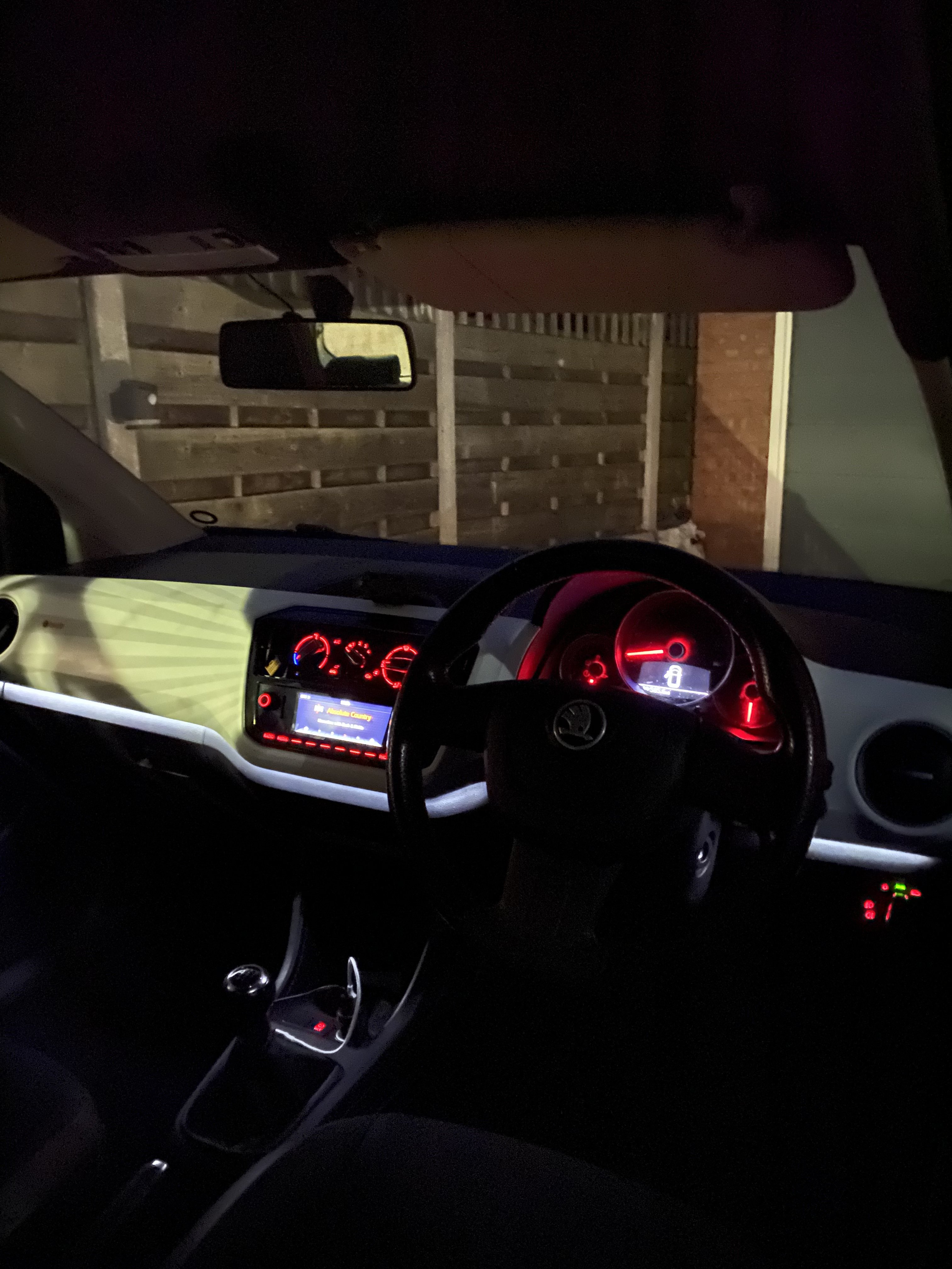

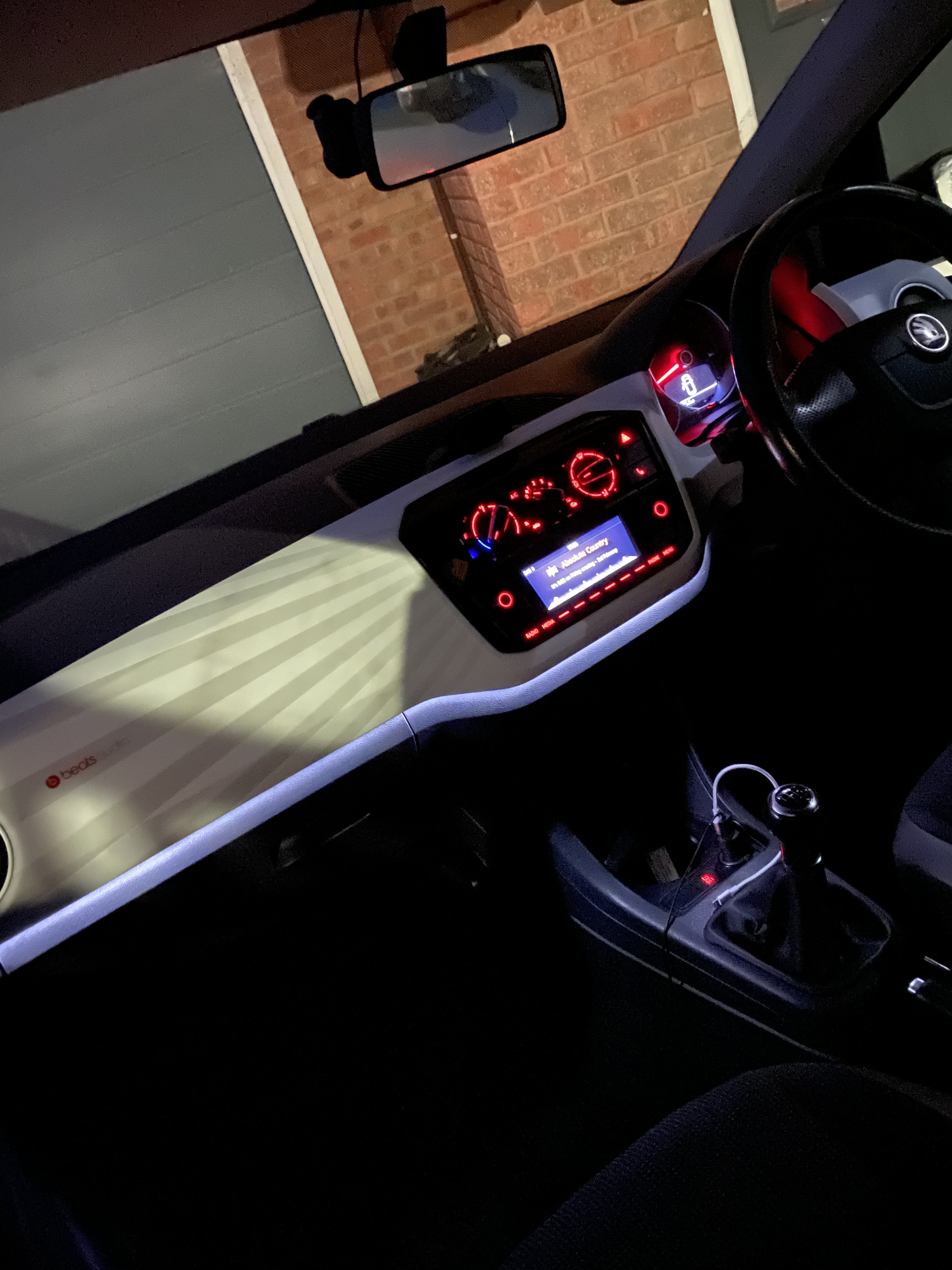

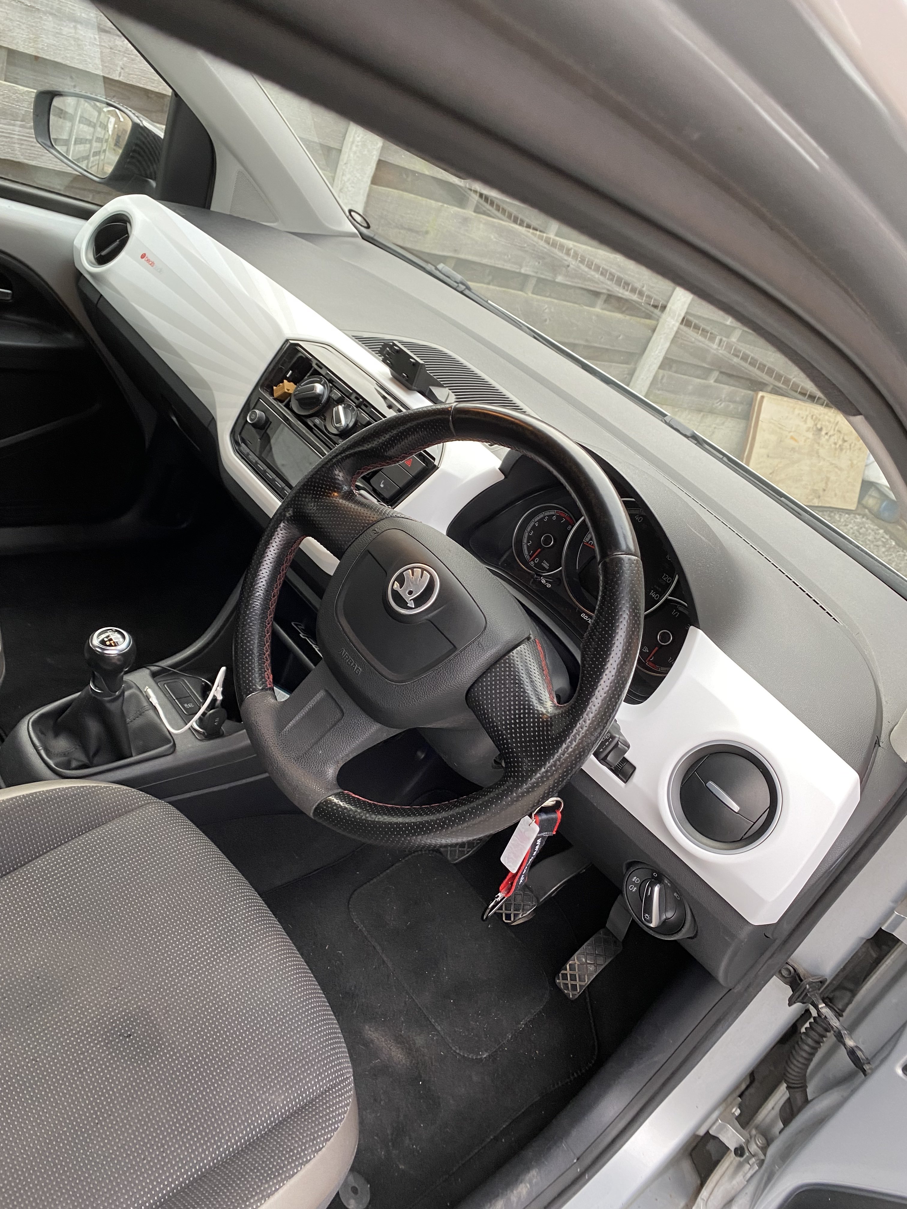

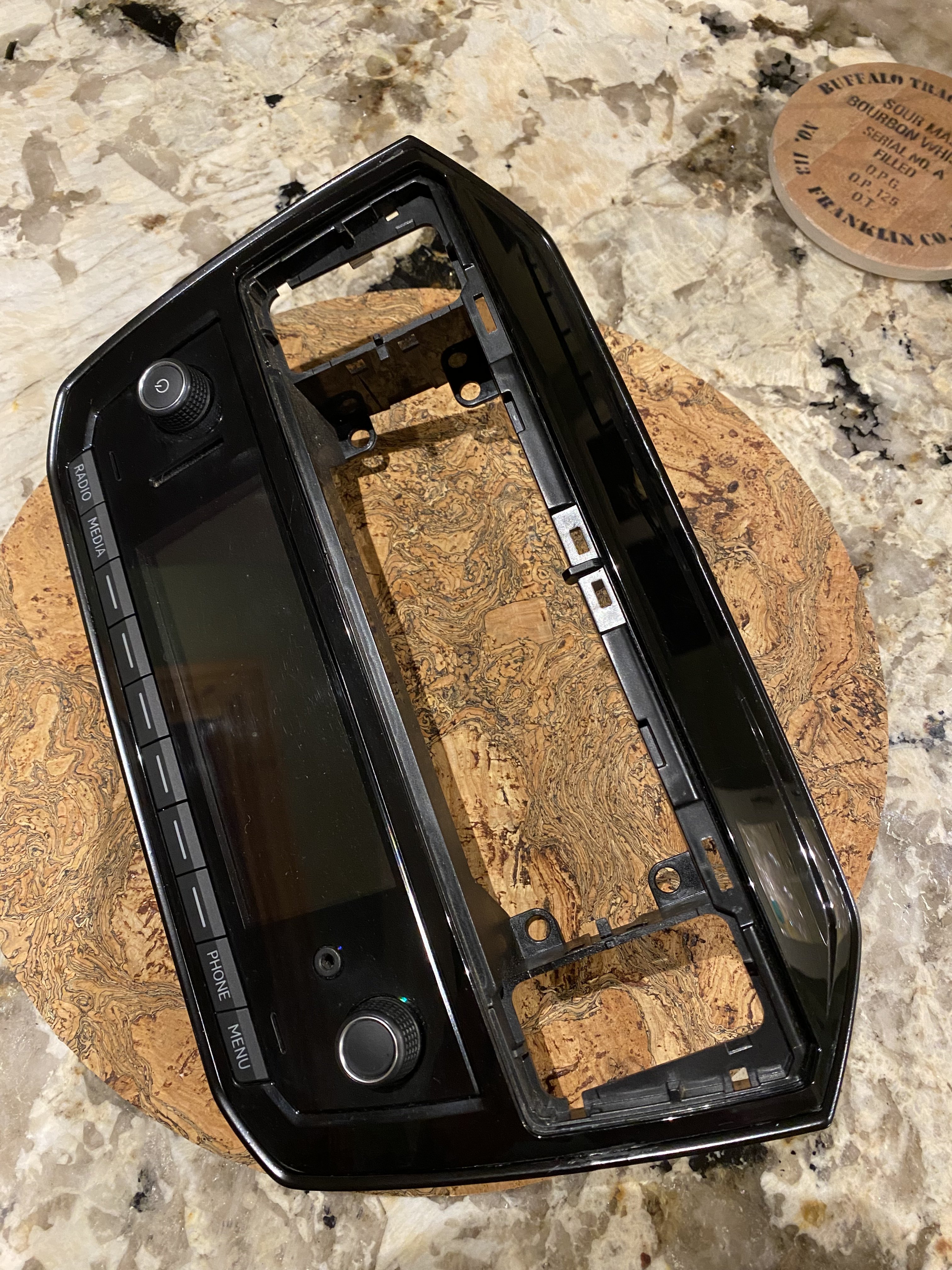

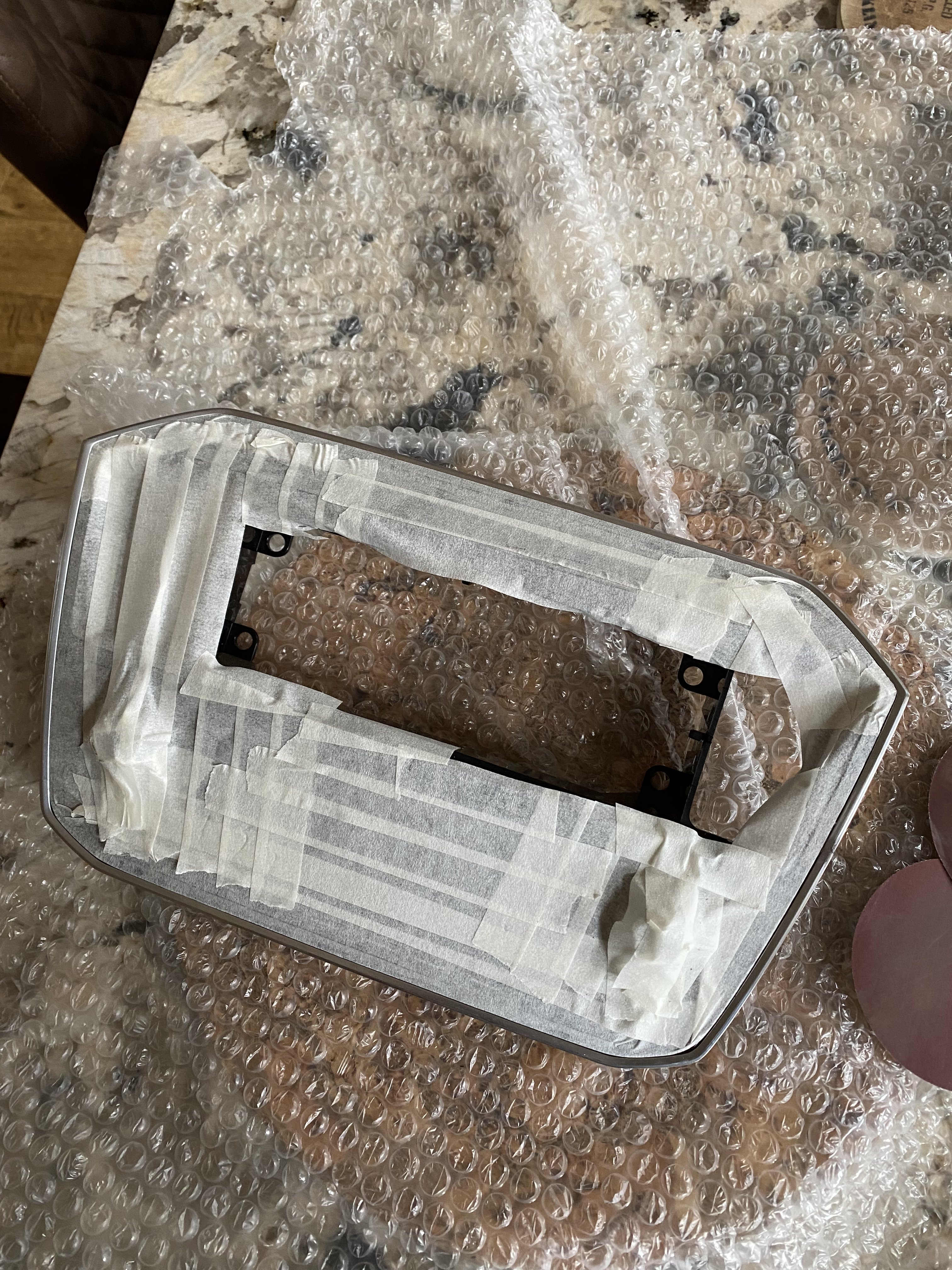

Been playing with fitting facelift dash panels so I could get the ambient lighting as I have all the wiring there already just needed the panels.
so brought a facelift stereo and swapped my headunit to it and sprayed the surround black, found a Up Beats dash set that had white ambient lights so swapped them over. Just need one switch that’s on order,
came out really well. Citigo never got the beats sound system but I retrofitted that all from the gti, the amplifier rear speakers and sub in boot. So it is truely a citigo Beats 😂
just on the look out for another steering wheel now

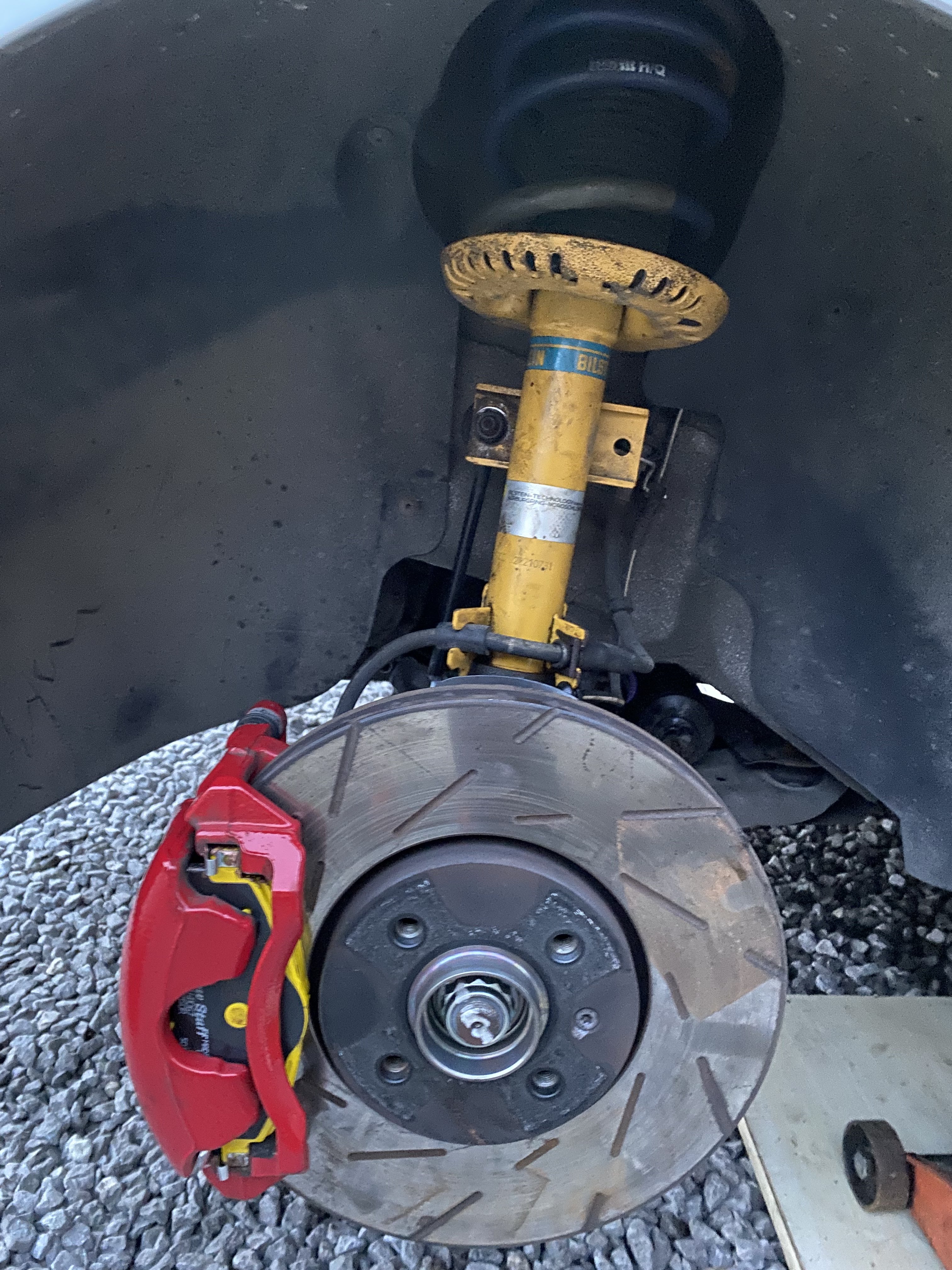

I have a few changes happening this week

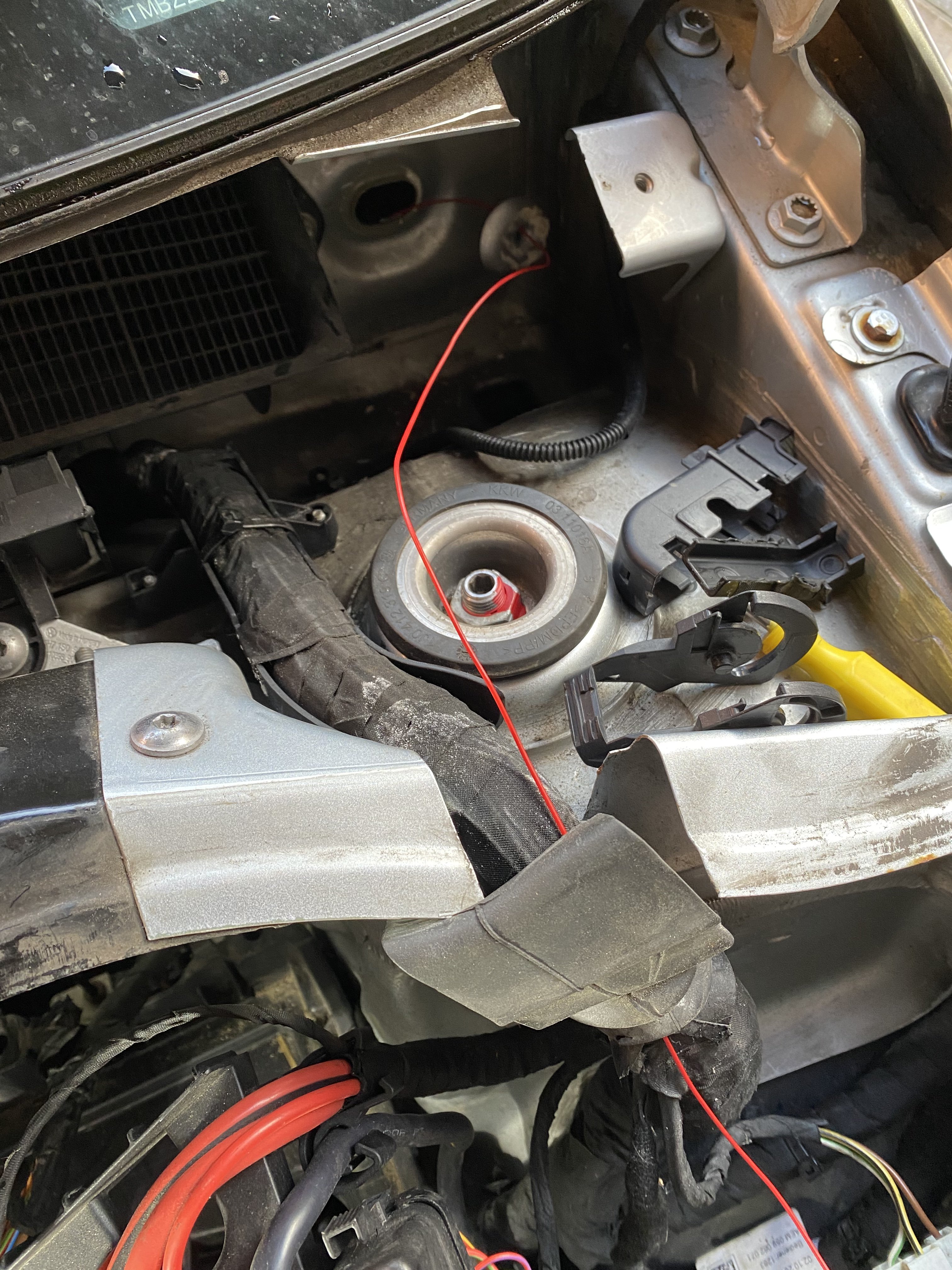

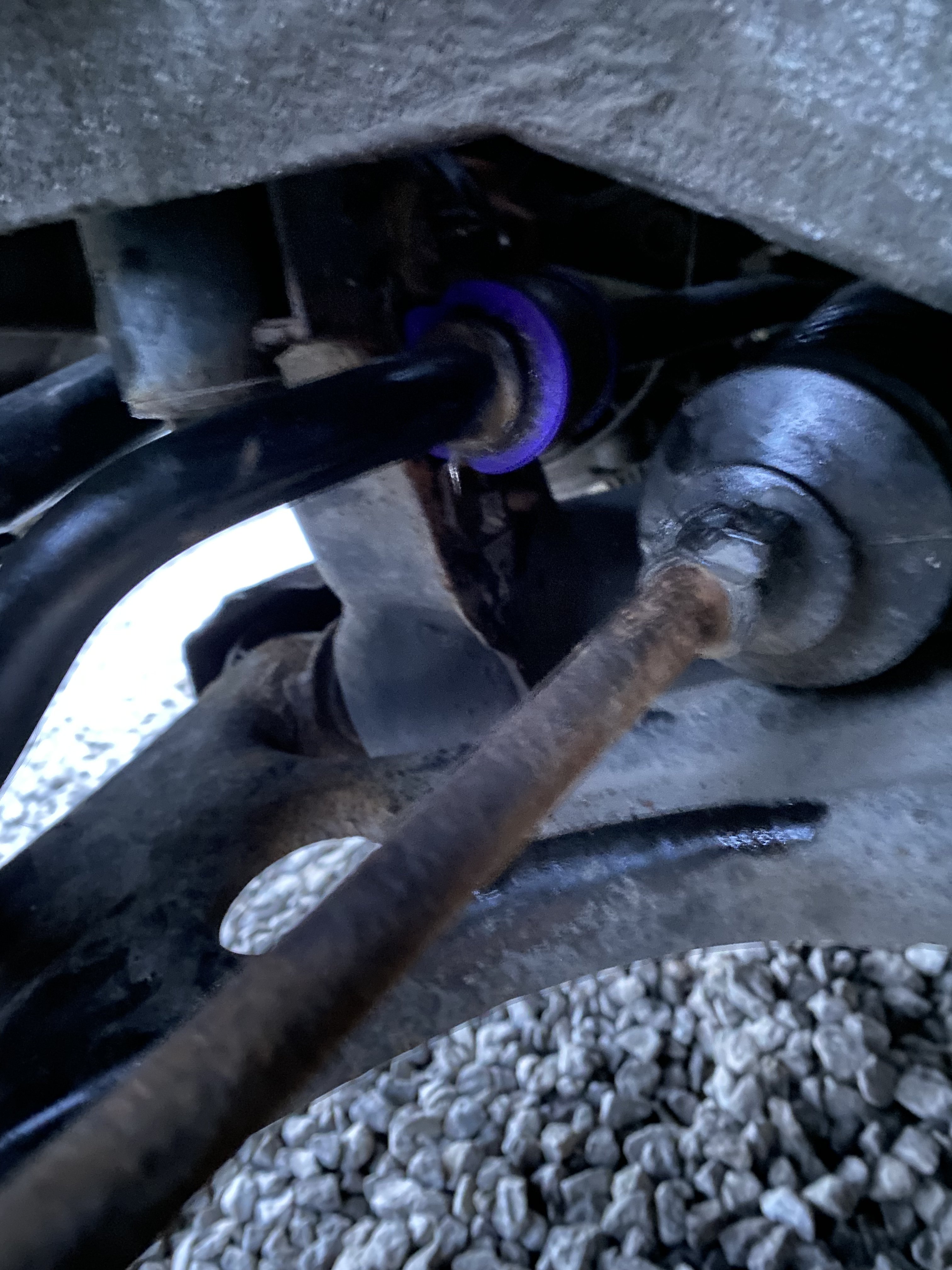

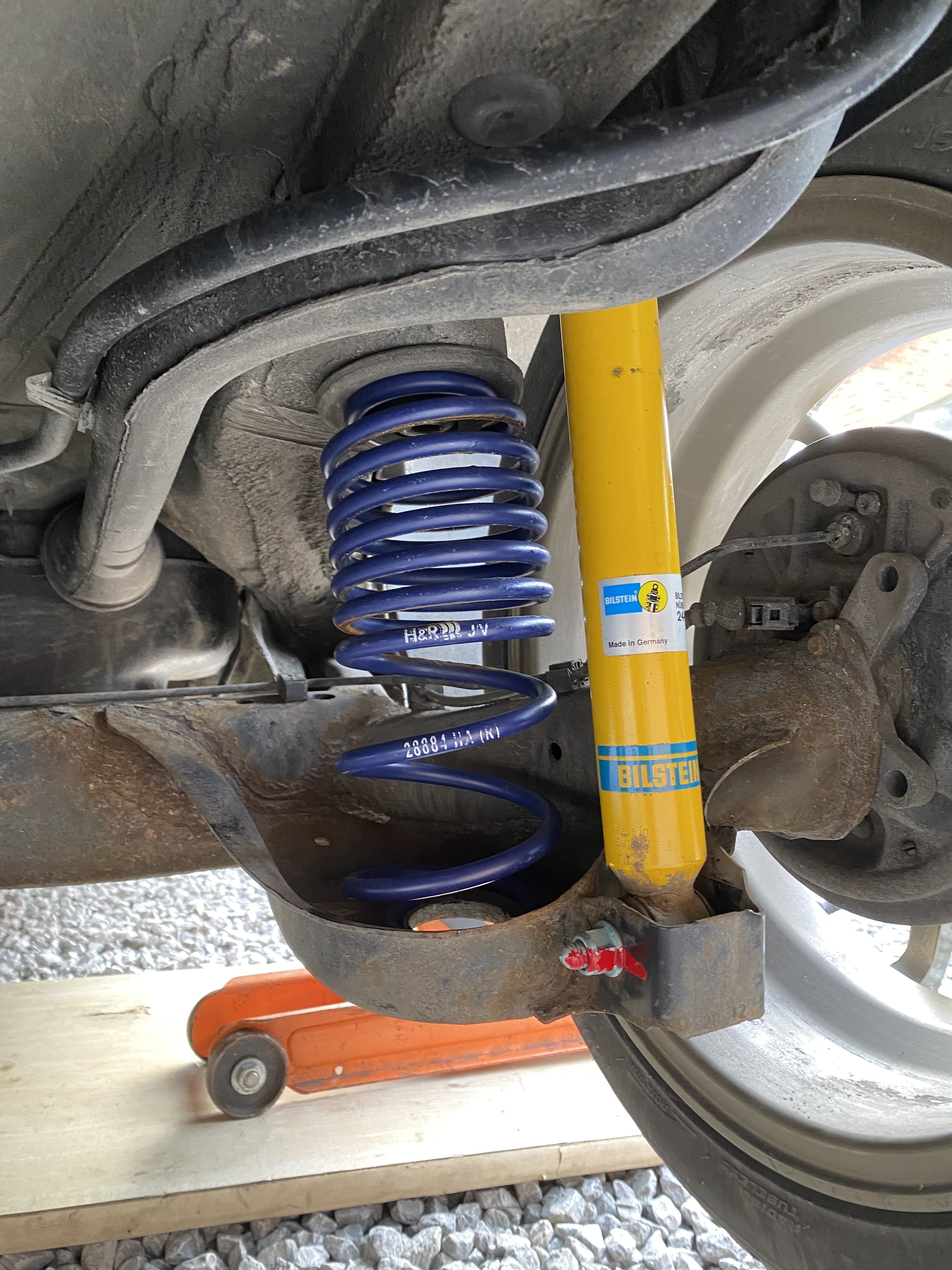

swapping springs to h&r so should be an extra 10mm down front and rear over the eibachs.
New rear top mounts and various new nuts and bolts for the suspension side as it’s been on and off a couple of times now.
Powerflex arb bushes
Yellowstuff front pads
then off to Motorist hub on Sunday with a few up owners

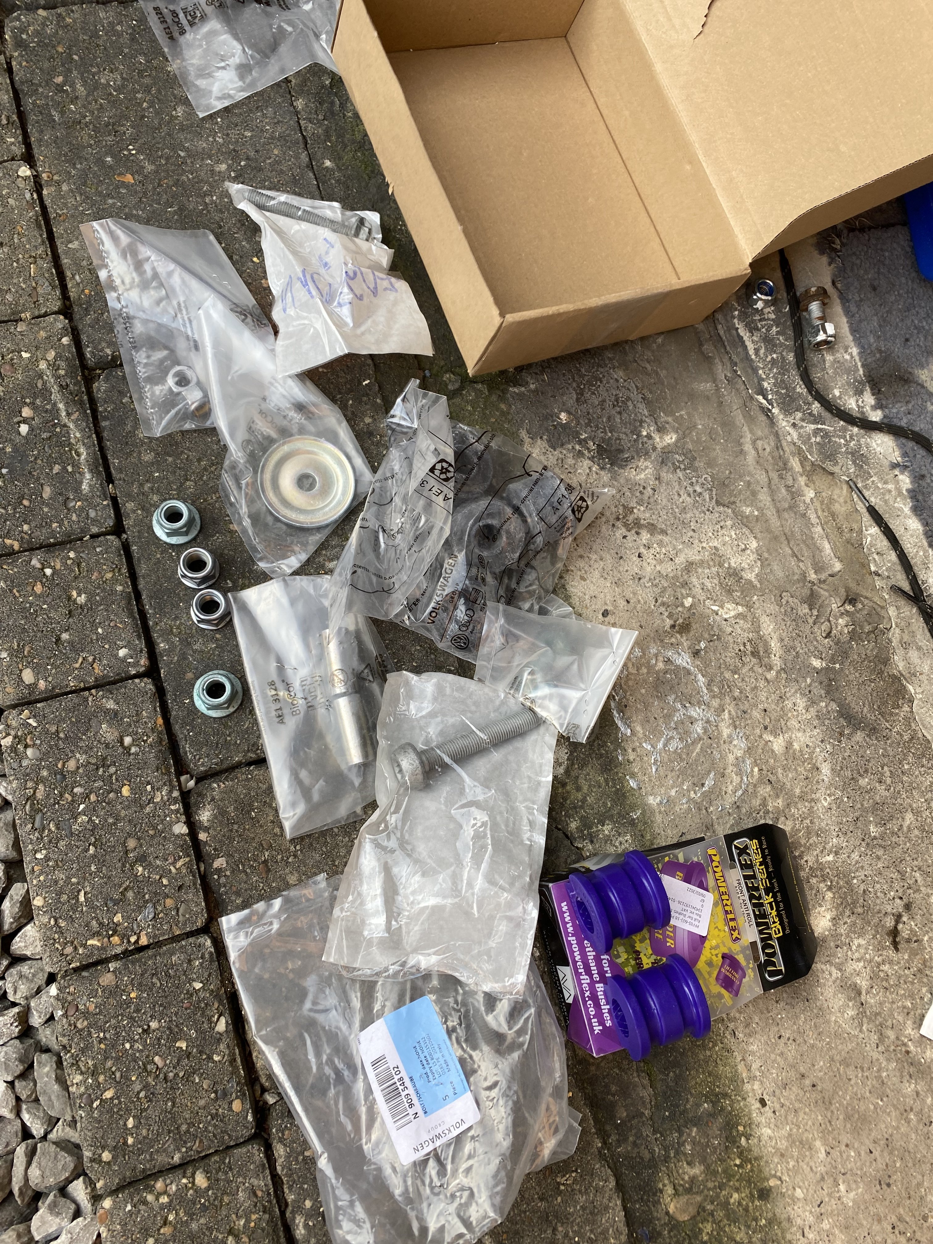

Some new bits
- Swapped the Eibach springs out for h&r so should be around 10mm down front and rear
- EBC Yellowstuff pads to go with the Ebc slotted discs I already have
- Powerflex arb bushes
- Various genuine new bolts and rear top mounts

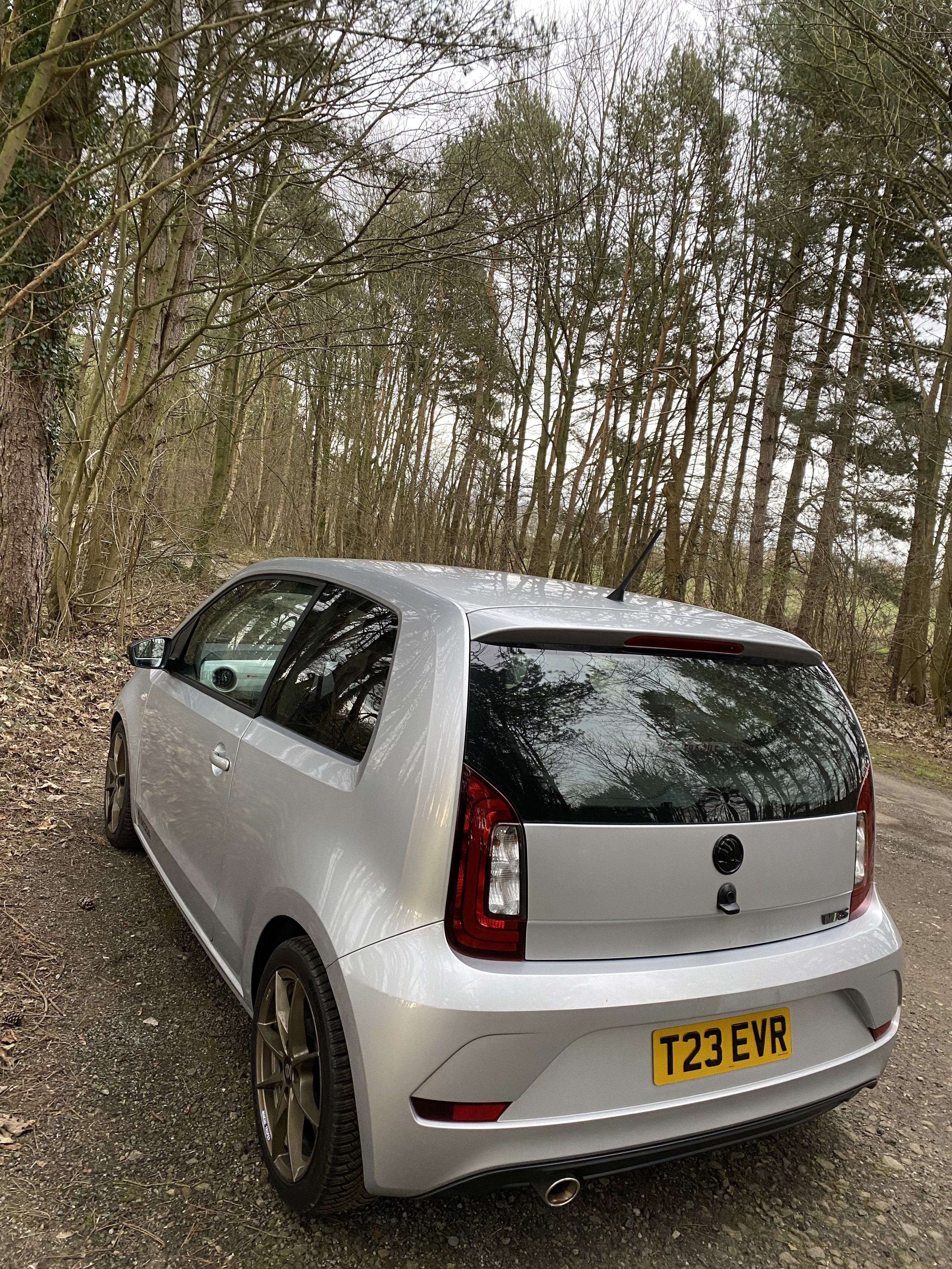

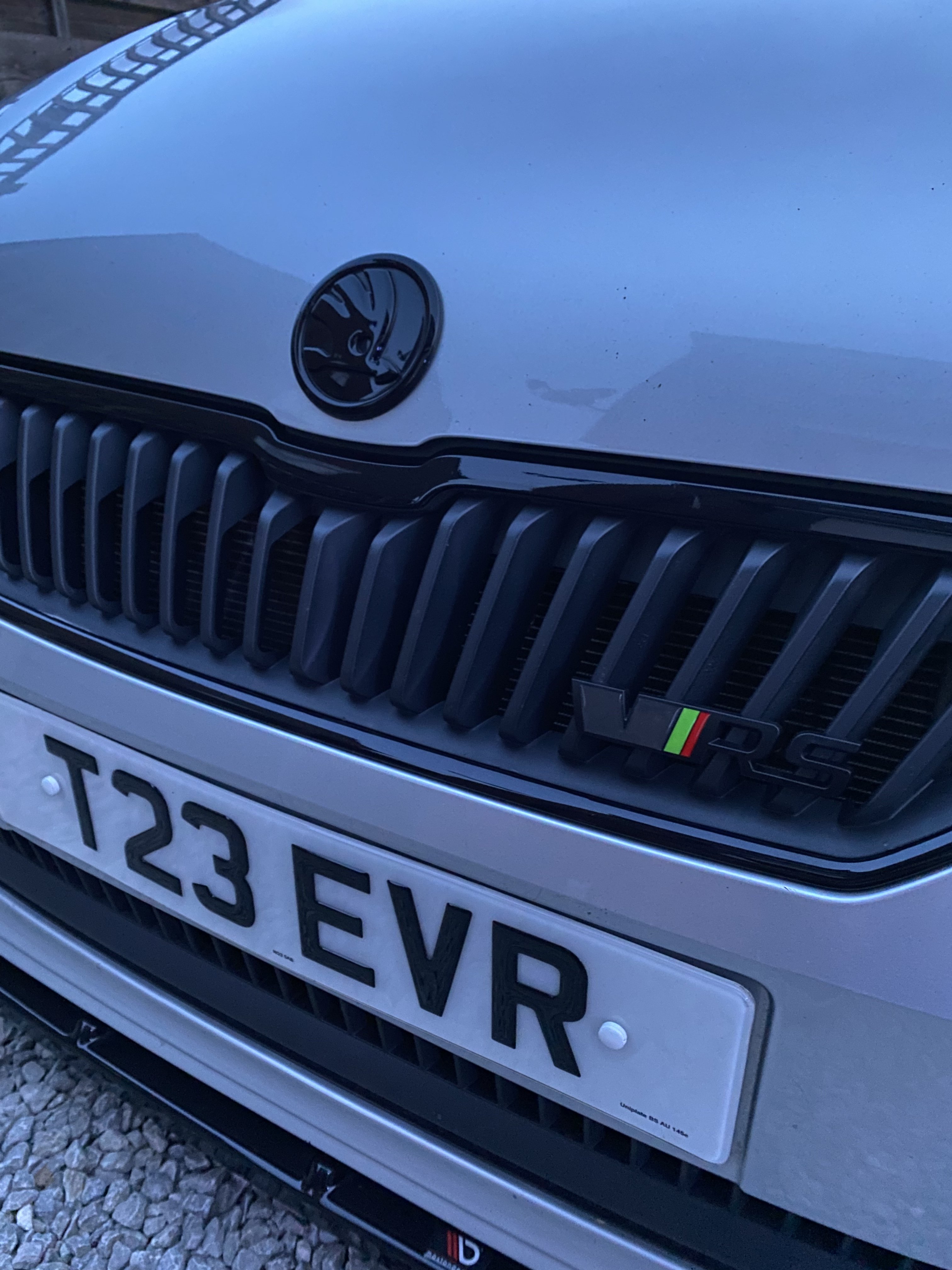

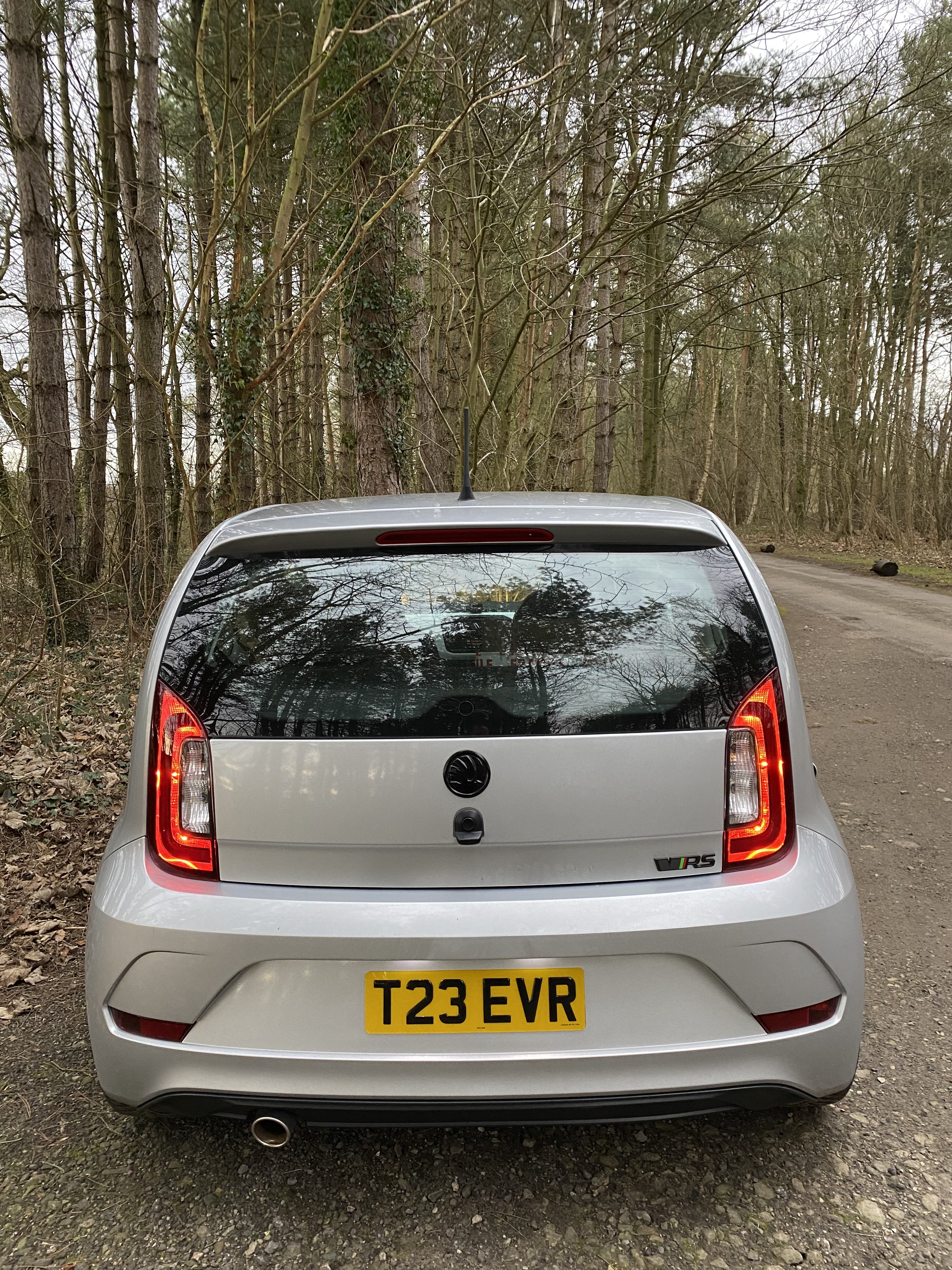

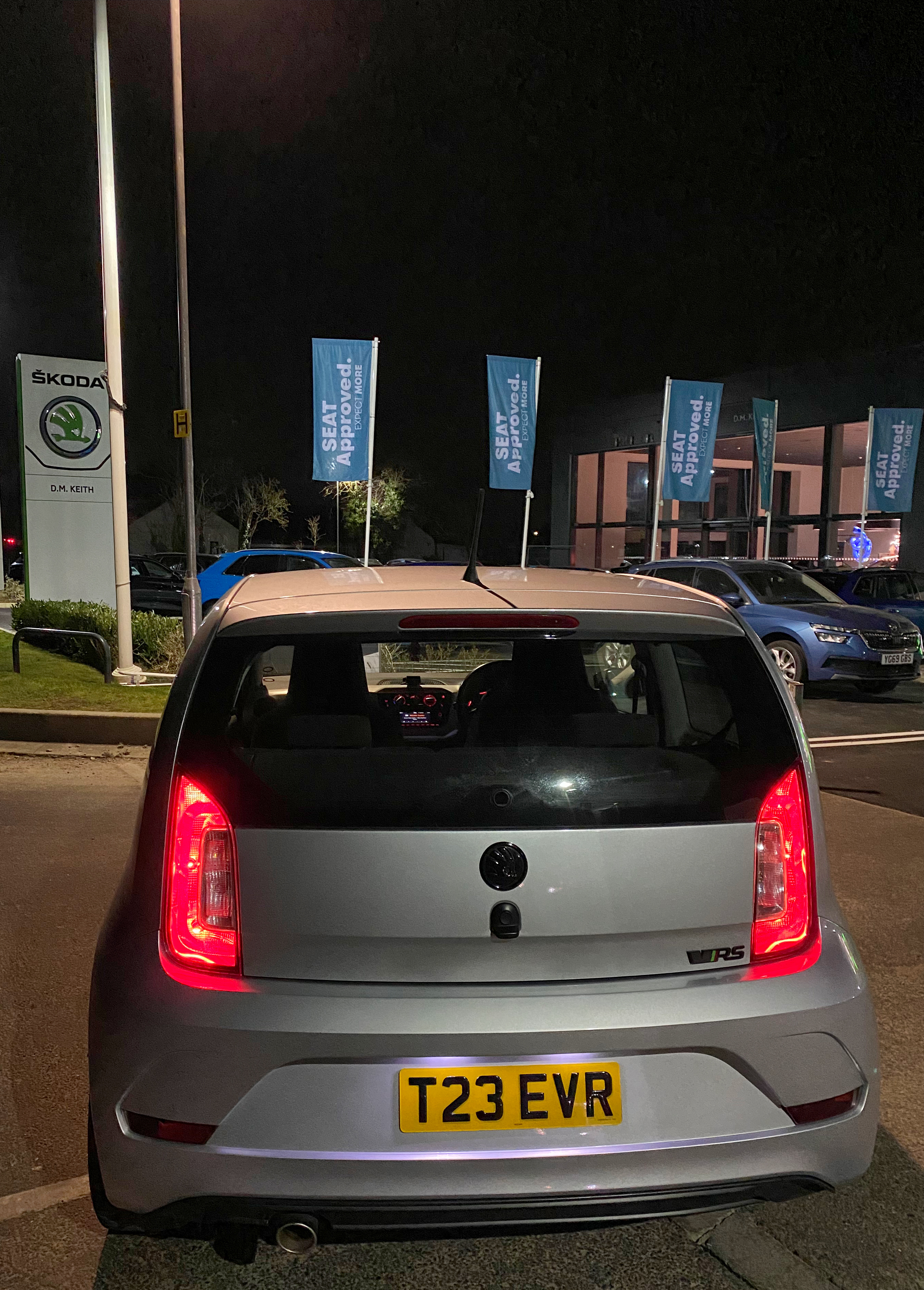

Got my last switch for dash I was waiting for, got some facelift rear lights coming tomorrow and I’ve fitted vrs badges now :).
Overall other then the steering wheel I’m pretty damn happy atm
Edited by TrevorB33

Just fitted facelift rear lights so now I’m in cool down mode for abit, just needs a service soonish
Seen it on Motorist and cracking car mate.

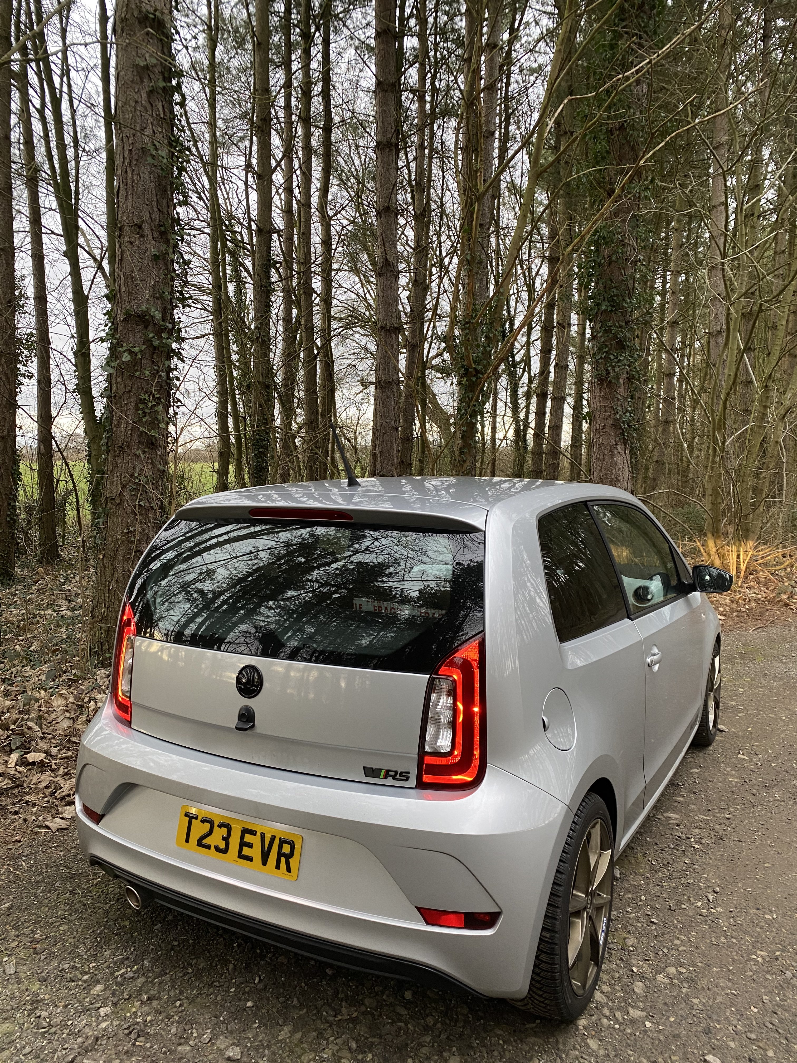

Just looking at that rear end pics again Trevor, I wonder if the strip reflector off the Octavia could be made to fit along the edge of the bumper under the number plate and could you get a more squared off tail pipe finisher to make it a bit less VW and more vRSy?😂
Not suggesting you must do anything with it, just wondering out loud!😁
I do like the octy style twin exhaust,  god know how to make that work 😂
Just do what they do with the diesel engined ones and have the o/s one a fake!😂

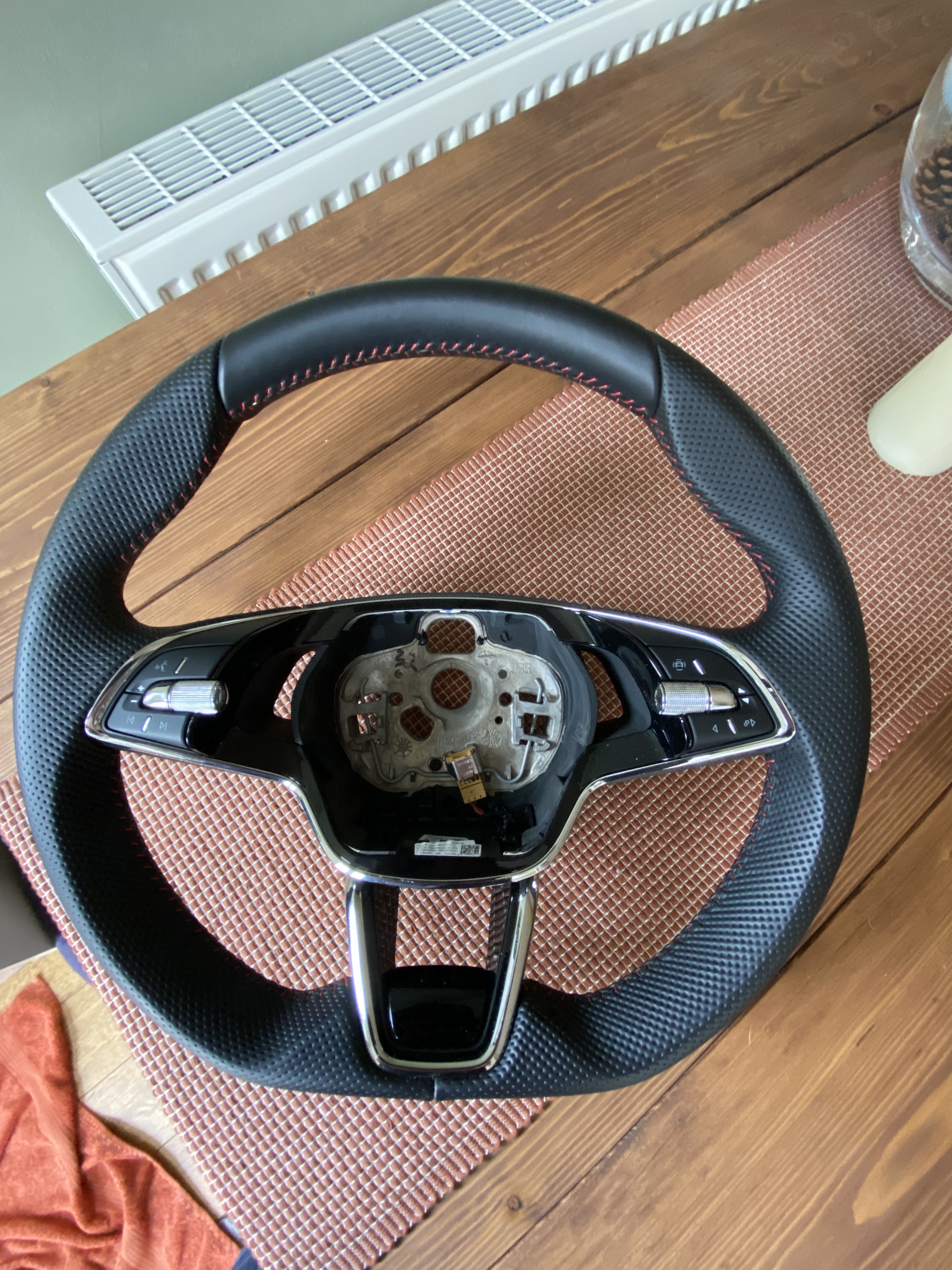

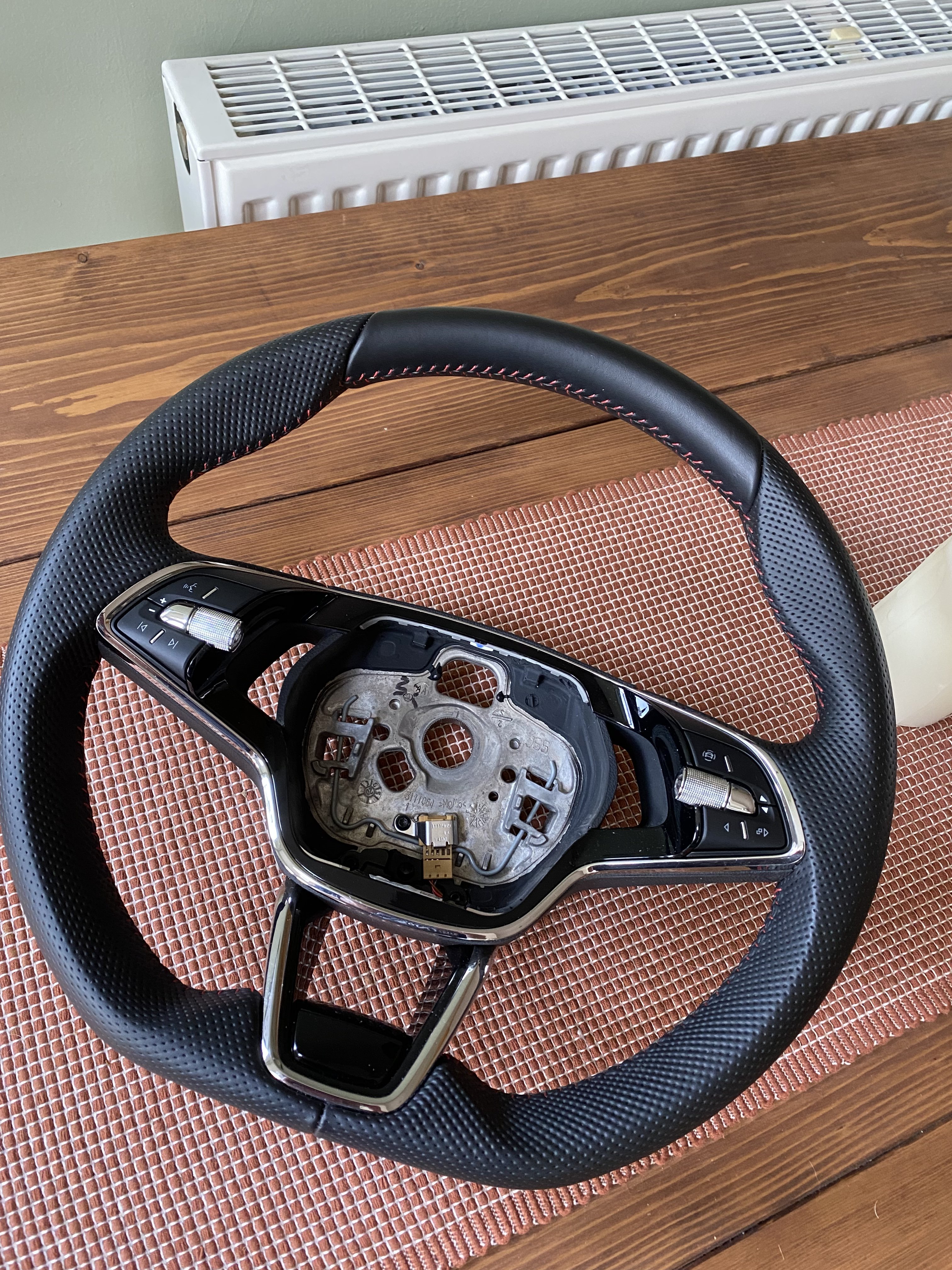

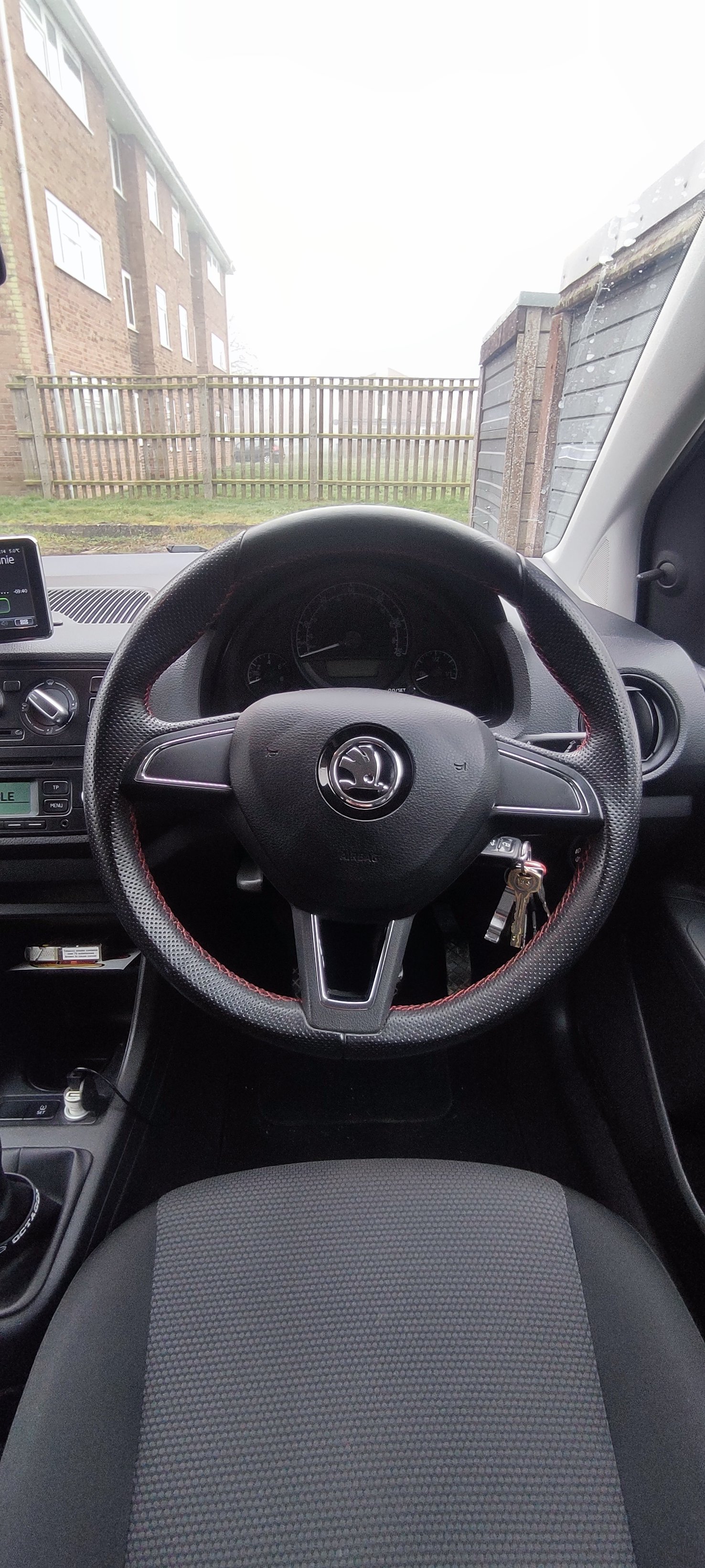

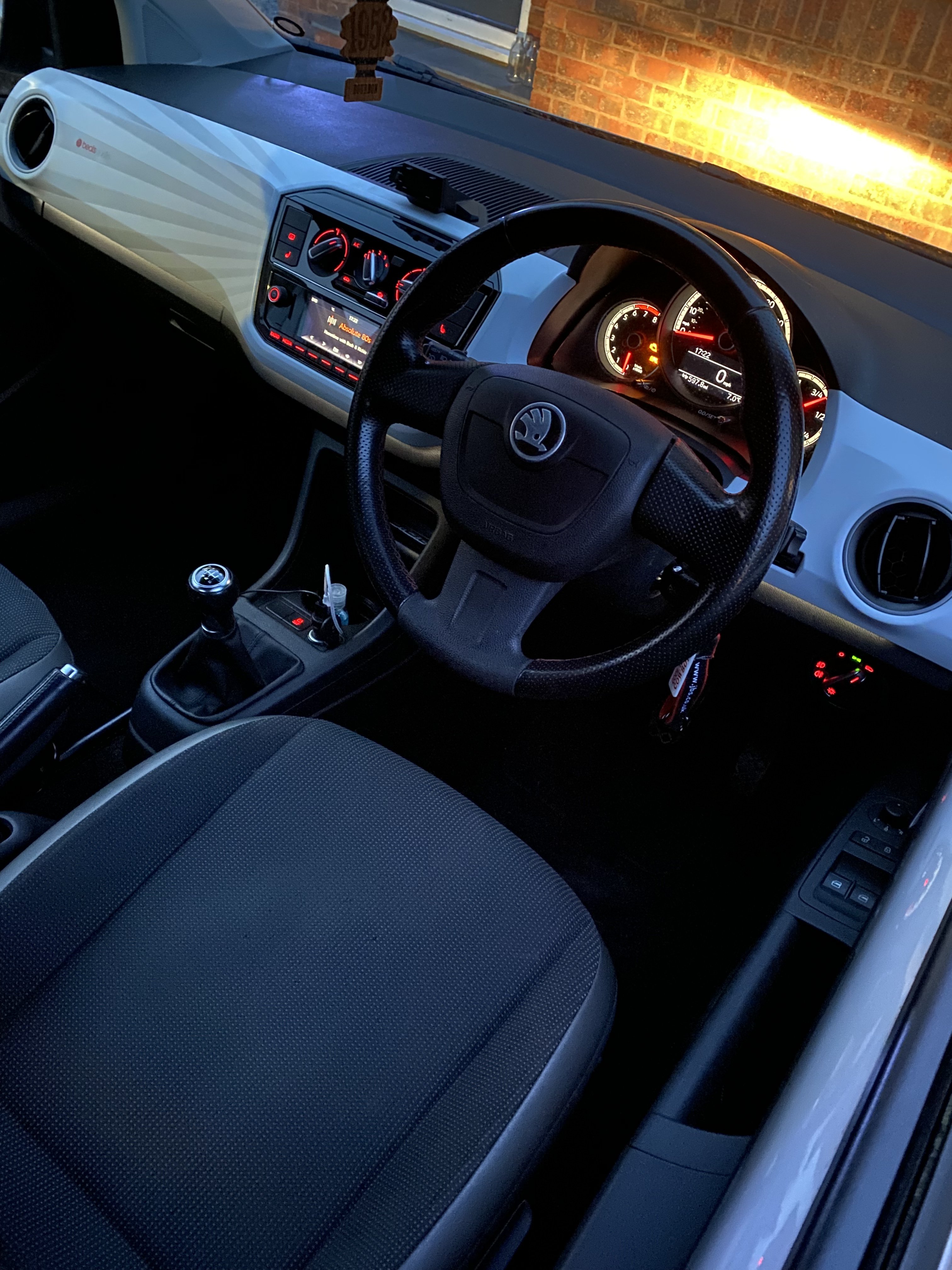

My new steering wheel arrived hopefully I can get the buttons operating the mfd, watching a couple of airbags just have to wait a month or so :)

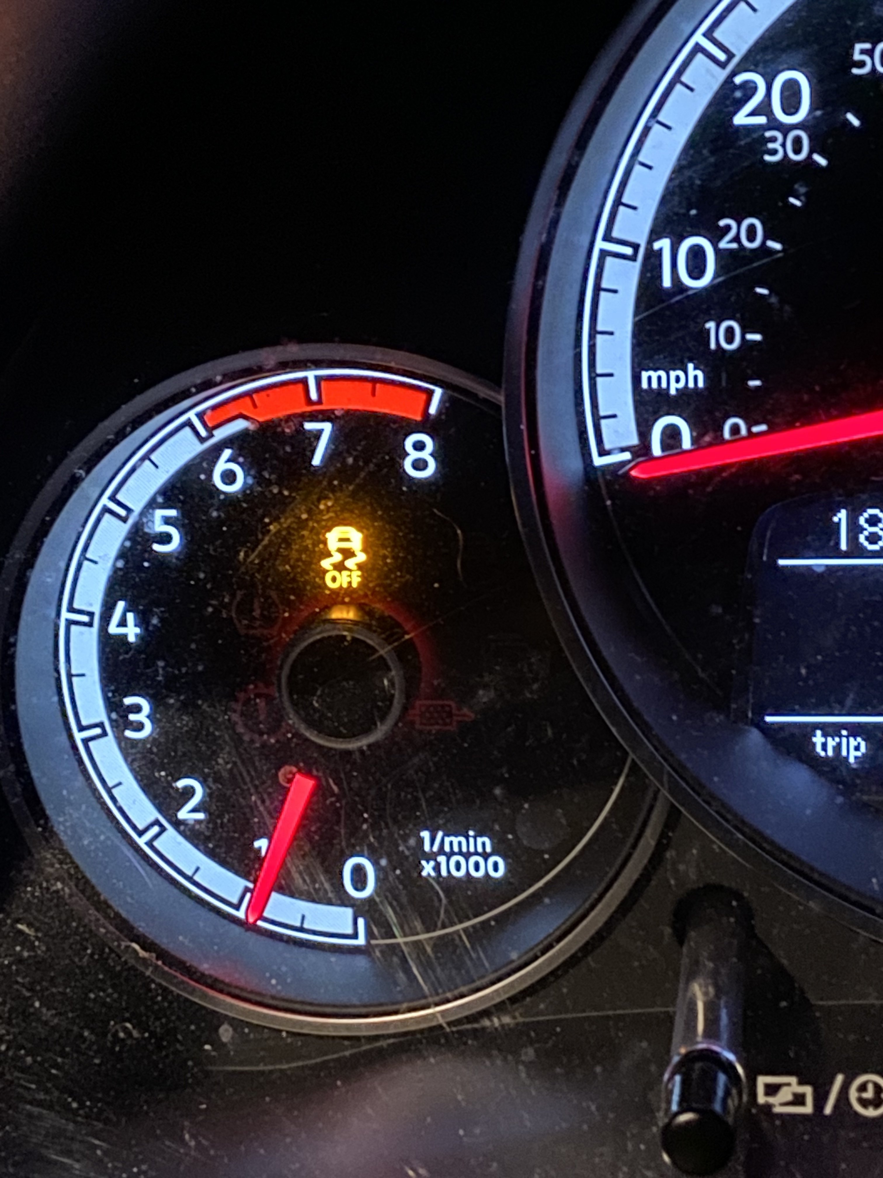

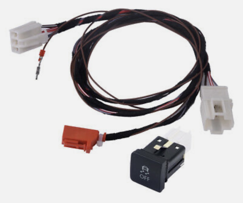

Been busy last couple of days,
traction control button wired in as it cannot be disabled on these from factory and coded to work.
Edited by TrevorB33

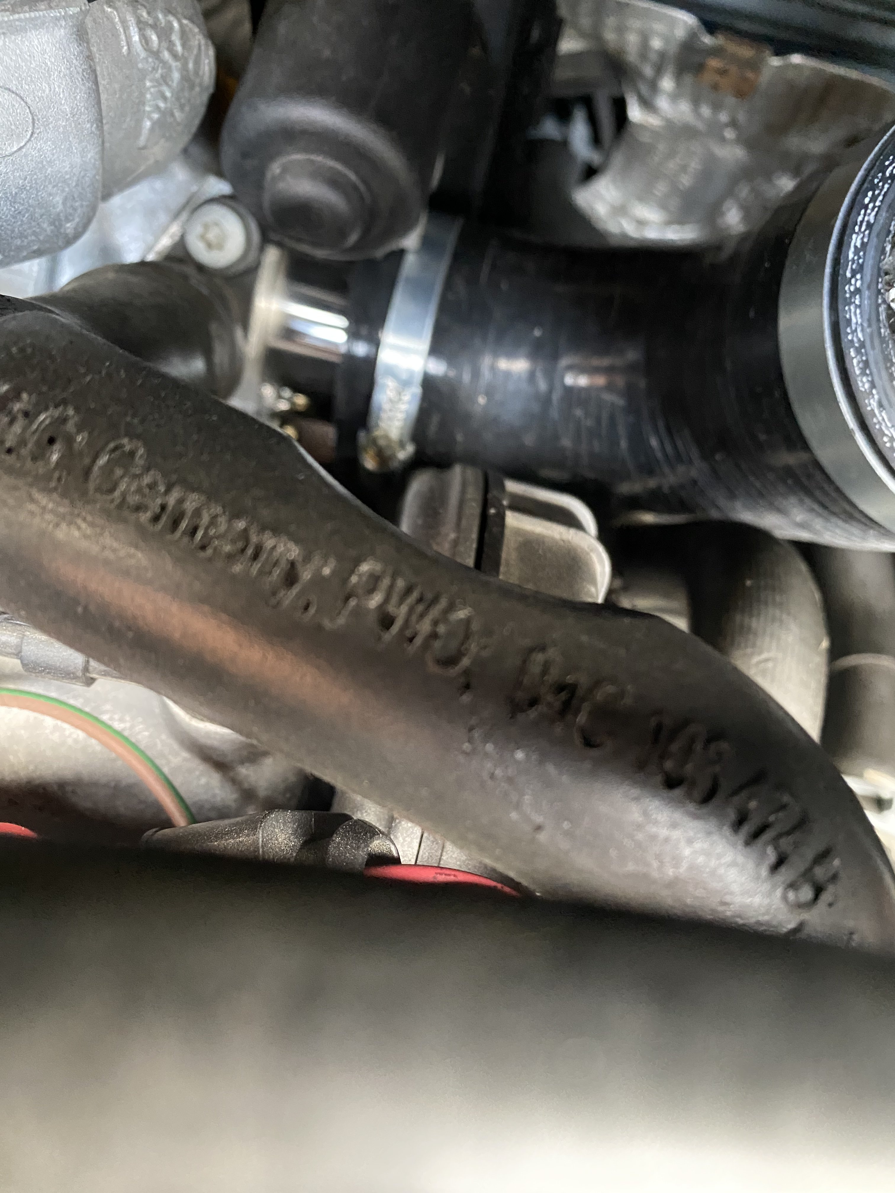

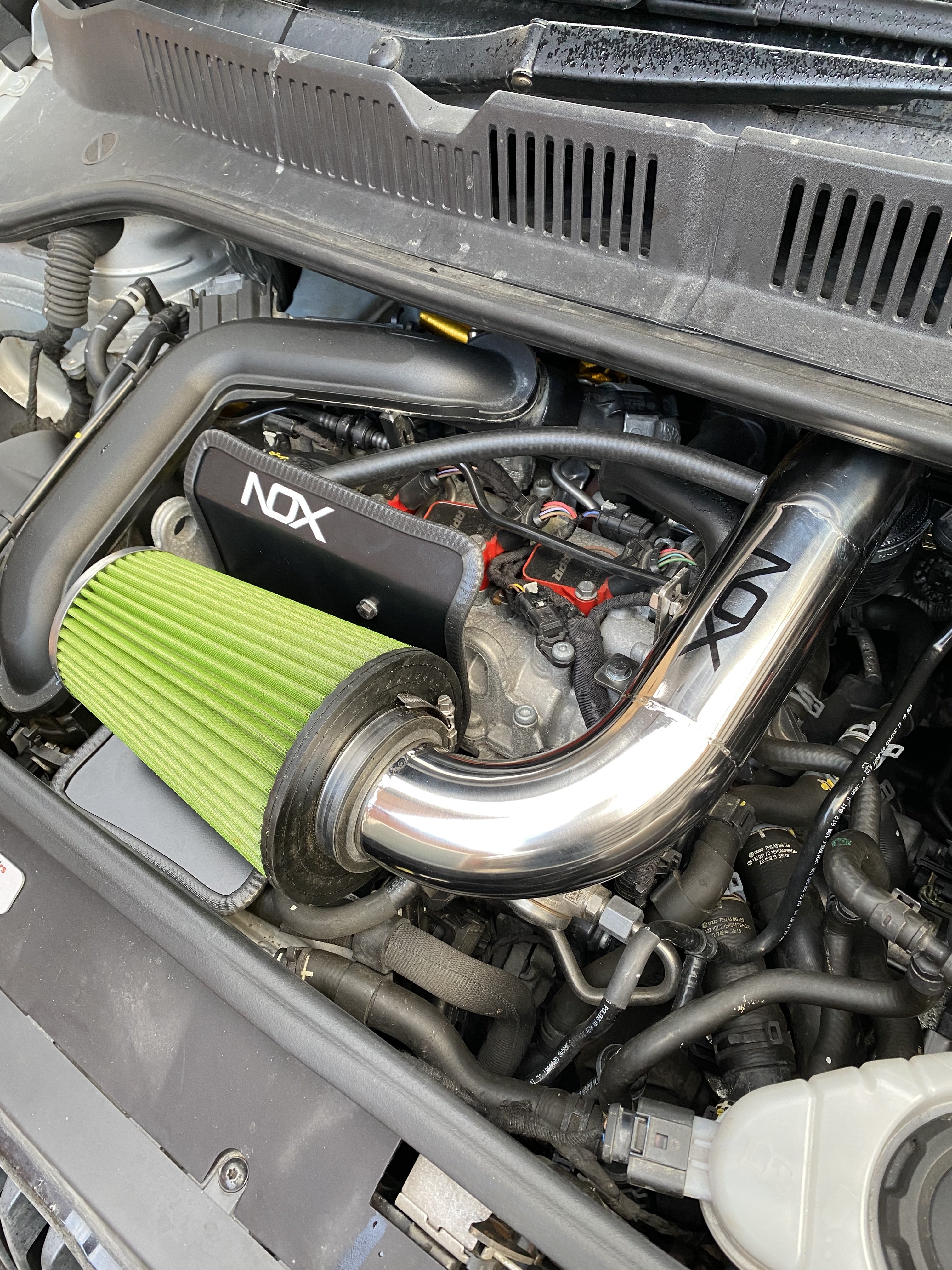

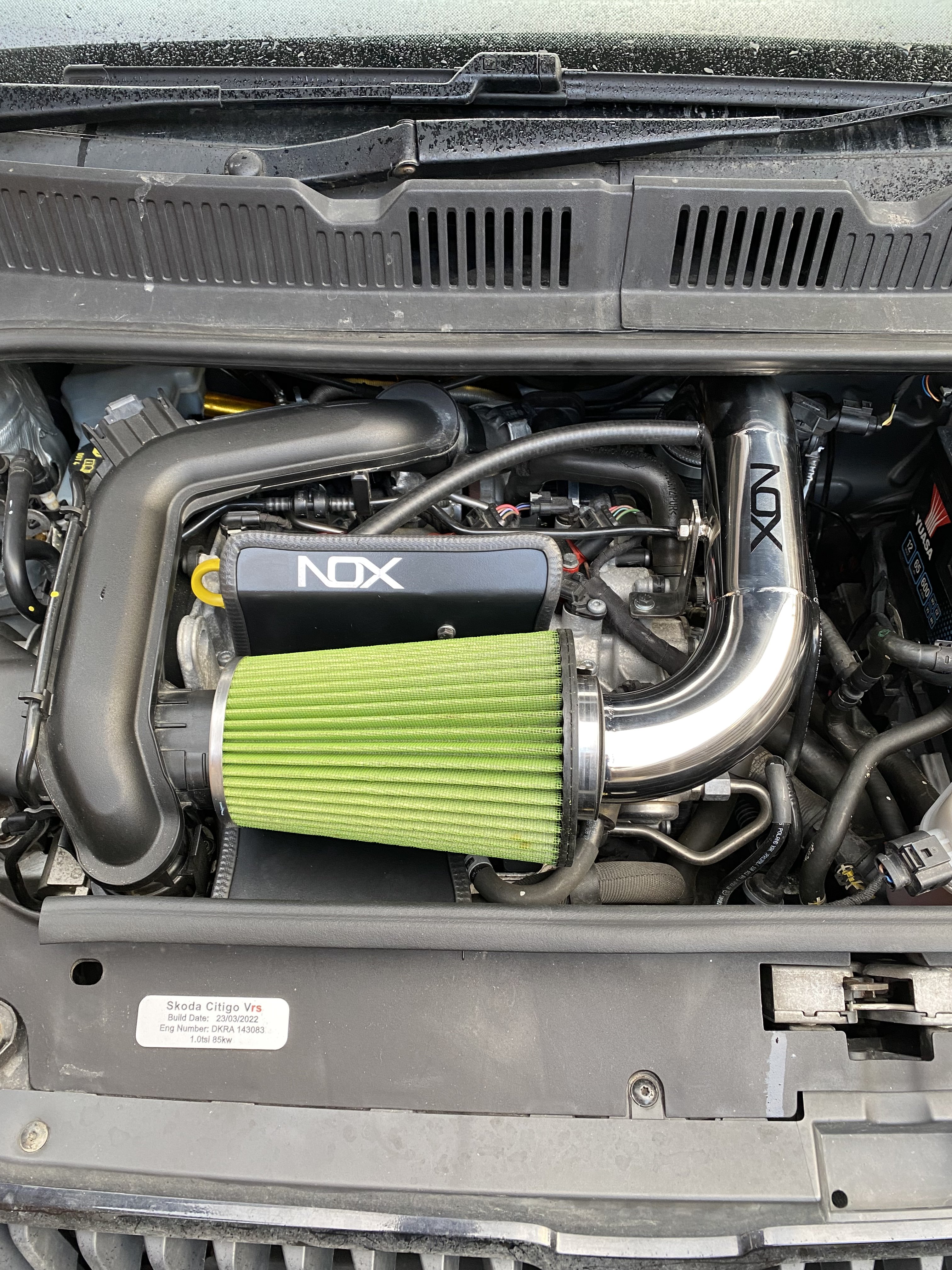

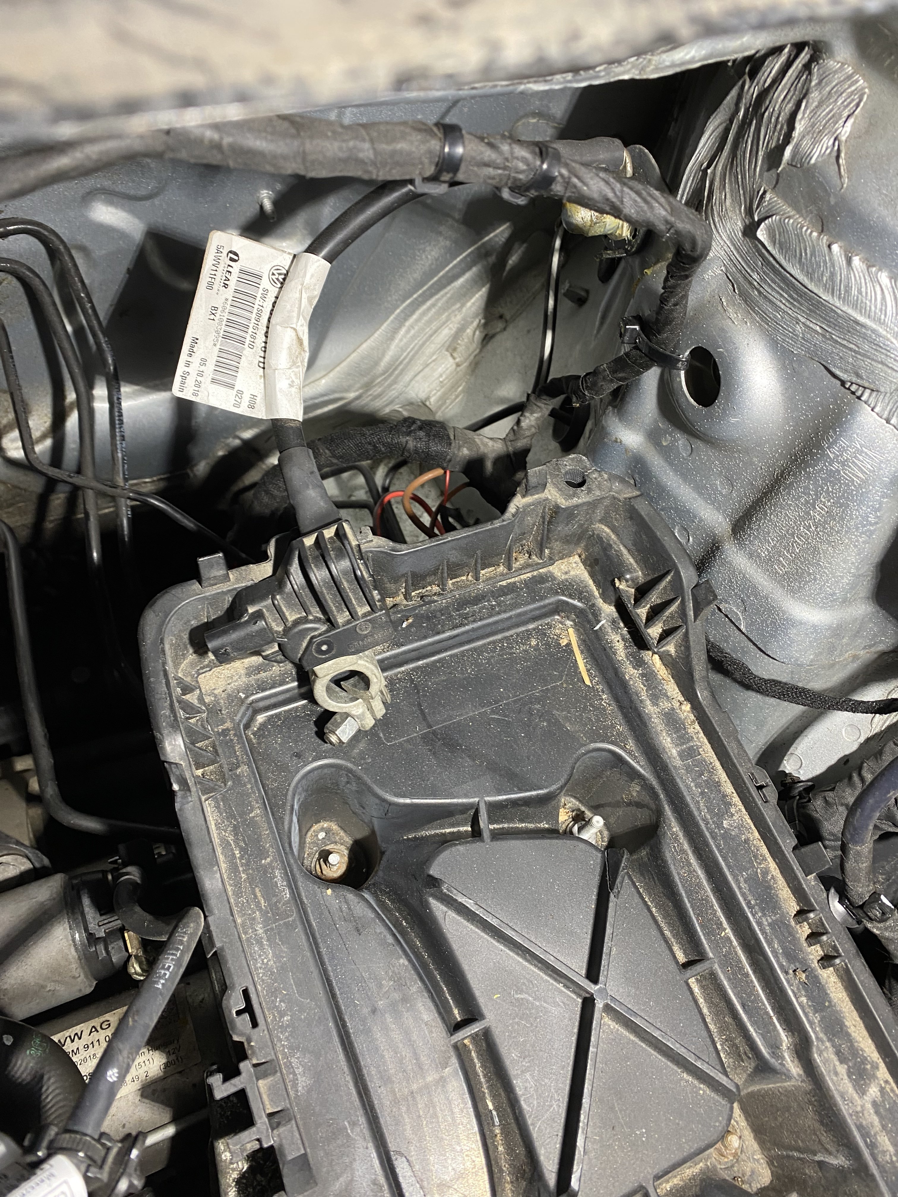

Also fitted a new intake imported from Brazil
slight problem with original air filter fitting as the citigo bonnet is slightly steeped where the slam panel is but luckily I had a slimmer one here I can use
rest of kit is lovely and incoperates the turbo elbow too
Nice; switchable ASR was the only reason I got through one snow drift.
Yes it’s certainly handy to have,
Did a little fitting vid of the intake if anyones bored and has 20mins to spare 😂
https://youtu.be/joe7bzH-yJI
