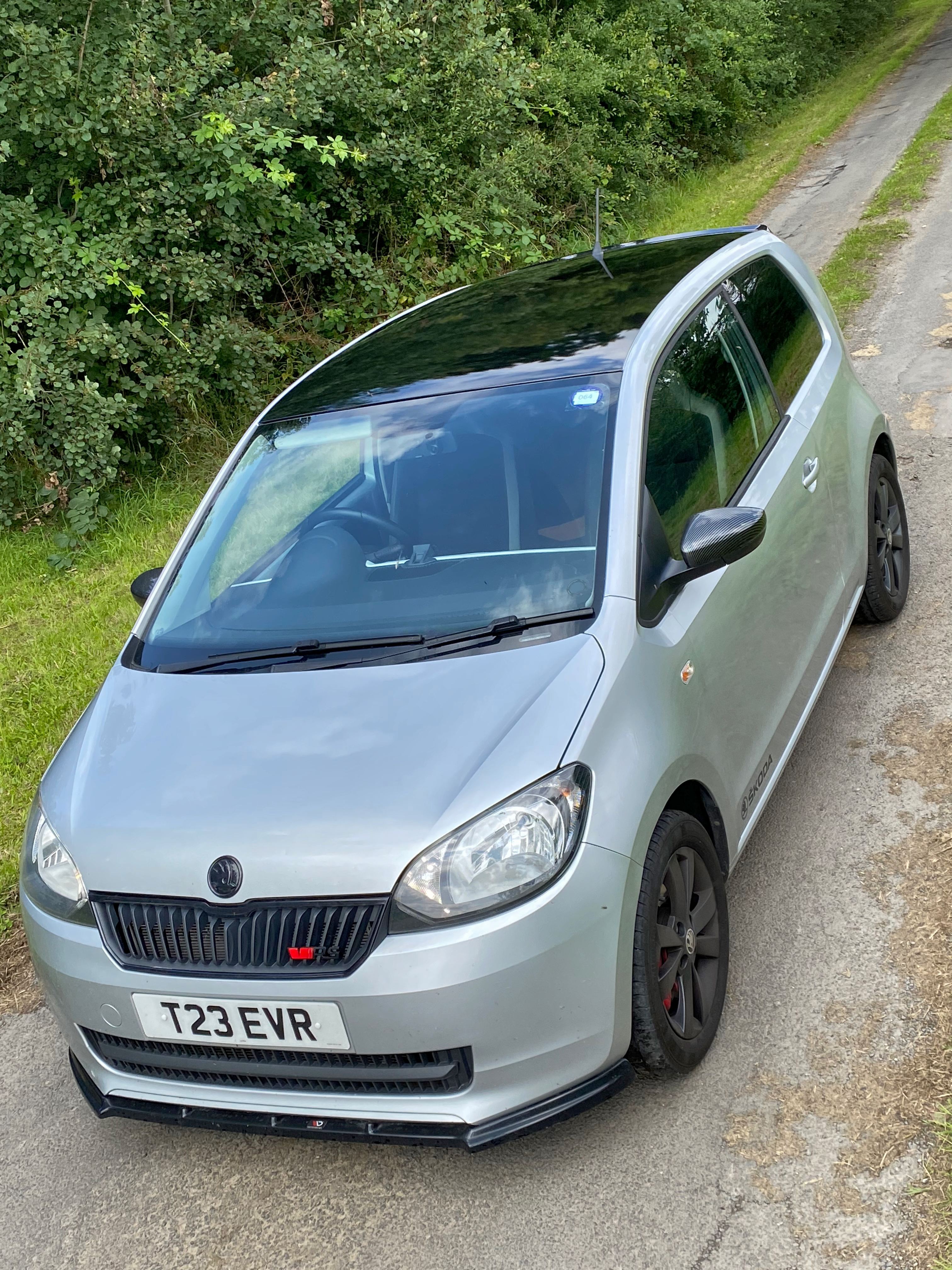

citigos had a little done to it
now back on oem Gti suspension

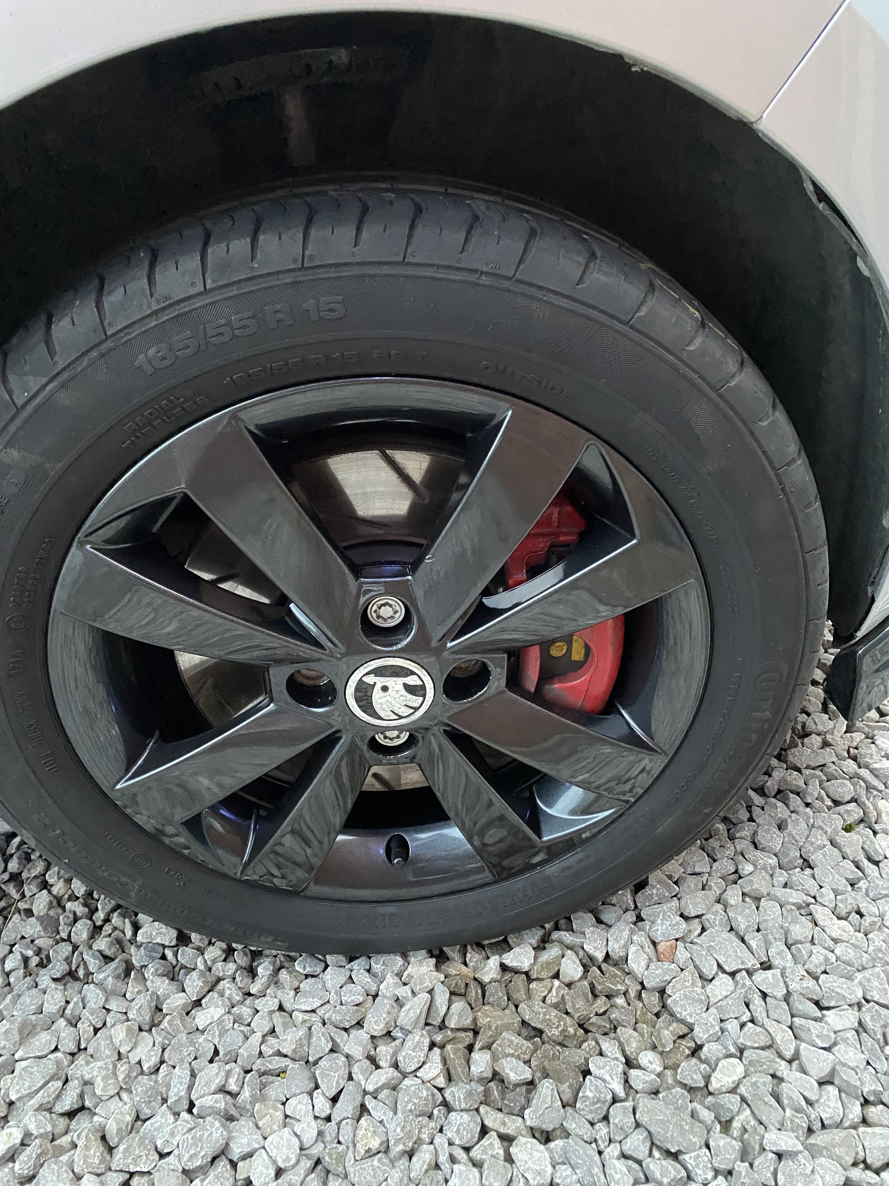

15” Auriga Monte Carlo alloys

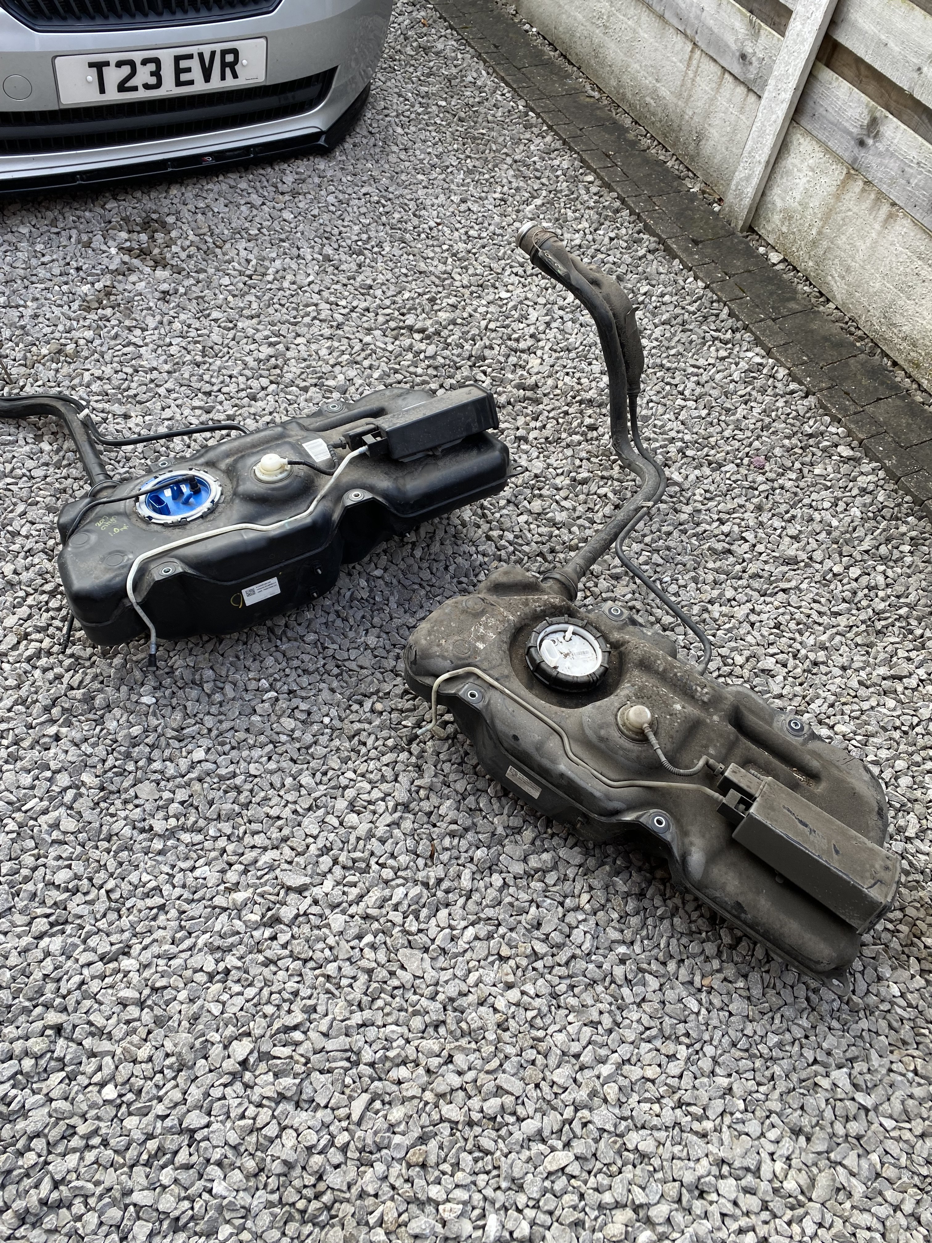

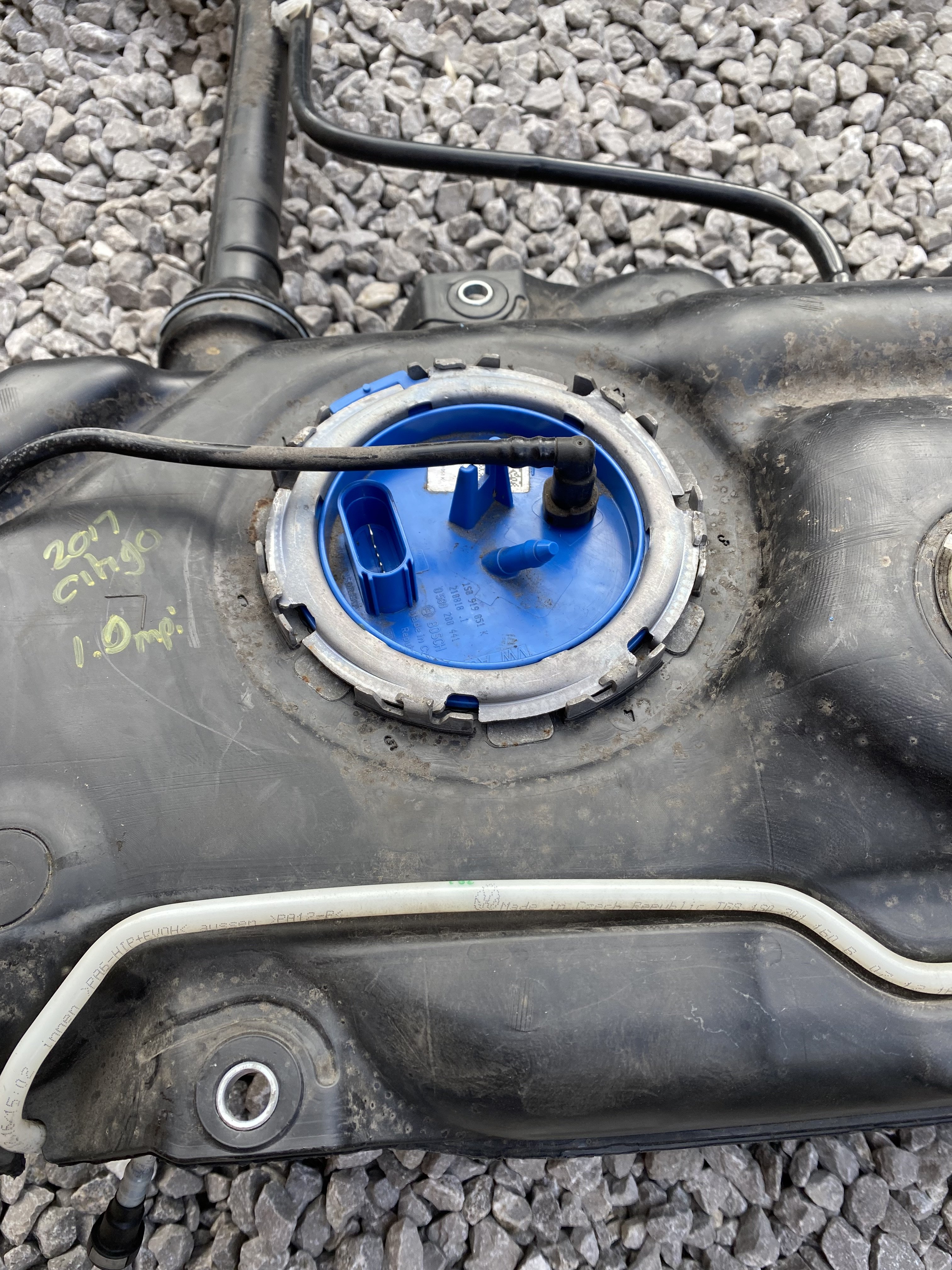

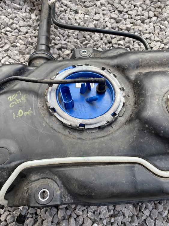

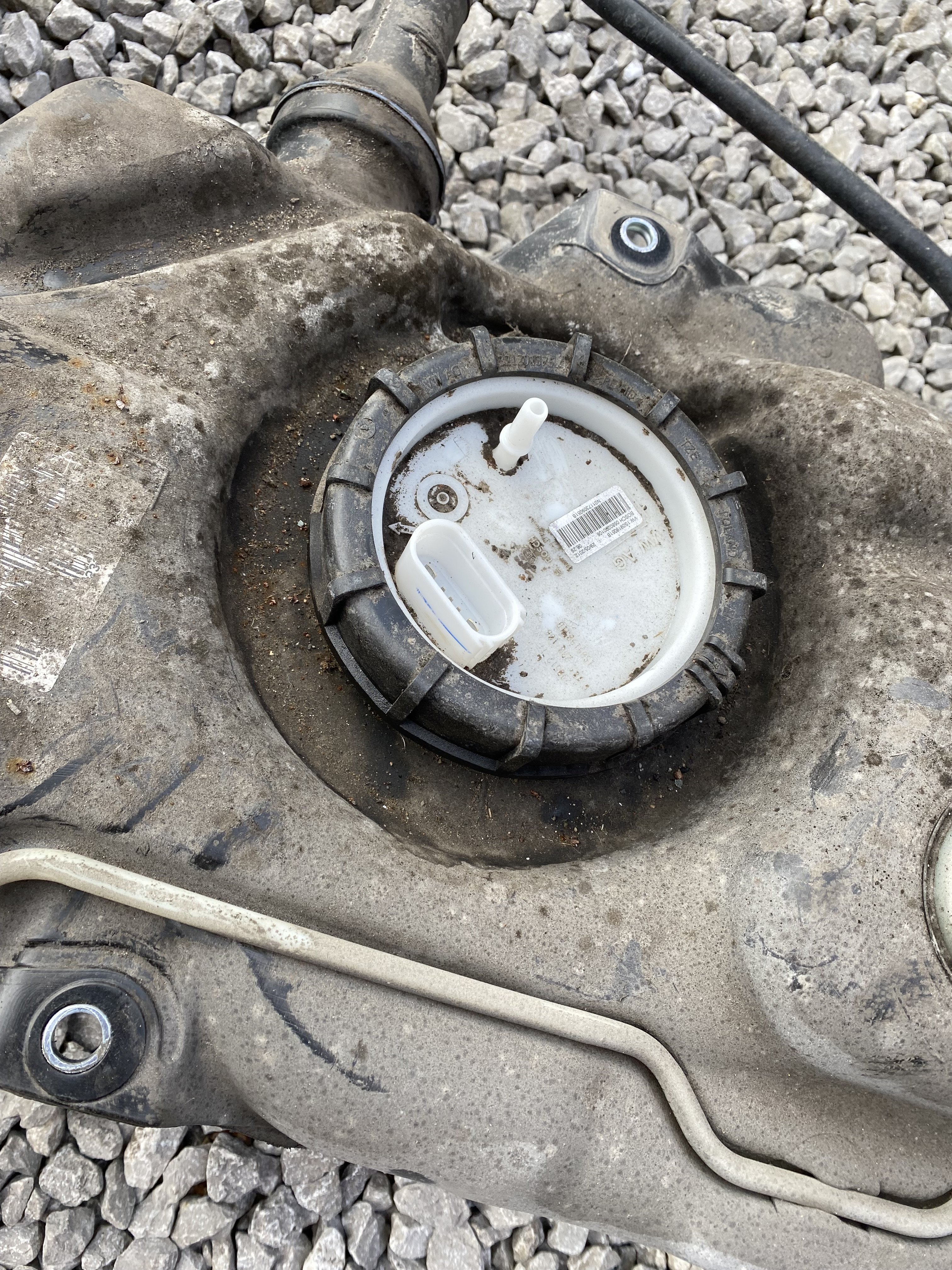

I changed the fuel tank for a later facelift tank and a new gti fuel pump as ever since I did the conversion I had a fuel pump error code as i was using the original car head and internals from the gti pump and even though it caused me no issues, I didn’t want anything to crop up when it’s eventually remapped.

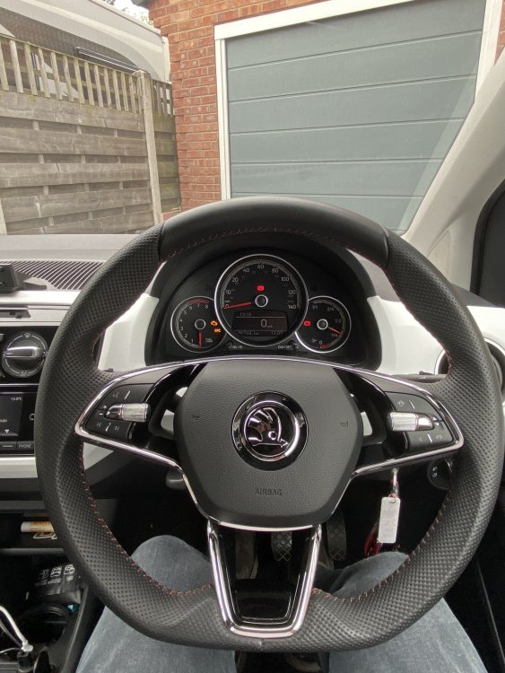

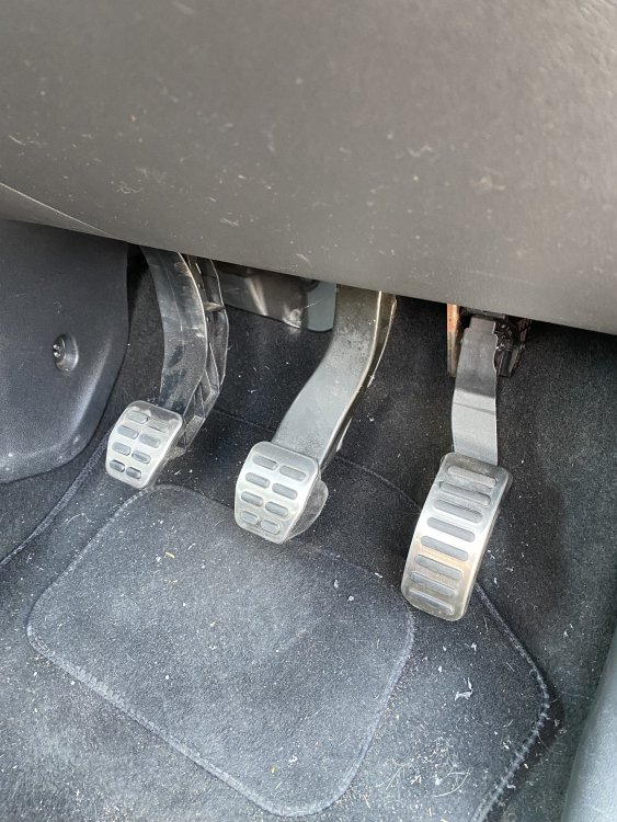

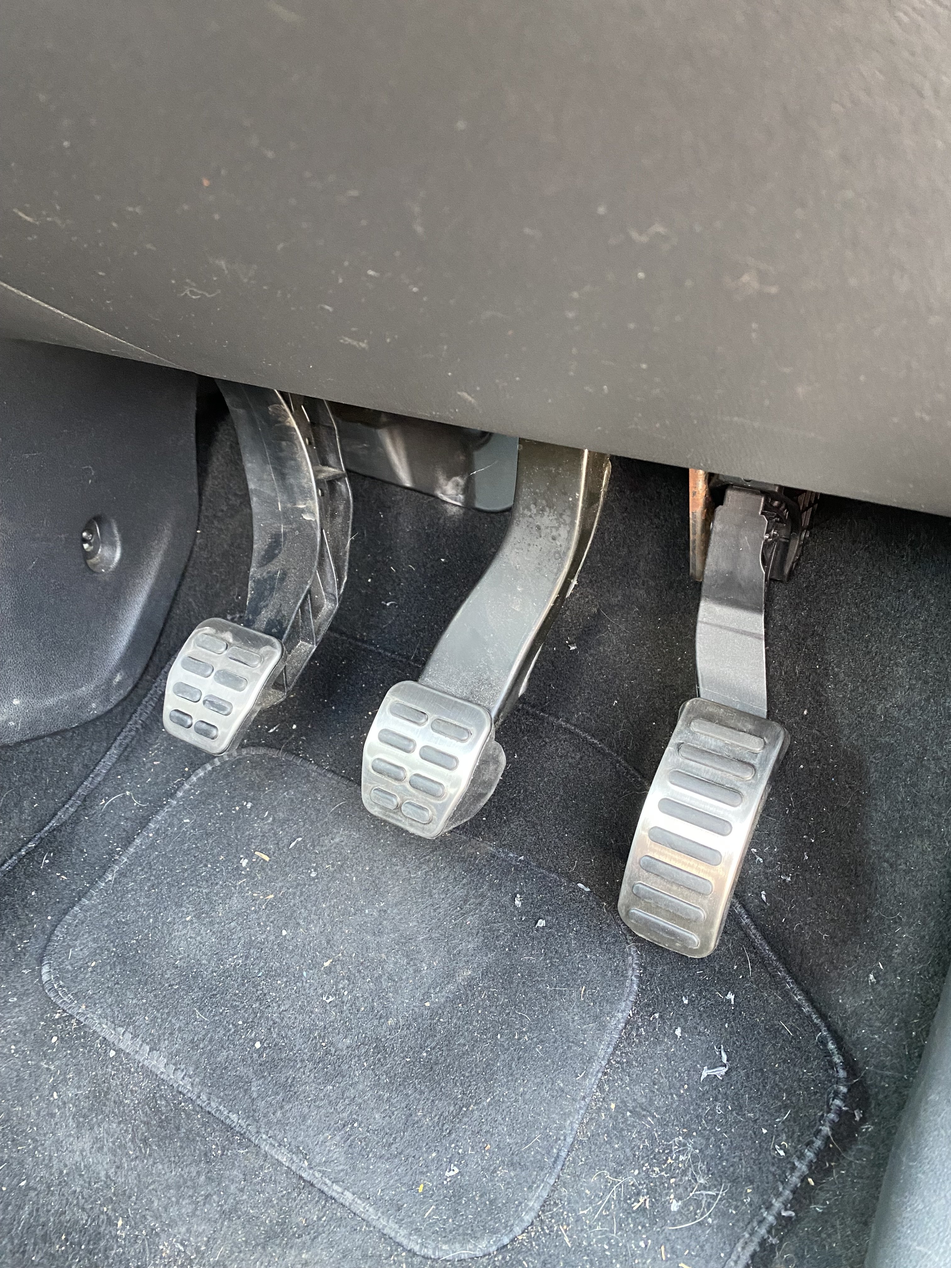

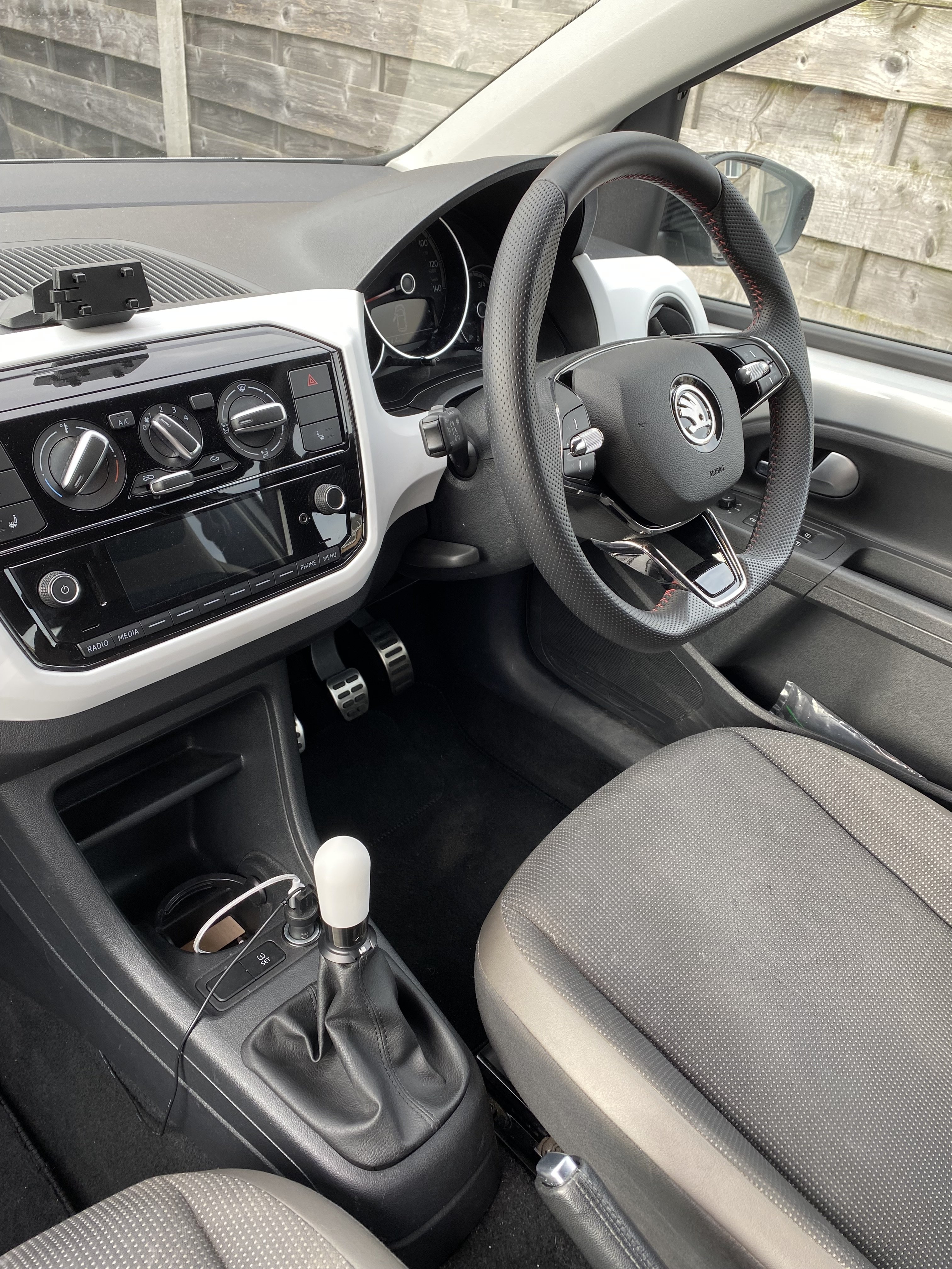

Mk4 Fabia Monte Carlo steering wheel fitted and stainless pedals, just waiting on a new gear knob and interiors pretty much how I want.

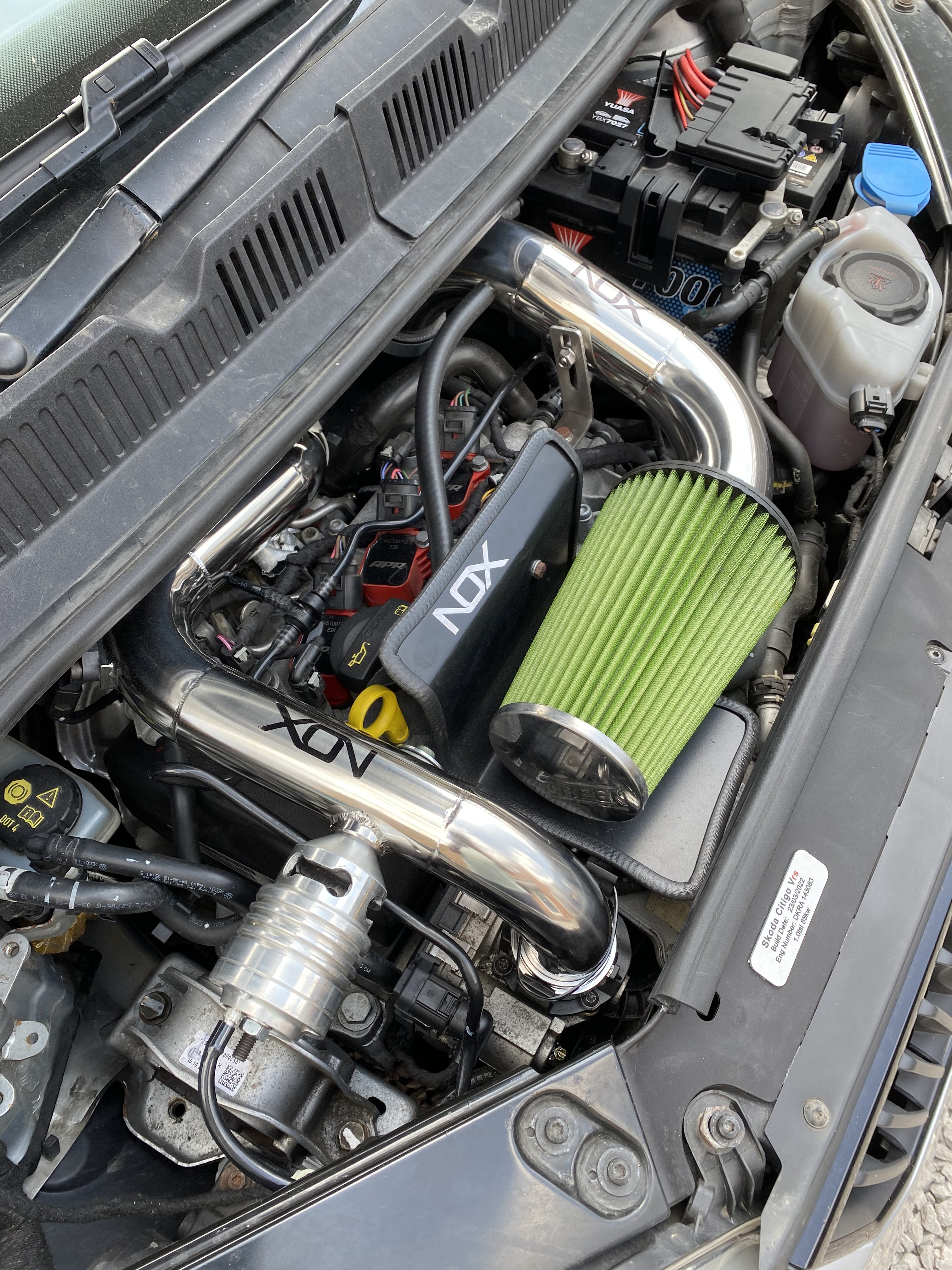

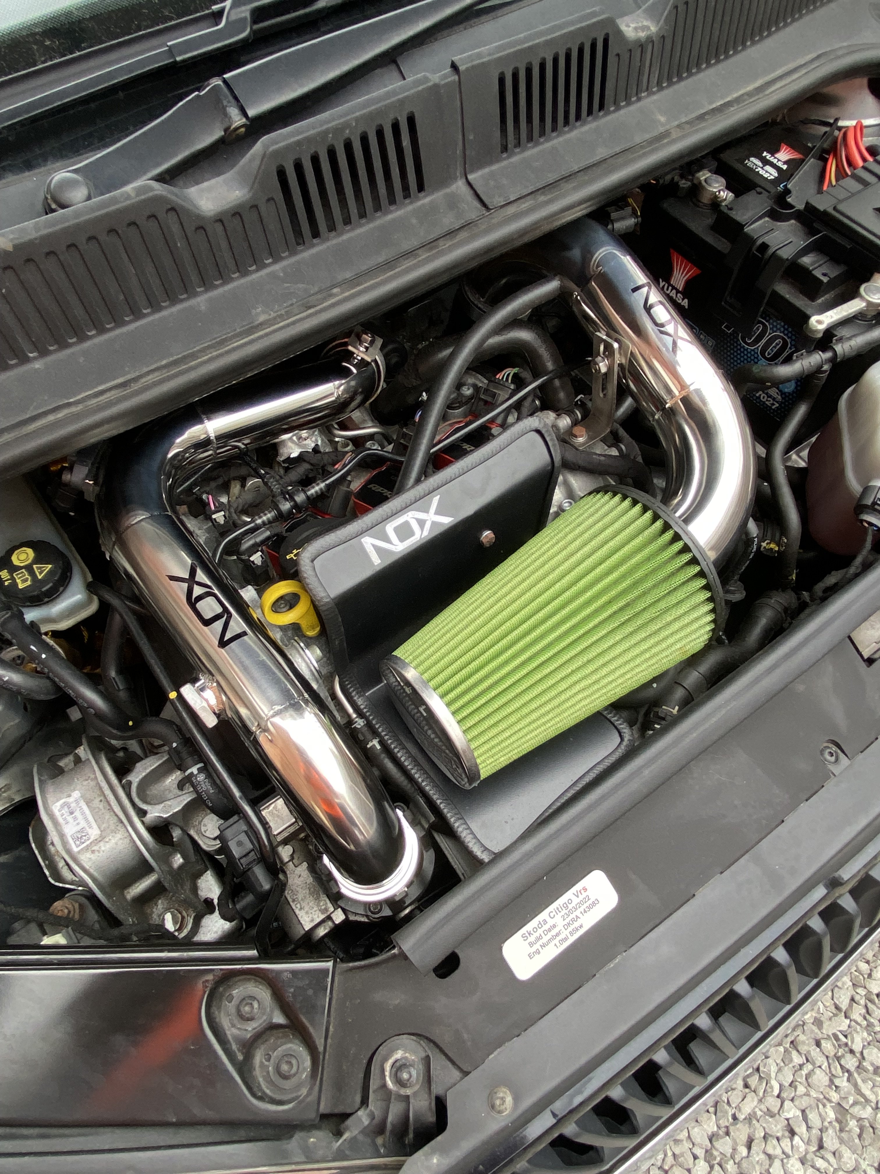

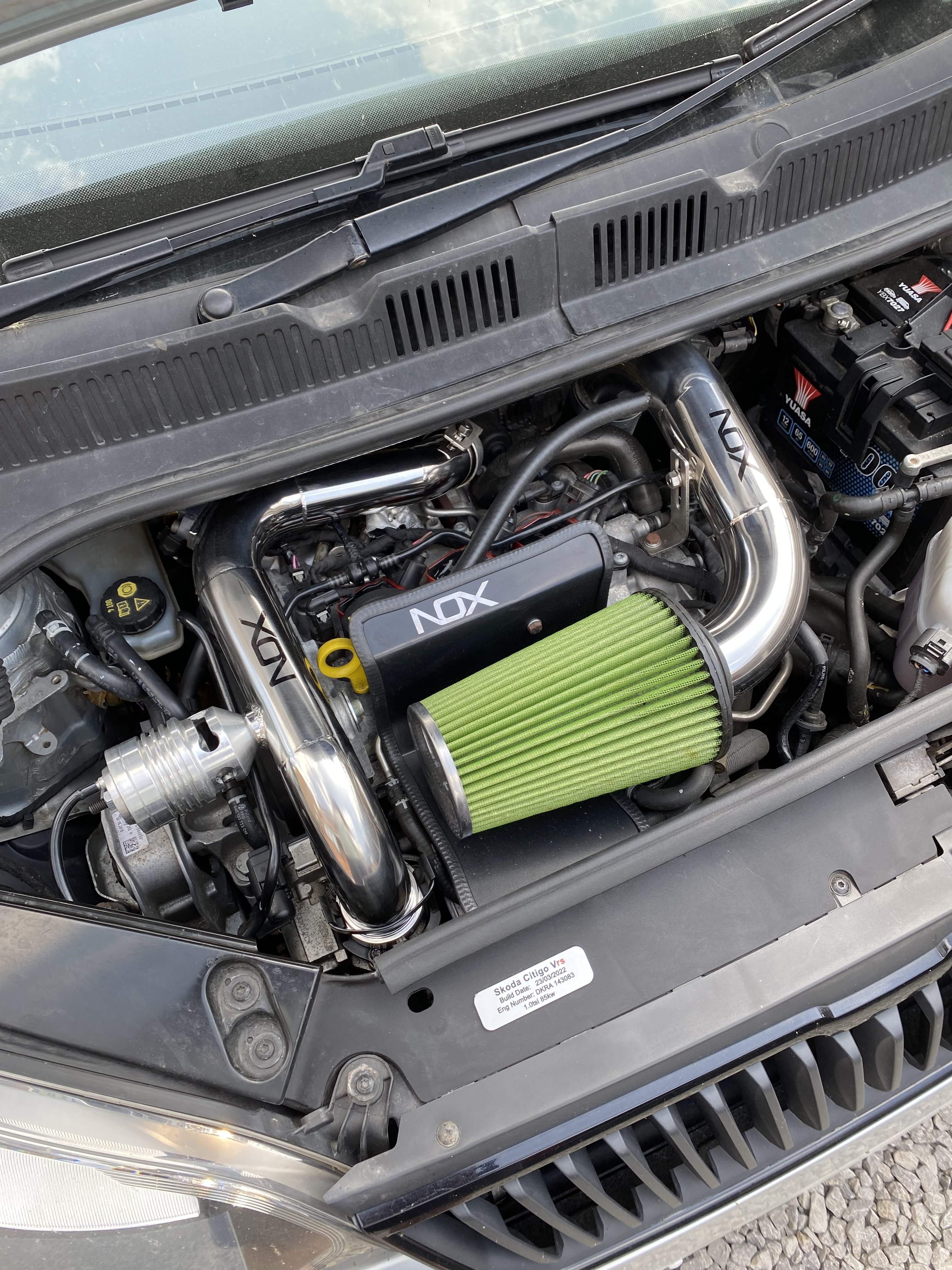

Also fitted another Brazilian part I imported which is a stainless charge pipe and dv, although you can choose to blank of the dv which is how I’m running it currently.
It’s so comfy on 15” with the oem suspension 😁
Some pictures!!

Got bored so thought I’d see how the dv looks and sounds. There’s a clip on my Instagram @citigovrs for sound as it’s abit of a big file to fit on here

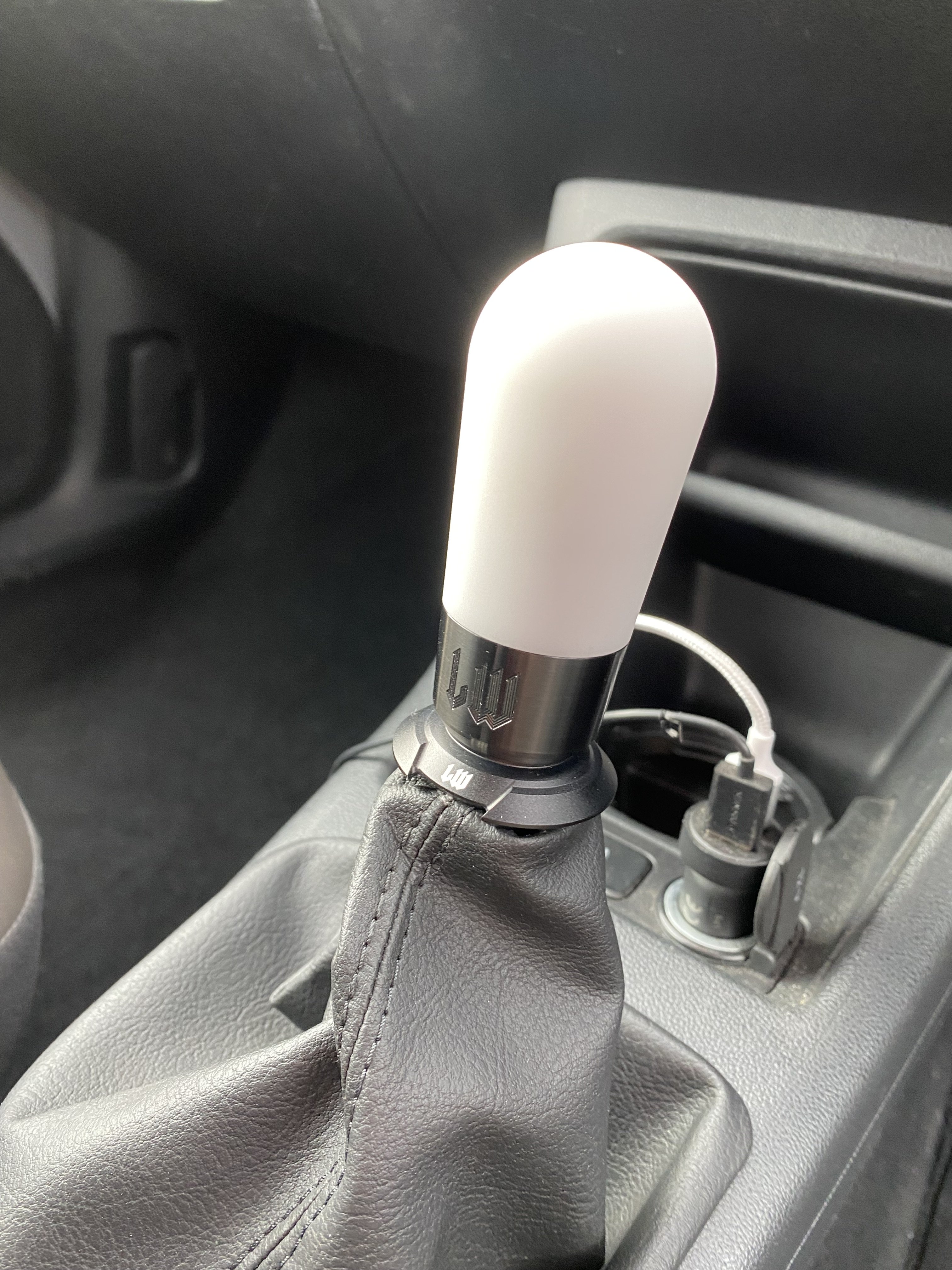

New GearKnob to match the dash

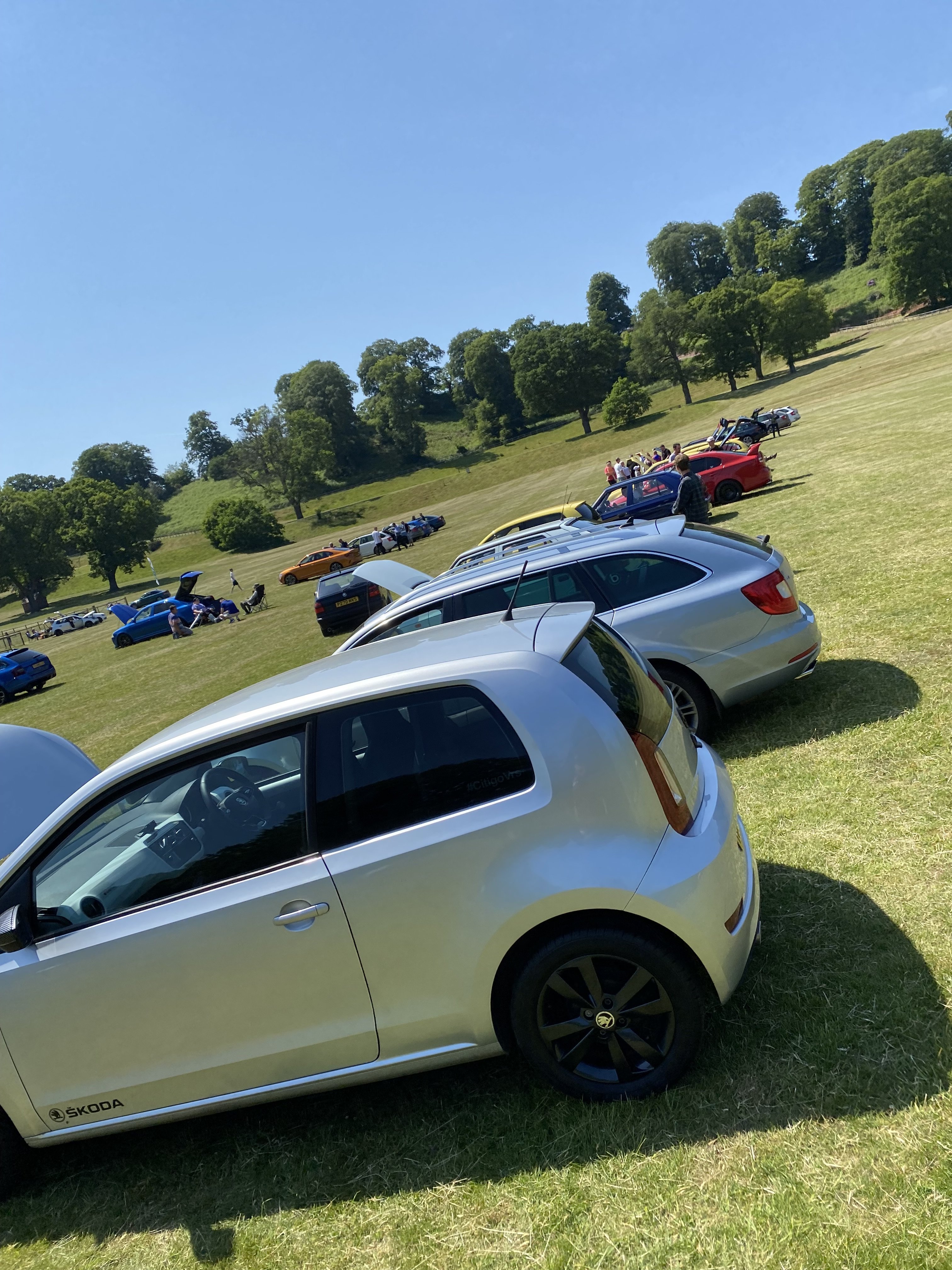

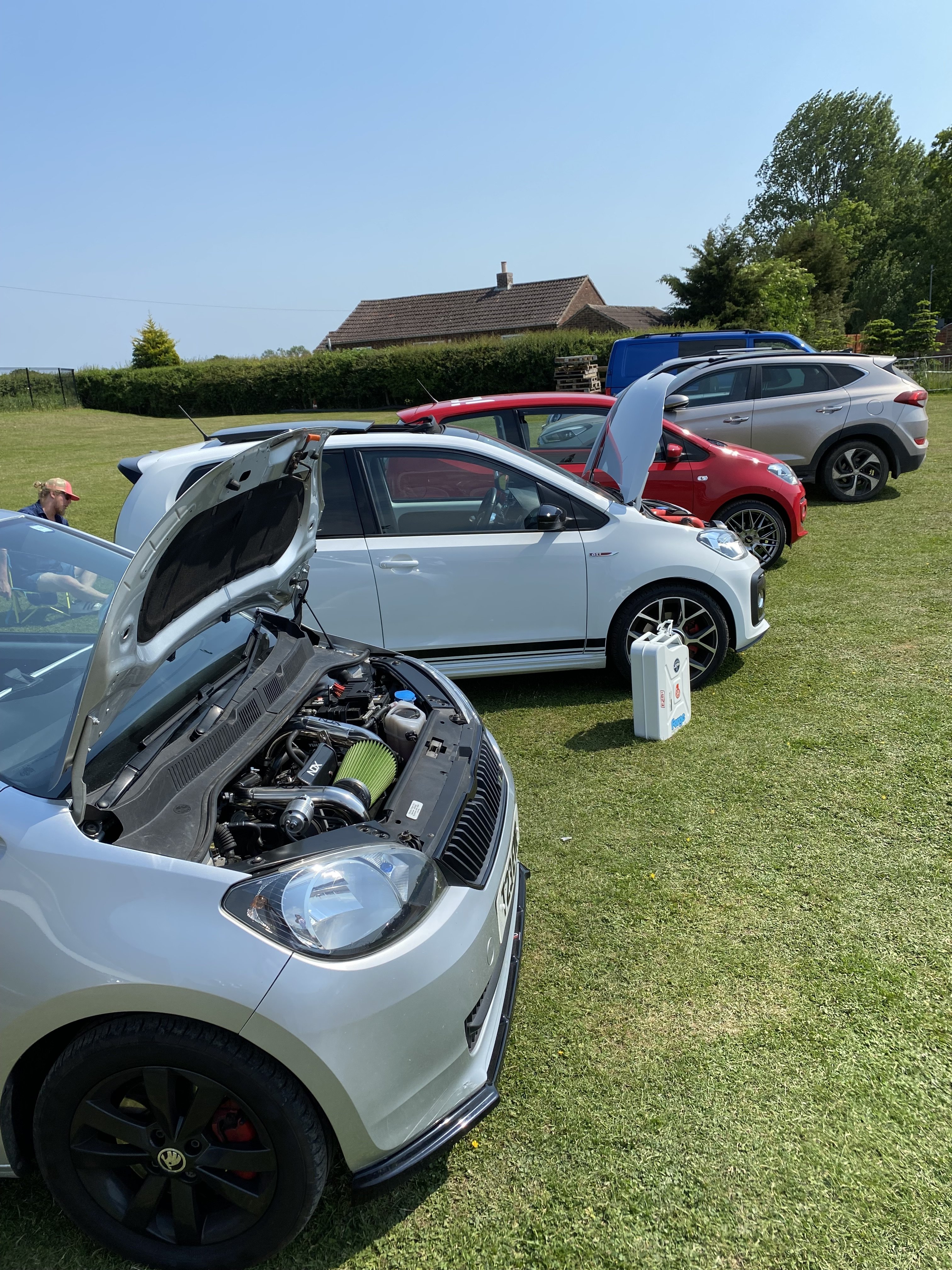

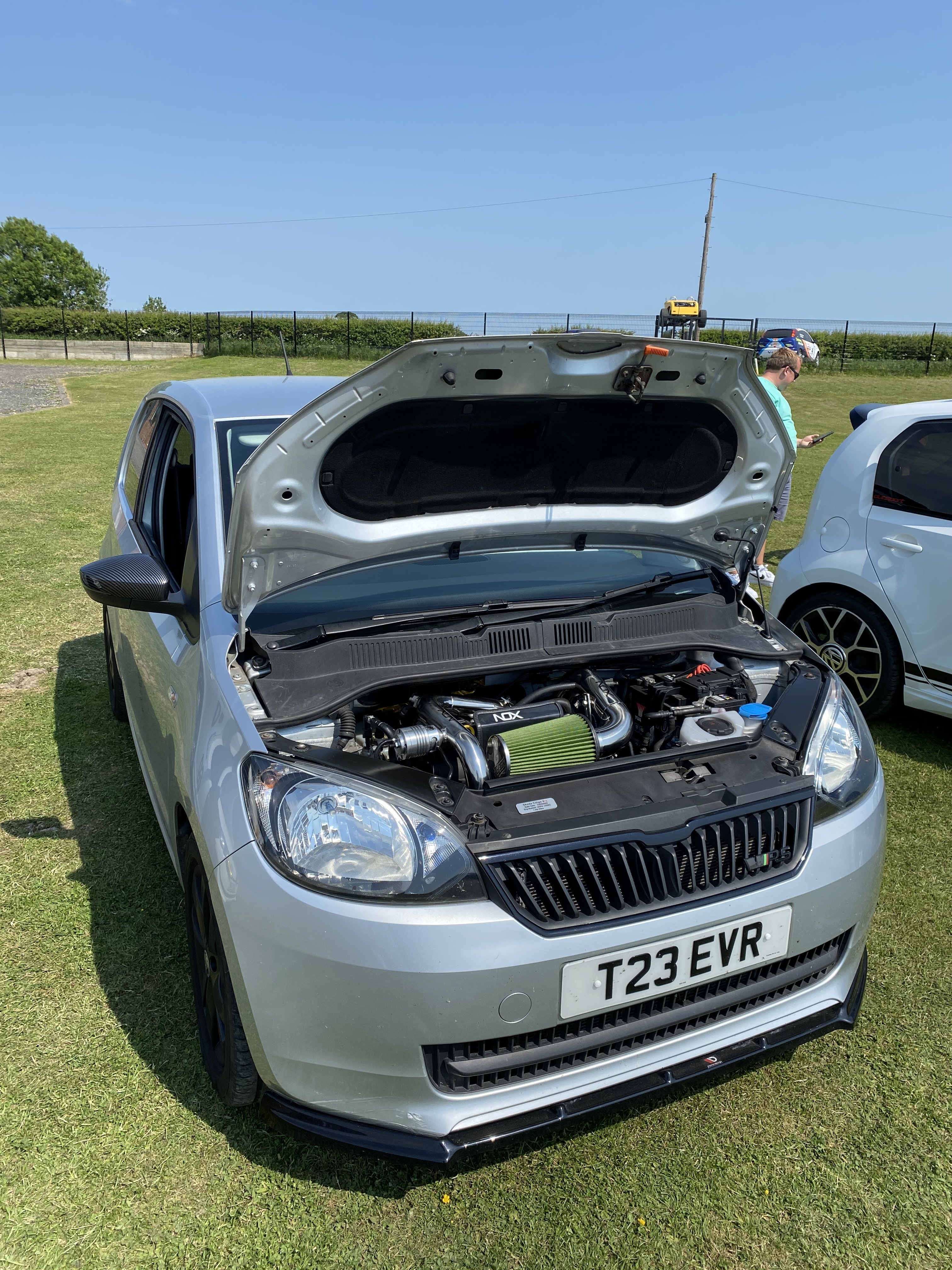

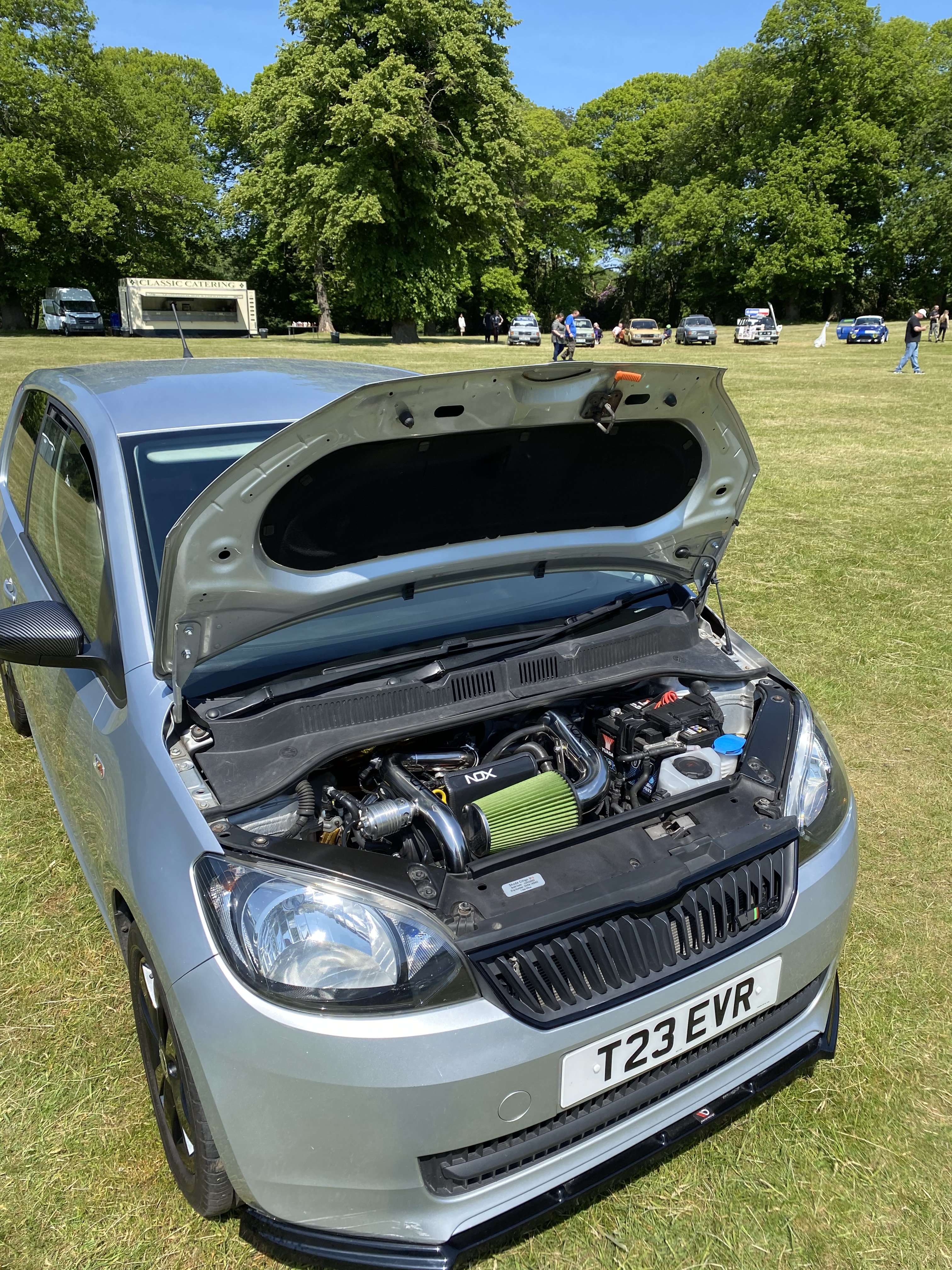

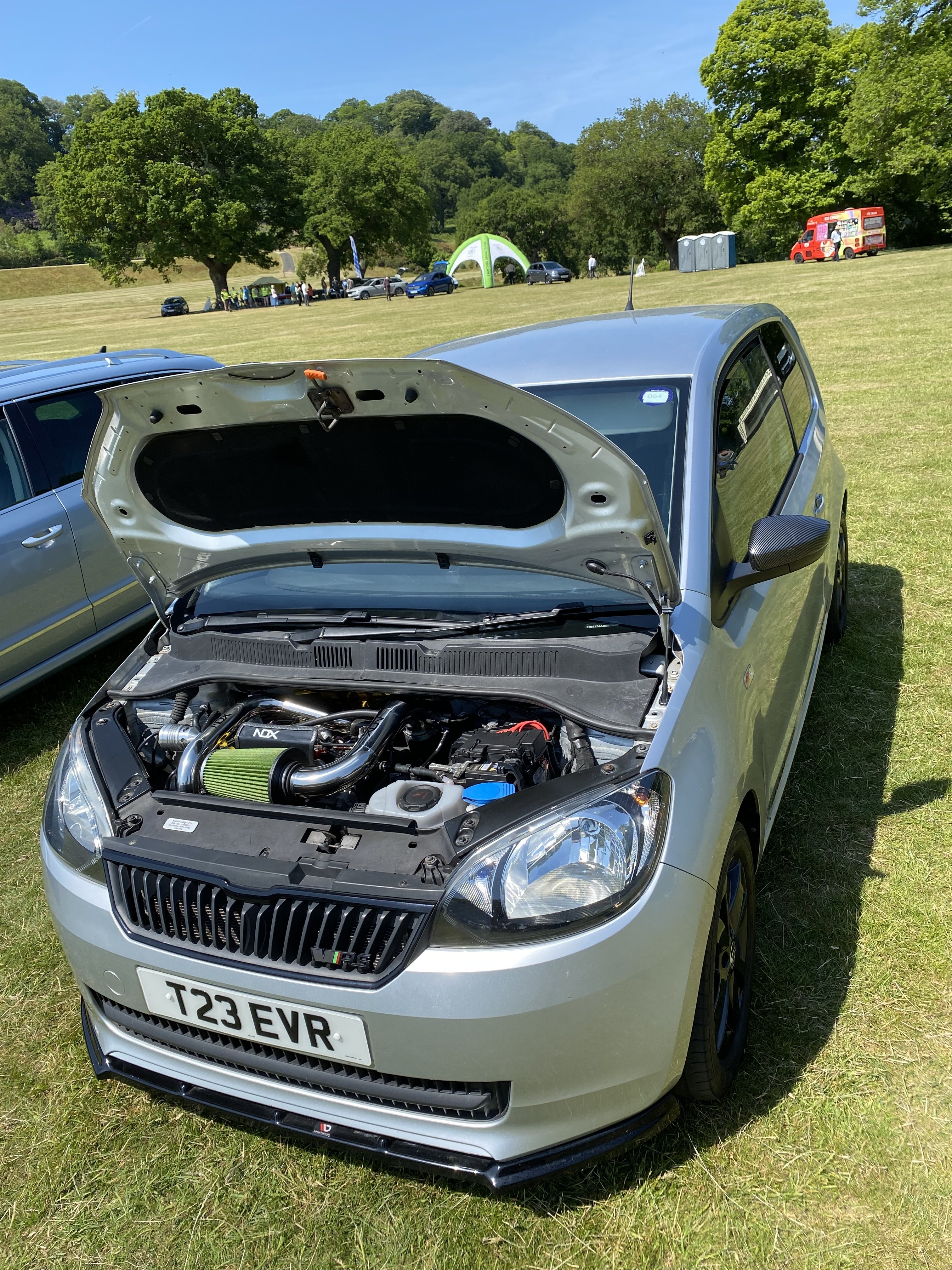

Trip to Skodafest last Sunday little 6hr round trip, only two citigos there.
First proper show with it had some great comments mainly what engines that? Haha

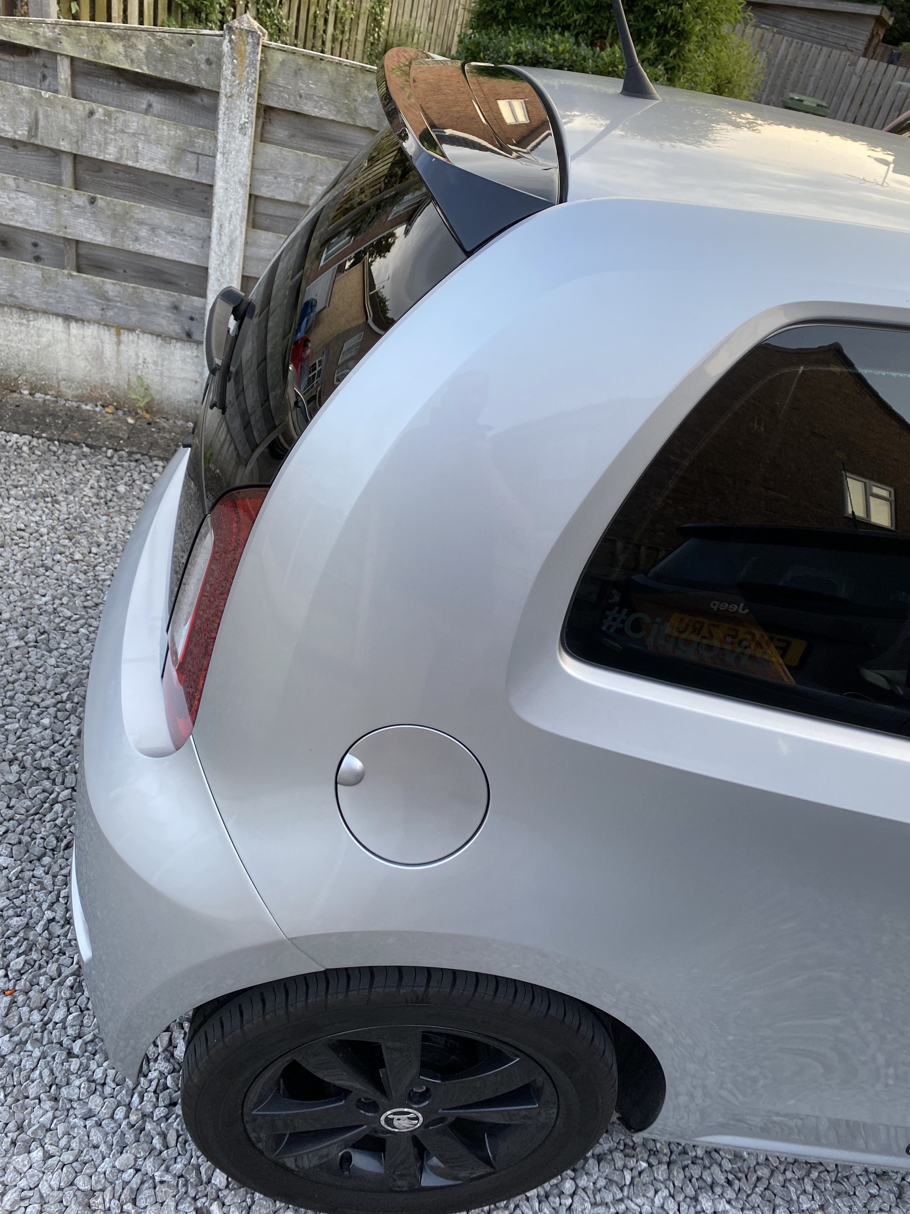

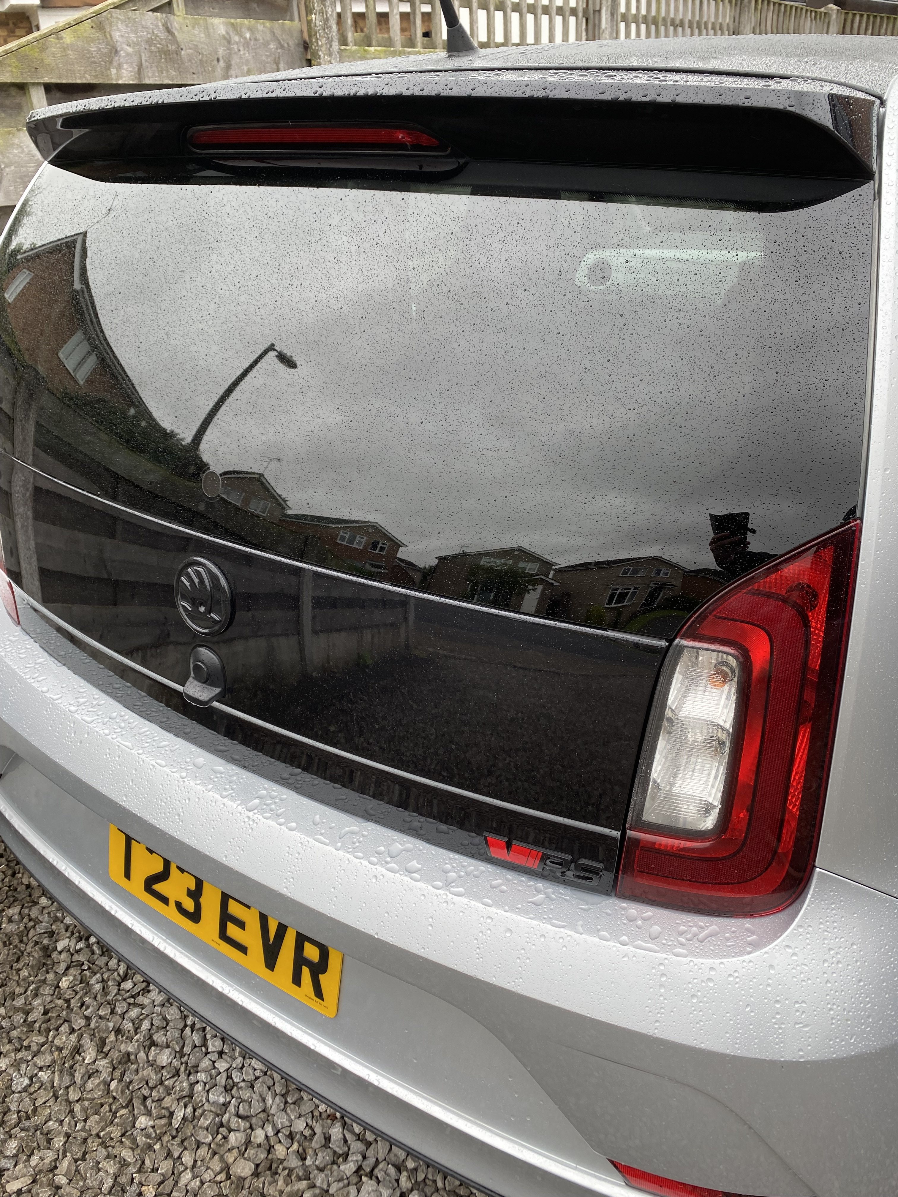

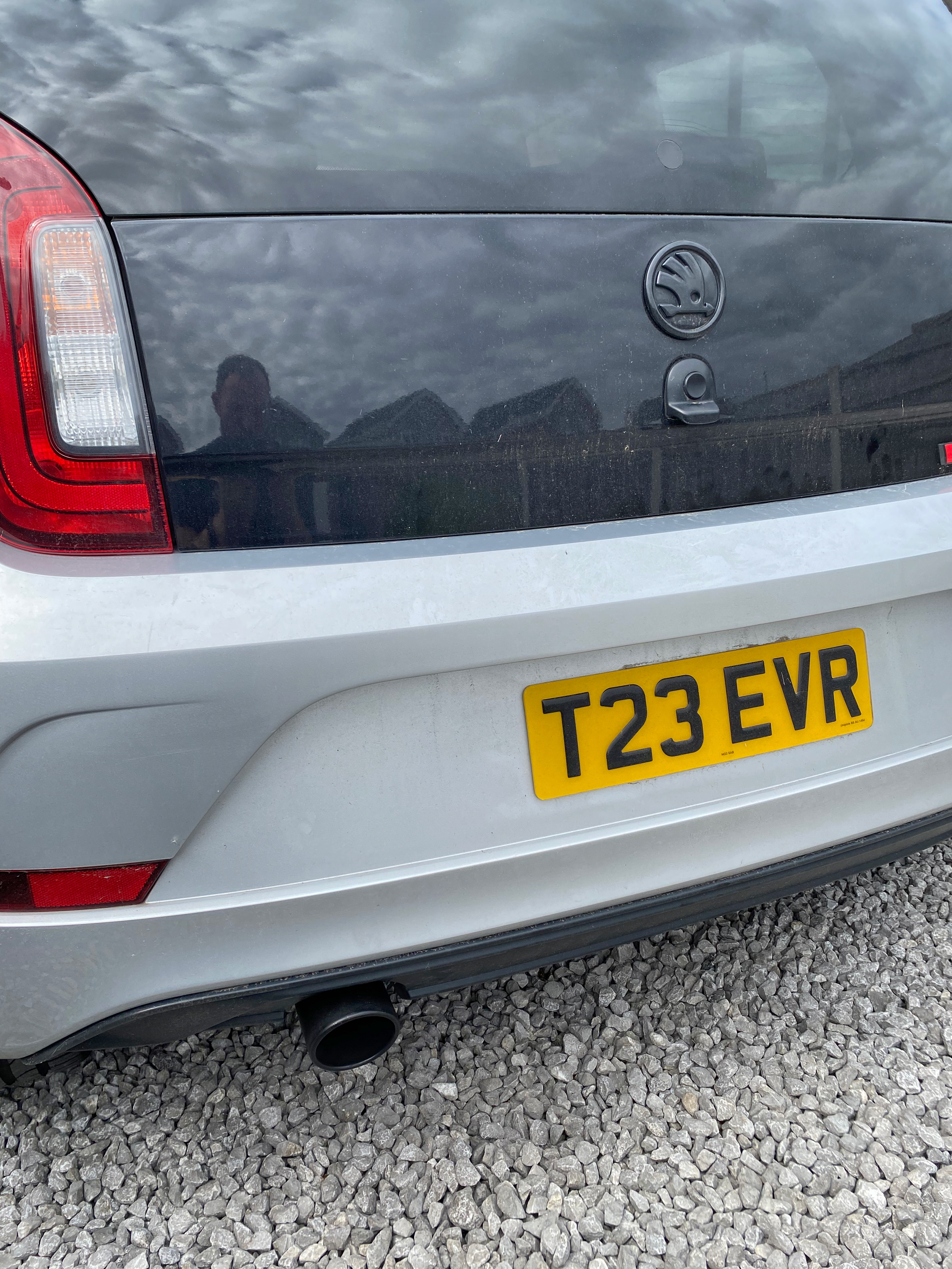

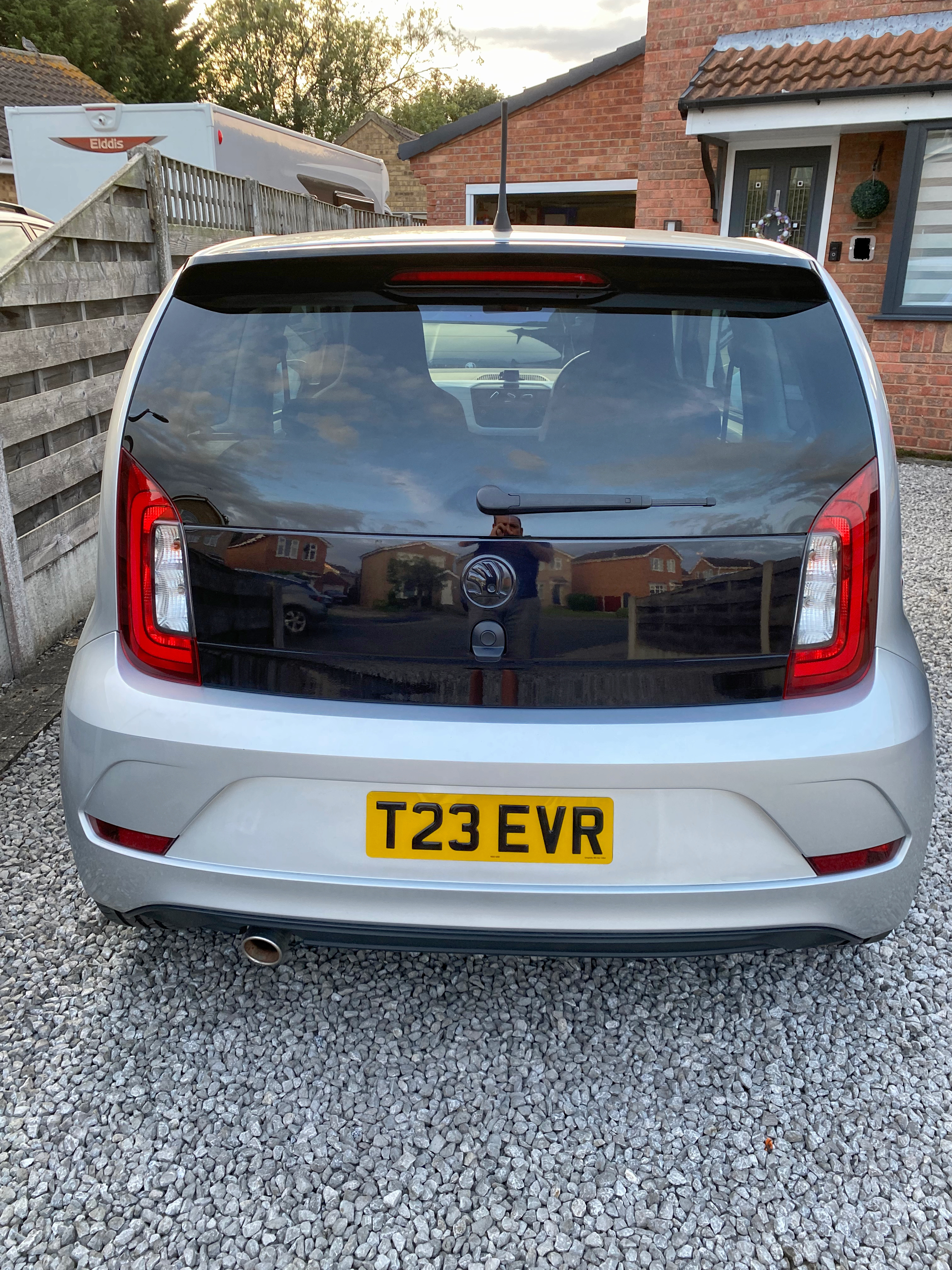

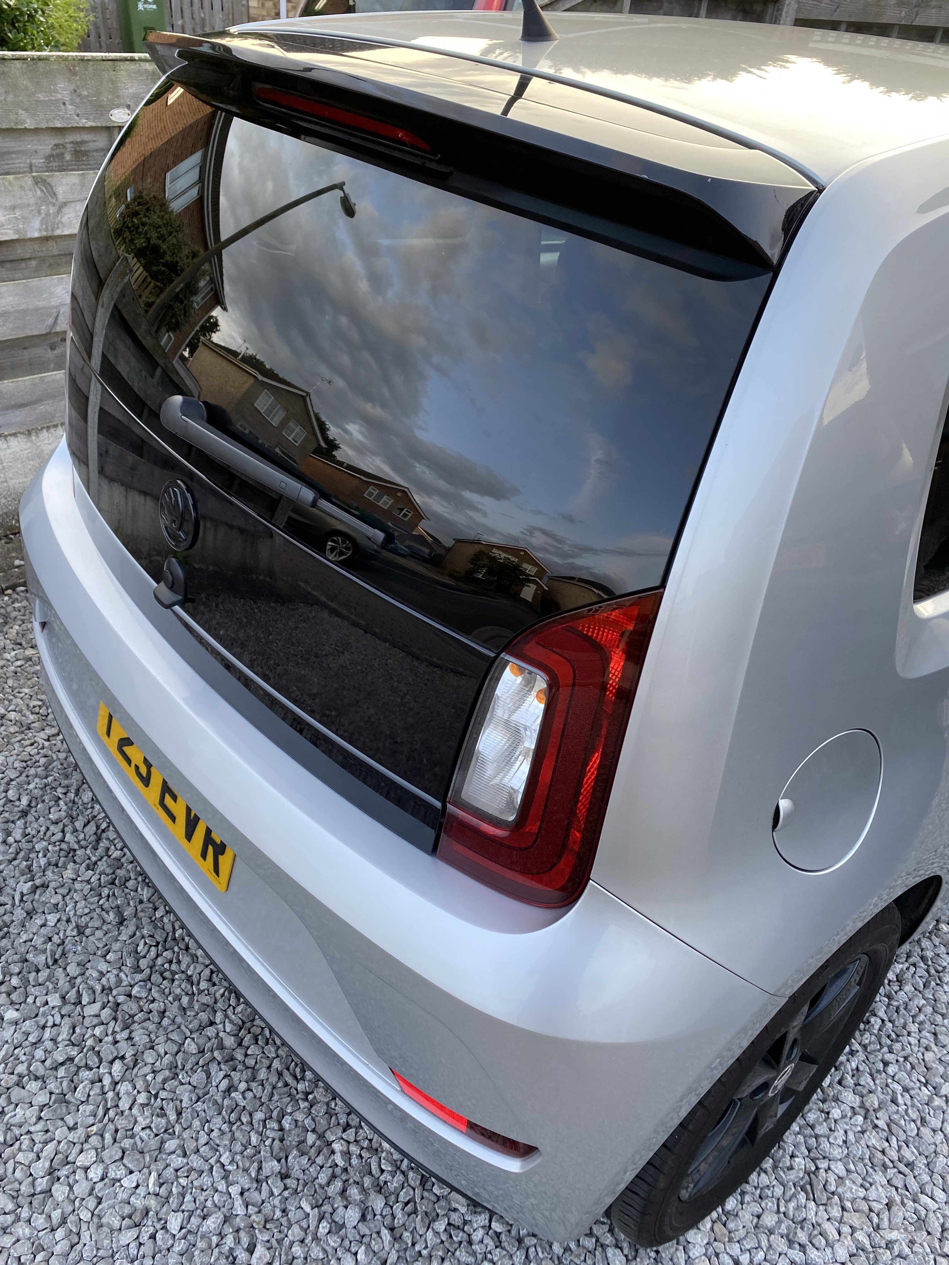

Changed the bootlid to a Black Monte Carlo one so I gained factory tint and the little spoiler, de stickered it as it didn’t really go with rest of car.  Swapped the gloss black badge over just going to try and rescue the vrs badge and take wiper off too at some point
Edited by TrevorB33

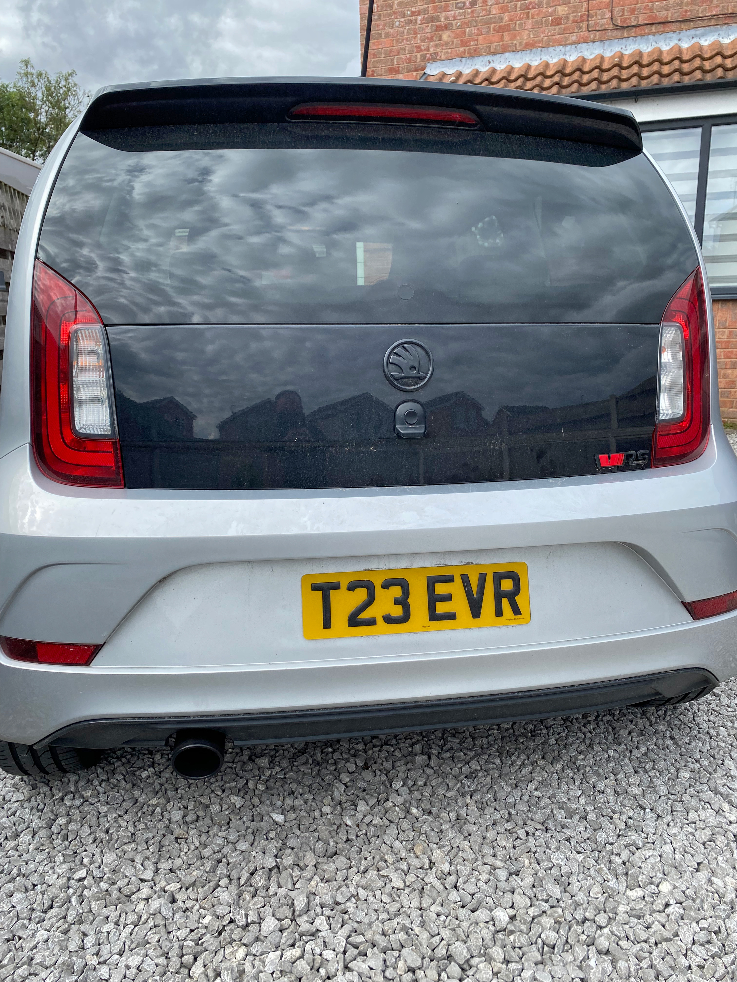

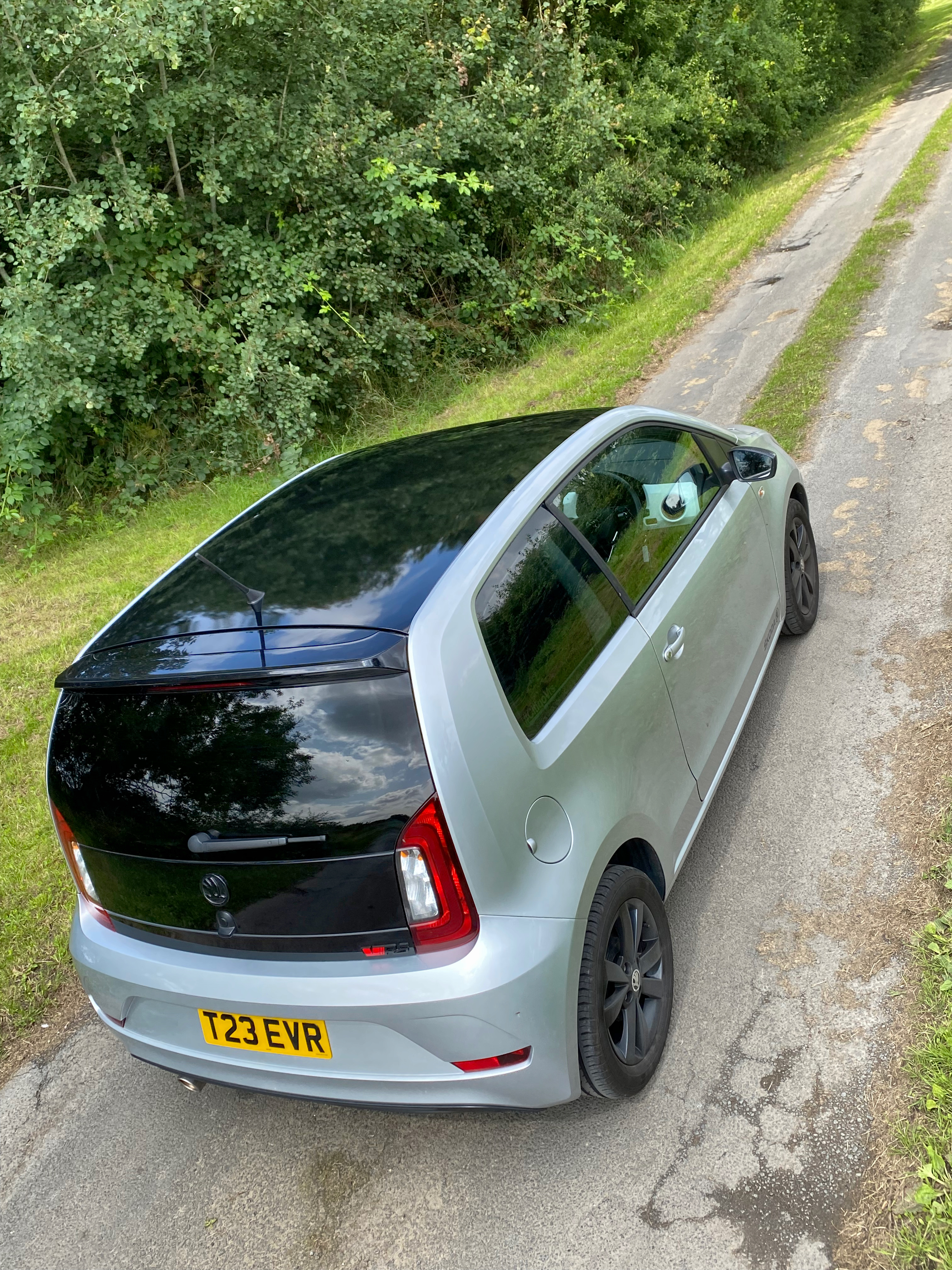

Dewipered the rear again

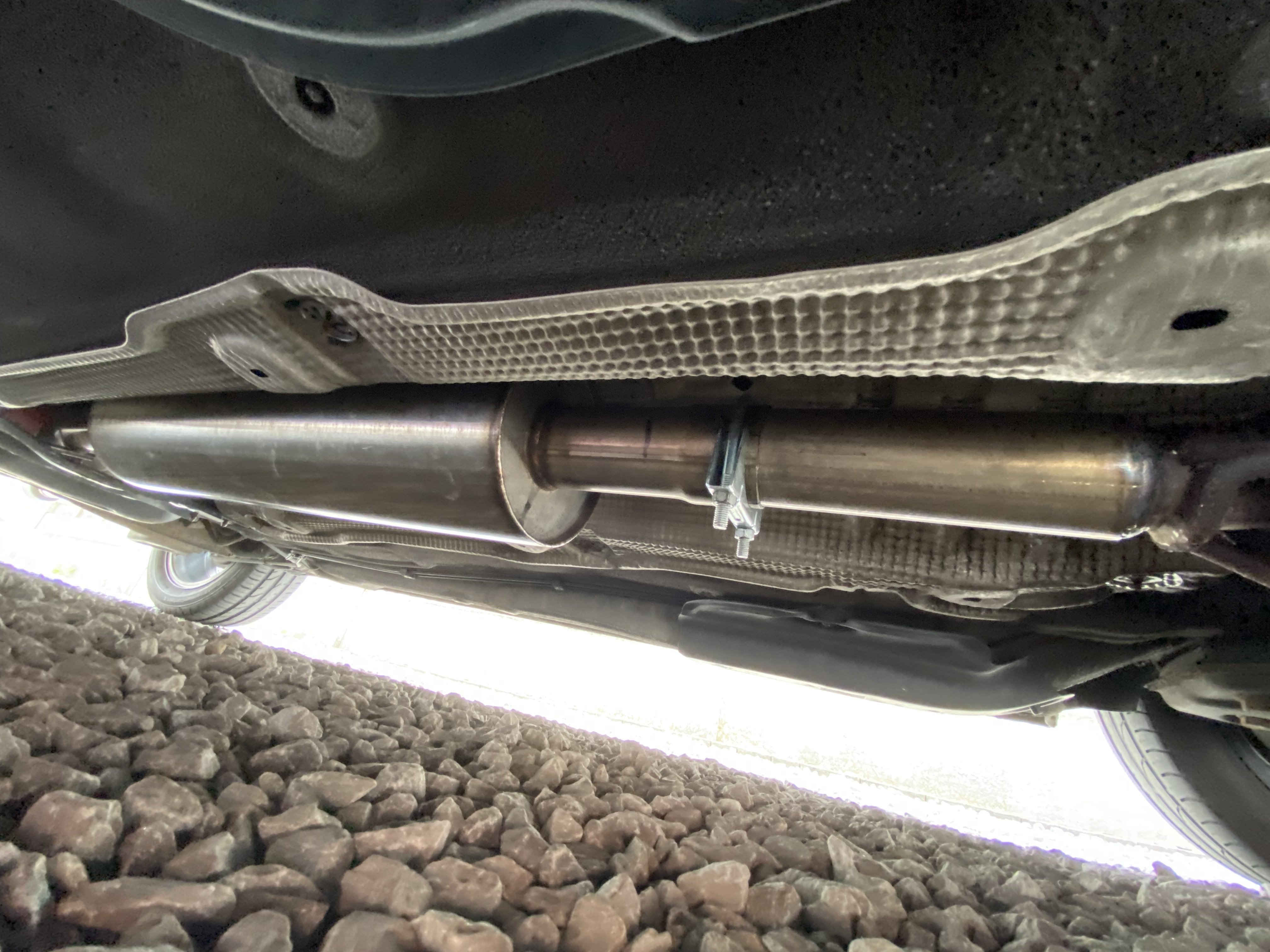

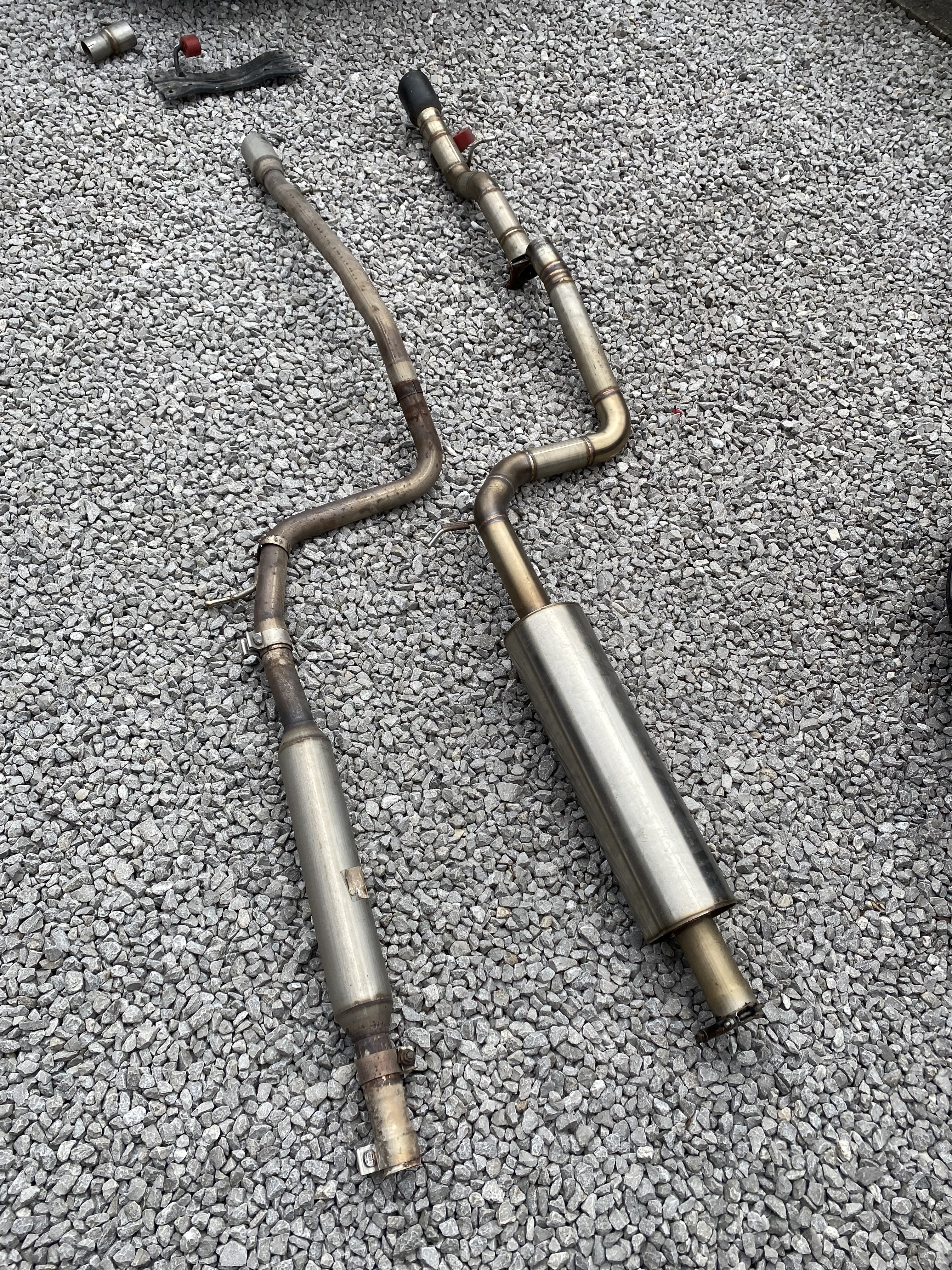

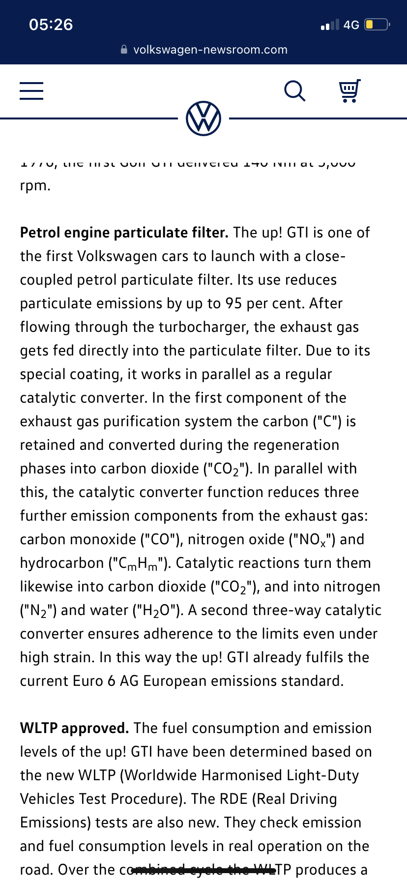

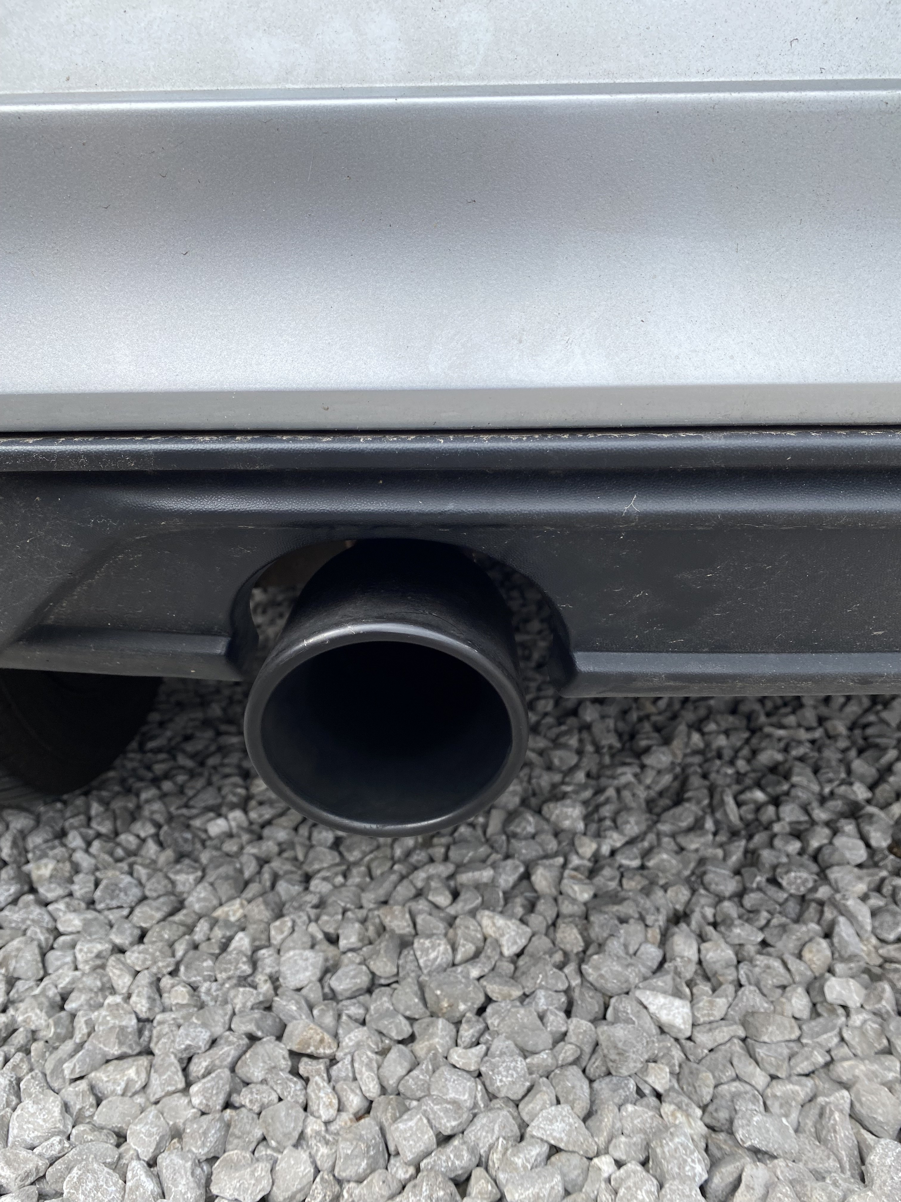

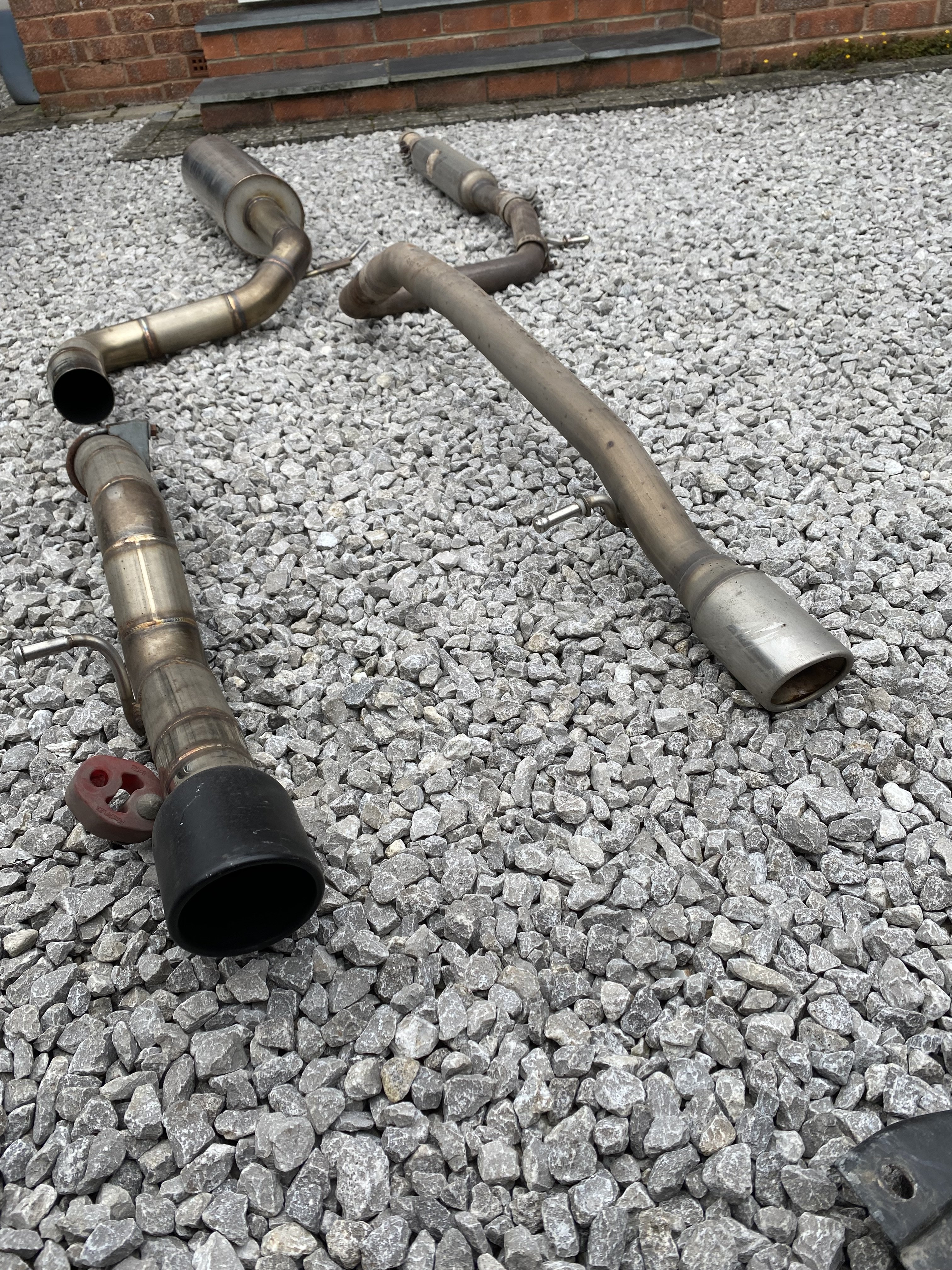

New exhaust went on yesterday, a custom 2 1/4 inch diameter up from the standard 2” all the way from flexi and removed the second cat. Booking in for a remap in two weeks so hoping for high 140’s on 99ron.
Nice and quiet only a tad louder then oem, no drone at all

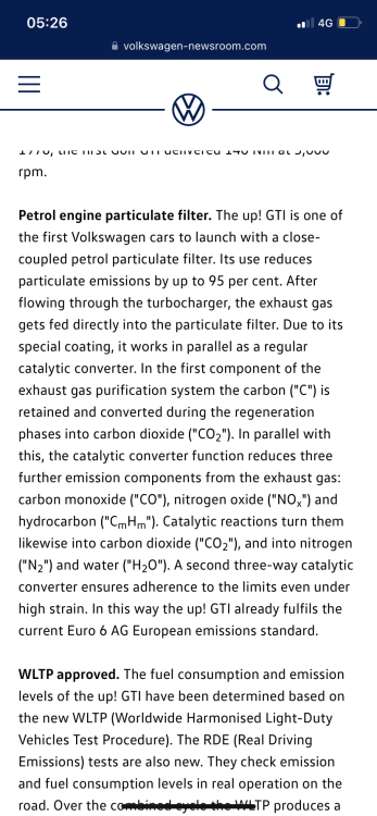

I thought the 2nd cat was the PPF Trev? Or am I wrong? Be good to know if it makes a decent difference removing it, might have to do the same 😂
Not on early ones the opf is combined in the first cat off the turbo, I did quite abit of research and found a technical doc explaining it all, no sensors or anything monitoring the second cat it’s all around the first. I’ll find out when it’s on rollers and what it does on stage 1 map too
