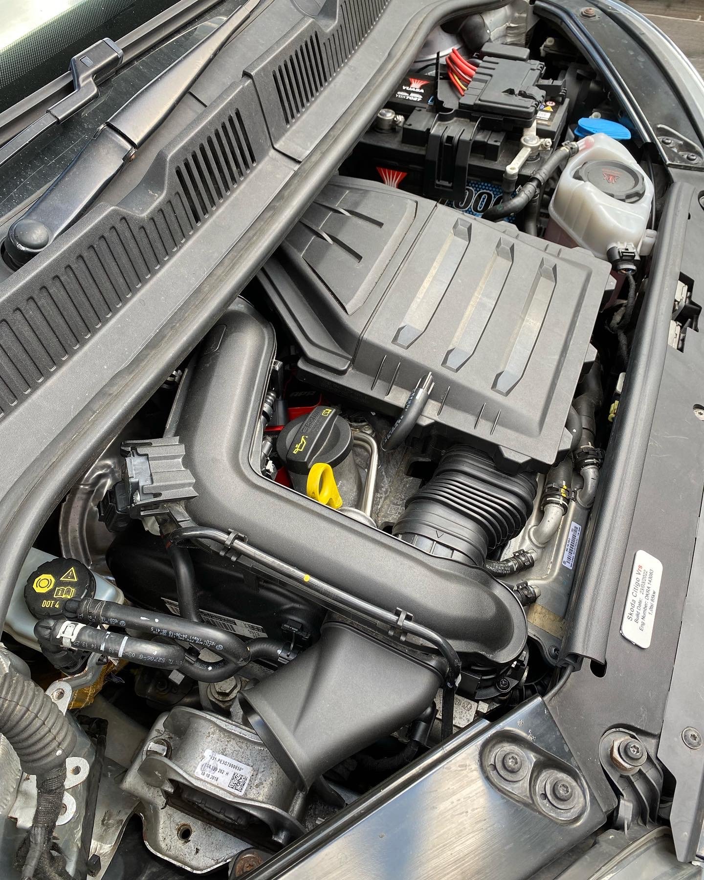

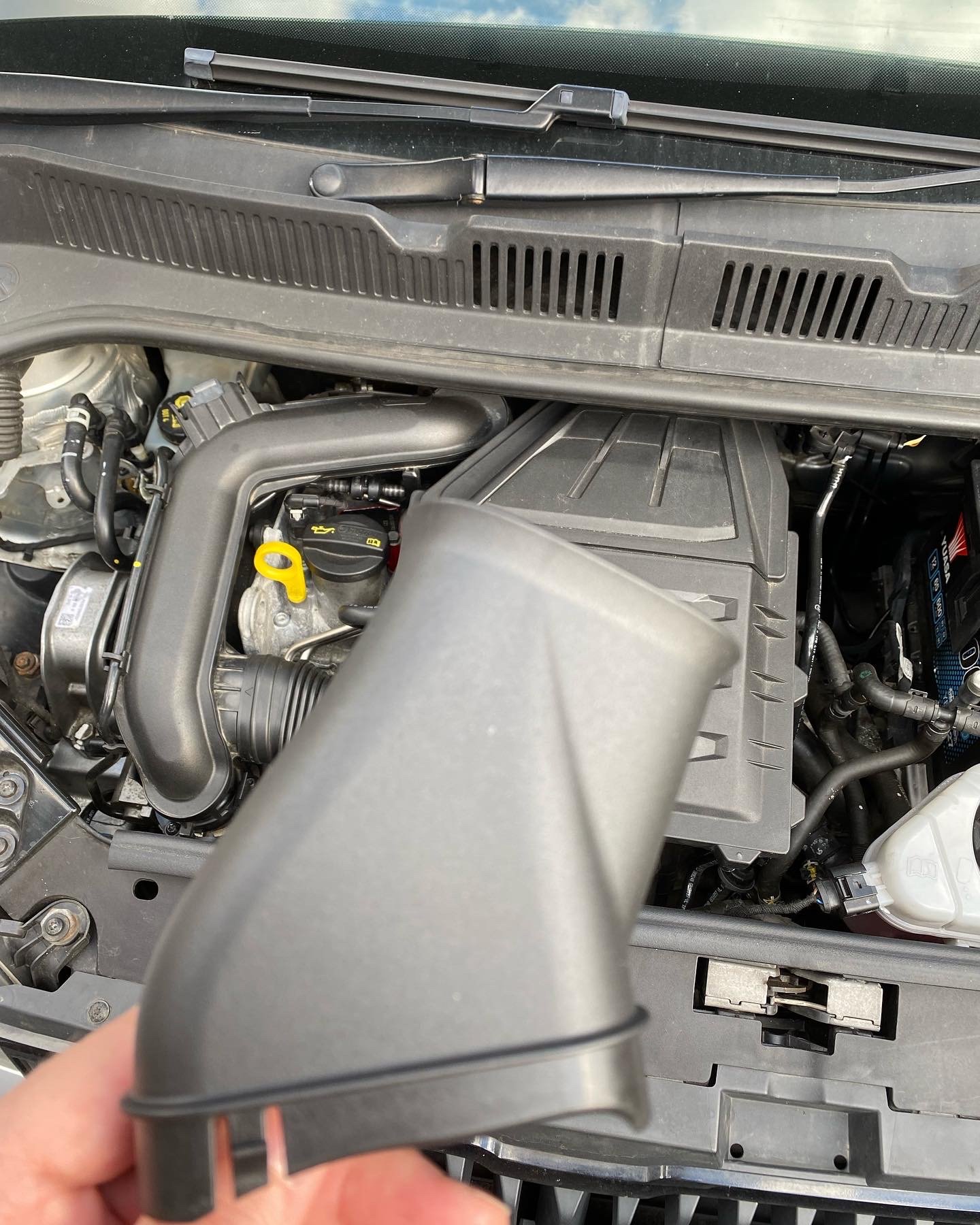

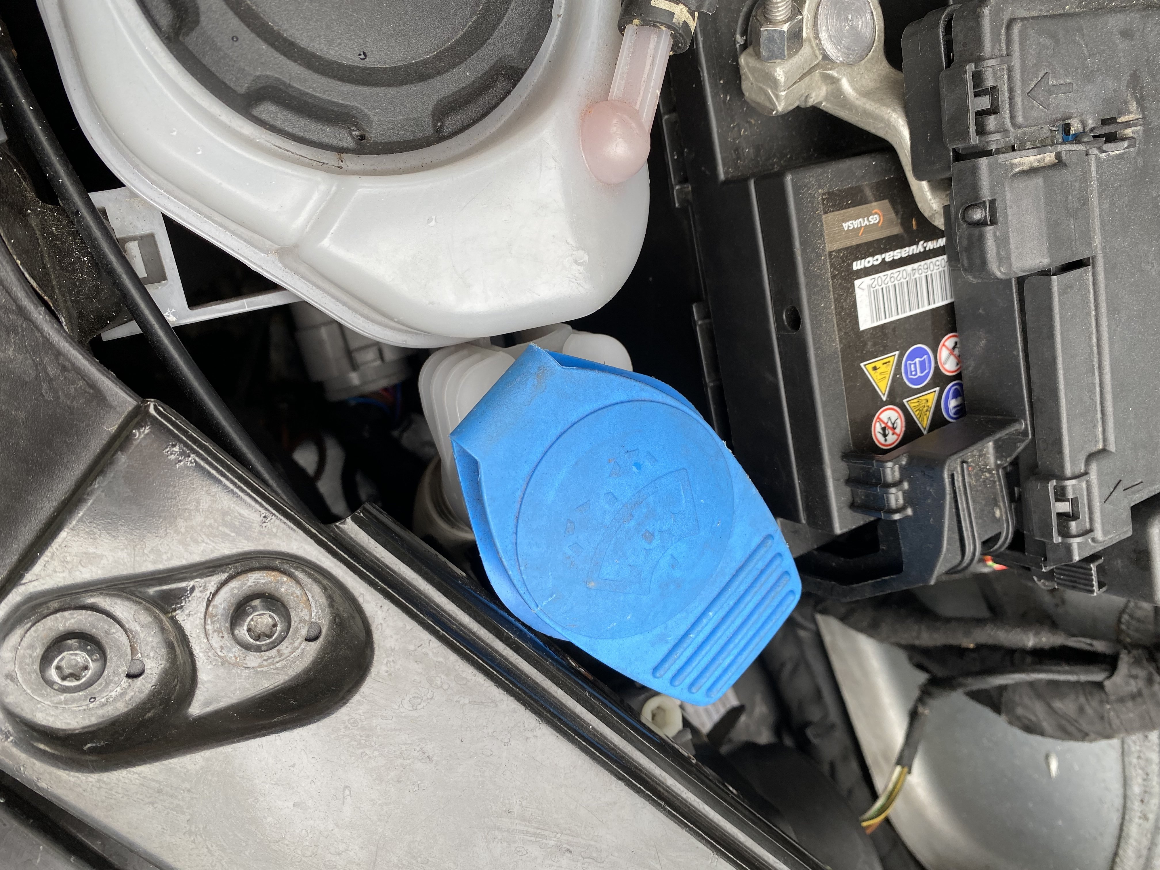

Little update, finally recieved the air intake trumpet that I was missing from the bay, now just a washer bottle top piece to get from vw and the bays done.

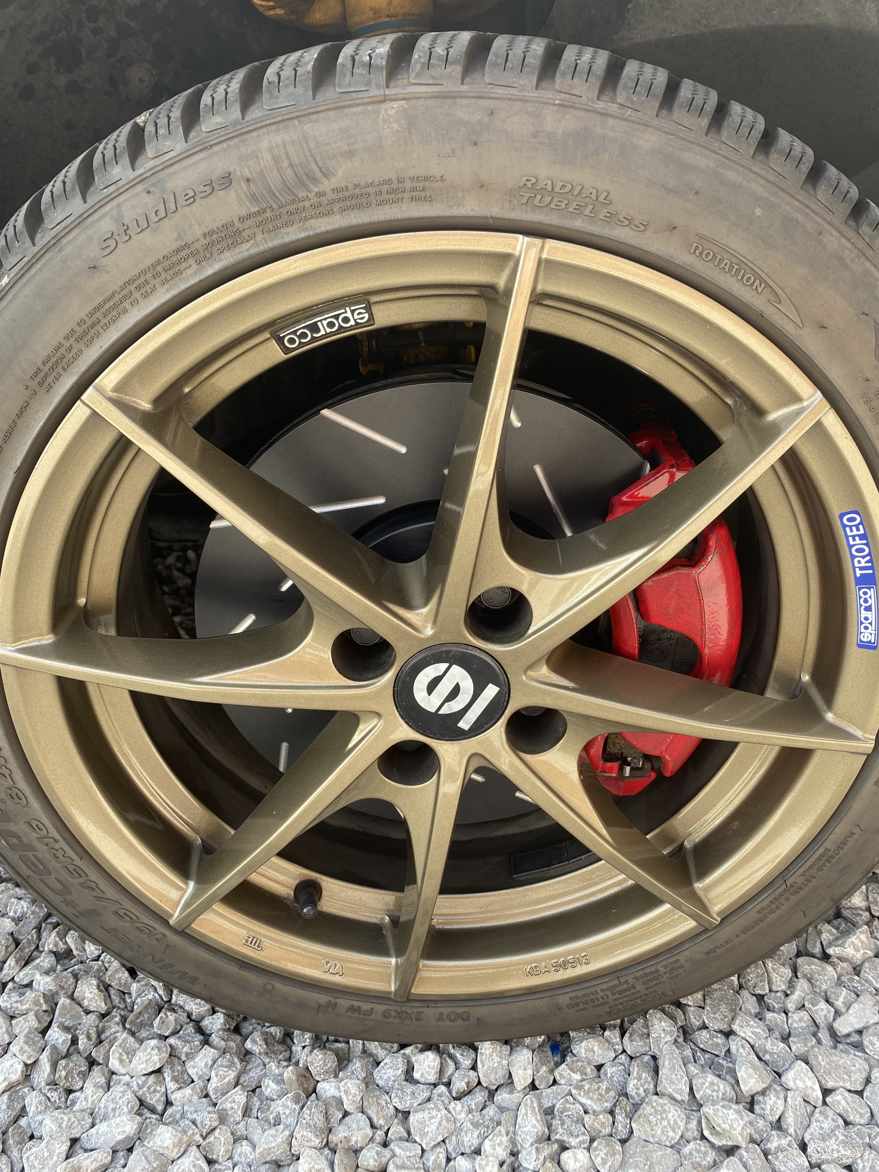

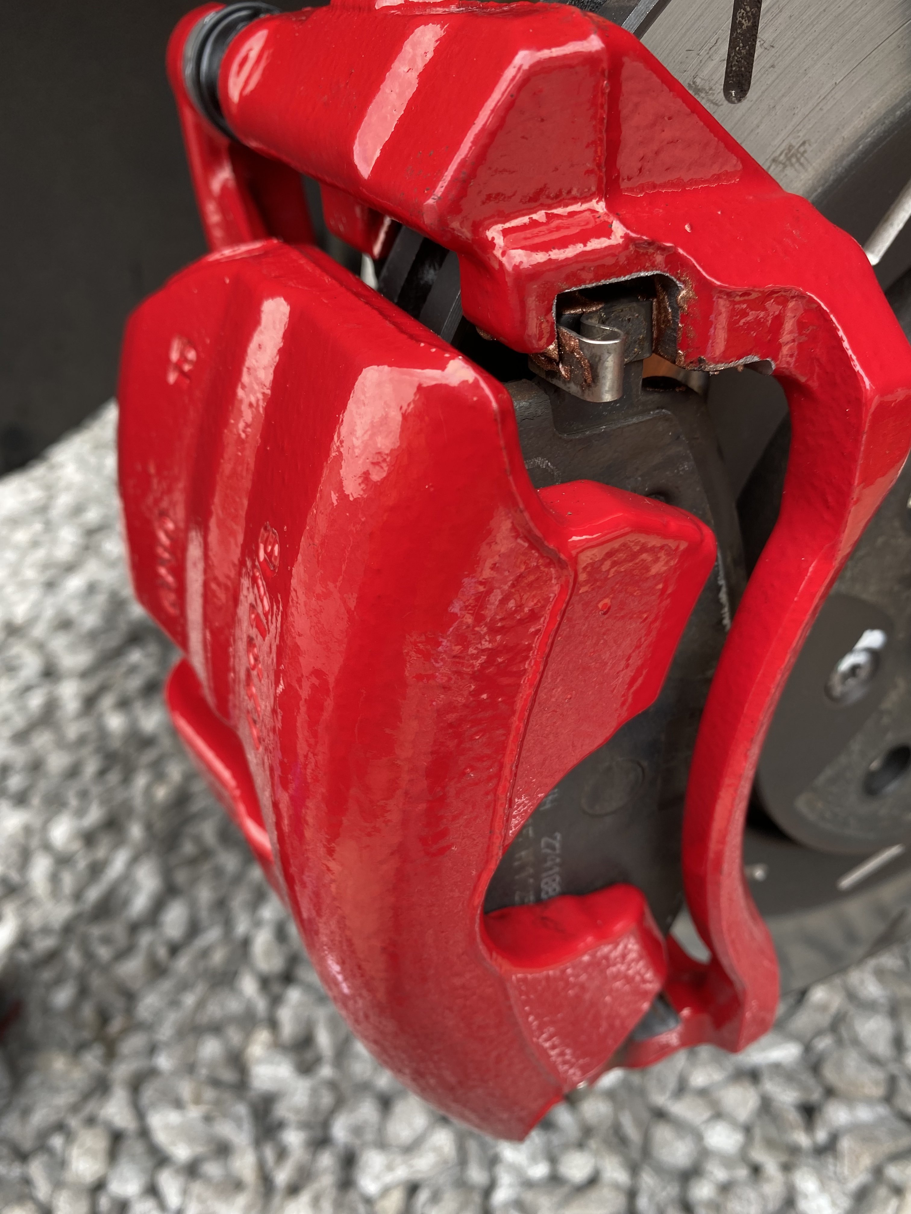

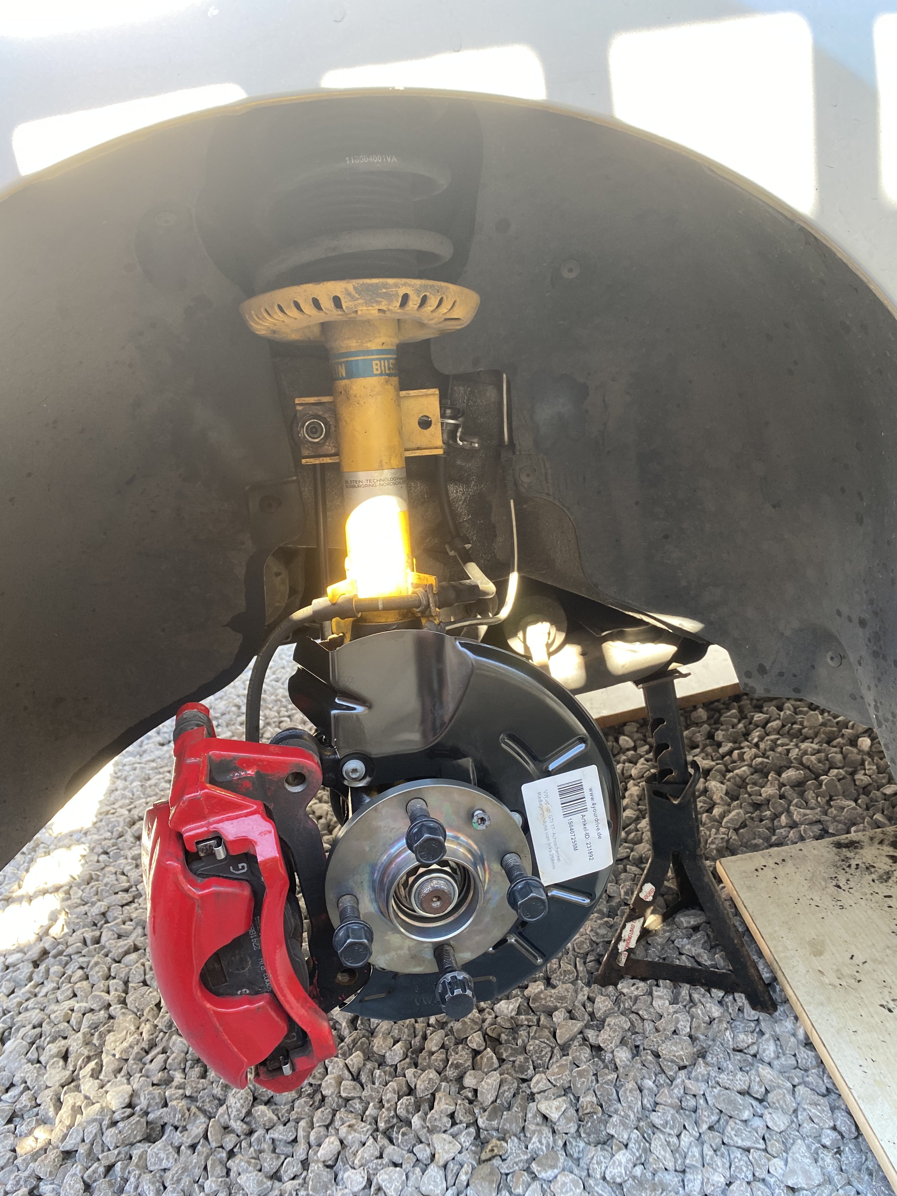

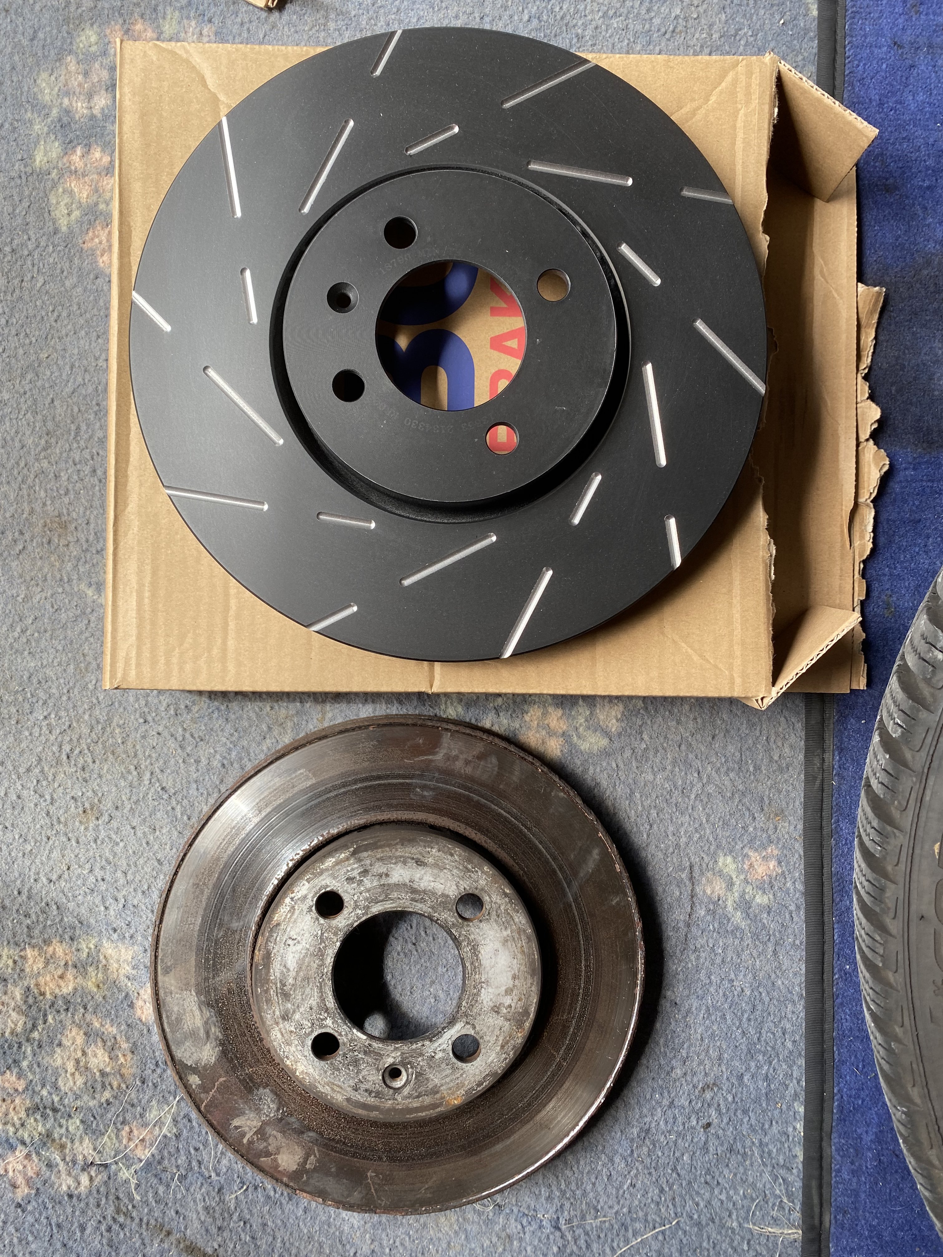

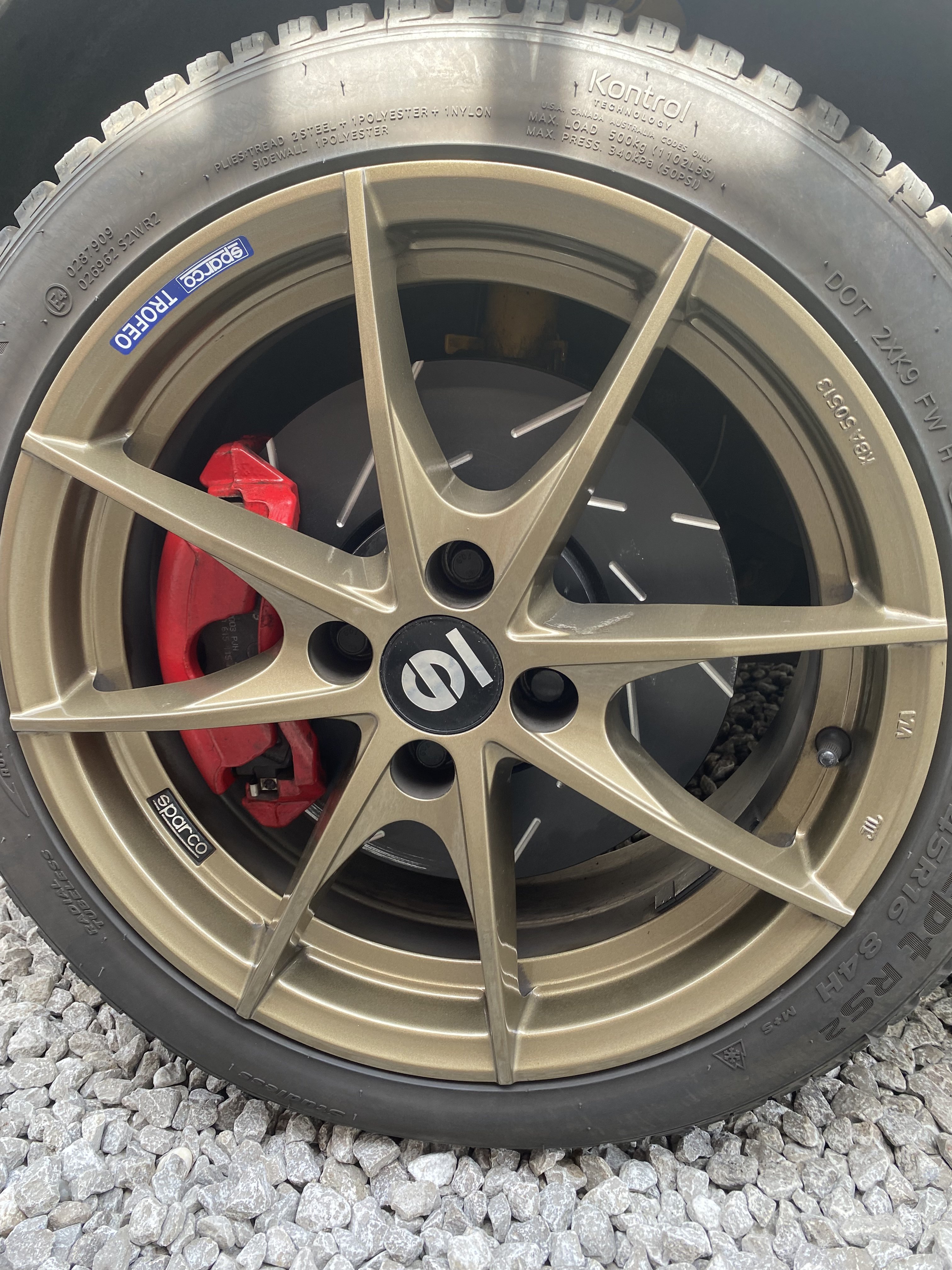

Gti brakes going on,
I ended up buying a brand new hub/knuckle for n/s as I wasn’t very confident in it due to the smack the donor had had on that side, better safe then sorry.
Discs are arriving tomorrow
discs obviously won’t stay black it’s just the anti rust coating from ebc
Edited by TrevorB33

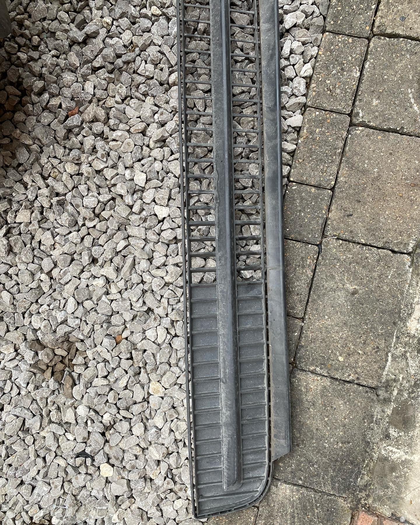

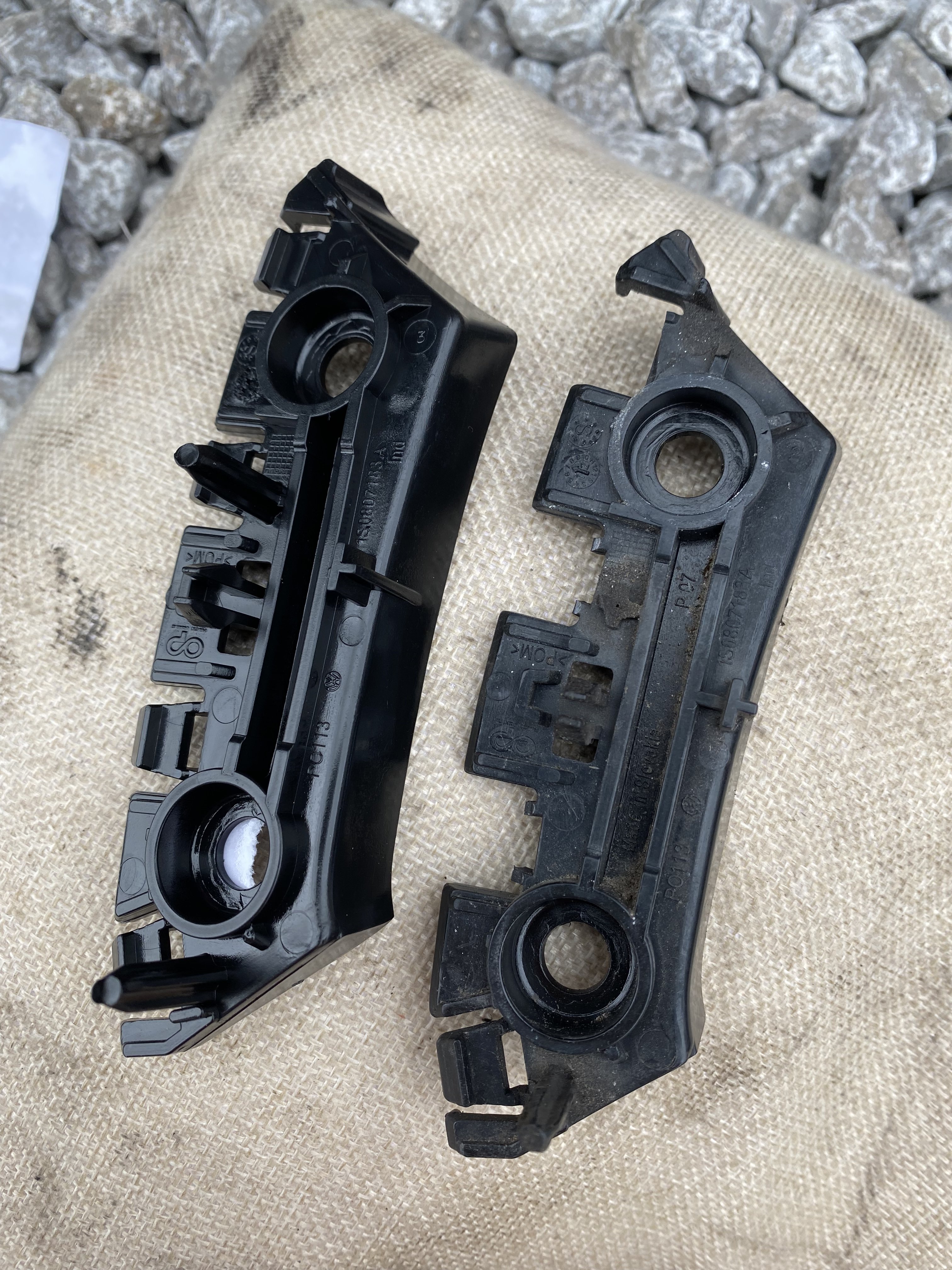

Those mounts are ridiculously fragile, that's what snapped on my Citigo when I smacked into a deer 😂
Yeah I think bumpers been off three times that’s well past there usual breakage stage lol

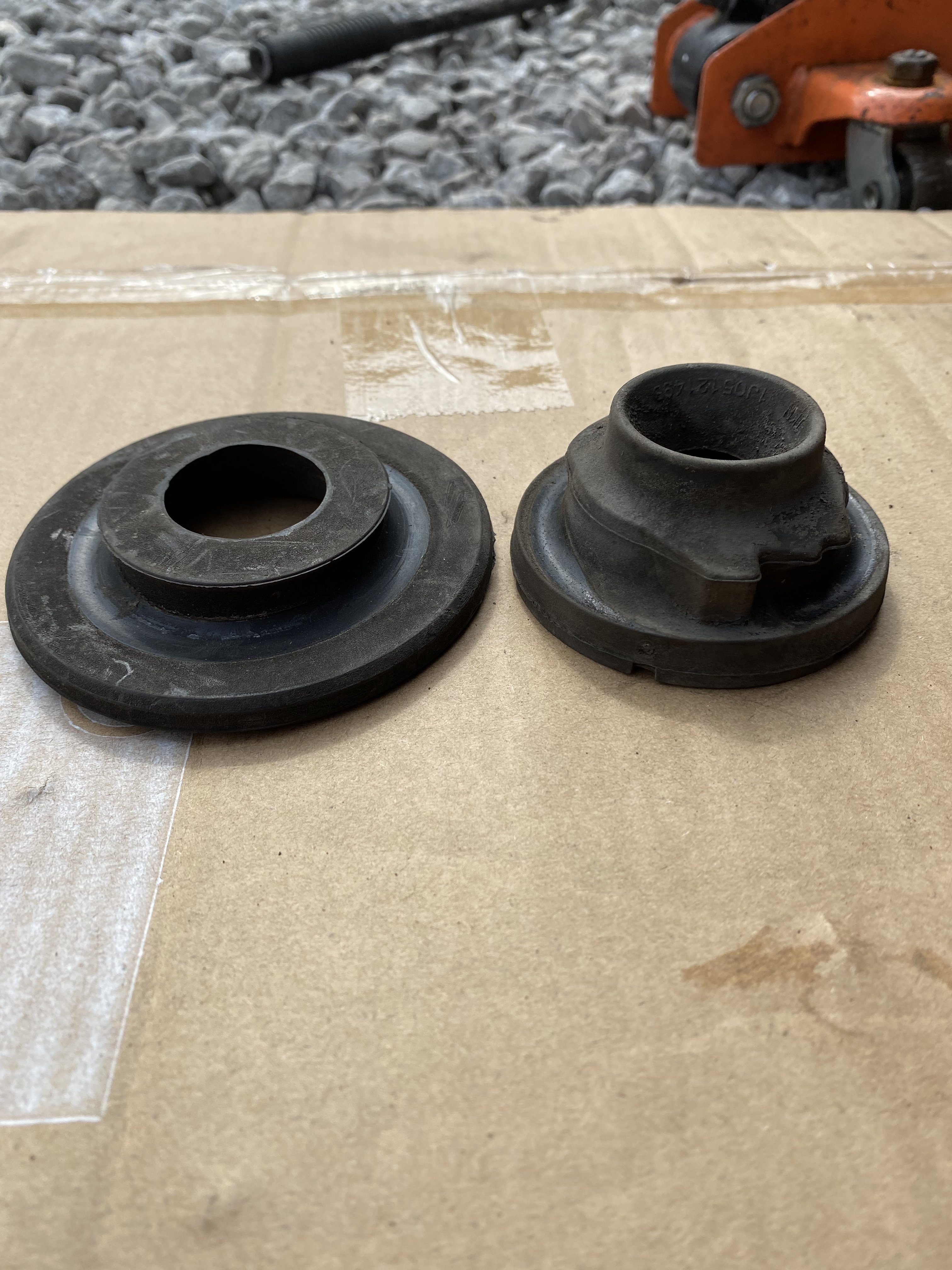

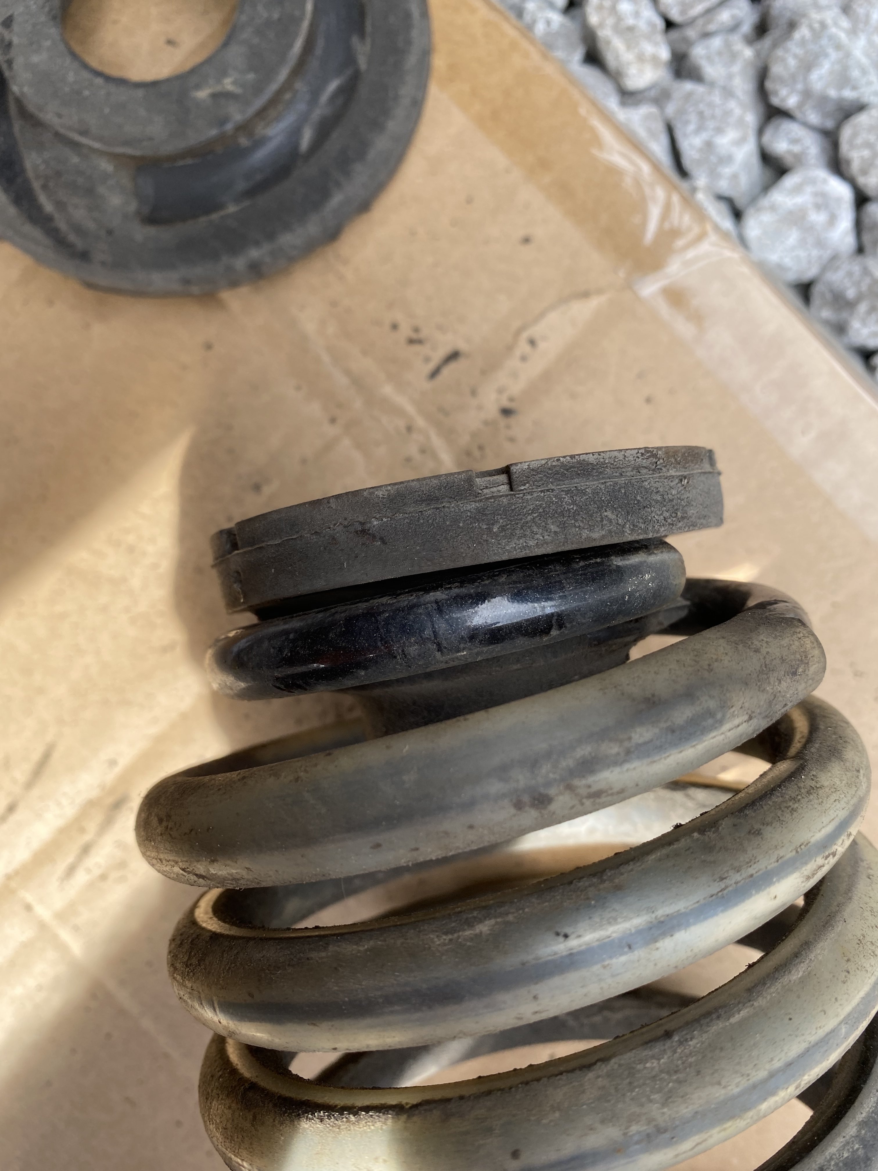

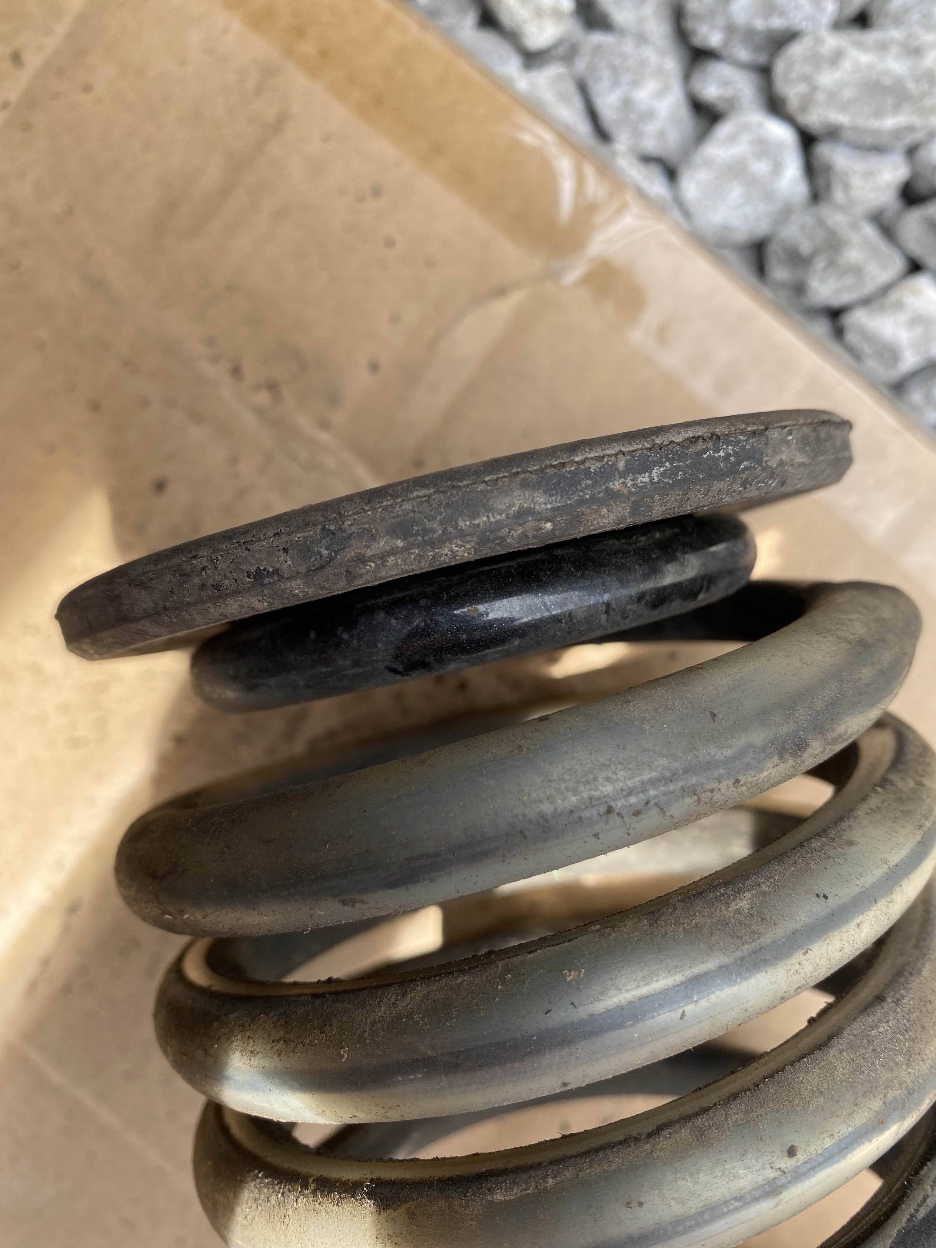

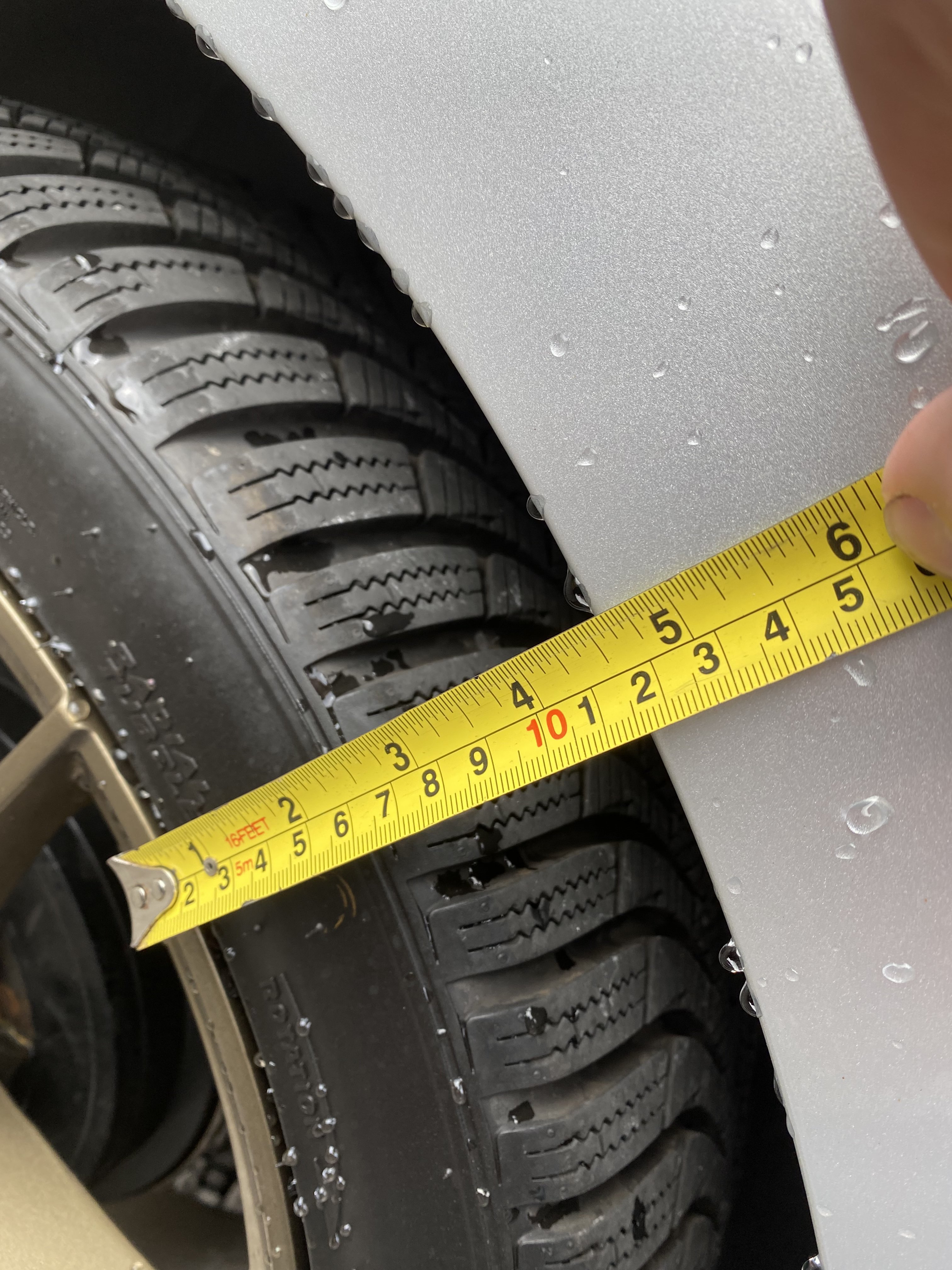

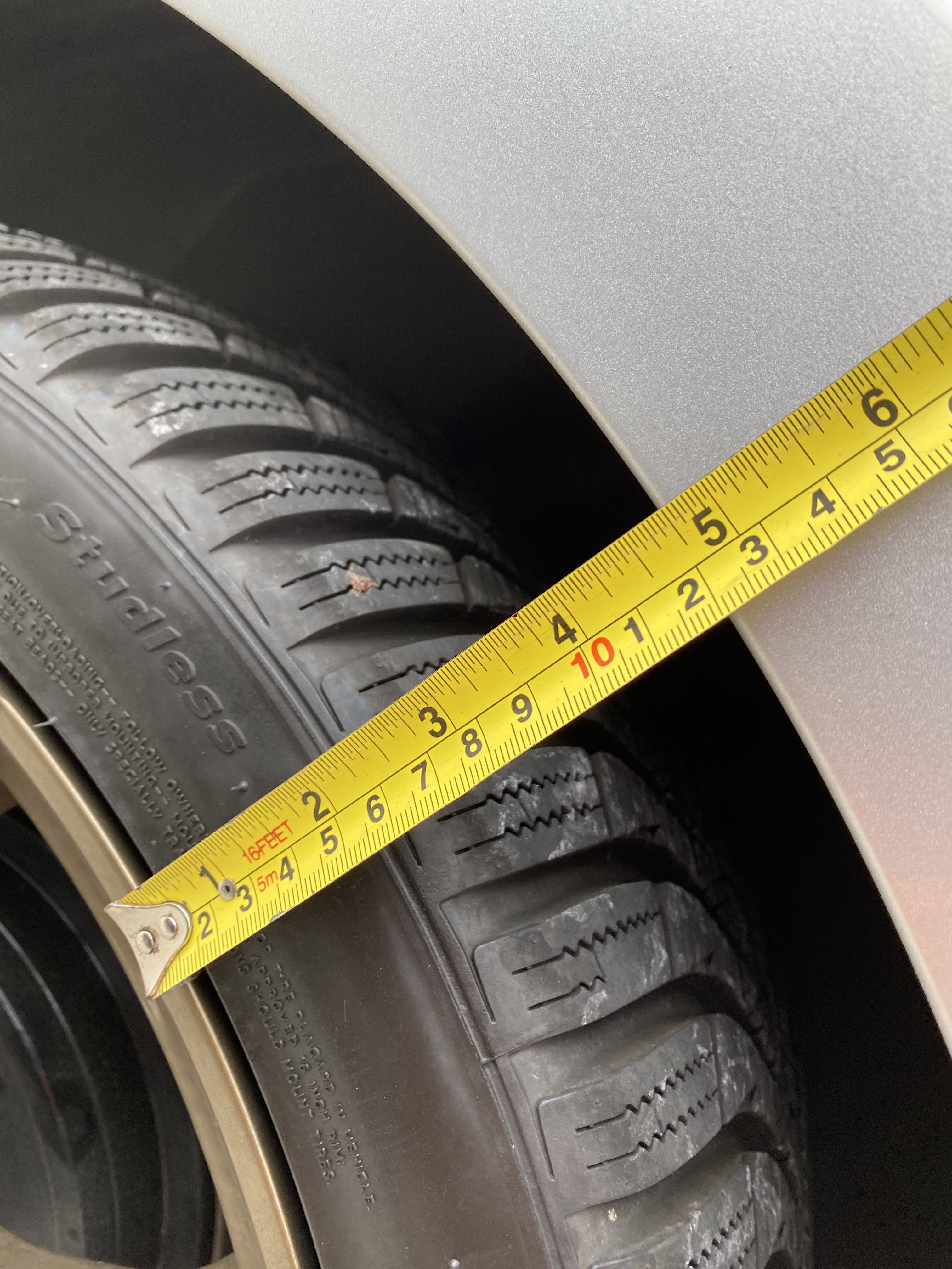

Also did a little mod with the rear springs as it’s always sat a tad higher then front.
it’s not a lot but thinner top rubbers off a mk5 golf that are 4/5mm thinner then oem ones, so should get a very subtle extra drop without altering the ride
Gained bang on 5mm drop on the rear with the different rear top spring cups, part numbers for anyone interested 1K0512149B
Edited by TrevorB33
Those spring rubbers look the same as those found on fabias, certainly look the same as the ones on my monte.
They seem pretty cheap on ebay, might pick up a pair.
They are probably shared on a lot of vag cars, I think mine were barely £10 posted cheap mod

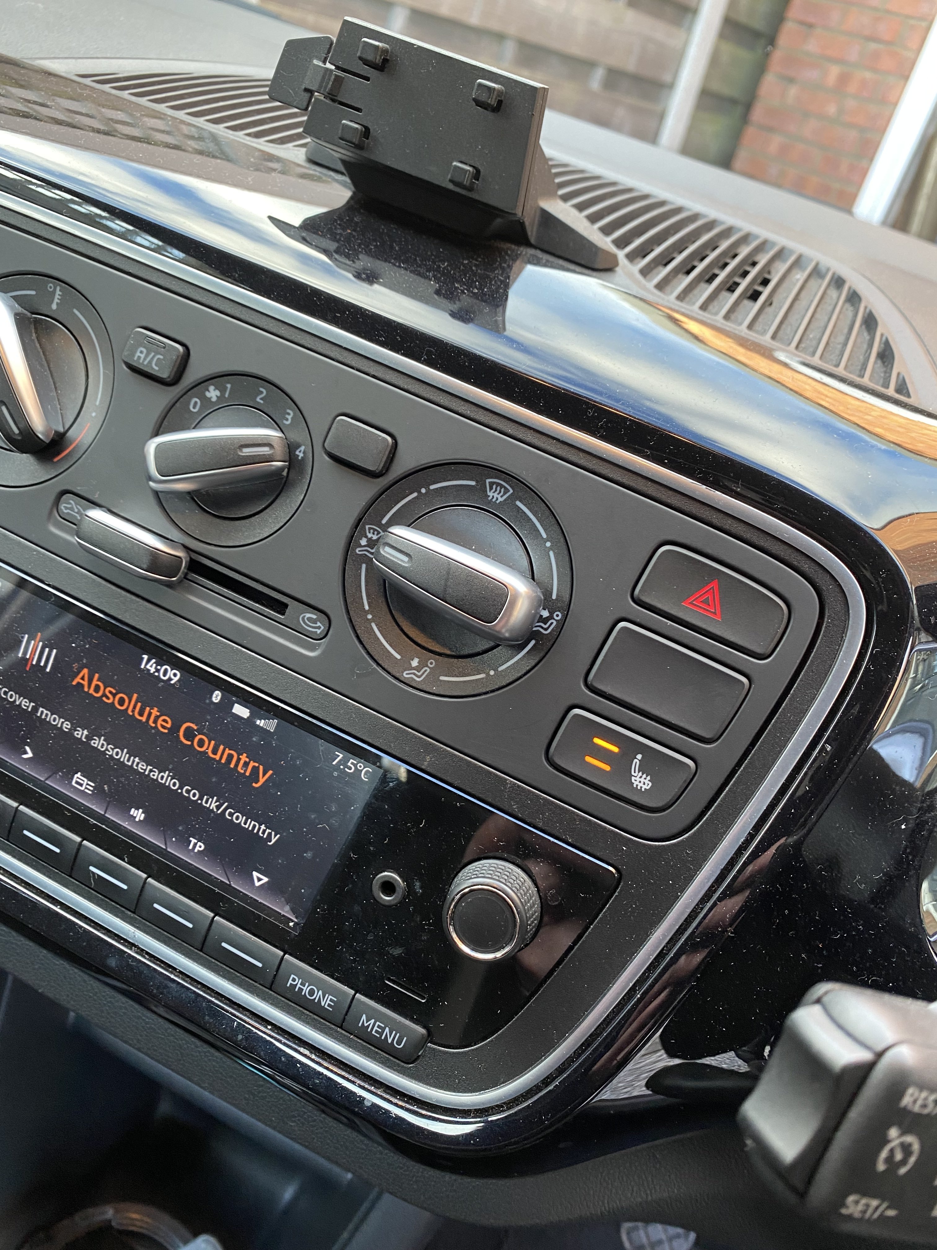

I finally found an airbag for a facelift up tsi wheel I’ve had for quite some time, I can now flick between the various mfd function and get the digital speedo :)

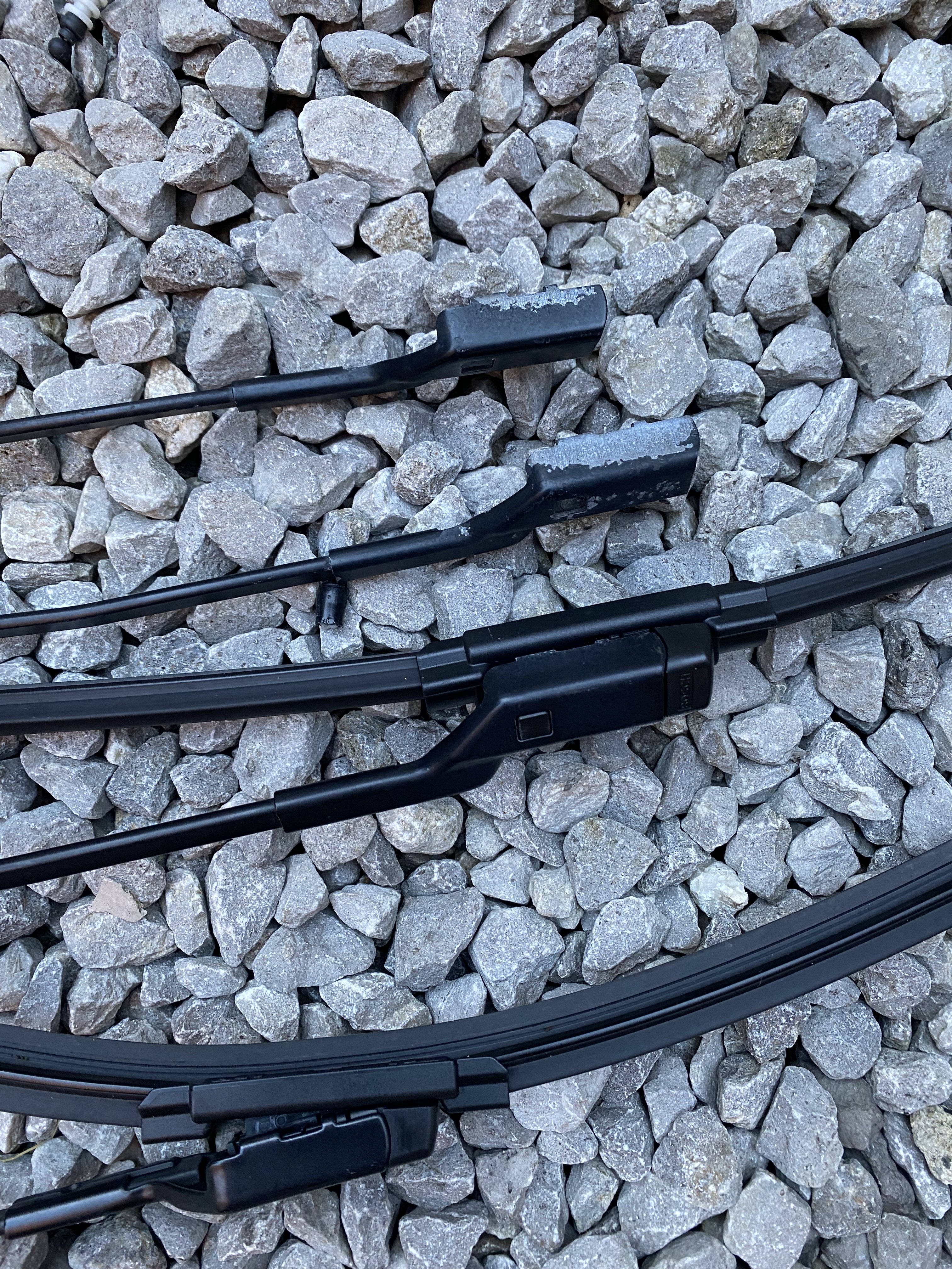

Also fitted some newer wiper arms as my coating had gone where the blade sits and I could see it everytime I drove her.

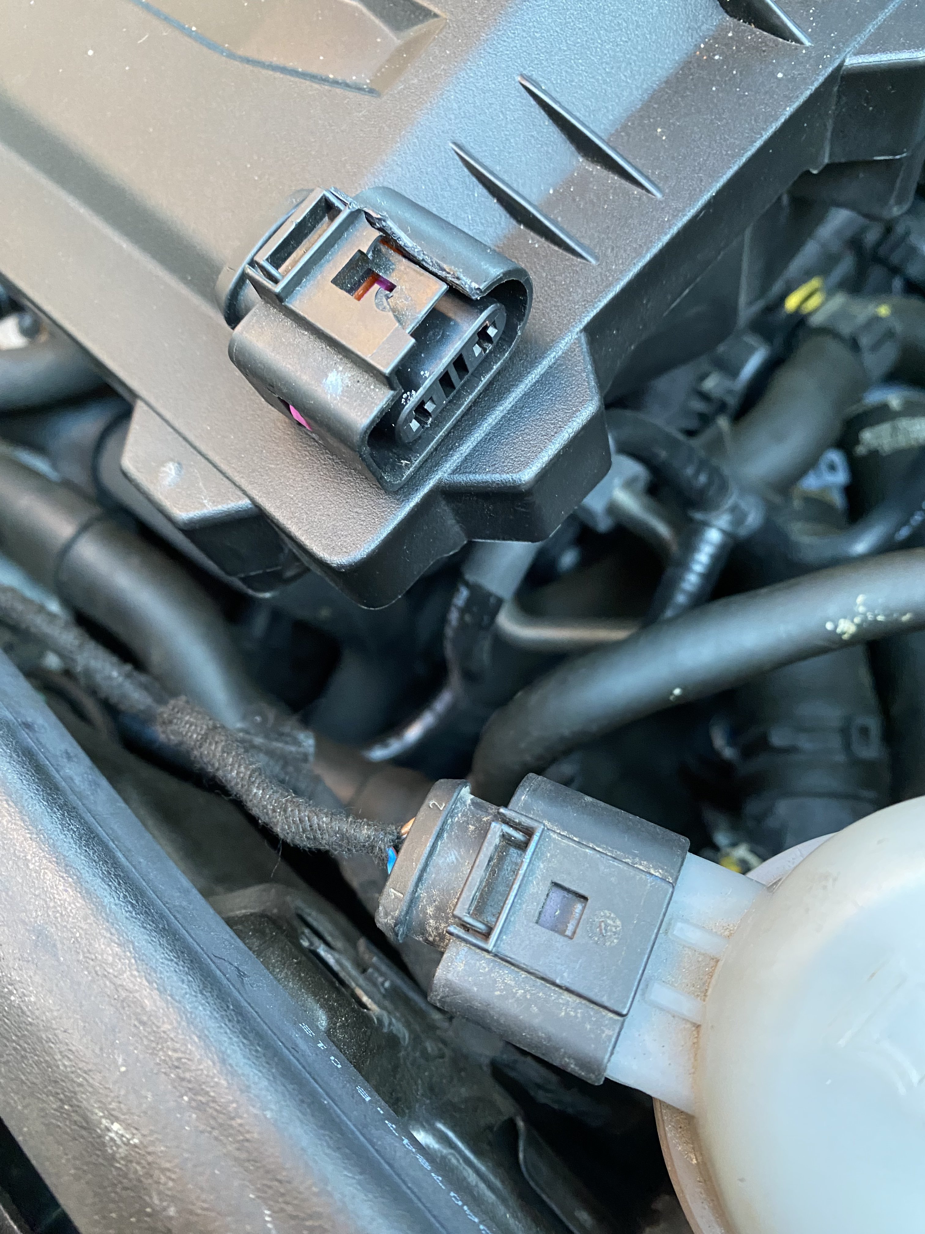

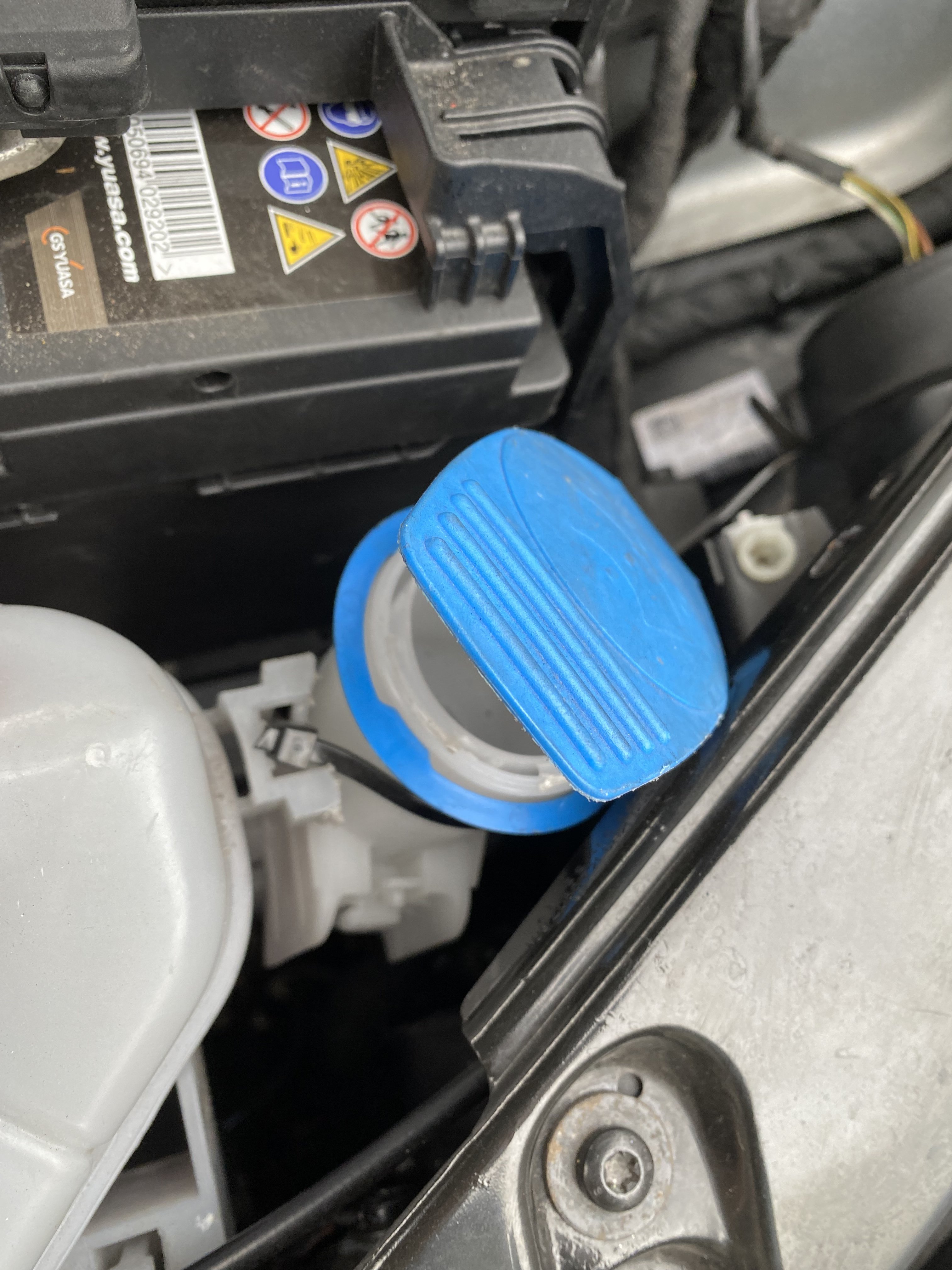

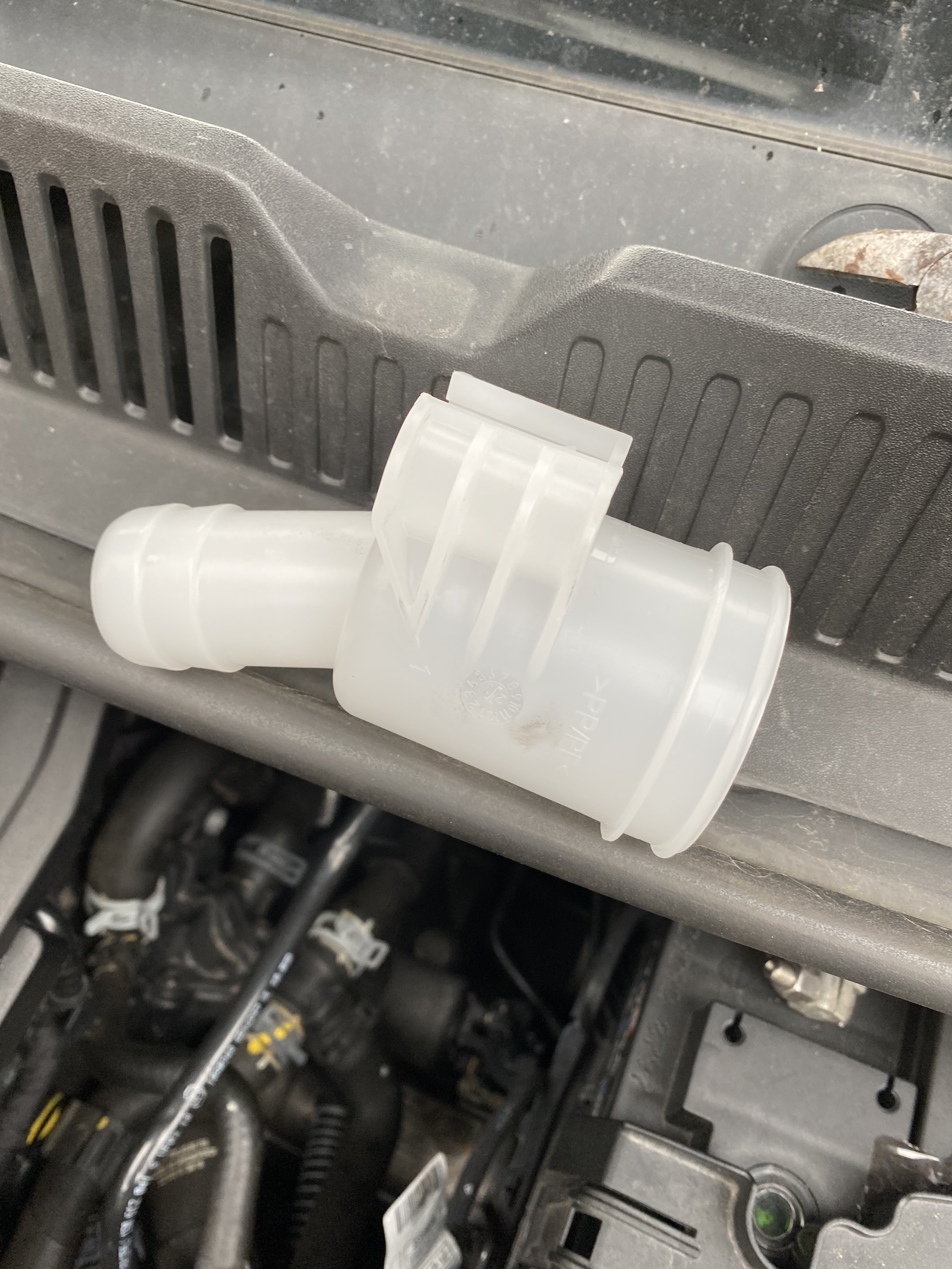

and my last little job was fitting a non broken connector on my coolant tank as the old one was snapped.
much better

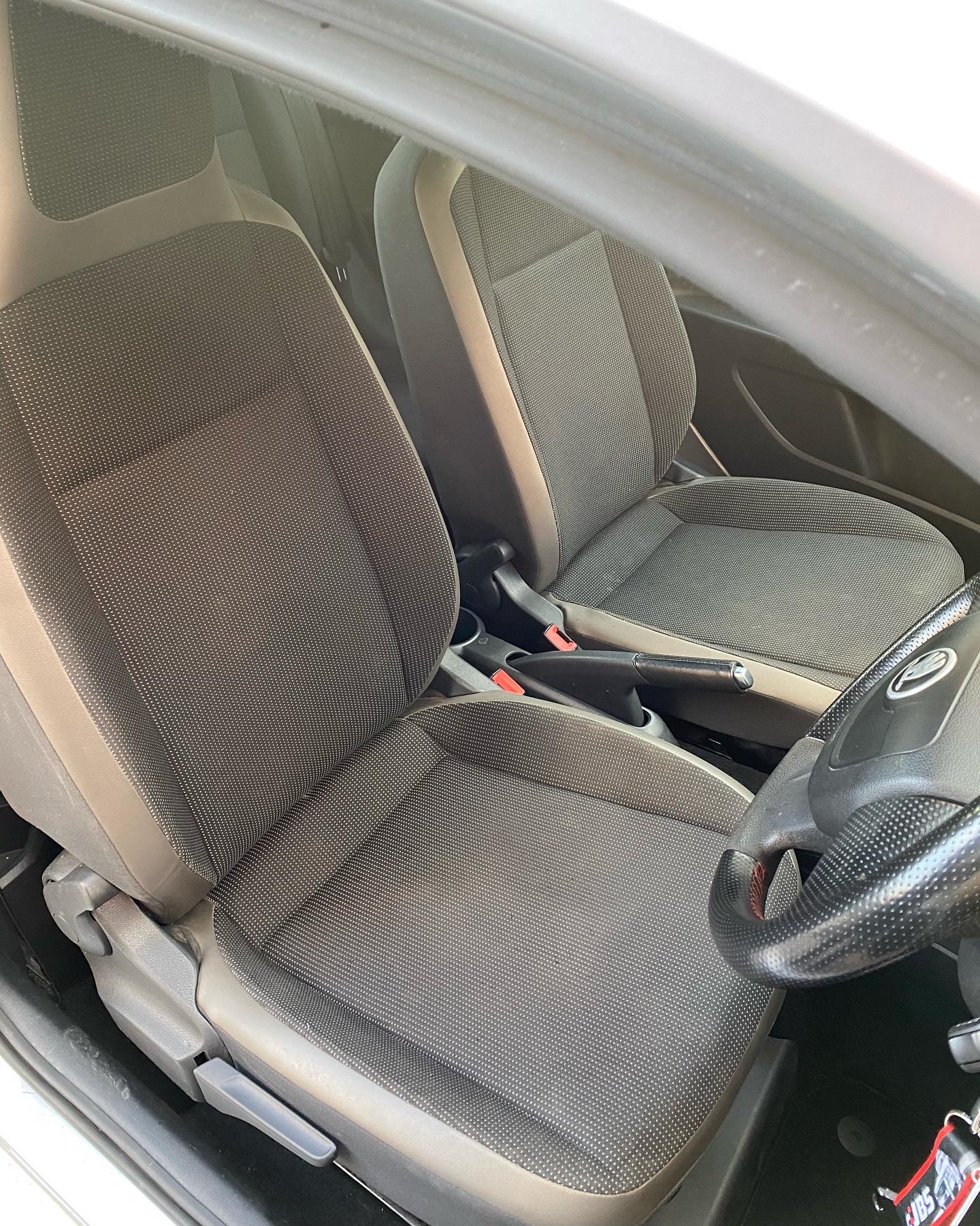

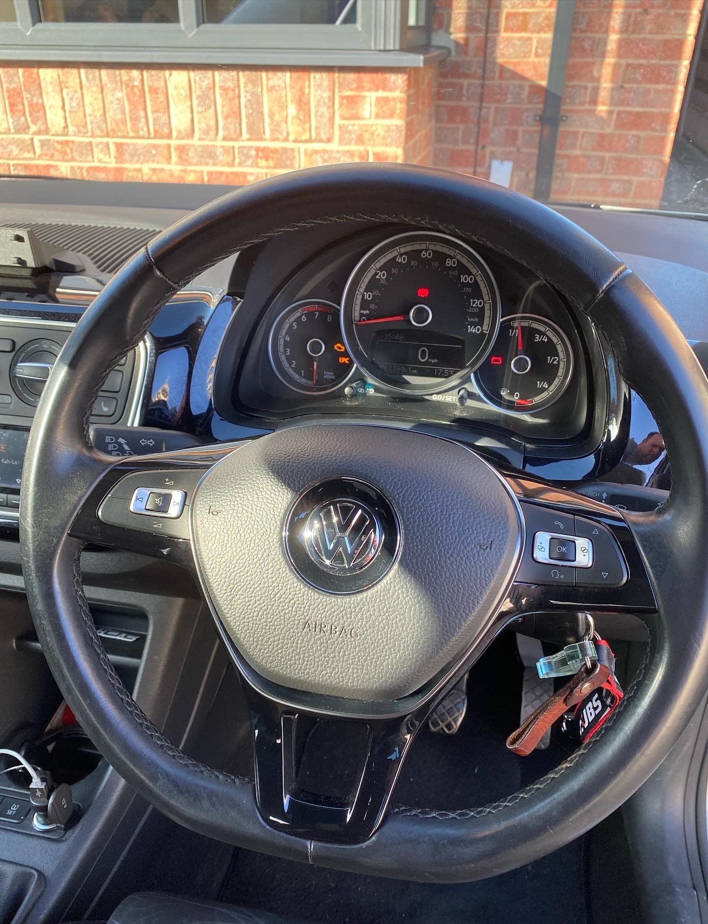

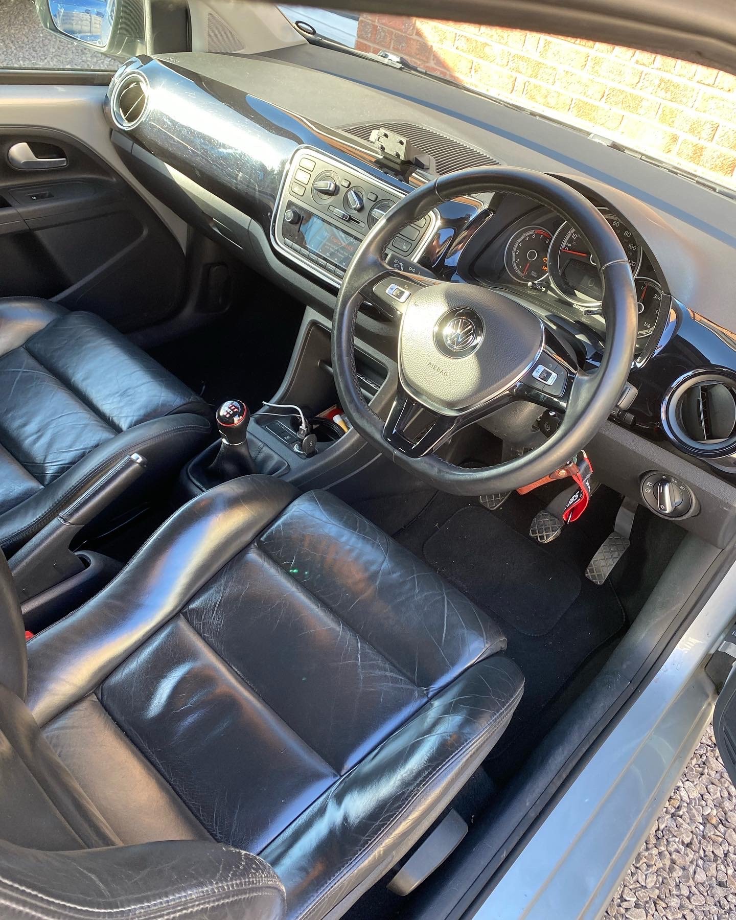

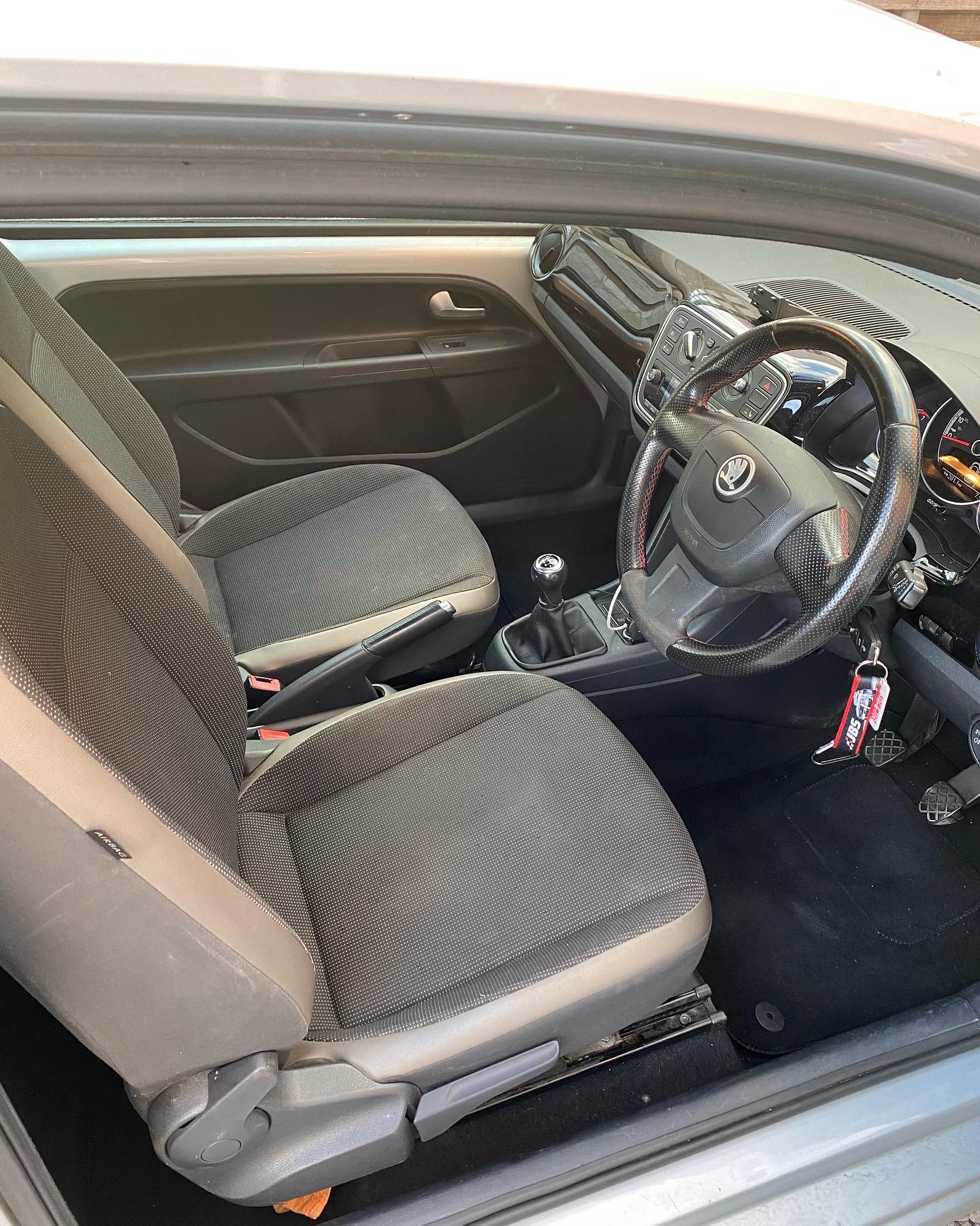

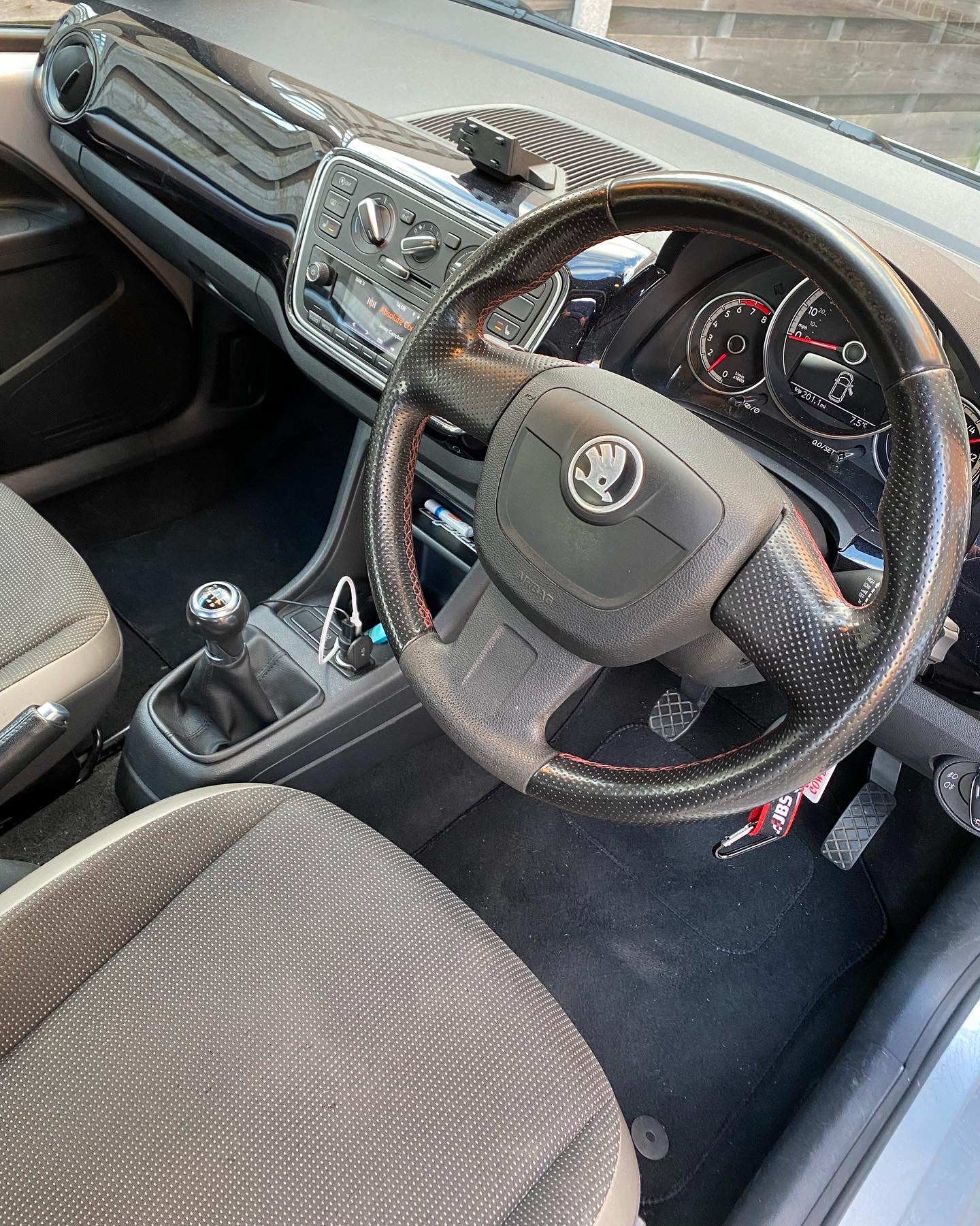

Had abit of a change up in the interior too.

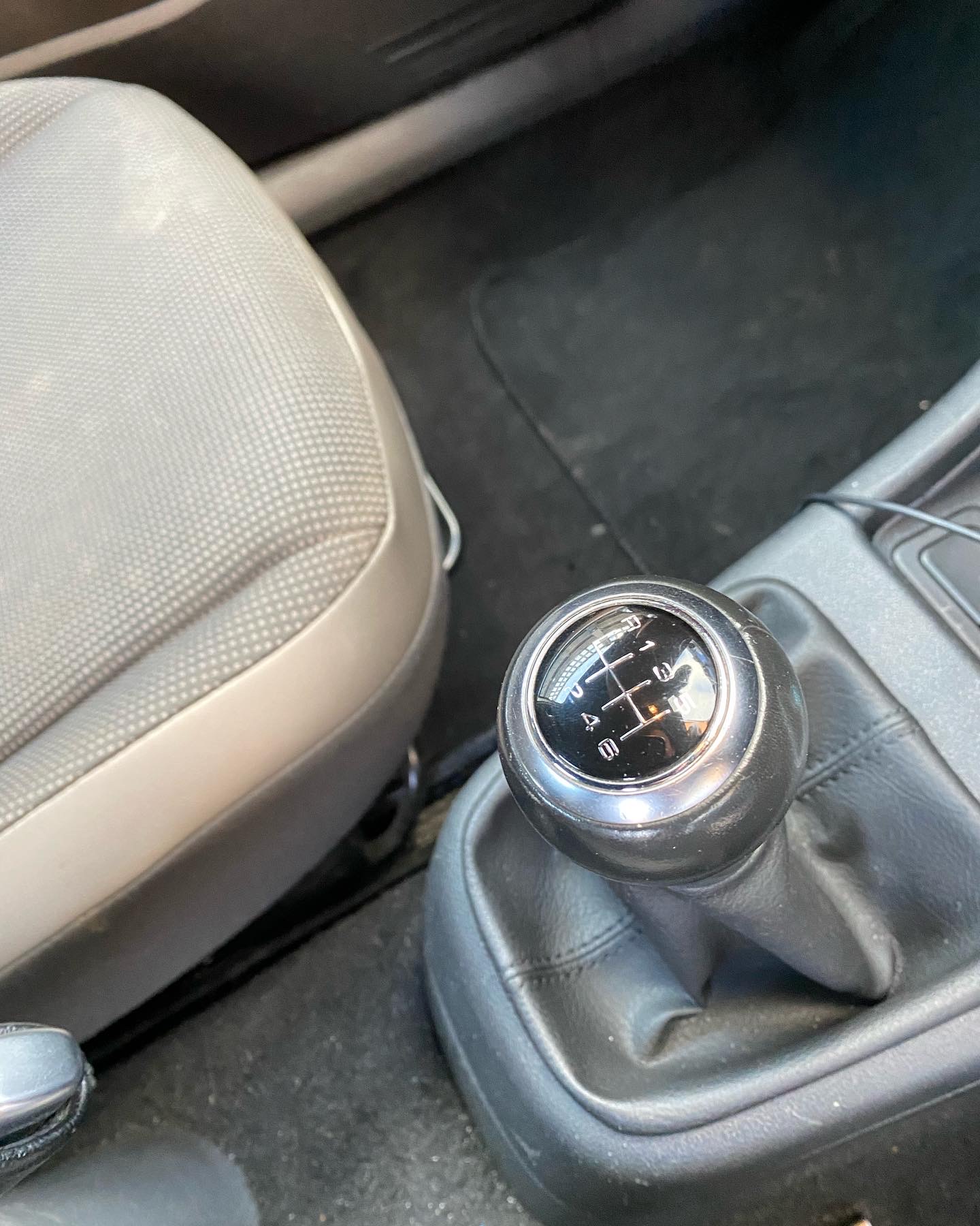

Fabia Monte Carlo steering wheel, Audi 6 speed GearKnob, and vw high up seats which fronts are heated :)
The Audi gear knob is a nice touch. Needs the sporty metal pedals too I would say just to round off the interior.
