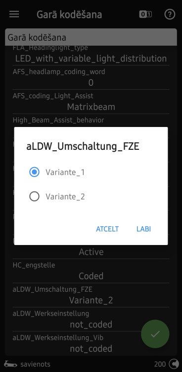

Hello. Has anyone managed to switch this to option 2 in the A5 Driver Assistance coding?
