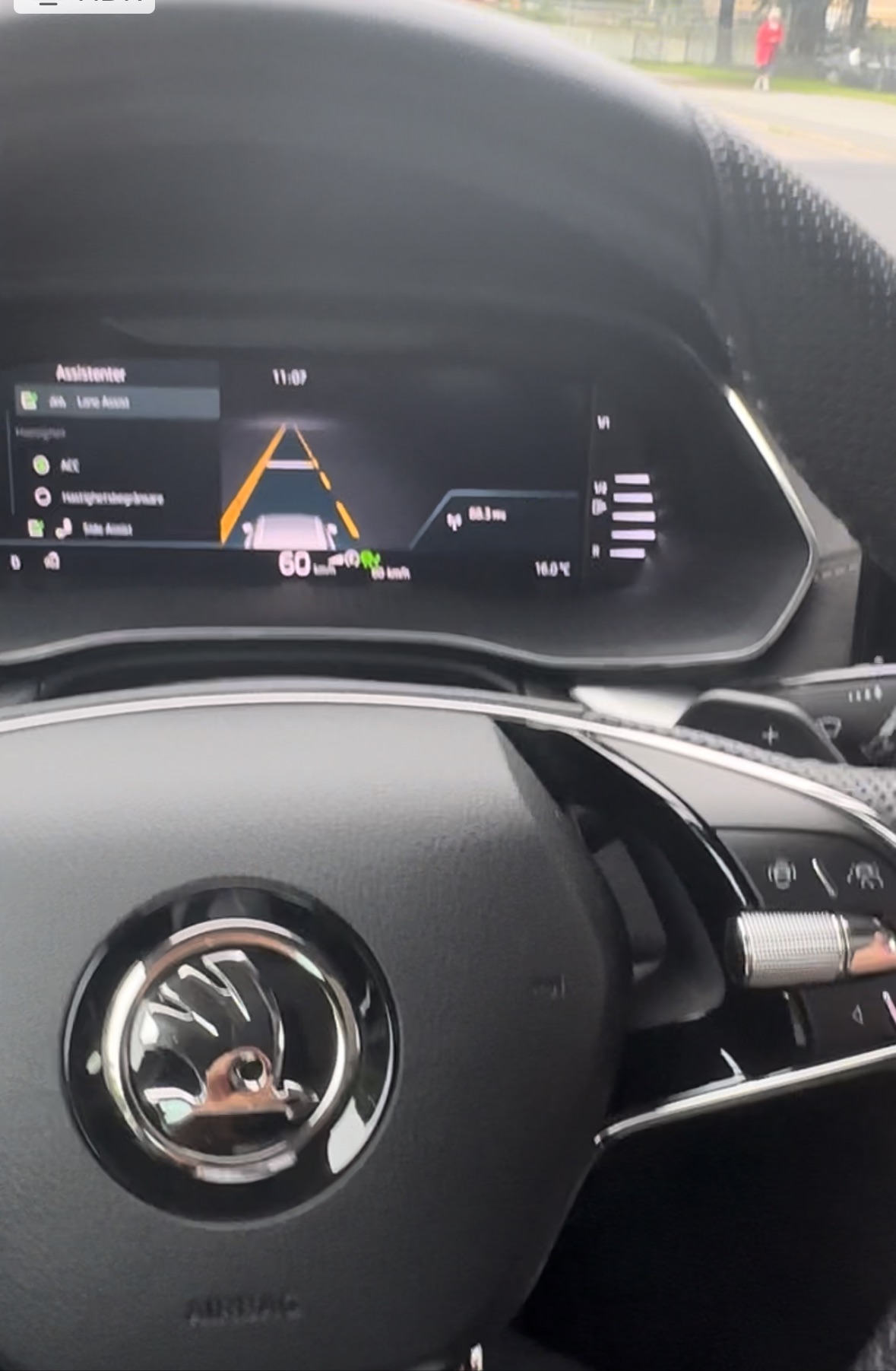

Here is a video and picture, hope it shows.
4 hours ago, Mattian said:
Hey @Grimlock, Nothing feels quite logical here. But the button was there from the beginning.Before it didn't do anything when I pressed it. But now that I have adaptive lane assist, I can activate it by pressing the button directly. Instead of going into the menu. And the yellow marks shows.
The Adaptive is probably an earlier version of Travel, because I can say that once it's activated  (after 58 km/h), the car drives excellently on its own. It follows the road perfectly!
Great advice, I'll look into it as soon as I get hold of an OBDEleven (borrowing from my friend).
22E2BA00-34F4-434B-919A-DD2ECE3936CC.MOV
I will give it a try next week, let's see what happens. By the way, I see that you are with ACC on and you do not have the CC option enabled; you could try and check with CC, seems that way works flawlessly.
Yeah, I usually drive with the ACC on. And like you say, it works perfectly! It's just the beeping that gets to me, haha.

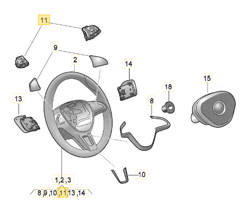

for you other guys who have changed your steering wheel. Did your old steering wheel have the travel assist button like mine?
Negative, mine came without button. Curious that yours came with, I guess it was due to manufacturing reasons.
So, I'm ready to buy a used steering wheel with the travel assist button and of course the "touch unit".
As I read, after replacing the steering wheel there should be some coding and that's it. No FEC from dealer and stuff like that. I am right ?

The more I check, the more doubts I have about your steering wheel. It's true that you guys have button on your steering wheel, but check this exploited view:
That's for a 2021 Kamiq, but I would bet a finger that it's also applicable for the Octavia. Maybe you have multifunction touch on the right side with Travel Assist button but with a standard steering wheel as a base, so even with proper coding, it would work but you will have the same experience as @Mattian
