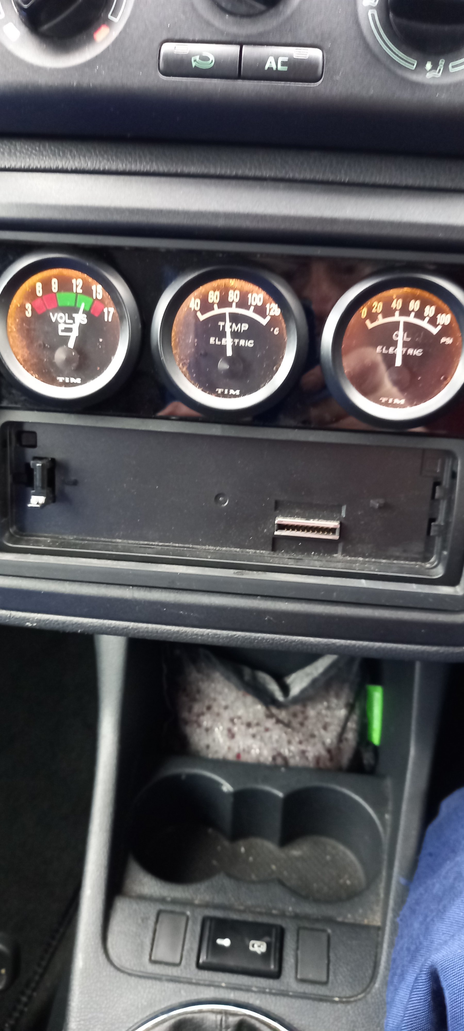

My temperature gauge is now connected up, which should be helpful.
Running engine again after topping up20211230_122345.thumb.jpg.957ce73a2d4815636d0269513b65e5e3.jpg

The heater is certainly better, running at an indicates 90 degrees no issues so far.

Fan came on at indicated 100 degrees,
Bottom hose is hot so I assume all is well.
Thank you for all your help and advice.
Have a good and prosperous new year.
I was wanting to check both the fan function and the flow, fortunately everything seems to be working correctly.
