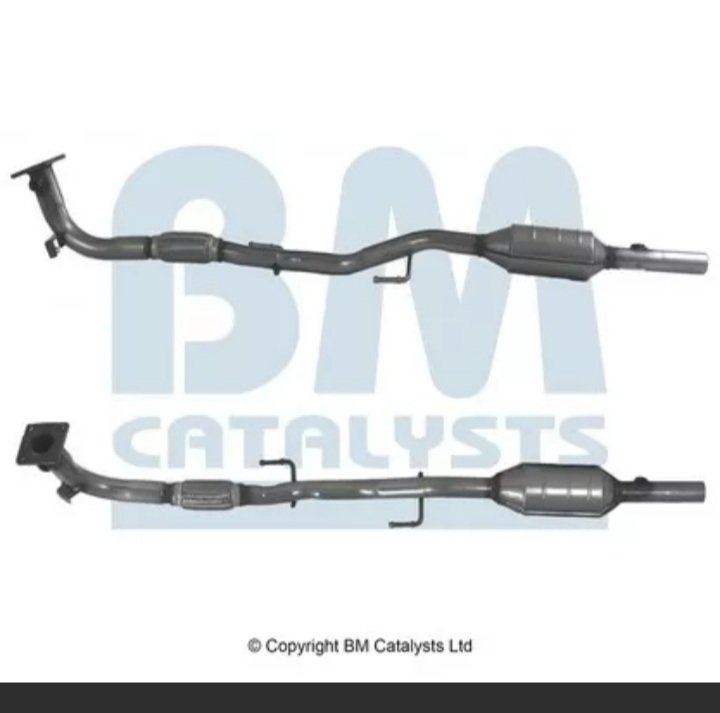

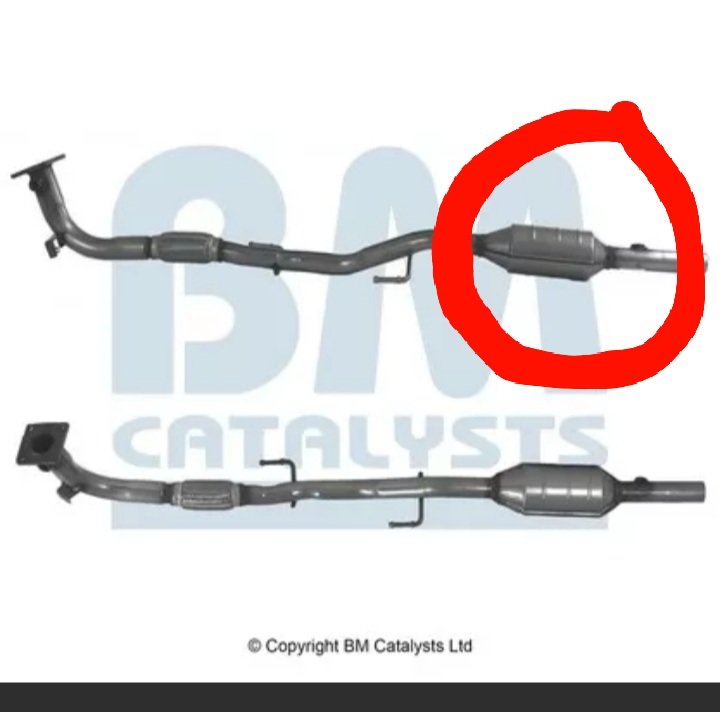

There is no manifold cat on a BKY, as I realised a bit late in the discussion. The pre-cat on an original section is the fat bit up by the four-stud connection to the manifold.
Forget about it. Anything but a megabucks genuine replacement won't have it.

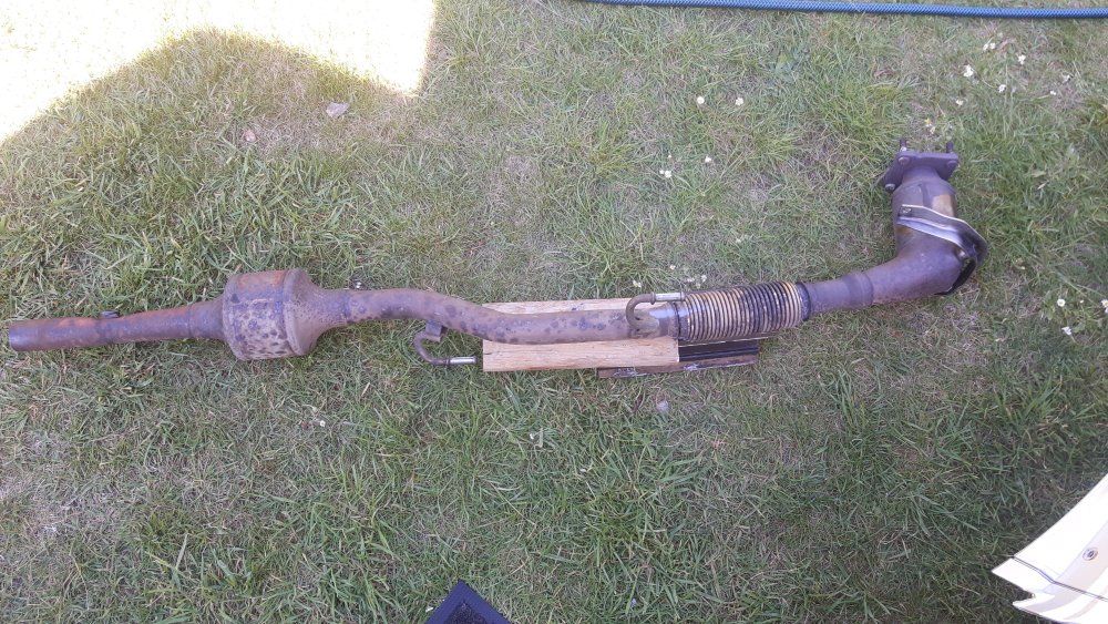

  • I got someone to come out to check the car and confirmed its a bad catalytic converter  and i found a car breakers who is willing to give me a catalytic converter and said if it passes the mot I pay £
  • Update good news my car passed its mot and it was the catalytic converter not the 02 sensor. And had to replace the exhaust sleeve as it was 100% rust lol  Thanks for every one's help 👍👍👍👍
Ok thanks do you think its worth buying the one from eBay? If not have to look for someone who's breaking the same car

I got someone to come out to check the car and confirmed its a bad catalytic converter  and i found a car breakers who is willing to give me a catalytic converter and said if it passes the mot I pay £50 for the catalytic converter but if it fails he take it back with no charge so got a good deal plus mot guy said he will do the mot for free as well 😀
Will Update after mot Thanks for everyone's help
