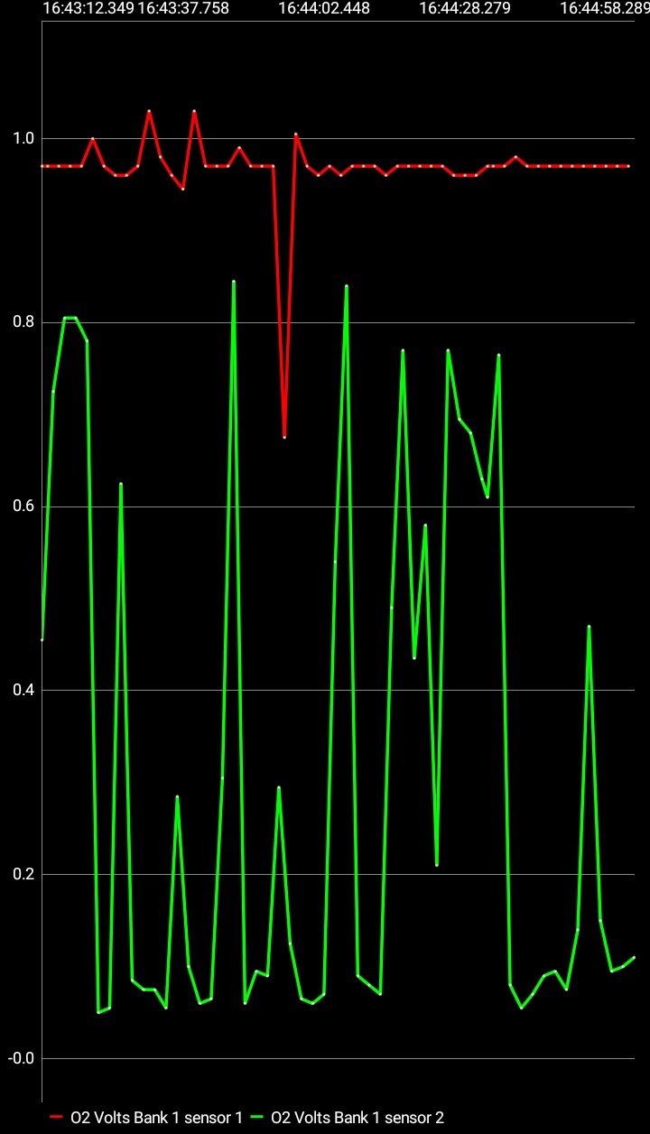

  • This has completely spiralled out of control, if the car has failed on emissions there should be a readout from the gas analyser stapled to the fail sheet. Please post a picture so we can clearly see
He is a pic of the o2 sensors graphattachment1644165930431.thumb.jpg.46974433860aecd33c2a749e5fc80277.jpg

Could do with reading the voltage on precat sensor with VCDS instead to see if it's just that app which is reading it wrongly
I add that tomorrow when I'm neighbor is in unless you can do it on vcds lite and how do you get to the option? Thanks
  • Sponsor
I think VCDS Lite does it, cos that's all I have. Engine ECU measuring block 033.
Ok I do that and post it Thanks

I thought this was the pre cat sensor, no?
Yea it was but what the second guy I went to said its not 02 sensor as he hooked it up to a obd reader and said both sensors are fine and he said its the catalytic converter and do you or anyone have a part number for the catalytic converter

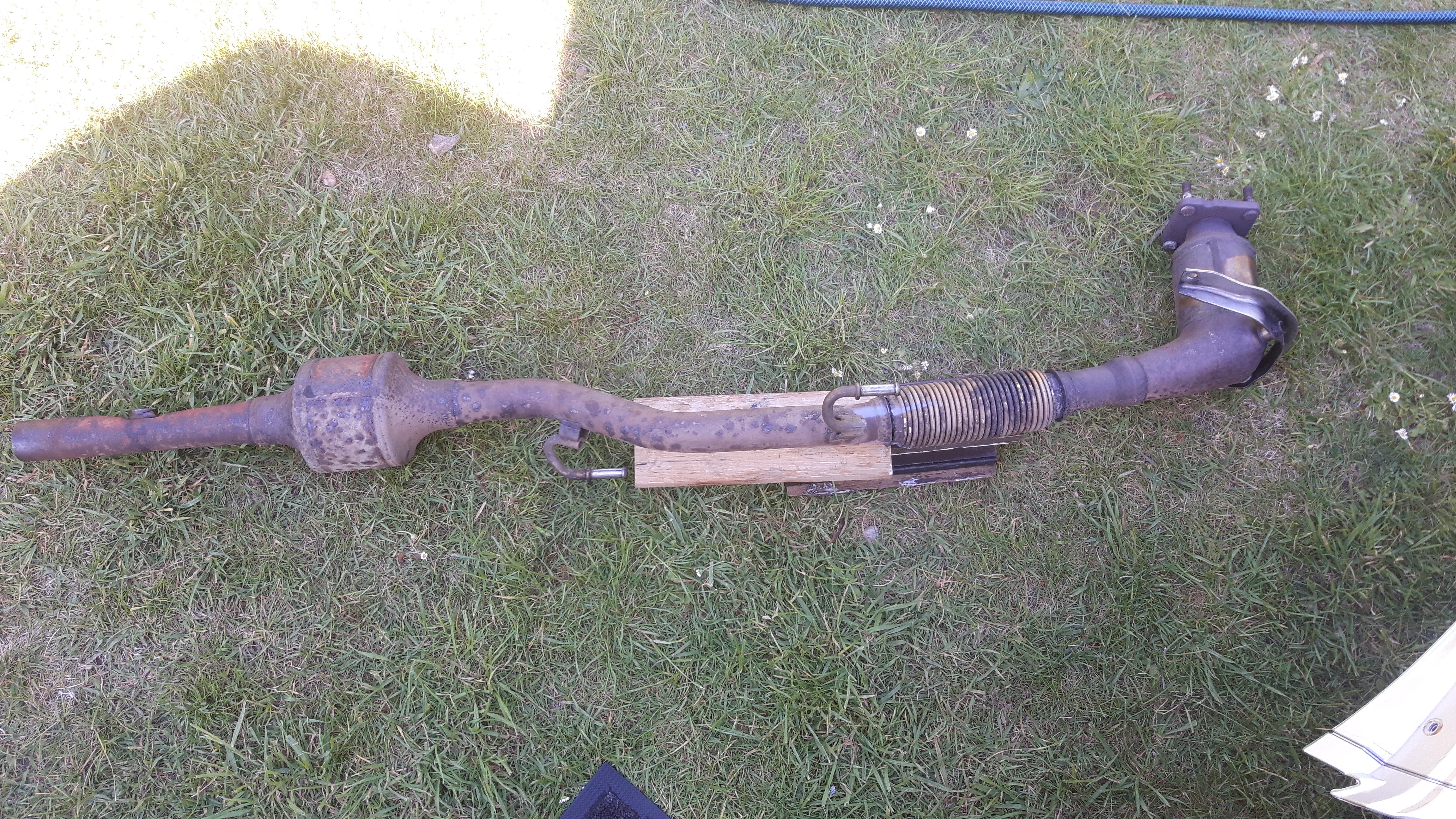

36 minutes ago, Mobear said:
got any photos of the full exhaust system
This is the original from my other (manual transmission, BKY engine) Polo:
I don't remember seeing an aftermarket replacement that has the little pre-cat at the top.
