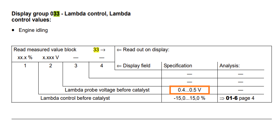

I found the problem it's the lambda sensor bank 1 sensor 1 it says at 1.3 volts constantly but the bank 1 sensor 2 moves up and down from 0.1 to 0.9 as it should
  • Sponsor
Maybe. It's a wideband sensor, so they tend to stay at a constant voltage when in closed loop operation.
My BKY engined 2005 Polo sits at 1.5V, what's the engine code of your car?
Correction, our Fabia 1.2 sits at that voltage, the Polo maintains approx 0.45V.

See correction/edit to previous post. I was looking at the wrong log.
I think yours should probably sit at around 0.45V like my Polo, so you're probably right.

Expect the new sensor to sit at about 0.45V, as per this official info:
Yea it was just a tiny gap where the previous owner put the universal flex pipe on and that means it the sensor mine sits at 1.3 volts on the torque app

Yeah, but the new one should sit at 0.45-ish.
