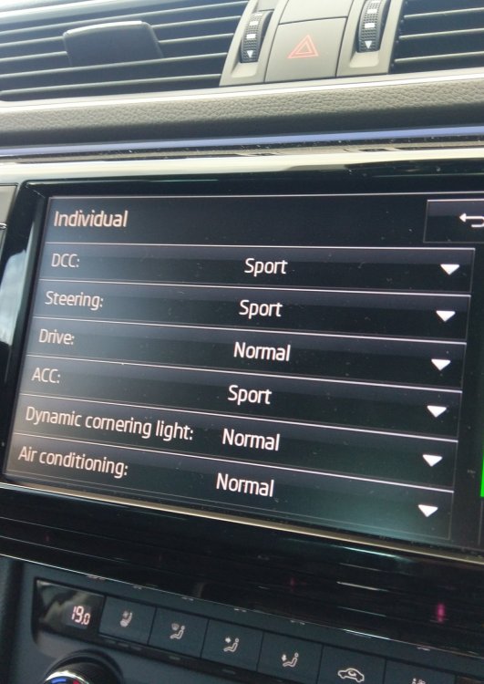

Does my car have DCC I can't see it in the infotainment system etc?
On 27/01/2022 at 21:25, JR RS said:
U have DCC if u have 5 driving modes - Eco, Comfort, Normal, Sport and Individual.
In Individual, it will show u a DCC setting.
mmmm I have  Eco,, Normal, Sport and Individual but no DCC setting in individual  afaik
Edited by BPL

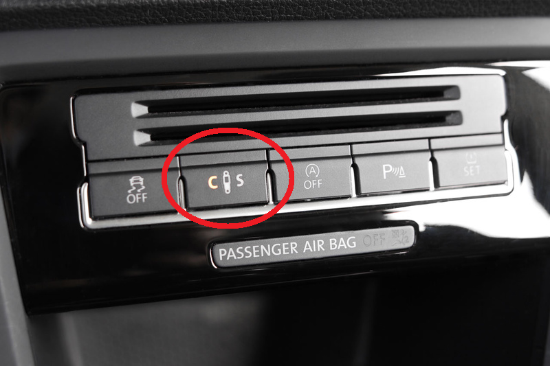

On the right hand side of your centre console, if you have DCC it will have a button that says “mode” with a car symbol. It will be above start/stop deactivation and below traction control (if memory serves me).

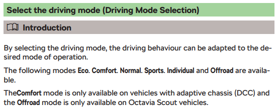

Yes i do but no mention of DCC in the manual or in the individual mode customisation. Do superbs ever have DCC?
Edited by BPL
Pretty sure that's just for drive mode selection. Given @BPL has no comfort mode or option to change DCC, I'd say they don't have DCC :)
Some VW's get a button for DCC but I've never seen one in a Skoda:
Mode on mine alters steering weight, throttle response and damper rates, depending on suspension setting chosen.
Exactly - it selects the drive (driving?) mode :)
@BPL - looks like u don't have DCC
DCC is not standard across the Superb range.  It's standard on the L&K models, and its available as an option in other markets, and some trims (possibly).
more on DCC here - https://www.youtube.com/watch?v=mpV-YChUivY
When u press the Driving mode button (centre console), it will also show there if u have DCC or not.  "DCC/Driving Mode"
