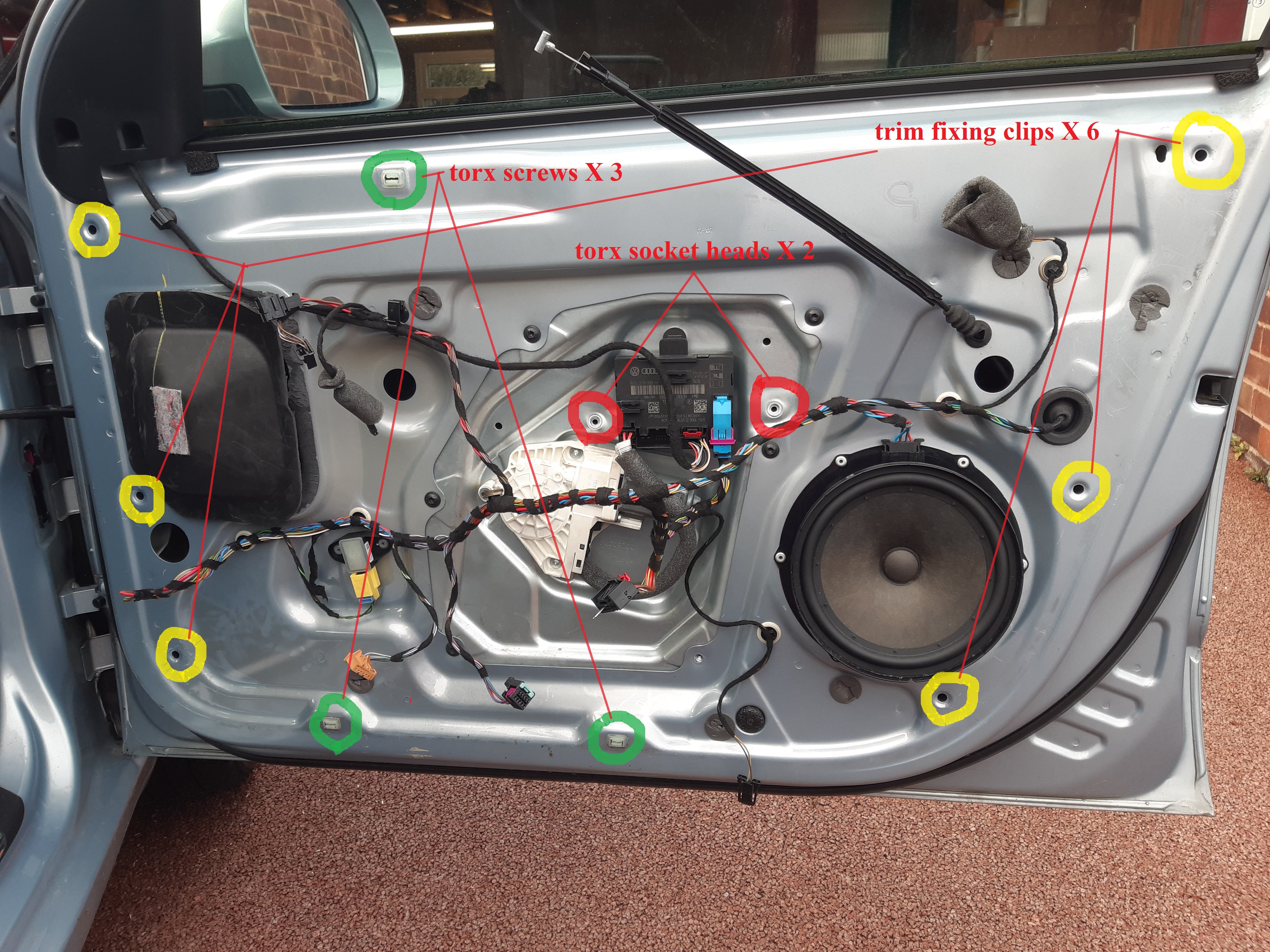

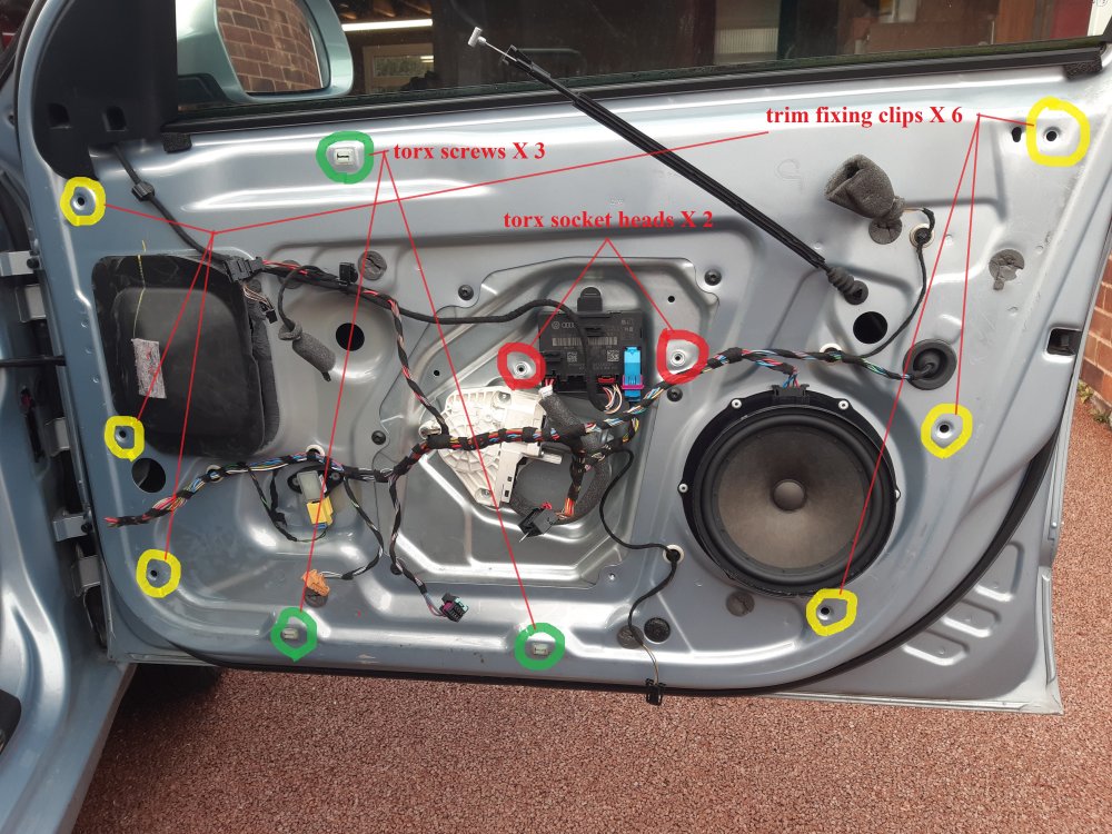

Yes I initially struggled to get the door card off ☺️ And use some proper plastic trim removal tools other wise you're likely to scratch things. You can get a very basic set for under £5 on Ebay.
Lever off the little speaker cover behind the chrome door lock latch. There is one torx screw behind the speaker cover the same as the two torx screws on the lower edge of the door card.
Lever up the door switch panel with all the switches in place. There are two connectors to the switches that will need disconnecting. One has a blue spring loaded tab which is a bit of a PITA to disconnect unless you use a flat bladed screwdriver. You can then access to undo and remove the two M6 torx socket bolts.
There are 6 trim fixing clips round the door card. Start levering the door card off from the bottom with trim removal tools I've marked the positions on the photo I've attached.

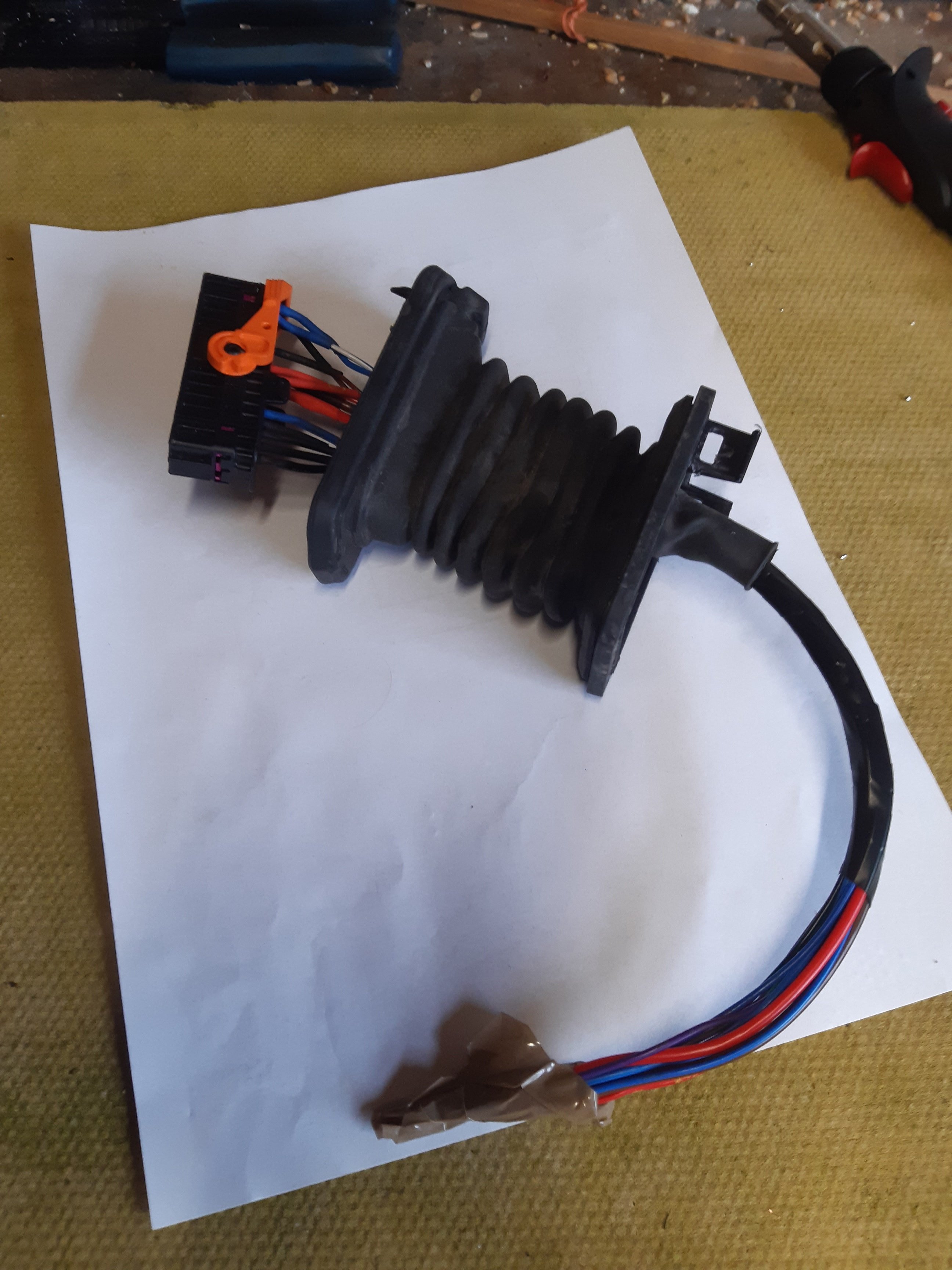

There isn't enough room even if you remove the door to replace the damage section of wires as you won't be able to pull the wires far enough out. So yes you'll have to remove the door card it so that you can cut off  the old cables and be able to have enough room to solder new wires on. I removed all the wires and replaced them all with new wire adding a few more inches which I then fed inside the door. You can see in the photo where I cut the loom with tin snips and left enough cable so the cable and joints could be pulled through the rubber boot (not in the photo) into the door. I didn't bother tapping the rubber boots back on to the cables so I could pull / push them through to where I wanted them. I did bind the new cables with with some insulation tape but not inside the large corrugated rubber boot so hopefully the cables can move as they need to when the doors are opened and closed without pulling or straining at the main door pillar plug. Make sure you run the cables round the side of window channel guide. If you run the cables on the wrong side of the window guide channel the door glass will hit the wires as the glass comes down ( I wonder now I know that! 😊)
The 1st time I did this I removed all the connectors from the terminal block and soldered the new wires to a small amount of wire I left coming from the connector. On reflection i don't think this is a good idea to make a joint so close to the connector as you really need the cables to flex here and I had to bend them down to get the orange connector block lock in the open position. On the second door I left a small amount of the original cable. I did buy some replacement connectors but at £5 for 10 not particular cheap IMO and then to do a proper job you need a crimping tool for around £30.  I've bought enough cable of varying sizes & colours to repair all 4 doors. Though if I ever have to do this job again I'd buy cables with connectors though I couldn't find any when I was looking to repair my car!!

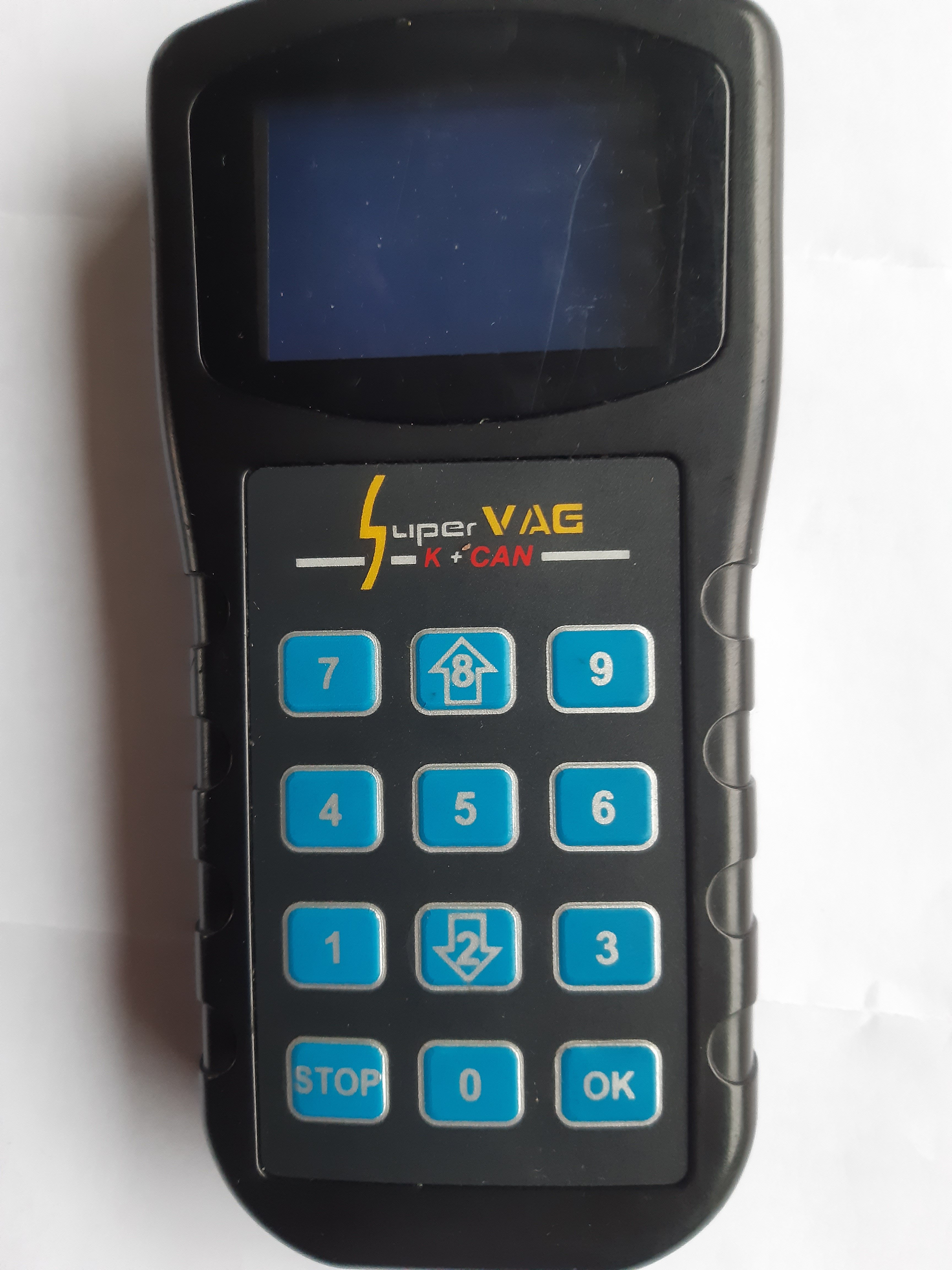

If you turn the ignition on with the door pillar connector disconnected it will throw up the air bag warning light and you'll have to reset it with diagnostic tools such as VCDS which I have. Though I used my very old Super Vag K + Can to reset the air bag light which I bought several years ago when I had a 2004 Seat Toledo. There is a lot of things I can't access on my Superb with this diagnostic scanner. There is a now a newer version.
